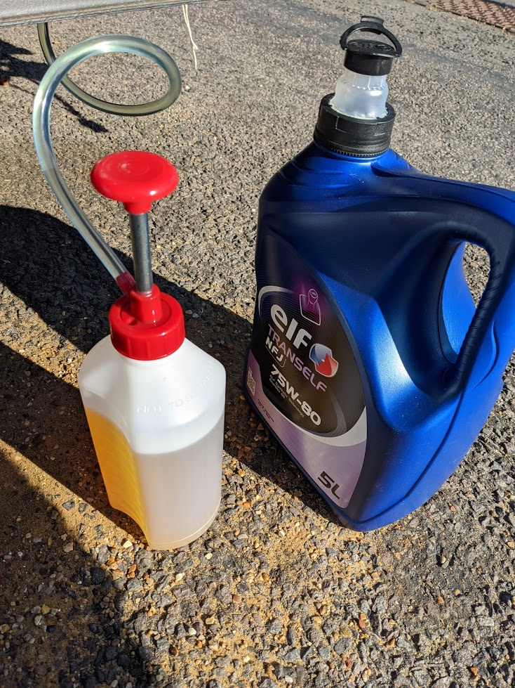

Nice pump. Looks like it'd make the job easier.
My insemination syringe? :ROFLMAO:
Yes it does make the job very easy, holds 500ml so not too many pumps gets the job done (as per). Cheap too!
https://www.amazon.co.uk/gp/product/B074KQNL2Q/?tag=cliospnet01-21
I have another pump which I used last time round which also worked well but took longer and was a chore to clean after. This time round I was changing a shaft and planned to use the old fluid (only 10miles on it) but saw some brass sparkles which is to be expected to some degree as the box was freshly built. Decided to do the nice thing and use new fluid instead. With the bumper off (or maybe just the lower plastics) you can fill from underneath very easily.
Either way, both pumps were loads easier than pouring gearbox fluid all over your rocker cover hoping that 10% makes its way to the daft hole at the bottom.
