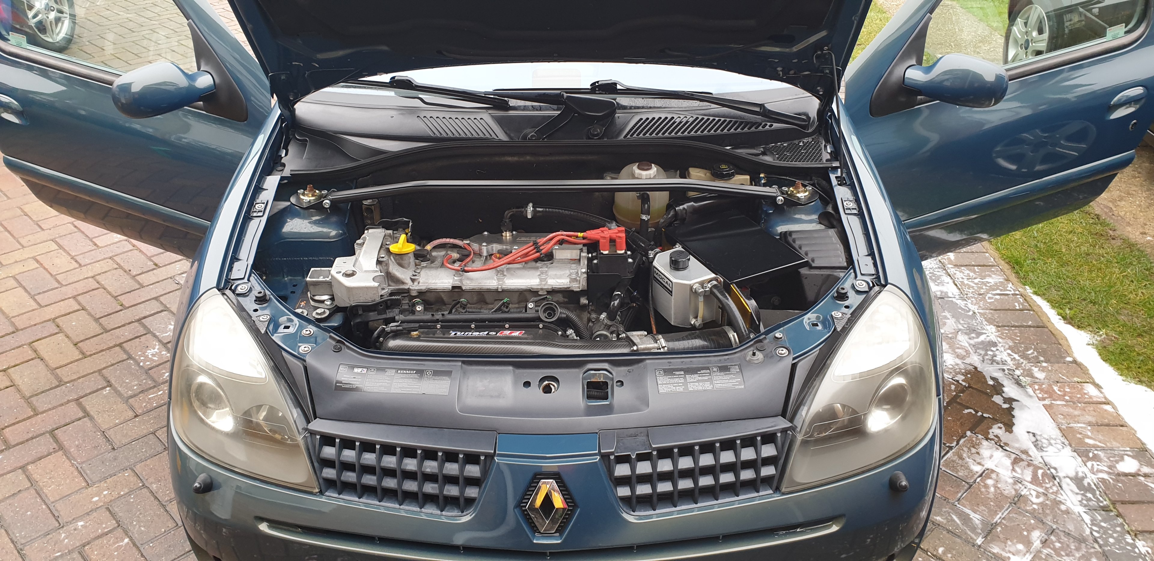

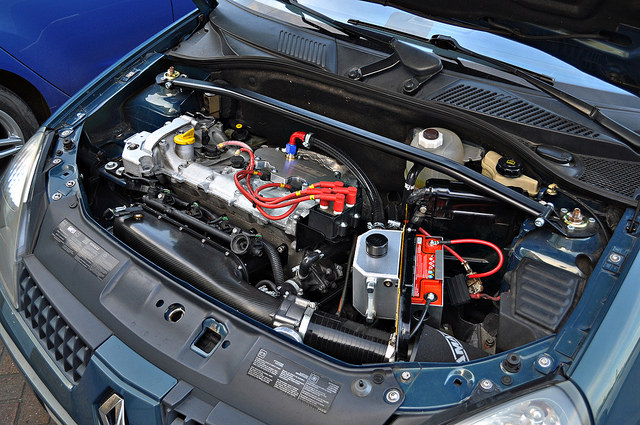

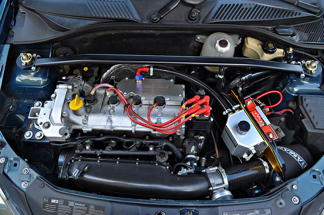

RS2 is fully in and running :)

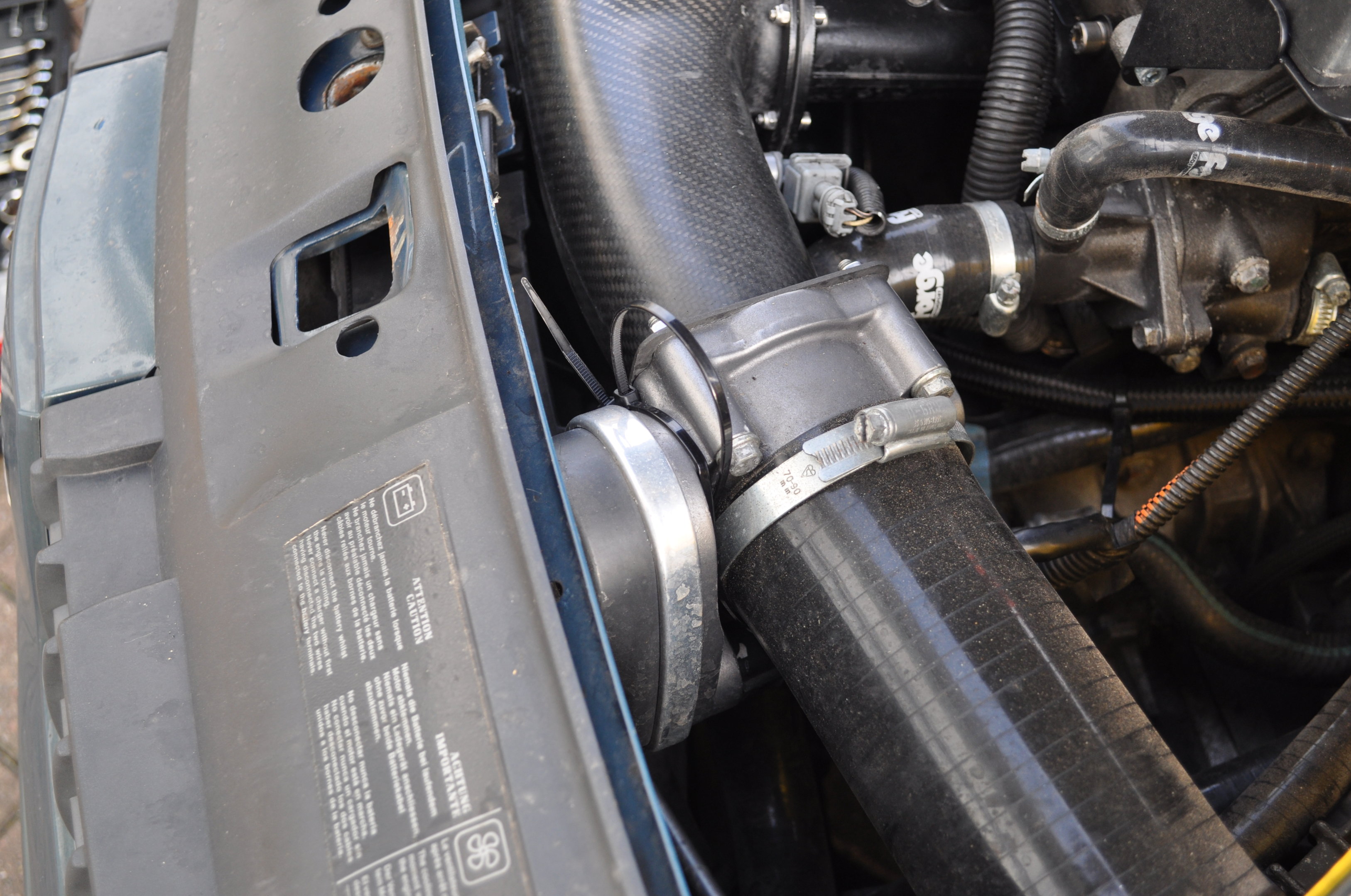

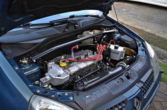

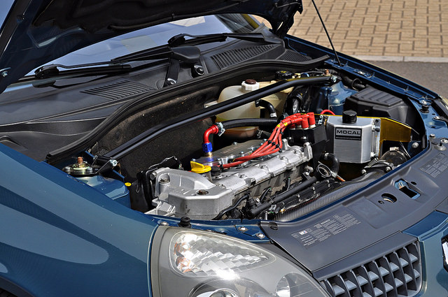

Managed to get my Girlfriend to help and we had it cracked within 4hours. Its all a bit tight where the old battery used to be but it worked out well i think. The battery joins are a mess as the original won't pull any further to mount it nicely. Thinking of putting the battery cover back on to hide it anyway. Gold heat reflective tape added to a custom made bracket that holds it all together. PMS breather plate setup, think it needs a Black An fitting instead of that cheap Chinese thing. You can see the HT leads are muddled up due to the lengths to reach the plugs.
All in all im very happy with the way its come together. Just needs mapping back up at EFi now :) 8th July can't come soon enough. It sounds epic when giving the throttle a little tickle :)
The RS2 install looks awsome. I think it really cleans the look of the engine bay. It's the noise it makes too! Definately something I would like for my track car.

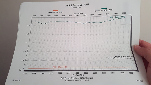

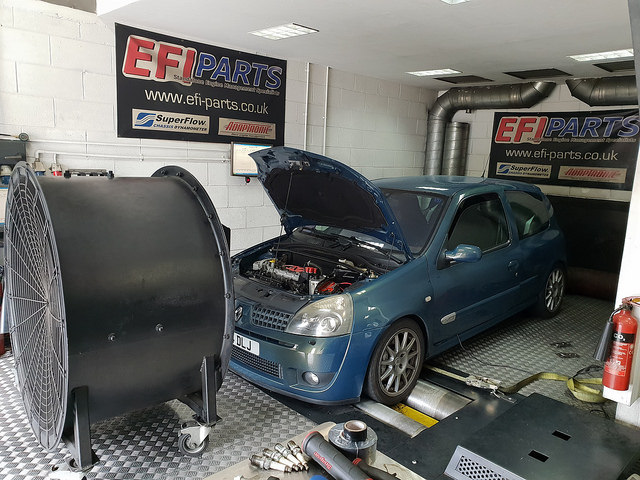

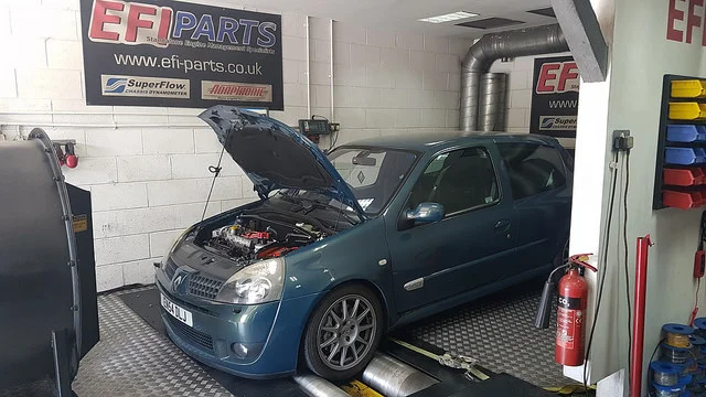

Car was in for mapping Sunday :)

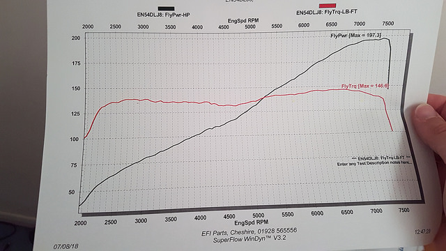

Maxed out the injectors ? 197.3 BHP/146.6lbft. Was 28 degrees inside.
The AFR's are not the tidiest and its running lean at the top end. Chris stopped what he was doing and said to come back with some 197 injectors :) Will be going back asap as you can imagine. Car runs lovely now and sounds awesome :)

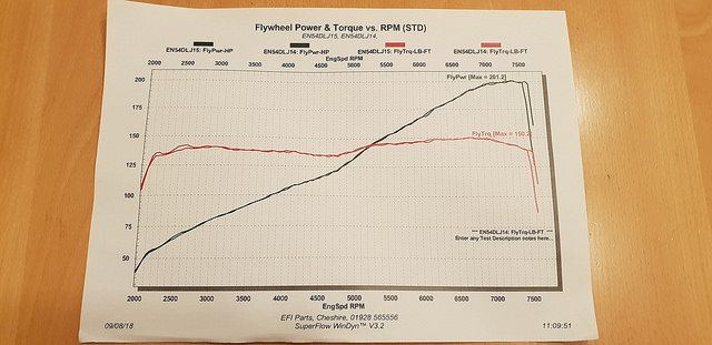

So a couple of weekends ago we headed back up to EFI and Chris to have the 197 Injectors fitted and re-mapped accordingly. Was secretly hoping to crack the 200bhp mark.... And it did :) The first run Chris made came out at 201 but the AFR at the top end was out a little. After a few 199.8-9 runs we had 4 consecutive 200bhp runs with everything showing as safe :)
Really happy with what has been achieved now. With getting to the 200bhp i now really want to get the weight down to 1ton !

- Mapped by EFI Parts. 200.6bhp/150.2lbft

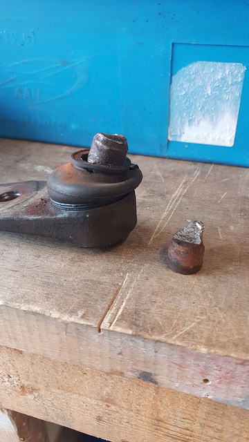

Had a slight issue last weekend !
Thankfully happened at 3 MPH coming out of a parking spot !!! No lasting damage to the car other than a tyre getting a rather large cut in the tread when the bodywork dropped on to it ! Lucky to say the least as we were going to be heading up to London !

Proper weird, never seen that happen before?
You say you were coming out a parking spot, no damage that appears someone has driven into your wheel is there?
Reminds me of trunnions failing on old triumphs
Jesus! Pattern part ball joint?
When rebuilding the suspension it looks like I orderd them from ECP without thinking. Looking back at the paperwork they were all of £18 each! The new ones are from Lemfodder. The quality difference is quite noticeable.

Nope me neither ! My mechanic best mate has only seen it a few times.... usually when it's been at speed ! The other side looked quite bad but no signs of cracks.
Nope no damage.

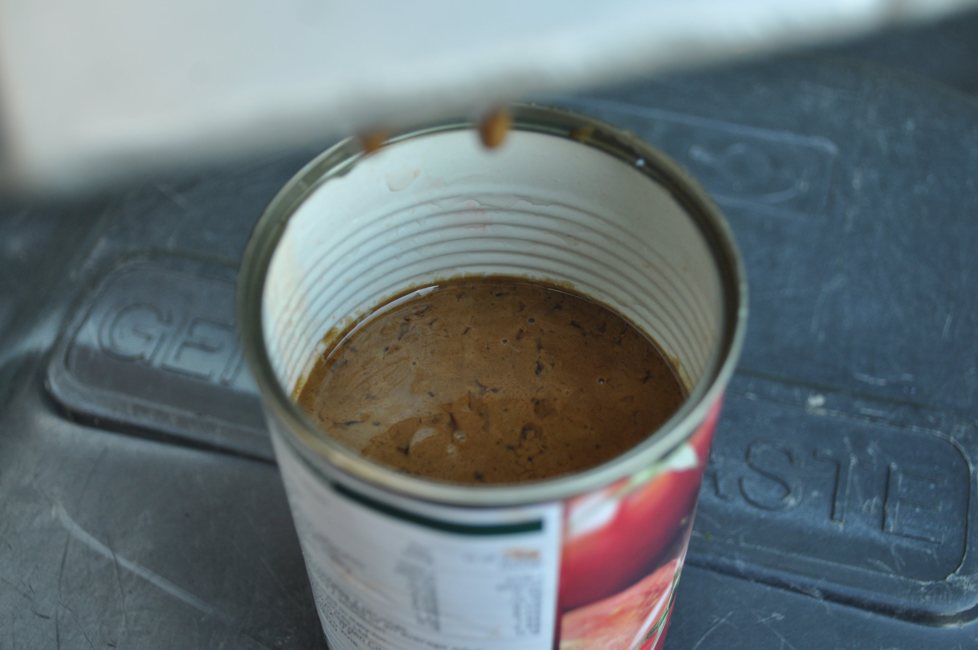

After that i was having a clean under the hood the other day and noticed some Mayo in the oil catch tank! As you can imagine there was a fair amount of panic! Looks just to be a dodgy seal on the PMS breather plate thankfully as the oil in the engine is unaffected and the coolant is low. By the amount of it i drained out of the catch tank it looks to have been happening for some time. Just need a spare weekend to sort that.

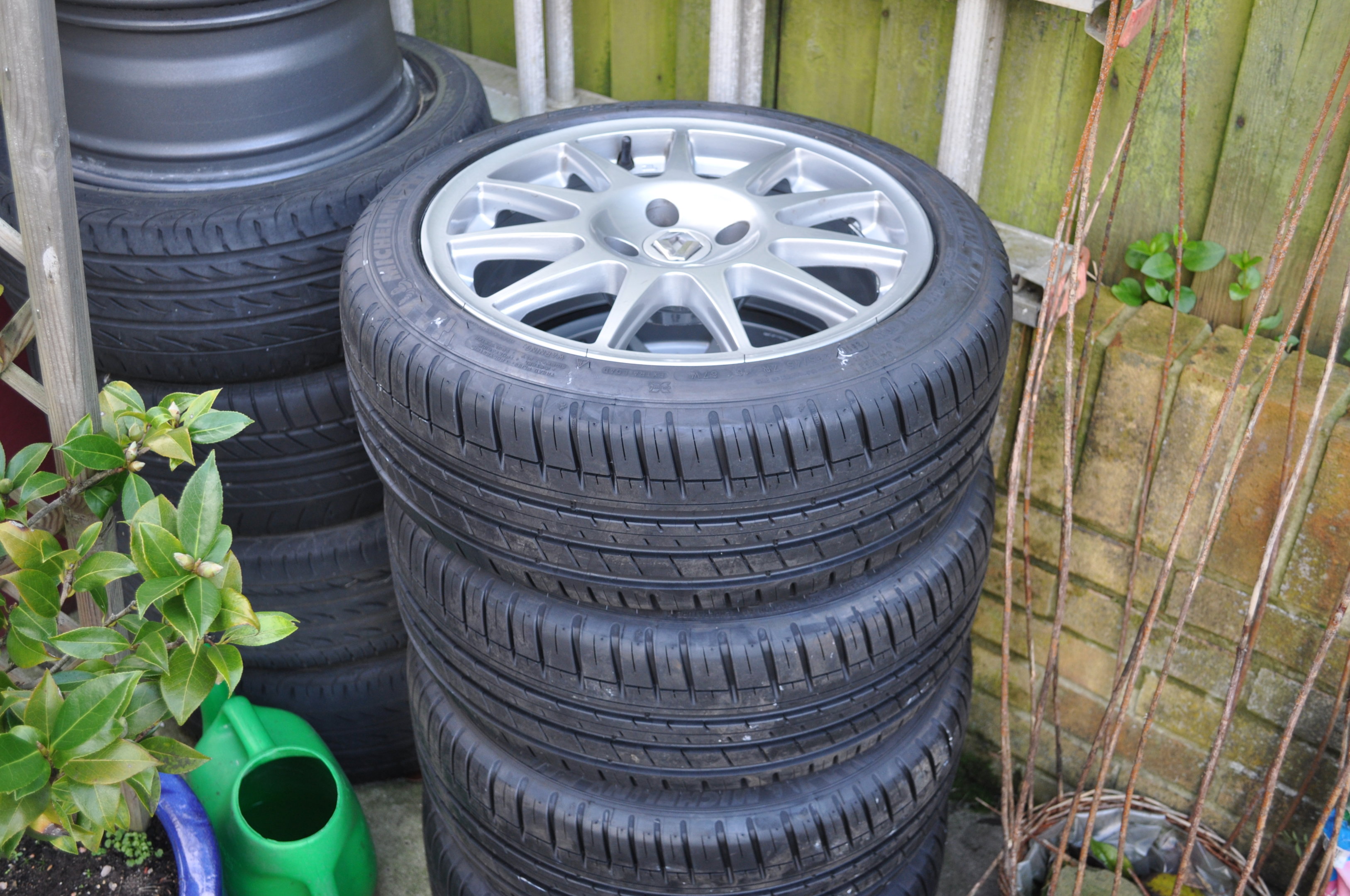

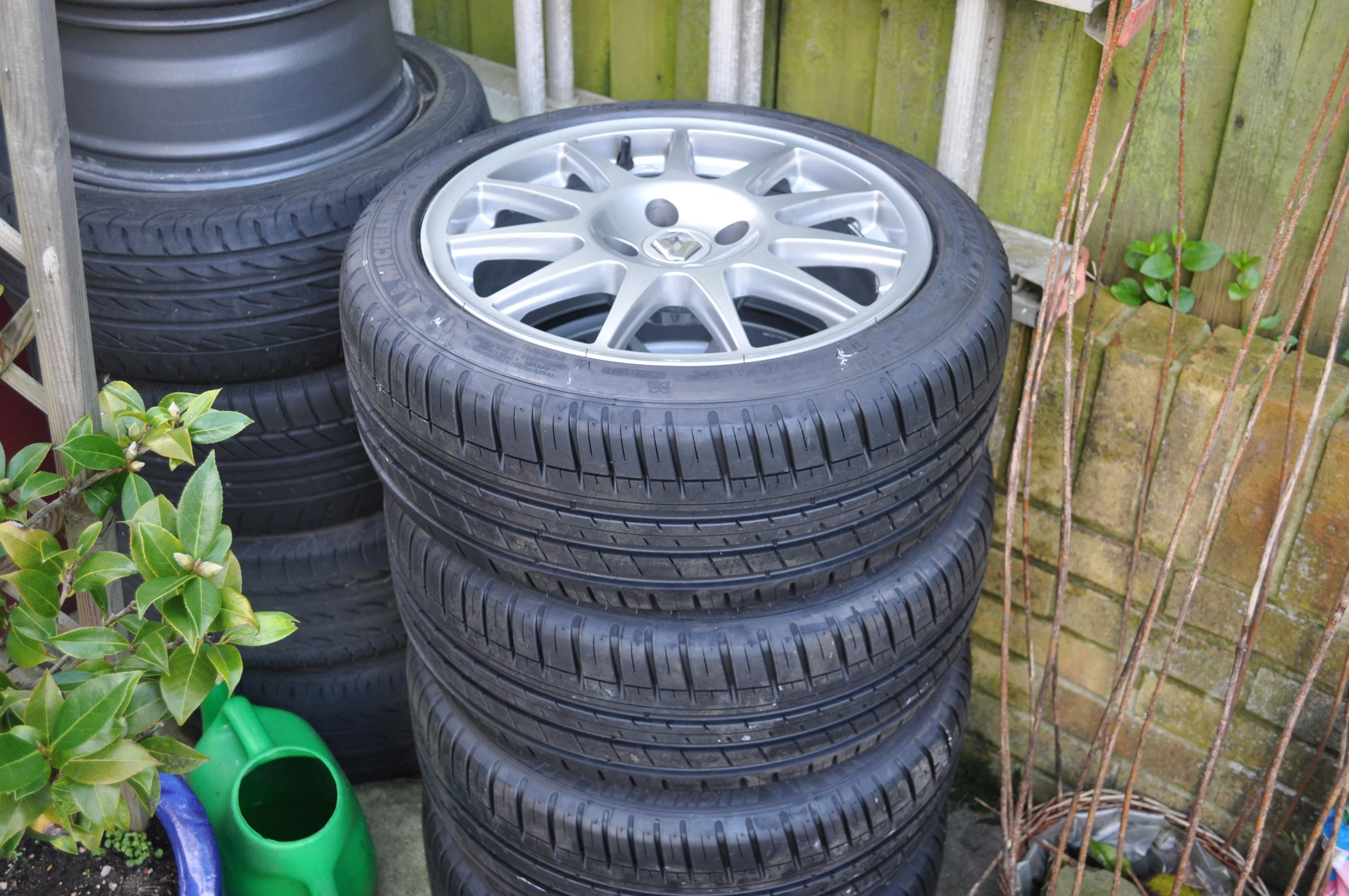

Got a new set of PS3 the other day waiting to go on since the other set got damaged when the ball joint failed. Would of swapped them over already but i lost the locking wheel nut ?

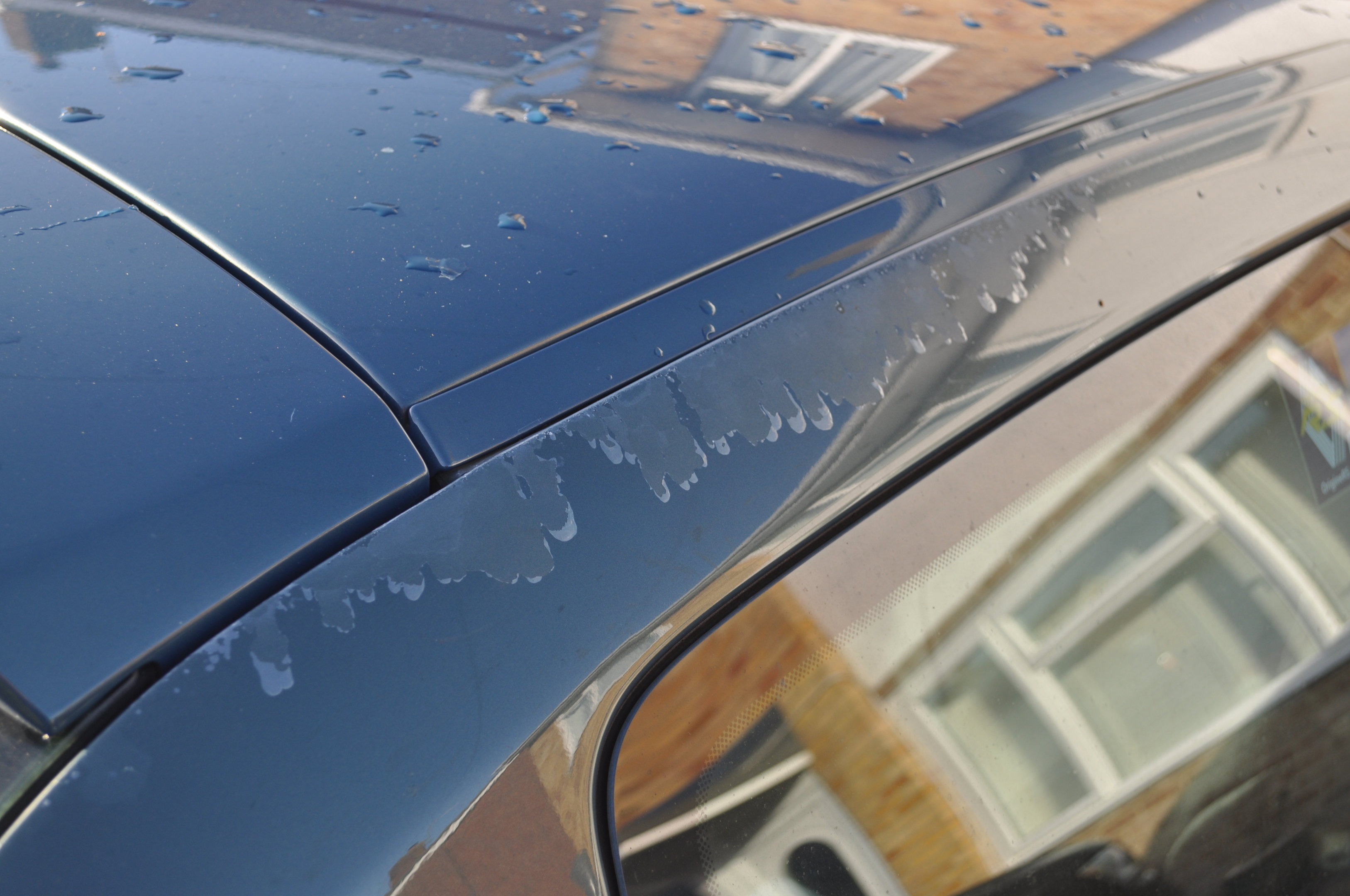

And finally the lacquer peel is getting much much worse ?

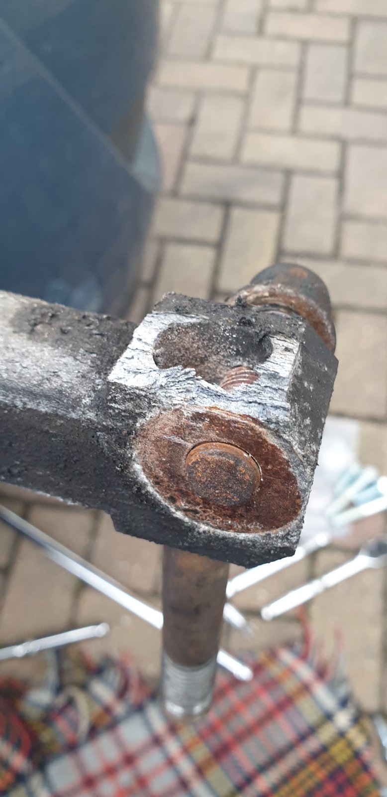

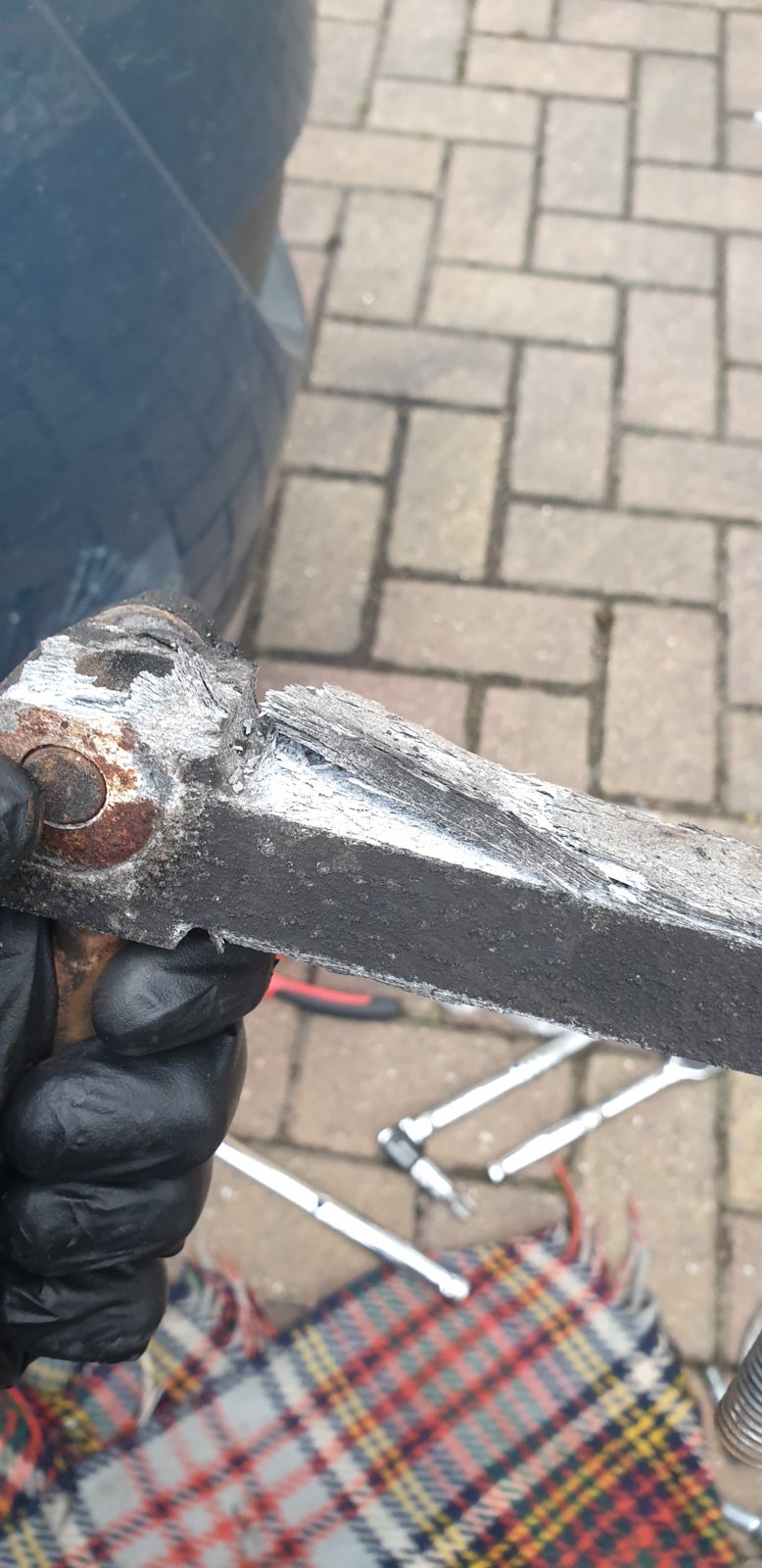

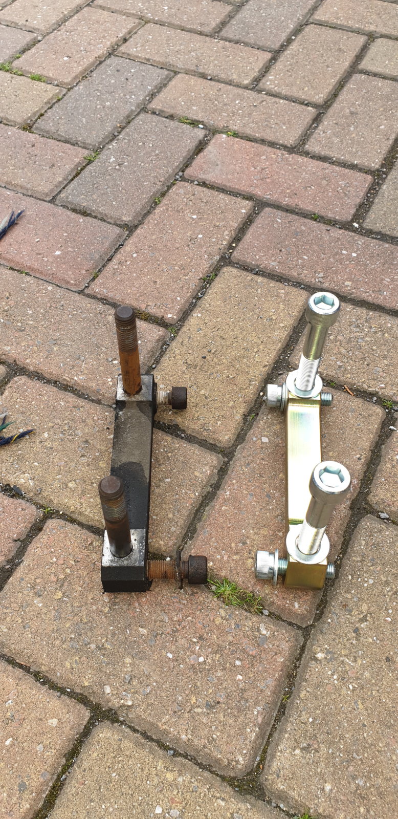

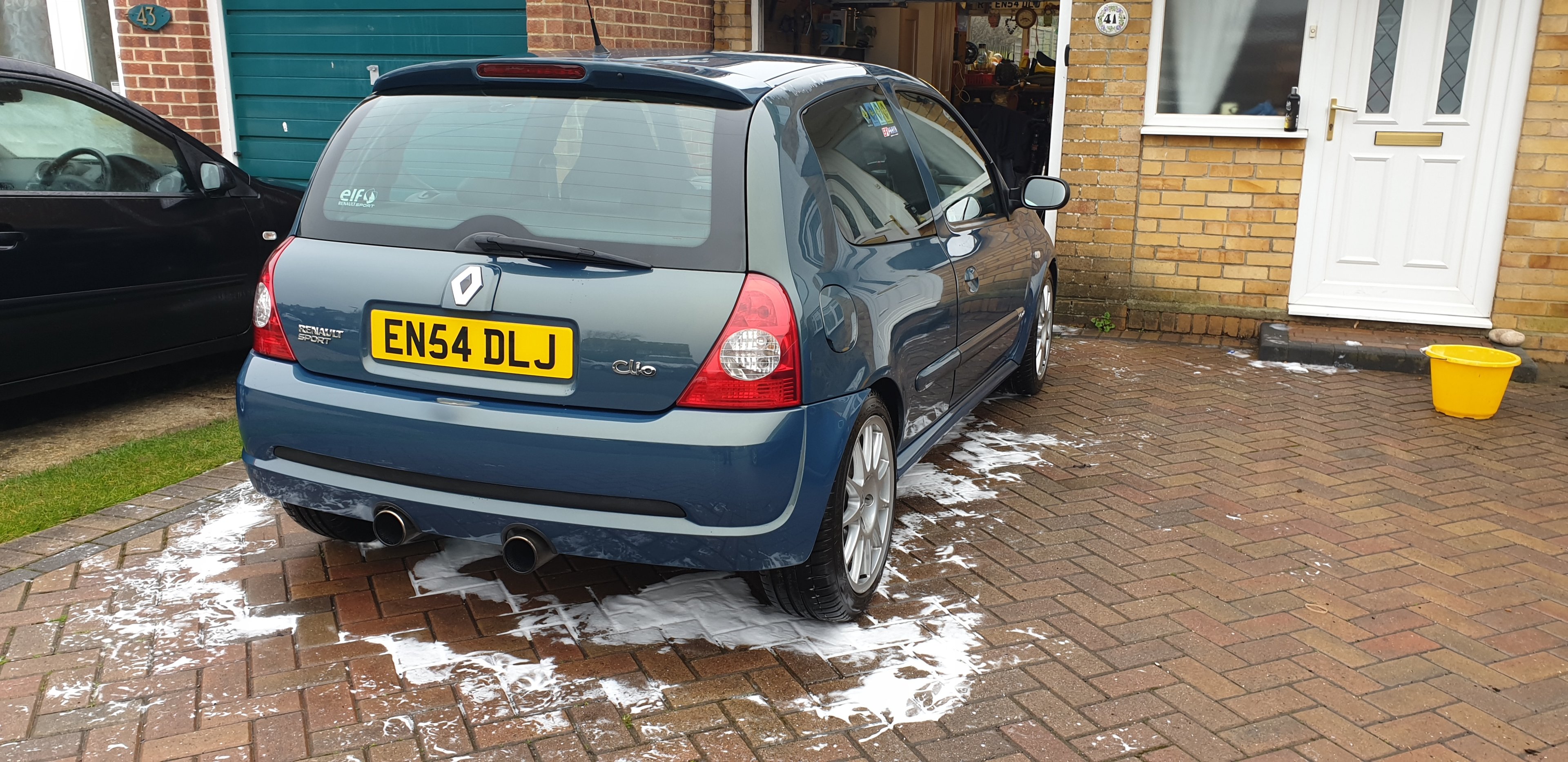

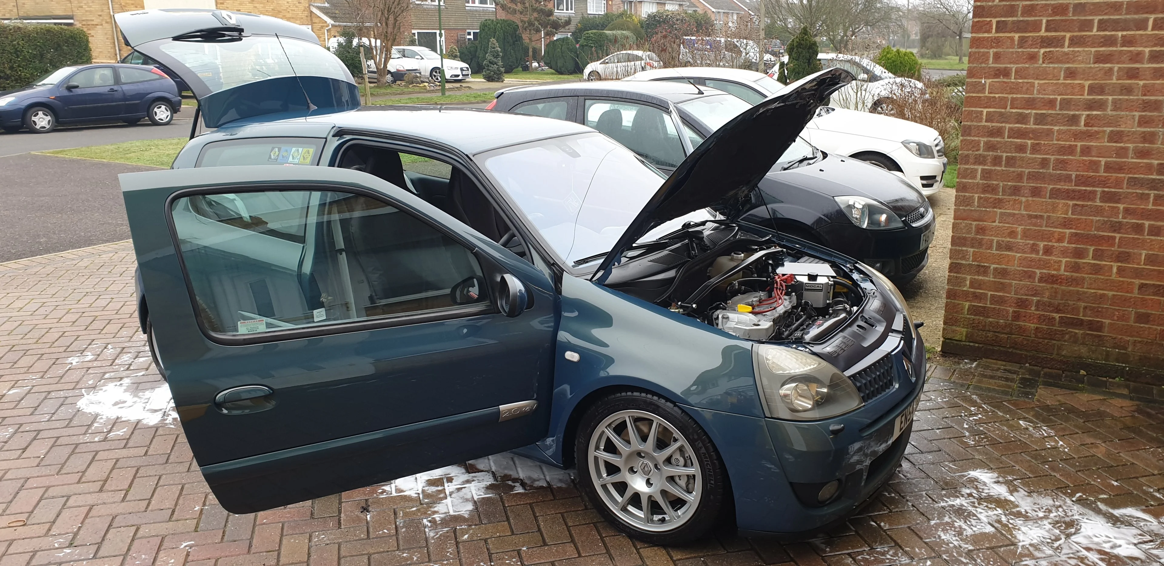

After seeing @Tim. Brembo Brackets fail I jacked the car up and checked mine before giving the PB its first wash in 4 Months !!!! All was fine on the Brackets but come pay day I'm still buying the PMS kit.

Swapped over to the PMS brackets. Found the old ones had badly corroded. When I jacked it up before to look they seemed fine. Once unbolted they crumbled to dust !!! Scary stuff really.

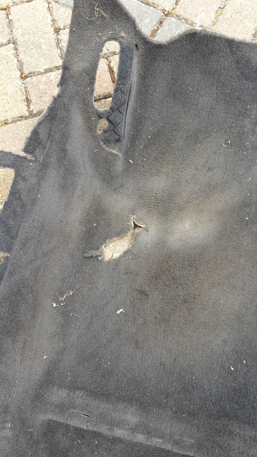

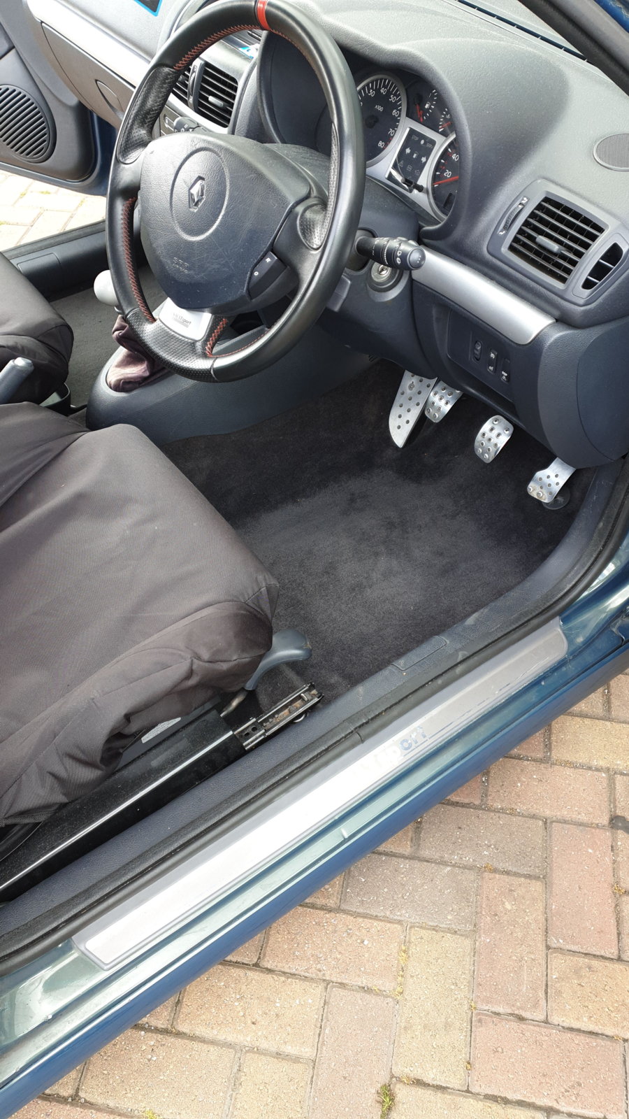

And then today I swapped over the old batterd carpet for a fresher one without any holes ! Quite a simple job really. Also replaced the foam underneath as that had also worn through.

Those caliper brackets don't look good at all! Good job you played it safe and got some new ones. I wonder how many more are out there like that?

All of them I'd imagine!!!
