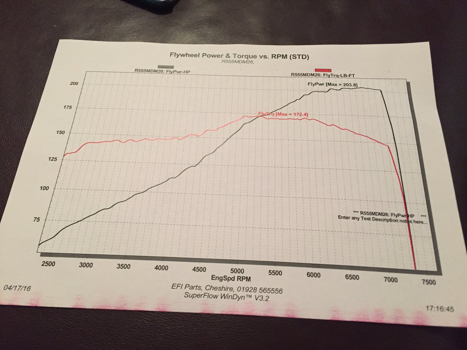

good result!! was saying to chris about the throttle body cough when they are poorly.
got a pic of the graph?
  M135i, 197 turbo
204 and 172 to be precise, sure it was 177... I blame the beer . Chris said the original map wasn't bad just not tailored to the engine / manifold I'm running which is what I expected. Want some cams fitting next and see what we get then
  dan's cast offs.
yeah, can do. sorry i didn't natter much, had a manic couple of weeks and was trying to switch off!!
