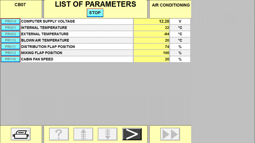

Now the winter is coming I want to get this sorted once and for all.
When I put my climate control on auto the fan speed drops to 1 unless I have set the temp below about 19. The temperature doesn't regulate the air coming out of the unit properly and there is nearly always warm air unless it's on minimum.
I can manually adjust the temperature and the fan speed but would like auto to work properly.
This is what clip is saying.
The temperature on the dash is reading correctly and I know the climate control gets it's feed from the clock display. The display is the AFFA type. Is it possible the external part of the clock has broken?
Your thoughts please
