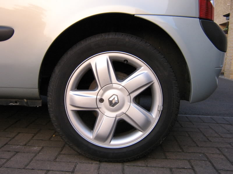

that looks the dogs :)
how difficult to change over the back just to see what it looks like, maybe they're not 60mm or maybe mine wont sit so low, who knows?

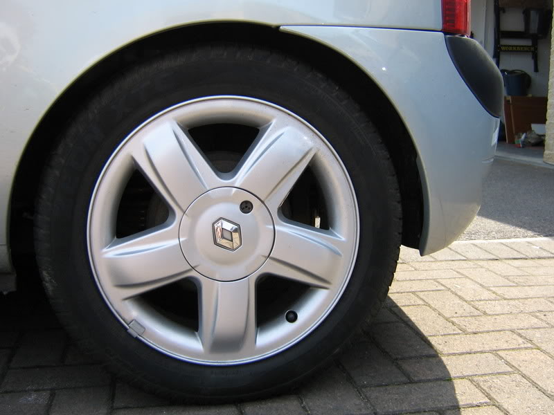

before
  clio 1.2 dynamique
they have quoted me now, £314 extra (on top of £2100) for lowered suspension so fitting the fronts tonight, will post pics when done.
