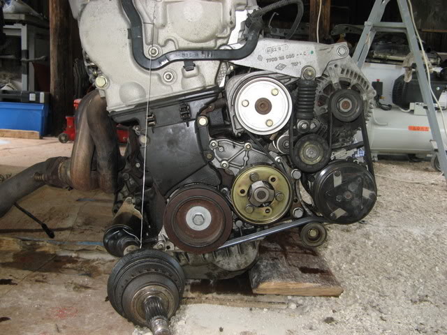

All 172s with air con and every 182 alternator will fit, they're all the 110 amp version
only one that won't is the 172 Cup as that was 75 amp and had different mounting points.
Just make sure you have a jubilee clip for the tensioner. Easy enough to replace. Need to do mine when I get chance too
Pretty easy to see it. Take the drivers side wheel off and you can get good access. If it all goes to s**t take the top engine mount and dogbone off and jack the engine a bit to get more space. This is the route
