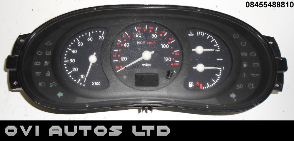

my current clocks panel is :
there is anything to do to fit the 172 clocks ?
