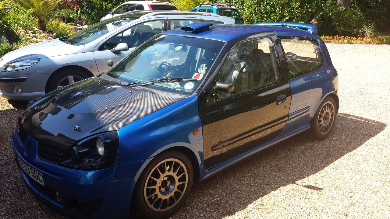

Probably about time to introduce myself to the clio community and update a little on the clio cup track car that was recently purchased for track use.
Purchased a clio cup 172 from Pistonheads in October with this spec:
Stone Automotive RS2 inlet manifold
Blitz 80mm s/steel mesh filter
Solid engine mounts
Oreca Group A exhaust, 182 manifold (heat wrapped)
Crank breather, Silicone hoses throughout
Alloy radiator and fan, Mocal 19 row oil cooler, Magnecor 8.5 leads
KW2 v2 coilovers with Comprace top mounts (3.5 deg-camber)
Koni fully adjustable rear suspension, Whiteline rear ARB (1 deg rear shims)
Fully poly bushed, Front OMP strutbrace
DCi steering rack (no PAS, no ABS, no A/C)
Bremo front and rear discs, Wilwood 4 pot calipers, braided brake lines
Pagid front race pads, Yellow stuff rear pads, Cup Racer brake ducts
Speedline 2118 Cup Racer alloys with 195/50x15 A048's
Short-shift kit

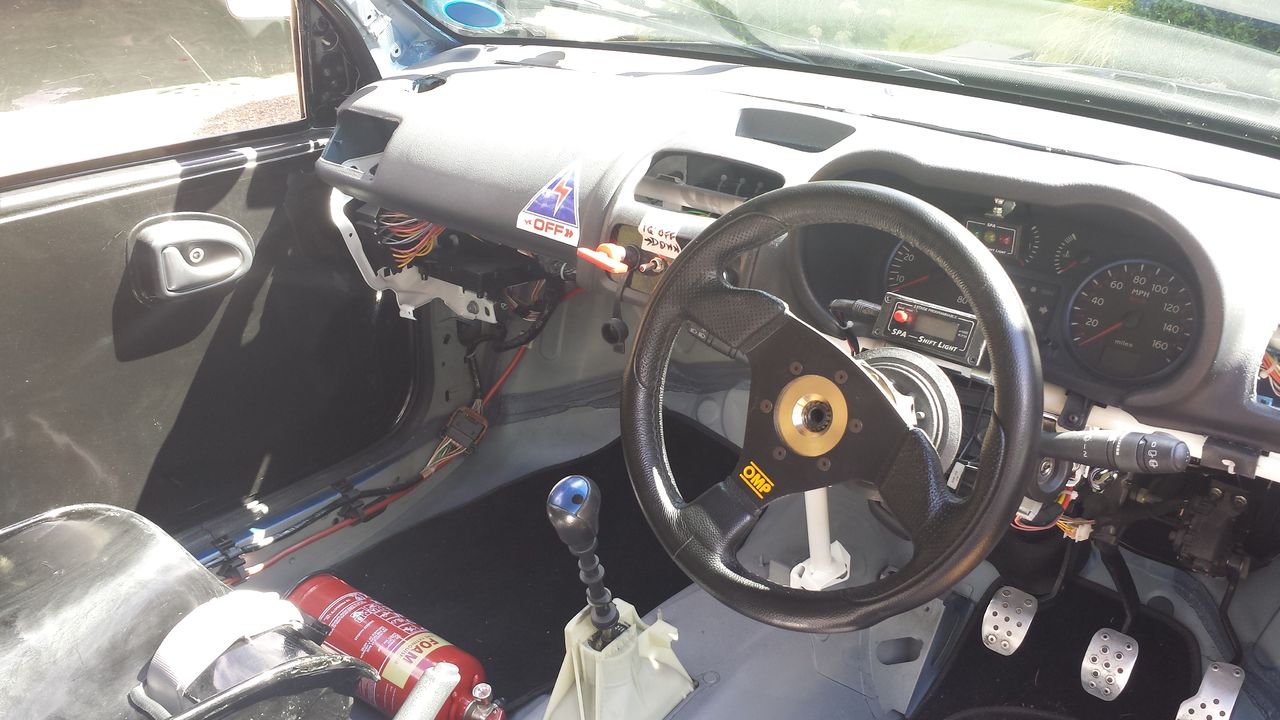

SPA 3 stage shift lights and rev gauge and removable steering wheel
F/glass doors and boot, Lexan windows, composite seats

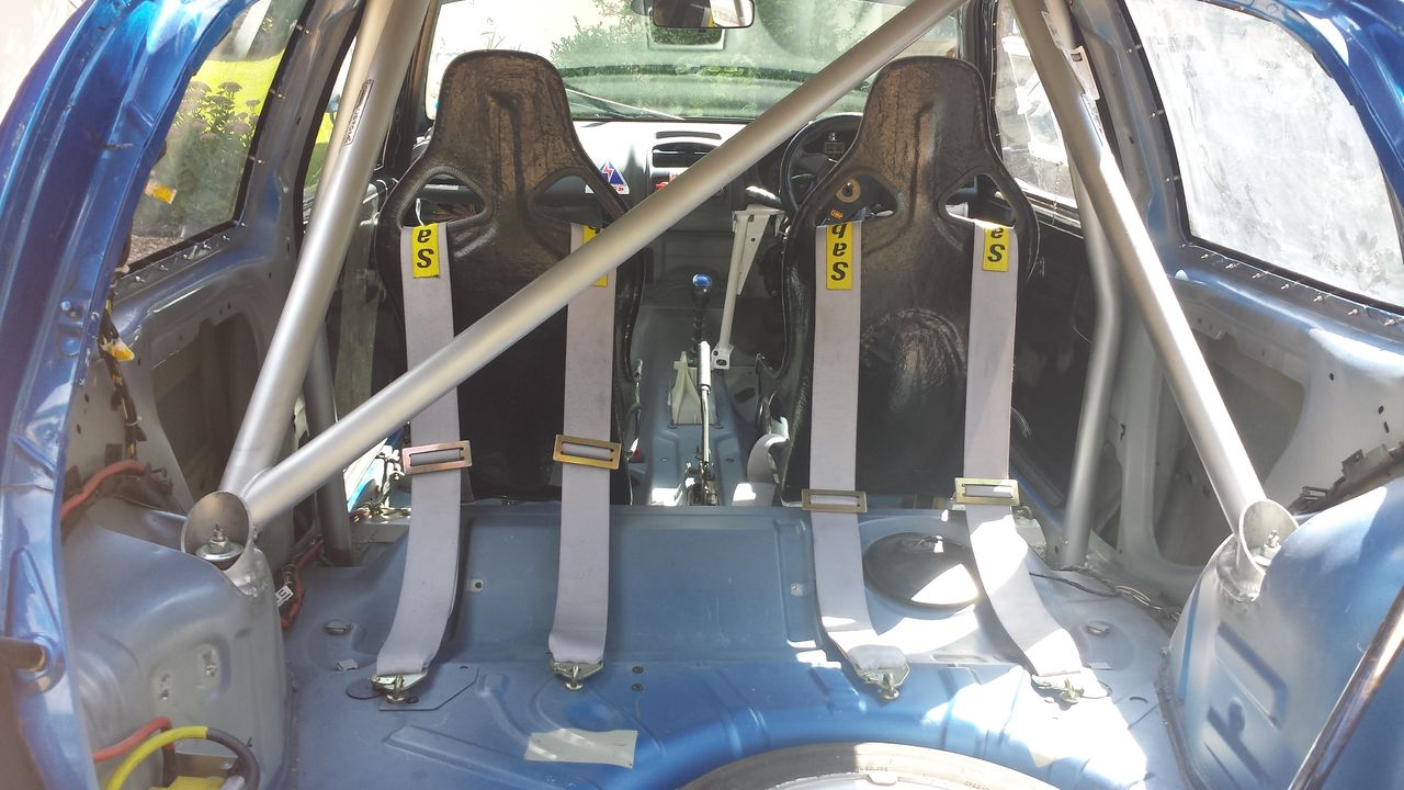

Custom Cages rear rollcage
Cup Racer roof mounted air scoop

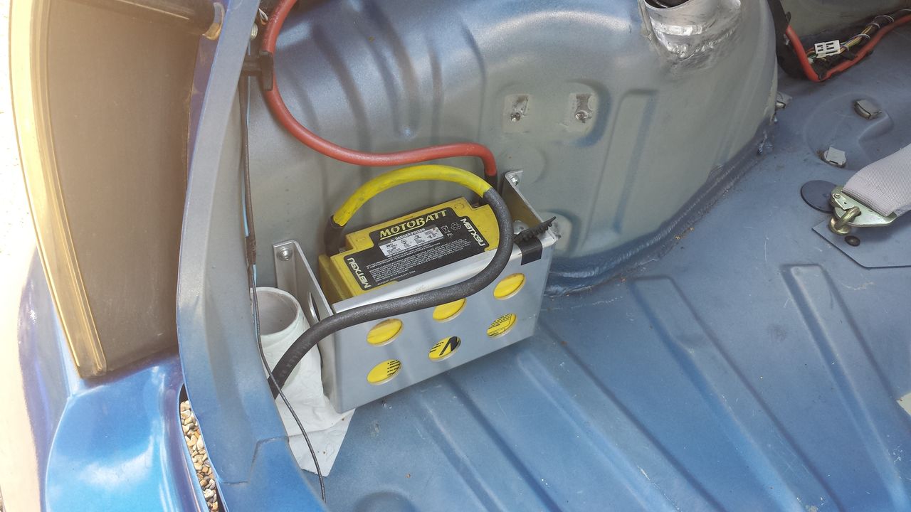

Motorbike battery in boot, master cut-out switch, starter button and ignition switch
Sabelt 5-point harnesses, floor-mounted fire extinguisher, single wiper, carbon GT mirrors, and carbon bonnet, Morette headlamps with direct feed to filter, spare steel wheel/jack

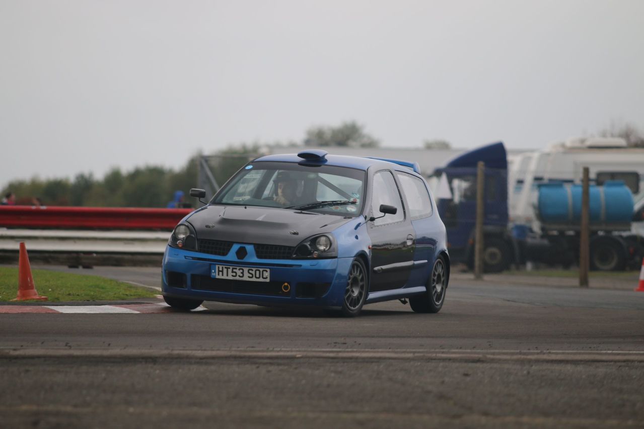

Good points - it was light, engine was eager and went pretty well
Bad points - mirrors were pretty much unusable, wind nearly blew the fibreglass door off and inside wheel was lighting up on some corner exit

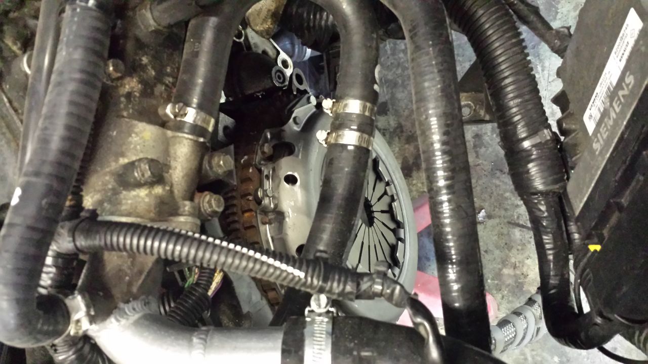

There was a few things to sort out, firstly was the new OEM VALEO clutch as its a track toy so don't need stronger clutch:

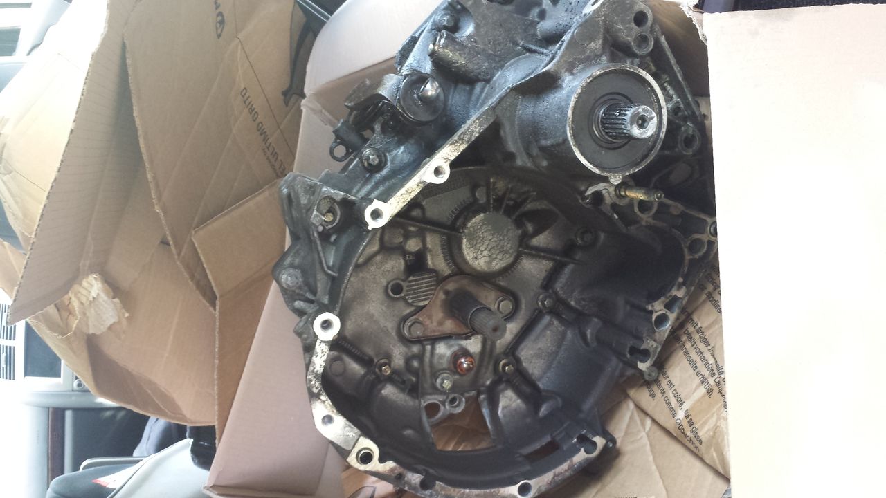

Then it was time to box up the dirty old gearbox and send away to Competition transmission services for a rebuild and Gripper diff:

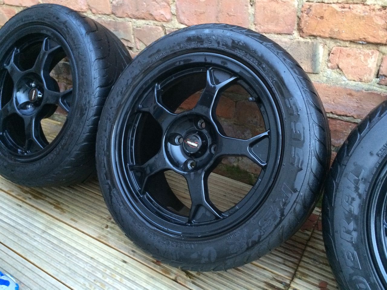

Not fancy going for some super light weight wheels too?
This is like a build thread that I should have started months ago :) Already sorted that bought these pro race 1.2's and put some rainsport3 wet tyres on there but will swap them over next year as didn't realise how much lighter they are than the speedlines

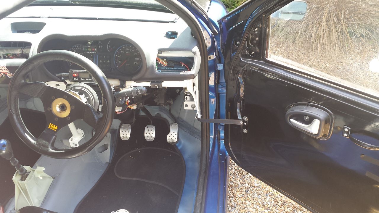

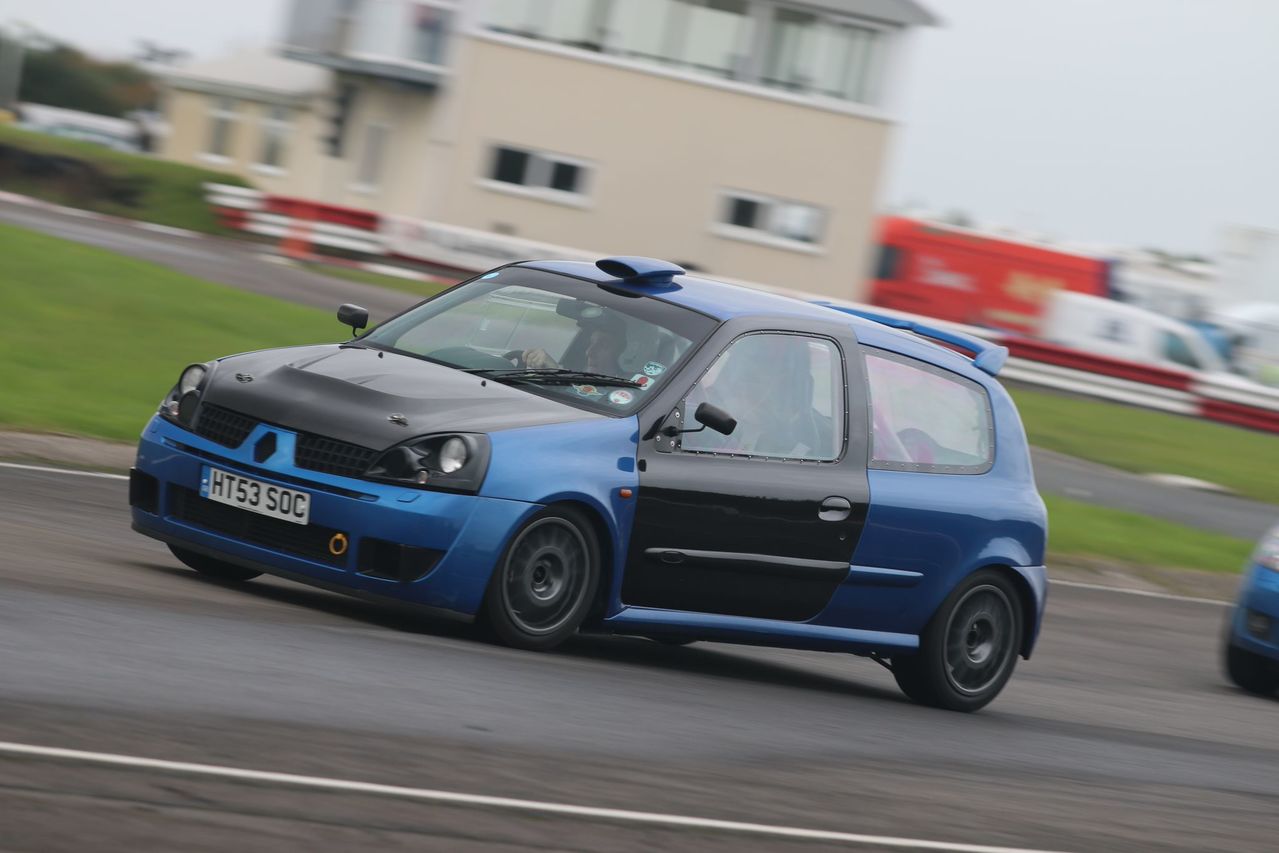

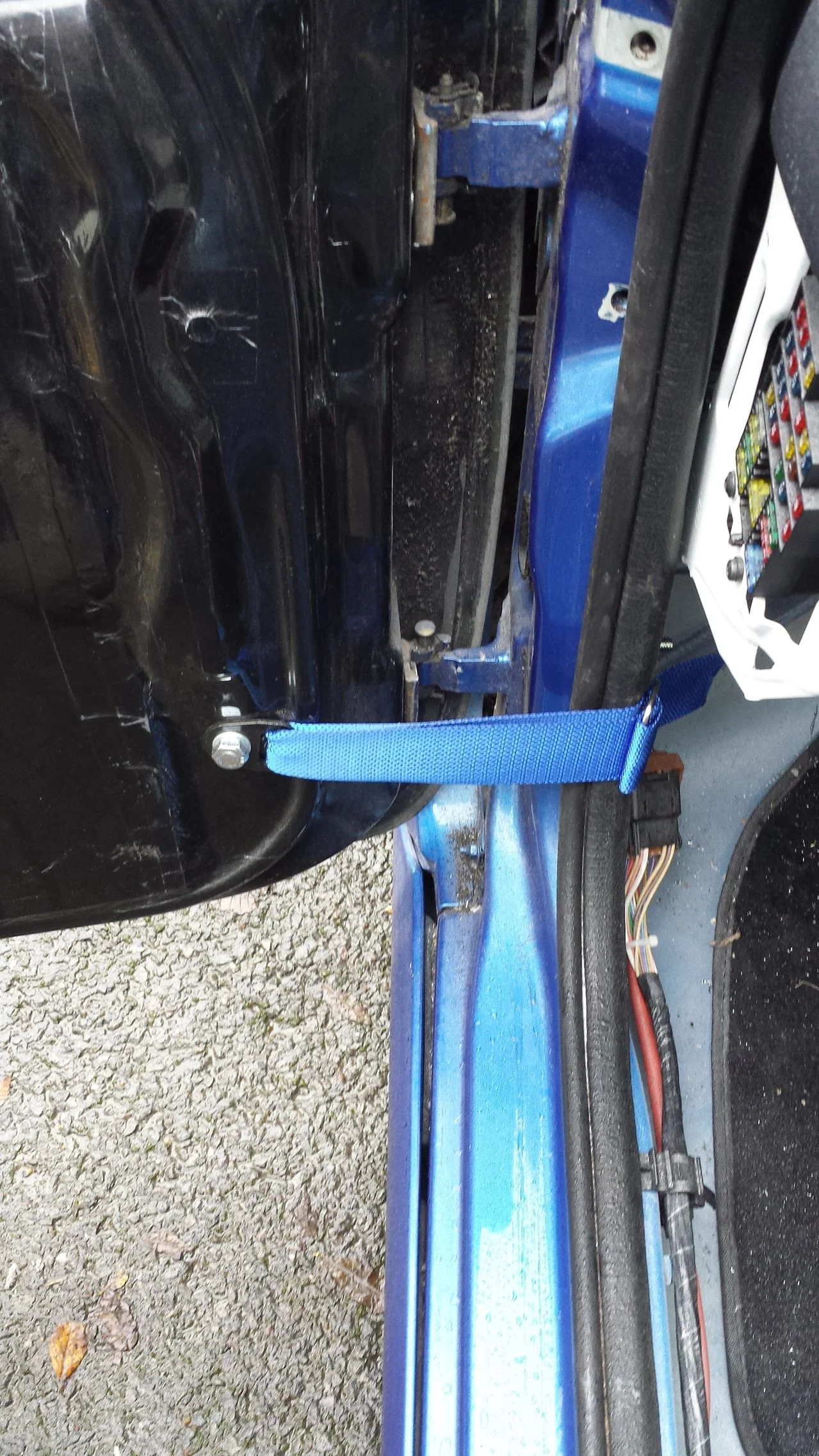

After a gust of wind nearly blowing the doors off at Llandow and ripping the leather strap:
It was time for something a bit more sturdy:
Great car, remember having a mooch around this a few years ago.
I would look into getting a correct harness bar as thats a disaster waiting to happen, even more so as its a track car.
Also (you may have done already) but make sure you put some form of spreader plate behind strap bolt on the door side otherwise it will pull right through the lightweight door.

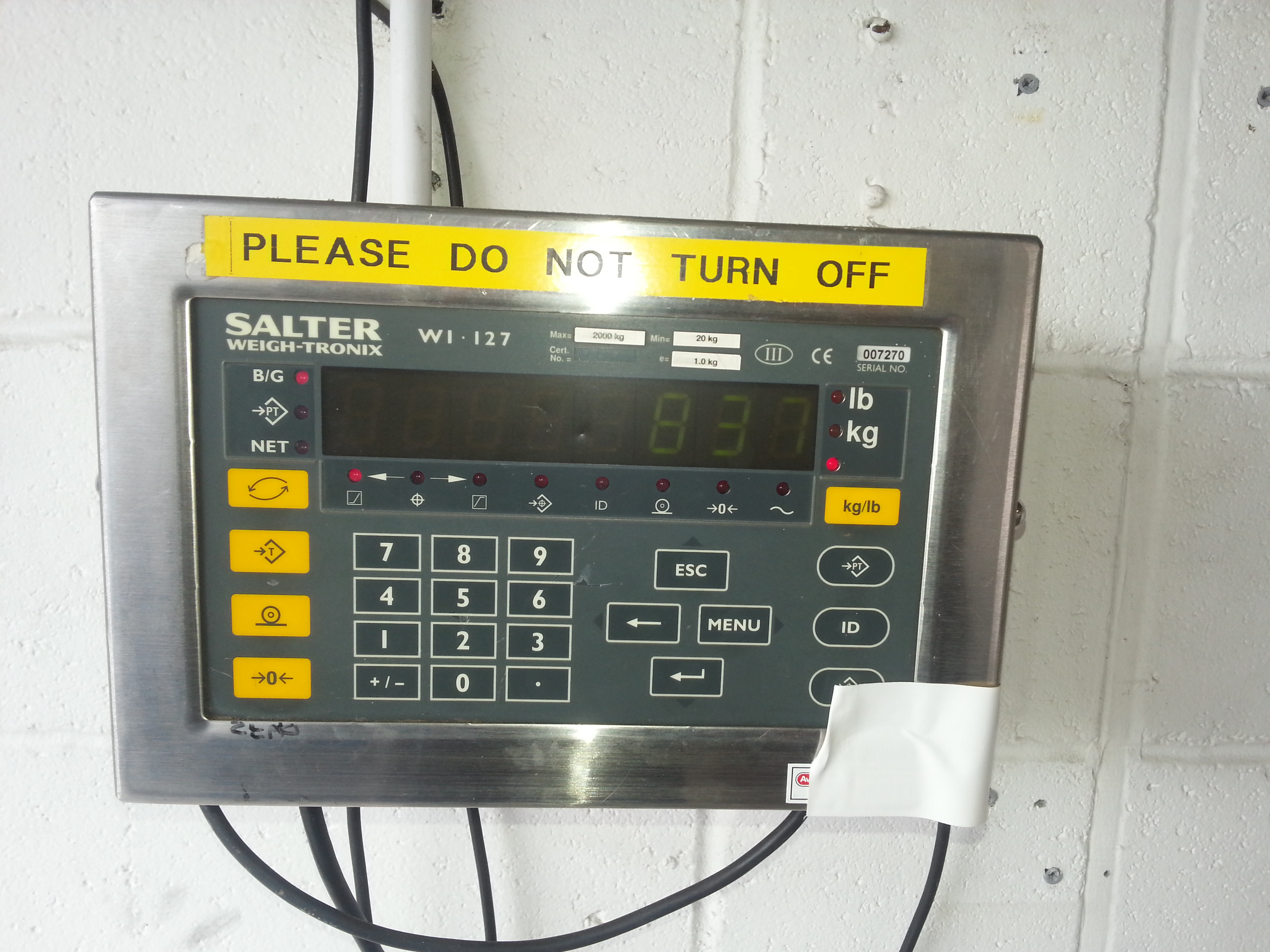

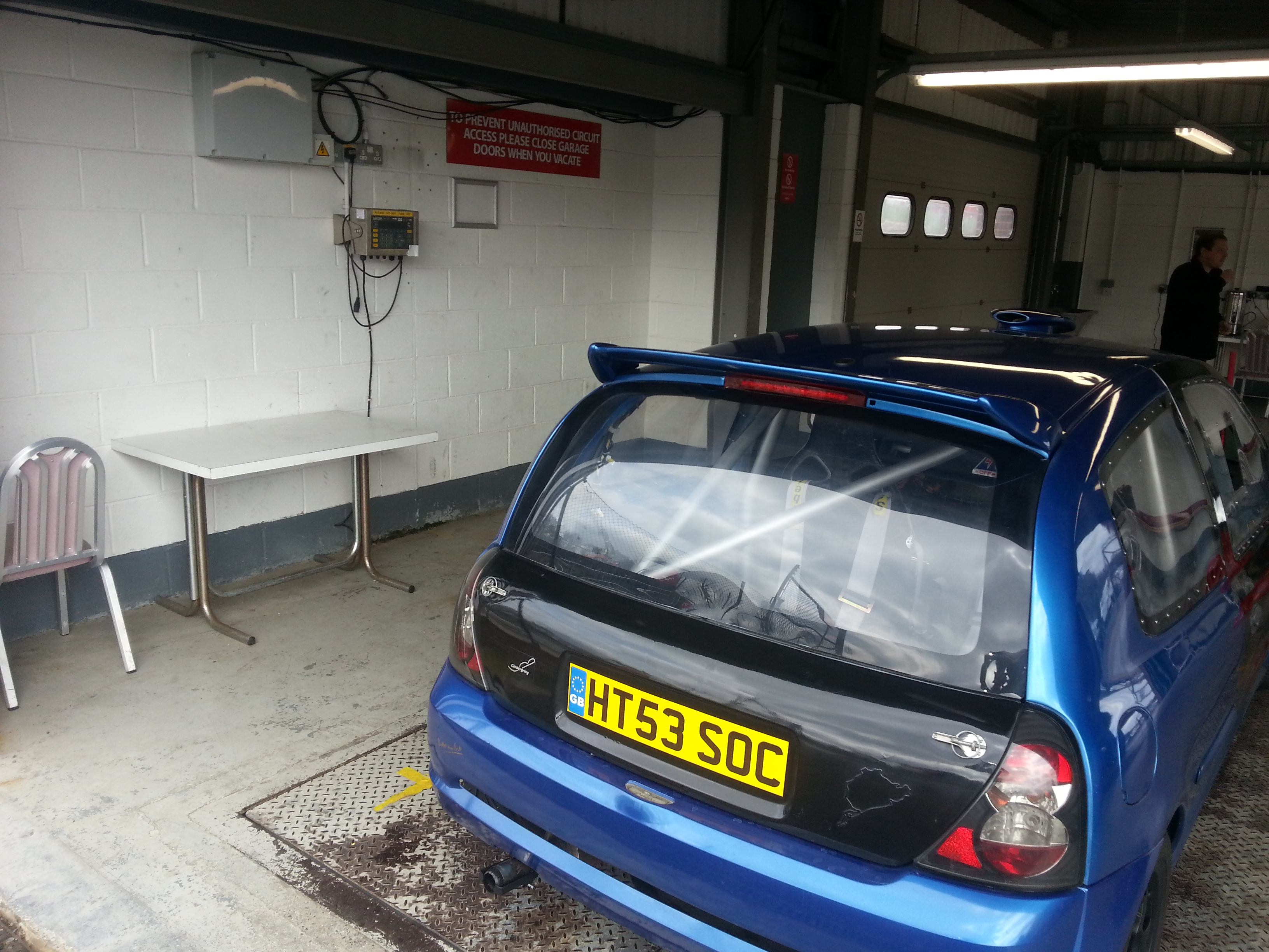

Went to Brands today and used their car scale (I am told these are very accurate):
837kg with half a tank of fuel isn't bad :)

Yes big time, if you roll it and land on the front part of your roof then you may be compressed into your seat, as you have a harness so your stuck upright, Funnily if you don't have a cage a normal seat and seat belt is more safer as you can slip out from the crush. It gets even more scarier if your car lands on top of a crash barrier and knife edges the roof down.
