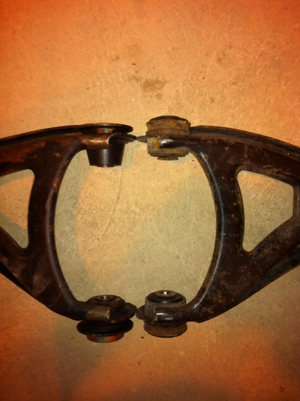

What sort of caster do you get with the wishbones?
Is it done by moving the ball joint, or pickups/bushes or a combination of both?
  Cup In bits
The caster is dine by having offset bushes. The figure I'm not sure on yet but it ain't much more than the cups run.
NorthloopCup
It's the same amount Morgan. I run cup racer wishbones on mine and when measured, it was identical. You could increase the caster more if you fitted cup wishbones with the cup racer uniballs on yours due to the way the cup arms are drilled. It never bothered me enough to do it though as it scrubs the f**k outta the arches already!:lolup:

Interesting that they didn't run any more caster - why offset the bushes, then?
  Cup In bits
Yeah I didn't think it would be much different, its 10mm offset at the bush end but I never measured the ball joint centre.
Its for a stronger wishbone design Mike with the slicks they ran. The side loads will be transferred to the subframe better with the straight drilling and they had that extra plate that bolts on to strengthen around the bolts. That isn't possible with the angle the cup wishbones are drilled.

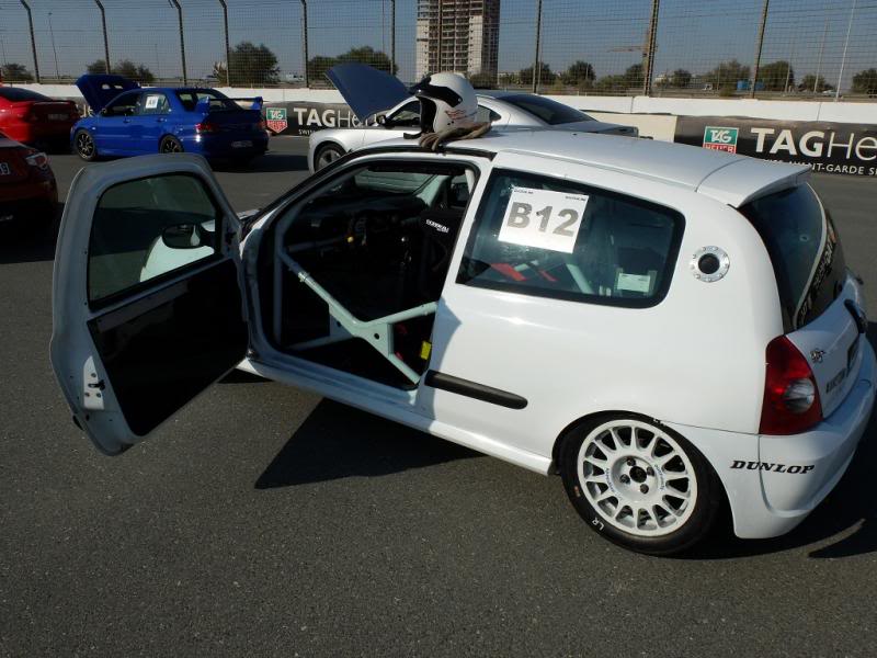

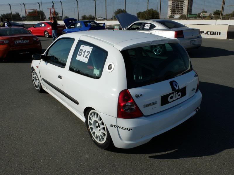

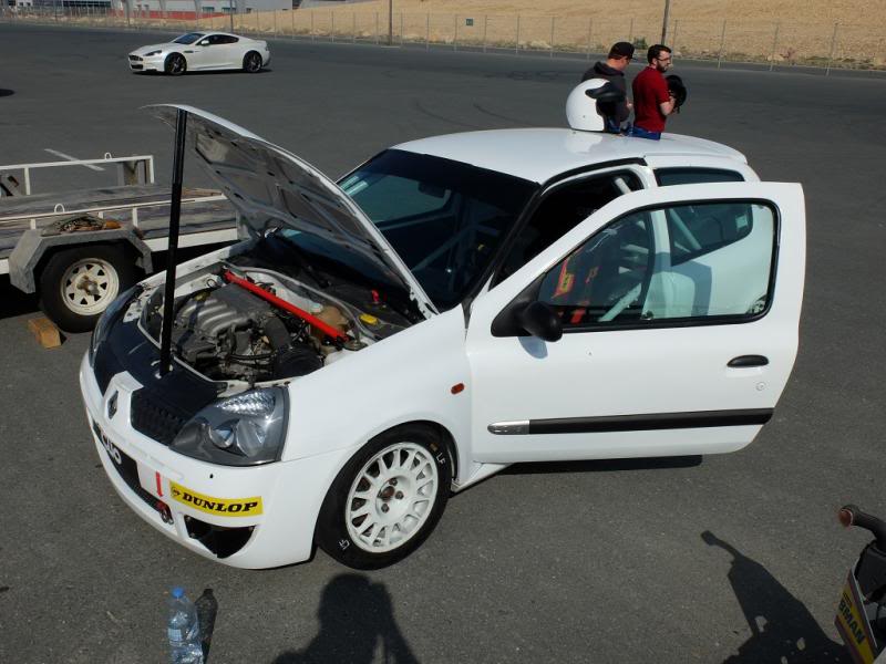

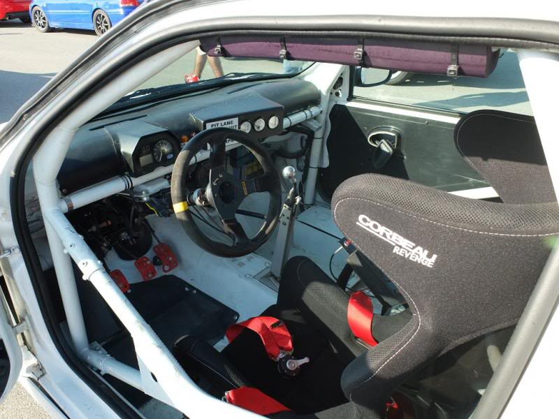

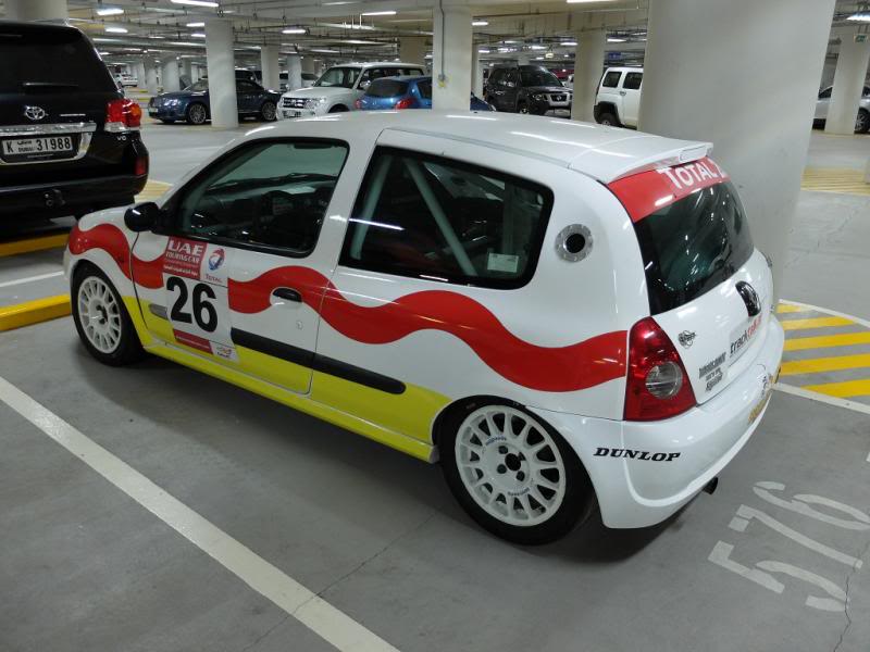

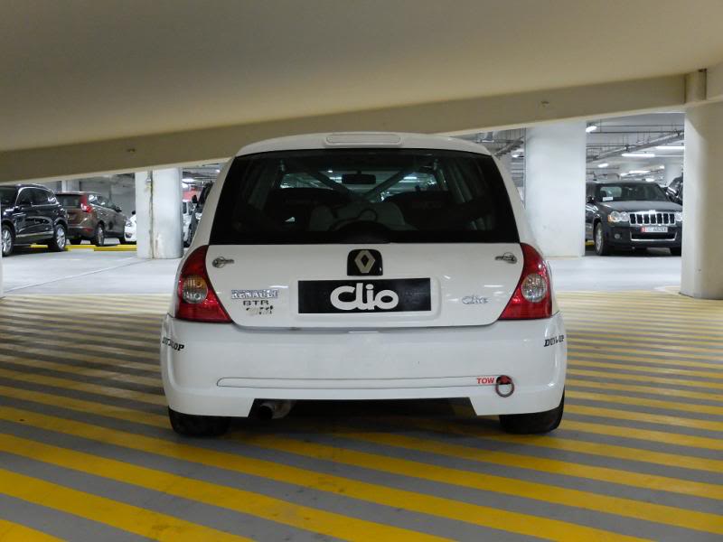

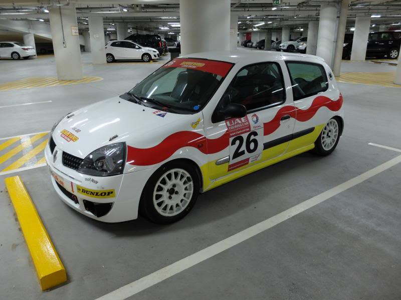

some pics and write up as promised:
the background is that i bought a gts clubman when i arrived in dubai which is a locost based 7 kit which had a 2.0l duratec fitted. i ran this for a season of trackdays [can you imagine, open pitlane with 20cars max, 4hrs for about £120 and 18p a litre of super!]. i then had a fuelling issue which very quickly escalated into a bare chasss rebuild and modification session includign a set of jenveys, carbon intake, lots of customs fab. etc. as you do......
my mate jase has a pukka caterham with a 1.8k series. he's also undetaking a refresh so we needed something to play around with before summer rolls around and it's too hot to play. enter a rather bargainous clio....

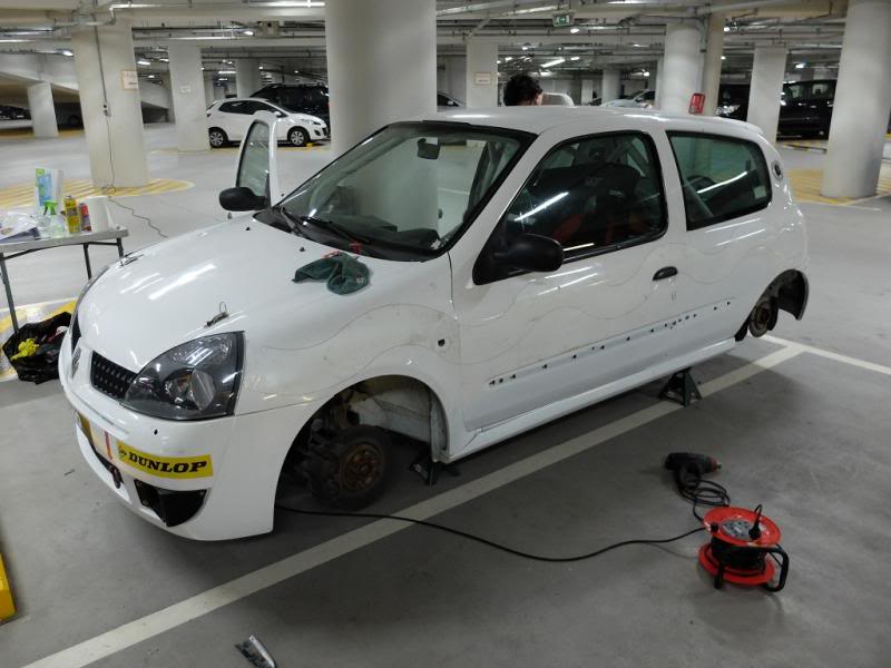

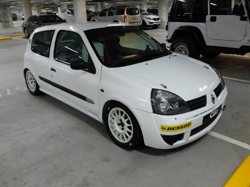

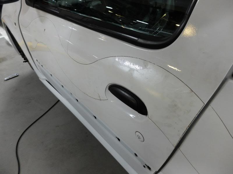

here it is as collected, still in the BTR colours:
we have not dug that far back as yet but given the chassis no. [017] we believe it may have been an original french clio cup car. it was campaigned by boulevard team racing for several seasons of the british clio cup before it was rebuilt for endurance racing in the britcar series. hence it has several useful upgrades over the standard cup including beefier brakes and shocks and a long range fuel tank.
prior to being shipped to dubai the car was refreshed again, including an engine build by BTCC/F3/DTM champion builders Neil Brown Engineering. the sadev sequential gearbox was also rebuilt and both have since only been used for a single round of the UAETCC series where it won the double header. again it was this provenance that made us realise the value of the deal on offer.

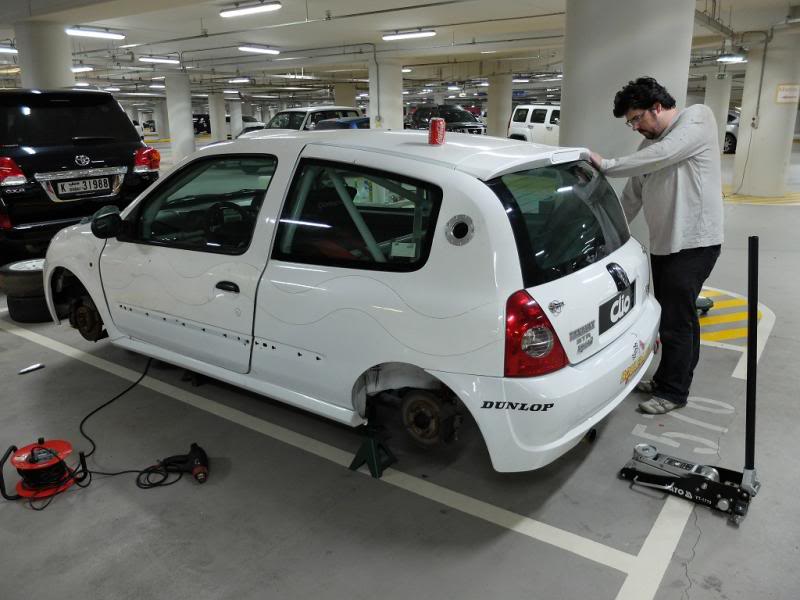

anyway, although it had been serviced and prepped by a decent local outfit we had been doing a fair bit of research on here and nosiness got the better of us. hence it was up on the jack stands and wheels off for a good look around. we also wanted to get rid of the red sperm stripe and make it ours.
the amount of old glue on there was horrendous.
however, a little elbow grease [and 6 cans of brake cleaner] later it was back on it's wheels and looking nice and shiny after a run over with some autoglym and a rotary polisher. i think a polished car is good for at least 10mph on the top end :p
after being filled with fuel it was tucked up in bed at 1am friday morning.....

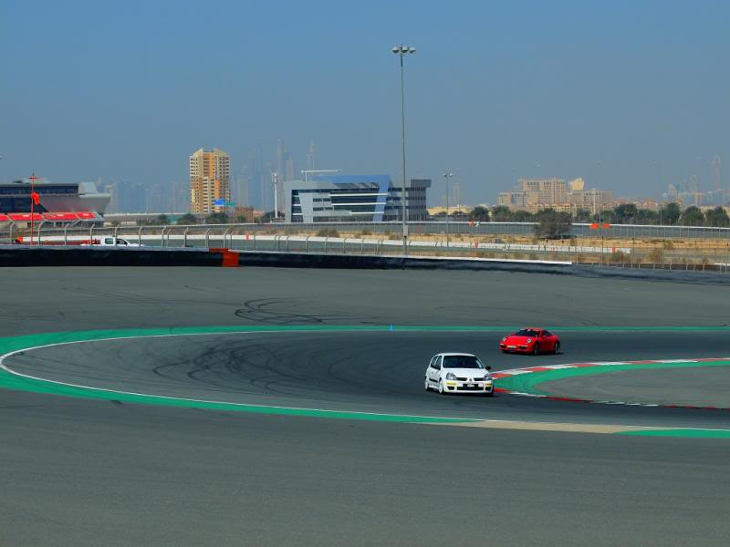

6.5hrs later [yaaaaaawn!] and the flatbed came to take us for a shakedown on the dubai autodrome international circuit.
we had a few small problems [coolant hose came off and the clutch cable detent nut vibrated loose] but it was great fun off the bat and shows great promise. the dry break refuelling was fun as a party piece but took ages to fill the churns......

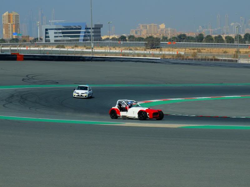

my mate nev had his gts out which is putting out about 190bhp and weighs about 550kg, and another friend dave had his 230bhp 6speed westfield. i would have a hard time keeping up with either of them in matched cars but found it a doddle to do so in the clio despite the weight penalty and 2yr old slicks. although this circuit layout doesn't favour the caterfield's brick like aero i reckon i could have braked later into some corners and corner speeds were pretty similar. the real tester will come in a couple of weeks on the club circuit which favours the lightweight low inertia cars.
jase having fun in the bowl:

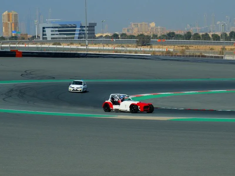

abd creeping up on nev:
biggest drama of the day was seeing nev and dave come round twice with no sign of jase. fortunately the cause was a stop off the circuit to close the passenger door which had been left off the latch by a spectator.
soooo...... we packed up for the day and went to see the rolling stones at yas marina. jase was working saturday but my desire to be on track was too strong to leave the car undriven so i headed back to the autodrome to compete in my first ever autocross.
the clio really showed it's potential here. 2nd fastest on the day against a field of m3's, caymans, tuned evos and subarus etc. i was only beaten by a very well driven brand new pdk cayman s and reckon i could have had him with more practice. granted i was slick shod but cold 2yr old slicks are no advantage imo as there was bugger all feel hard under braking and the dust on track made it very slippery. it really was the chassis setup that allowed it to be such a weapon. just need a spare set of wheels to put my 888's onto next time!
all in all a great purchase for us.
