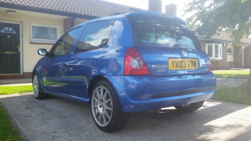

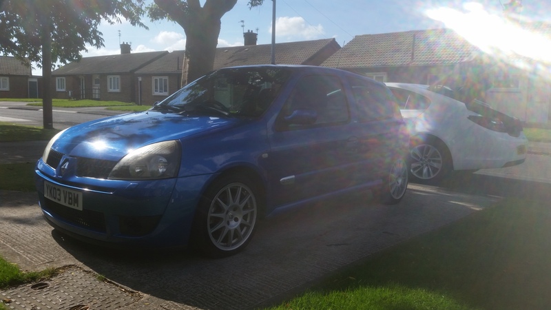

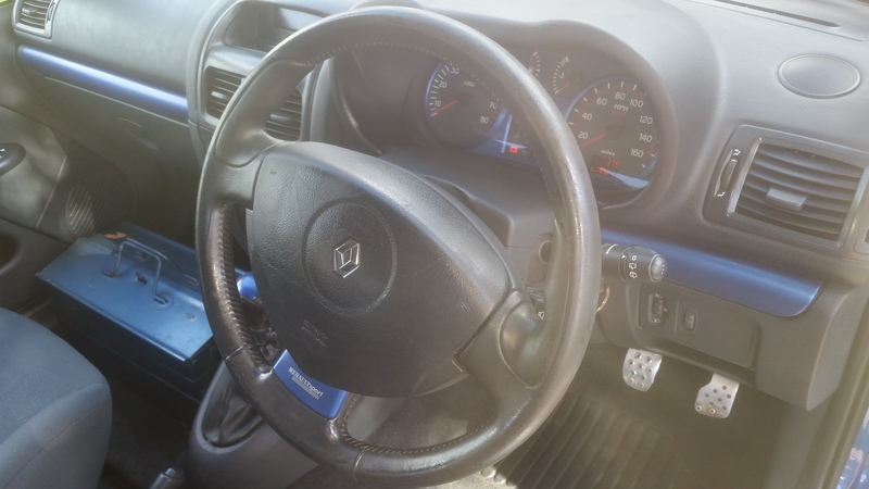

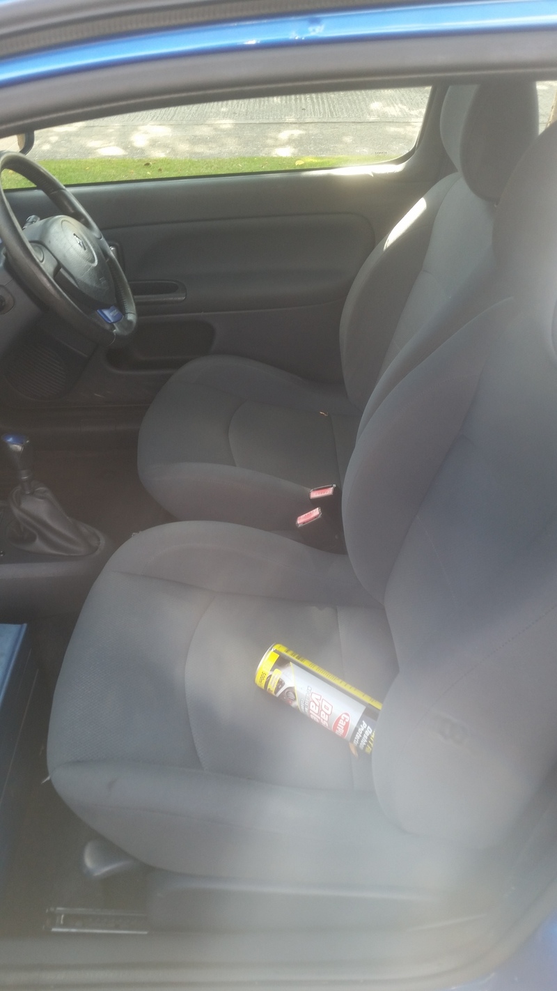

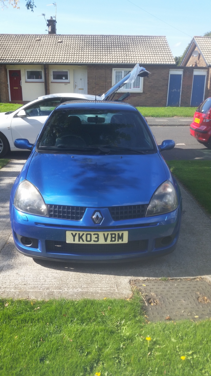

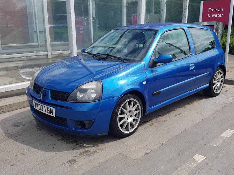

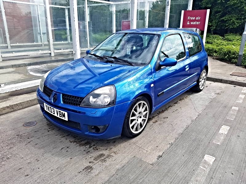

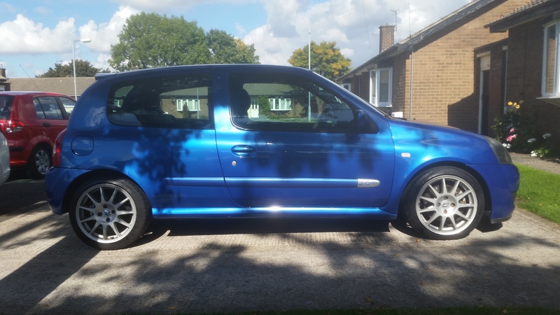

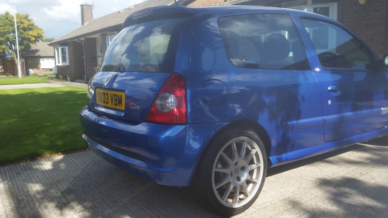

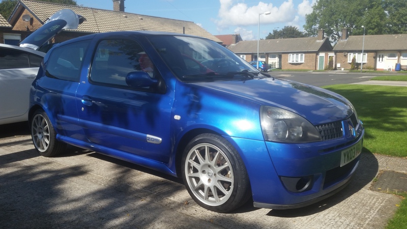

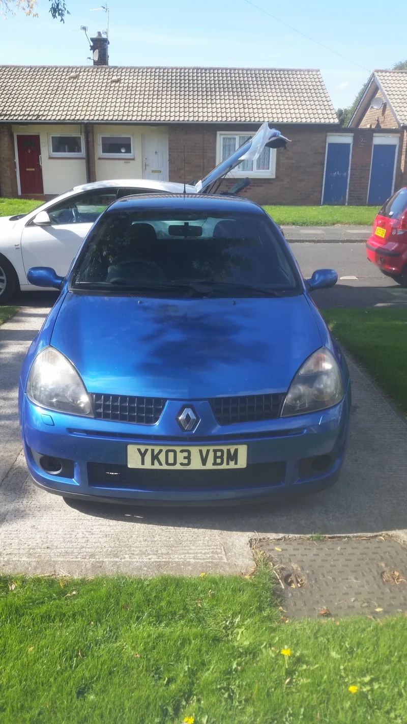

So anyway, here's some pictures of how she stands today
Plans are to change 2 front tyres, a headlight bulb, high level brakelight isn't working, belts need done and she's desperate for a good polish. Clioturbo know the car from the past and will likely be entrusted to do the major mechanical work she needs. Otherwise the gearbox catches slightly between 3rd and 4th when hot but only slightly.
Comments and suggestions welcome :)

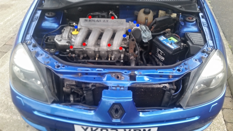

to take the injector cover off I easy. 2 recessed 10mm bolts are all the hold it on. Go steady as they're prone to shearing off. The inlet manifold is pretty straight forward. Unplug the electrical connectors for the coil pack, and 1 each side of the plenum chamber. 4 10 mm bolts for the coils pack, just pop it out of the way no need to take ht leads off. Throttle body or whatever it's called of with a few 10mm bolts I think. Then iirc its 4 or 6 10mm bolts holding the manifold on. Go steady as there is a small gasket at the front which is reusable if you don't break it removing it. That's it I think. Takes about 10 mins to whip all off. Good luck. Oh one other thing, I had pops and bangs and after 3 weeks it'll probably annoy the hell out of you!!!

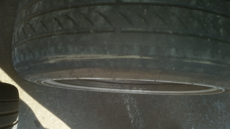

The car does seem to have a "hum" at between 40mph and 60mph but only seems to be there slowing down. Thinking more something to do with the exhaust rather than a bearing tbh especially when the car had new rear discs/pads in May apparently. Only other issues are lack of high level brake light and temperamental n/s headlight bulb that keeps not working unless wiggled. Averaged 38.1mpg on a run up A19 to Silverlink and back with some "enthusiastic" driving added in.
Couldn't find this thread so been a while since the last update.
Hum is defo a low tread tyre so happy with that until the tyre is replaced. Average mpg since purchase is 33.3mpg so pretty happy with that.

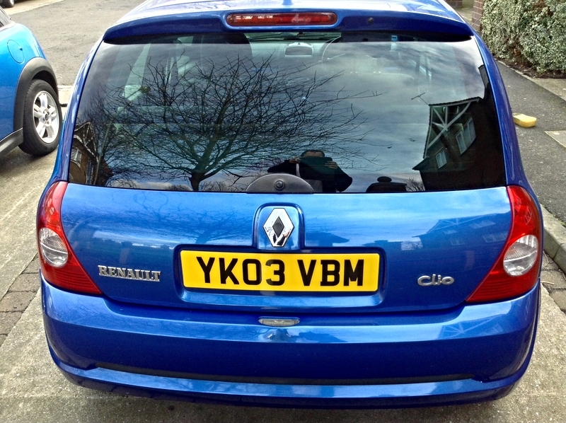

So, I had a fuel tank seal issue, sorted the high lvel brake light, had belts and dephaser done by @Andyrg@ ClioTurbo (top man!) and had a rear spring snap so rear is back on standards for now until I source a pair of -40mm springs.

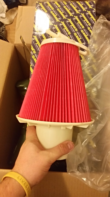

I've also had a play with a huge new filter as a trial which I removed as it made little difference tbh. Only cost me £13 from Eurocarparts and is meant for a Honda S2000

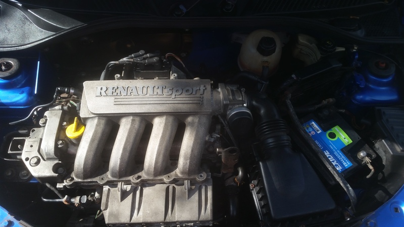

Now I just need the upper inlet manifold off to paint. Is it a case of removing the bolts in red in the pic and removing the plugs and sensors in blue then pull?

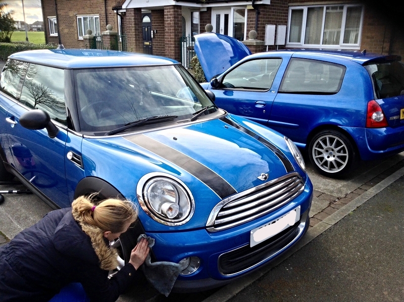

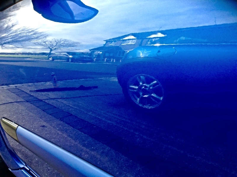

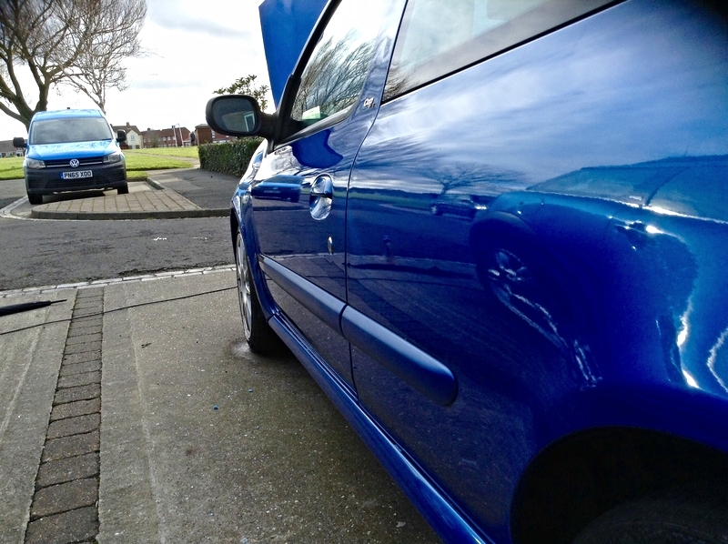

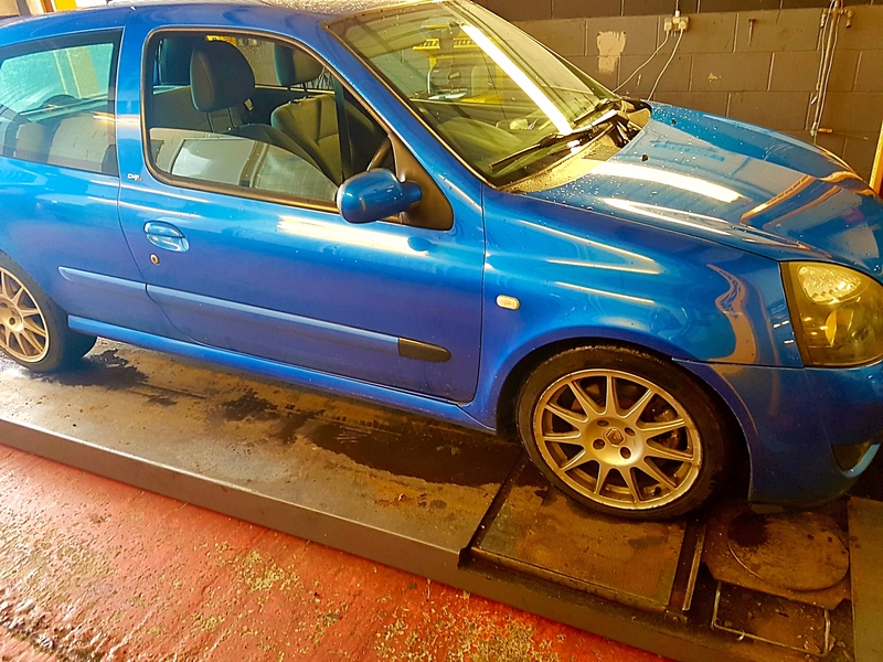

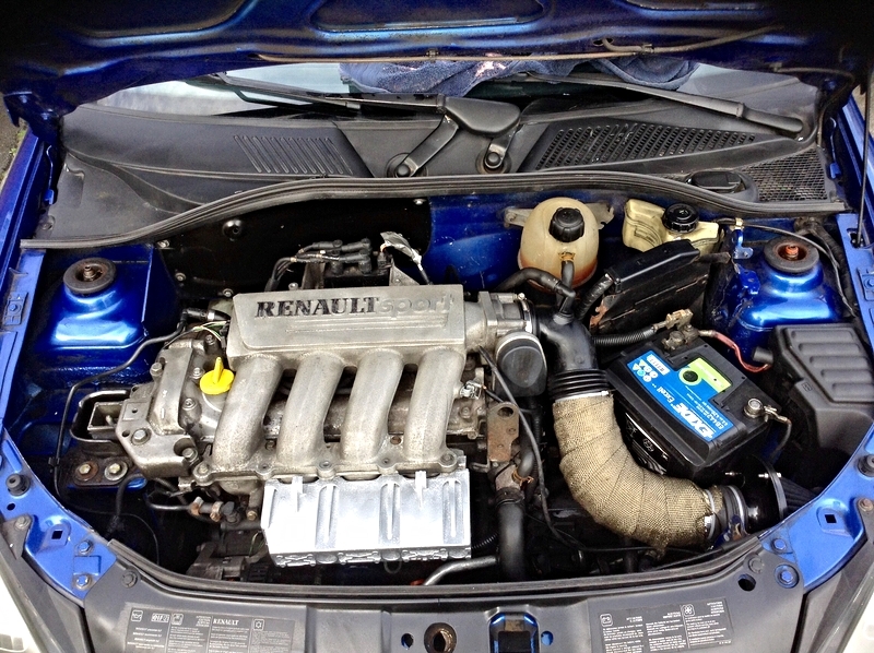

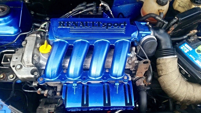

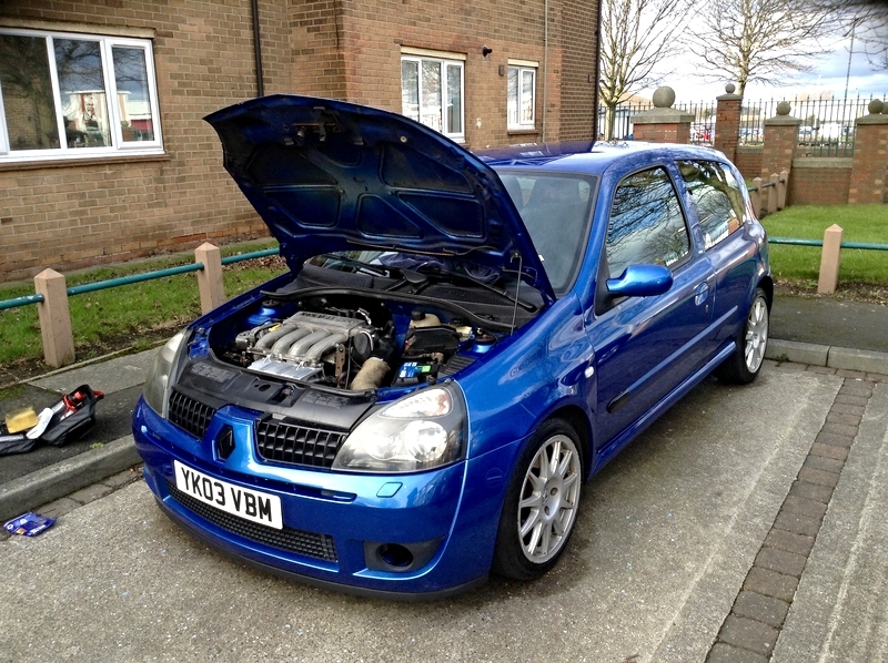

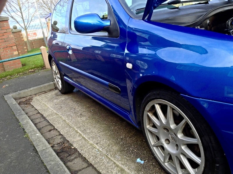

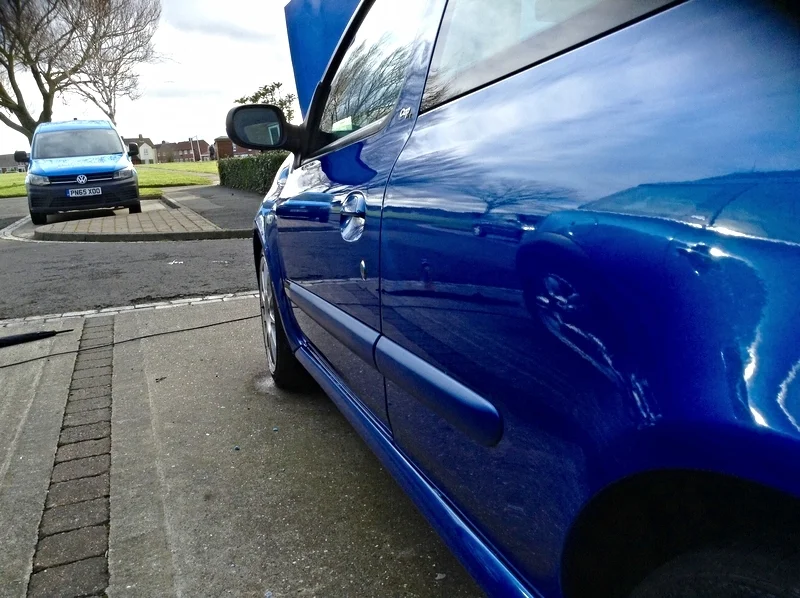

As this is my week off, I wanted to do something about the engine cover as it's seen better days.
But the missus started cleaning and polishing her car, so I decided to do the same first.
After a wash, dry and hoover I used Poorboys Nattys paste wax (nice bubblegum smell)
And finally got the inlet manifold and injector cover done to tidy them up. It has some orange peel effect on it, but overall I think it looks better than it did. It'll do for now.
I still need a silicone throttle body elbow and better intake elbow but undecided on what I want and as we're redecorating and planning a wedding, it's not a priority.

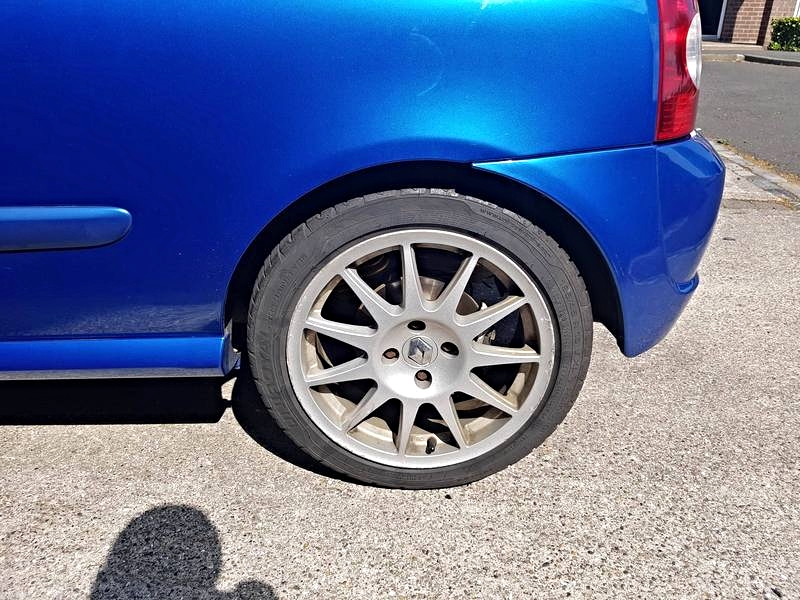

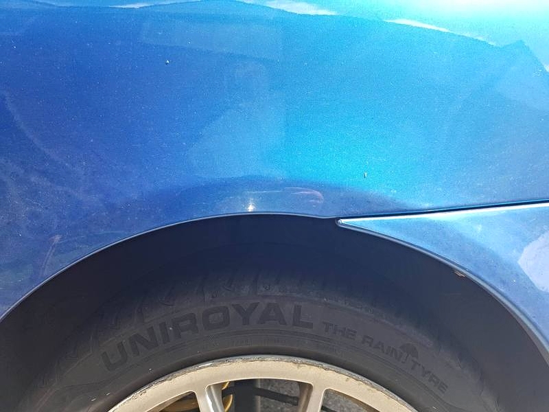

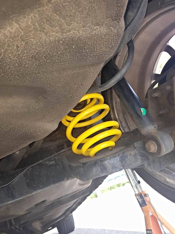

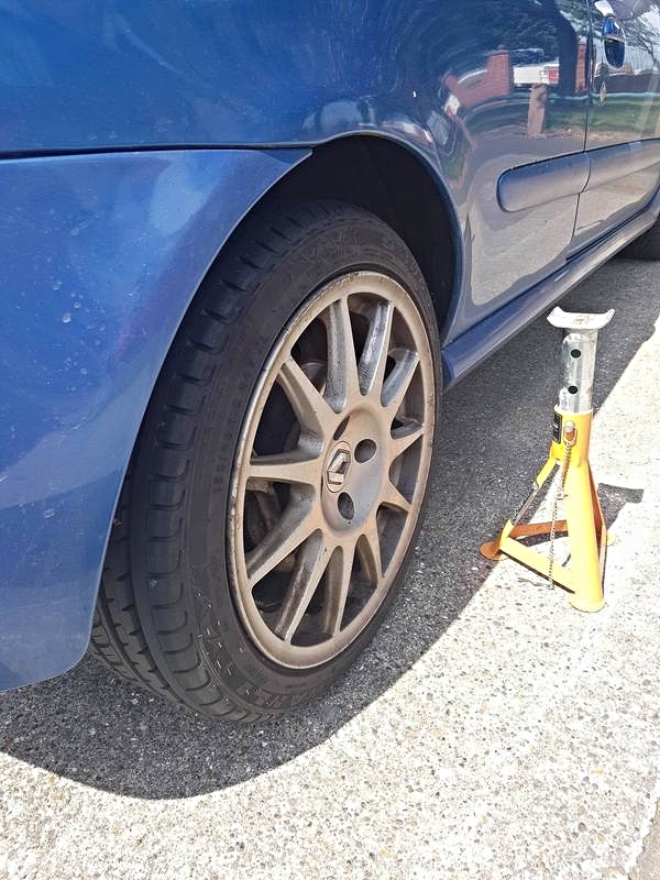

Had some spare time today so had a go at the rear springs,
BEFORE
AFTER
And to make sure everything was sat right, I went for a spin to give her a wash and check tyre pressures :)
Sits so much better now and feels more settled in the corners
