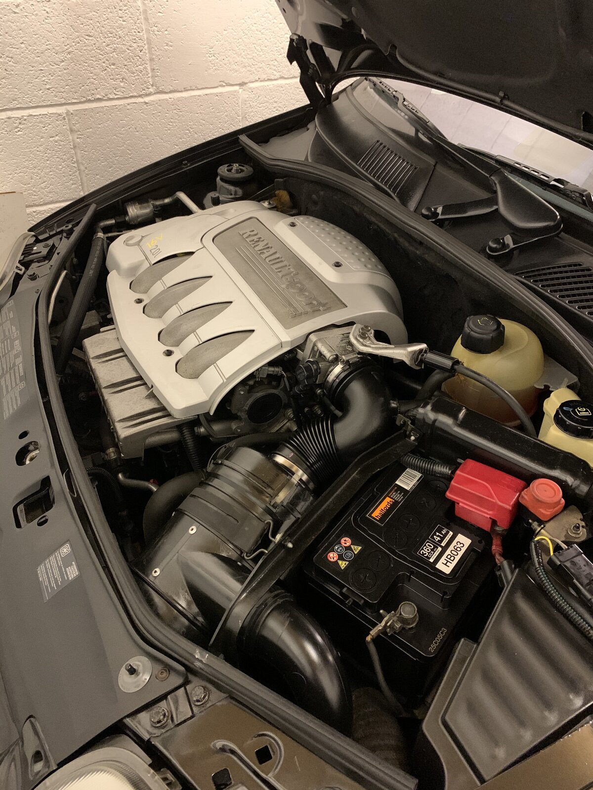

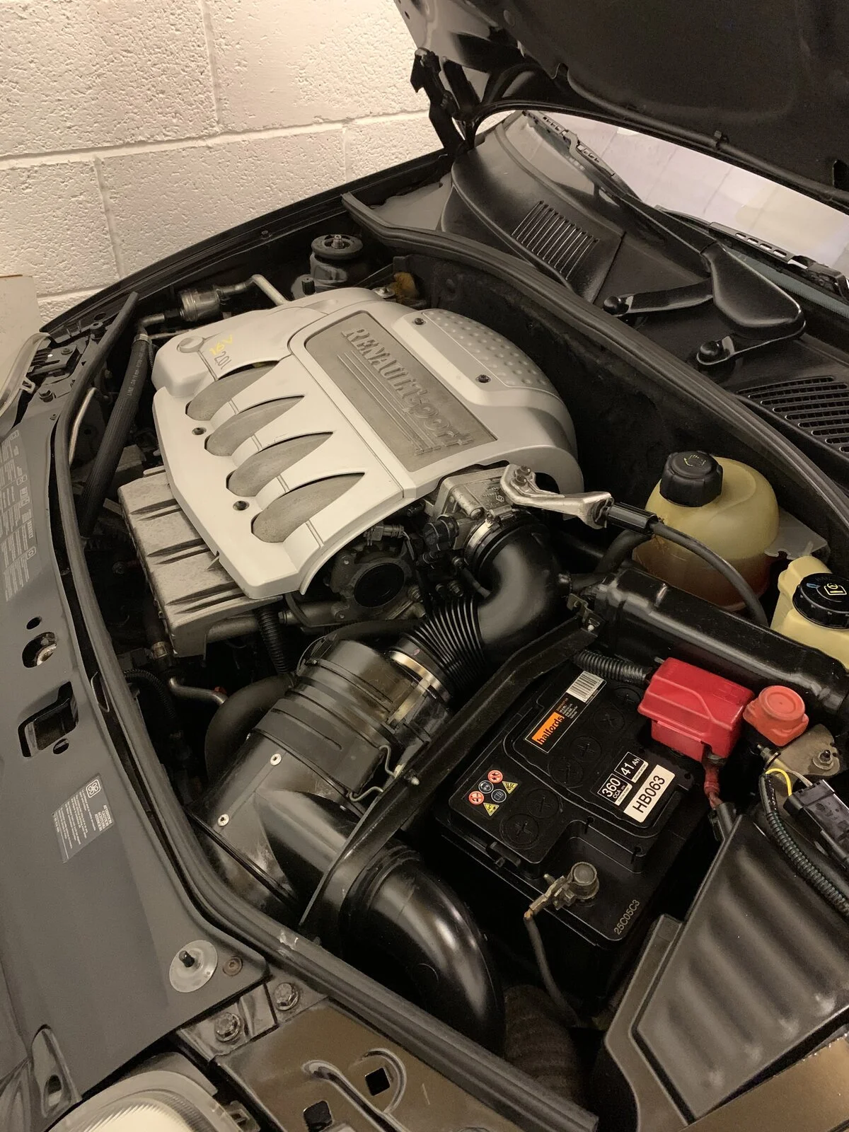

Couple of jobs today, oil change, re balance the wheels and investigate air con inop.
Recovered 340g refrigerant from the a/c system, vacuumed and refilled to the correct amount 660g +/- 35g.
Air con now working lovely.

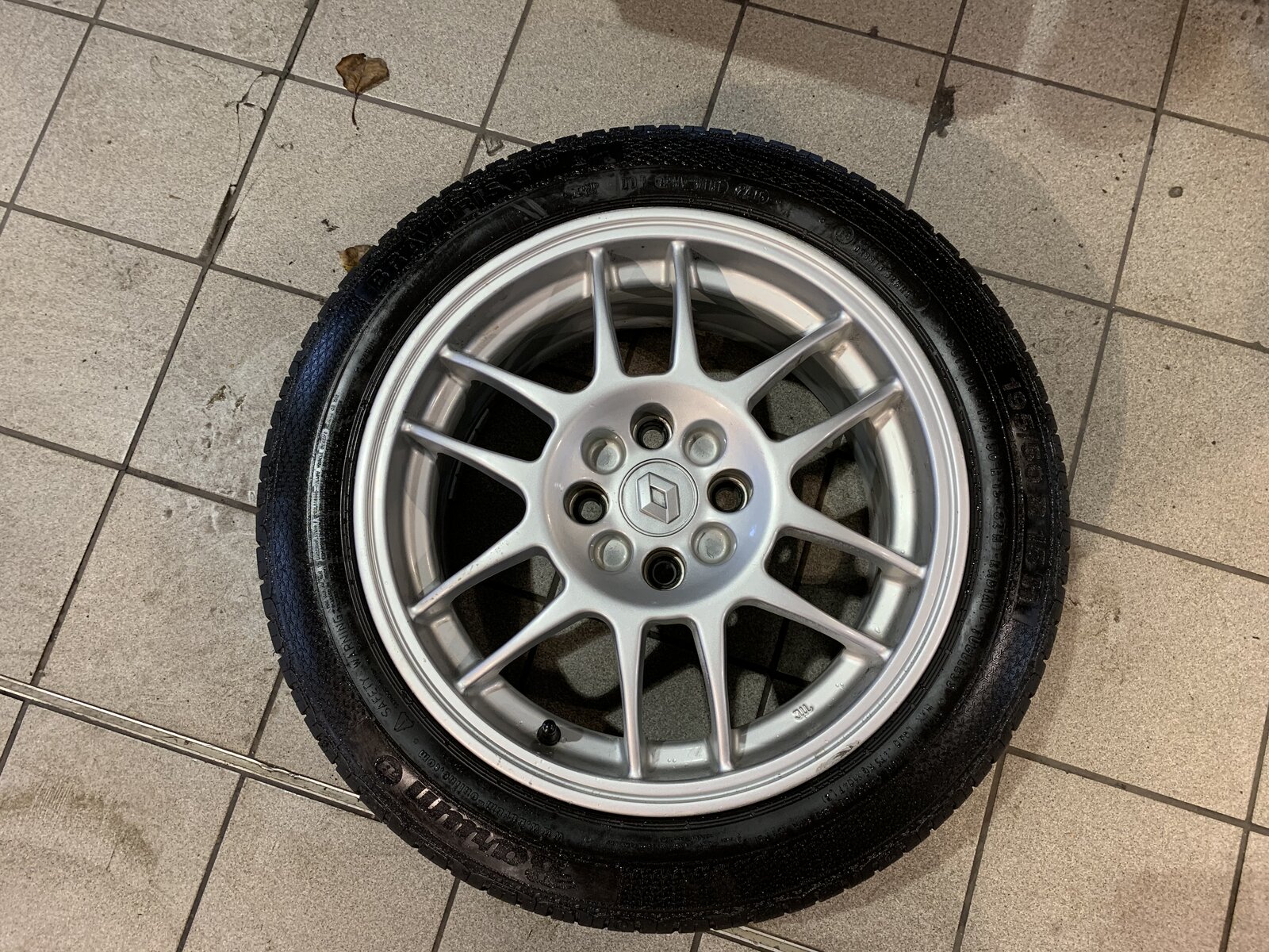

Center caps fitted, all wheels rebalanced, previous sticky weights removed and the insides all cleaned out.

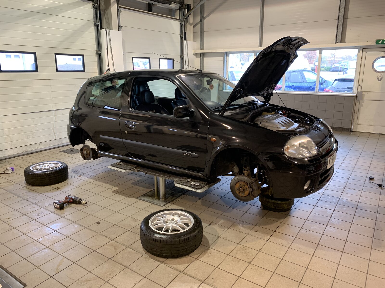

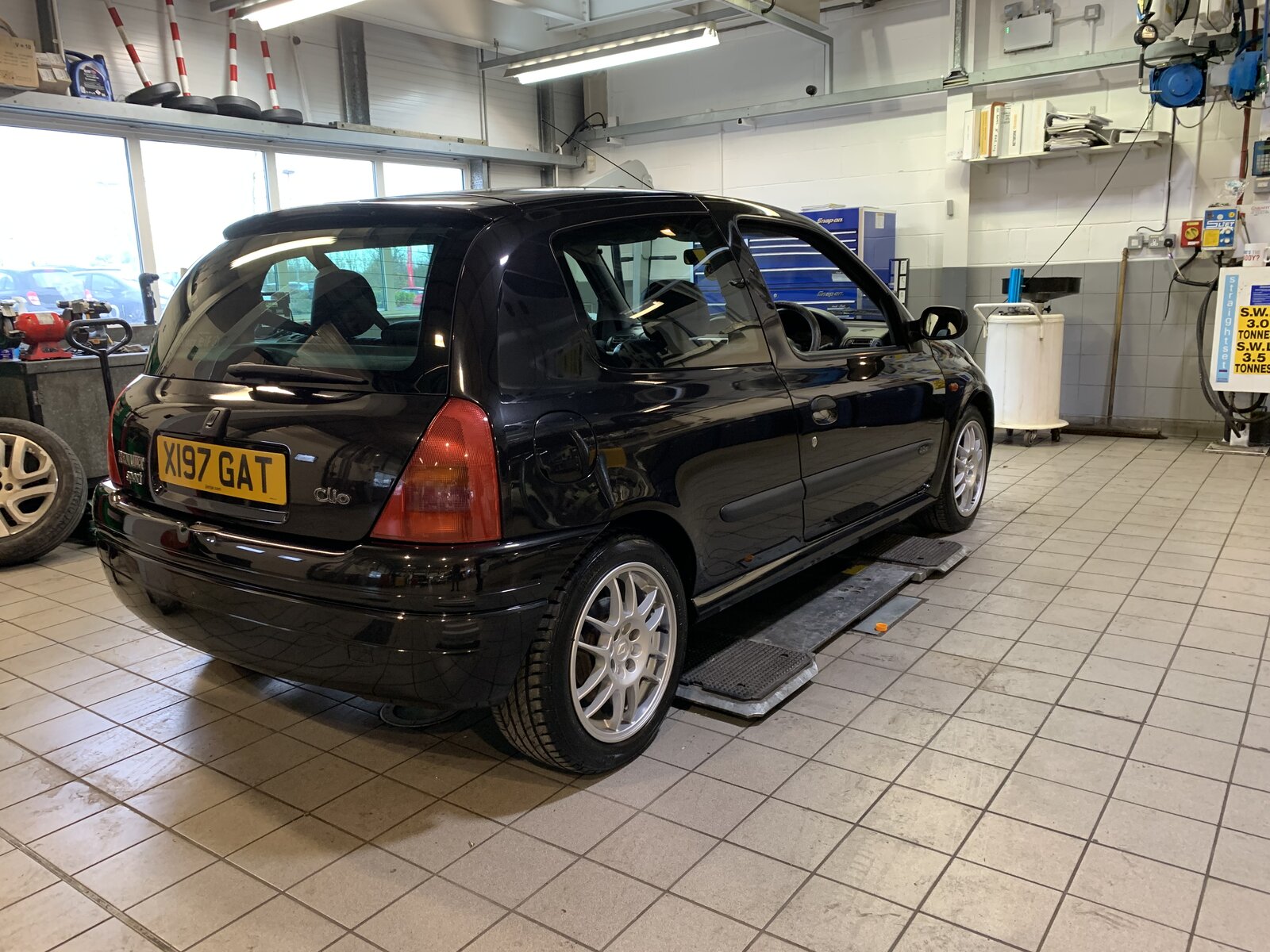

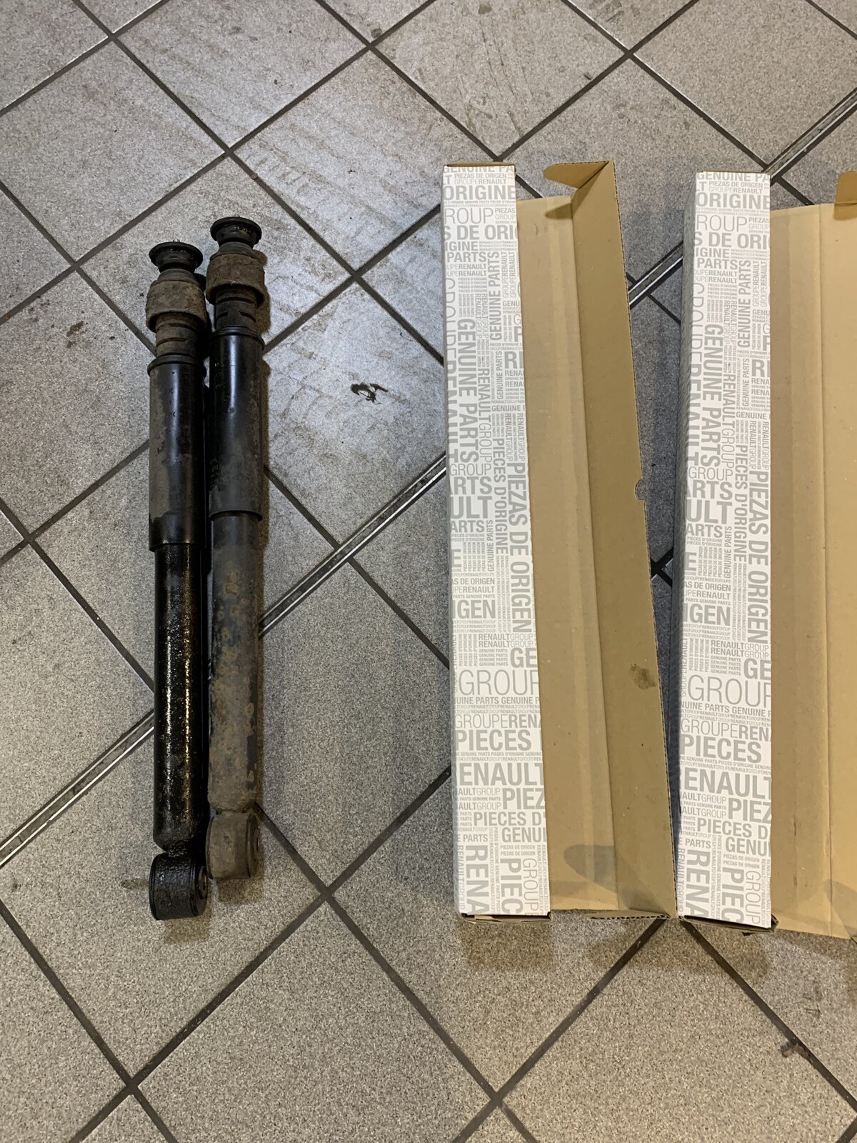

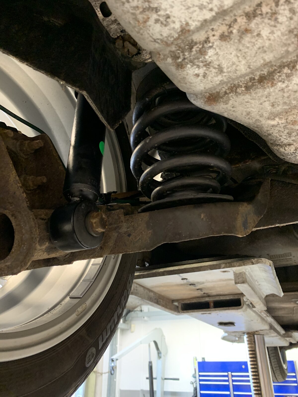

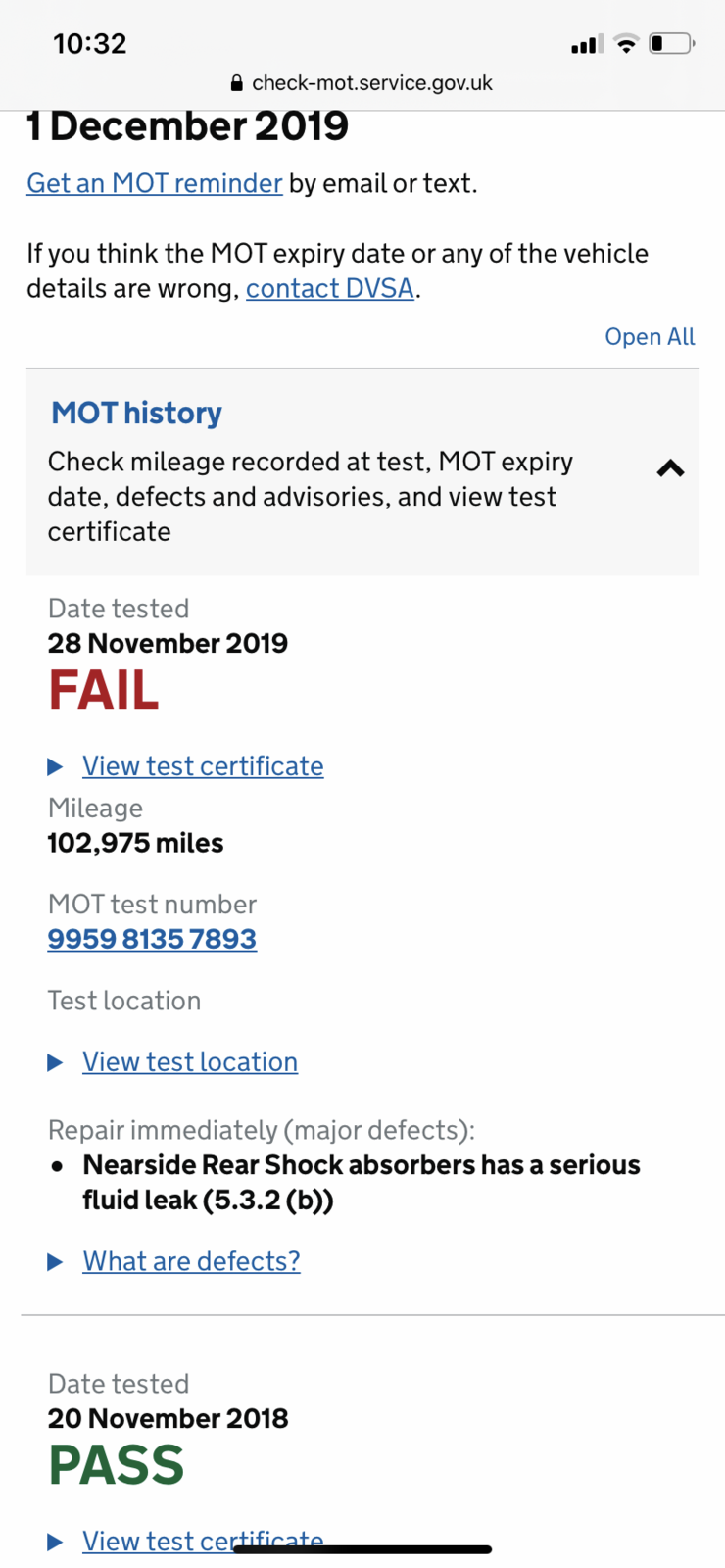

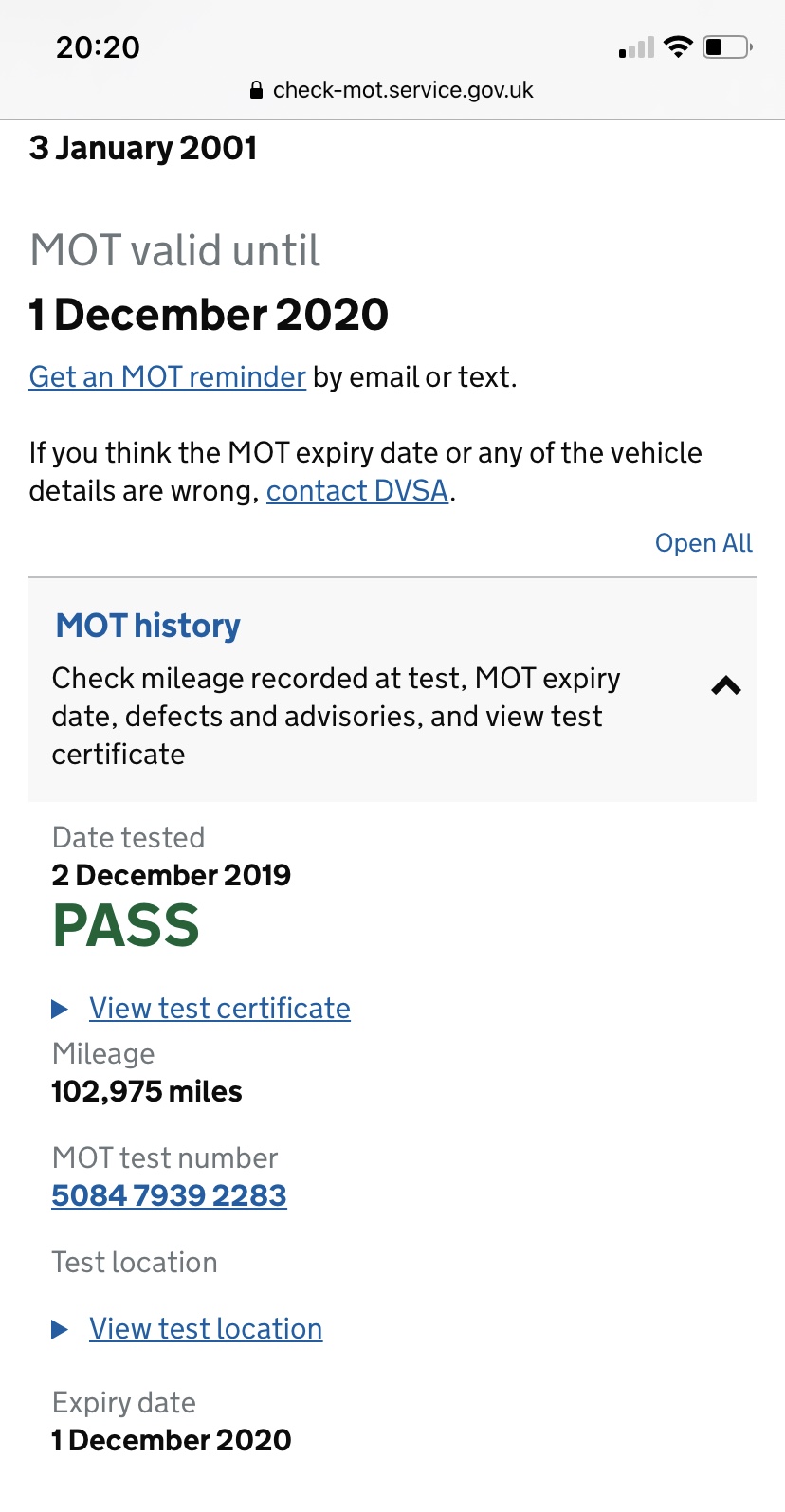

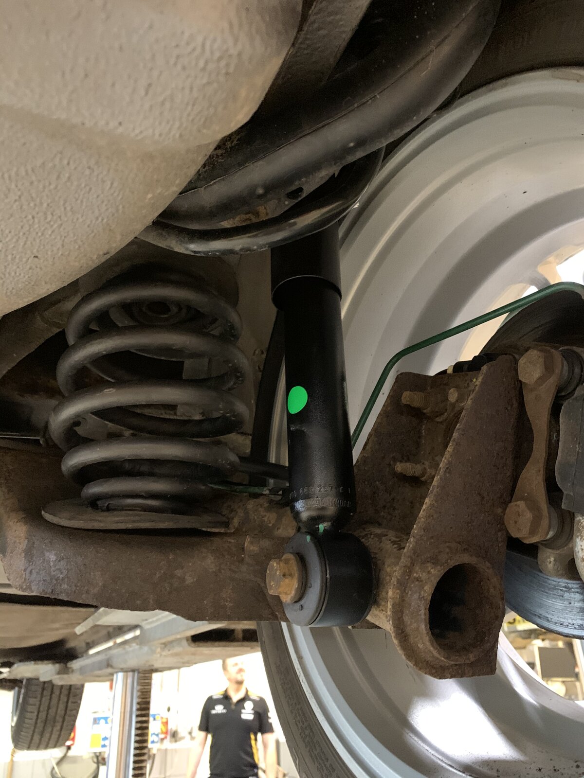

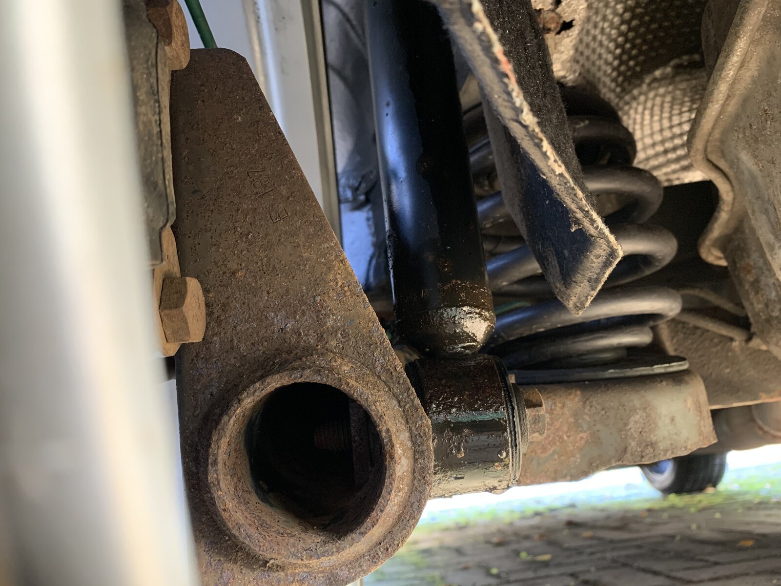

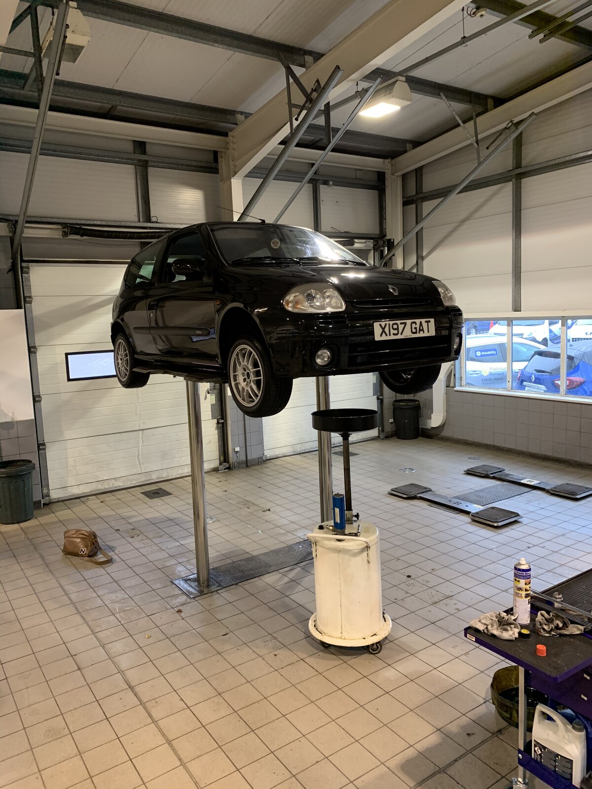

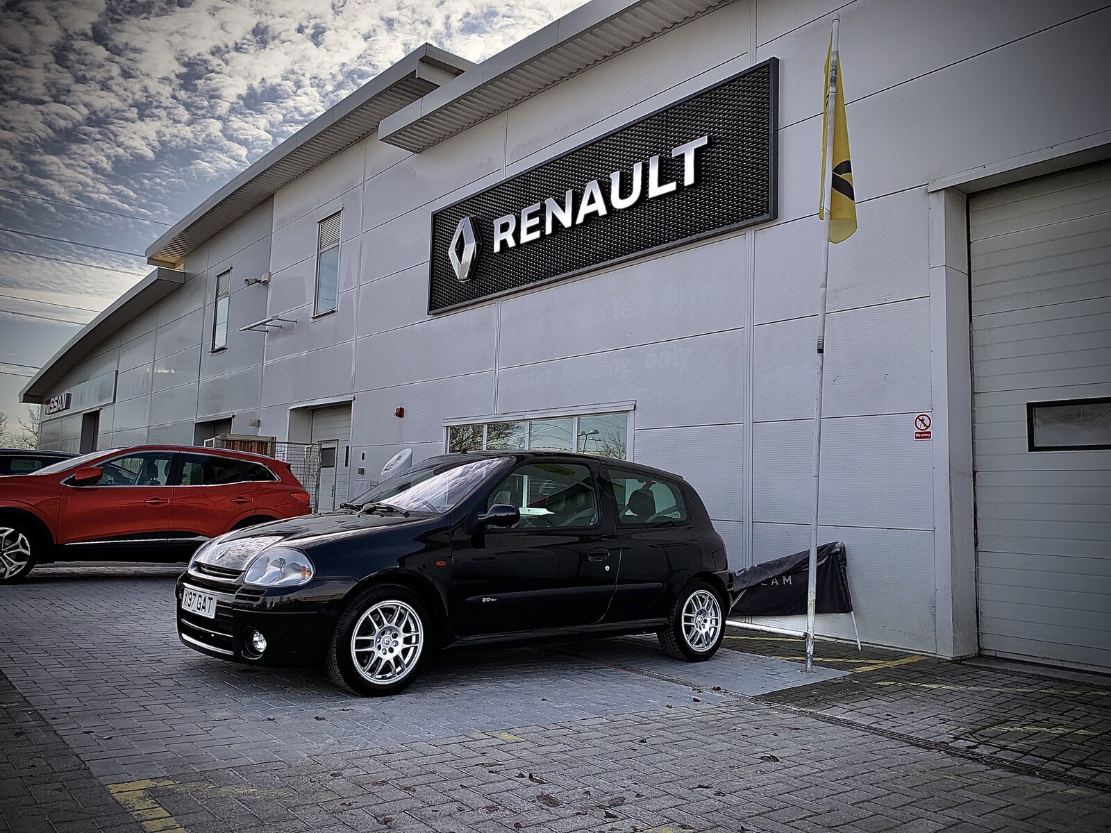

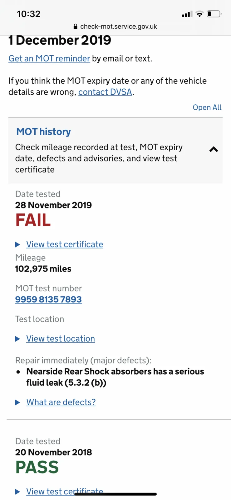

In for an M.O.T today @ Renault Trowbridge. All going well until the n/s/r shocker decided to spring a leak :(
no advisories though 👍
Ive ordered 2x genuine shocks.
MLB
Such a shame, would've been so nice to have passed with no advisories after all the work you've put in!
At least it's not a big job to replace them!
Alastair.
  986'S 172ph1+182FF
Yeah, i could tell it had literally just happened as it was dripping everywhere whilst it was jacked up on the M.O.T ramp.

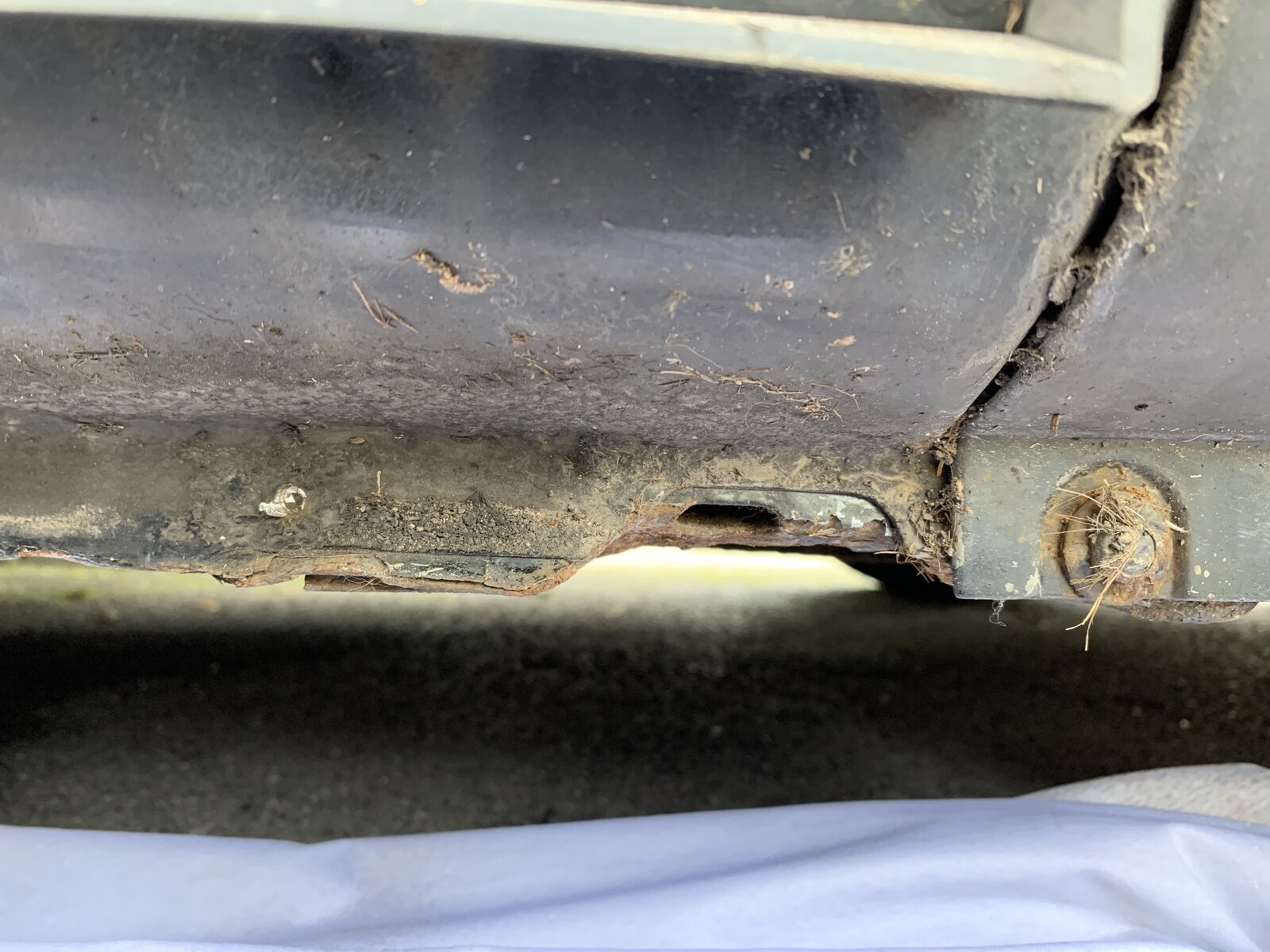

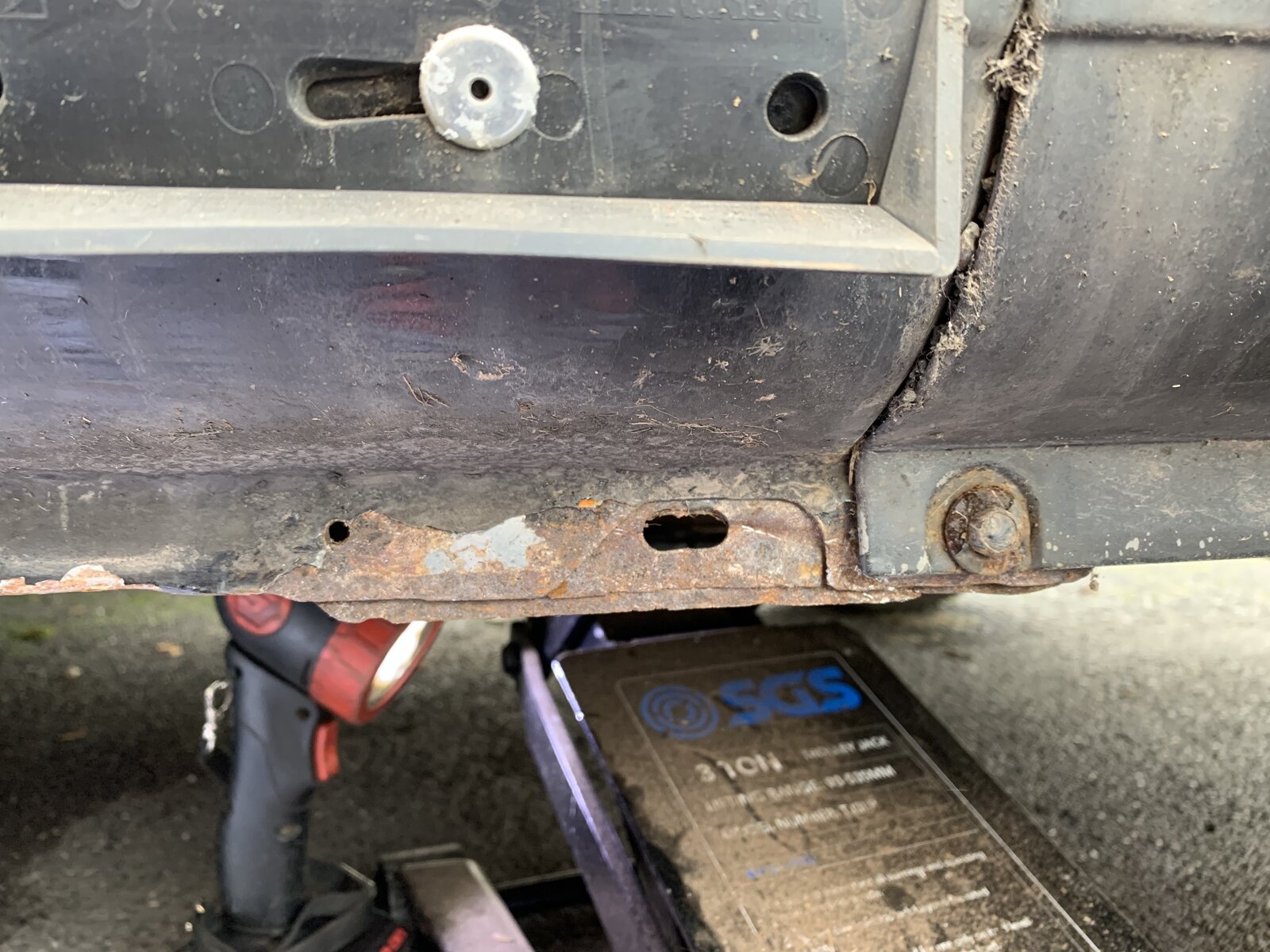

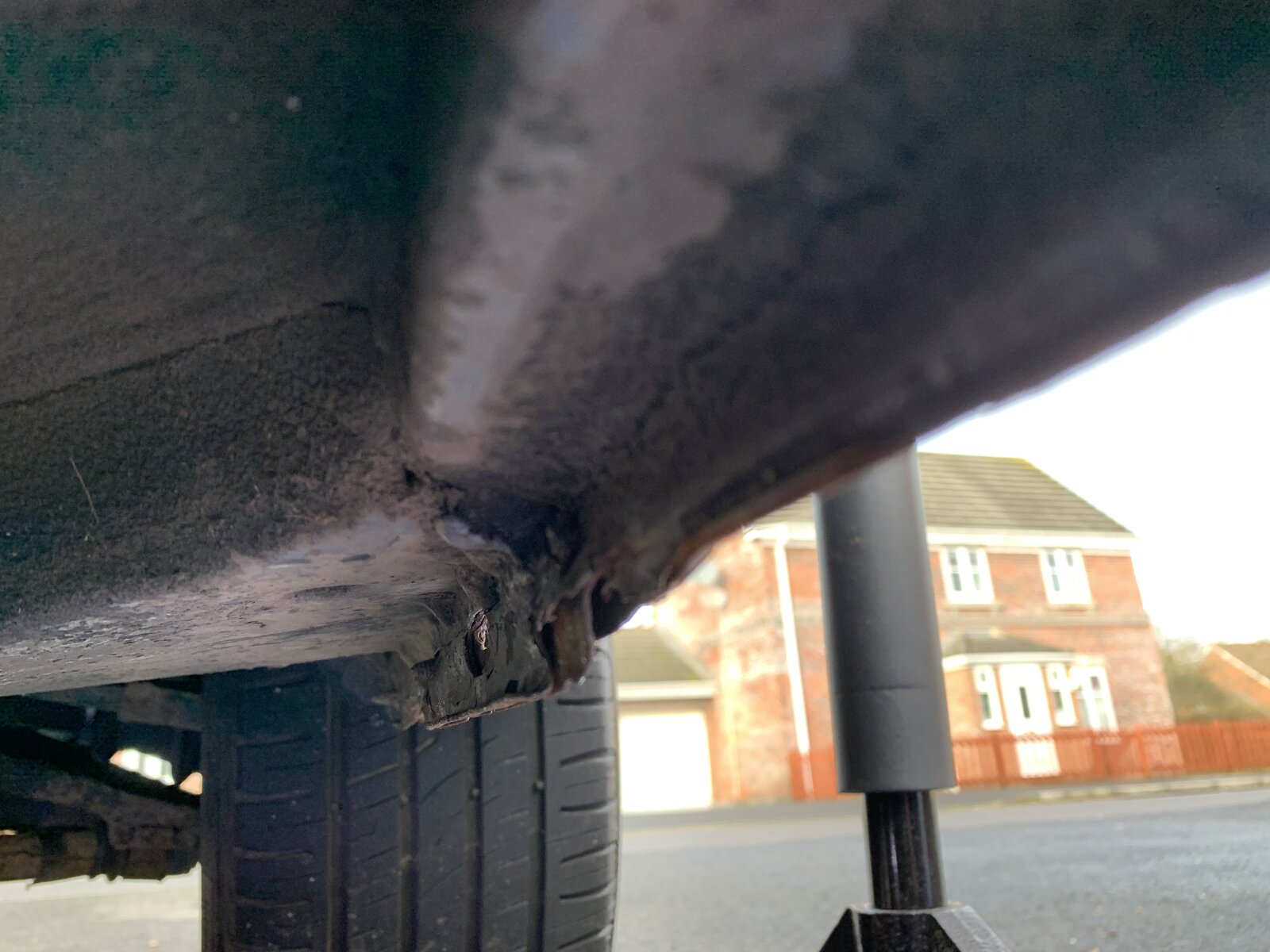

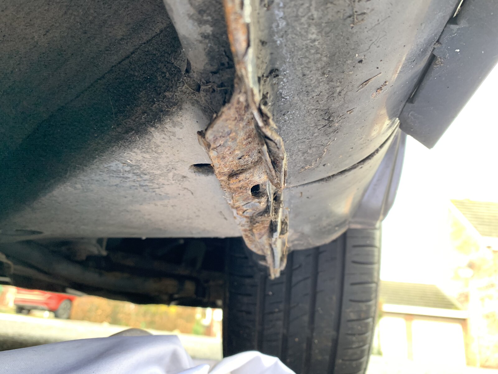

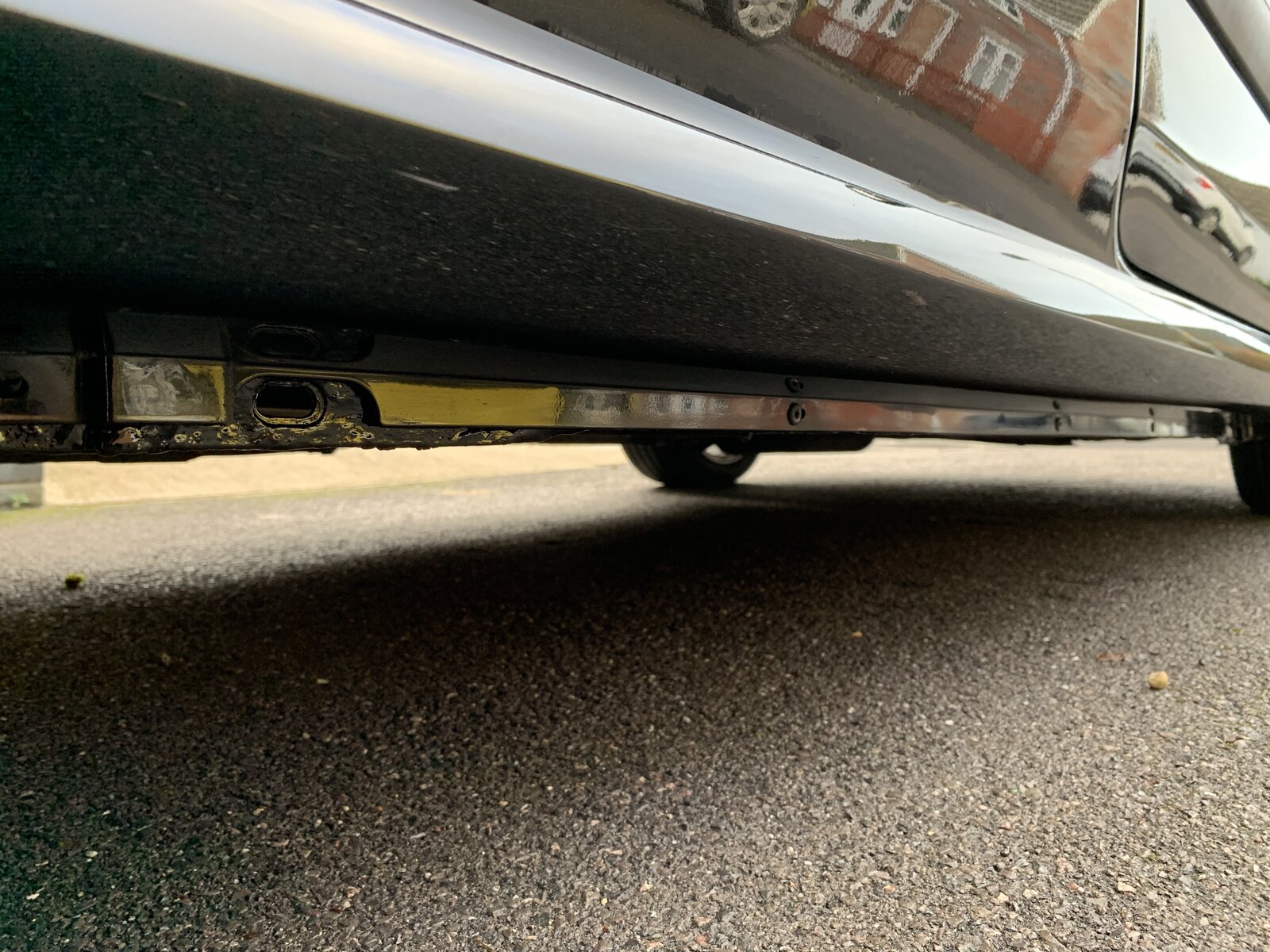

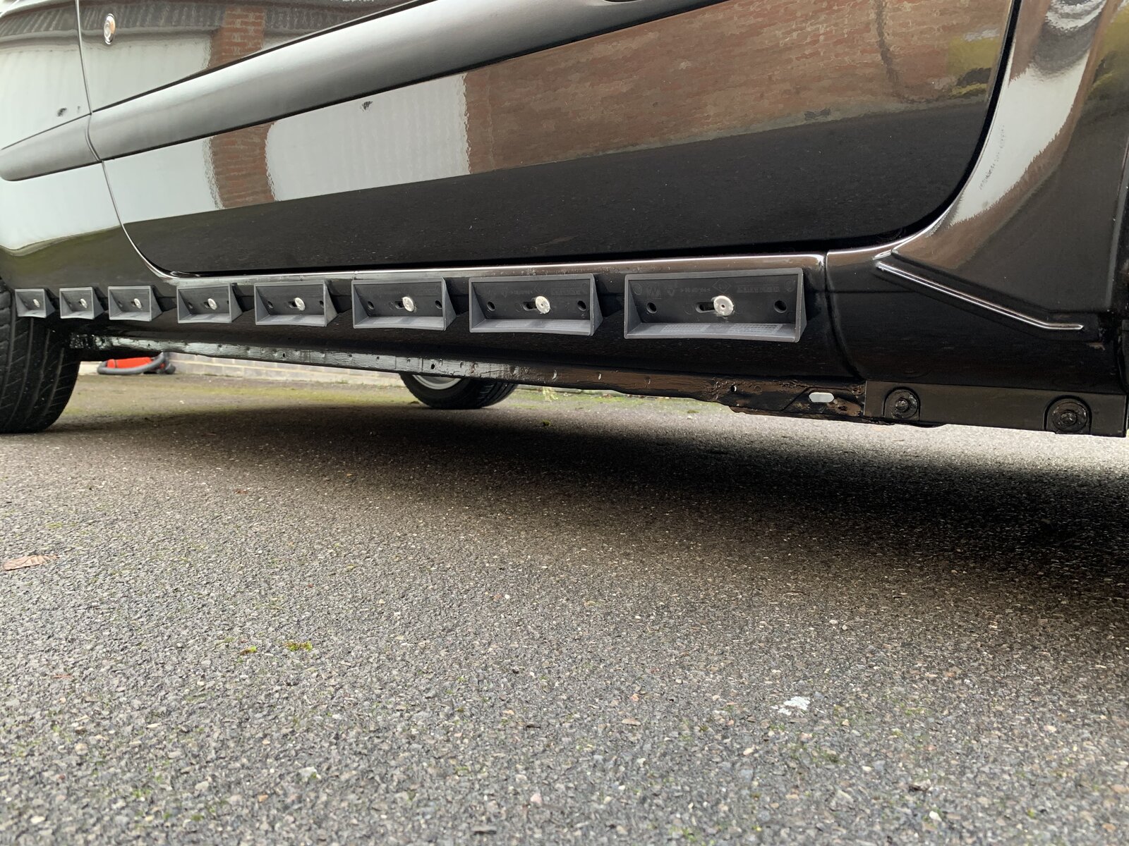

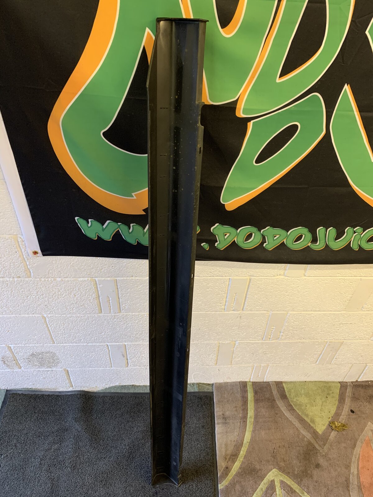

So I’ve taken the side skirts off to give everything a clean behind etc. The amount of mud and shite that was caught up behind there was quite comical.
Having the skirts off aloud me to straighten and repaint/hammerite the sills where clowns have been jacking the Clio up in the past.
I also cleaned out about a KG of mud behind the arch liners.
I side down, 1 to go.
Drivers front properly bent over..
Straightened.

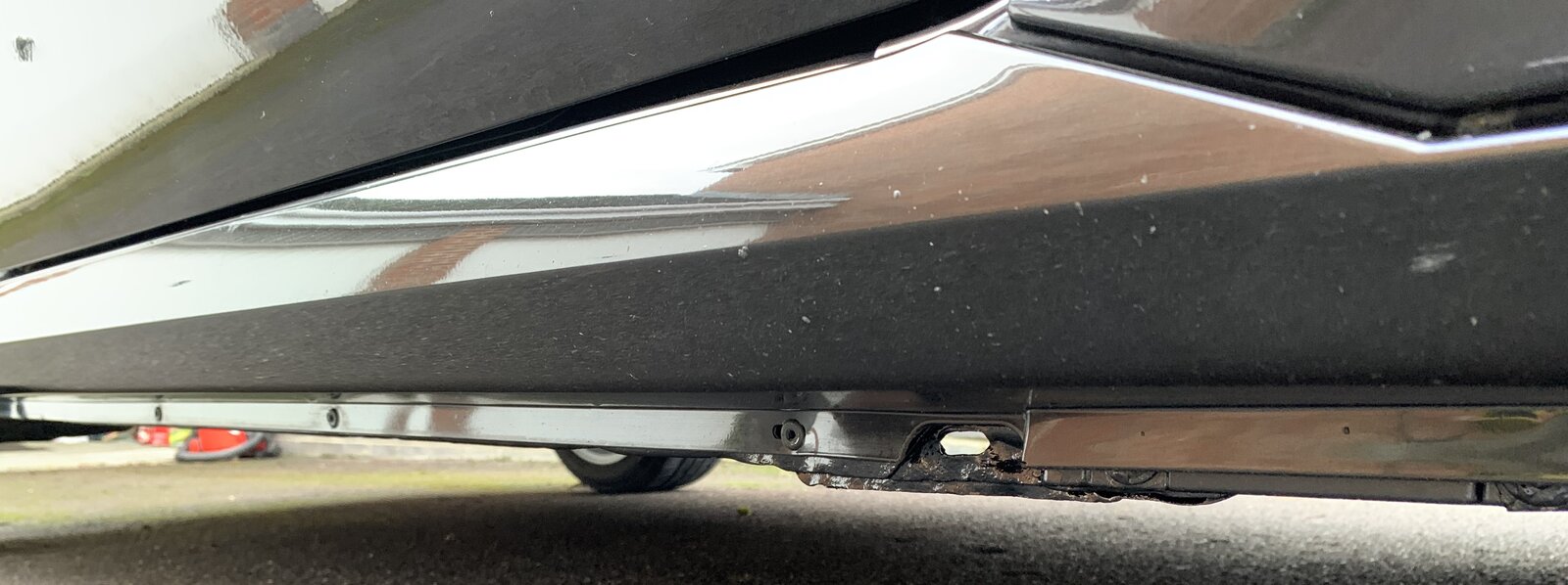

Cleaned up and painted the lower sill/jacking points. Also gave the insides of the skirt a good going over.
DomP182
  ph1 172, Arctic182
Those bent jacking points weren't all that bad really, straightened out nicely too! I did mine this summer but some bits I couldn't get back to an oe look. I BH electroxed mine after deox gel but I do worry about the rust trapped in the layers, dynax ub under the skirts too for extra protection.
