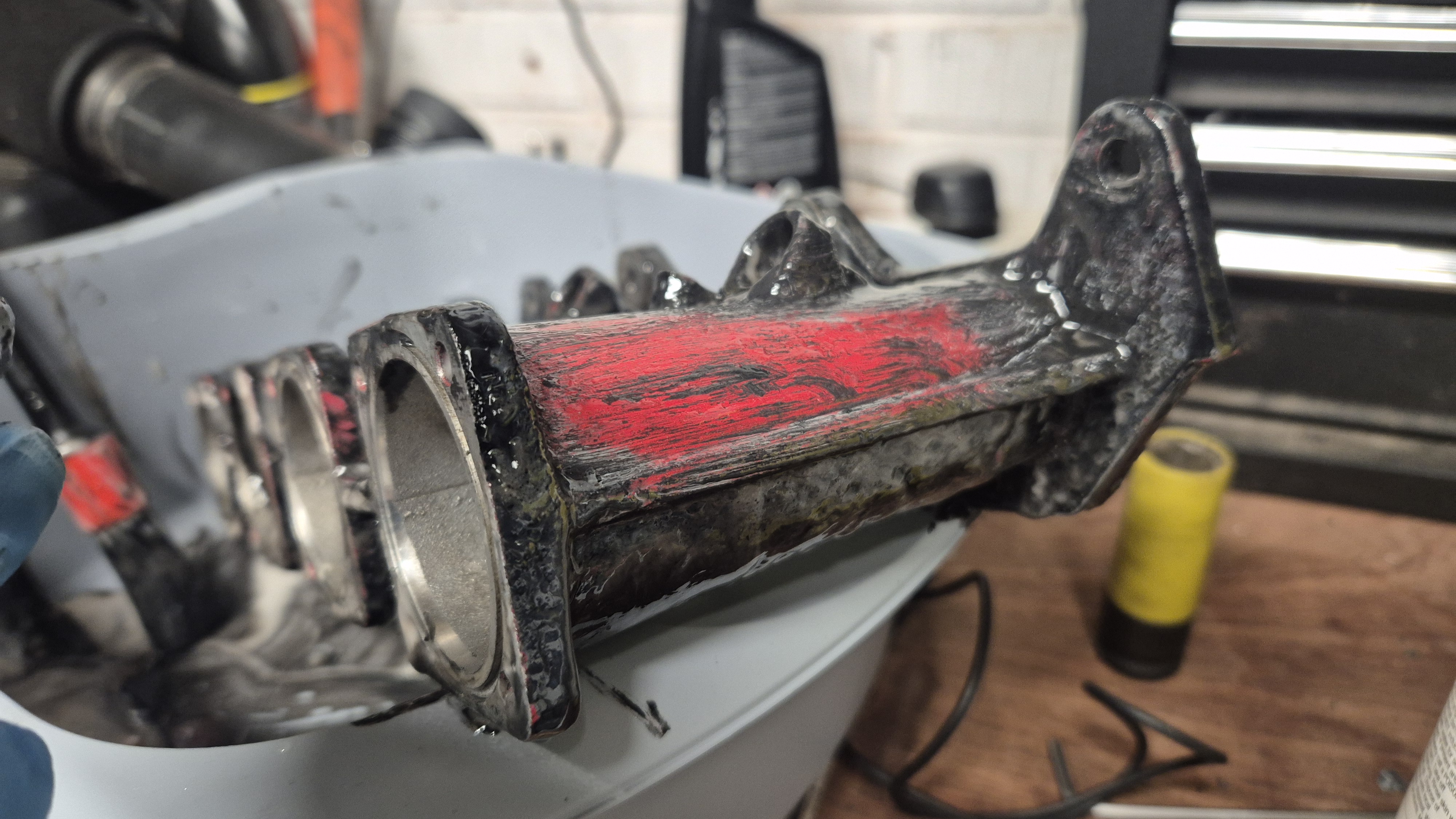

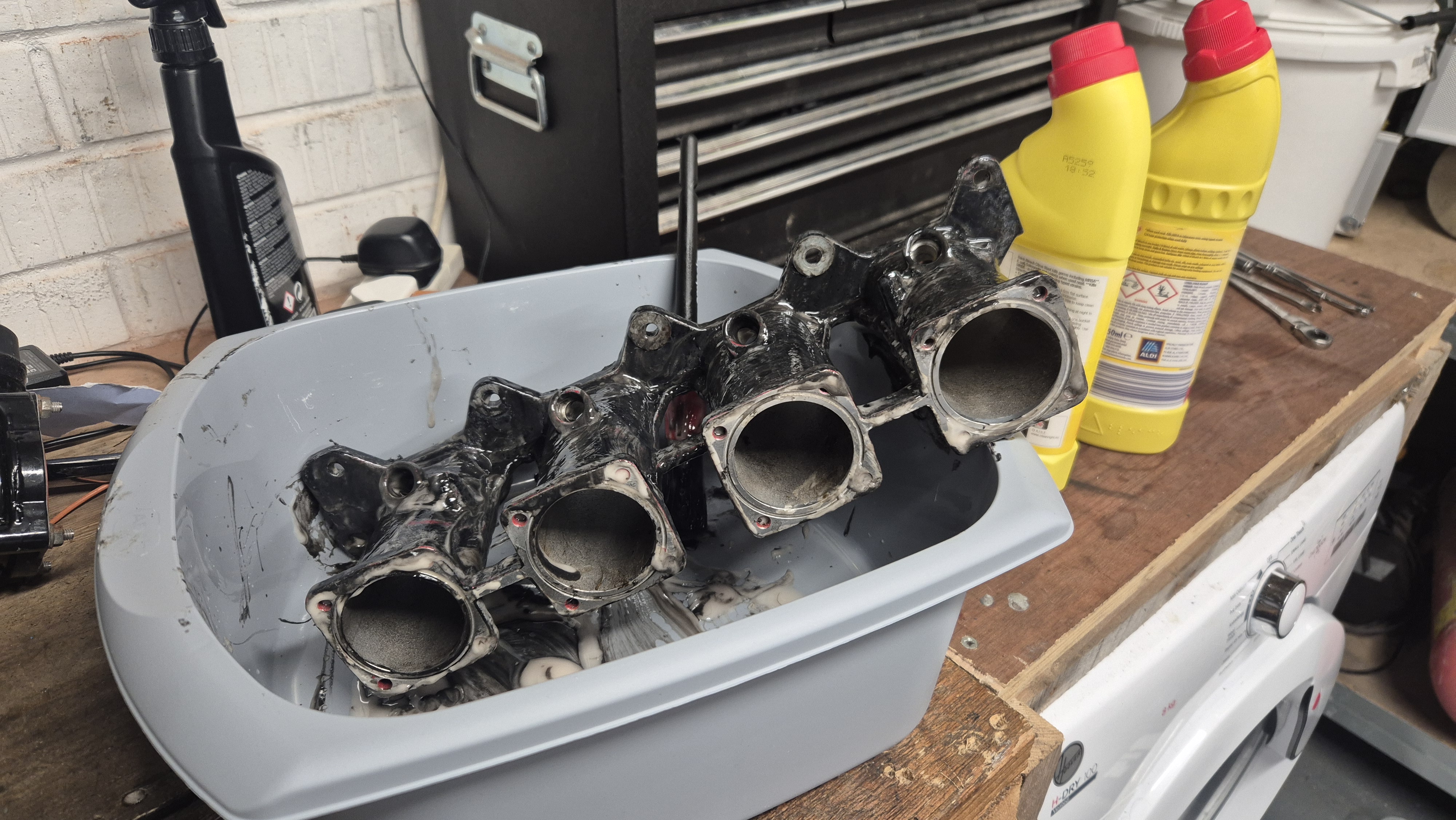

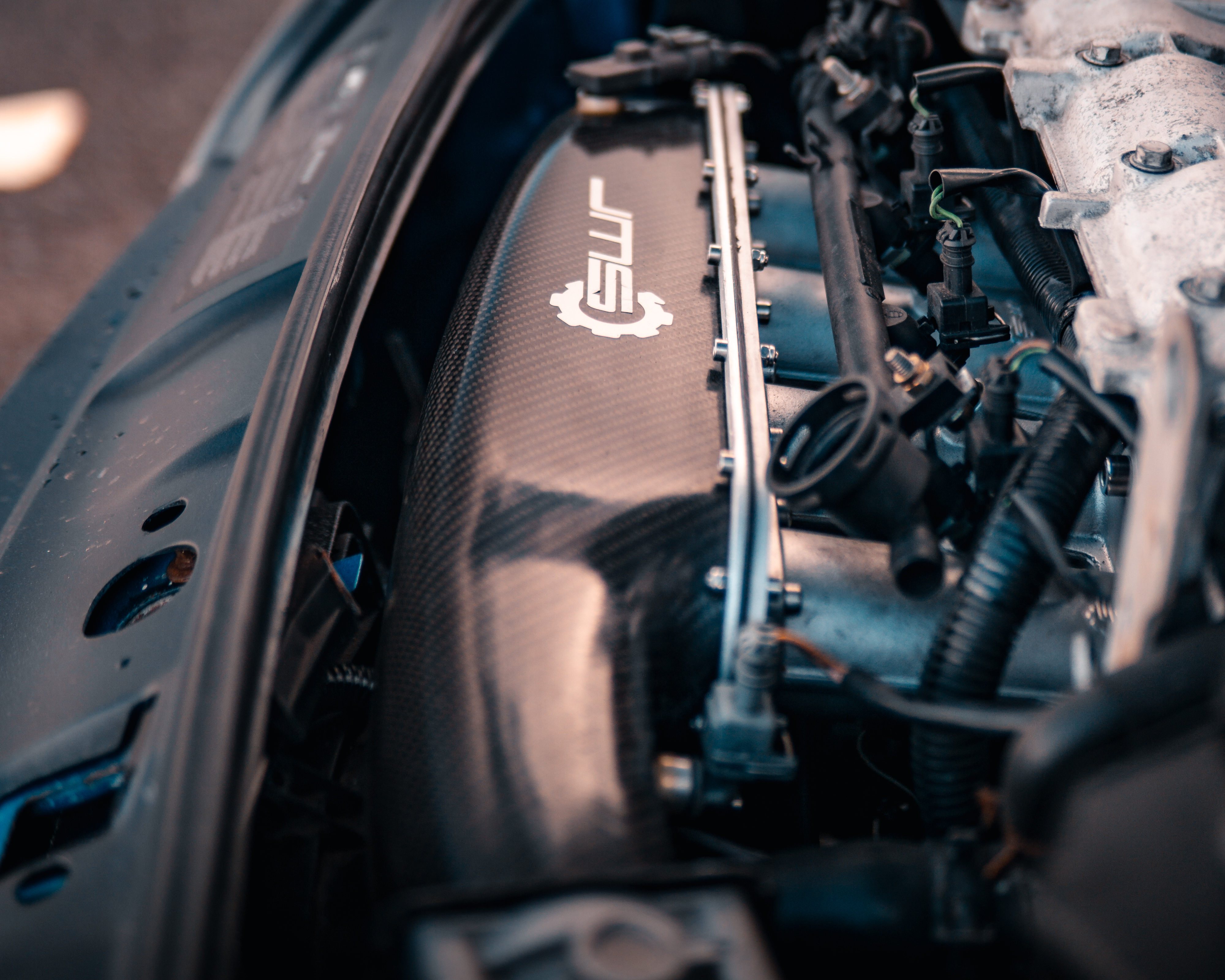

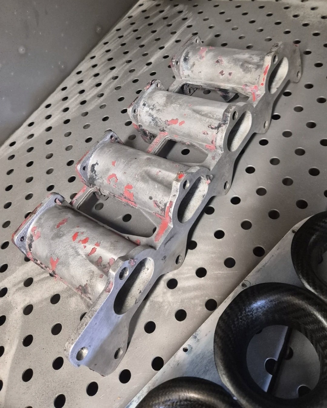

Put in some time this weekend on the JMS Inlet.
The manifold looked like it was painted with a brush, so I started to strip it.
Under the thick black was thick red. FML.
It beat me and I've dropped it for vapor blasting.

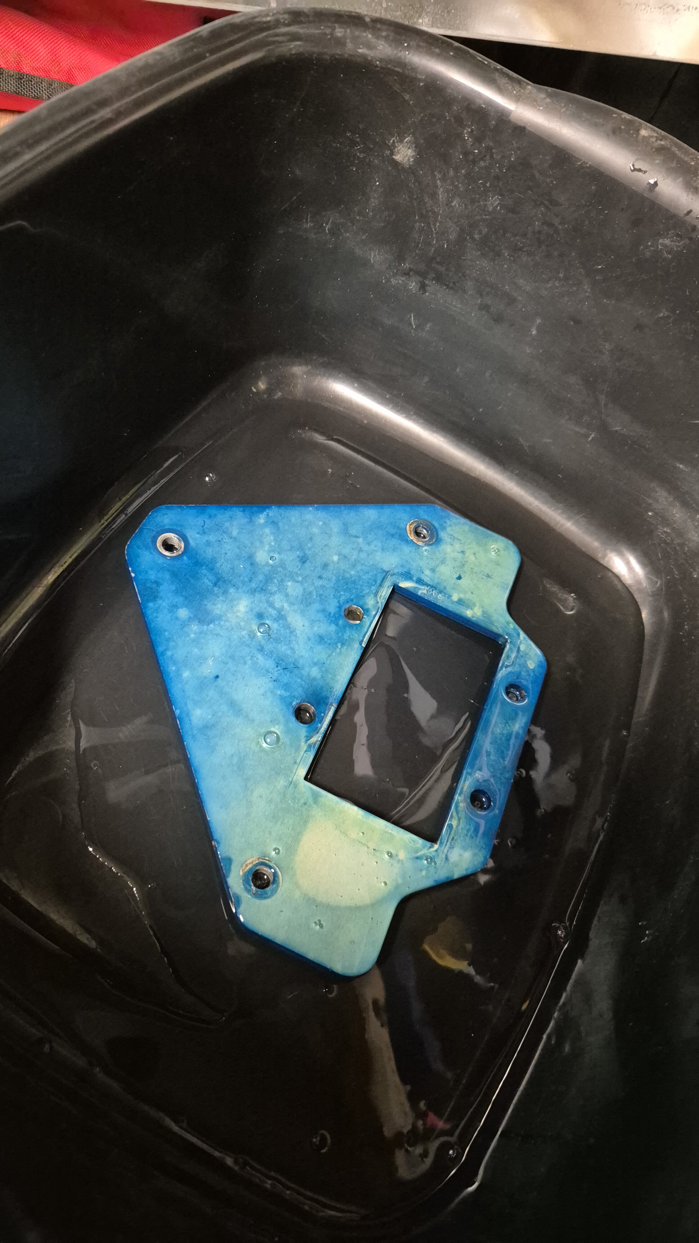

The aluminium which was anodised blue, which isn't the worst colour considering the colour of the car, but it wasn't for me.
@frayz came through with the great idea of applying some bleach to remove the colour.
Voila

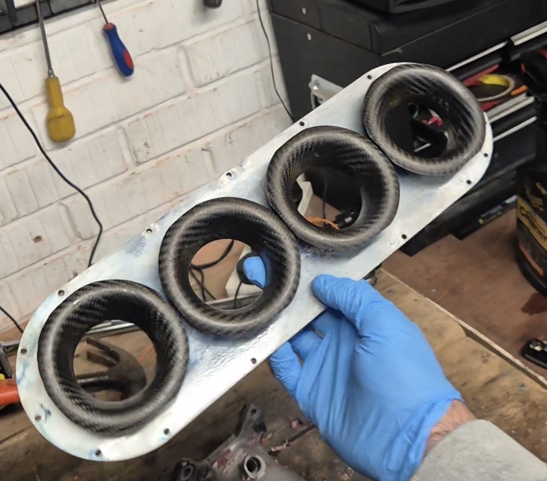

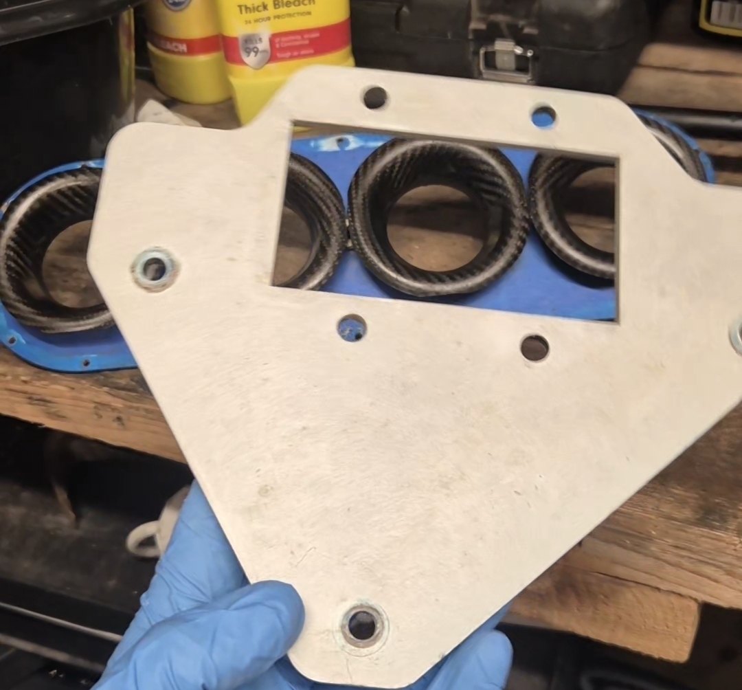

Trumpet panel had the same treatment.
Needs more work, but you get the idea.

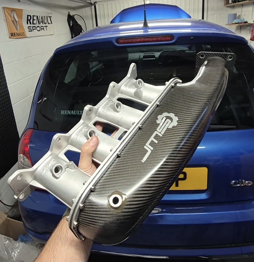

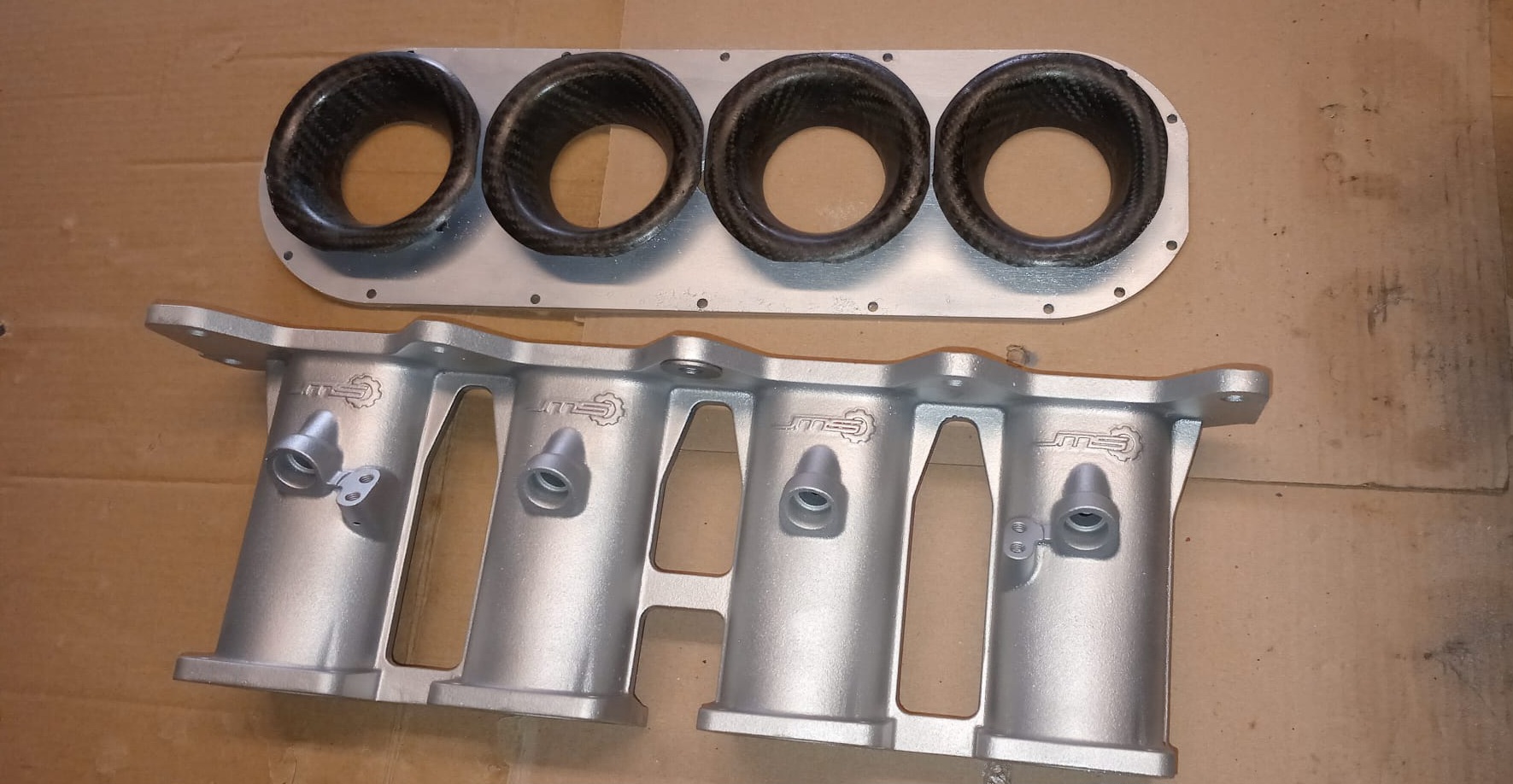

Bit of an update.
Pre vapour blasting.
And done...

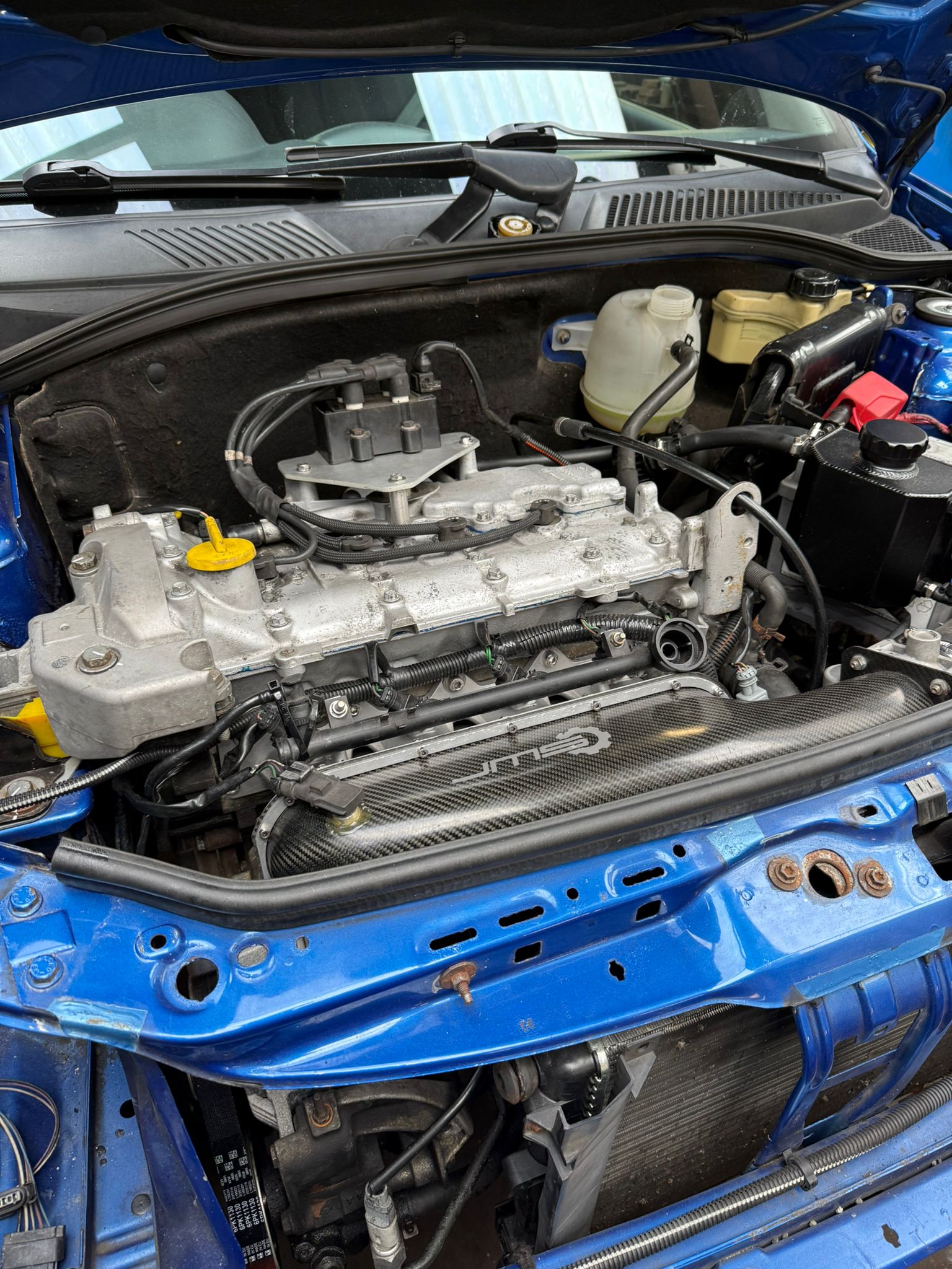

Then I spent a few hours yesterday plumbing it all in. There are no fitting guides out there, that I could find anyway, and although pretty straight forward the vac line to brake booster had me stumped for a little bit. Also, the bolts on the bottom of the inlet... What the actual f**k. Dislocated my wrists getting them done.
And fitted.
Few bits need tidying where I've had to free wires from conduit etc.
Apart from starting it and letting it idle, I've not driven it and won't REALLY drive it until it's ready for mapping.

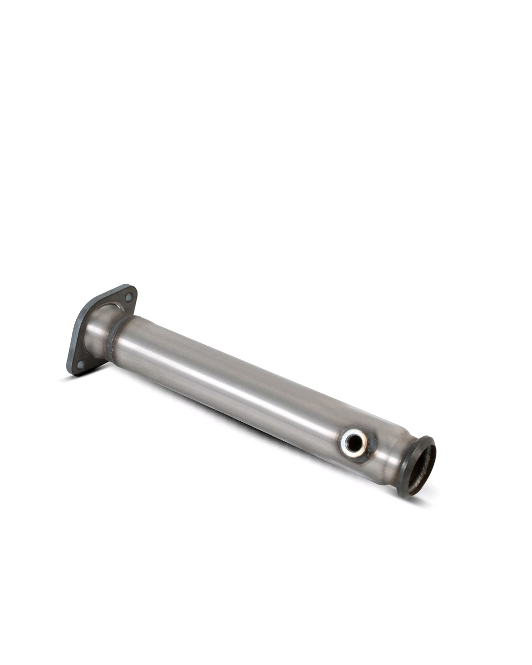

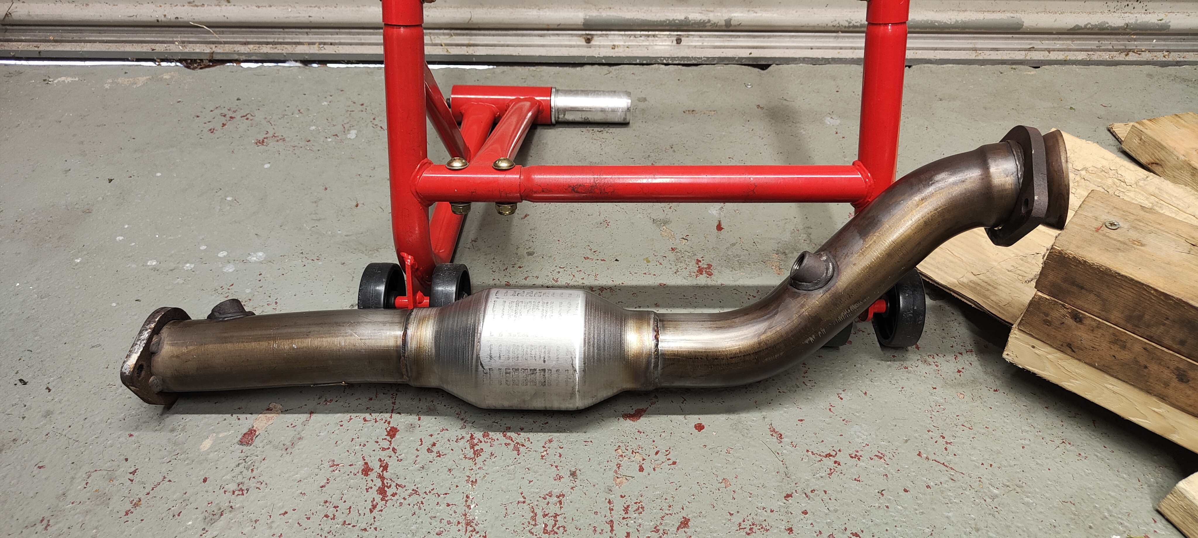

I'm thinking I need a sports cat/decat which has a vband at one end and a 'normal' flange at the other like this?
Send help.
I use to run a 172 -182 conversion sports cat that I then had converted to V band saved chopping the 172 system
Id bin the klarius exhaust for something a bit more free flowing and get an exhaust place to extend the centre pipe to manifold with a flexipipe and vband, so only one joint.
I'd ditch the pattern exhaust and get a fab shop to make something to fit, you can still have something quiet with a couple of decent boxes in it if that's your thing.
I've heard nothing but bad things about the Ktec cats too, they're cheap china rubbish that probably won't get you through a legit MOT
I had a magnaflow sports cat welded into my milltek downpipe, it was a while ago but I think the lad that does my fab work only charged me £40 to do it.
This is the cat I went with

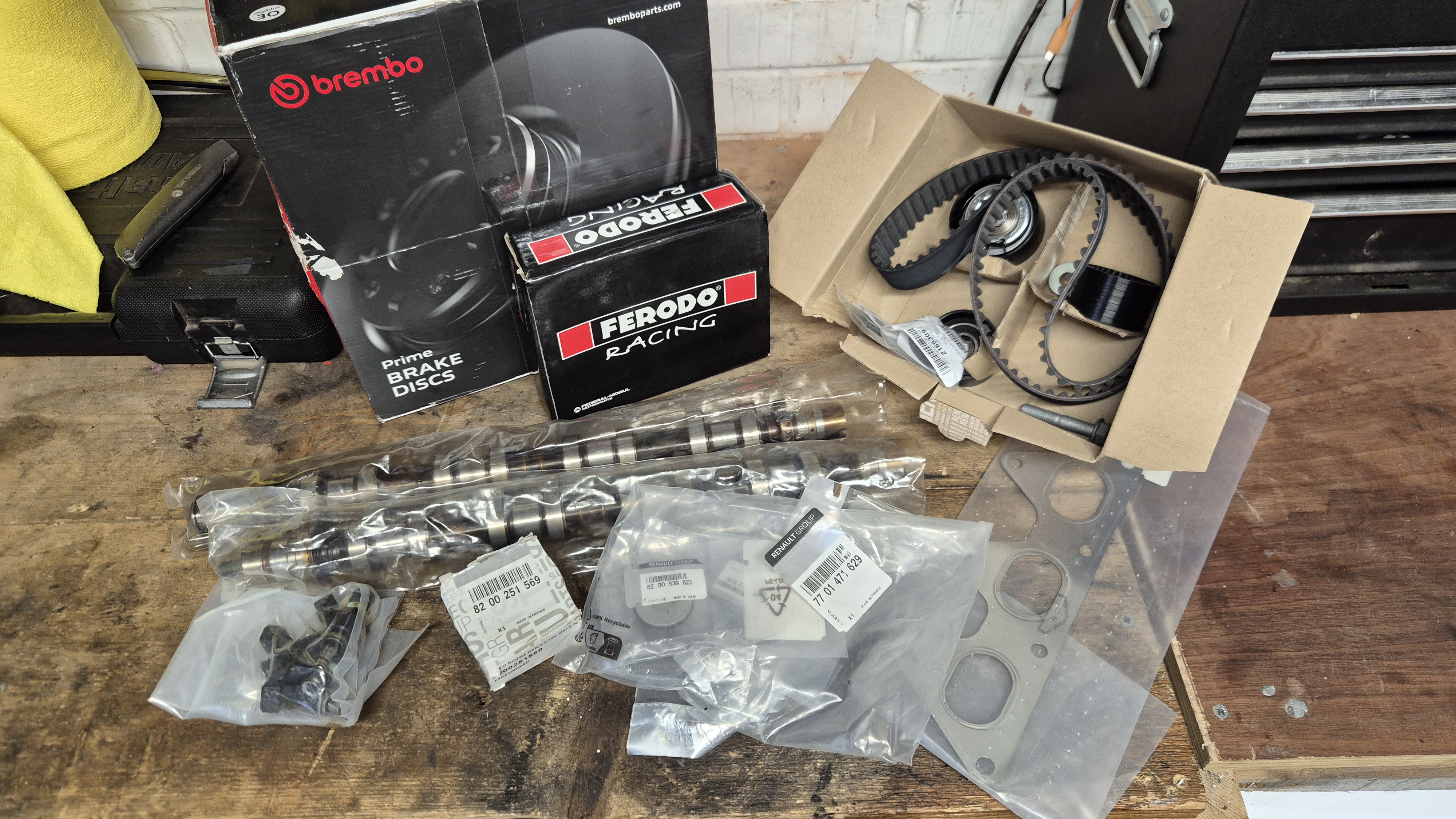

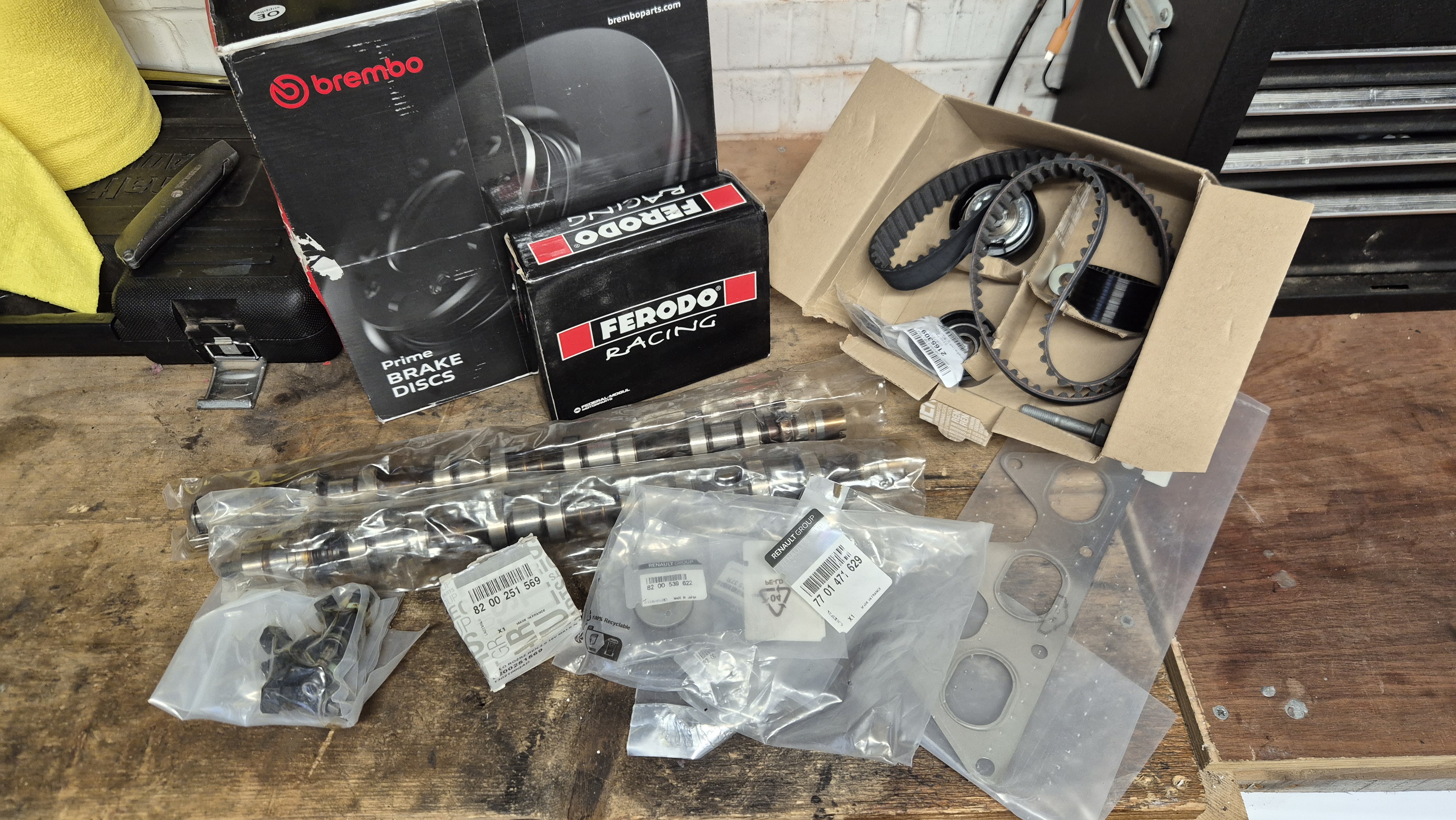

Been gathering parts the last month or so.
197 Cams
Cambelt kit
Camshaft nut and seal kit
Camshaft seals for gearbox end
Keyed Crankshaft pulley
Exhaust manifold gasket
Brembo HC Discs
DS2500 pads

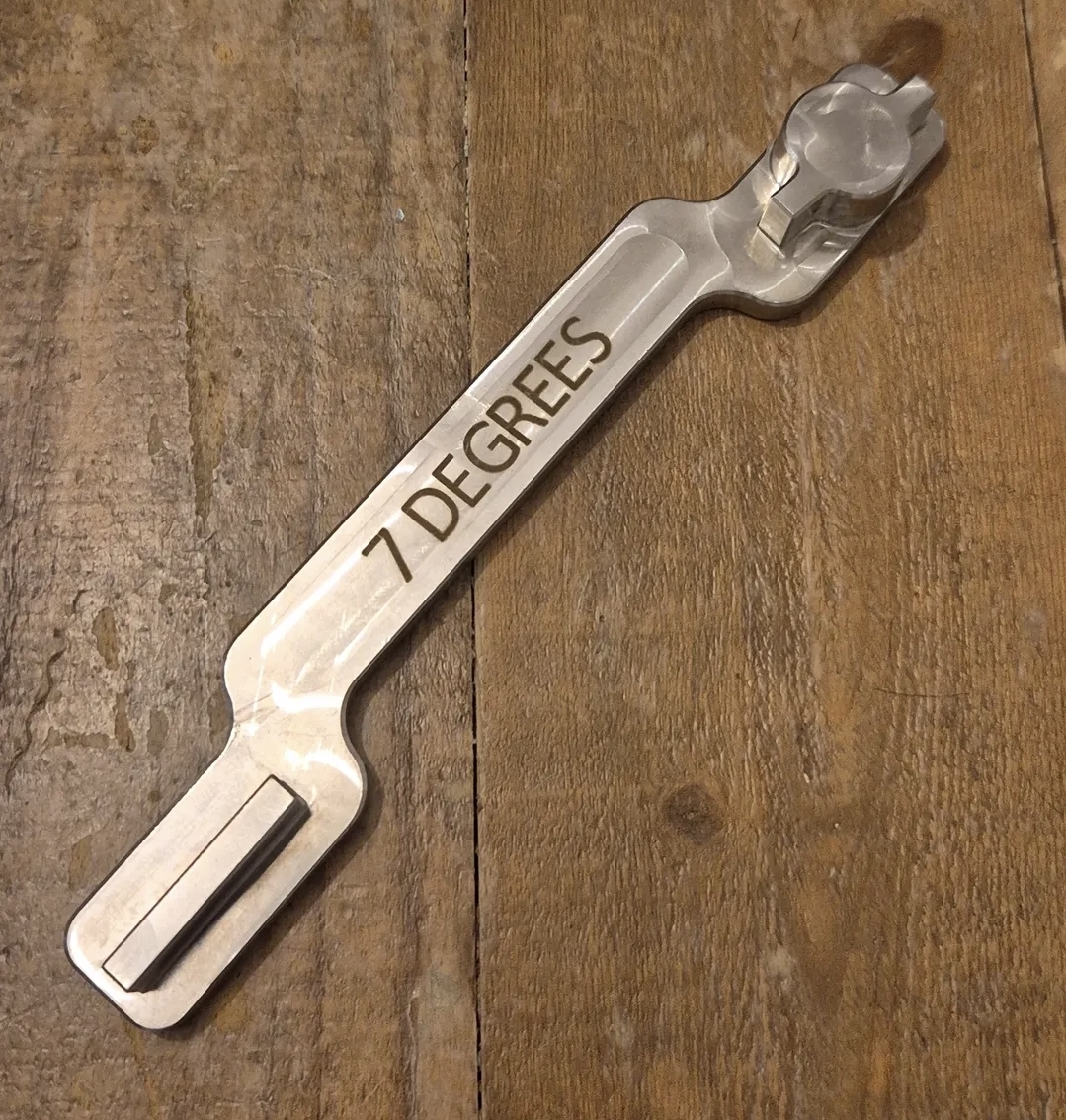

7 degree timing tool

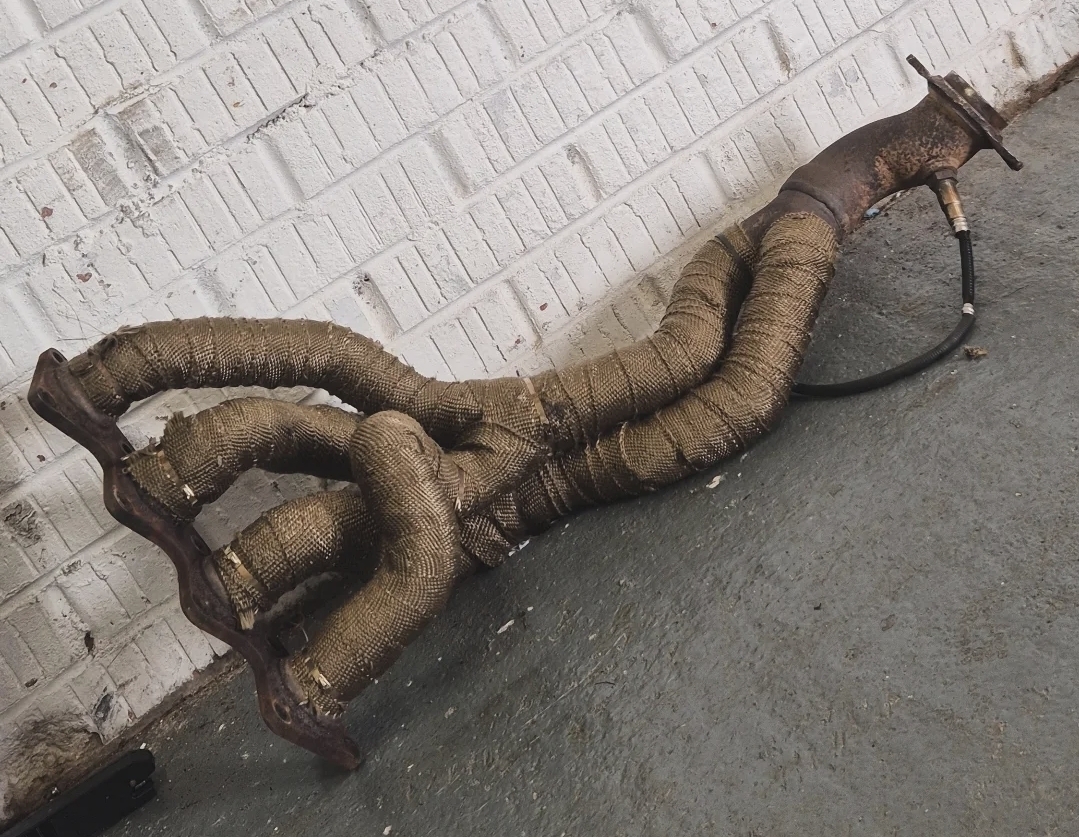

182 heat wrapped manifold
2118 speedlines from @colesy. These aren't to be fitted ASAP more a future plan.

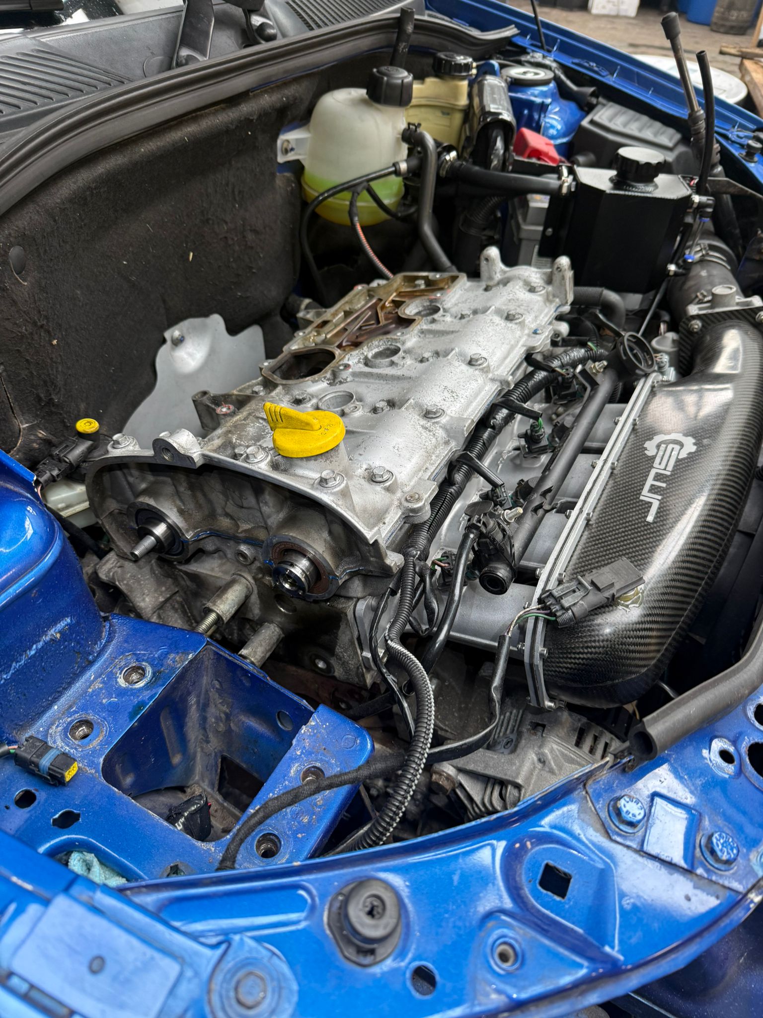

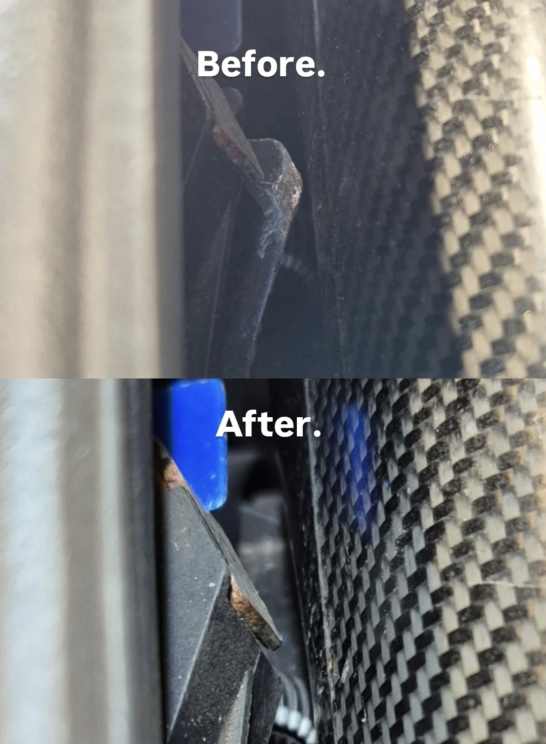

Lastly, the JMS inlet sits increbily close to the bonnet catch bracket. So I took a bit off it.
Will be having the mechanical work done this month, fitting and timing cams are way out of my knowledge bracket. I'll send my ECU off for a base map before driving to Engine Dynamics for proper mapping.

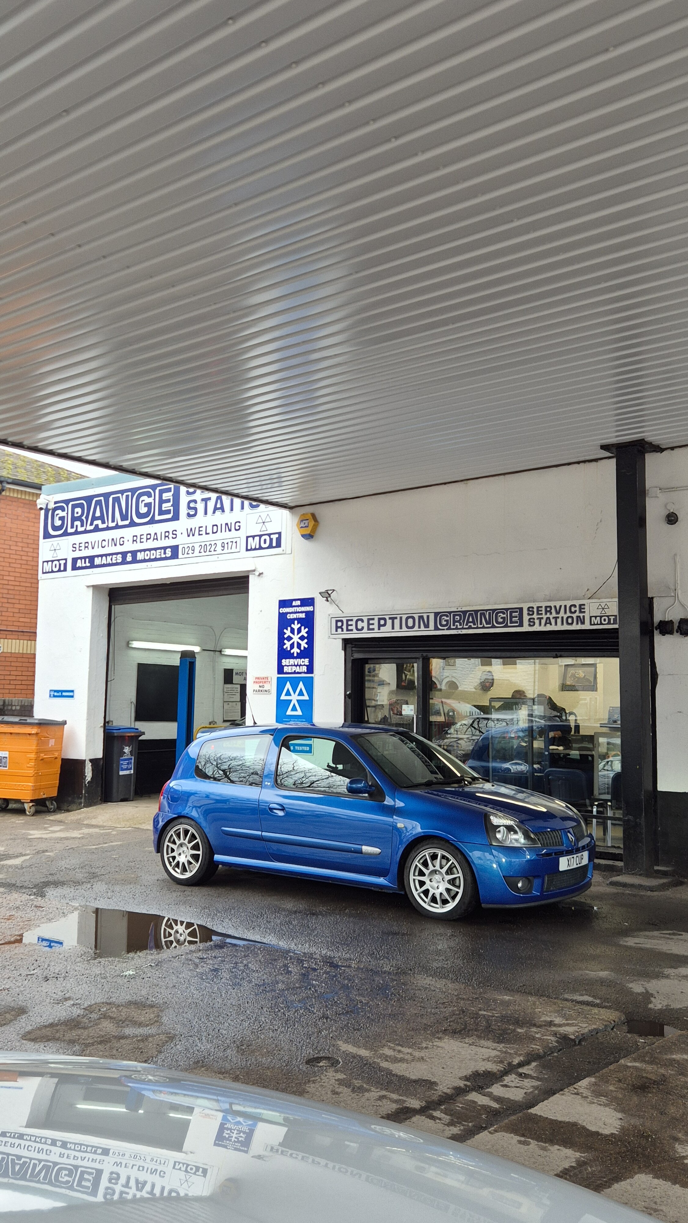

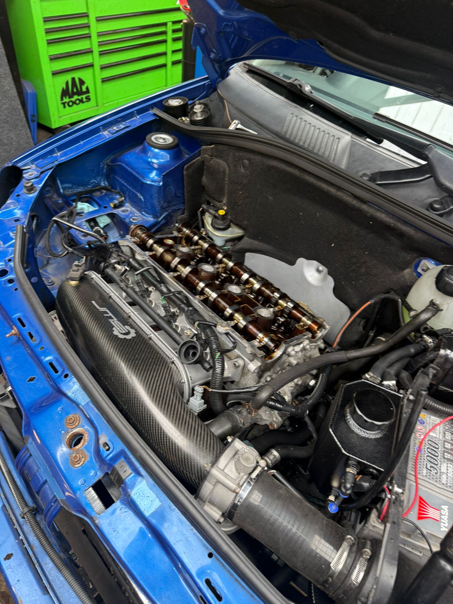

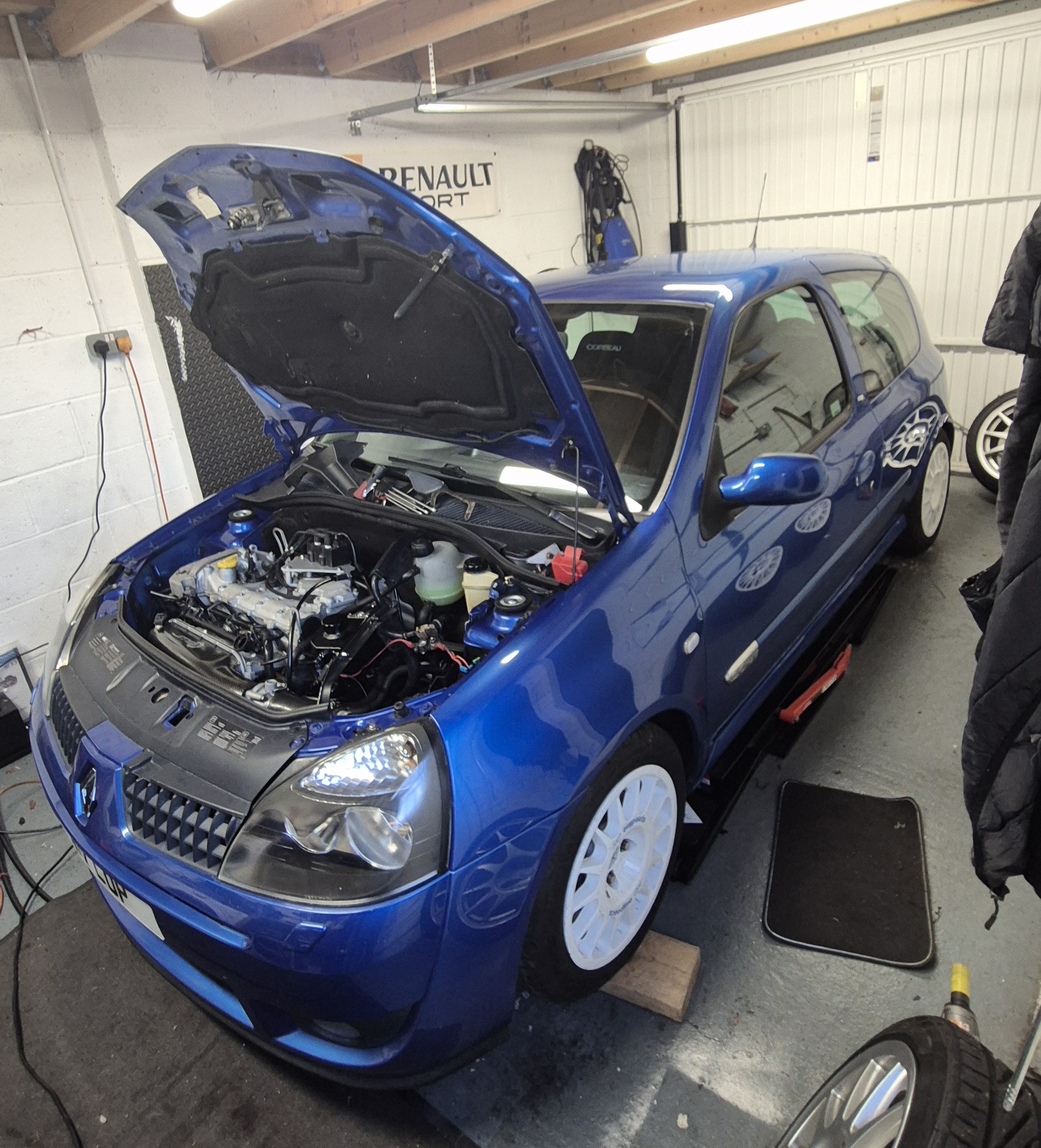

Cam Belt Kit, Keyed Bottom Pulley, 197 cams, 7 degree timing, aux belt, oil + filter, coolant, 182 Manifold, sports CAT and an MOT (no advisories) for good measure.
Phil at the Grange Service Station Cardiff put in a great shift.
I was expecting it to be super hard to drive it home, assuming it would cut out and run rough etc. But it was 'ok', I was expecting much worse.

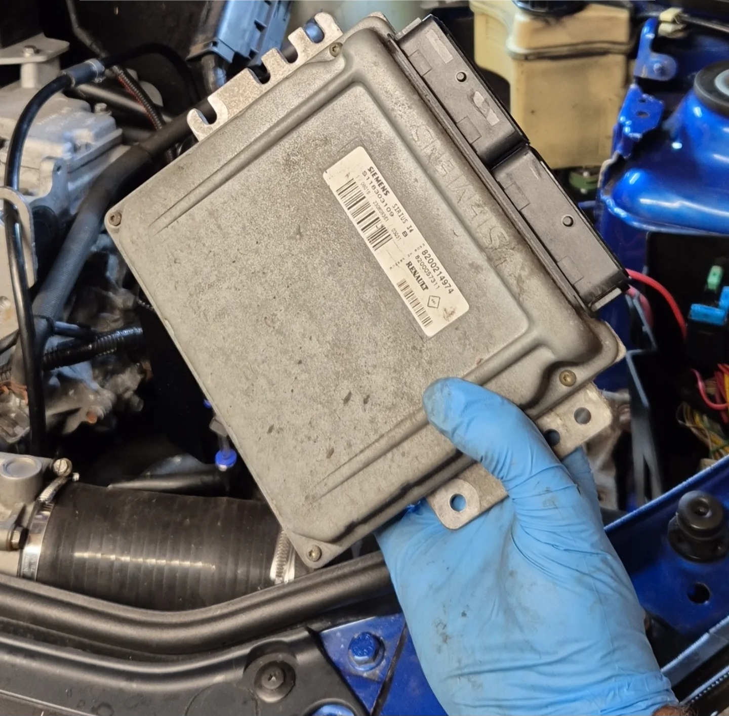

Home now to remove the ECU, get that sent to Engine Dynamics for a base map so I can drive it there for a proper map.
ECU off to Andy at ED.

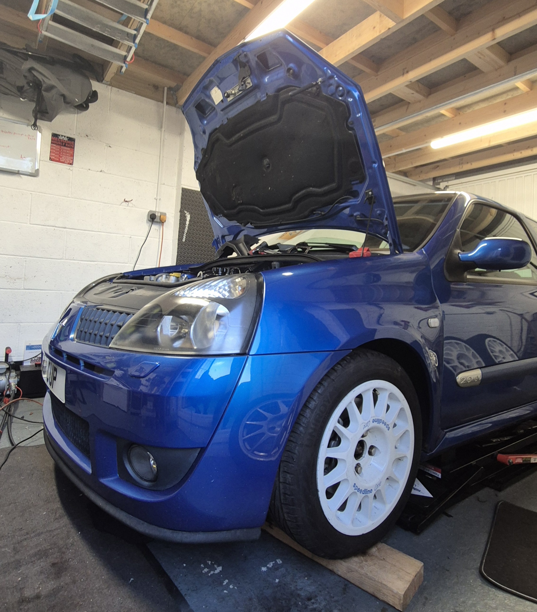

Couldn't help but throw the 2118's on. Because no one has ever seen a Clio with 2118's on.
They won't be staying white. Off for a refurb and a change of colour.

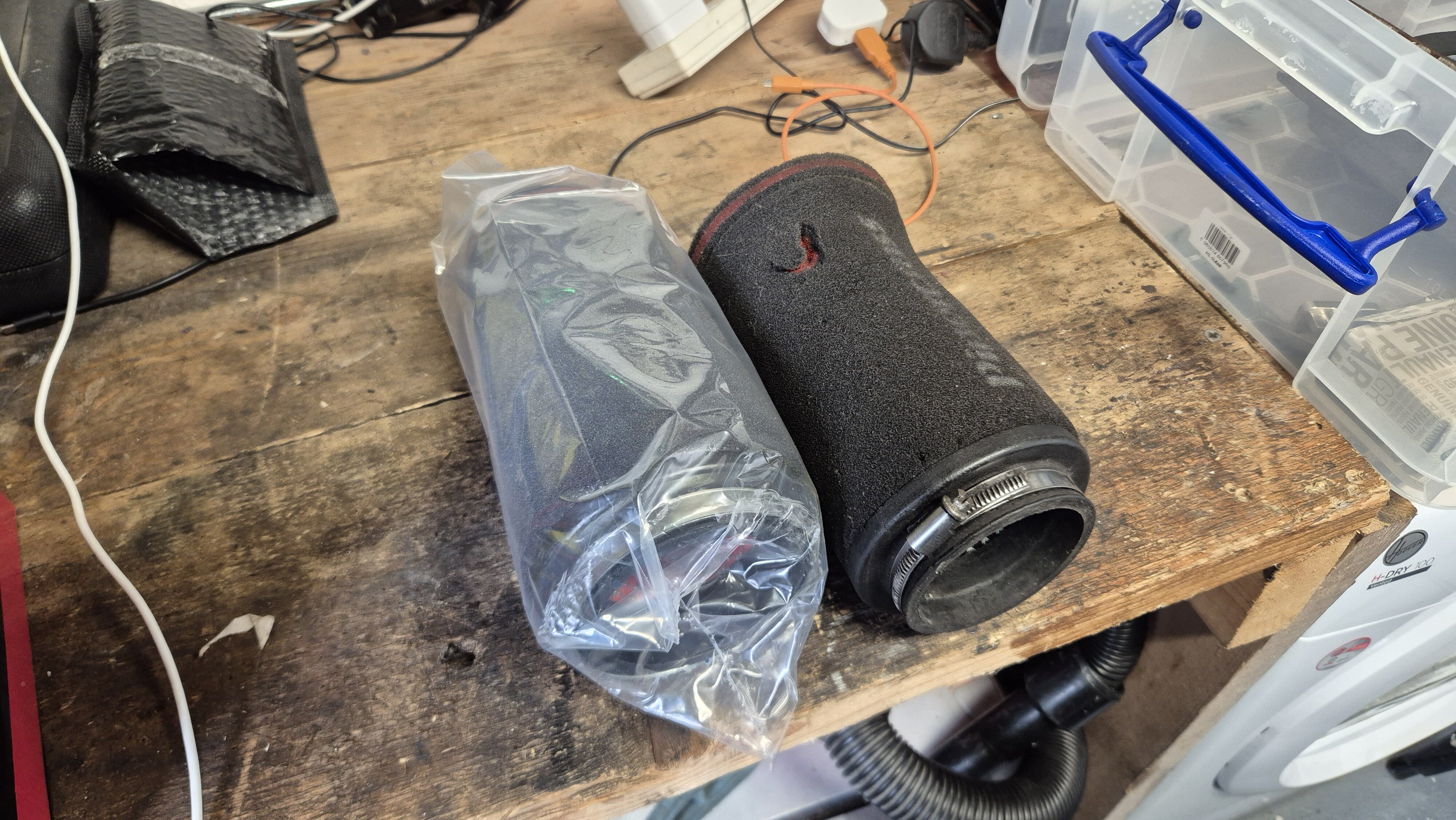

The old airfilter for the RS2 inlet was hanging. So found a similar item.

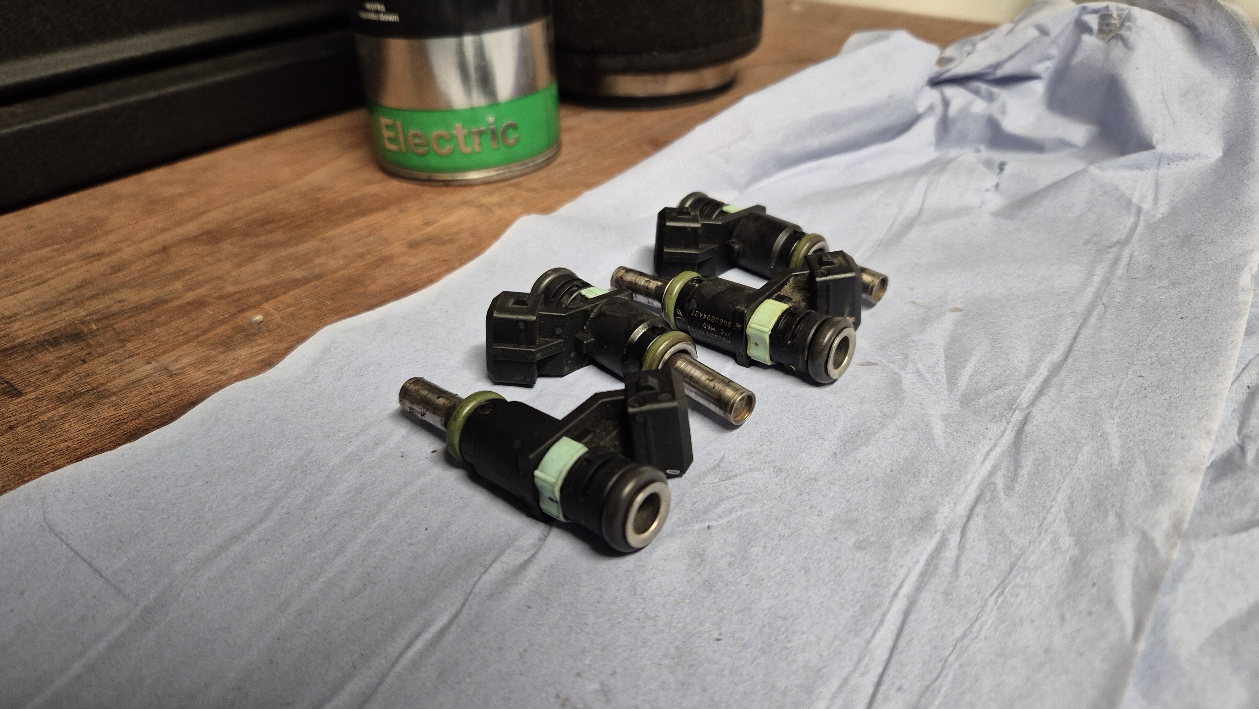

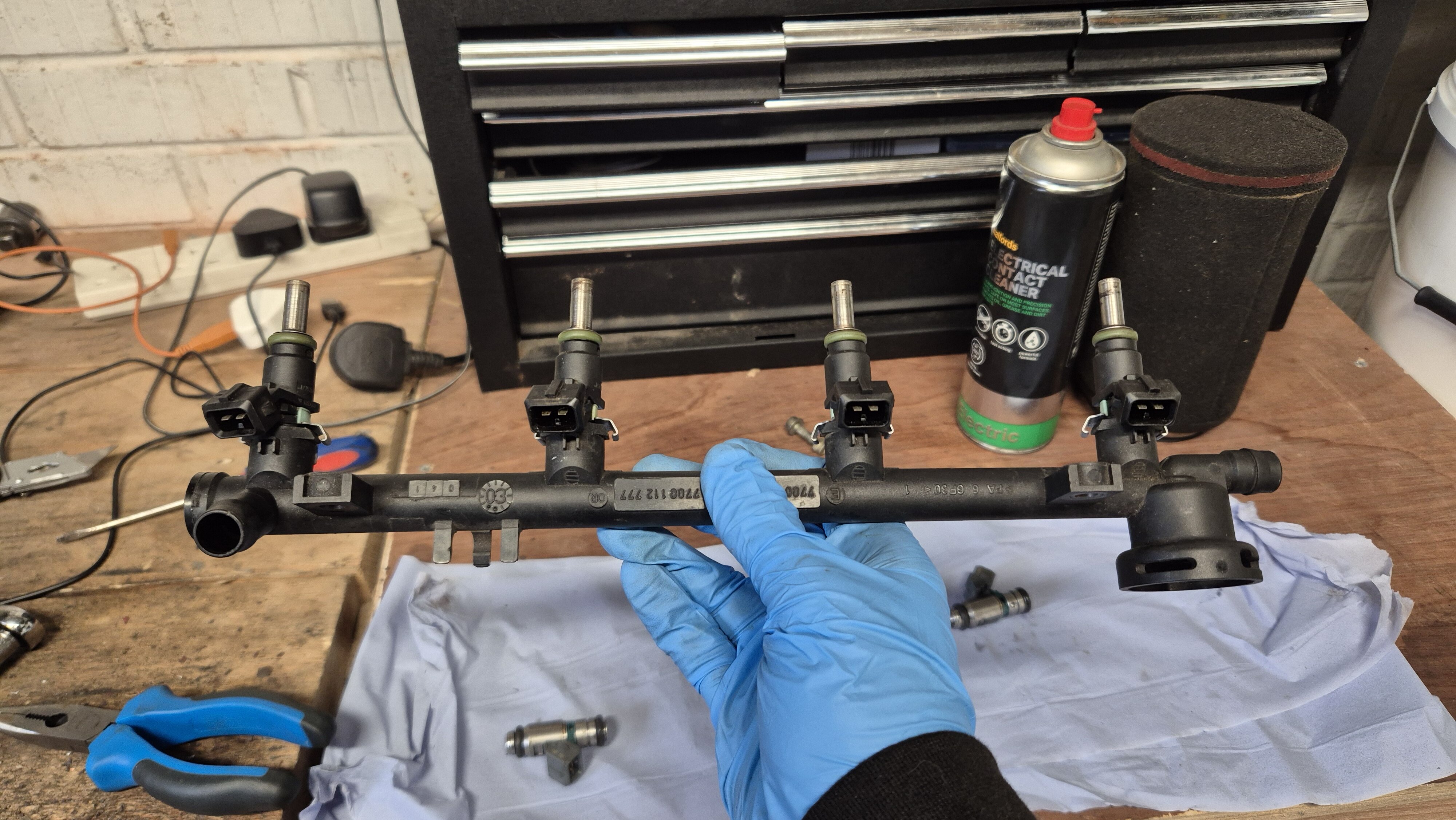

I was speaking to Andy at Engine Dynamics who was uploading a base map to the ECU. Andy knew I was dropping 197 injectors in, however I was planning to drive to ED on standard injectors and a base map. Andy already had a 197 injector map, so suggested I fit them now.
Just waiting on the return of the ECU and I'll fire it up...

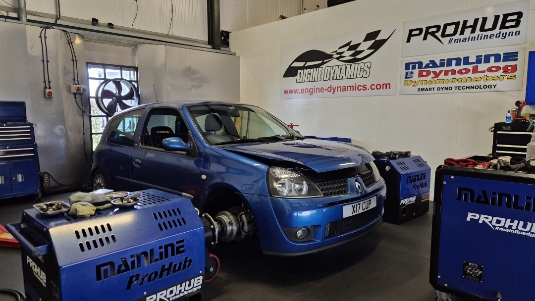

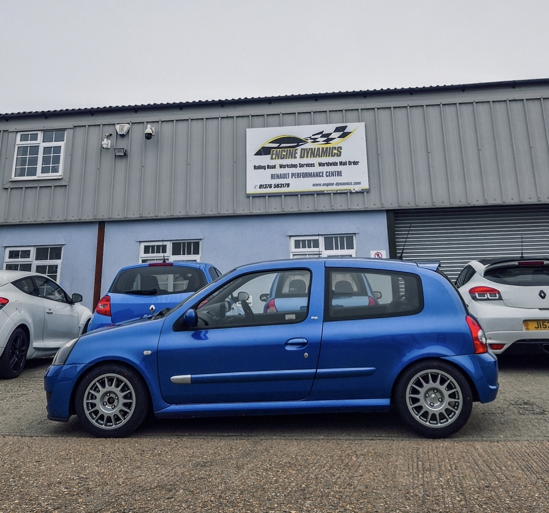

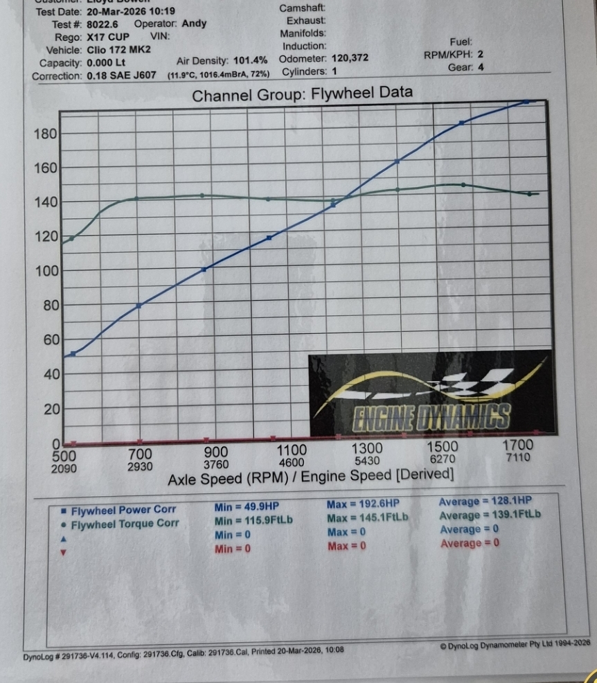

Took the trip to Engine Dynamics yesterday, stayed the night before as it's 4 hours each way and my booking was 9am this morning.
Turned up this morning to be met by Andy who's took me through the mapping process. Very knowledgeable guy and I felt very reassured, even if some of what he said went over my head.
I explained the base map was really good and the car felt really strong.
A few runs and a few tweaks and I left with a healthy 192hp and 145ft.lbs torque.
Andy explained and I could also tell the car sounded really healthy and wanted to continue to rev, but Andy advised limiting the Rev limit to 7400krpm.
The torque was the most noticeable thing to me on the motorway drive home. I've since taken in on a more spirited drive and it's fantastic.
On the long drive to ED and back it's become even more apparent I need a less droney exhaust. Also, you might notice in the photos I had the Speedline 2118s refurbished and fitted.
That map looks perfect - such a linear power delivery.
Are you going to push for more power or happy with it for now?
@bowen86 where did you get the Grp n timing tools from, please? 🙏
Or rather, how did you get the 7 degrees set locally? Currently building an engine and will be fitting 197 cams etc etc.

Yeah, really pleased with it.
No more power. I just wanted to get the best out of the current hardware, I also don't want to start chasing a number. Next is some maintenance, some bushes and quality of life stuff.

Are we local? I have a 7 degree timing bar you can borrow.
I believe we are buddy. I’m just outside of Swansea. 🙌🏻

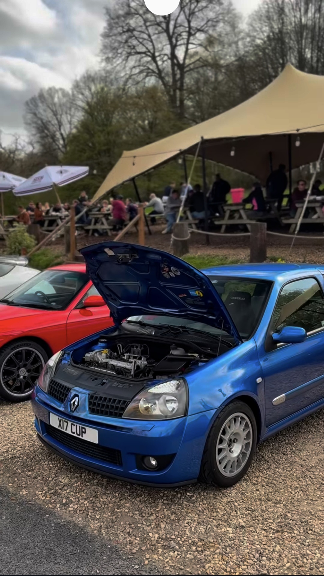

Took a trip to Caffeine and Machine for the Renault Sport day.
Was a decent day with good weather.
On the way up I heard the "ting, ting, ting" sound of a bolt flying off and then and then an even louder exhaust. Yep, lost a Cat to Cat back bolt. My ears bled when I got home.
Screen grab from someone's video on Instagram.
The RS2 inlet got some attention

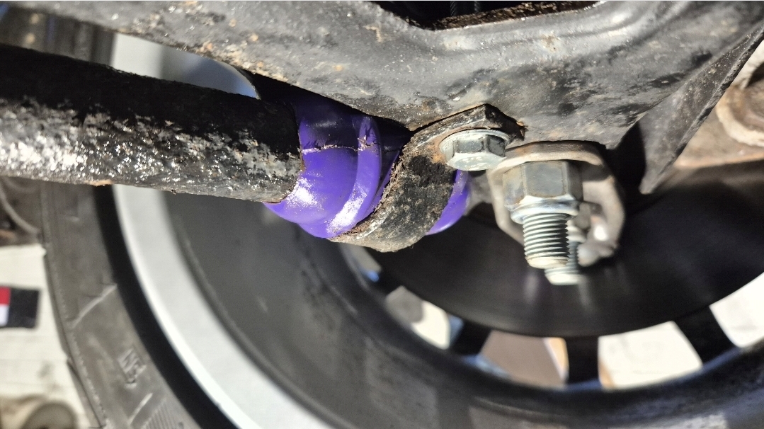

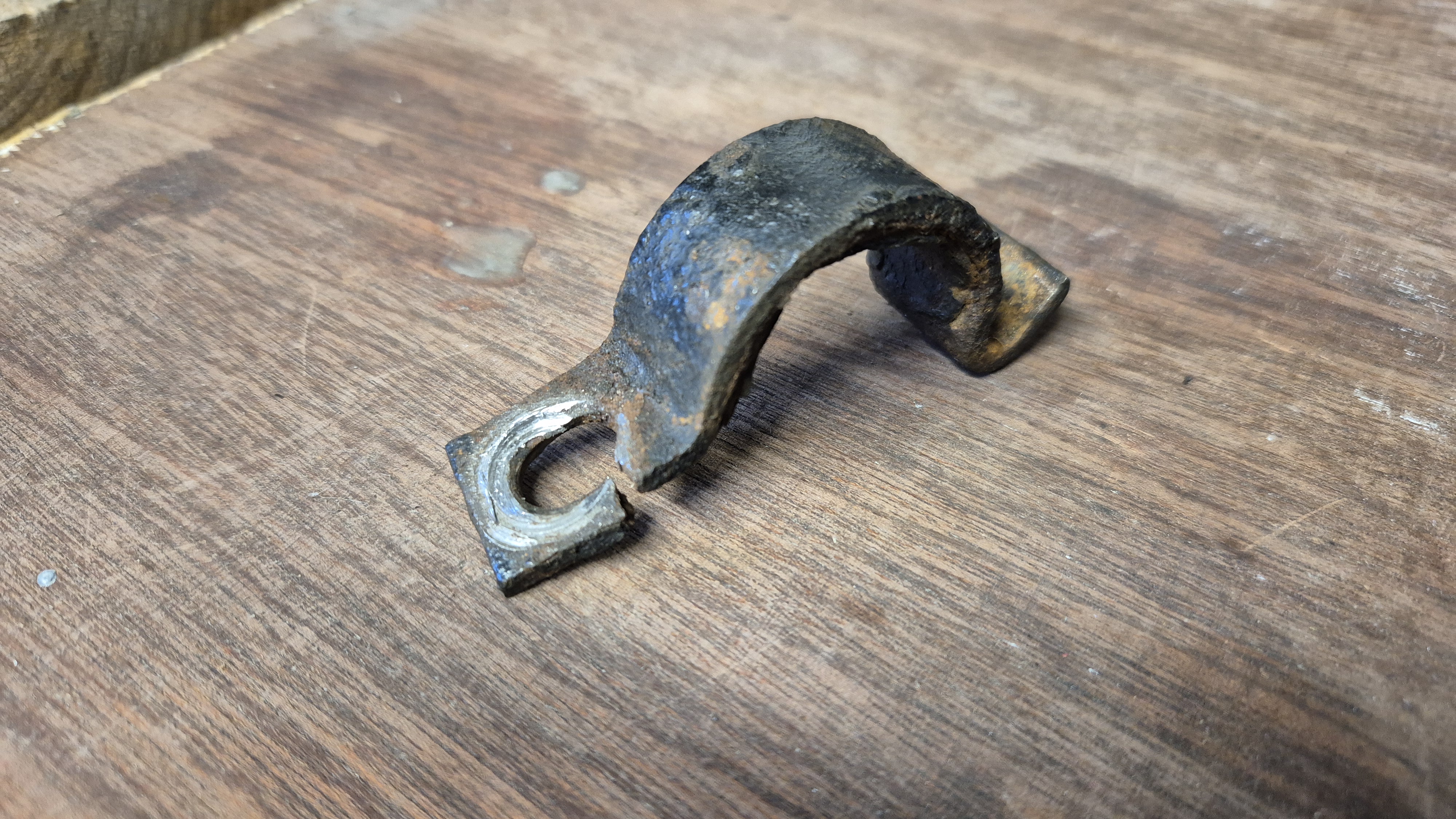

Had a few days off over half term and did one of the (many) small jobs I'd been meaning to get around to....outer ARB bushes.
Safe to say they needed doing.
Also one bracket was broken so ordered a new one from RPD.
And fitted (this is the side where the bracket didn't break)
I have the inner ARB bushes but after I read on here that they are an arse to do, I've decided I'll pay a man.

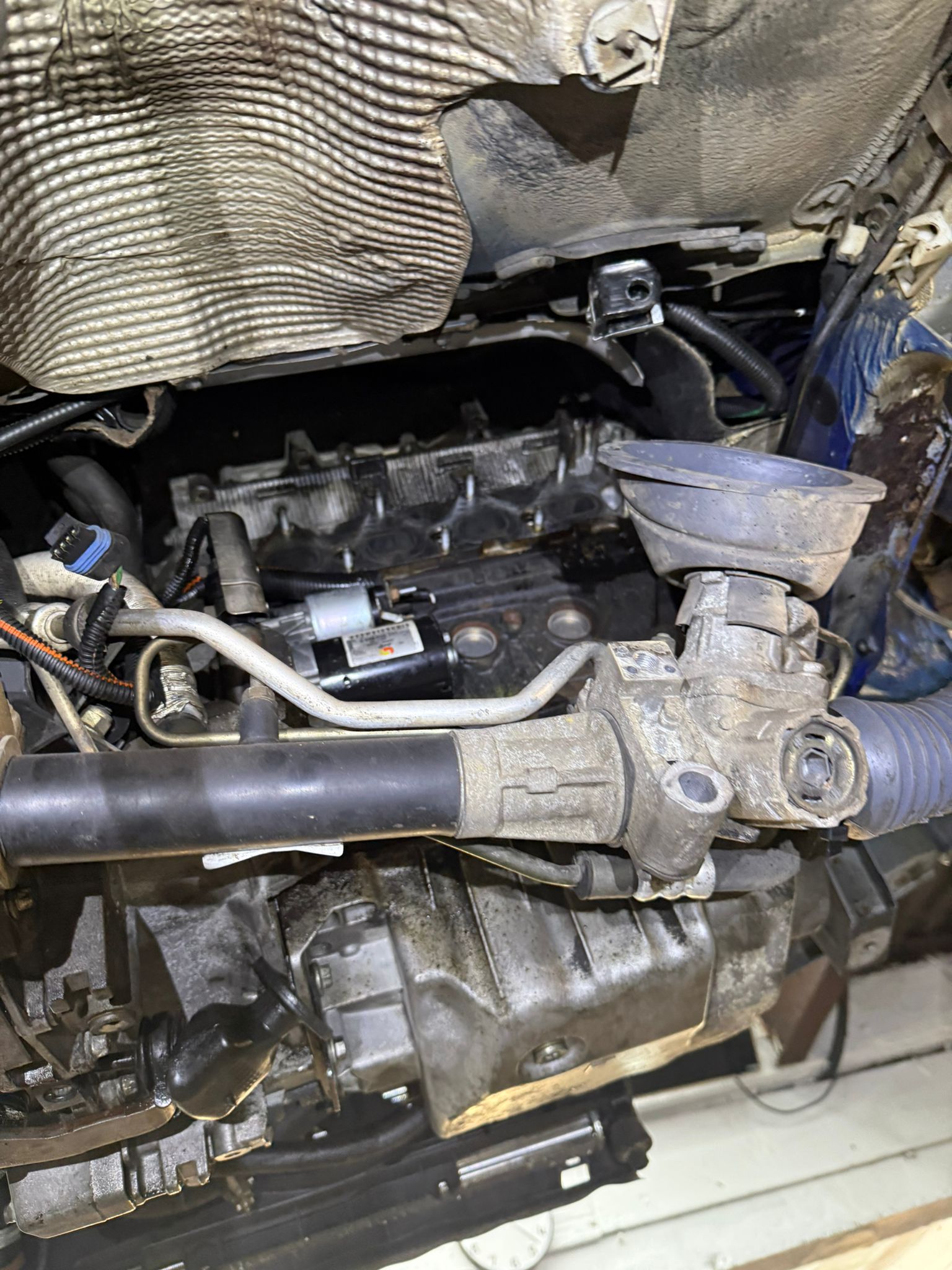

Next? Well, this may seem sacrilegious but I'm going EPAS. I had it before on my RB 182 and really rated it. It's one less fluid and it's one less drain on the engine.
