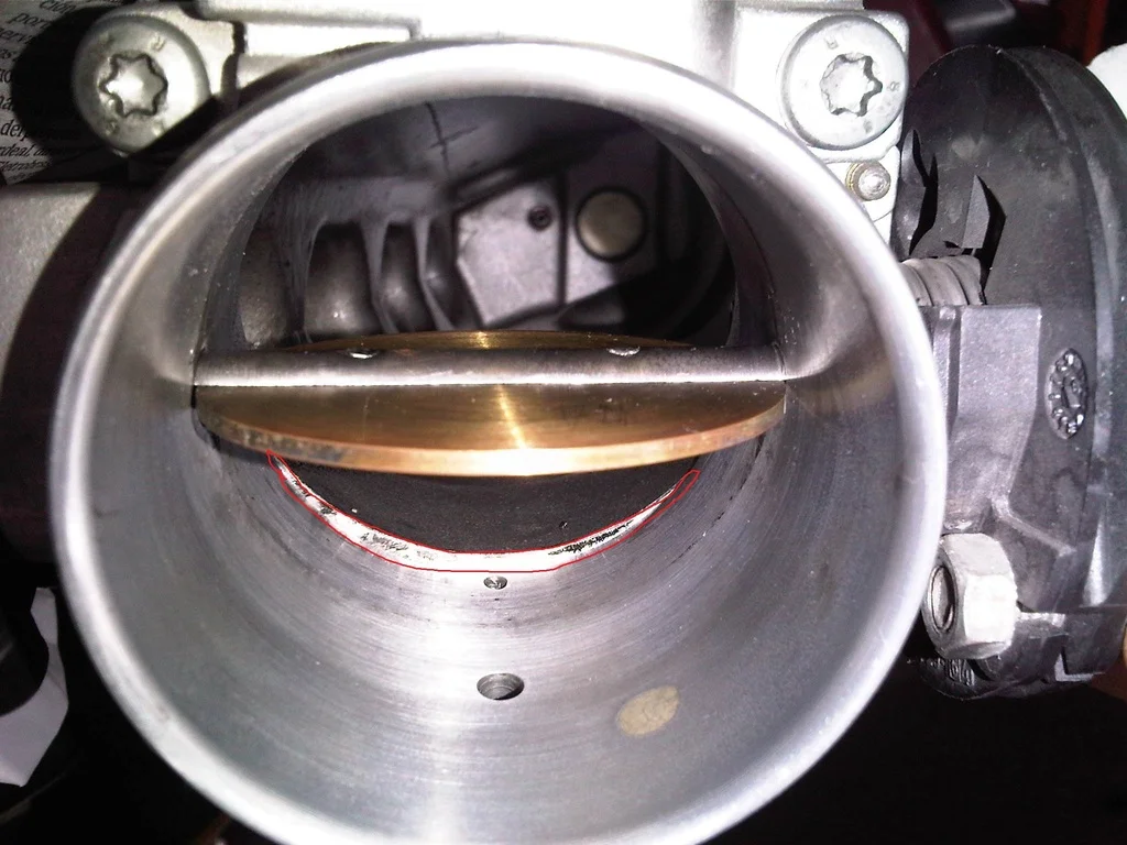

here is a project about my old throttle body it was bad in idle and sticky. previously i fixed it and polished it also ported inside of it
the last job is disassemble it machine the whole throttle body and make a larger flap
the tb is ready to use i will polish it in a few days like a mirror

I'm going to be honest, I think you've kind of ruined your light throttle control. The shape of the housing is such that only one side opens up at light throttle, giving nice fine light throttle. With boring it out you've turned it into an on/off switch. It wont lose you anything big, but will be much more likely to kangaroo
I did it im my sport. 2,3mm same! more will be dangerous to break the TB.

You must polish the Manifold also. Because thats the problem.
You increase the diameter but.. you still having same diameter on the Manifold.. so you can polish that with dremel yo remove the little wall of alluminium. that appear in the picture.

yes you are true it also needs to port the manifold entry
also there wont be a problem for light tb control
i made an megane 225 tb last day and it works fine
