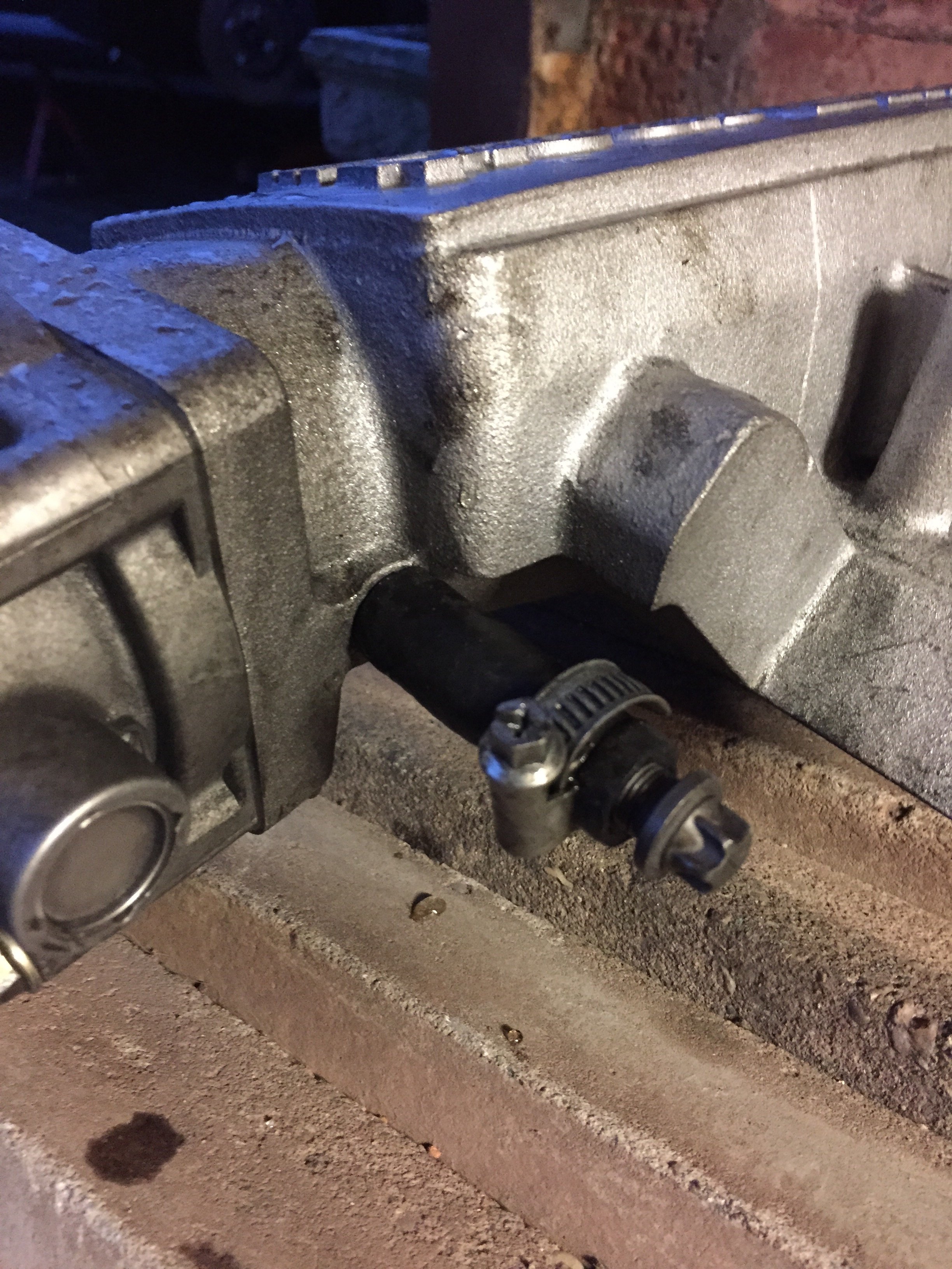

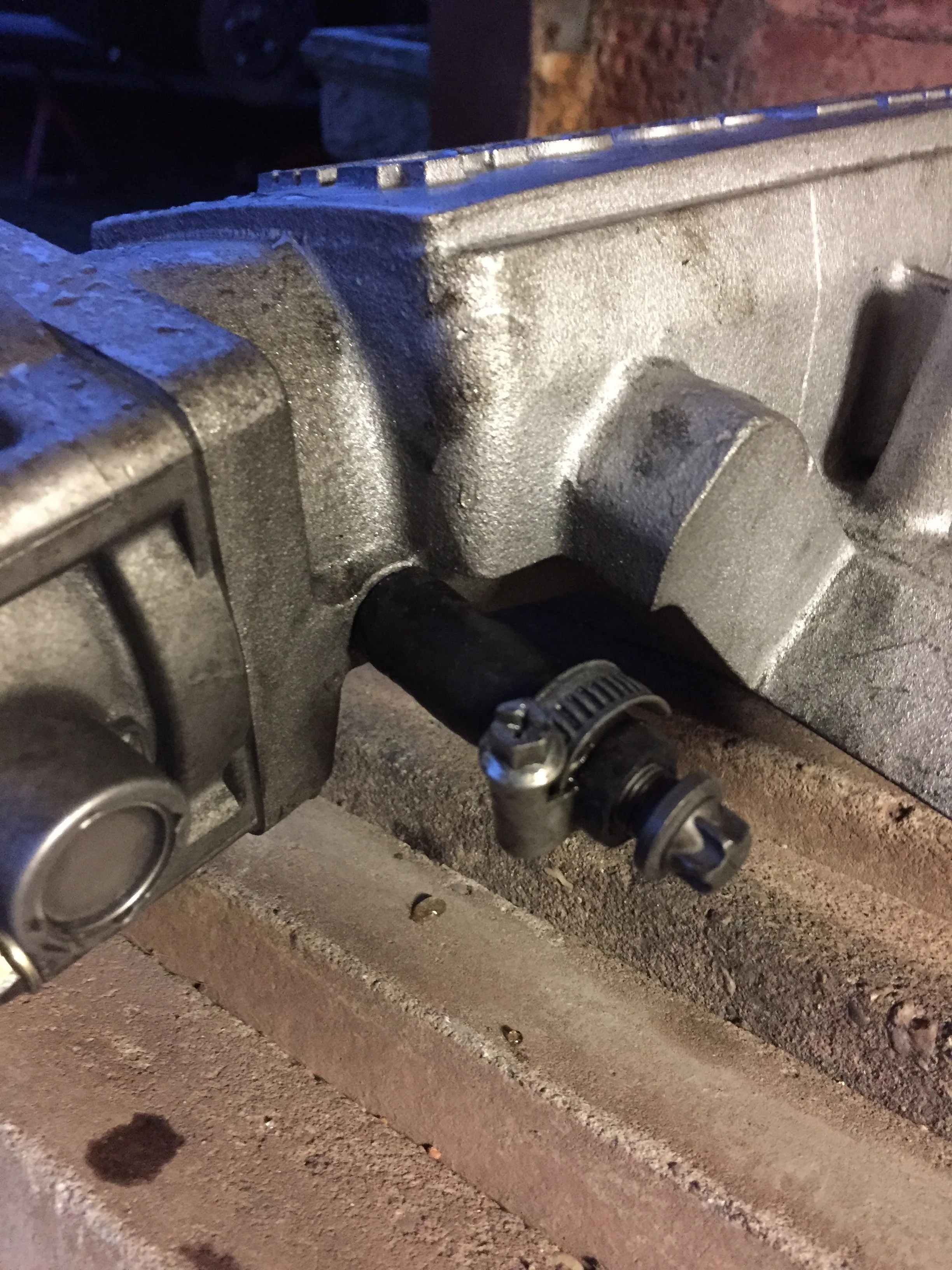

Well i had a quick look tonight and within a couple of minutes, found this that i think the bolt has gone walkies that was blocking it off. Also the clip was loosr
So i plopped a new bolt in and tightened it up

Well guys thank you very much car is now sorted :) the one to the left on the breather on the rocker was open, blocked that up :) and the 1 by the throttle body, no idles and drives spot on few more things to do, got to sort a build thread out
