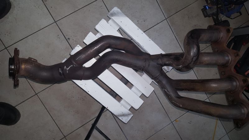

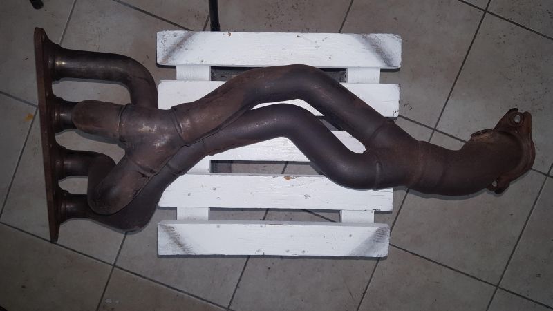

Found a 4-2-1 manifold on a ebay auction and get it for around 70 pounds.

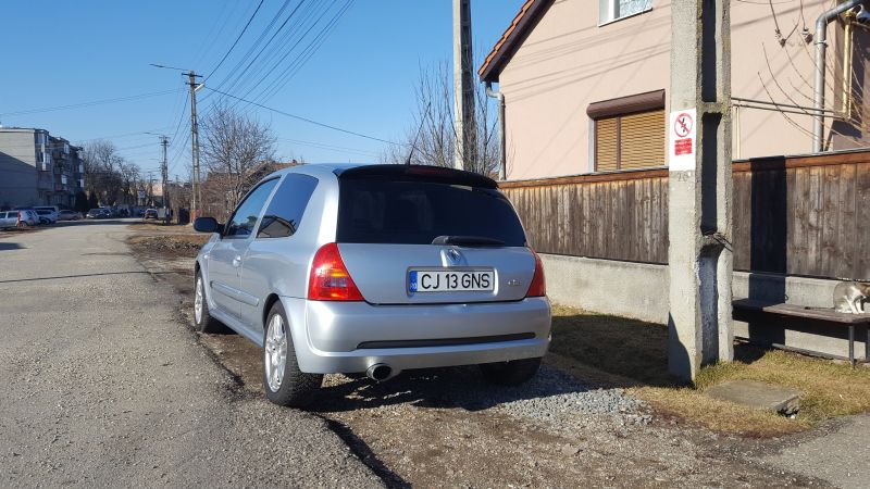

I really like the old style tails, there are not many ph2 clios that have fitted this.
I hope this month could install the new manifold with a stainless steel custom 2.5" pipe line.

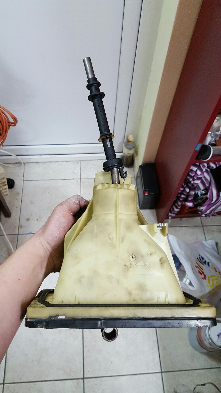

Managed to get a scenic shifter for 20 pounds, bend the rod and add the yanoo 3.0 kit. I cut around 1" and 1/2 from the rod and plastic reverse tube. Now it have to be a little taller than stock but also shorter distance to gear changes.
Next month I will put this on the car and also a "new" gearbox from a 182 Clio and hope with this solve the synchro problems.

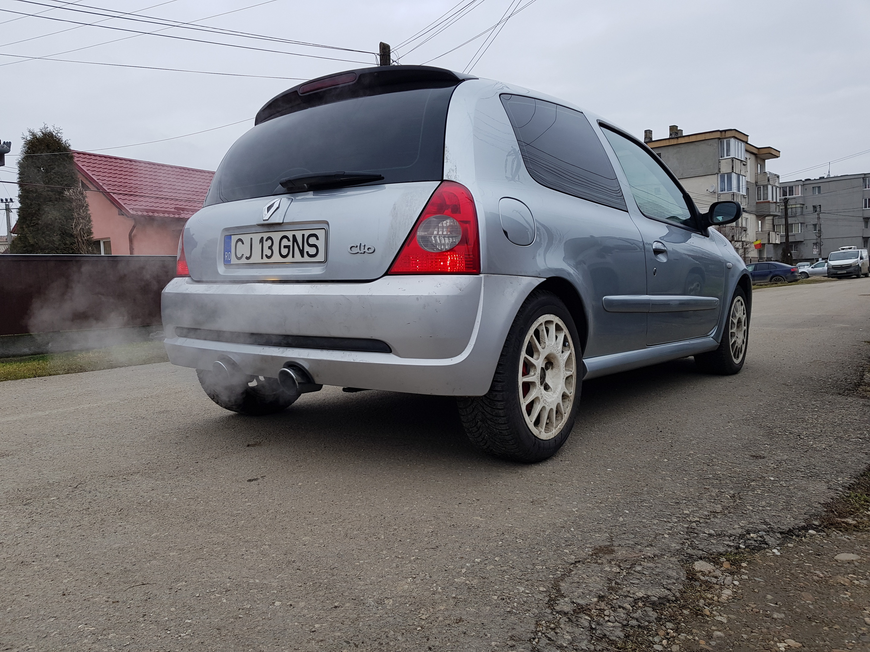

I've just replace the gearbox, both driveshafts and full 2.5" exhaust with 182manifold.

I've installed the Yanoo kit with the scenic shifter. A big difference tbh and really like it. I save money for a rebuild gearbox because of the increase rev limit and the scenic shifter the synchros hates me :)), 3rd one is gone.

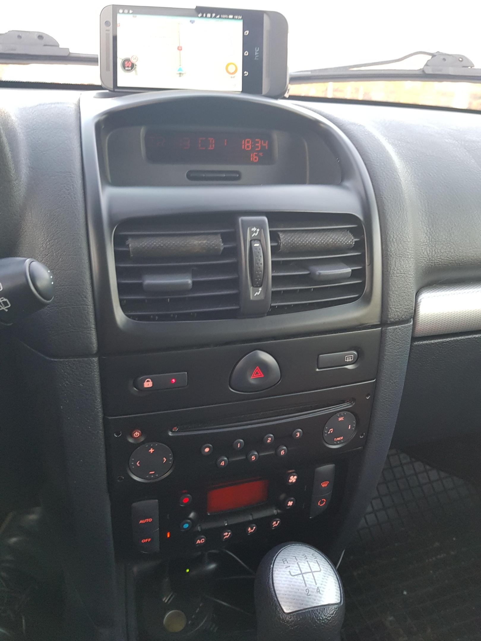

...and some interior parts painted
...and added a custom holder for phone, it is integrated in the dash and has charging cable always plugged in.

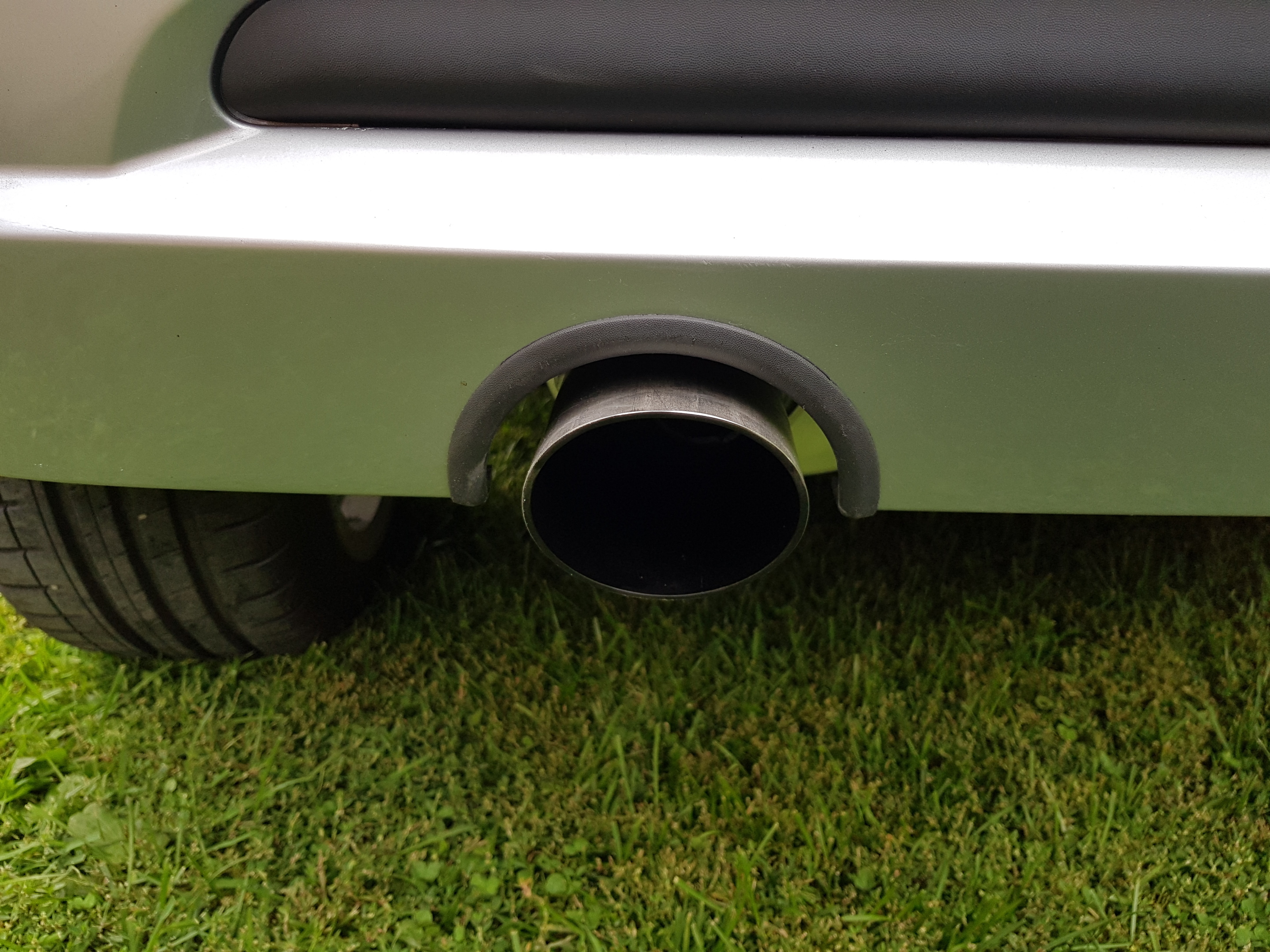

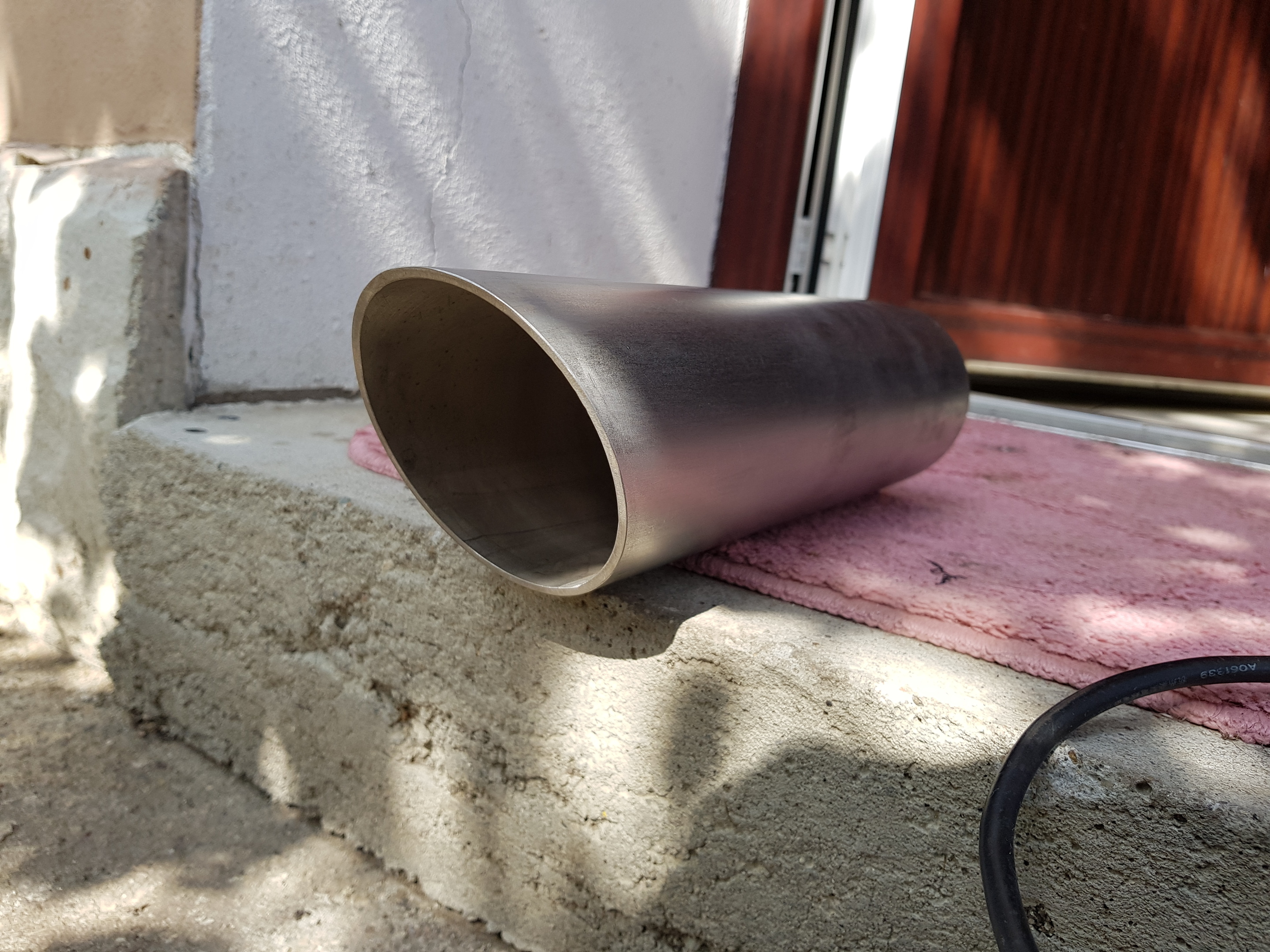

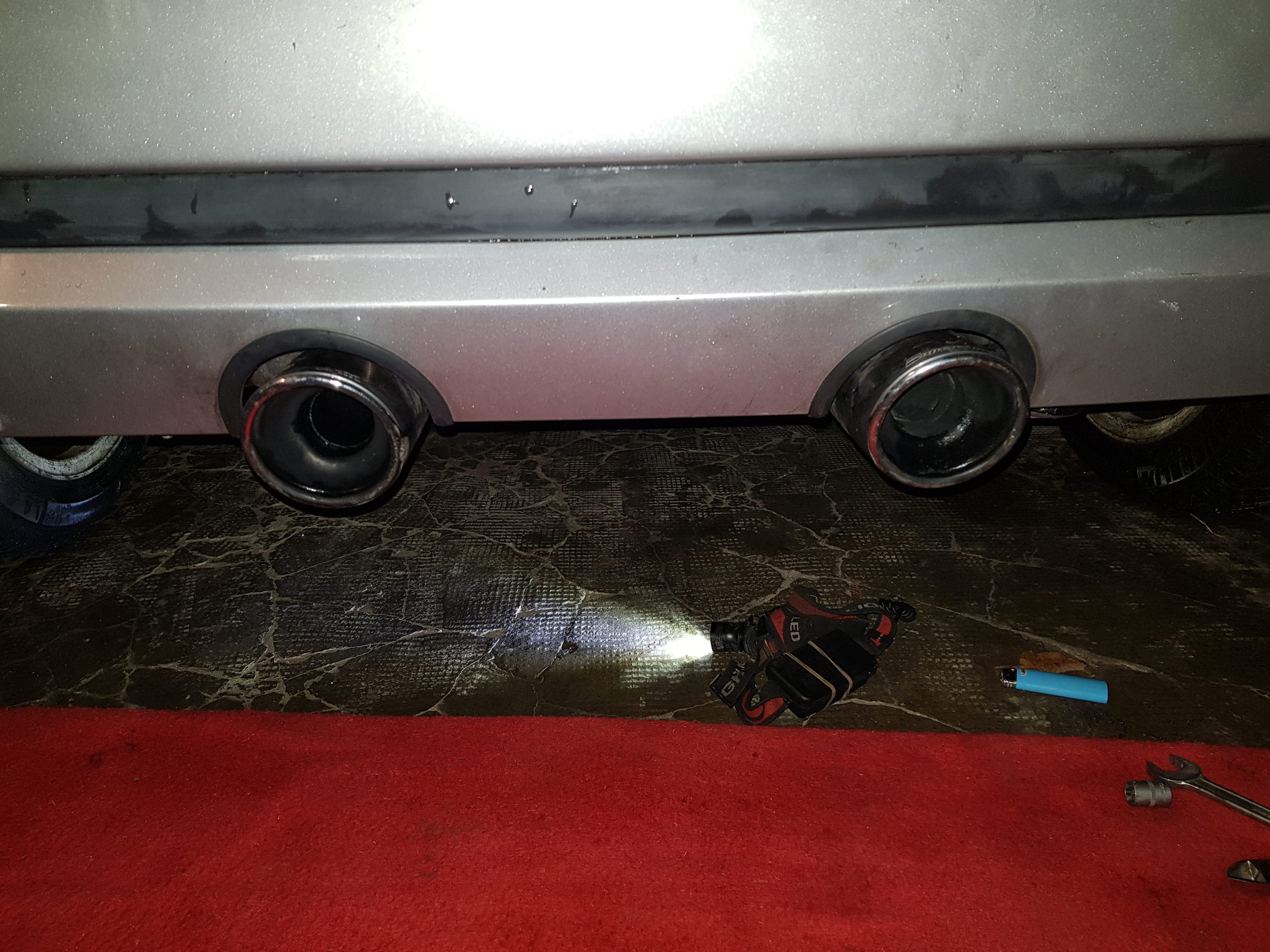

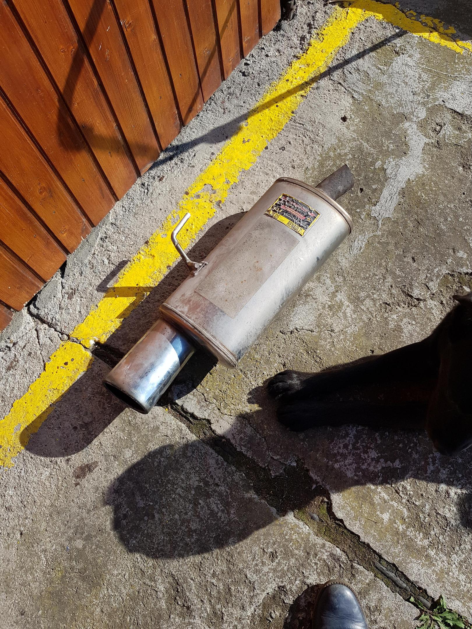

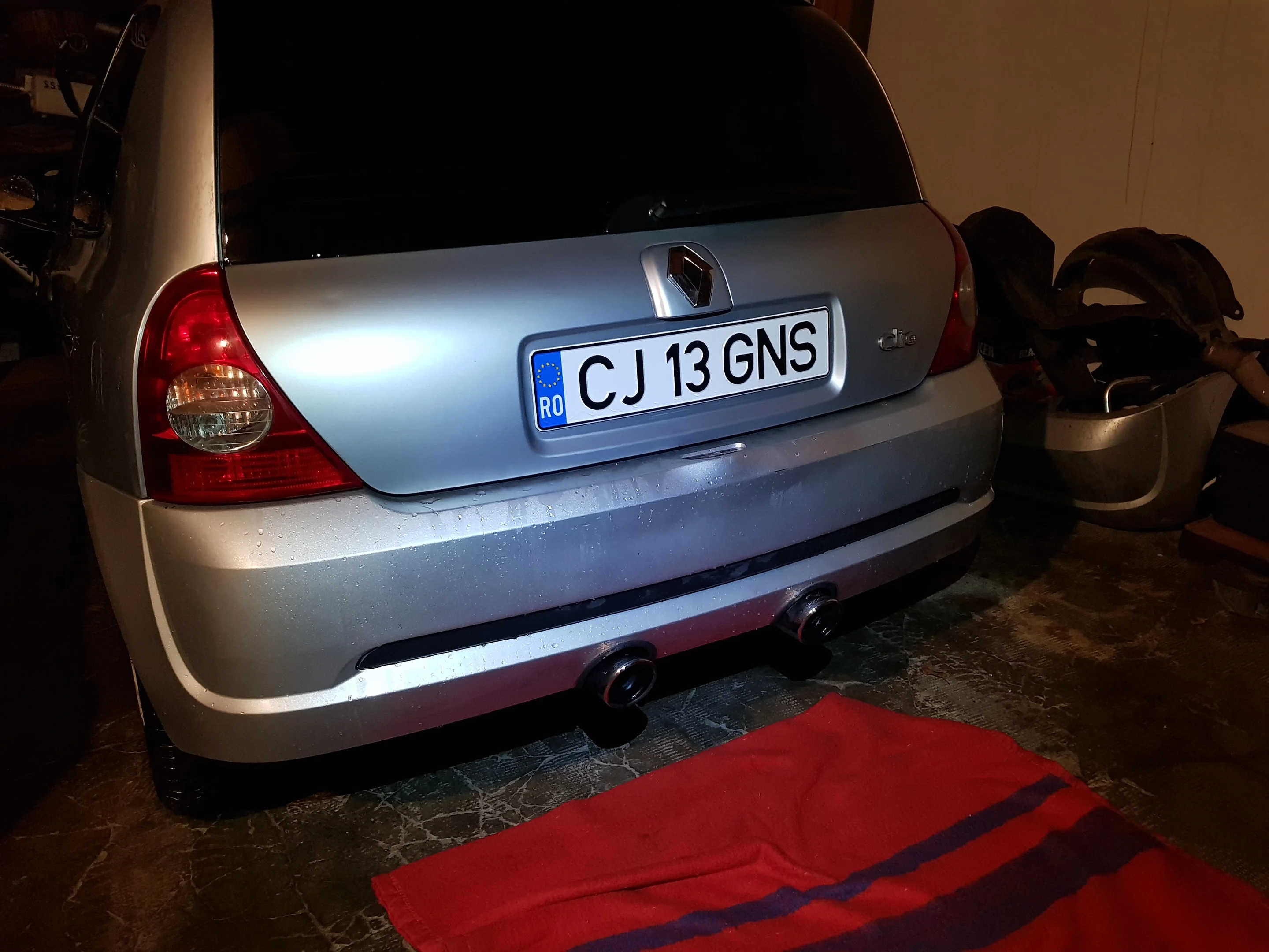

I get a SuperSprint 172 exhaust, the one with the visible tip. I did not like it and made my own tip from a stainless still pipe. I buy the gasket kit for the Renault and start bend the pipe and make a full stainless still exhaust line.

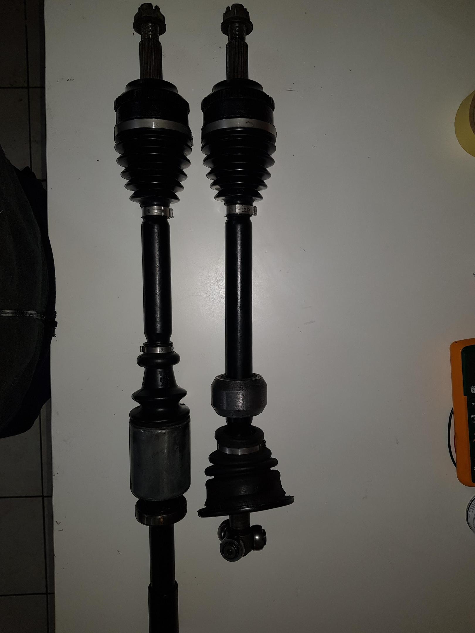

And install another left driveshaft. I get the right one from here and now the left one. They are in a great shape and change both of them.

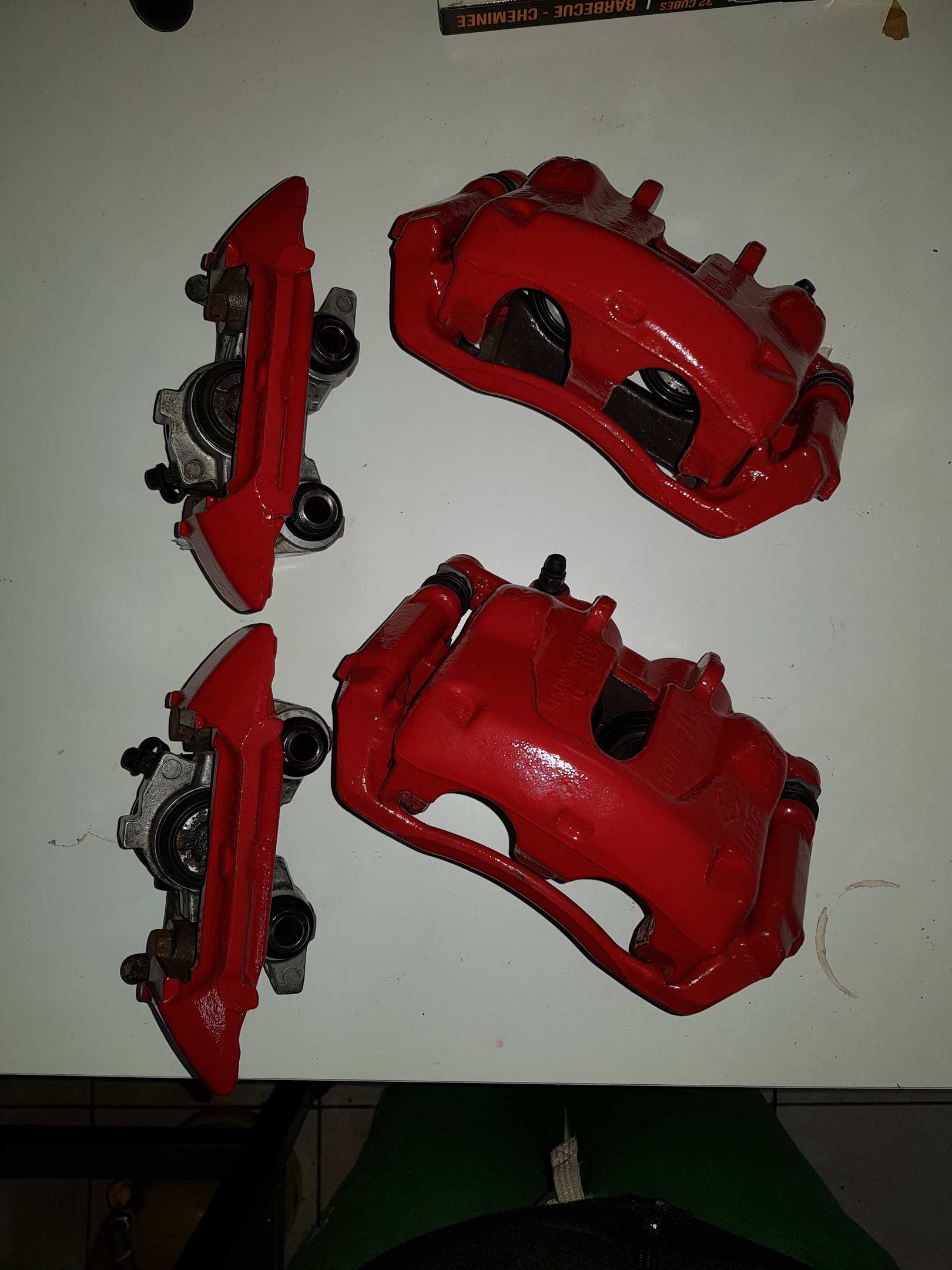

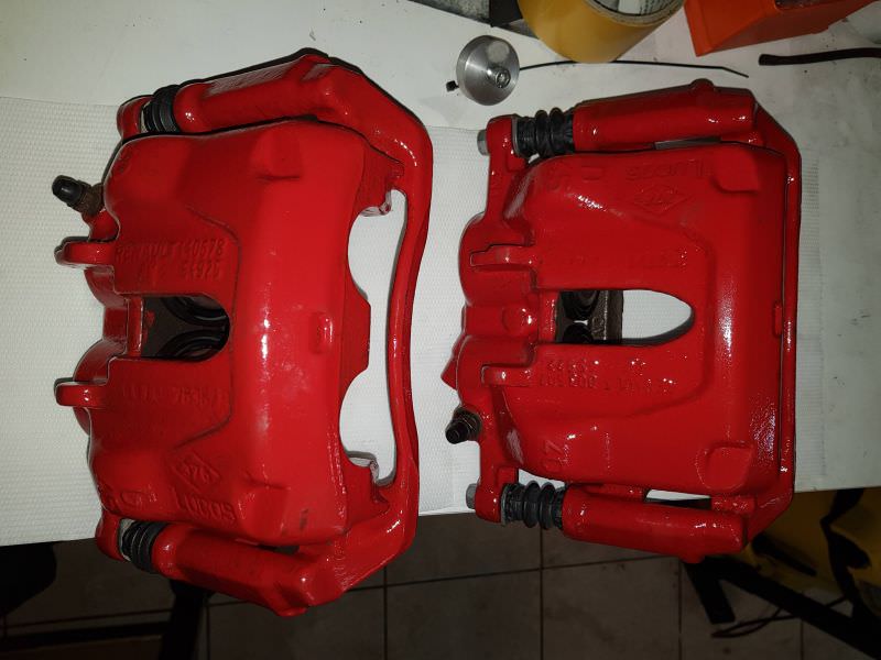

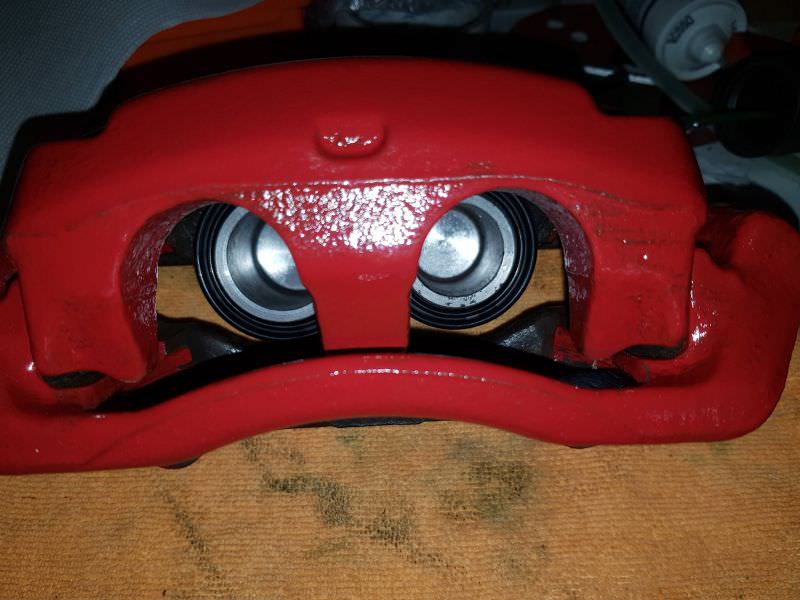

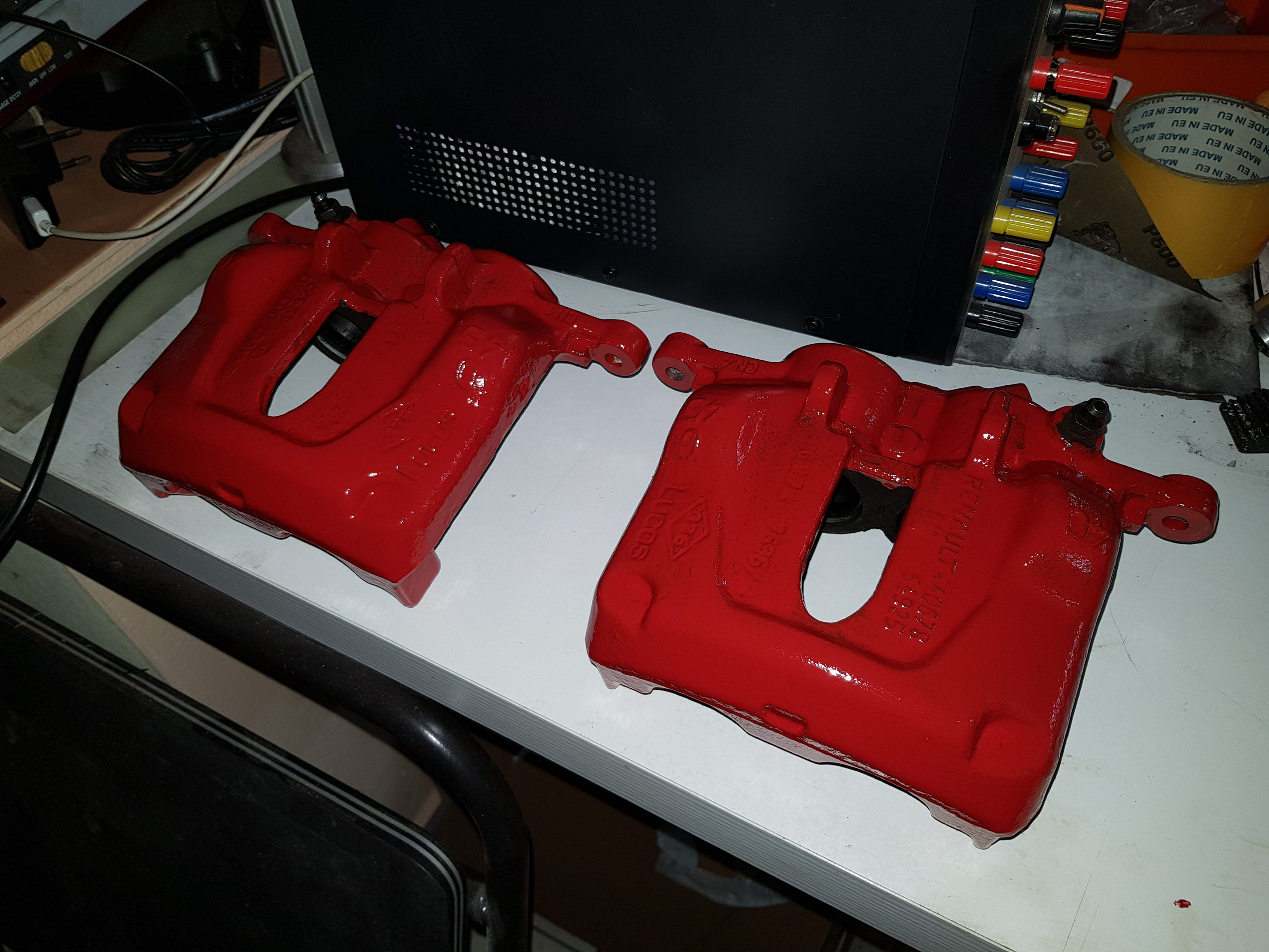

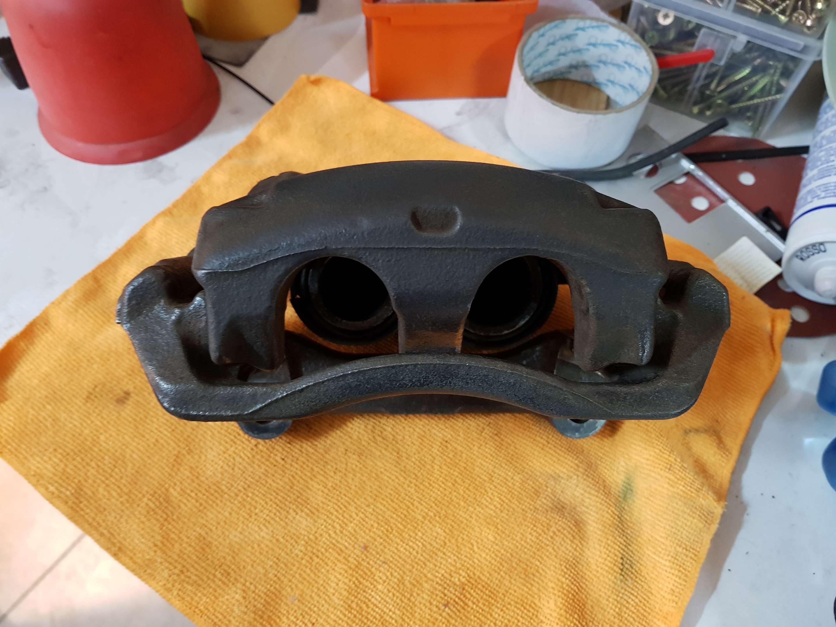

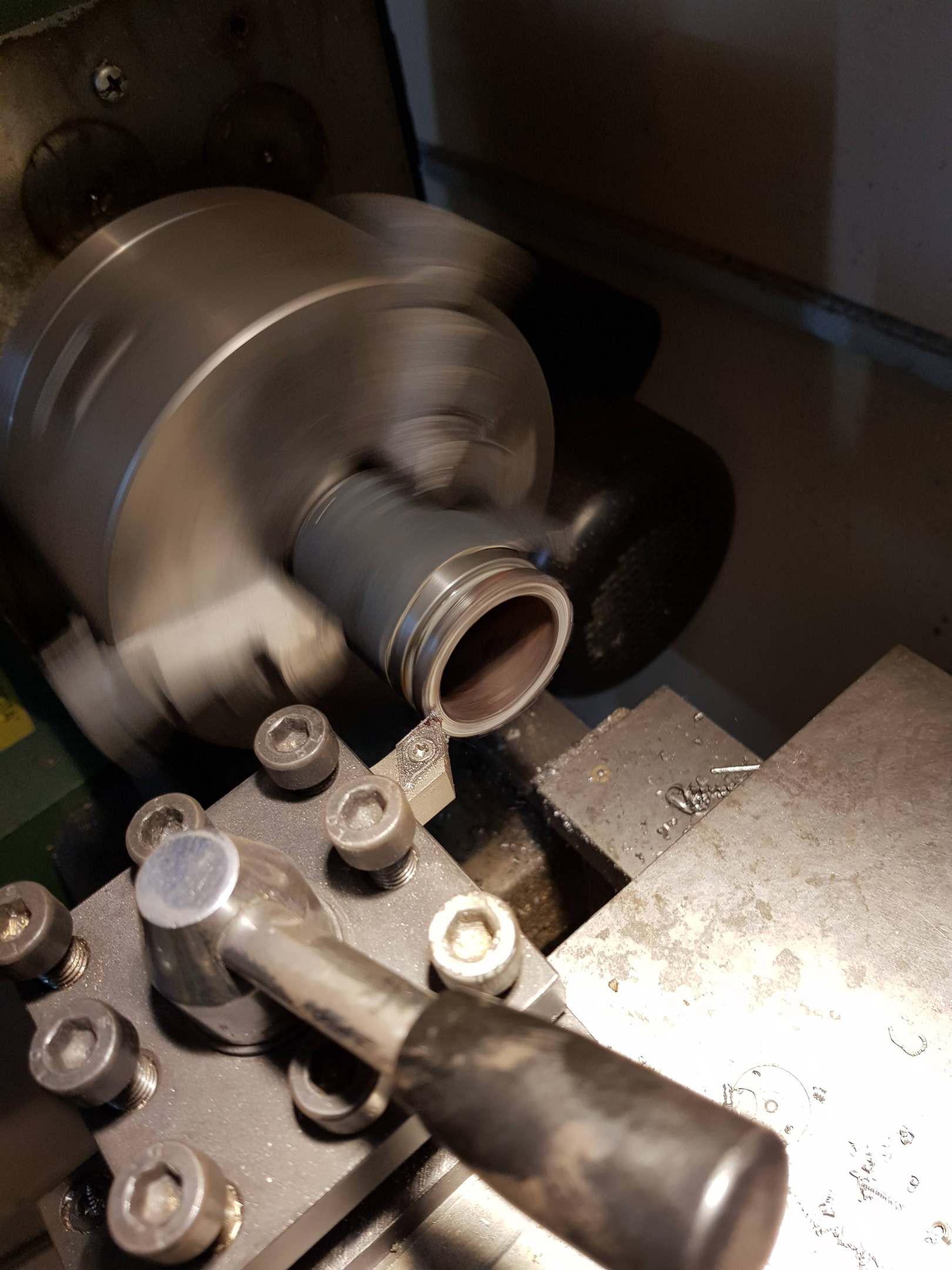

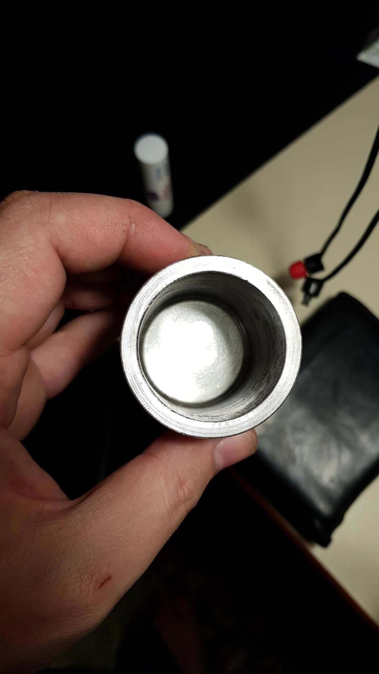

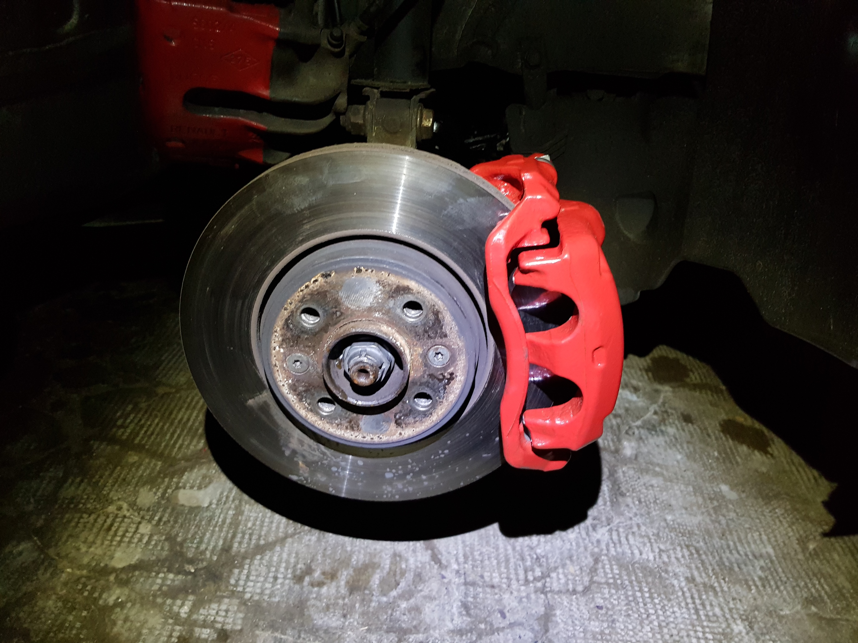

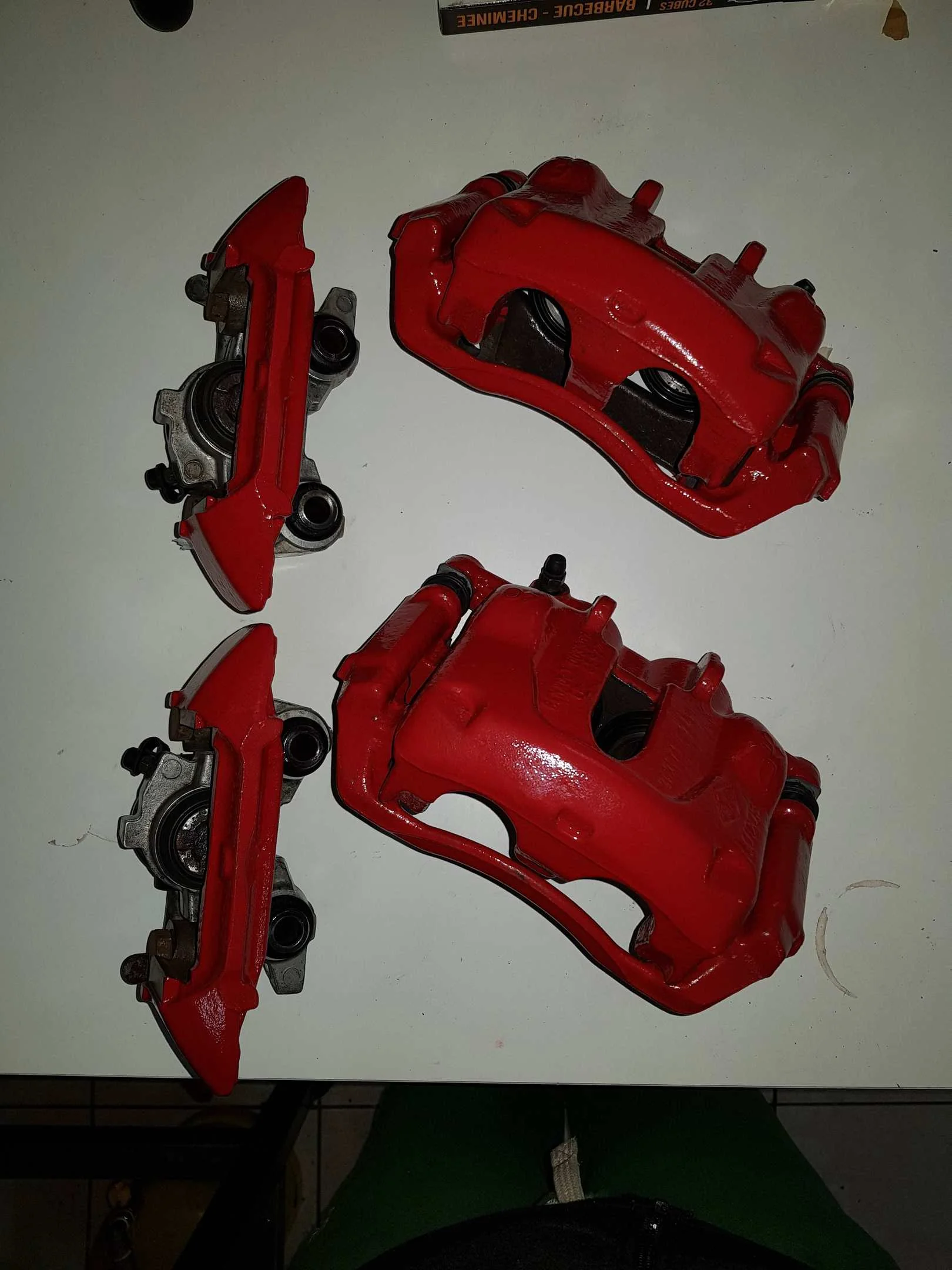

Because I want to put some bigger brakes on my Clio just to look a littler better, here are my new calipers and some rebuild of the pistons.
Because the piston were in perfect shape, except the pad contact, I reuse them.
Will fit with 300mm discs. The rear setup will remain the same, just rebuild the calipers.

Thanks mate! This conversion is plug&play, this was the only reason I buy the calipers instead of big 4 pot ones. And with spacers I could fit them under 15".

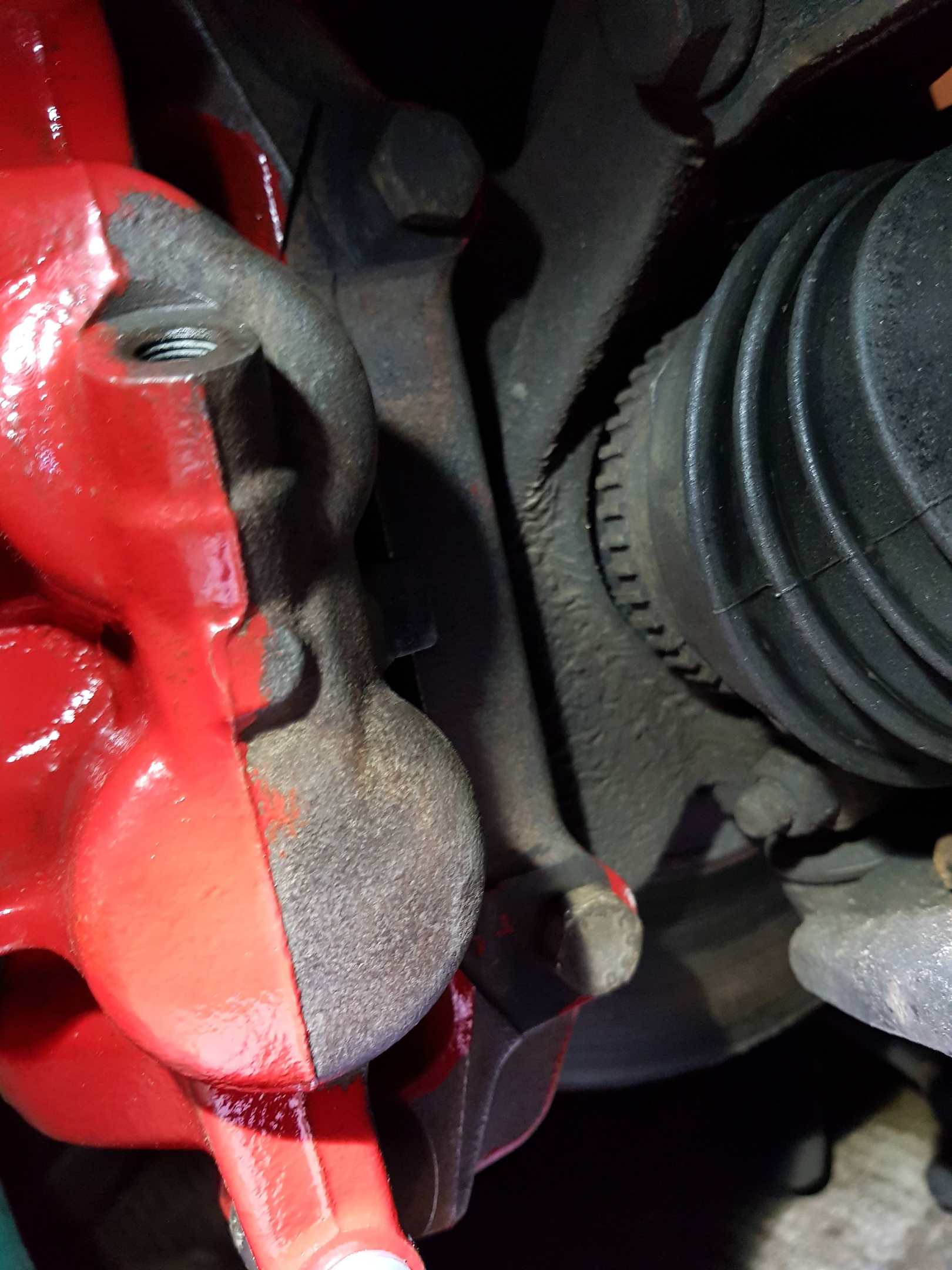

First layer of paint, another one and good to go. I bought new seals and pins and rebuild them this week completely.
Plug and play as in you can just bolt them up without any brakets? What did these calipers come off of? Never seen these...
Is there a big difference? What pads do they take?

@hostler
Yes, they are plug and play without any brakets, they are bold on to the stock oem hub, just replace the 280mm disc with the scenic 300x24mm one. I did not know about pads, but because this is not a race car, just a weekend car, the pads will be some normal Ate or Ferodo, because I did not think I could find some performance pads. As I said before, I want this conversion for look. I am also pleased with the oem brakes with standard pads. Maybe with this upgrade I will have a little more power.
After I will try and fit them on the car and be sure that everything works great, I will reply with the part numbers.

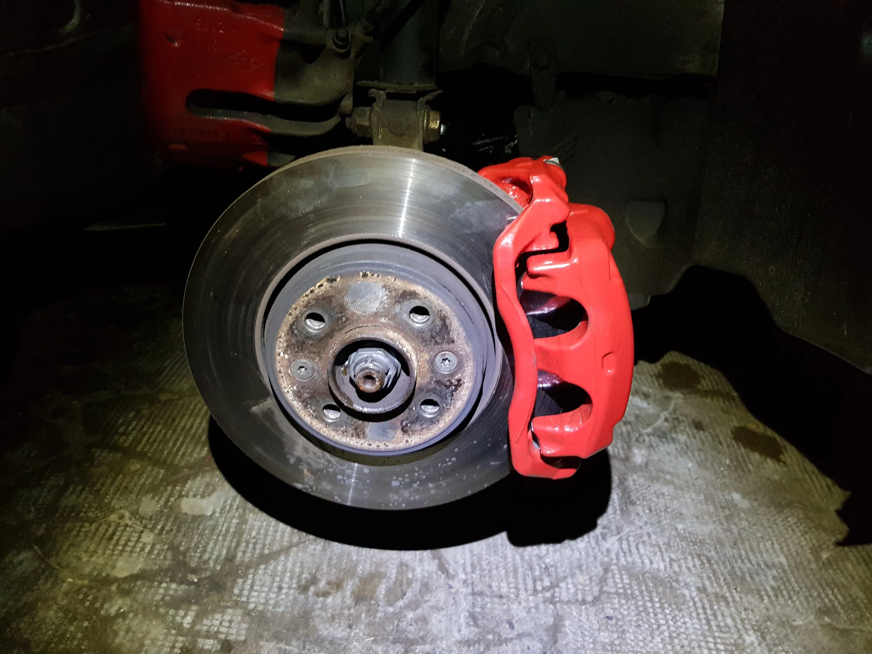

Test fit, the mounts are the same.
The 300mm discs will be just perfect. New pads and ready to go. I will need spacers to run them on 15", but it is possible.

Rebuild all the calipers with new seals and fresh paint. I will need new rotors for the big brake conversion and done with it.

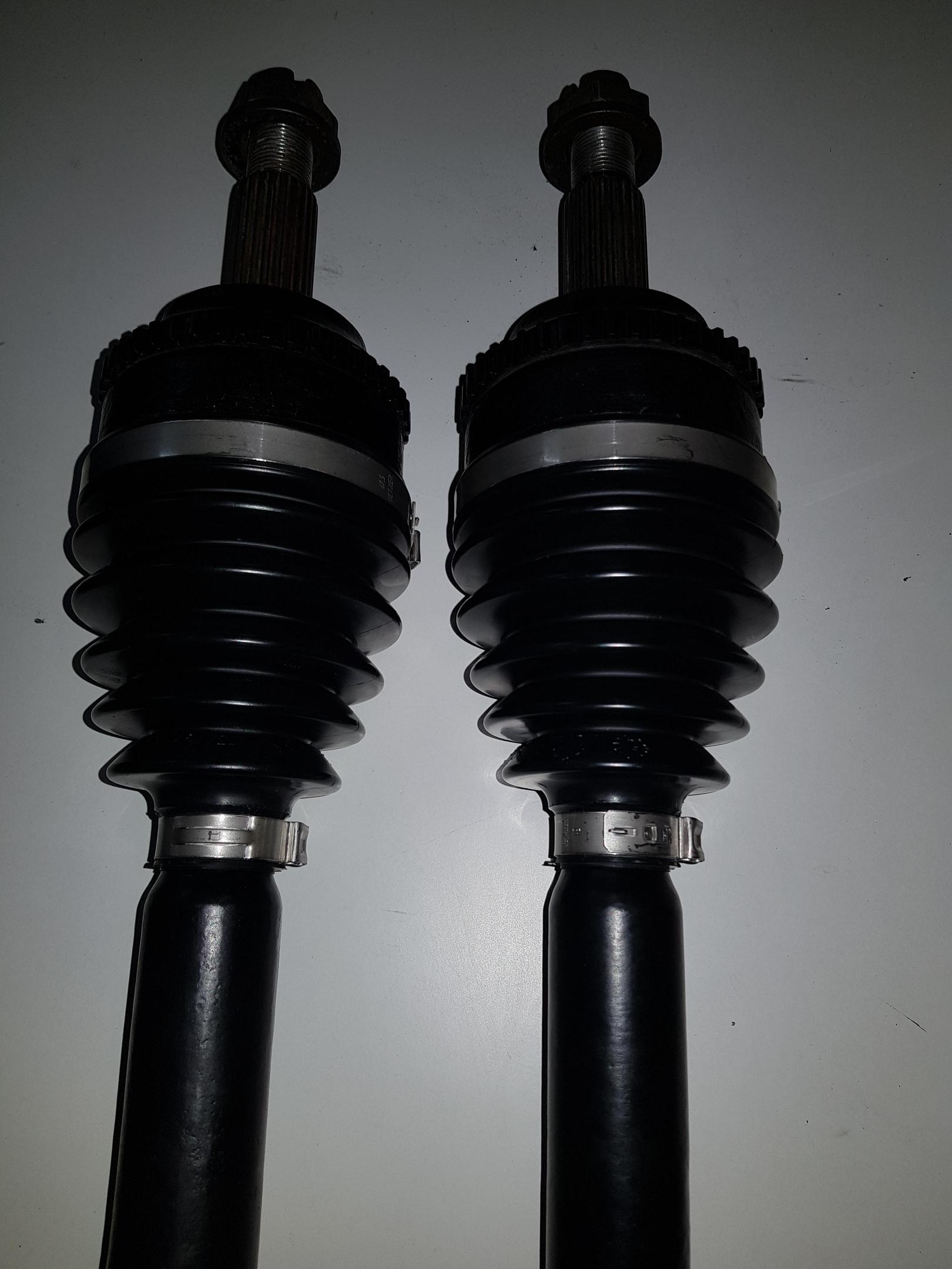

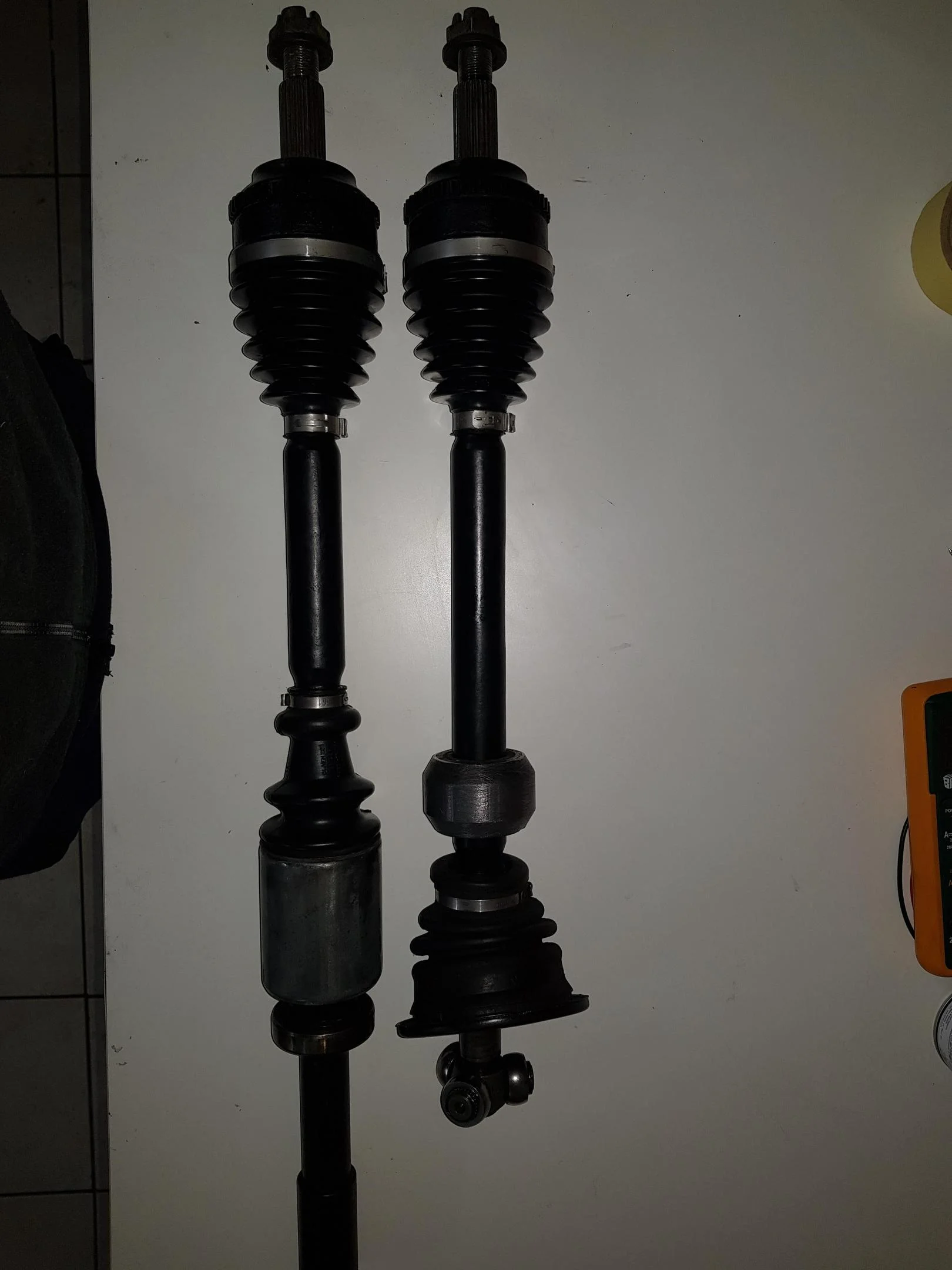

I rebuild a pair of driveshafts for my clio, just for backup.
They were in decent shape and cover arouns 60k miles. I've change the outer boots and ballbearings inside the cv joint. Clean the rust as much as possible and use rust converter and rust stop. After a night, clean and paint.

@Optimista
I need 20mm spacers to run on et43 15" wheels and I could not afford them right now. Maybe in March when I put my 16" alloys. And yes, 300mm discs from Scenic.
