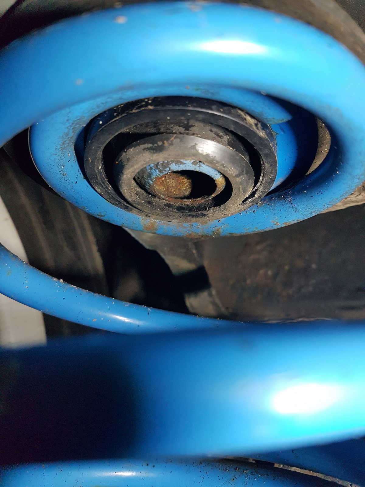

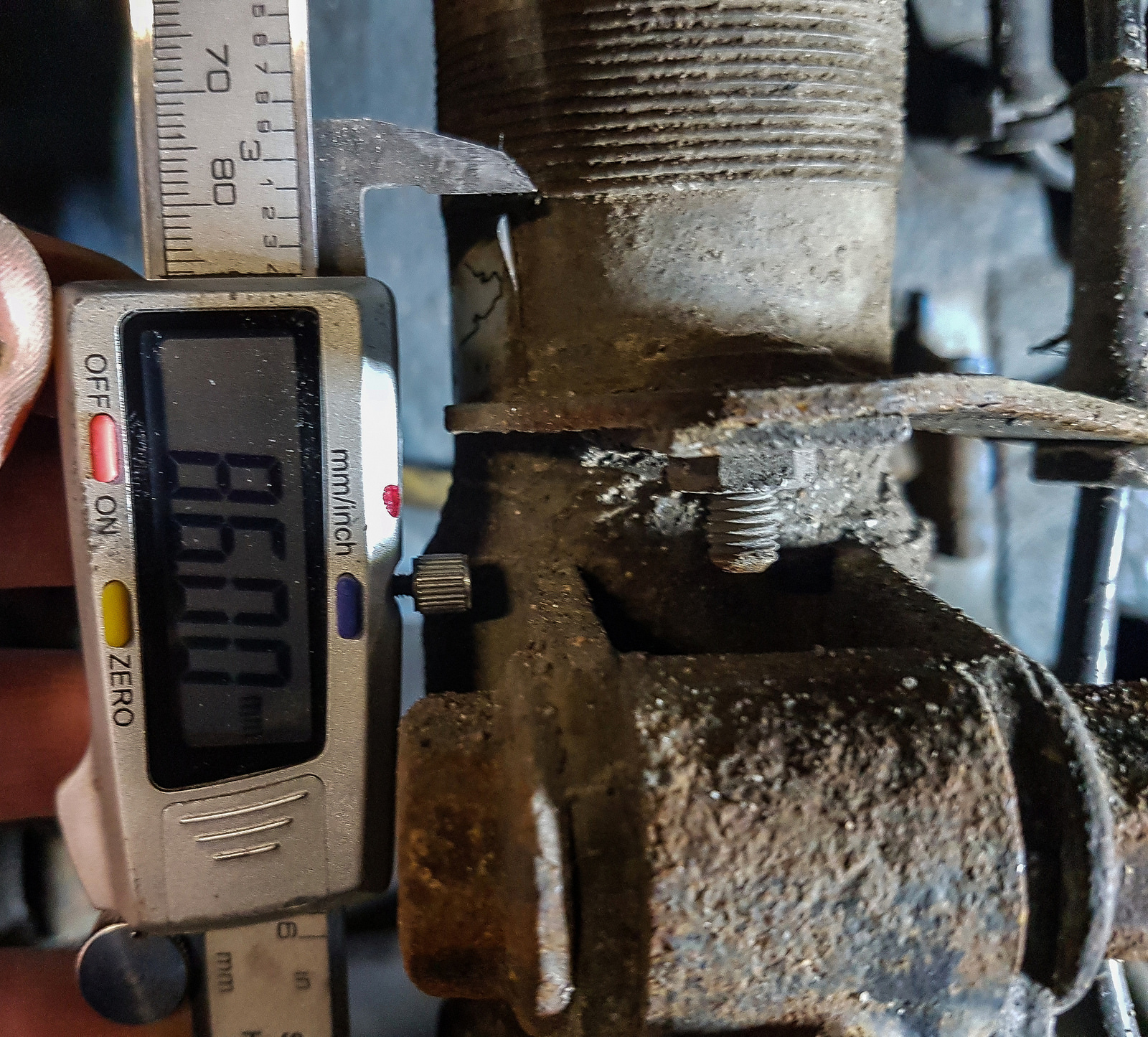

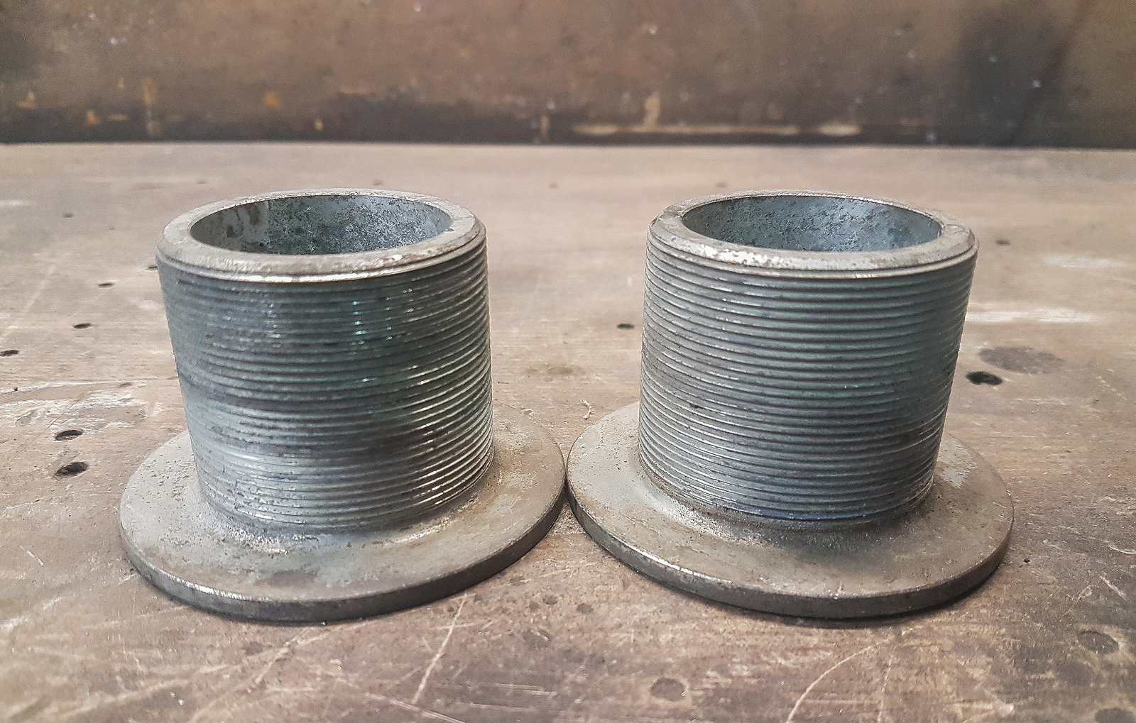

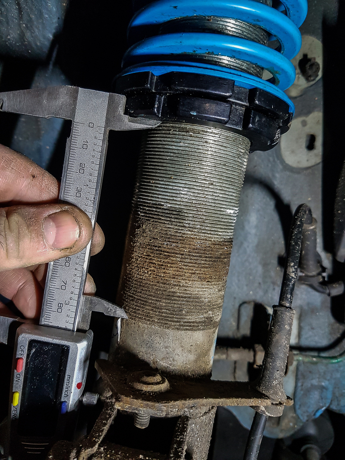

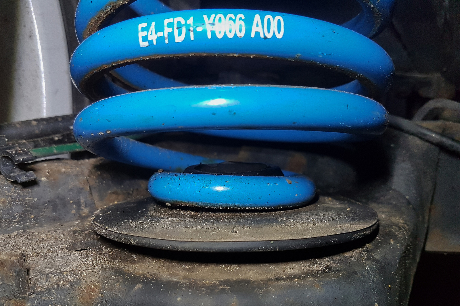

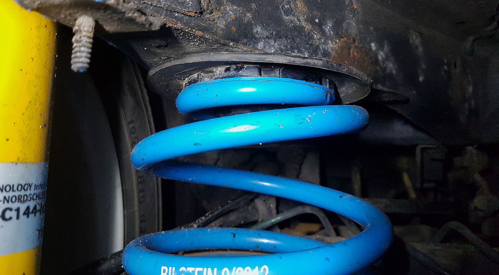

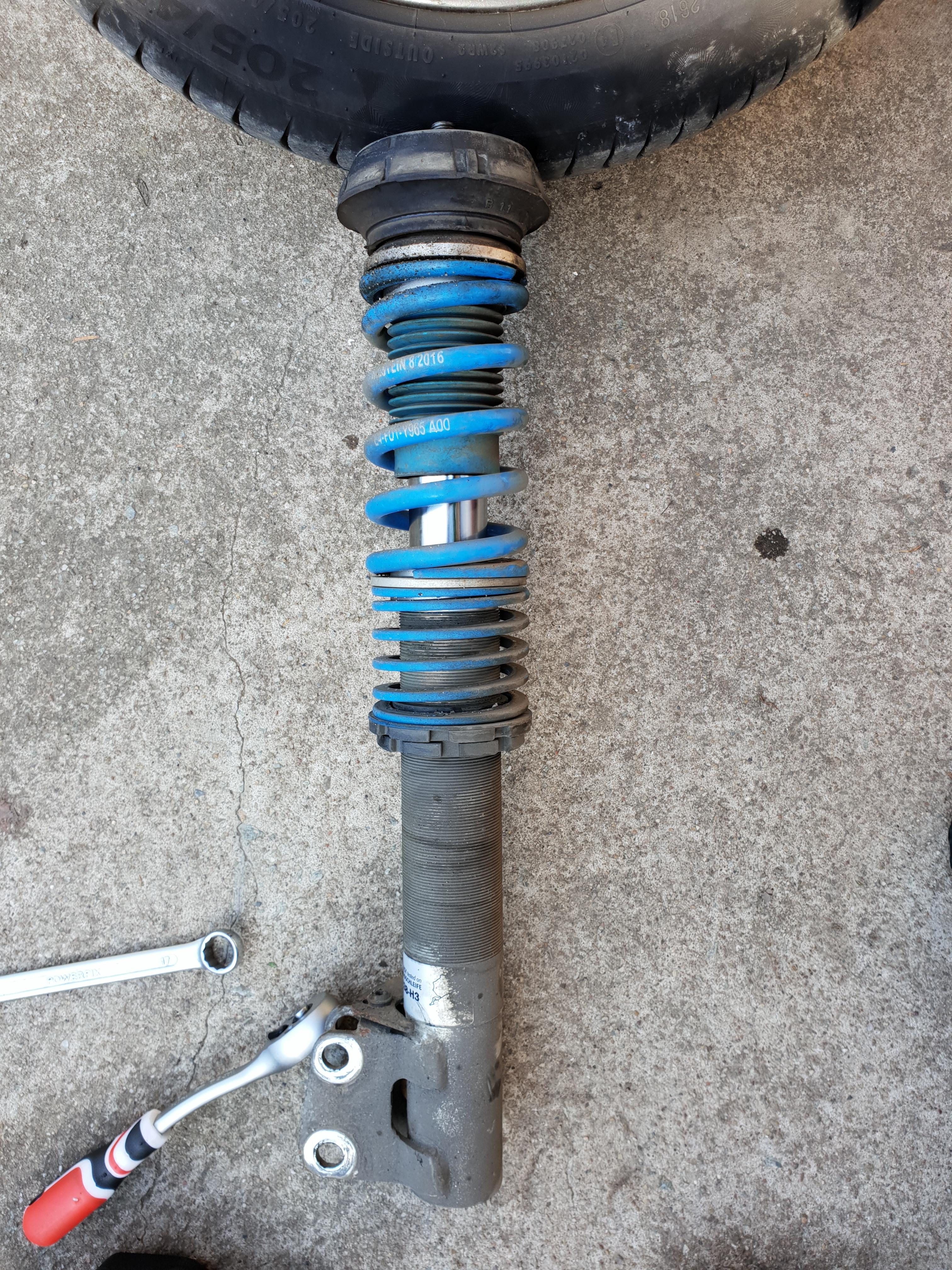

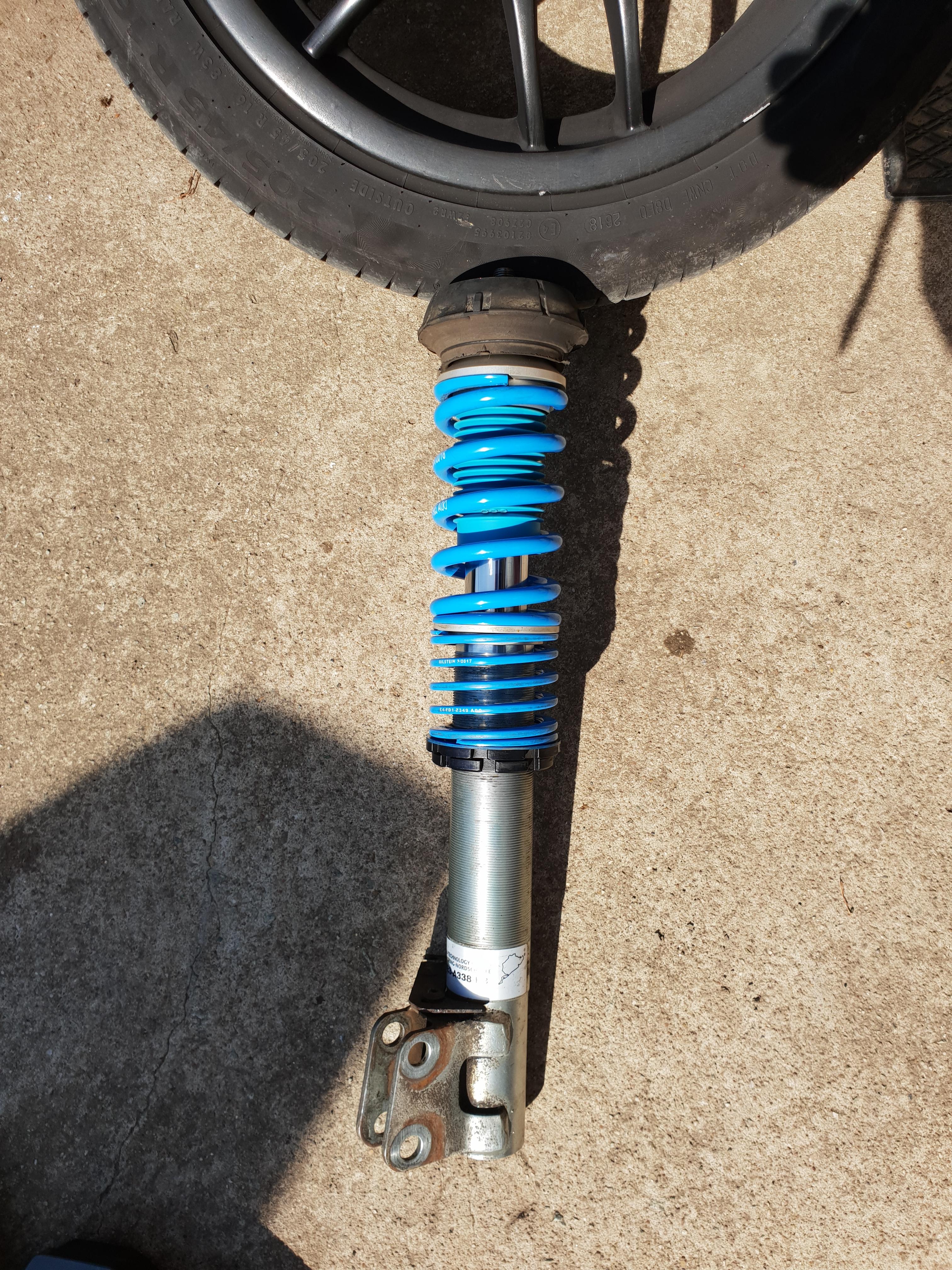

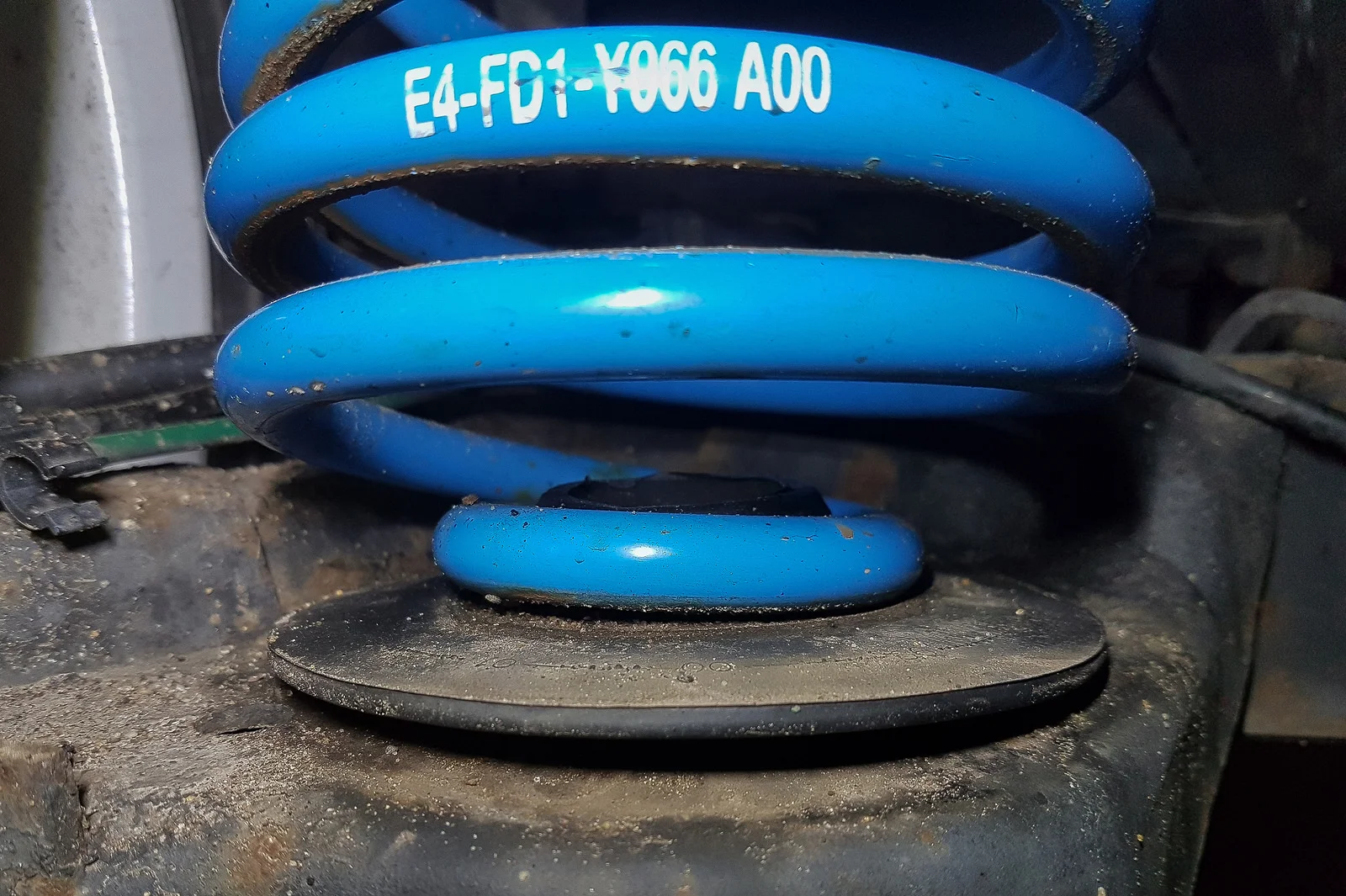

What I've seen on your pics, is that on rear is without spacer, and on front aprox 1/3 thread on upper side and 2/3 on lower side (upper and lower with the nut)

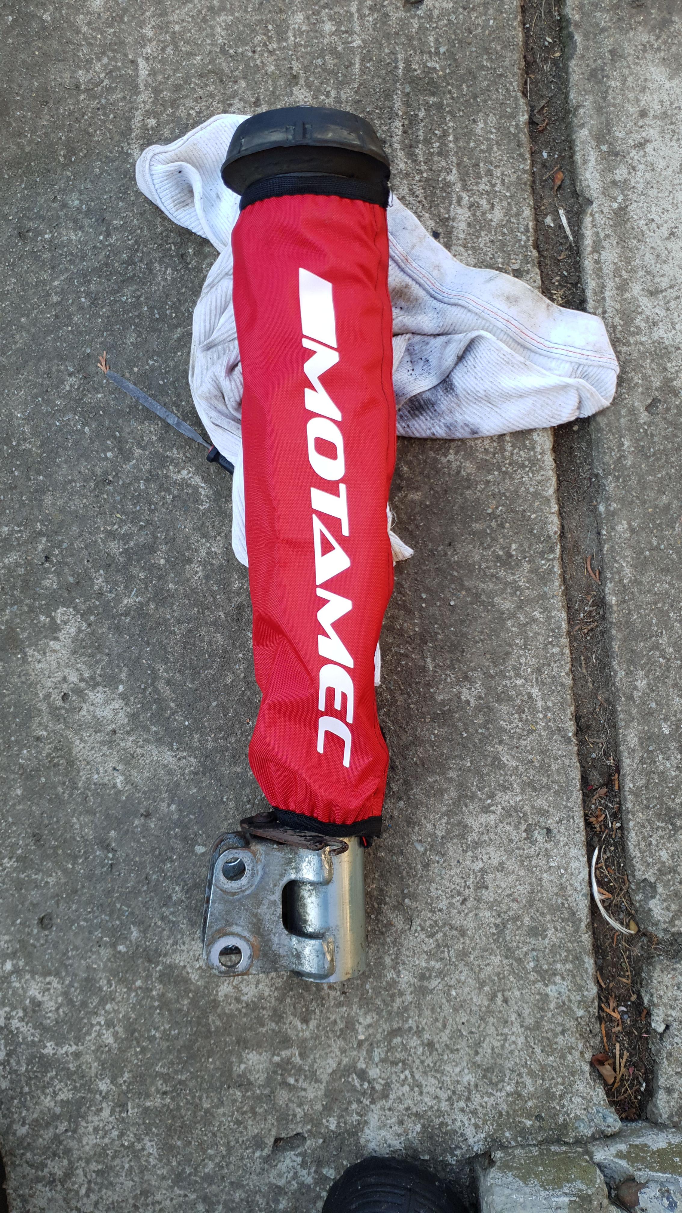

With the rear seats removed, it sits a little bit higher, but it handles better than the standard setup. Cup interior will the next mod and then the engine work.

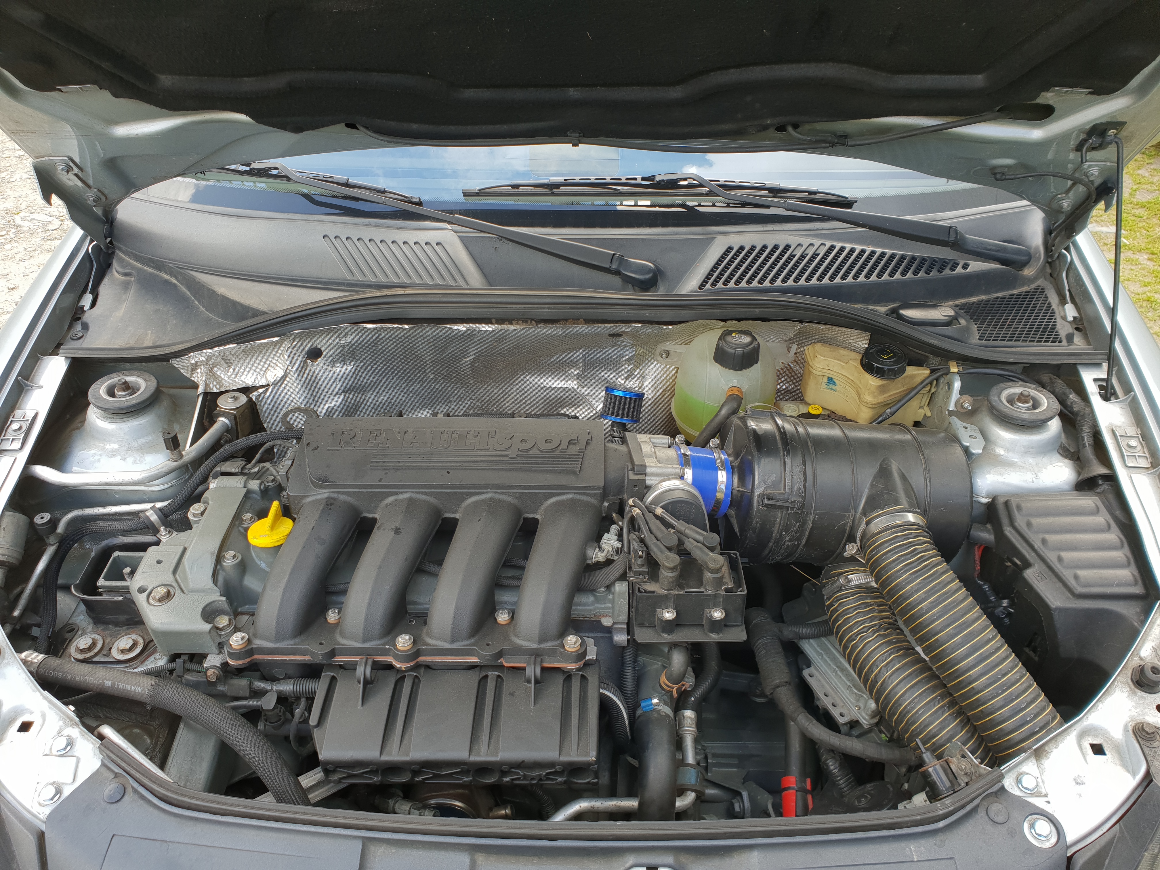

-197 inlet, will be fitted with a lot of head work and custom gaskets
-64mm throttle body to match the inlet hole. It is not Renault tb.

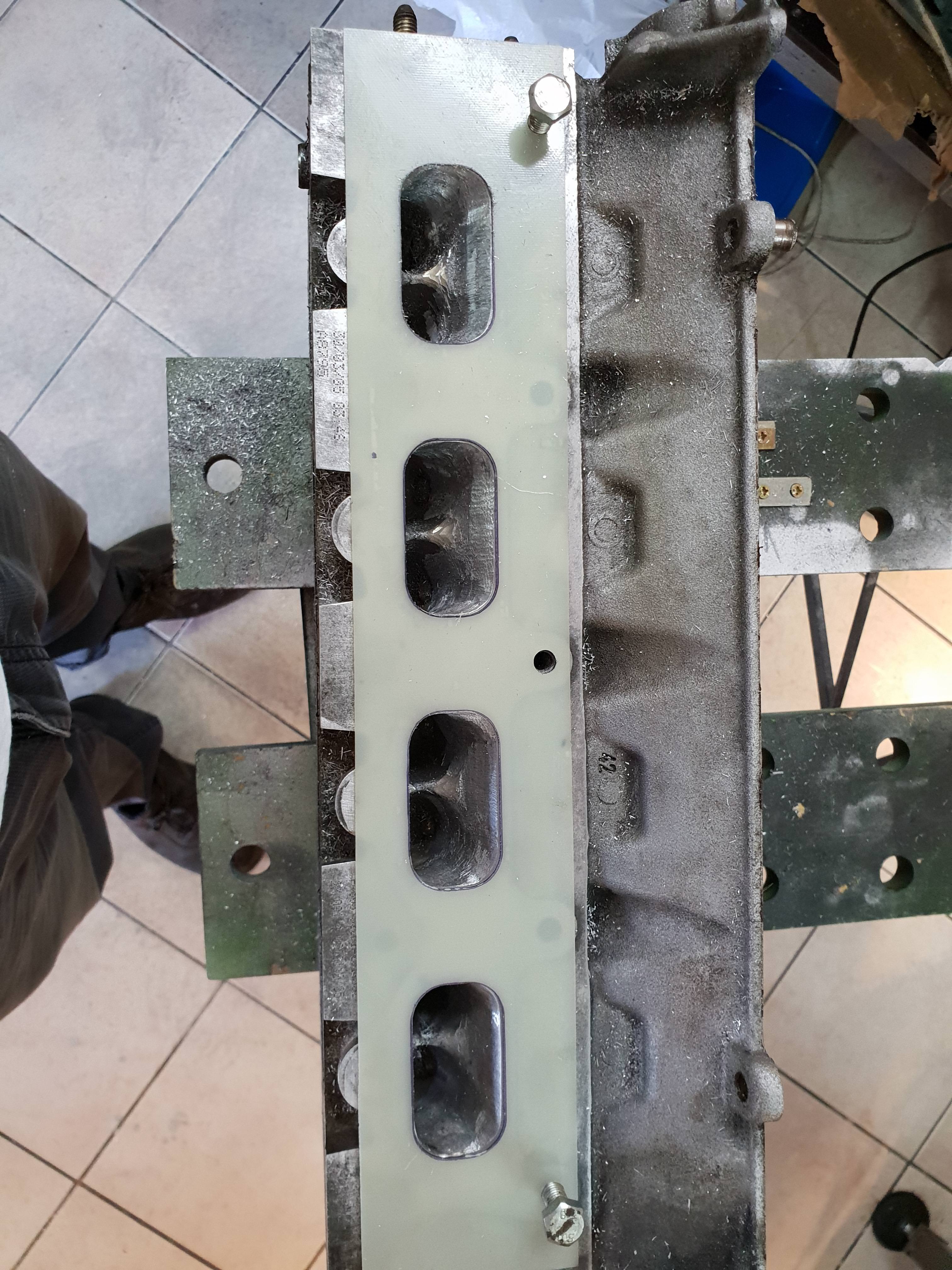

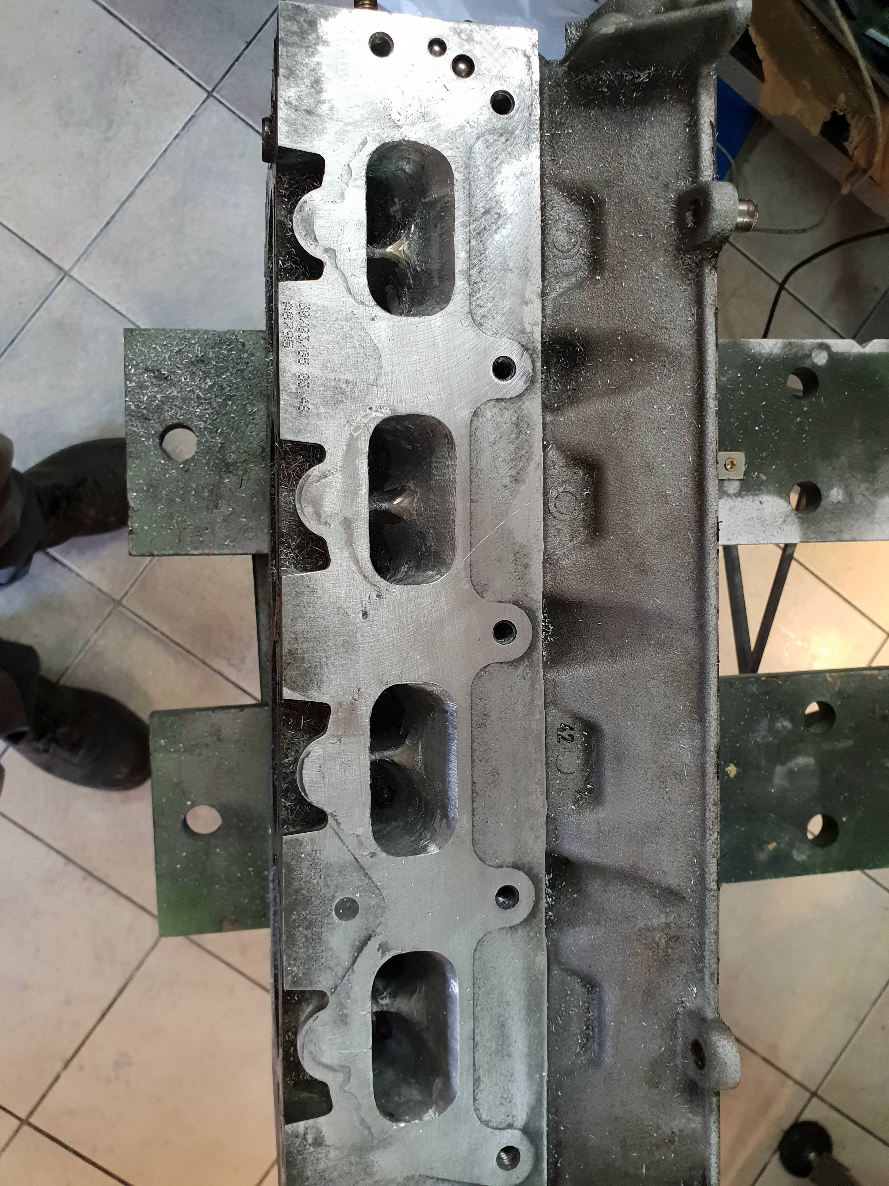

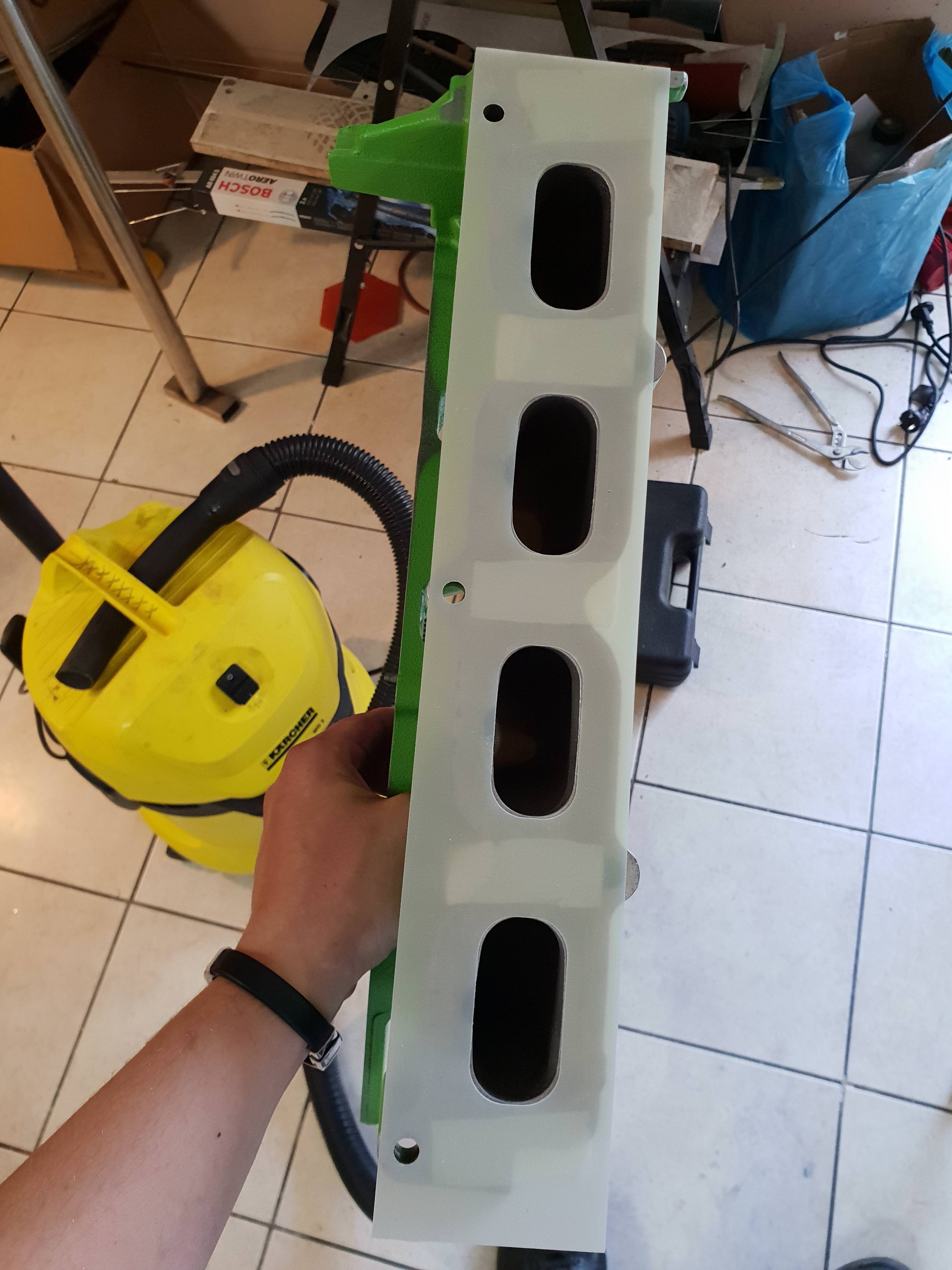

Dissasemble the head and make a template for 197 inlet.
With this template I can mark the port for the 197 inlet. It will need some weld also to be done properly.
I will tap new holes and hopefully the 197 inlet will fit on the 1*2 head making it a 192 head :smile:😂

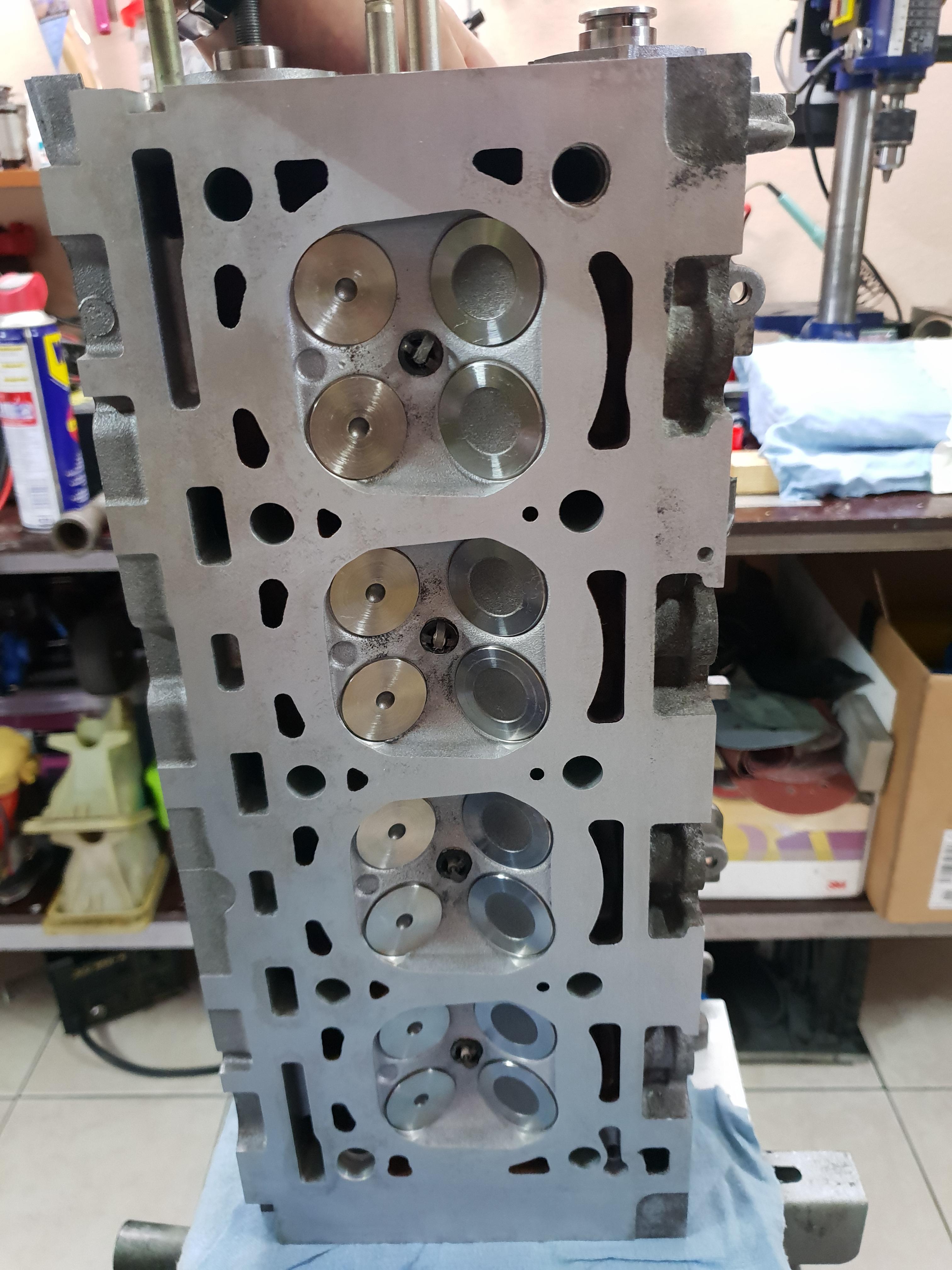

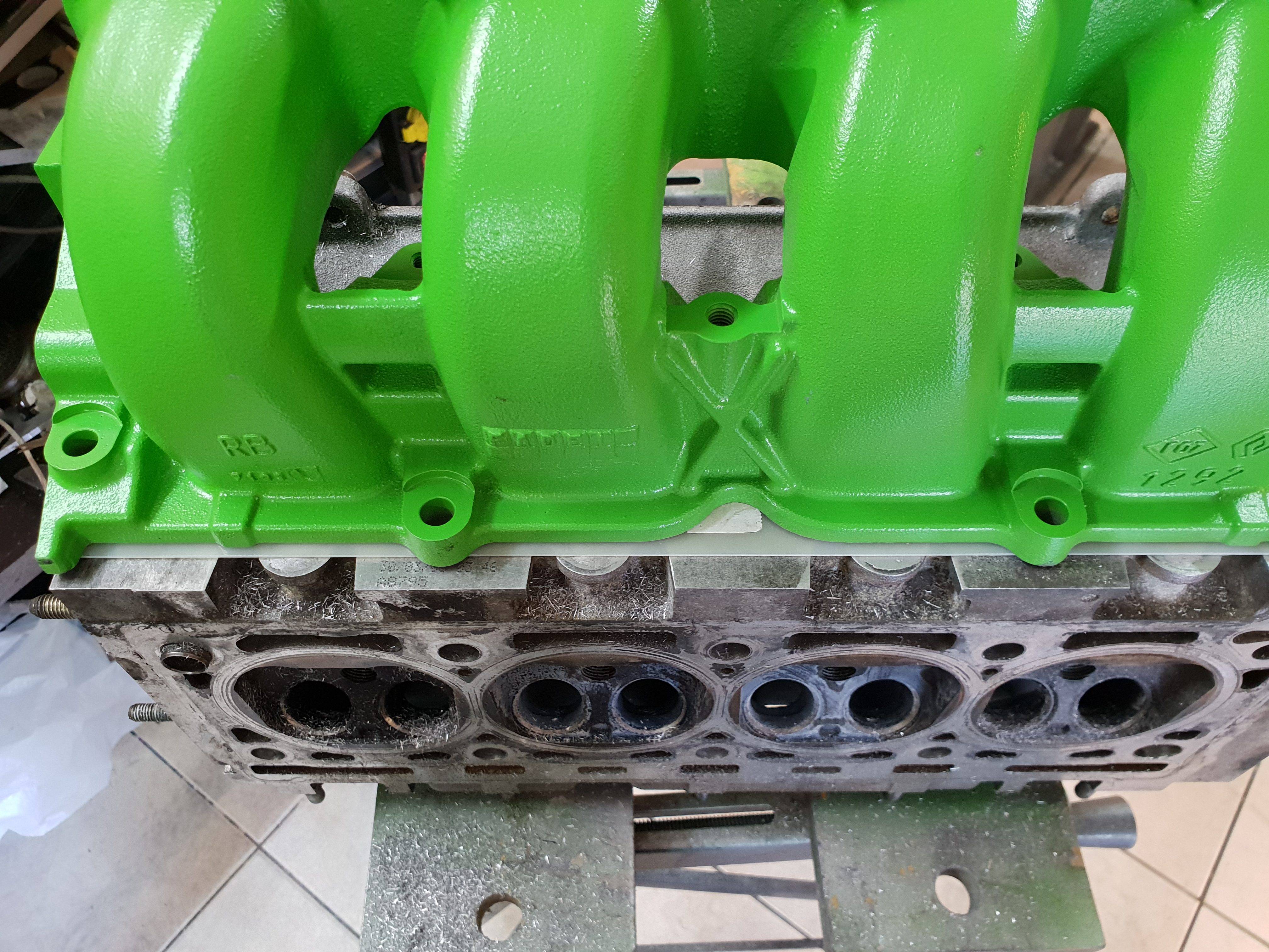

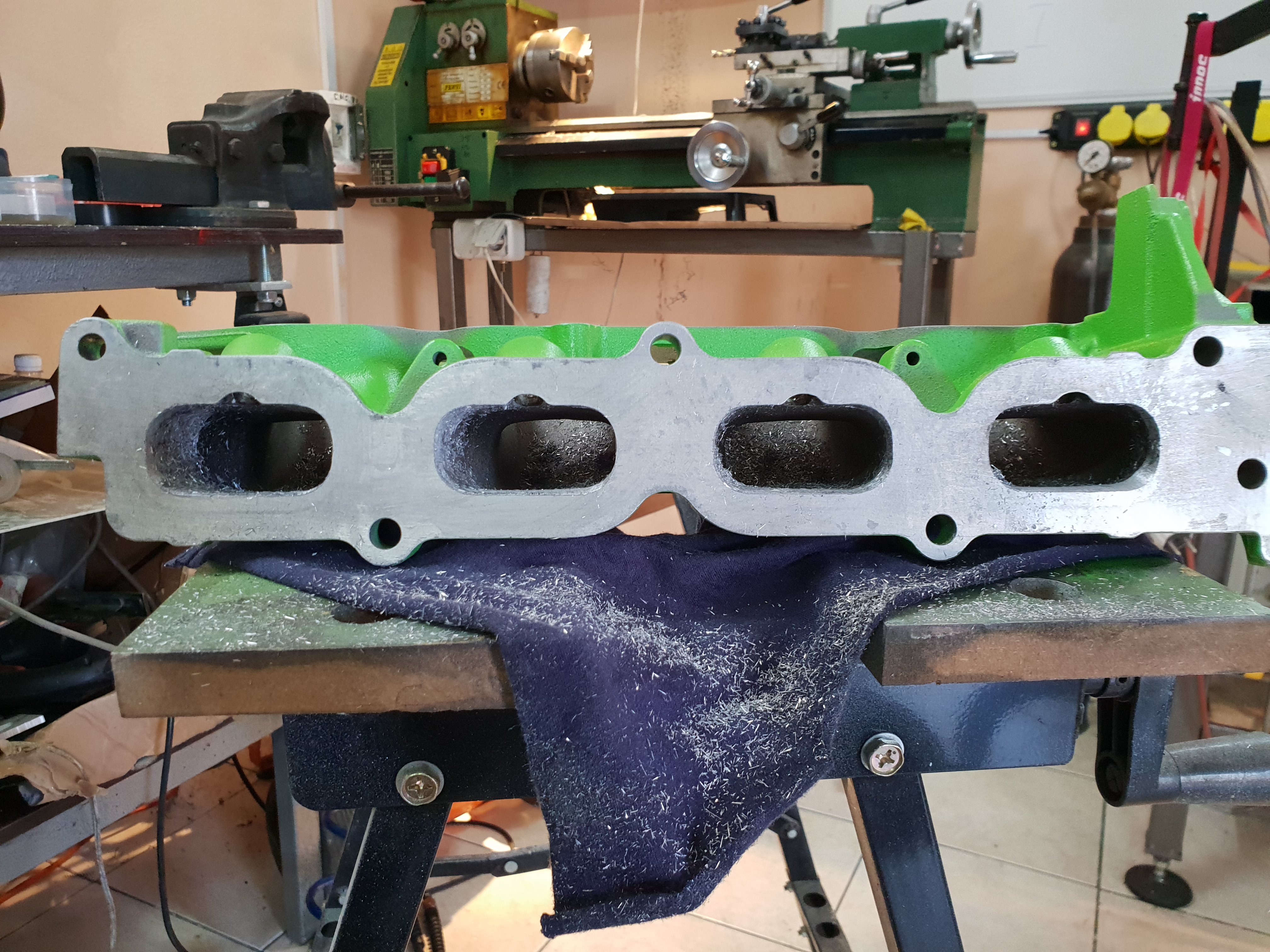

Weld and matched 182 head to fit 197 inlet. The head was filled using Al welding rod and then ported. The ports will be finished using sand paper later.
Repaint in the cam cover and a small test fit.
A clear coat and good to go
The welding:)
And the milling for screw head
And test fit the inlet

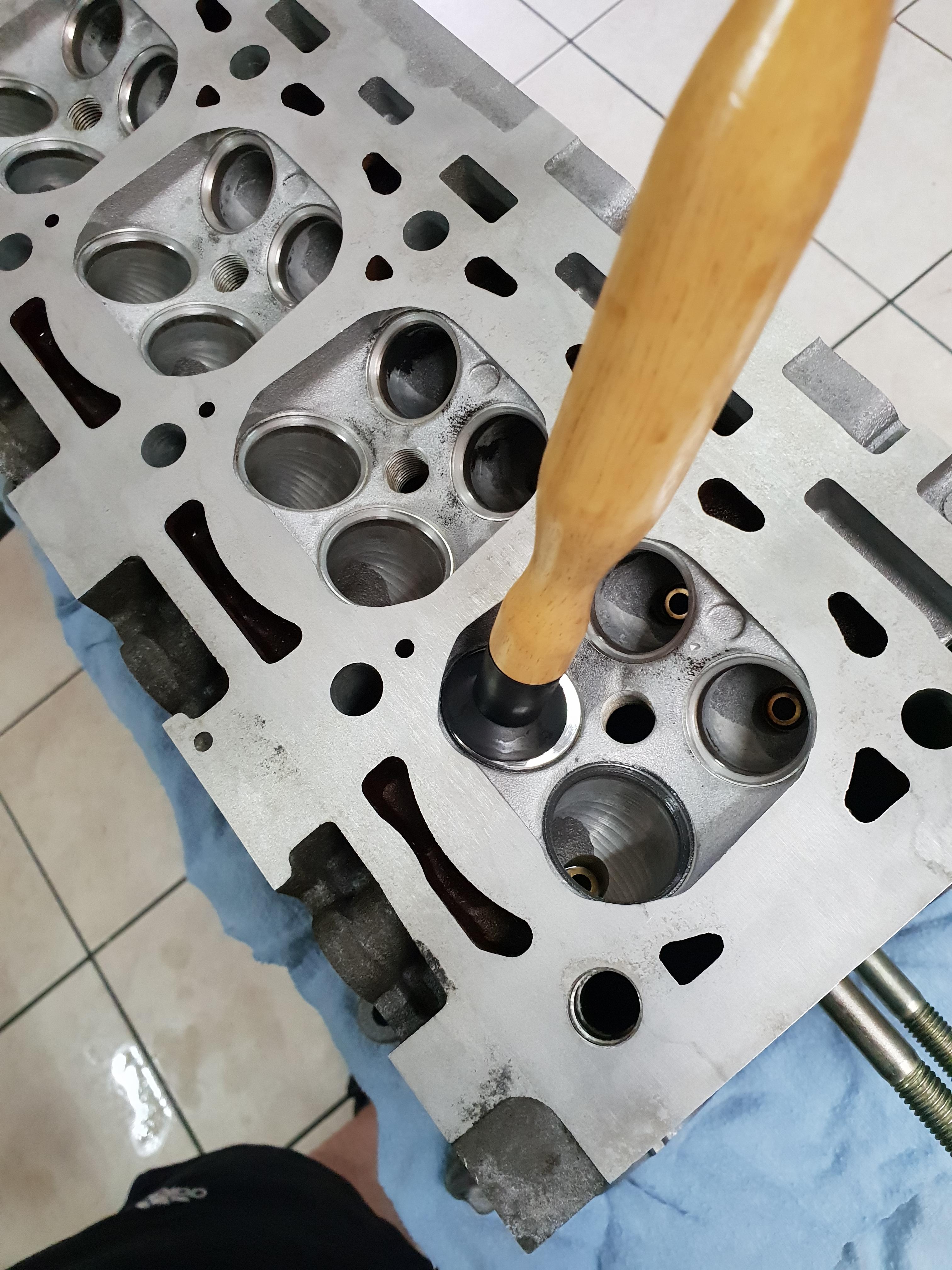

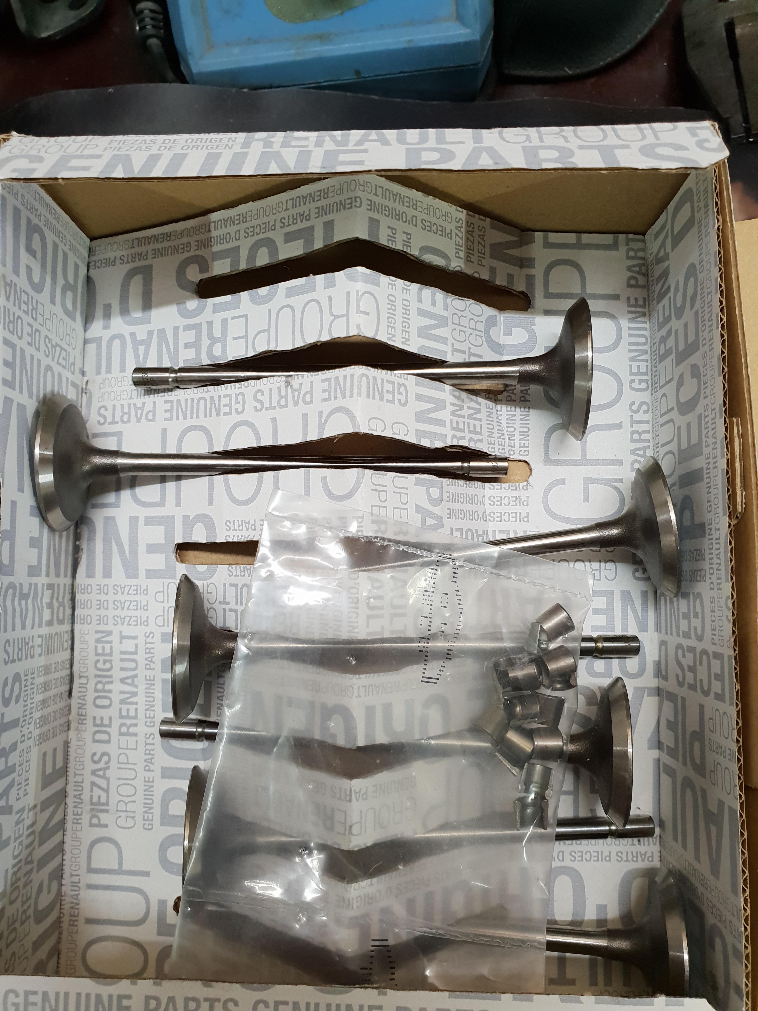

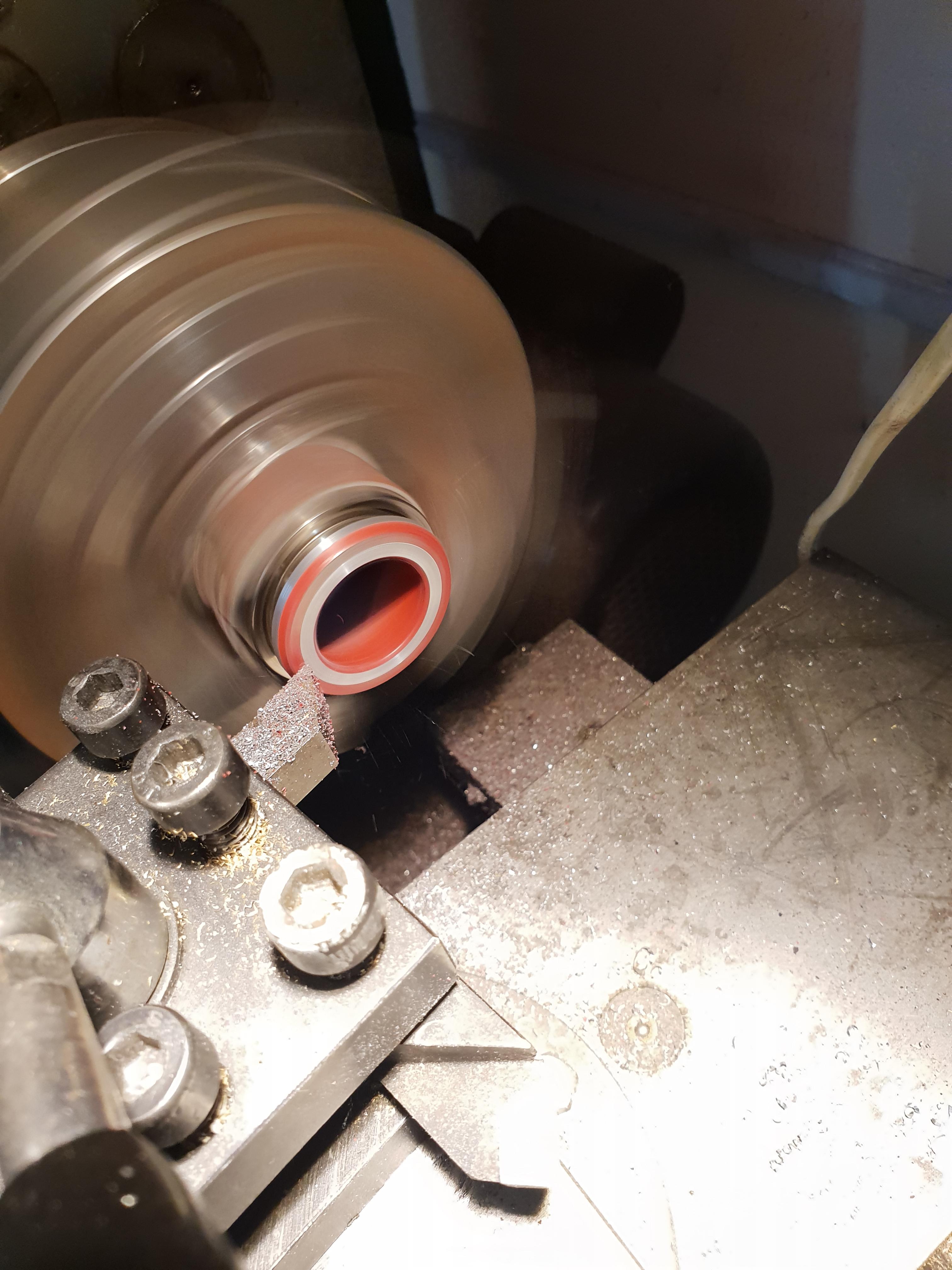

New oem valves and piston rings. The engine top rebuild is done. New valves, new guides, new seals, recut seats and lapped valves.
and done

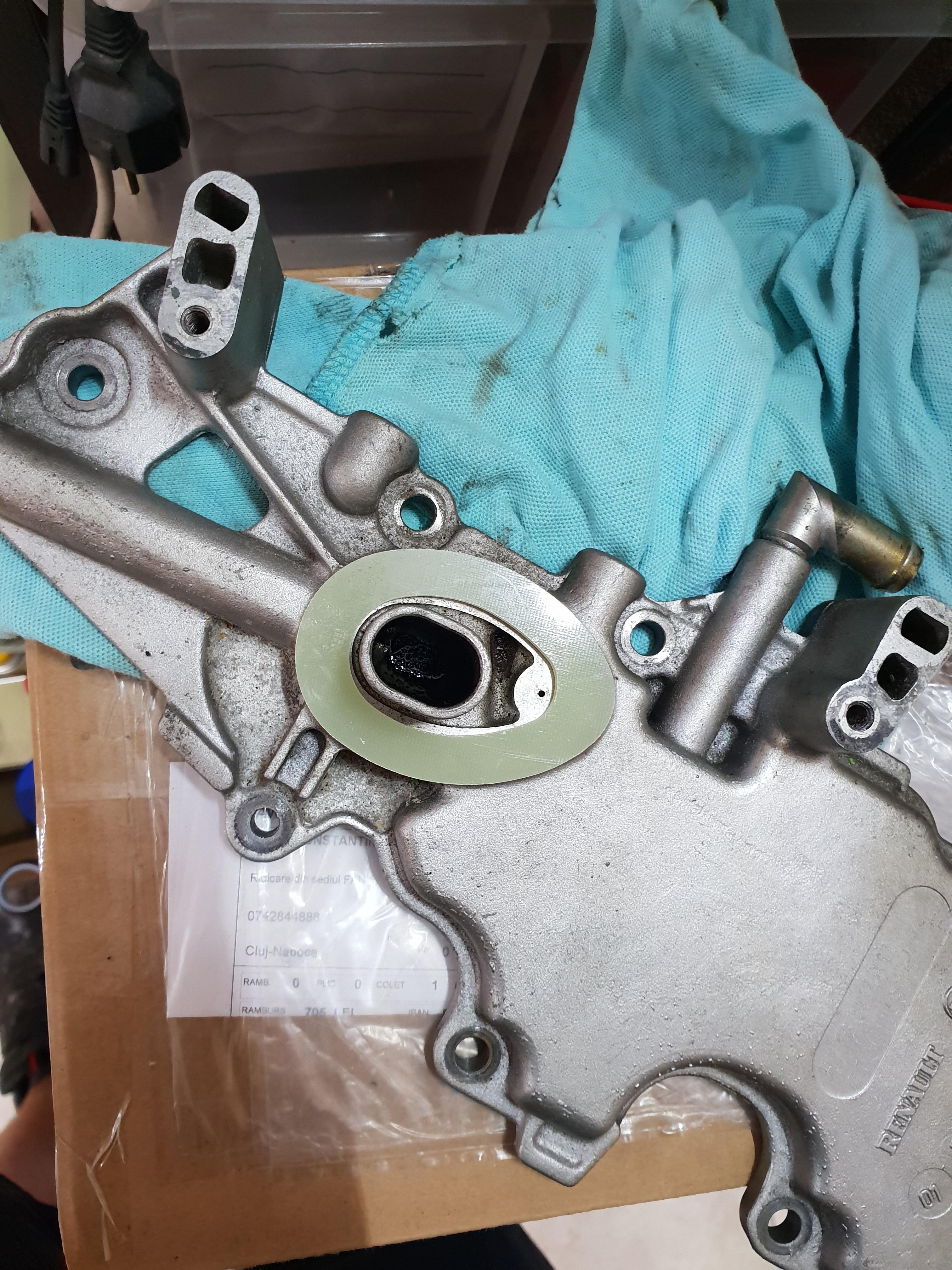

Make this gasket for a good fit of the plenum.

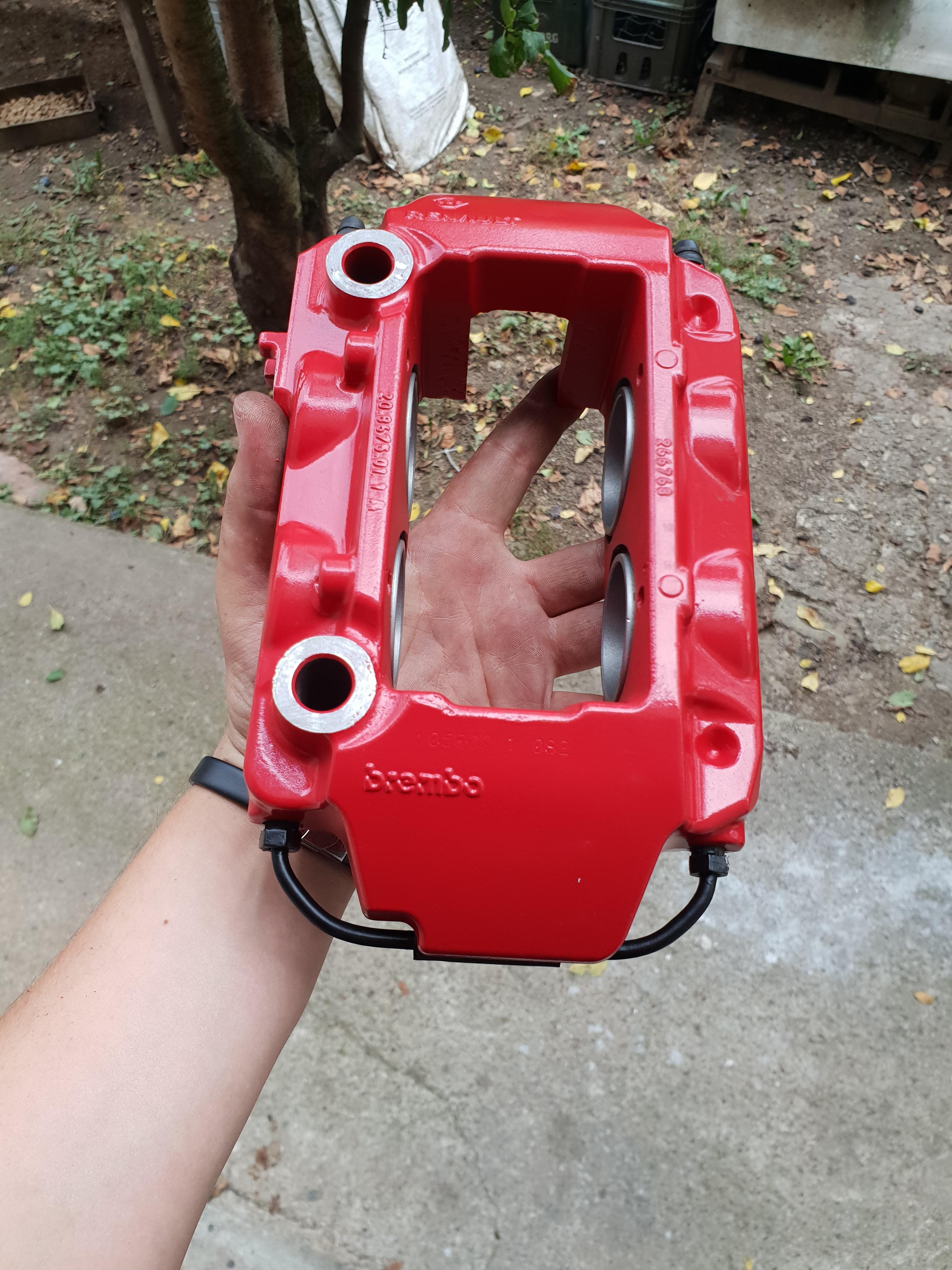

Rebuild a pair of Brembos
Reuse the oem brake pistons, just a small touch.

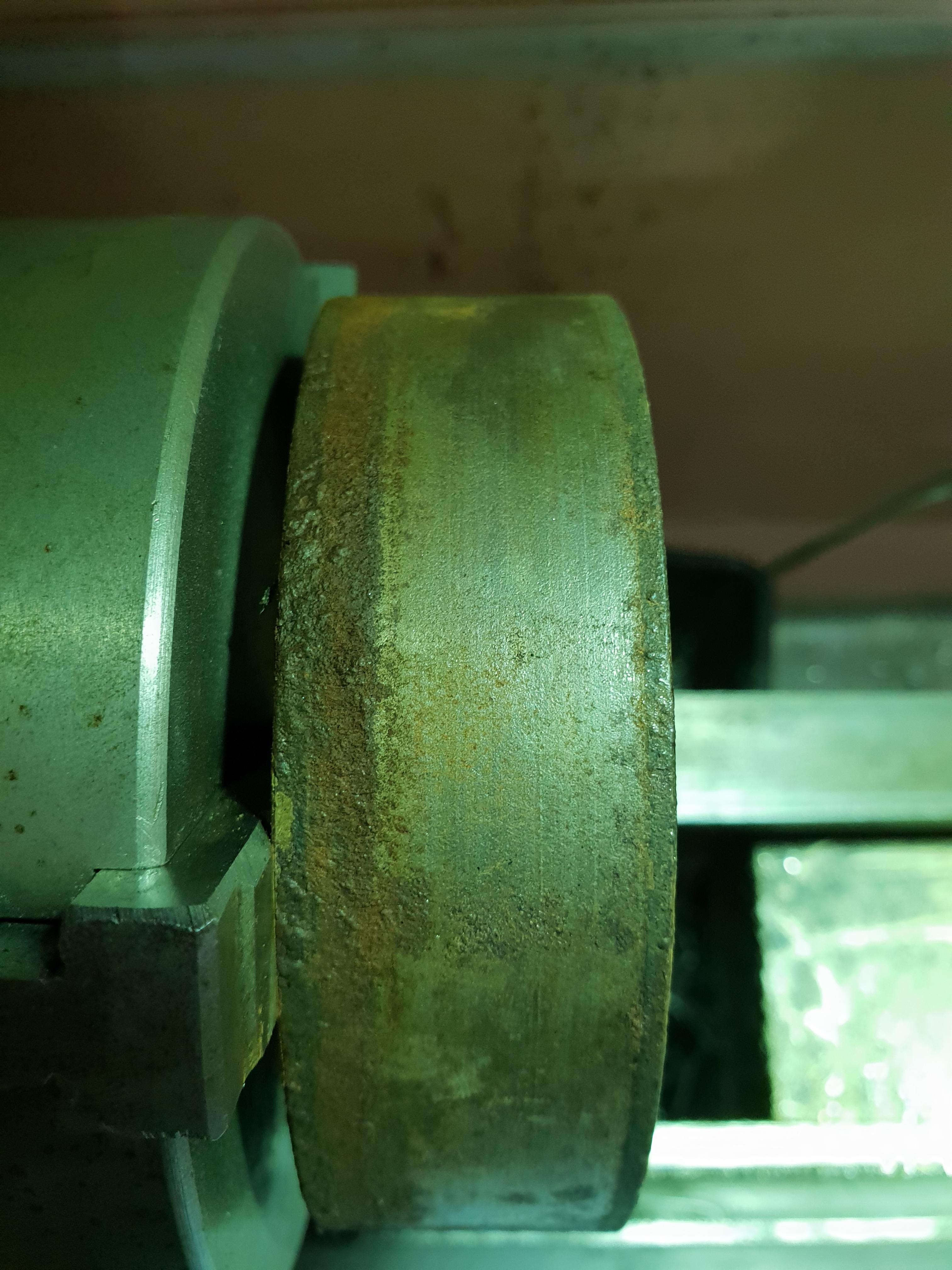

Clean waterpump pulley

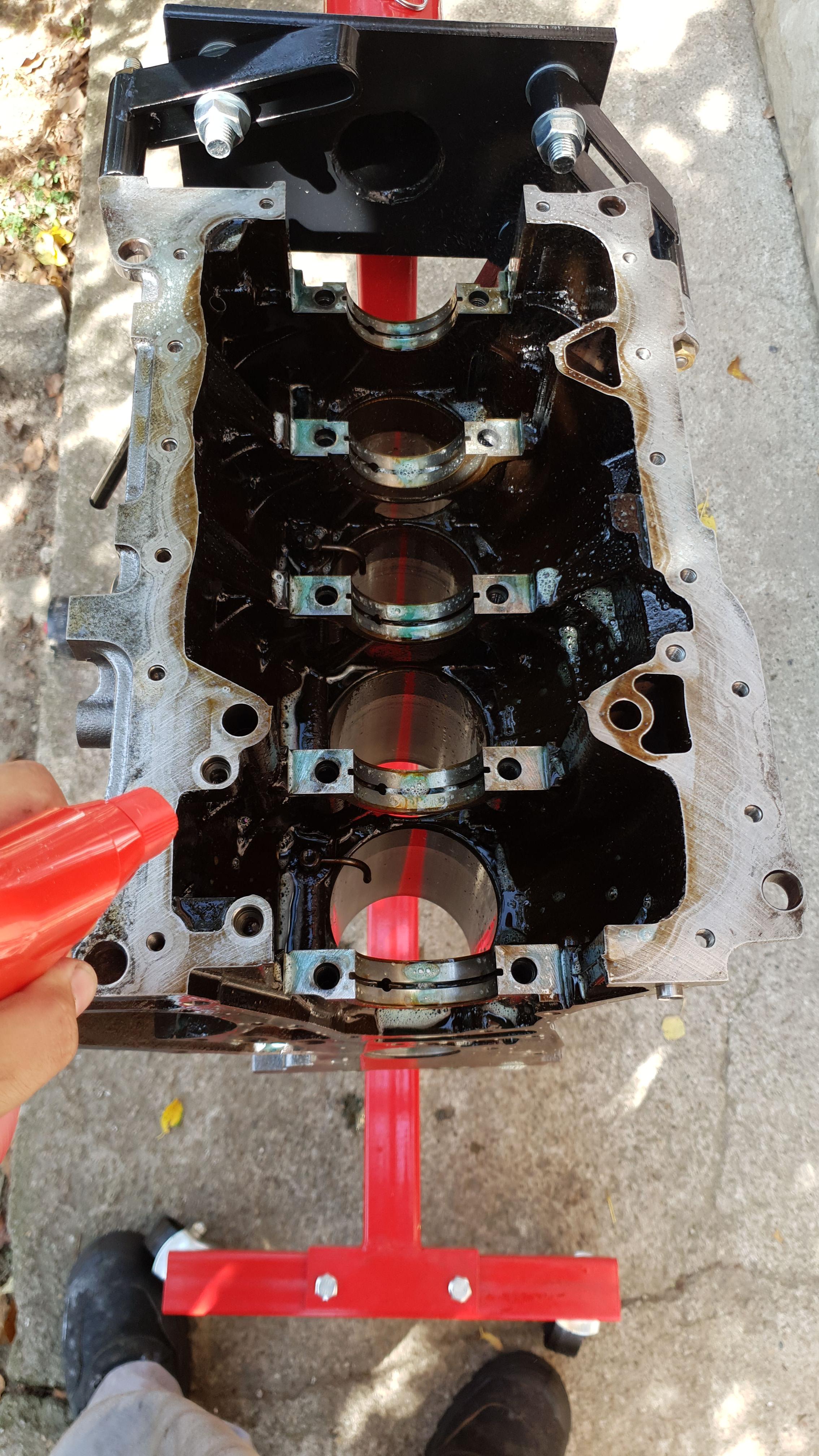

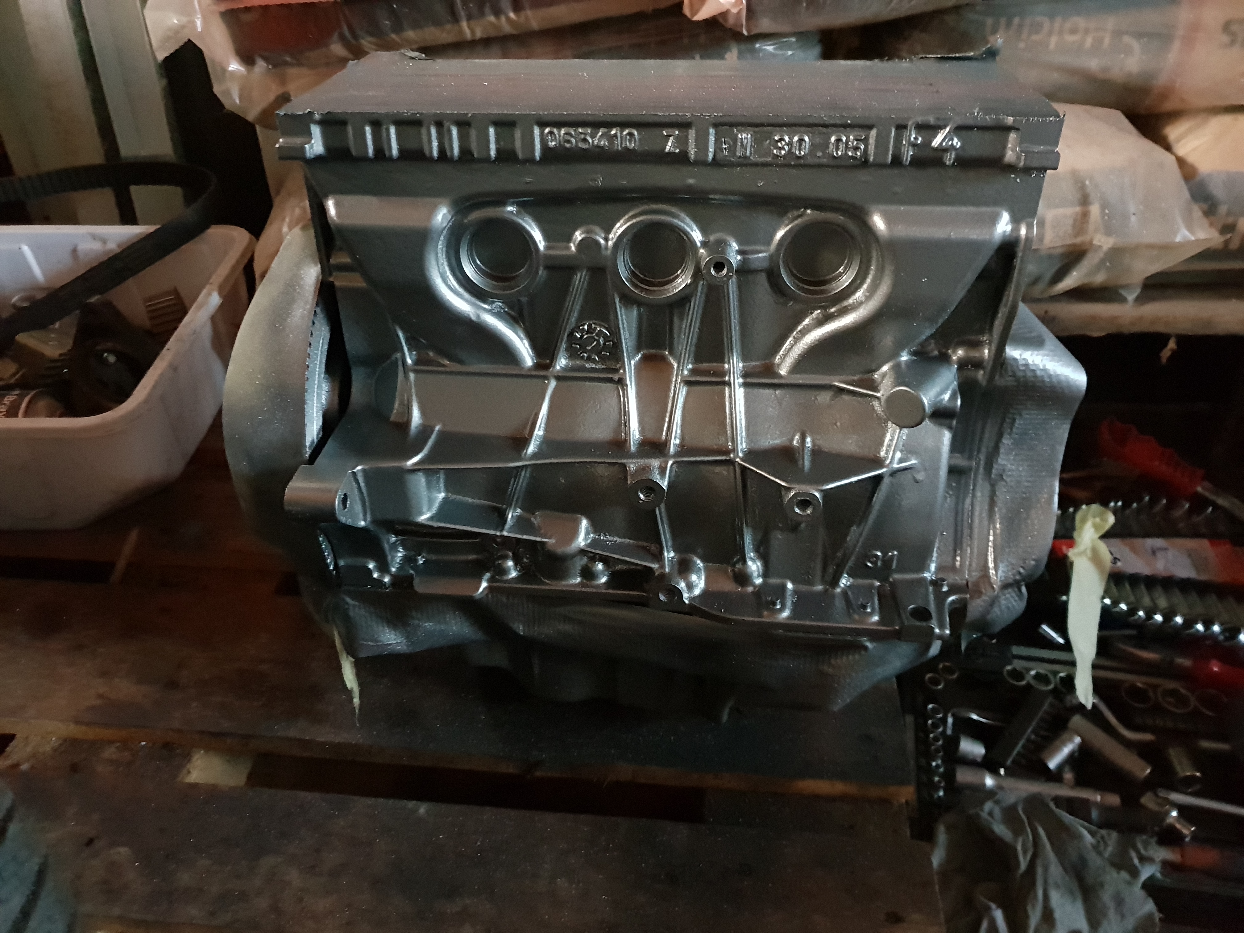

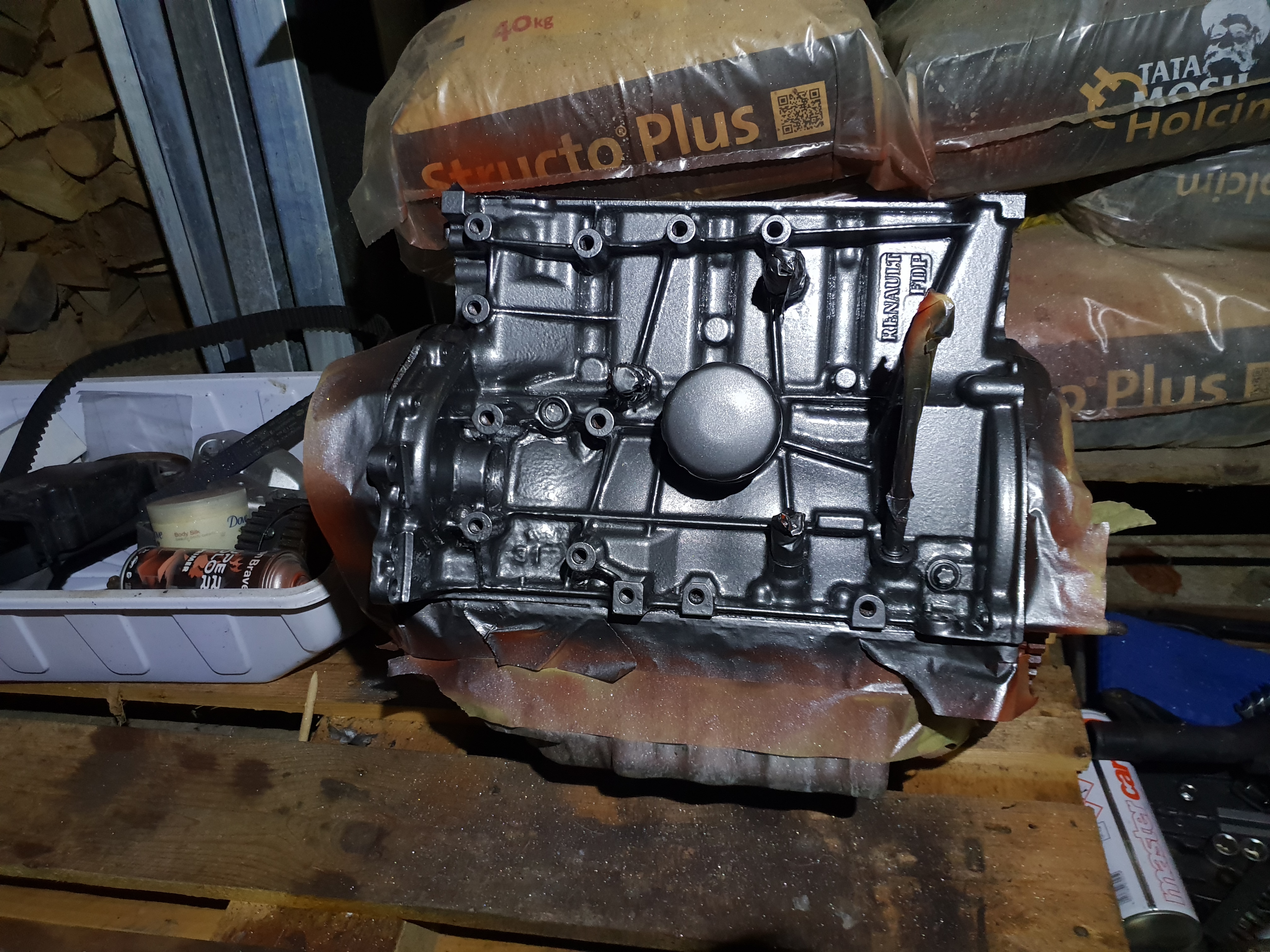

Clean, rust convert and paint the engine block.
Soon I will make adapters to can fit Brembos, hope they will came up nice as they will be home made:)
Block looks really good mate. Bet you can't wait to get it back together.

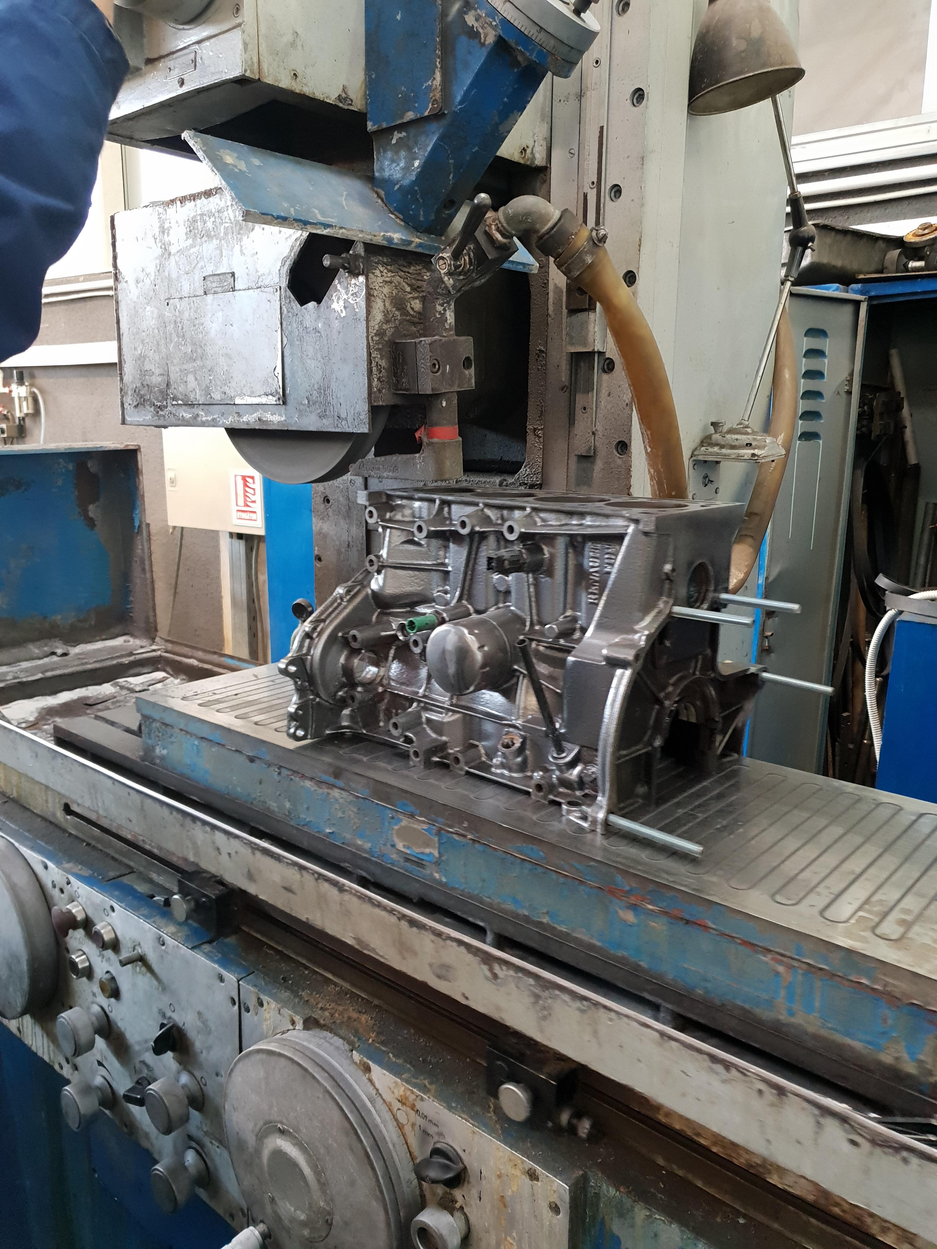

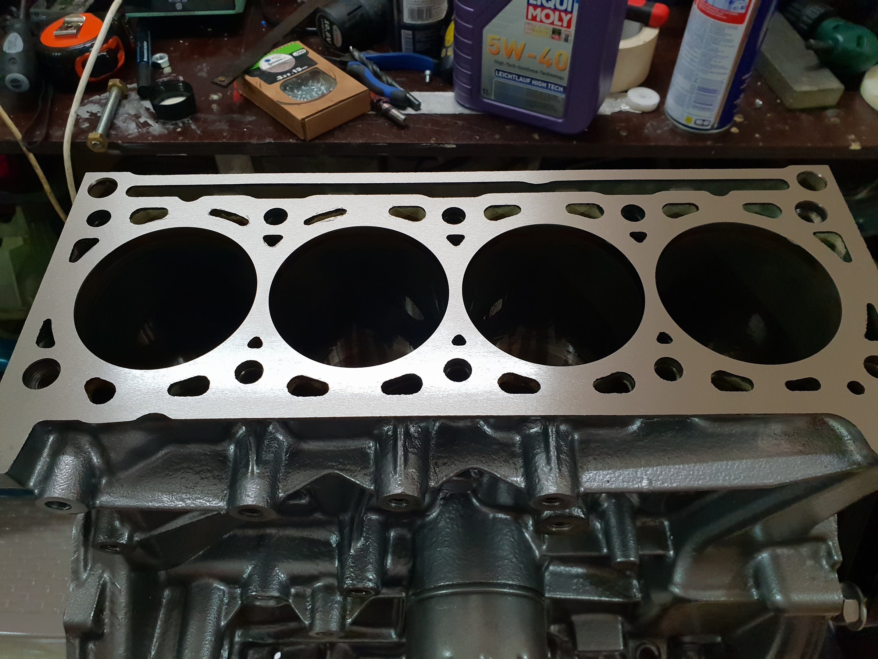

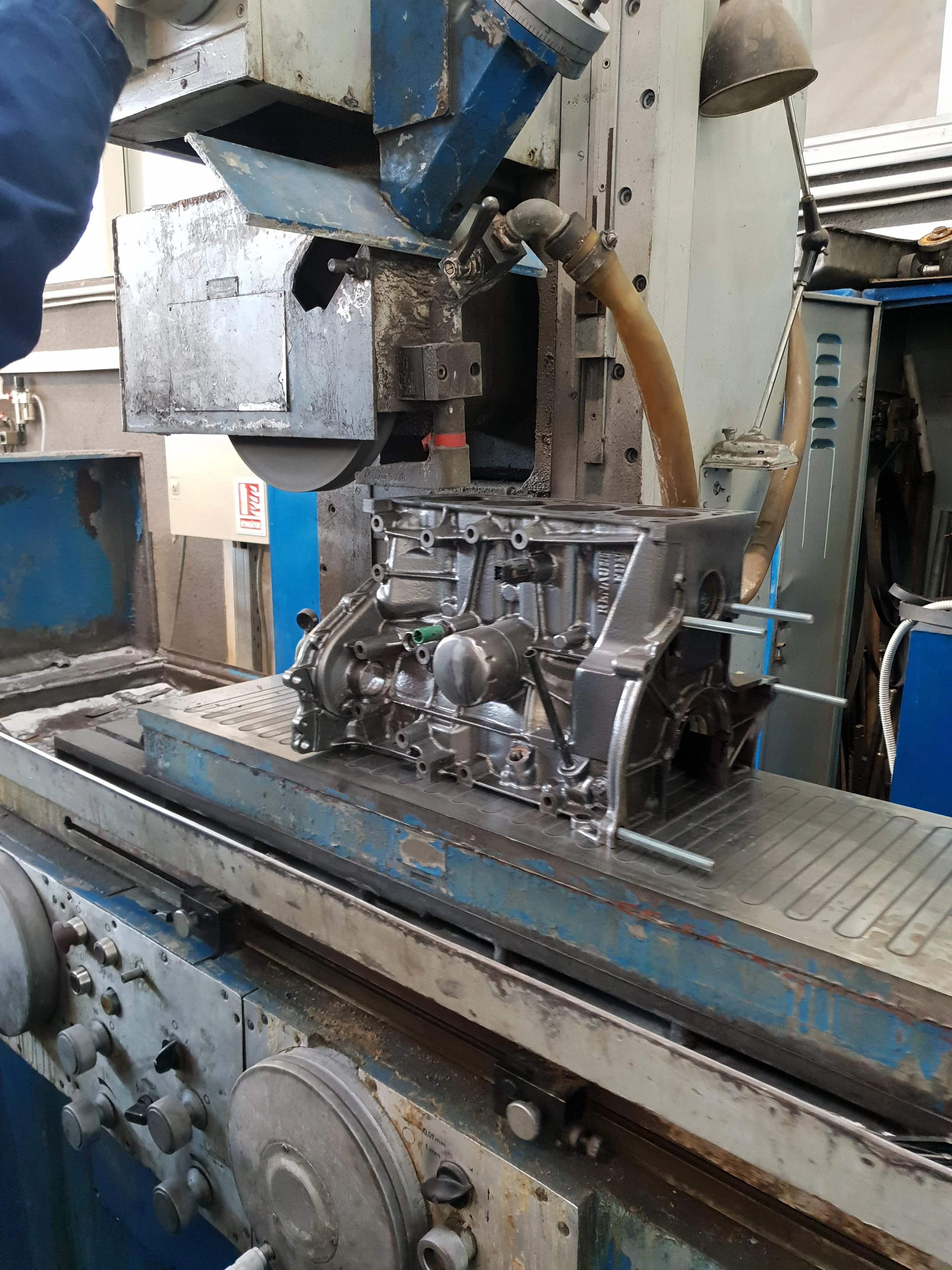

I will resurface the bloc by 0.05mm to have a better contact with the head and new gasket. Full ARP inside, main, rod and head and reassemble everything this month.
Thanks for all parts, mate
0.04mm skim from the engine surface. So overall was under 0.2mm skimming, so compression will be slightly under 11.2:1. Maybe I will get the 0.7mm thickness Elring gasket, but not so sure if they make that gasket of really 0.7mm and not of 0.65mm like OE specs.

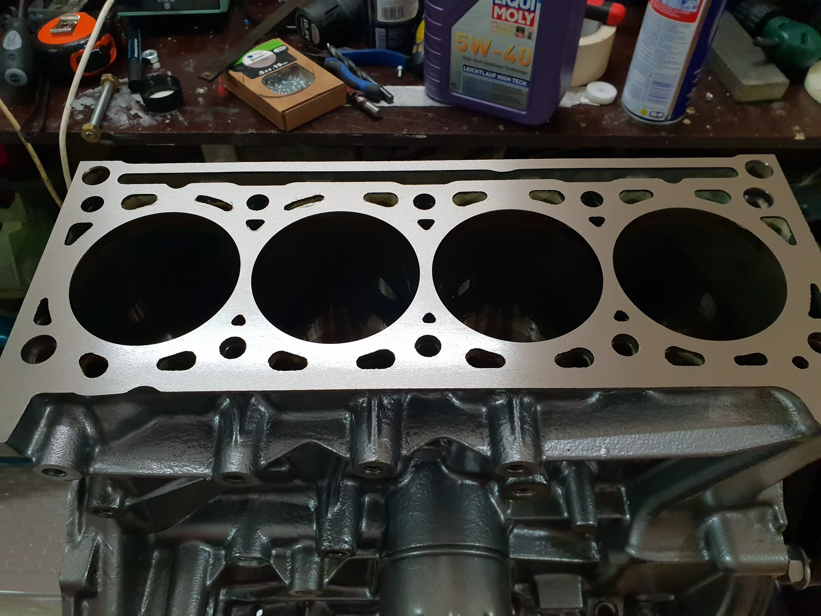

The engine block was cleaned, lot of brake cleaner, then lot of oil and patient. Clean each hole and then add new oil into oil pump hole and blown with air to fully lube everything.

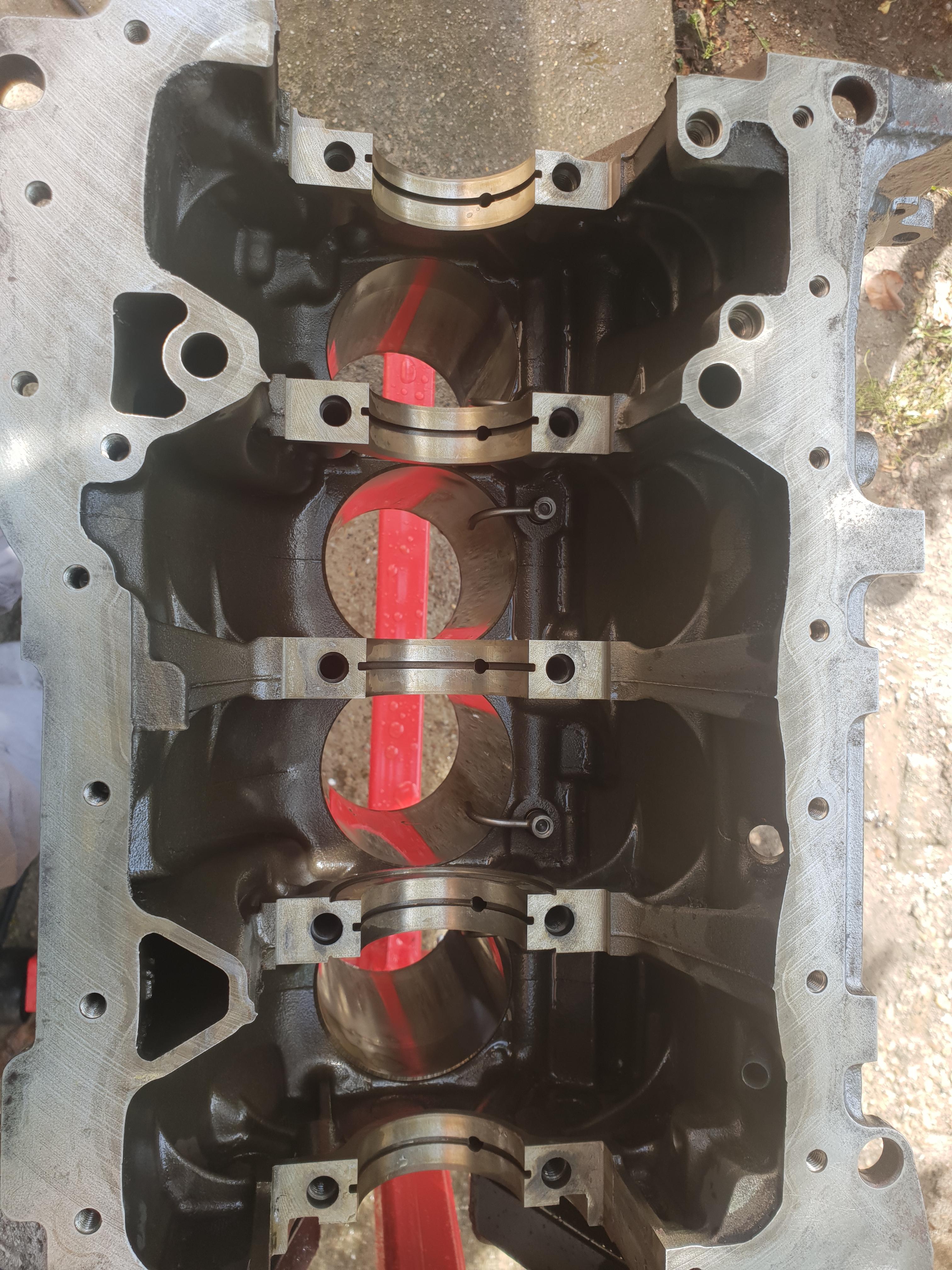

I forgot to post.

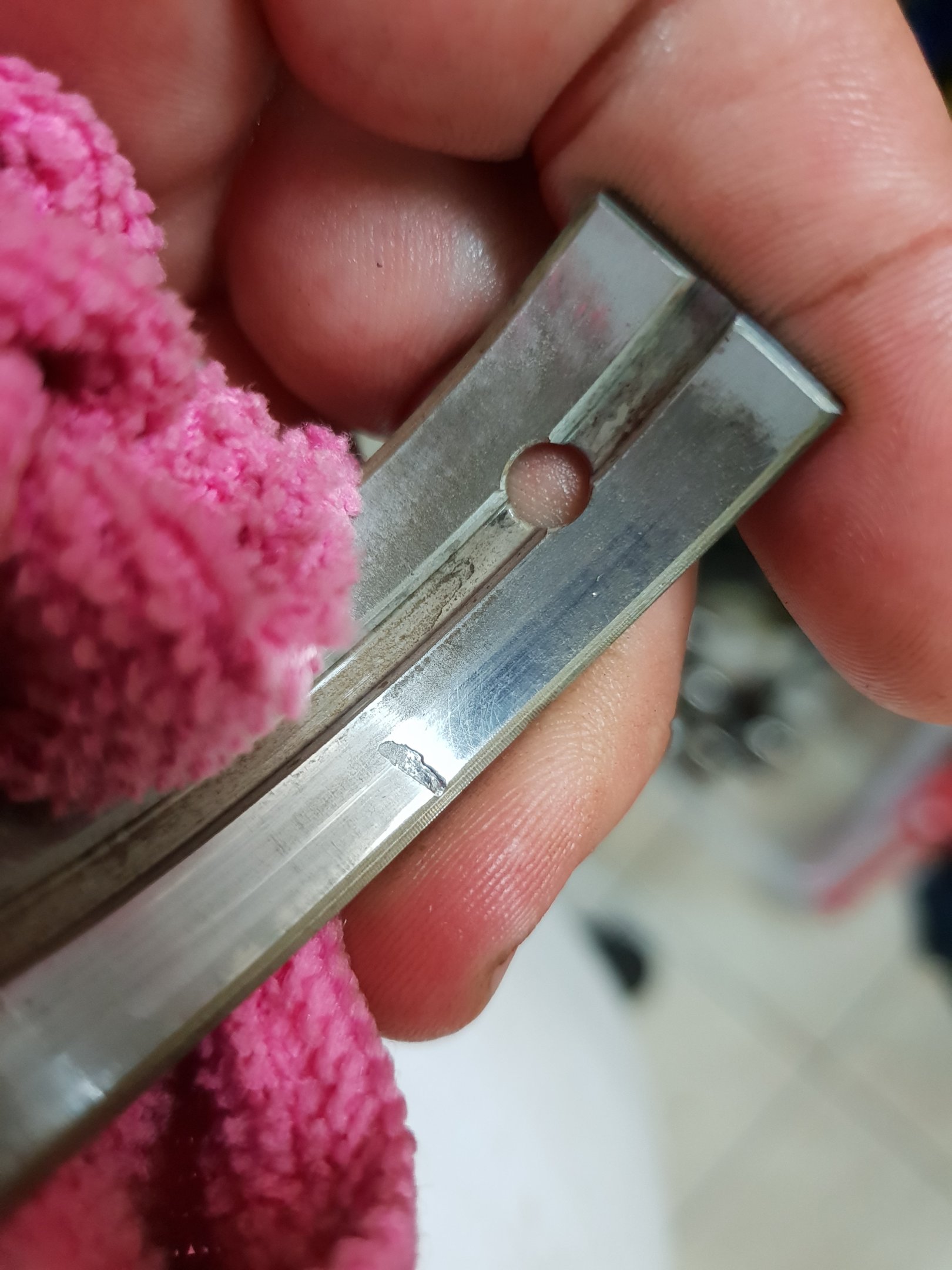

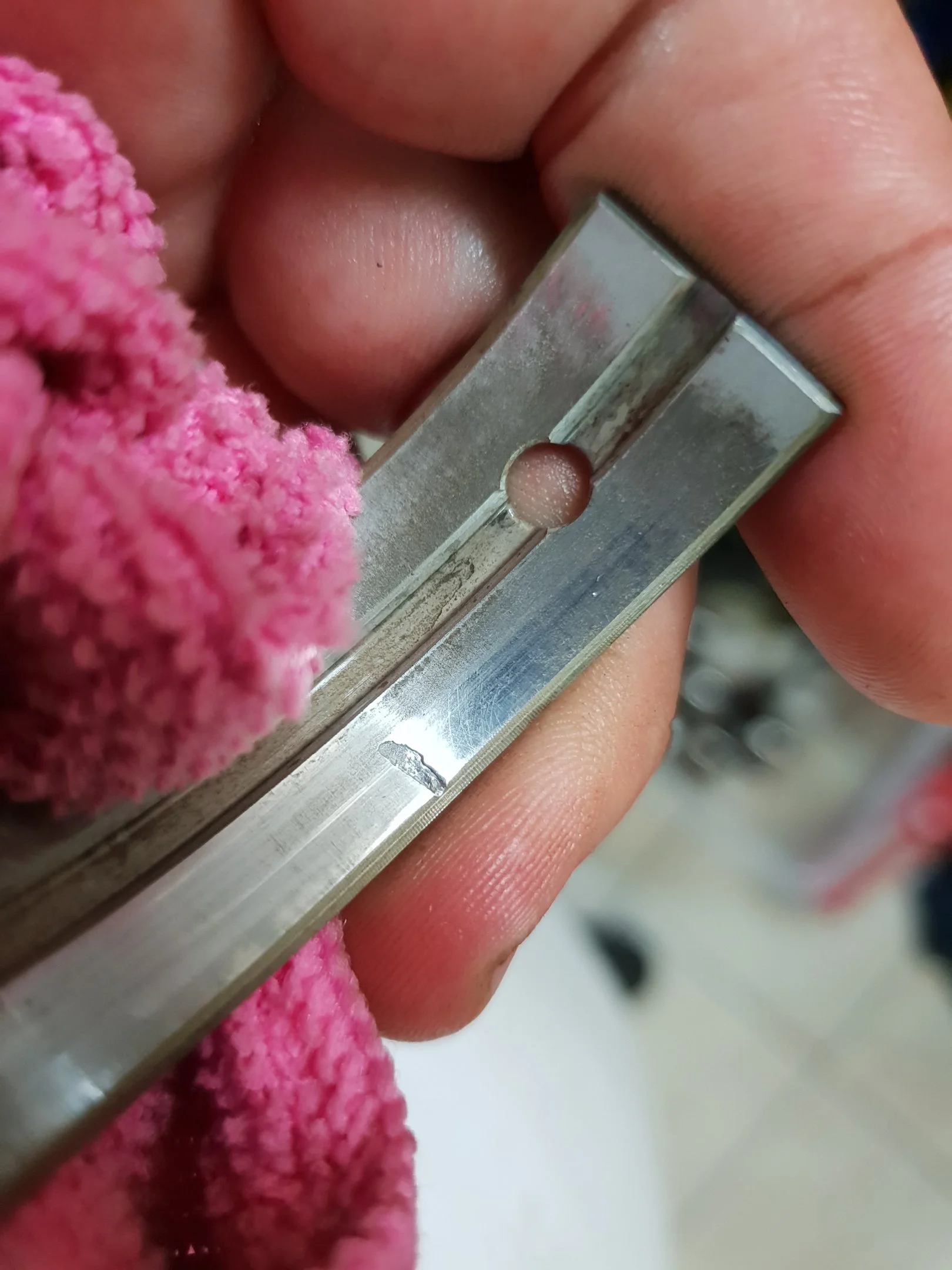

The big end bearings were original ones with the short part number (the last 6 digits from the 10 digit part number) and they still look like new.
The main bearings also were the oem ones, but one of then have a broken piece. It was still on the bearing, and when I remove the bearing it falls off.
I was lucky, no damage on crankshaft

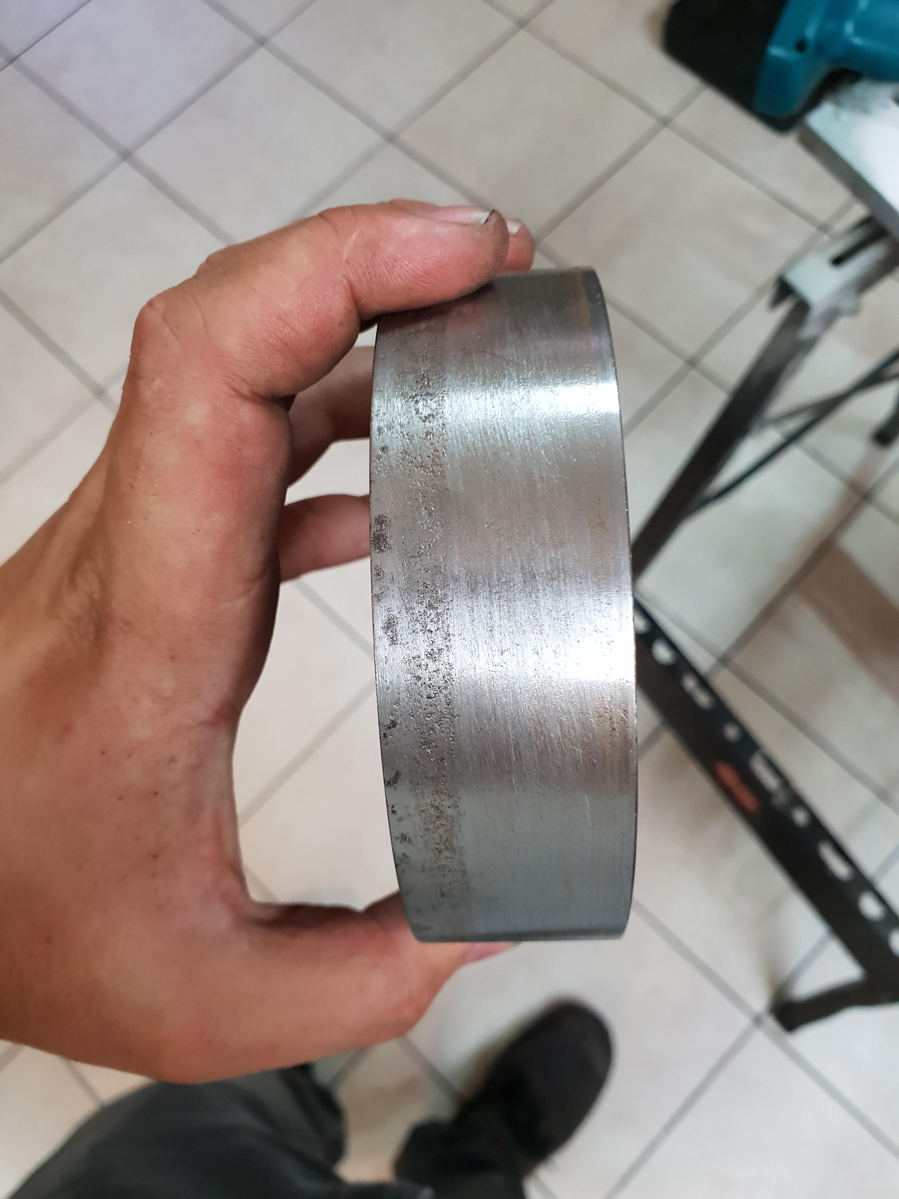

After I clean the old pistons I realize they were gone, the coating on them is damaged. So...new 4 oem pistons on next order. I have now all the parts needed to put my engine together. Here is a list with everything.
