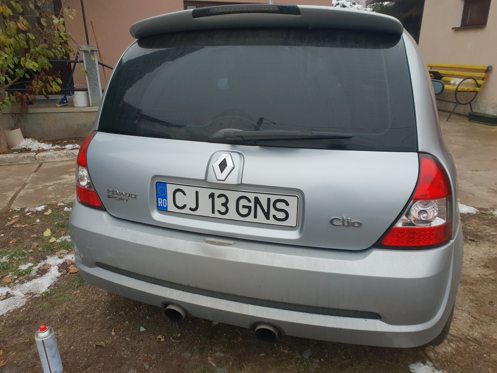

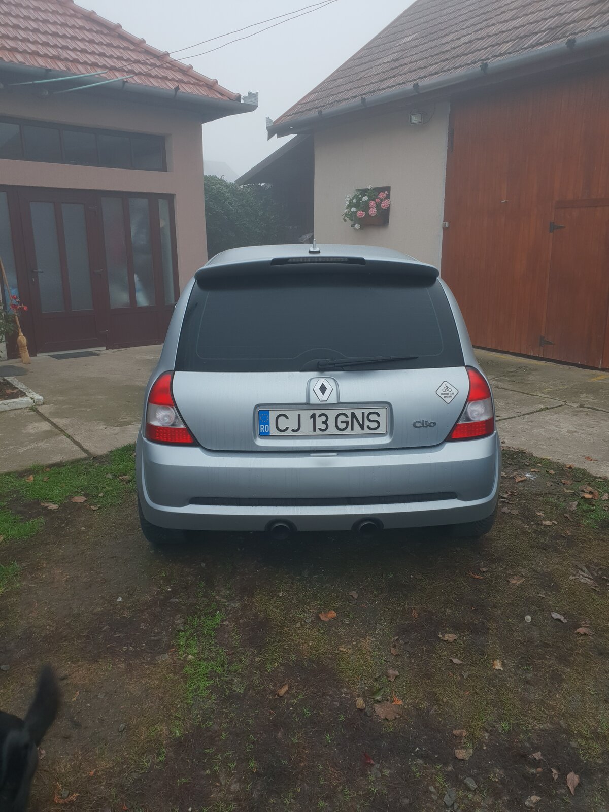

This is how 182 look was done on my Clio.

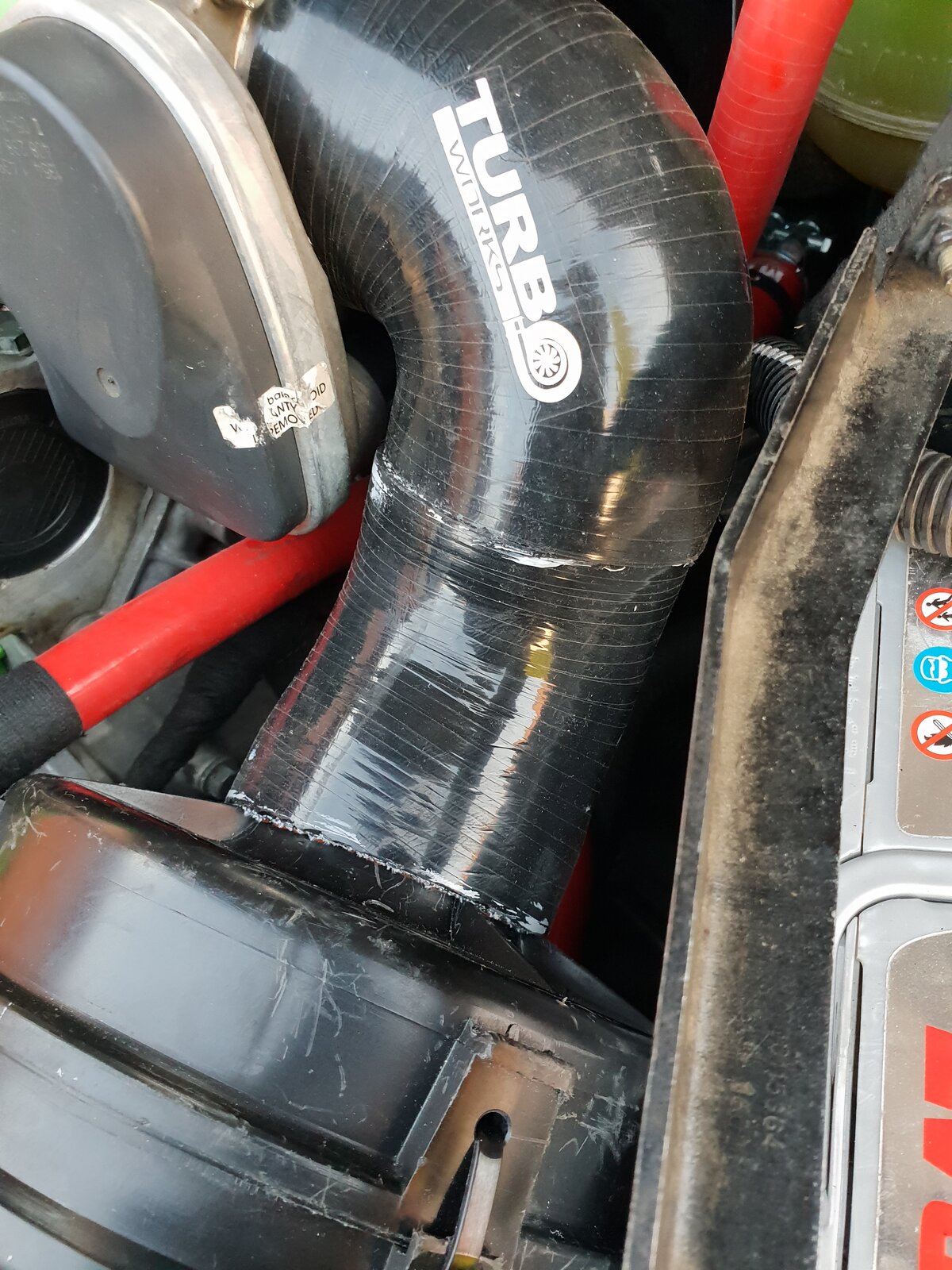

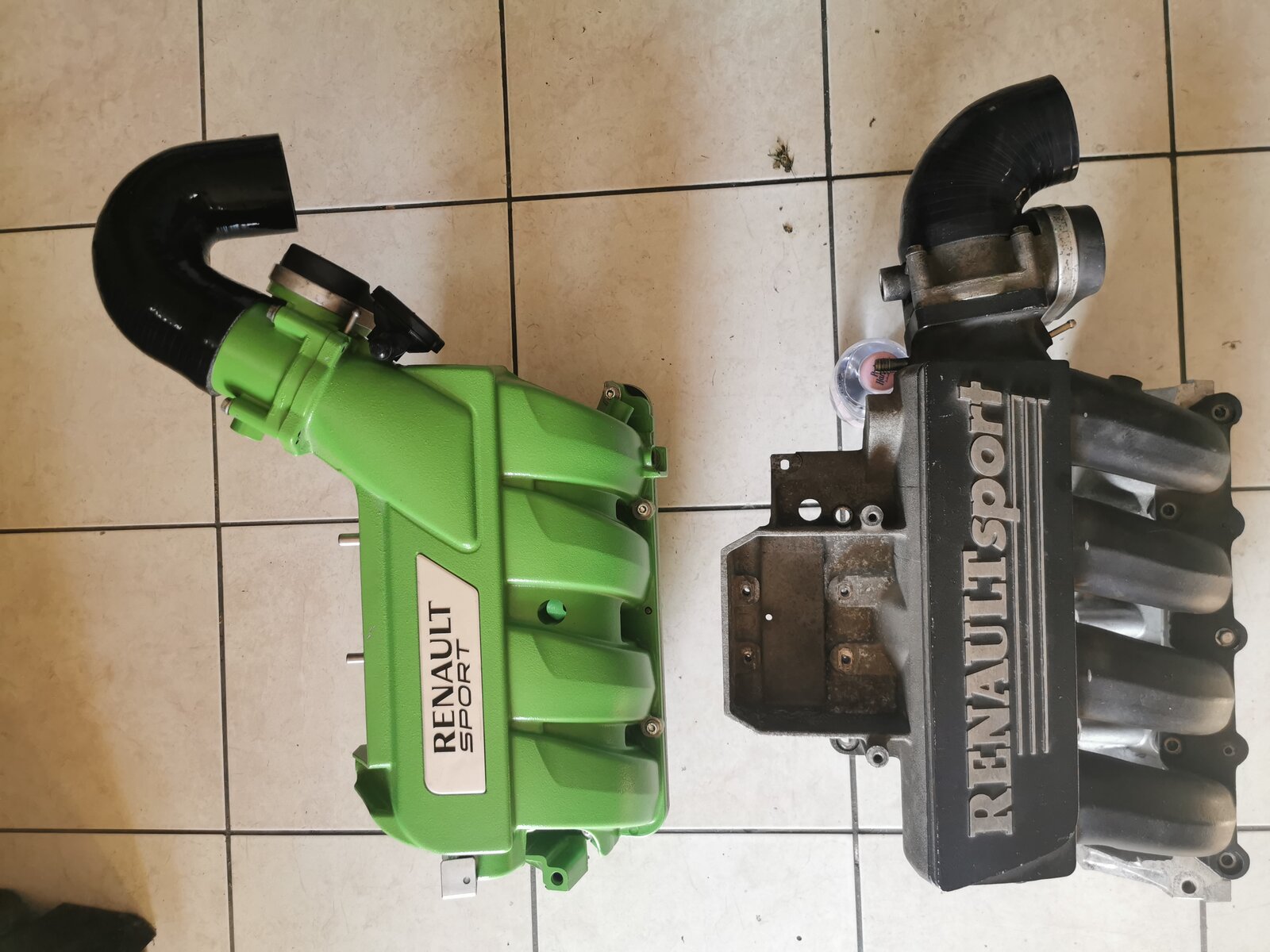

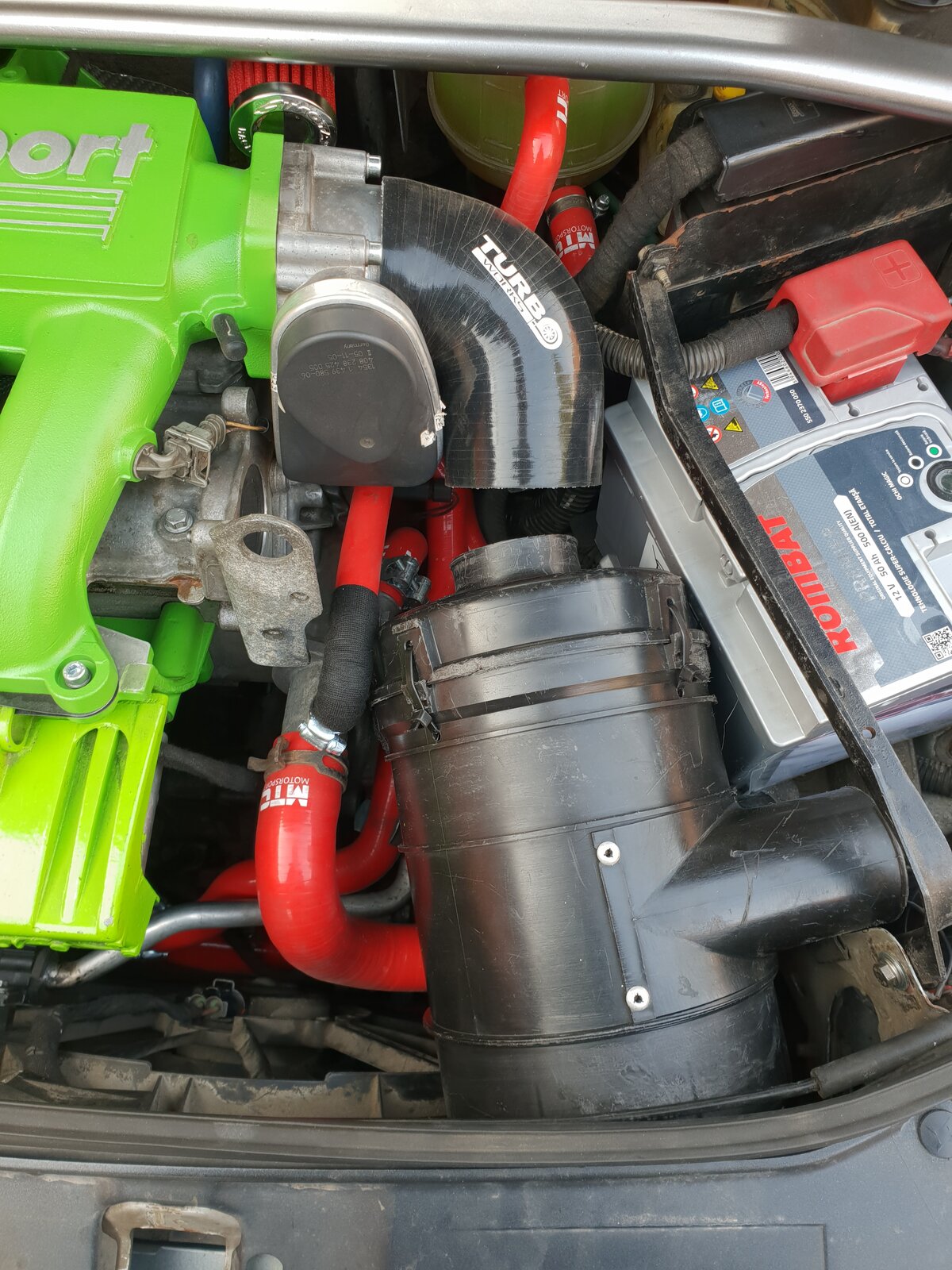

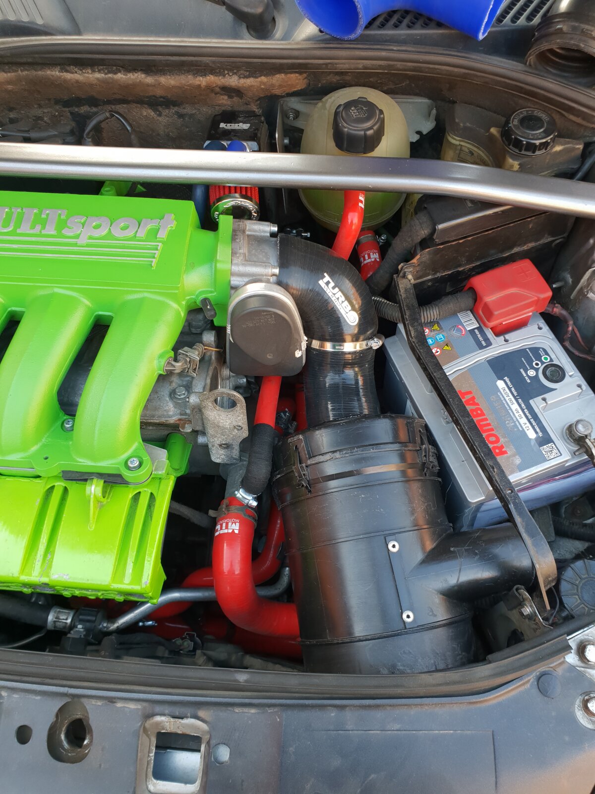

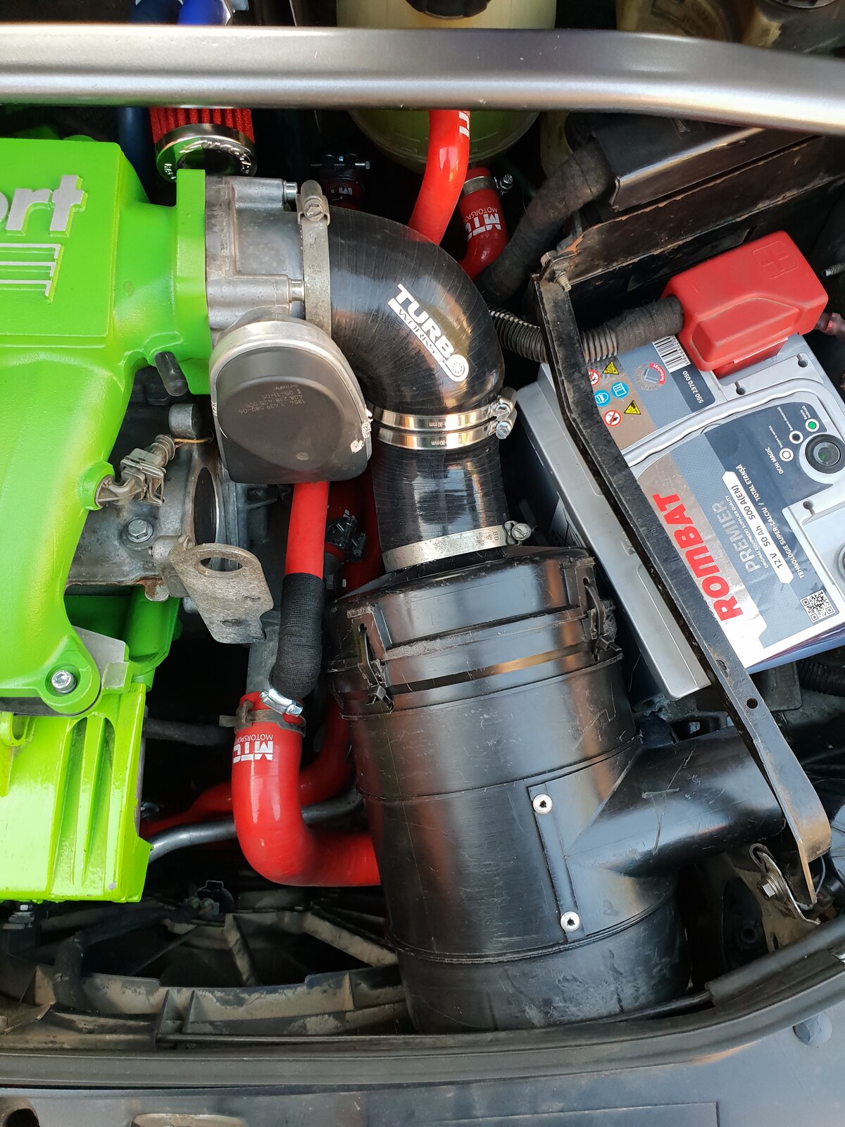

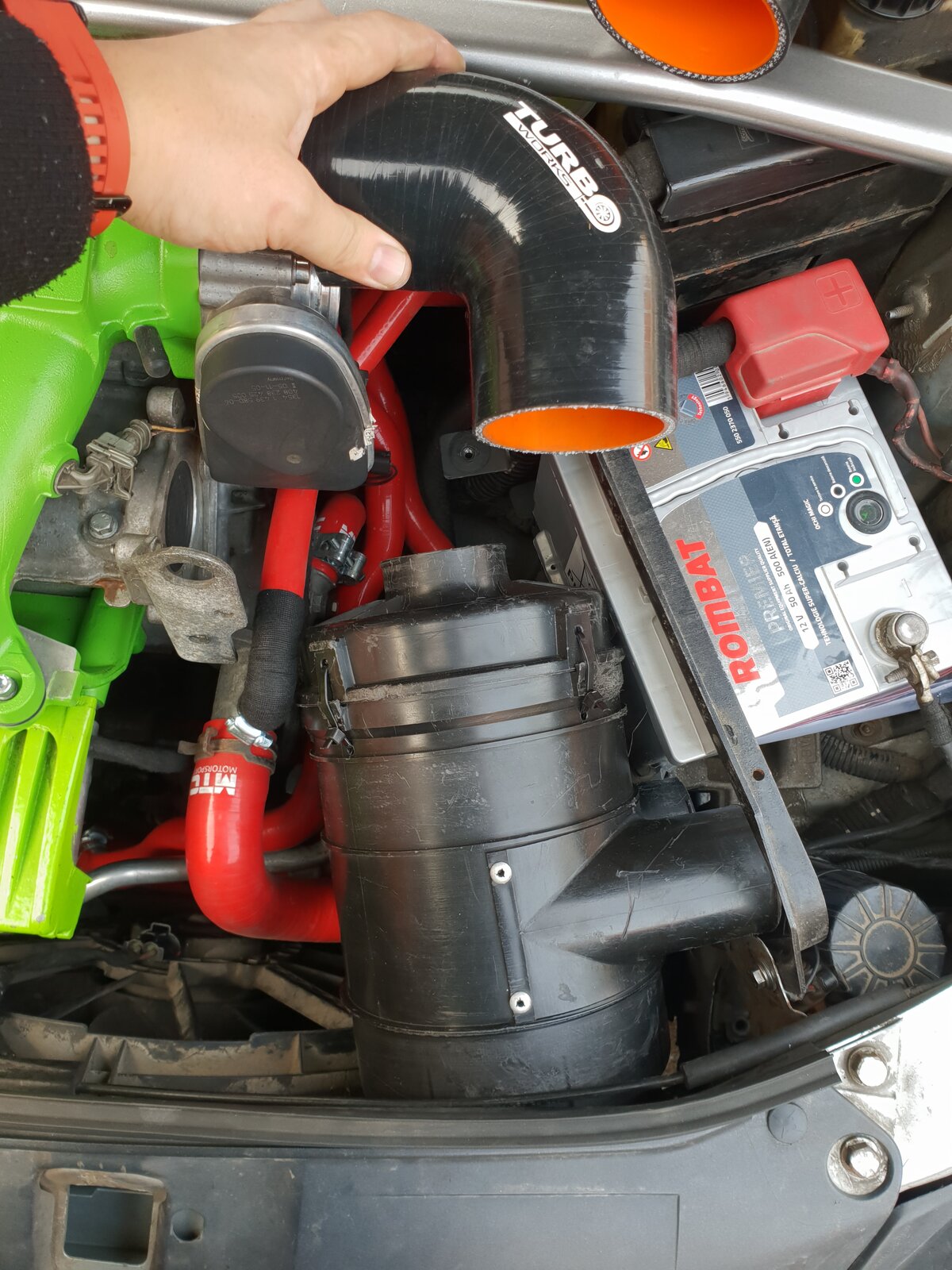

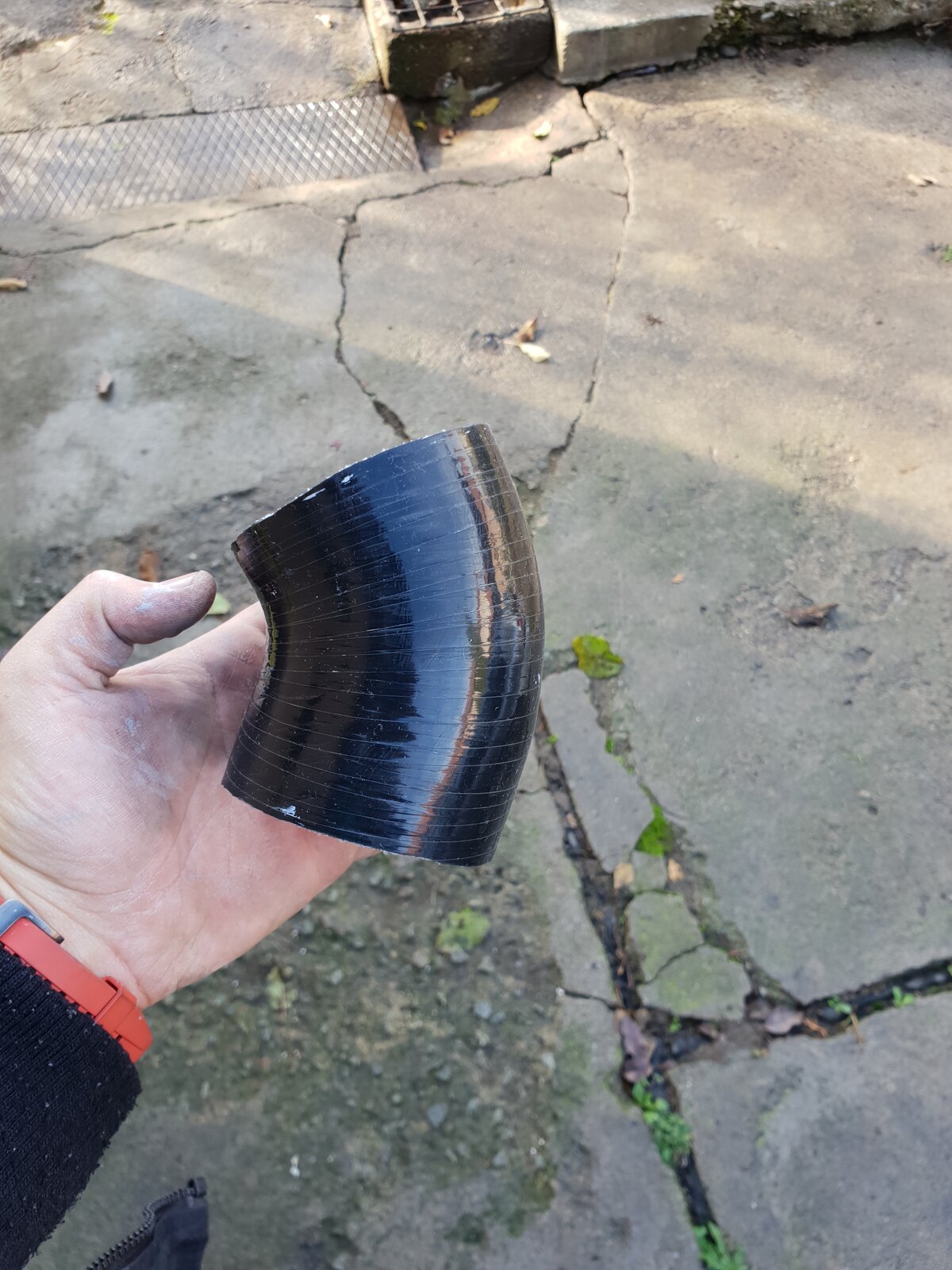

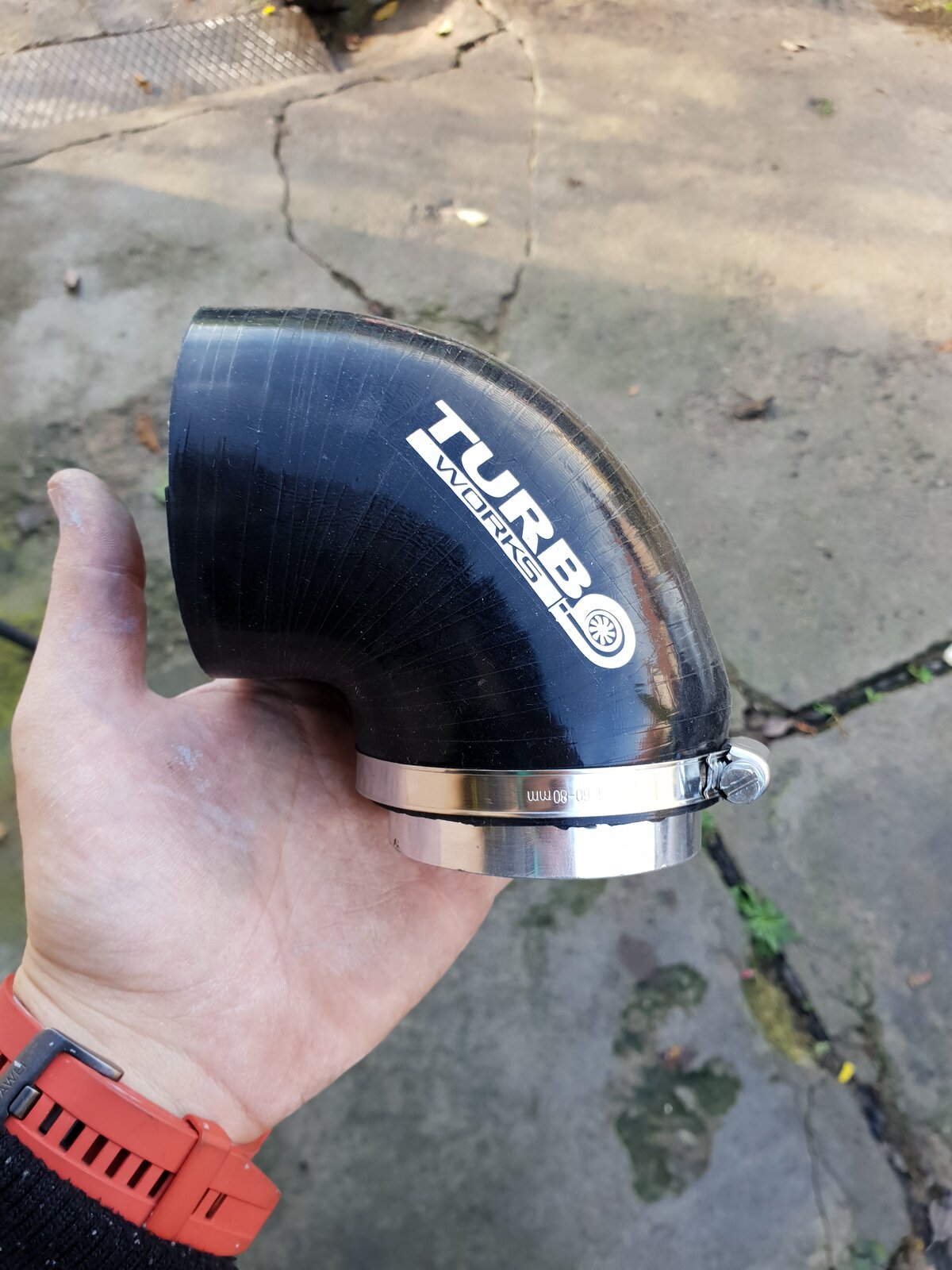

My (best) solution for fitting ph1 airbox using silicone hoses. I have a bigger tb so stock ph1 hose does not fit on it. In this case I was forced to use a 70mm ID silicon elbow. Using just one the airbox fits very tight and I did not like that. Start searching the forums, but no solutions to fit it like on a ph1.
For this I use a 90deg hose and 45deg one and paaaatience.
...two hours later...

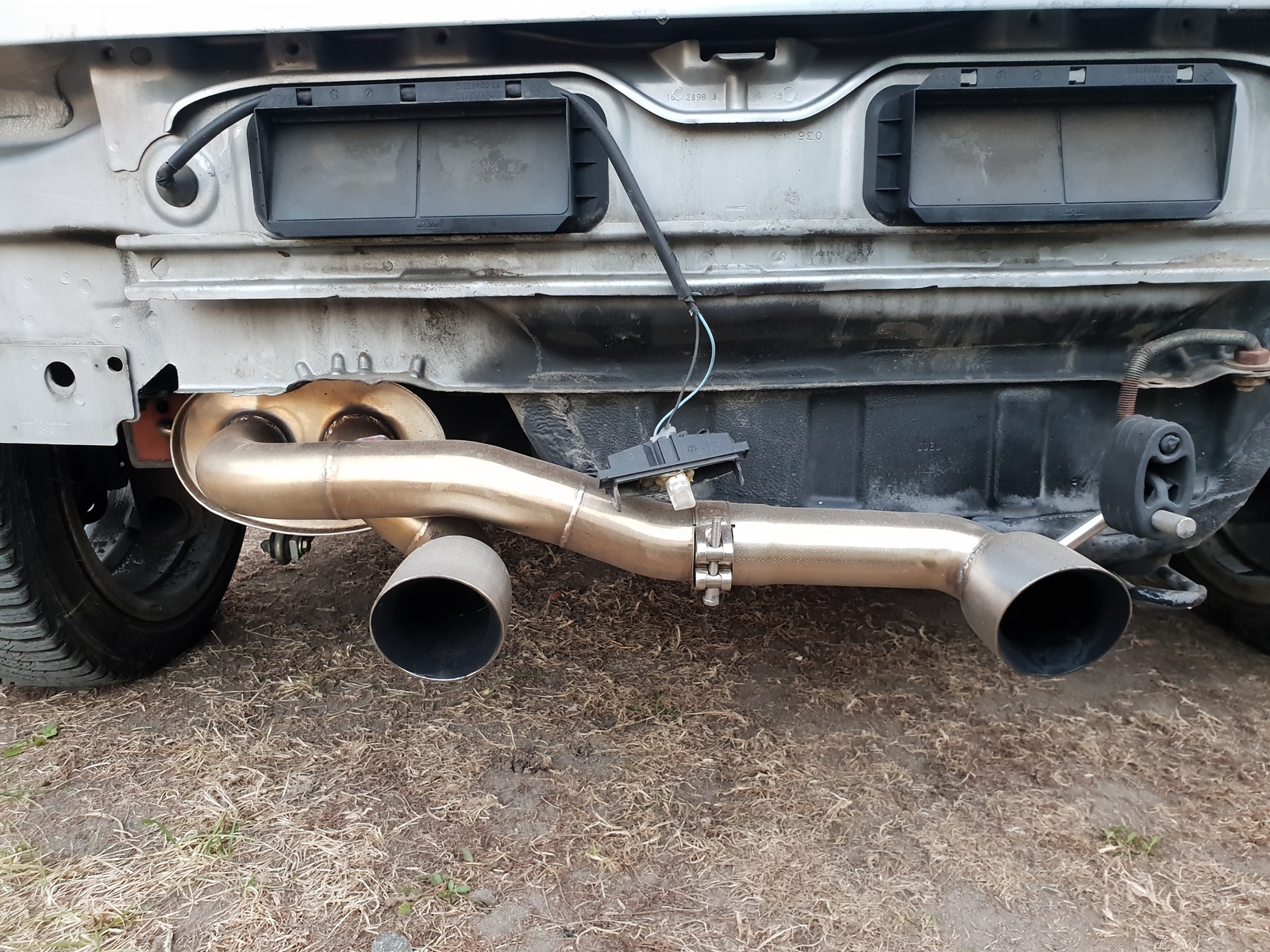

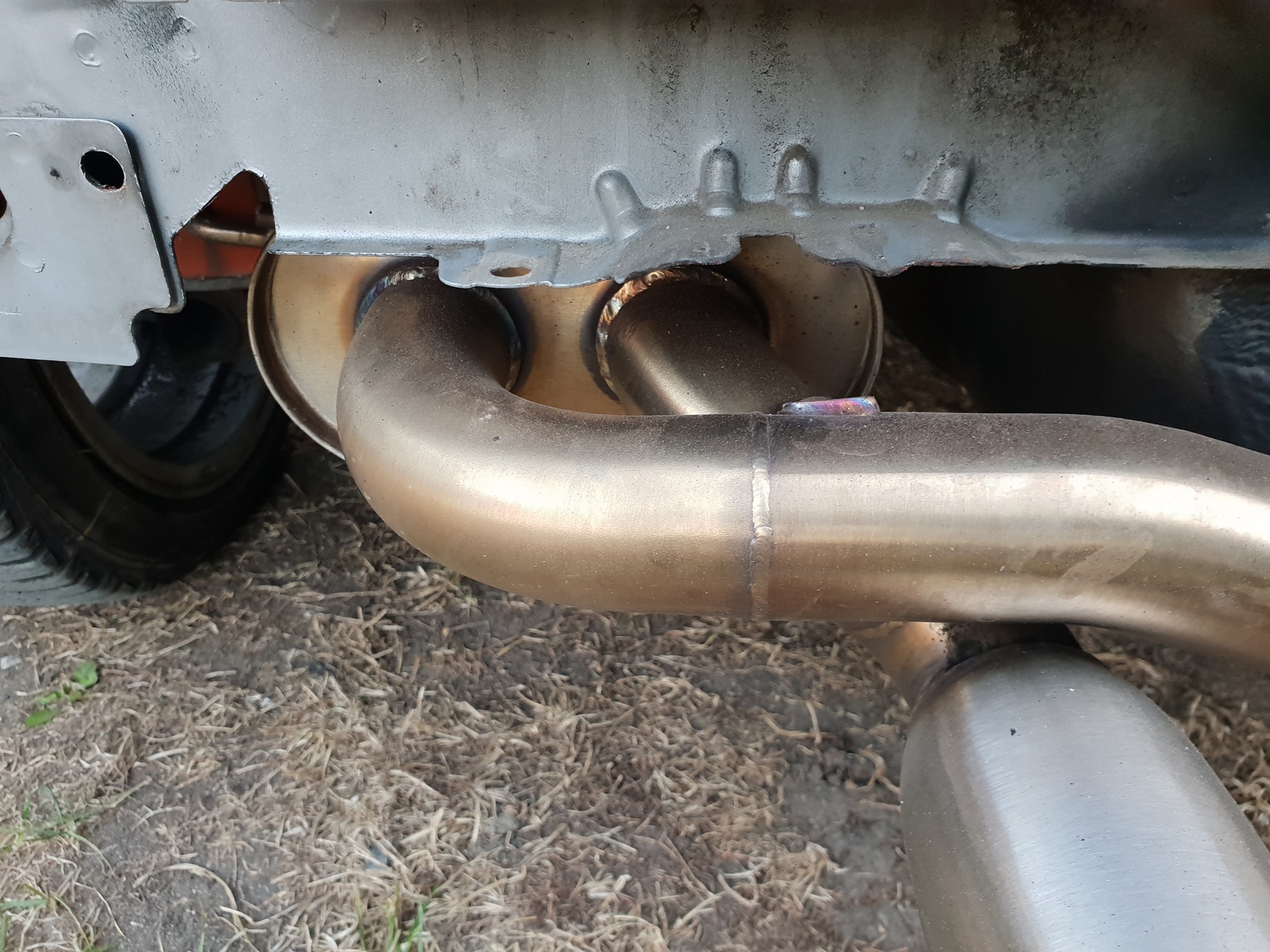

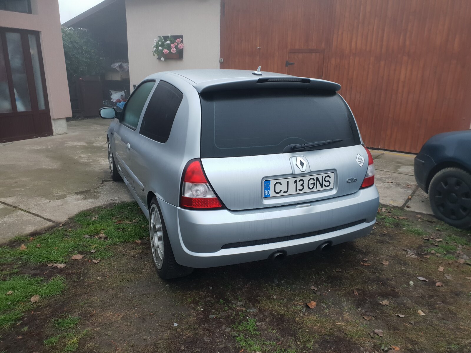

Some great updates on here mate. I somehow have managed to miss a load of your updates. Its brilliant you have a go at doing pretty much everything yourself. Car has really come along and looks great! I know it's not easy for you to get parts out there too.

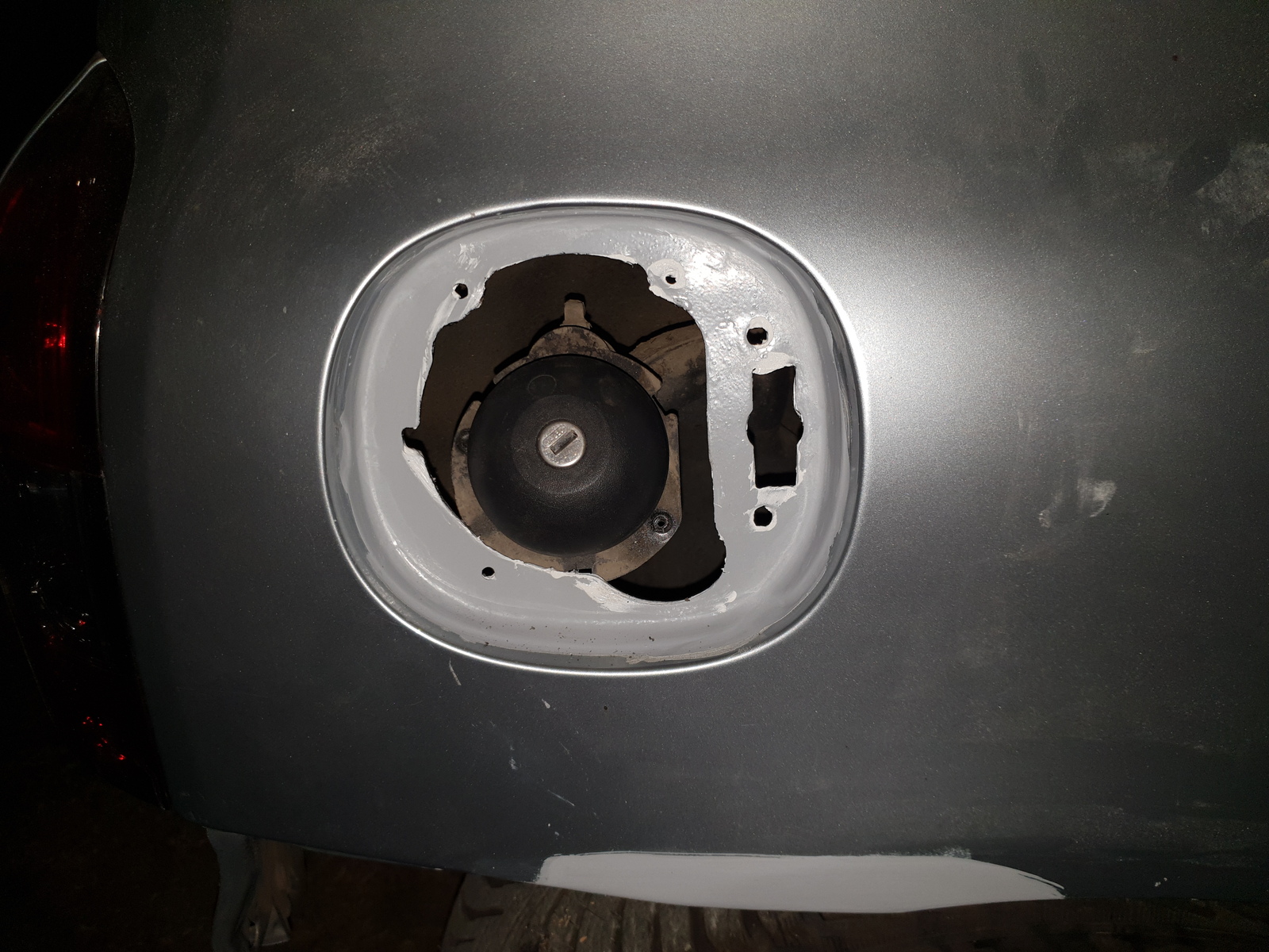

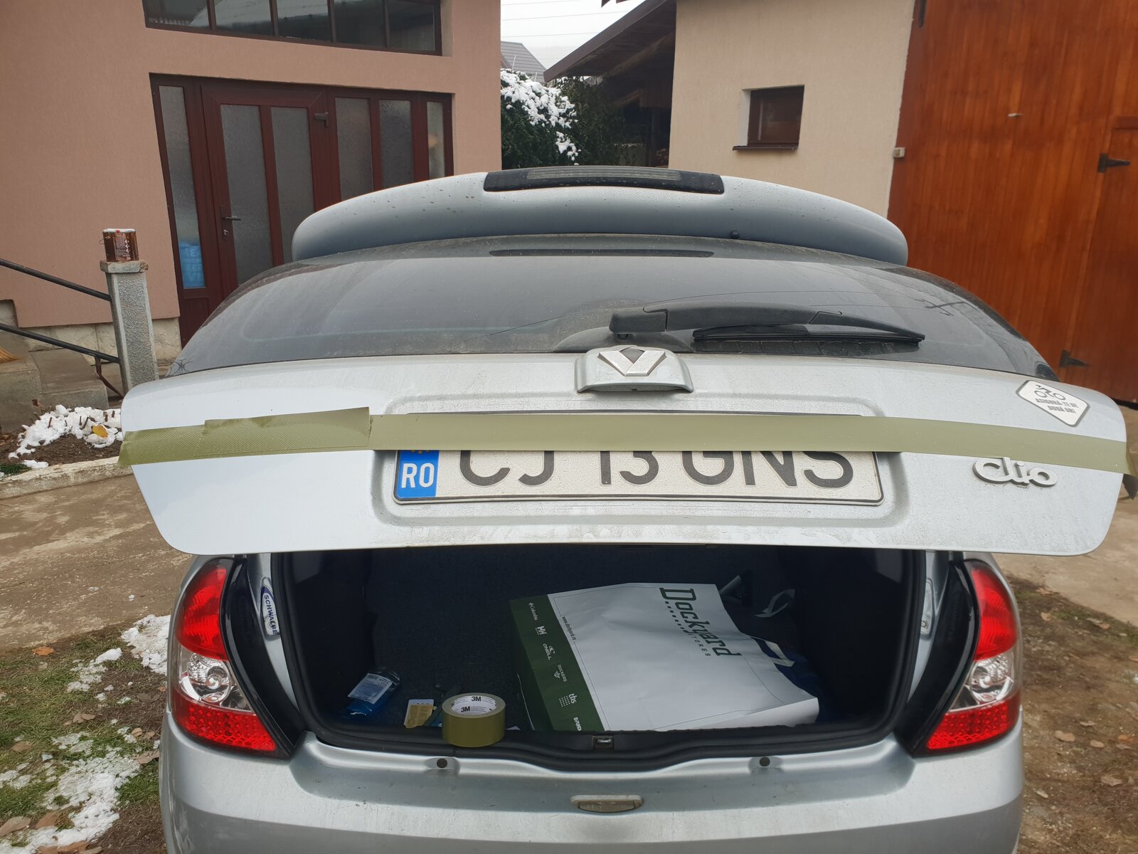

I am not normally a fan of 182 replica exhausts, but really like that. How did you find the spoiler to fit? All looks very smart 👍

Thanks a lot for appreciation. I could not find anyone that could help so I start to work alone and I am very happy. It was not that easy to work alone on the engine, but I managed to get it done without any left screws :))

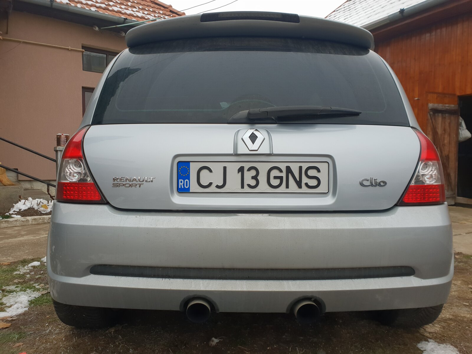

The spoiler is the one from Italy, with 2 lines on it instead of 1 like original Trophy. In order to fit it right, you need to enlarge the holes from edges (two on each side) to 10mm, or using a dremel tool to be more precise. Them some small M6 screws and thats all. It does fit fine if you enlarge the holes, impossible otherwise.

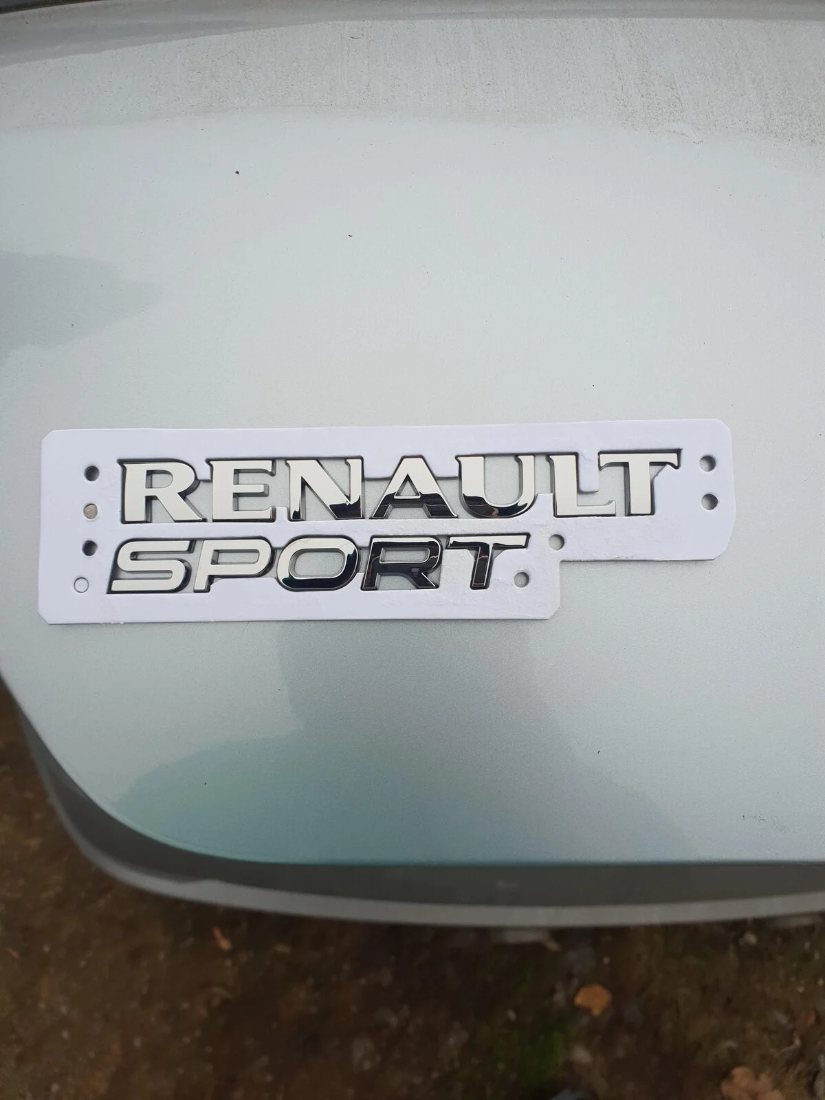

Now I am waiting for a Clio 200 Renault Sport badge to fit it on the left side:).
Cheers

Nice one. Sounds very similar to my replica spoiler. I also enlarged the holes on mine and fits well. I much prefer the brake light and style of the trophy spoiler.

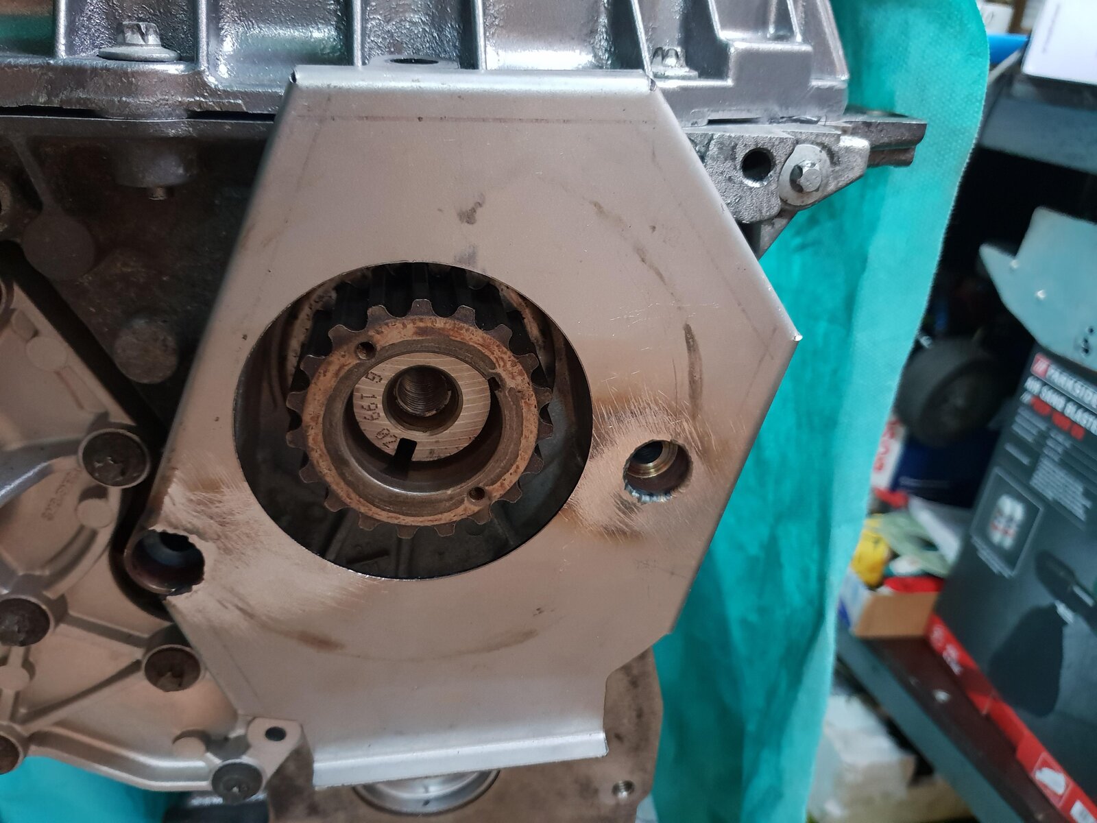

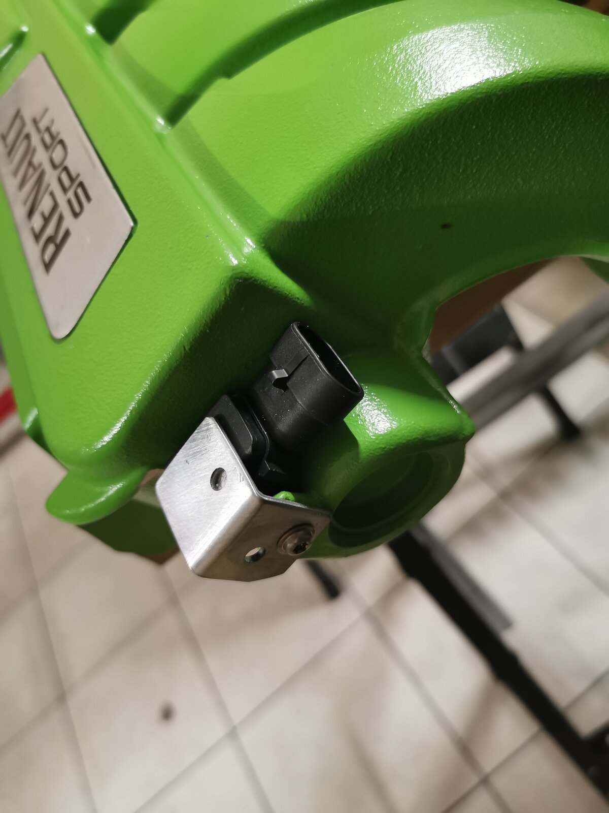

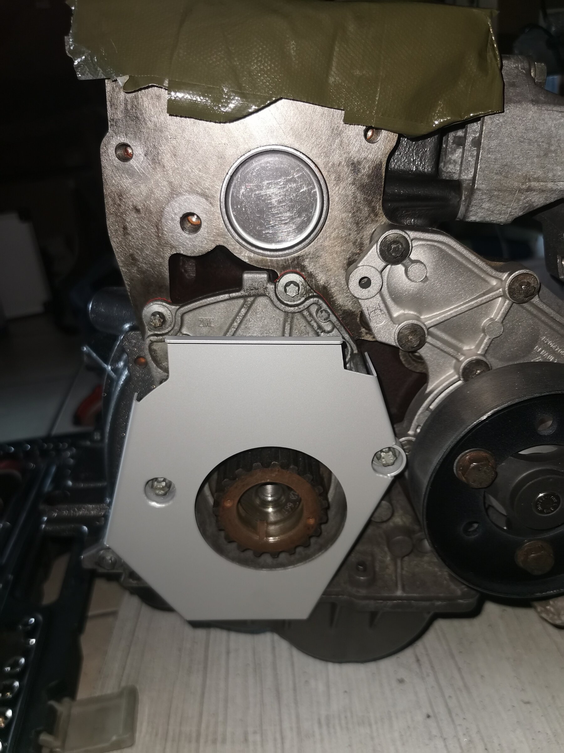

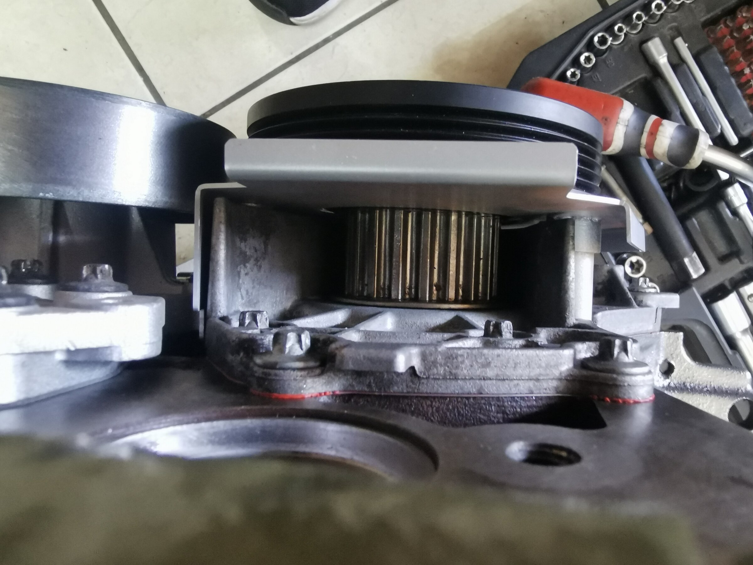

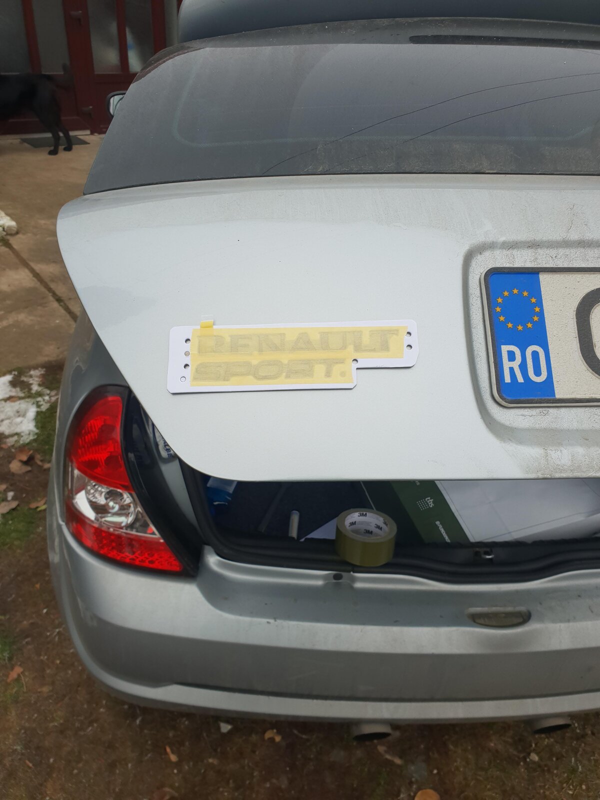

Add the "Renault sport" badge and test fit a cambelt protection. It does need some small adjustment because the aux pulley does touch the plate, but not a big deal to solve.

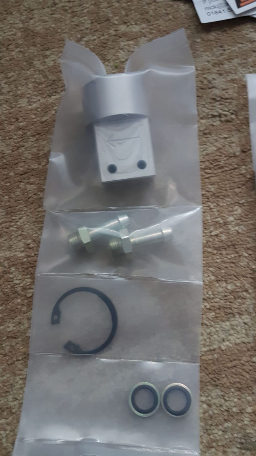

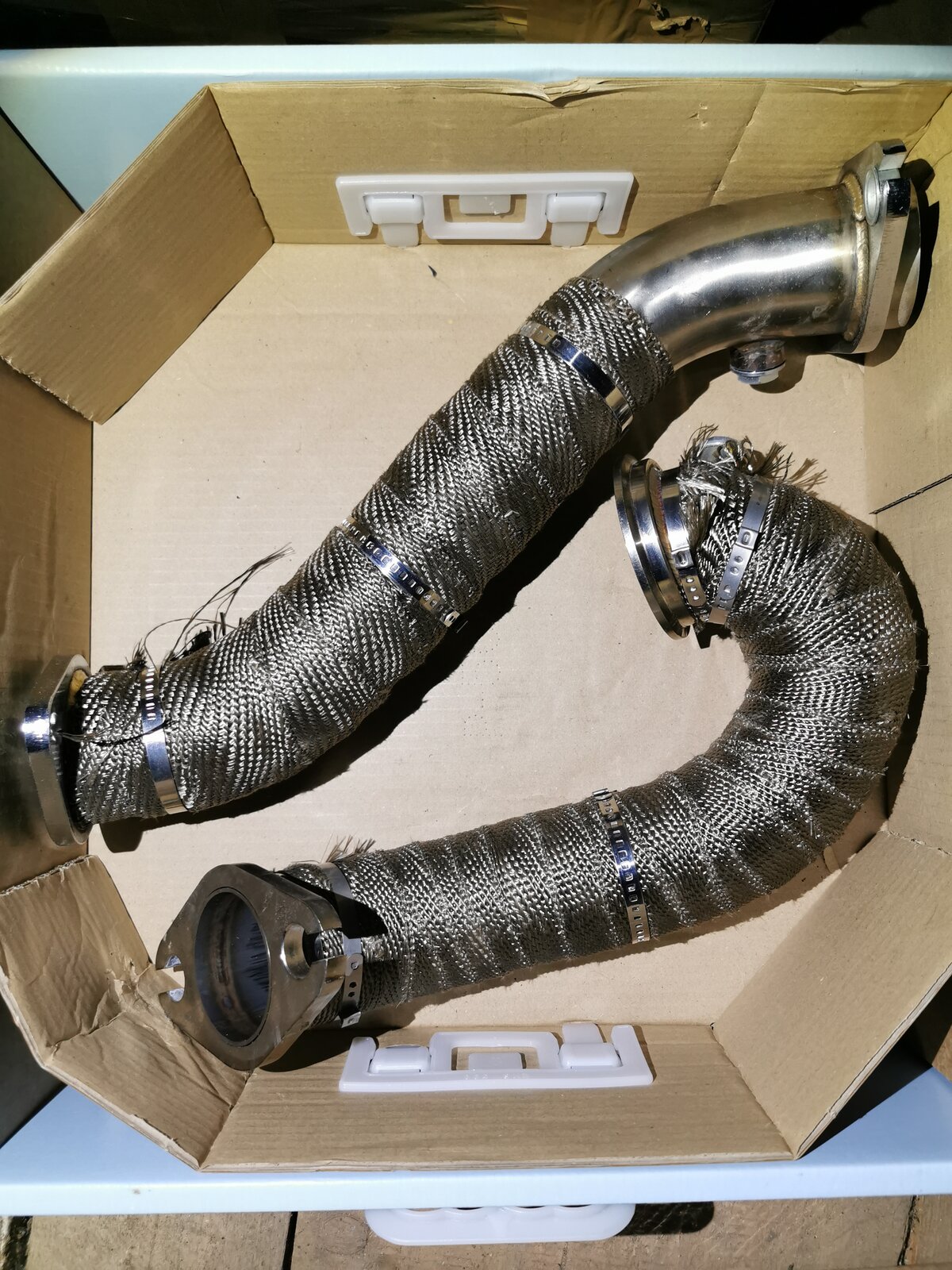

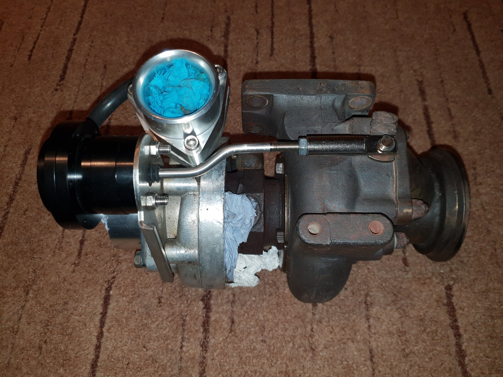

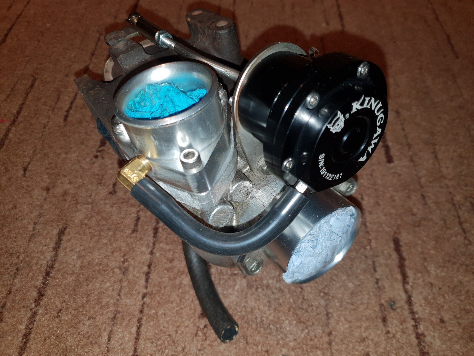

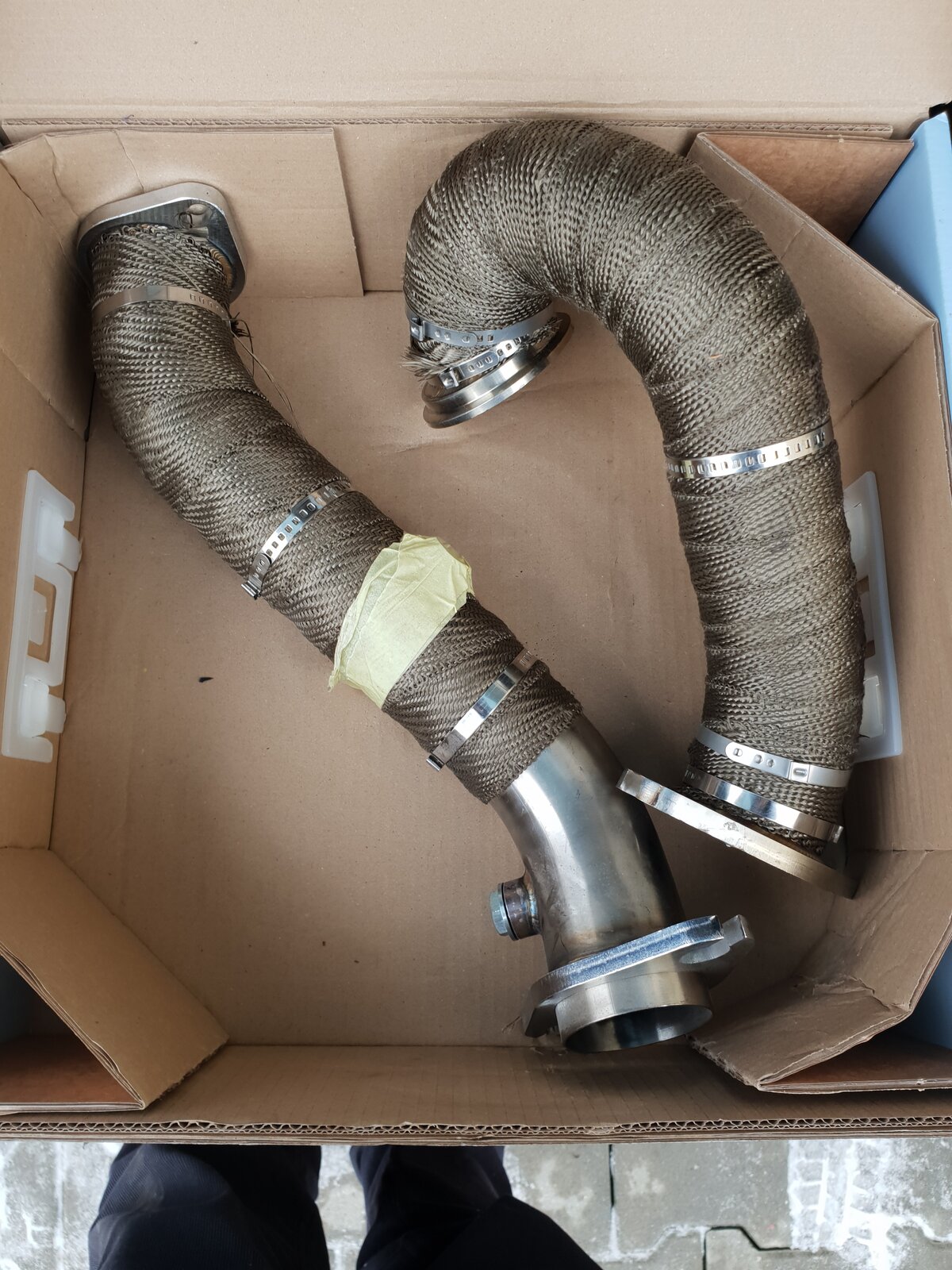

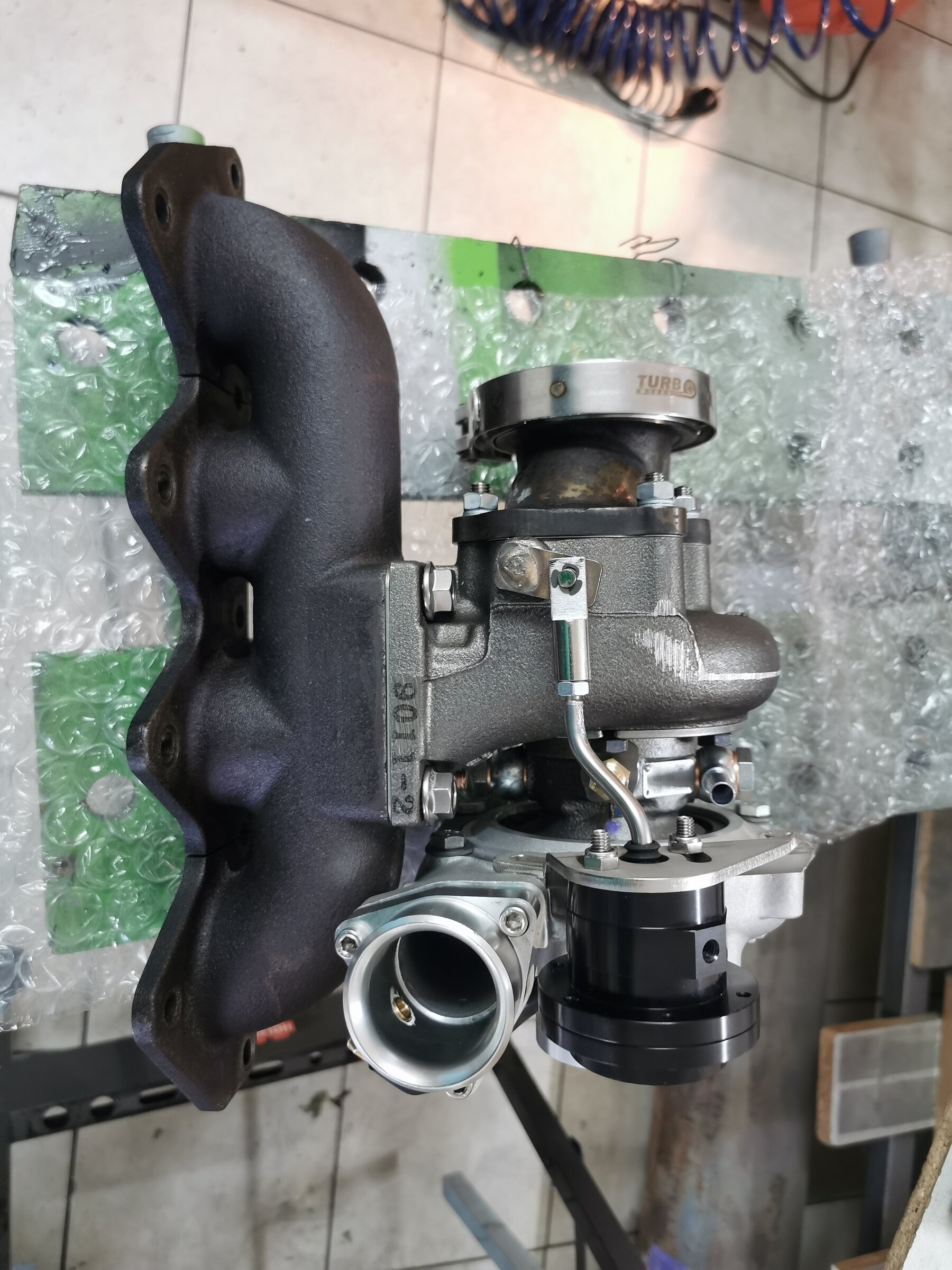

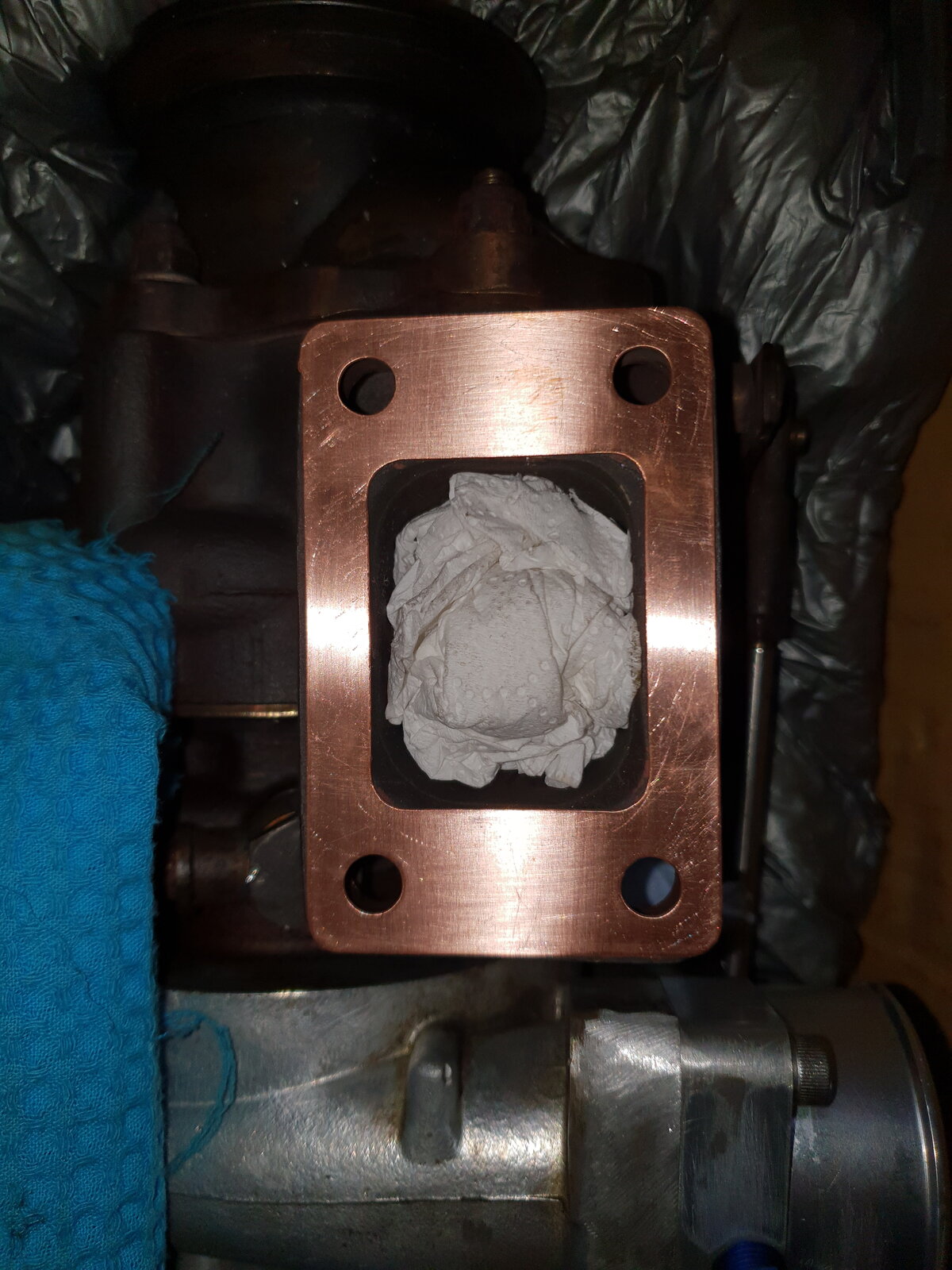

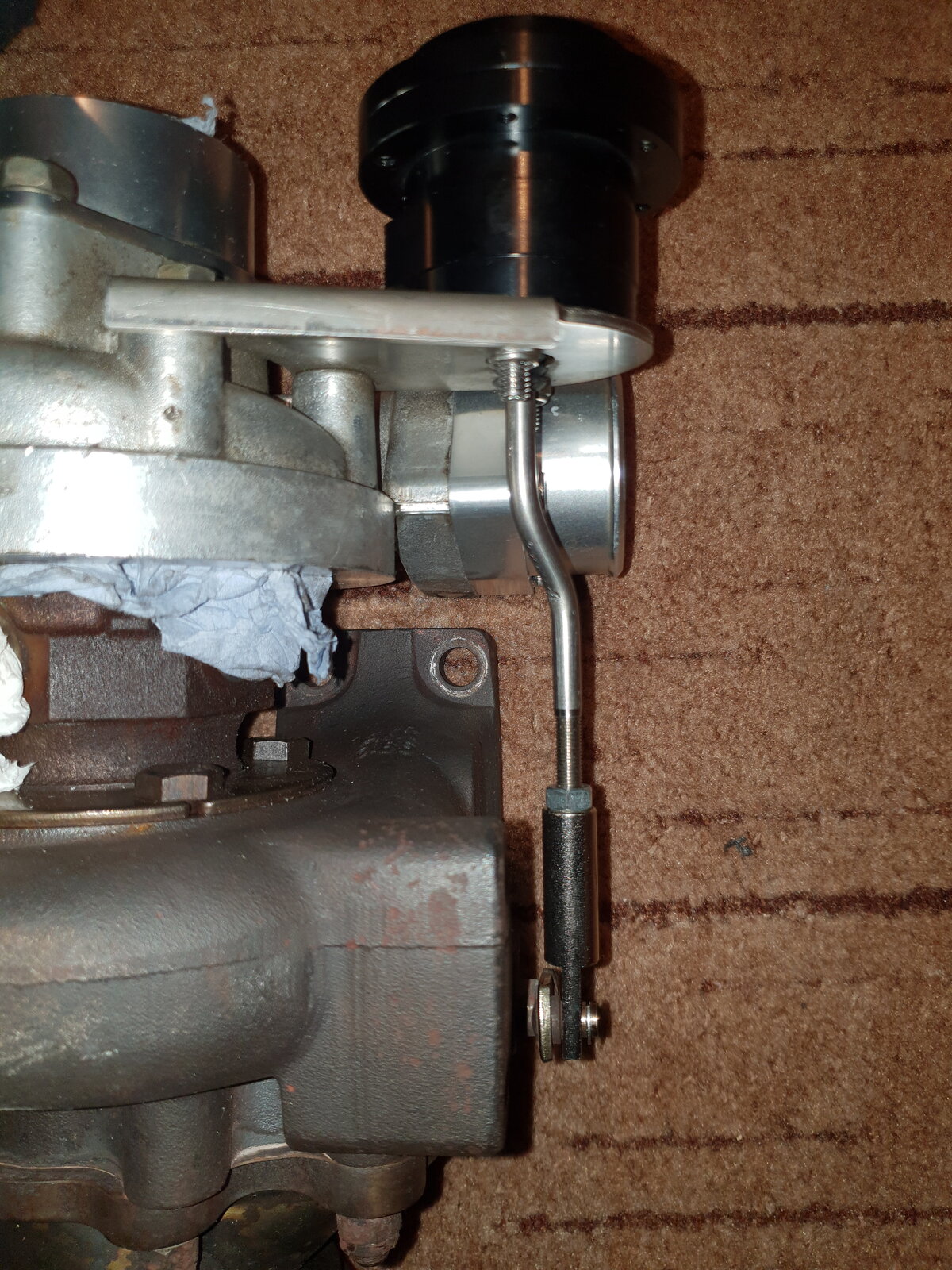

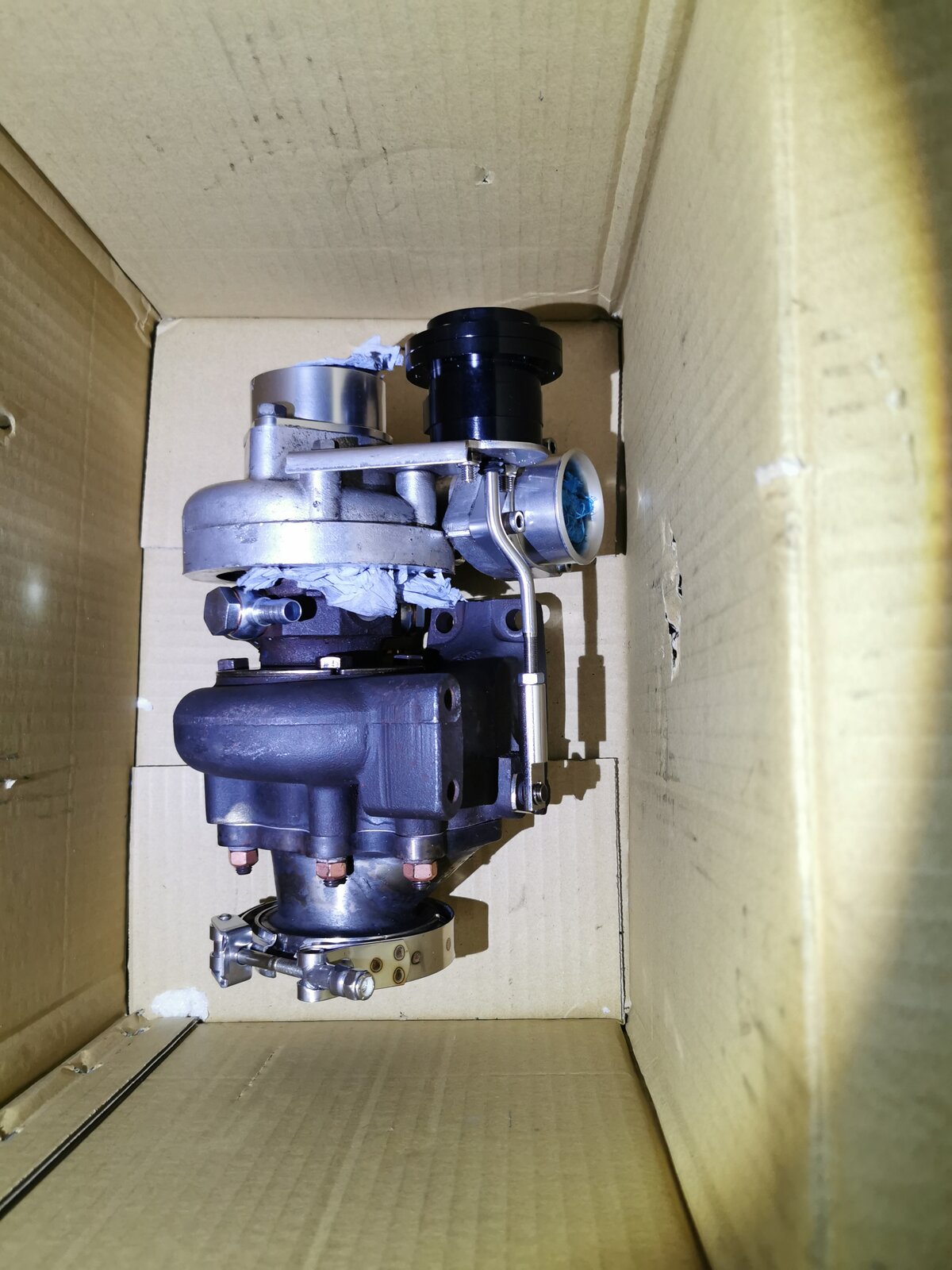

Almost all the parts for turbo conversion are here:
ED turbo with Kinugawa actuator

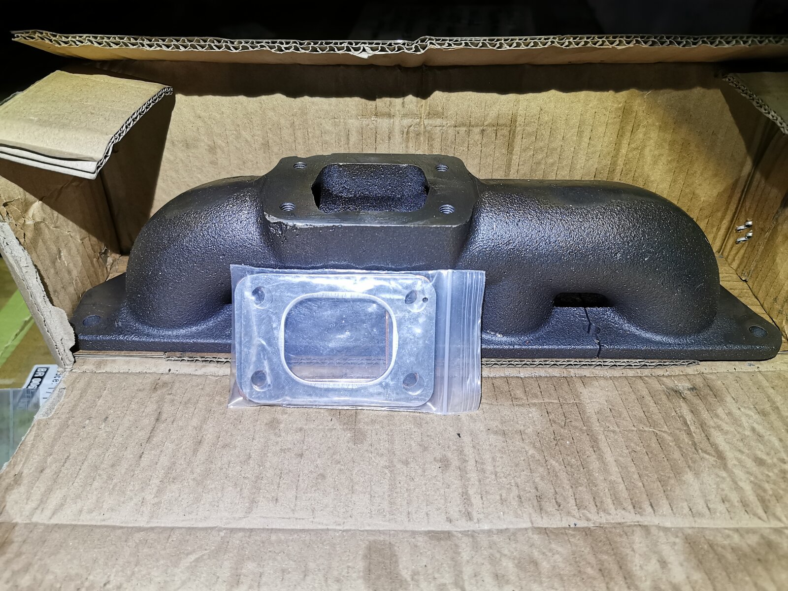

Ebay turbo manifold
197 fuel rail with custom return pipe

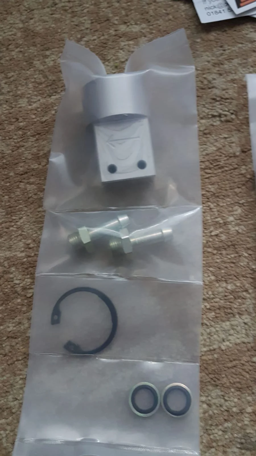

PMS regulator housing
AN10 oil return
AN4 oil feed ED
ED water feed
Efi boost module

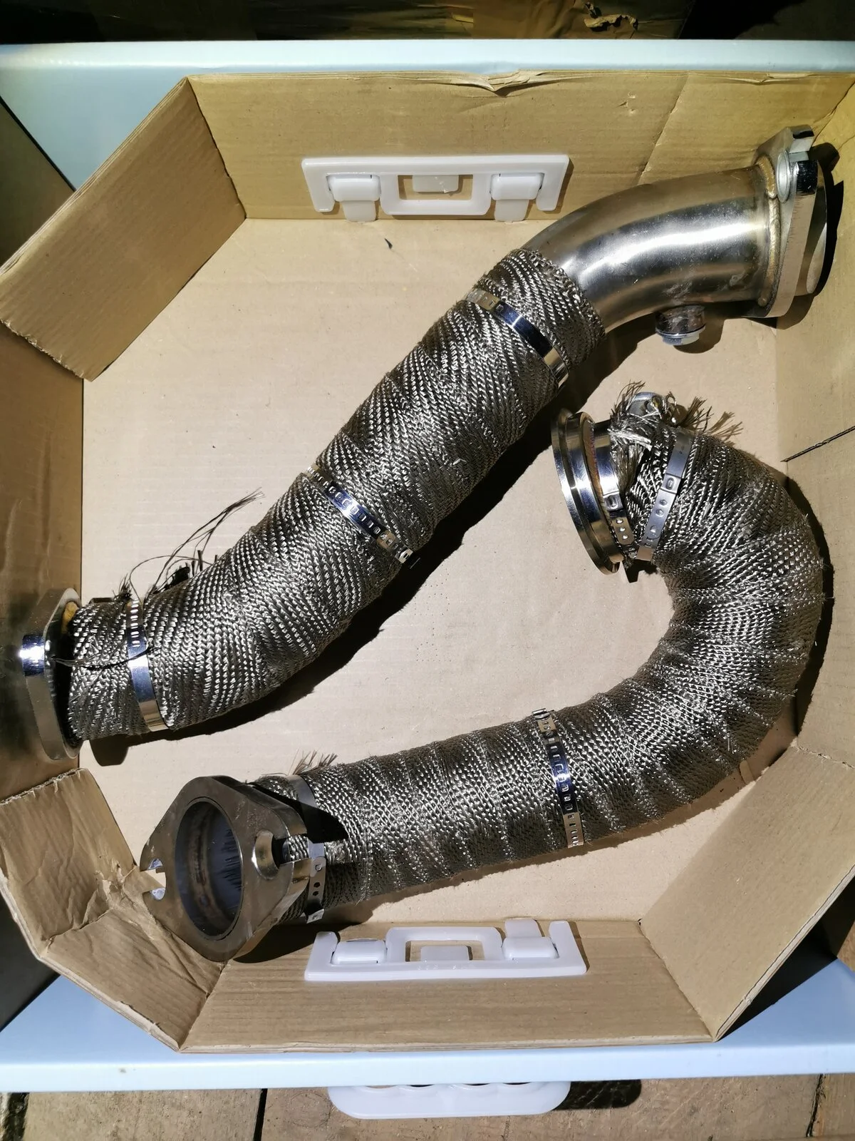

ED downpipe
KN air filter

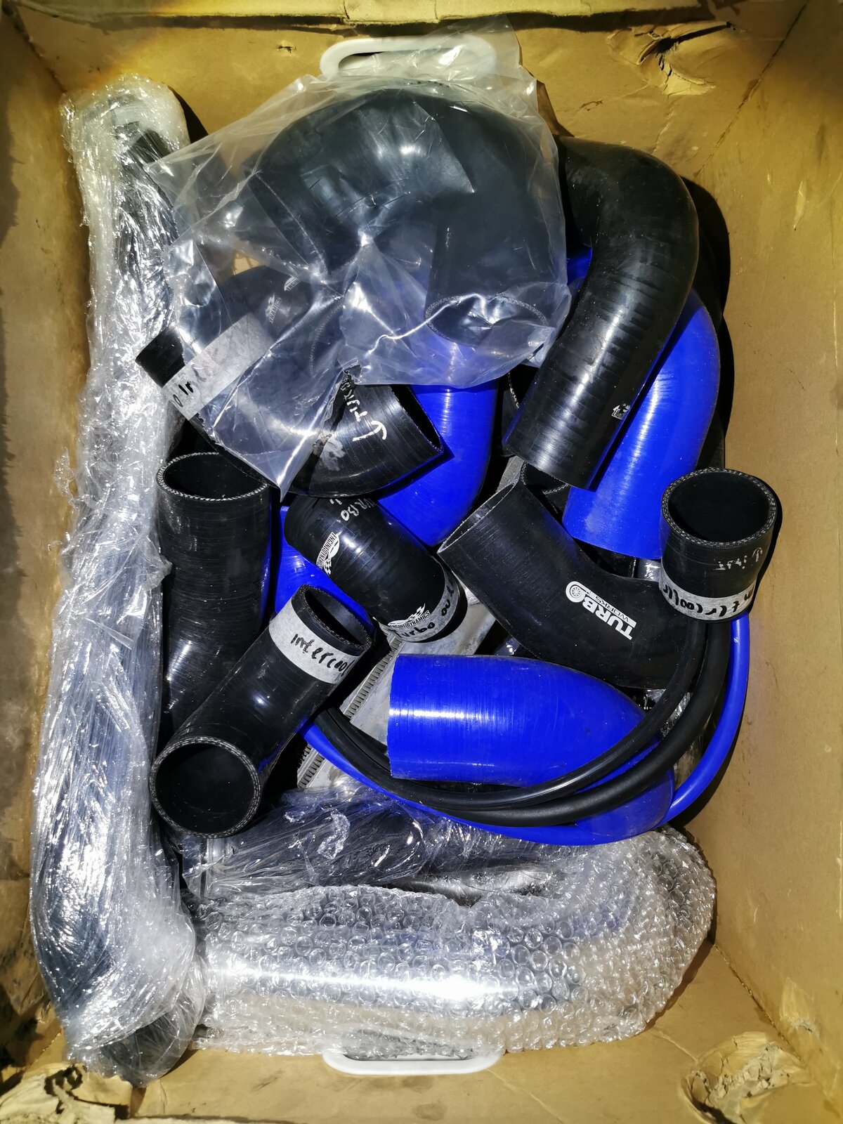

ED pipework with 135 degree silicone for 197 inlet
Catcams camshafts.

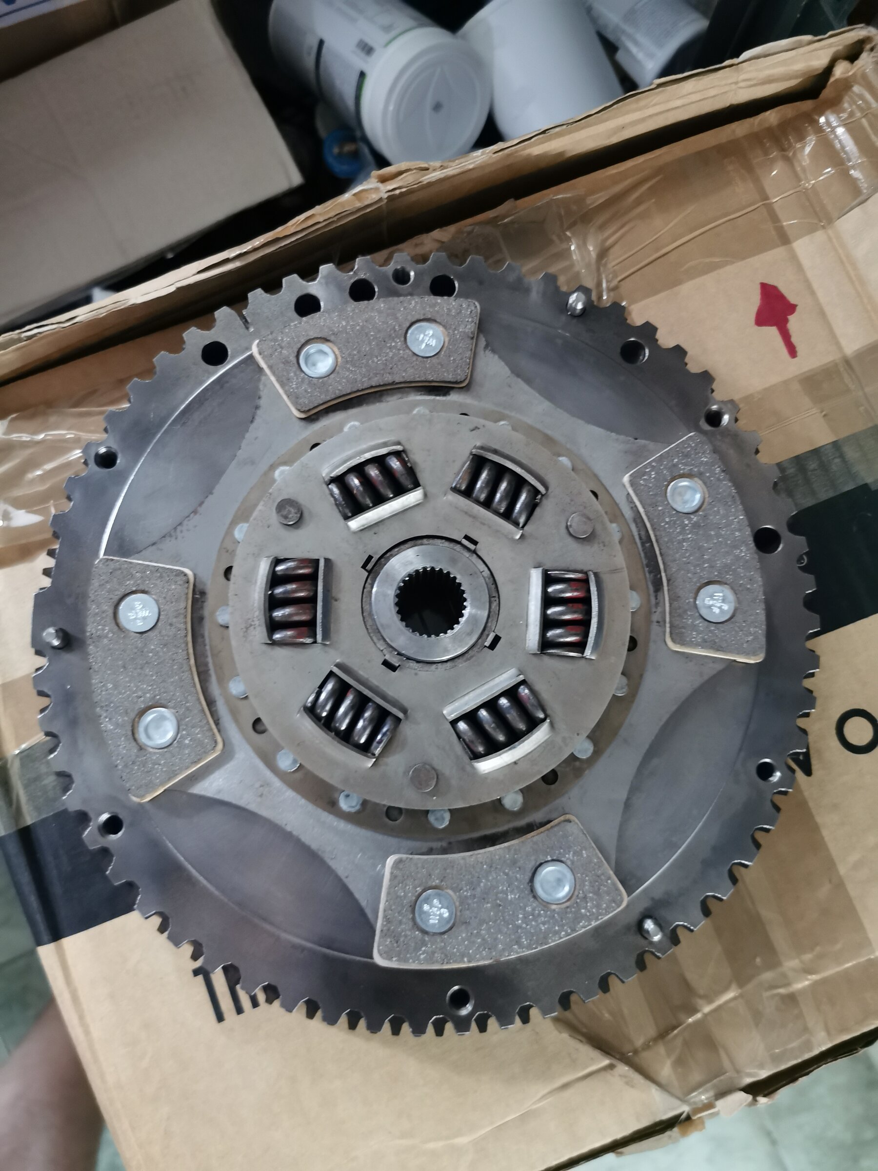

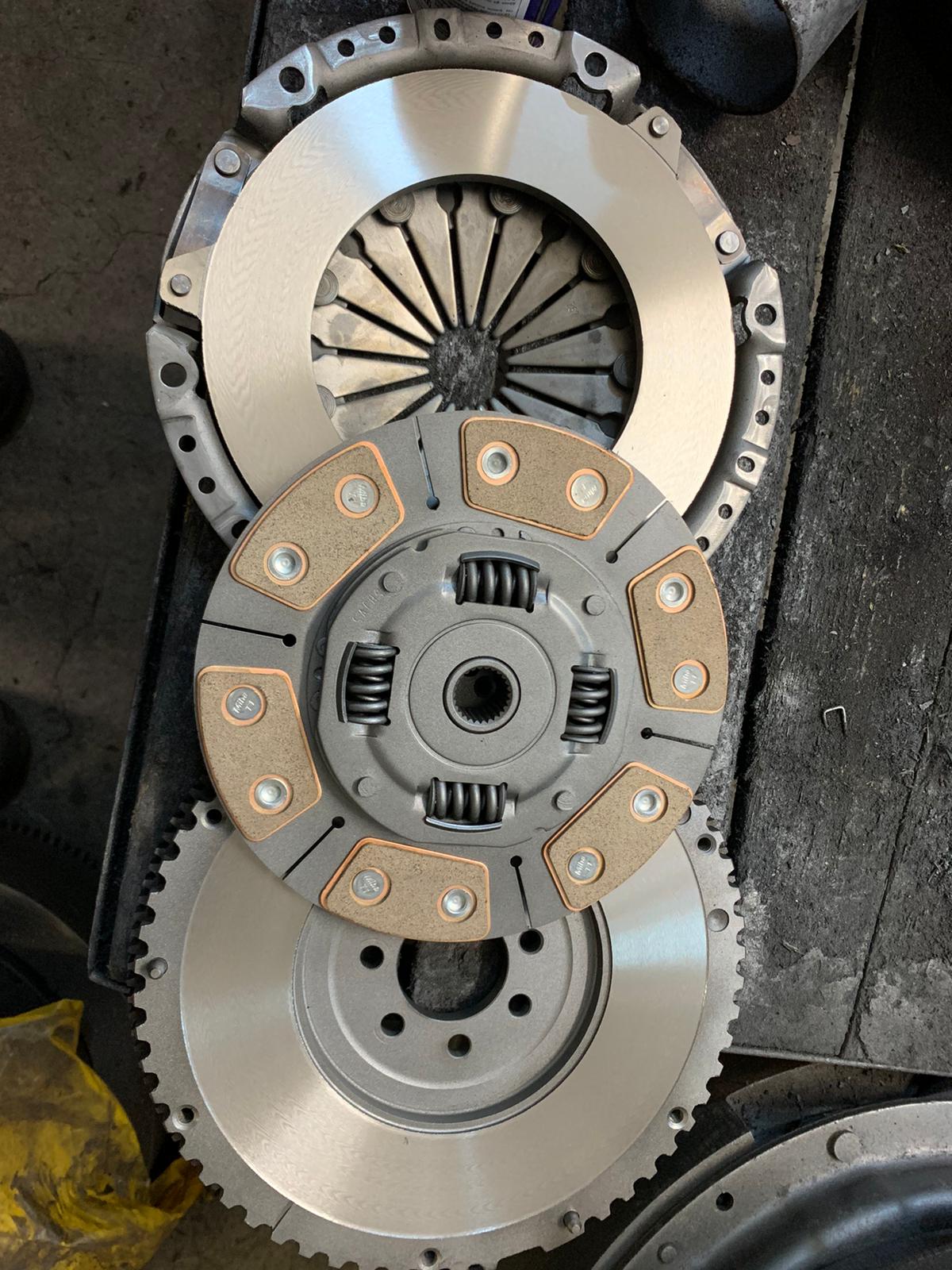

Custom clutch

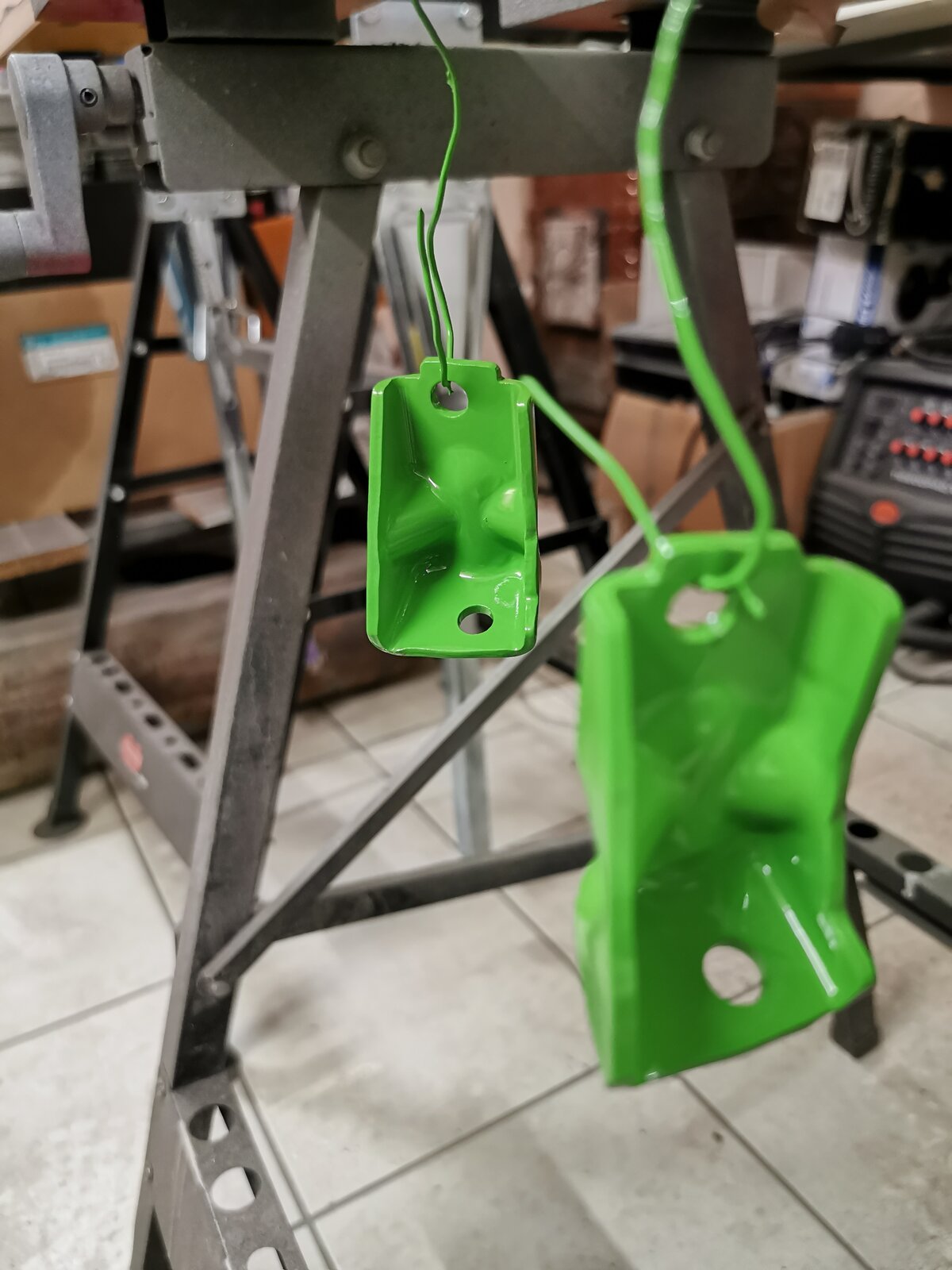

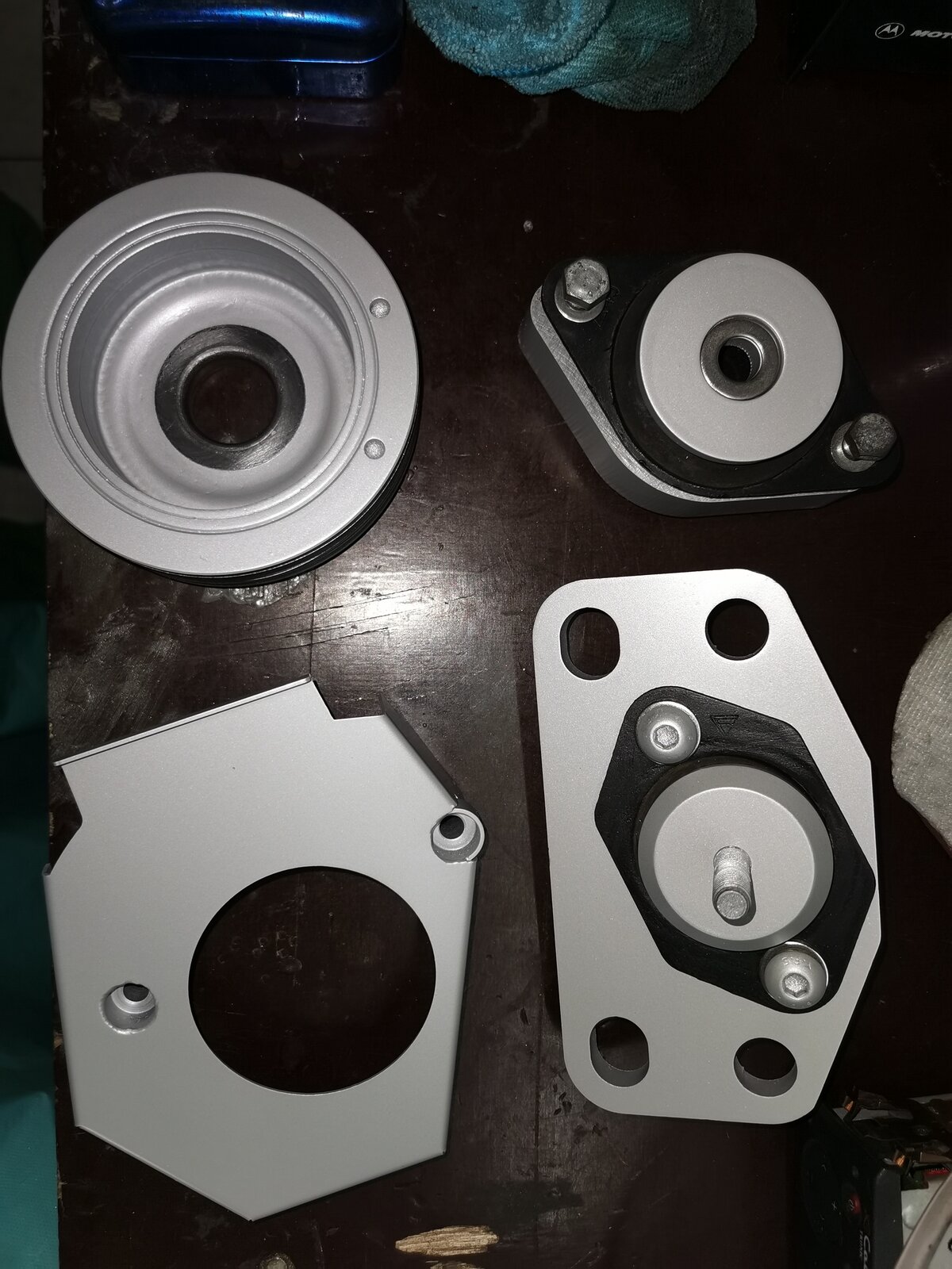

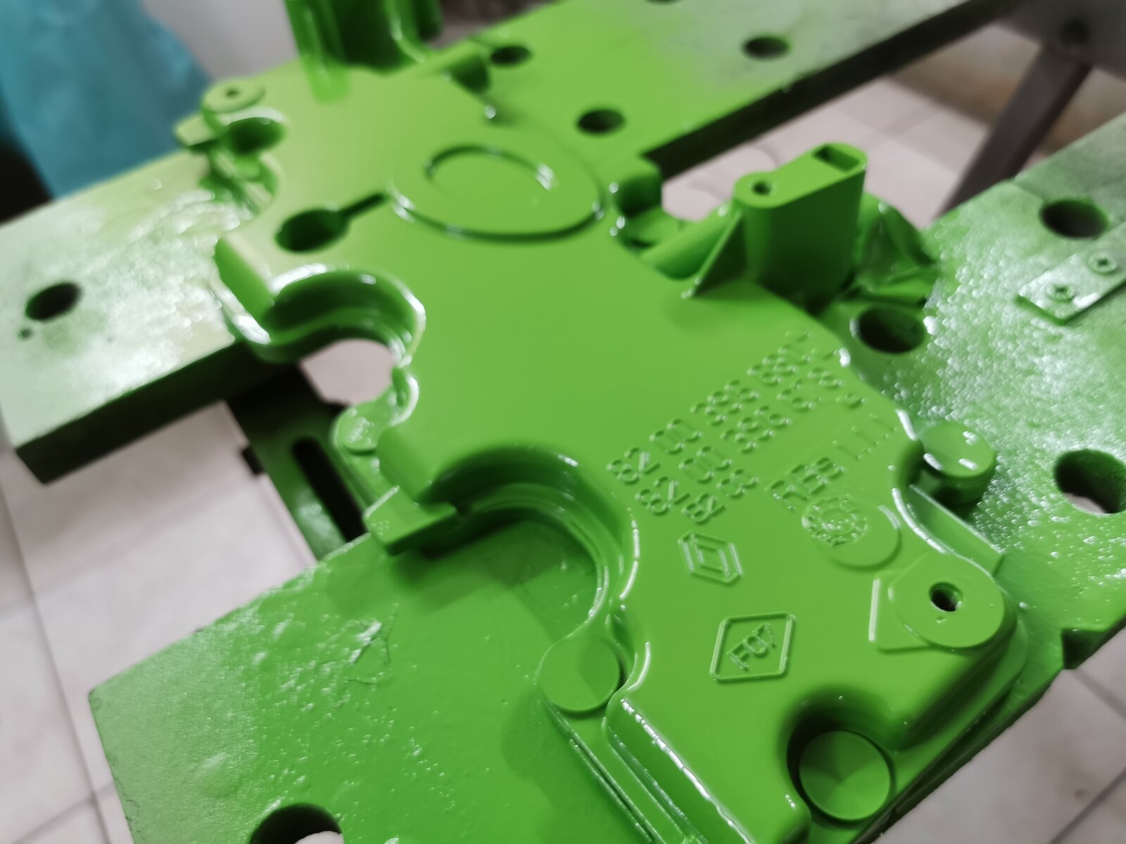

Paint some parta for a better engine bay look.
Some strange thing, the aux pulley does not have rubber inside, it does have metal bush and acts like a fixed pulley.
That one was on my previous engine and done around 40k miles without issues and using aircon.

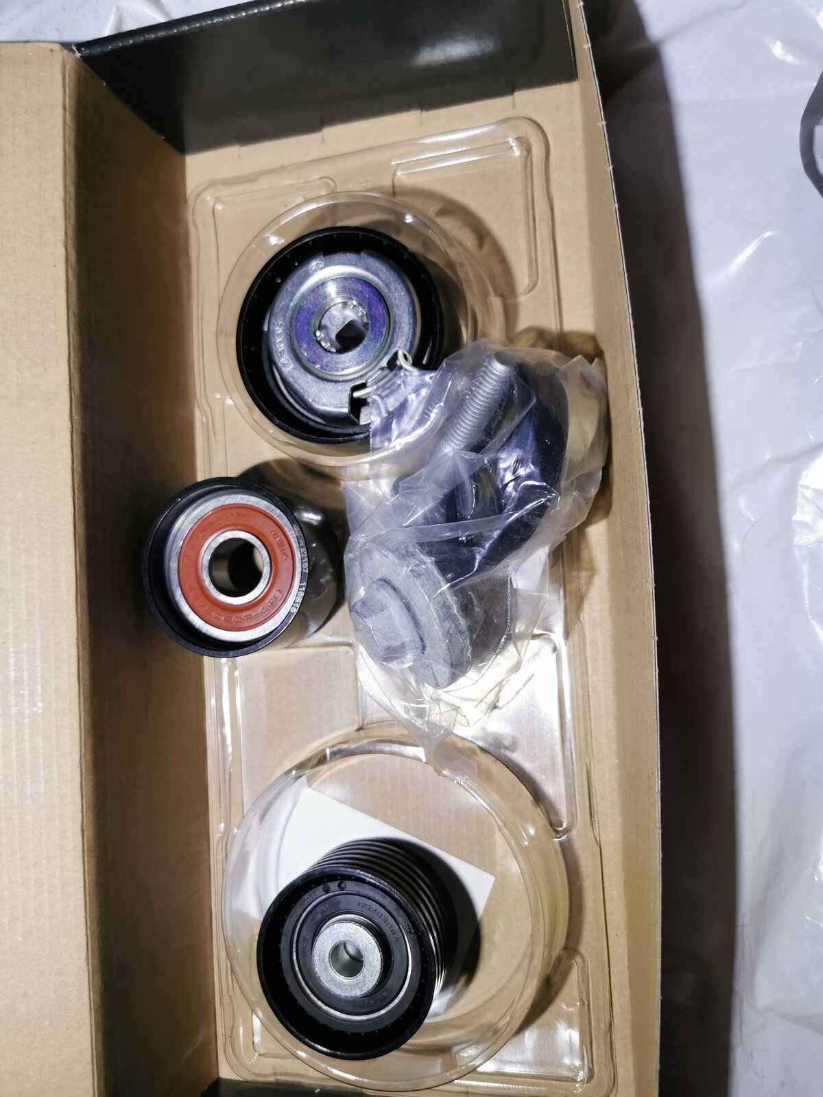

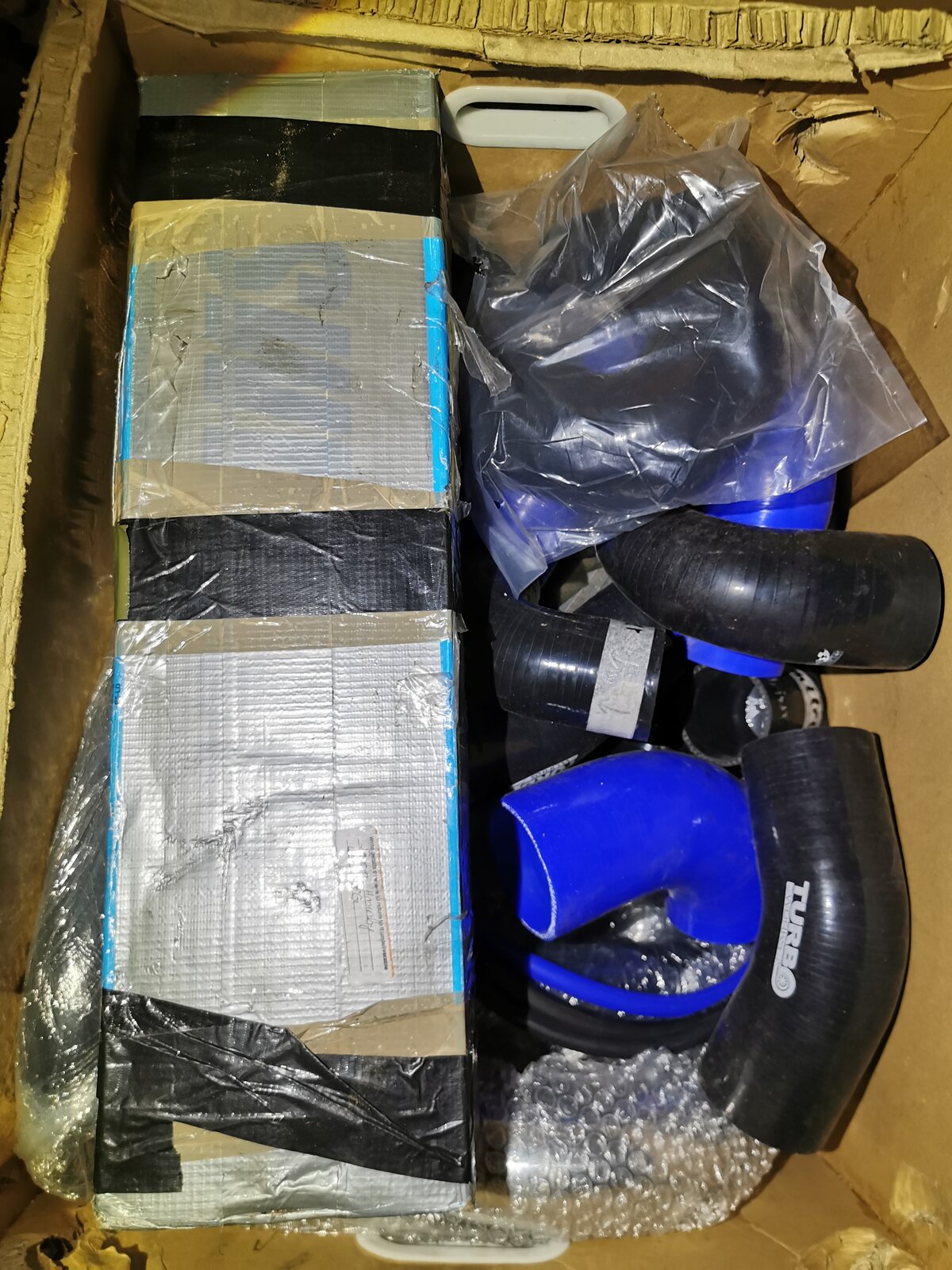

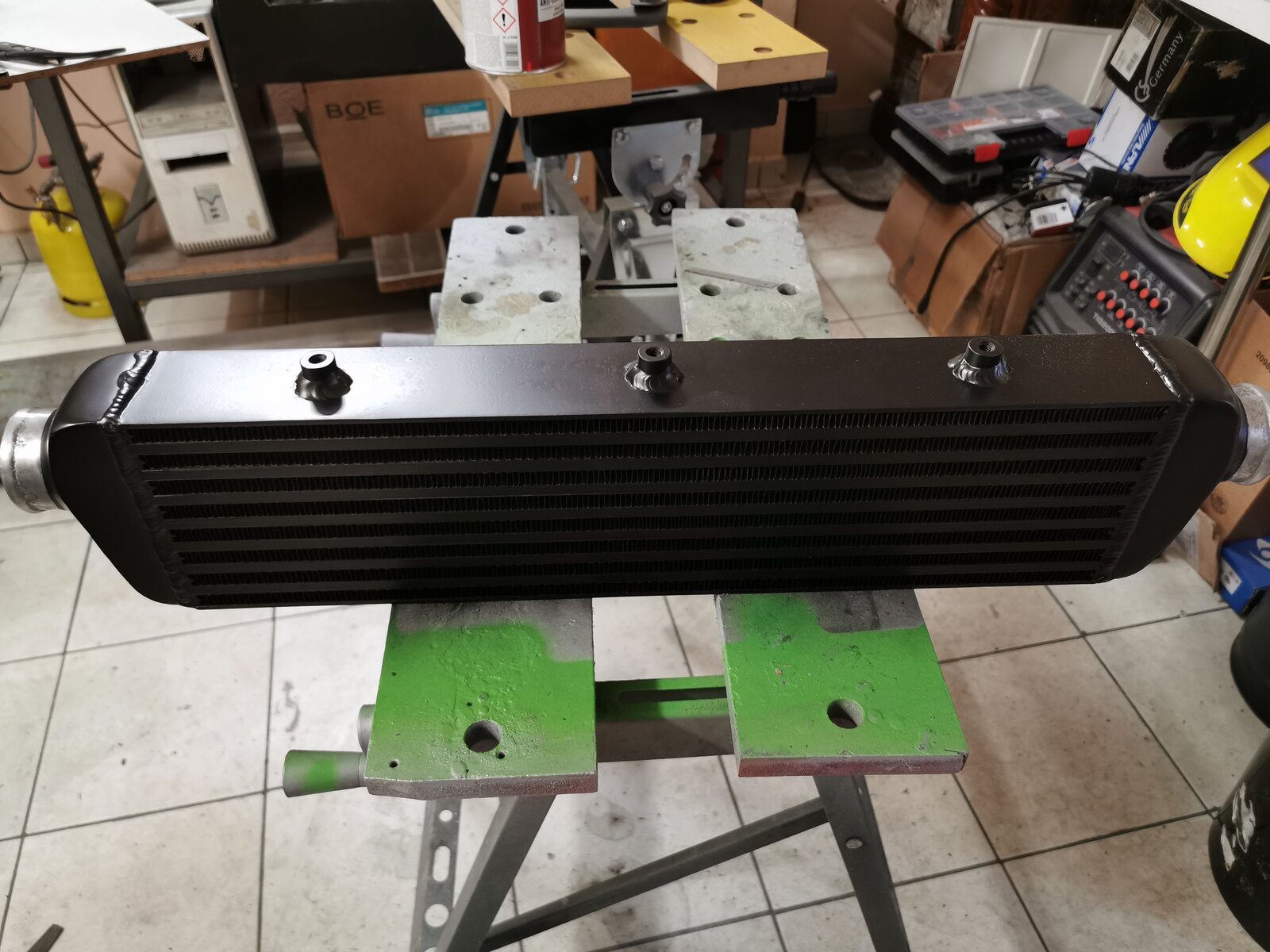

New cambelt kit for turbo engine
And black intercooler. I know it is not that effective, but will look great.
I choose Gates cambelt kit because of the metal idler pulley instead of plastic.

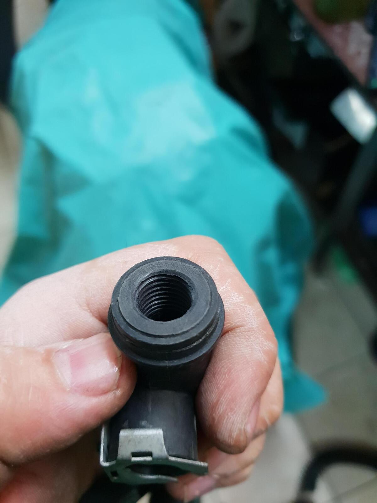

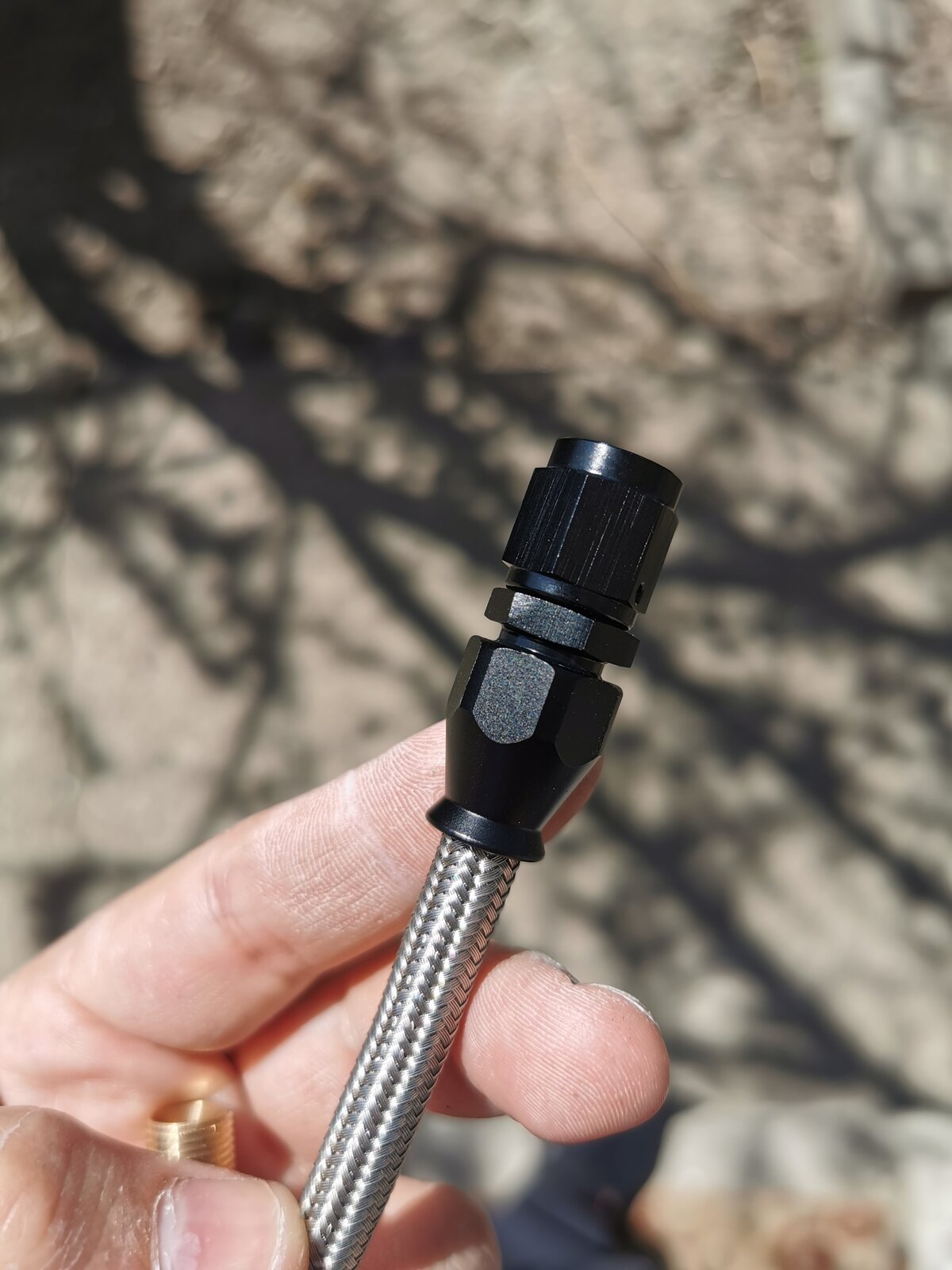

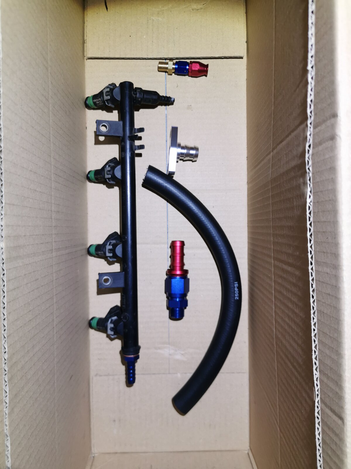

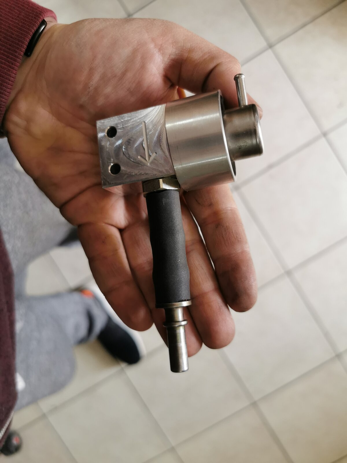

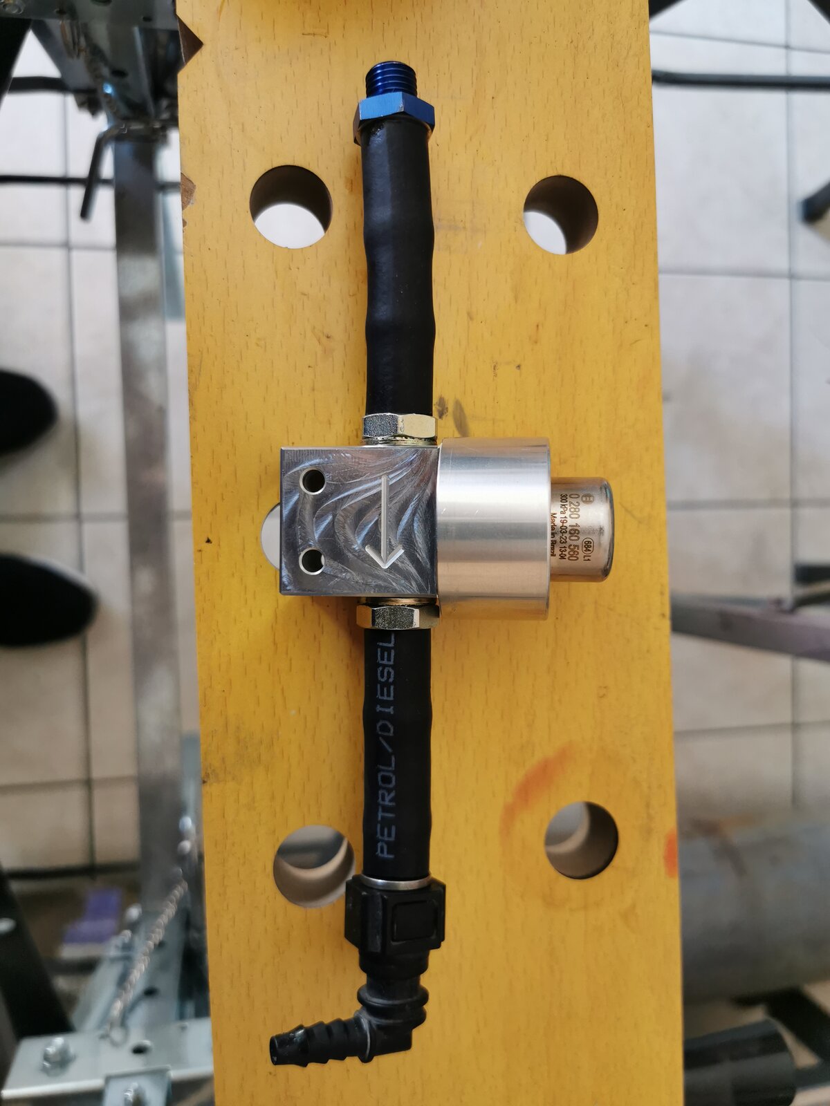

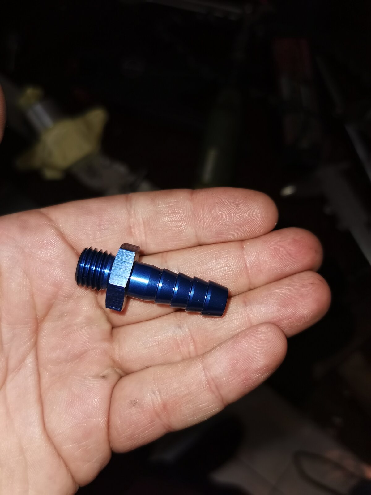

Fitting for fuel return line, need to sort a ph1 fuel housing and the fuel system is ready.

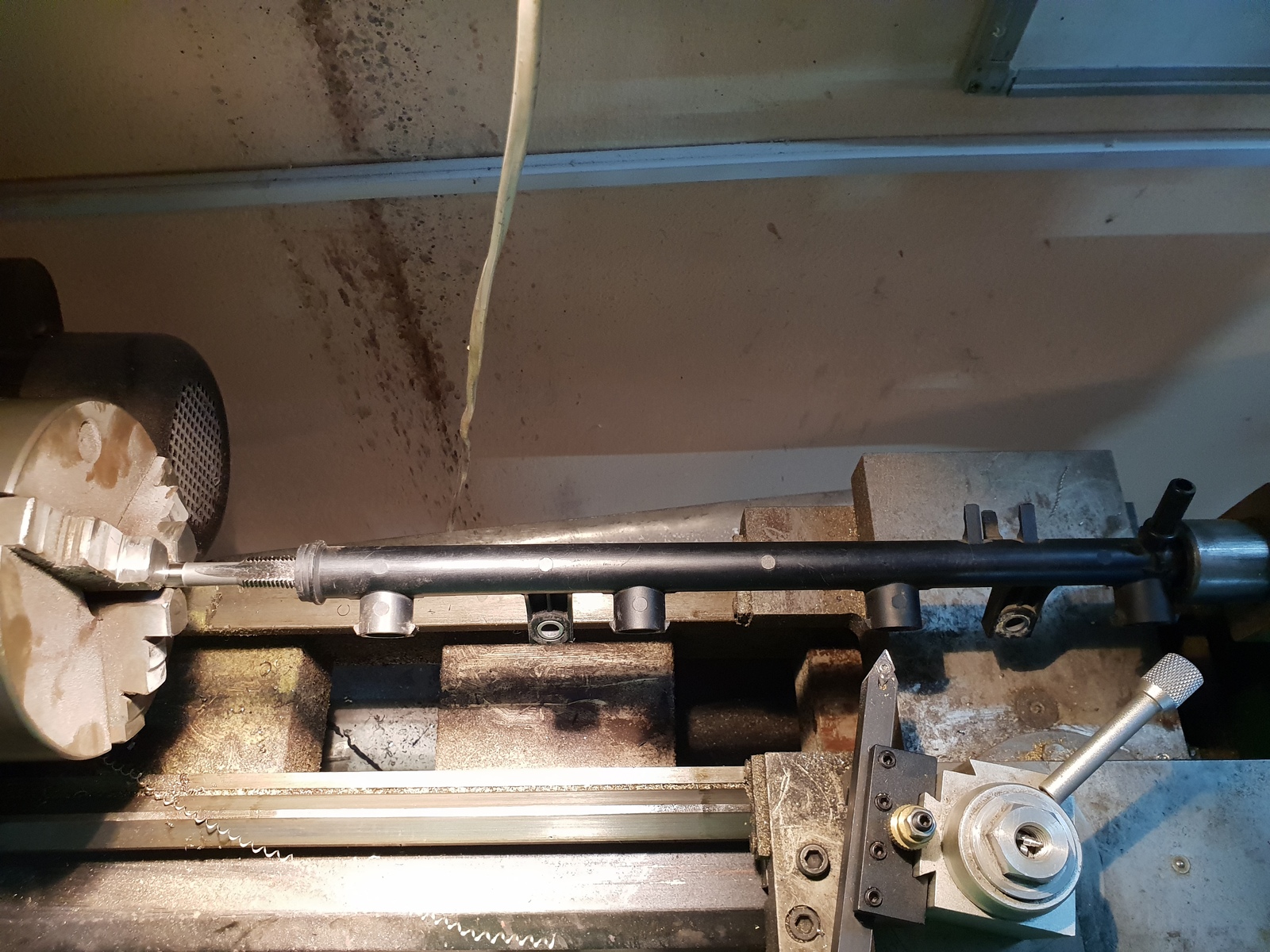

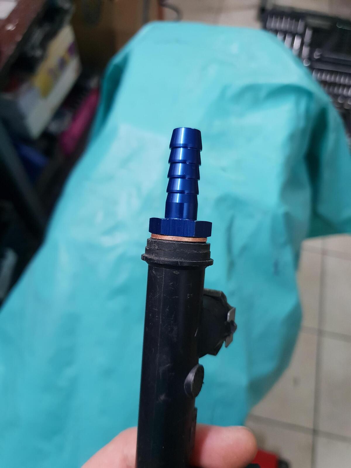

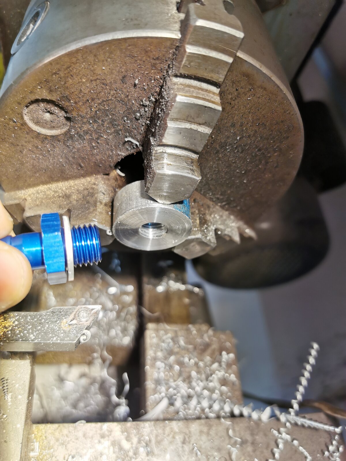

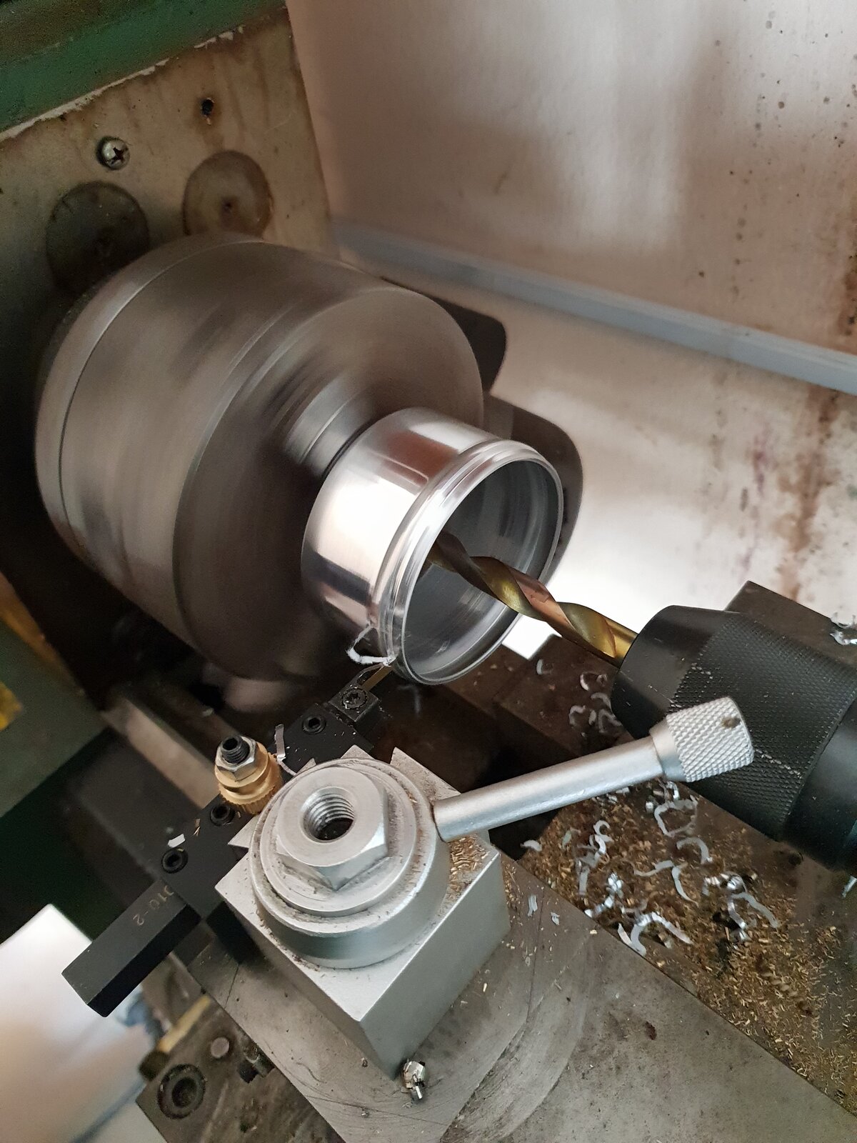

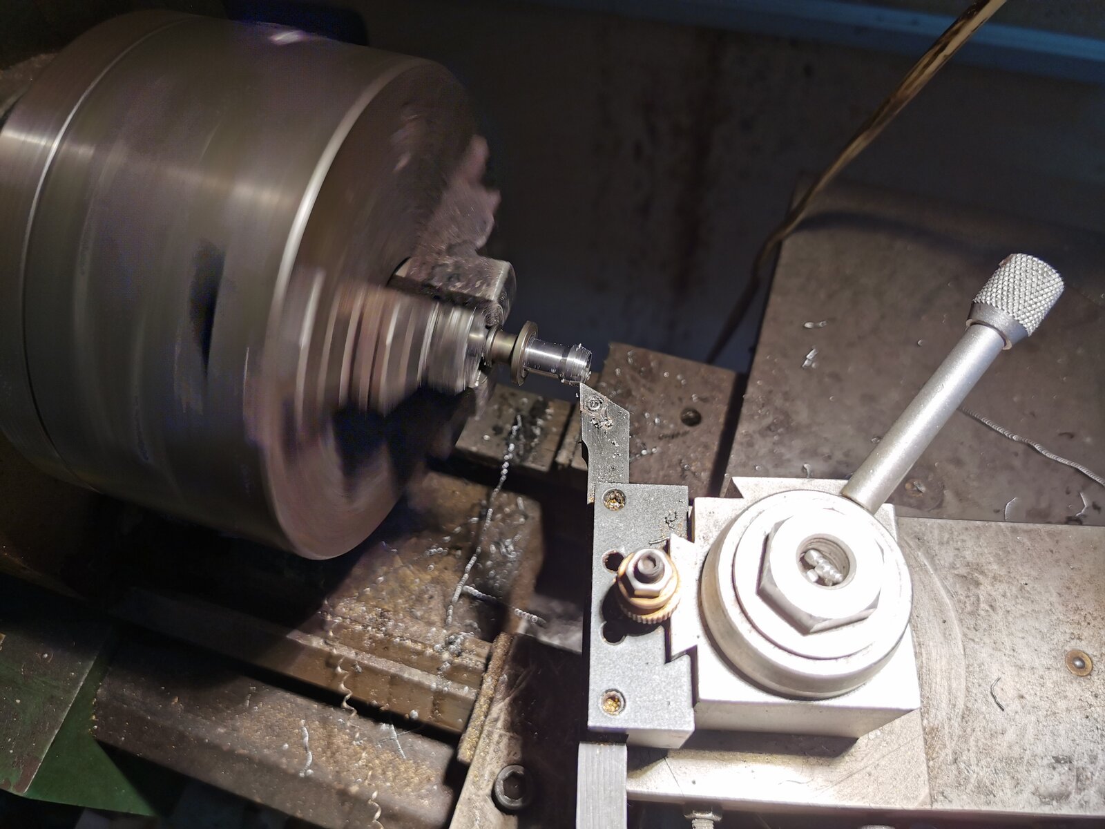

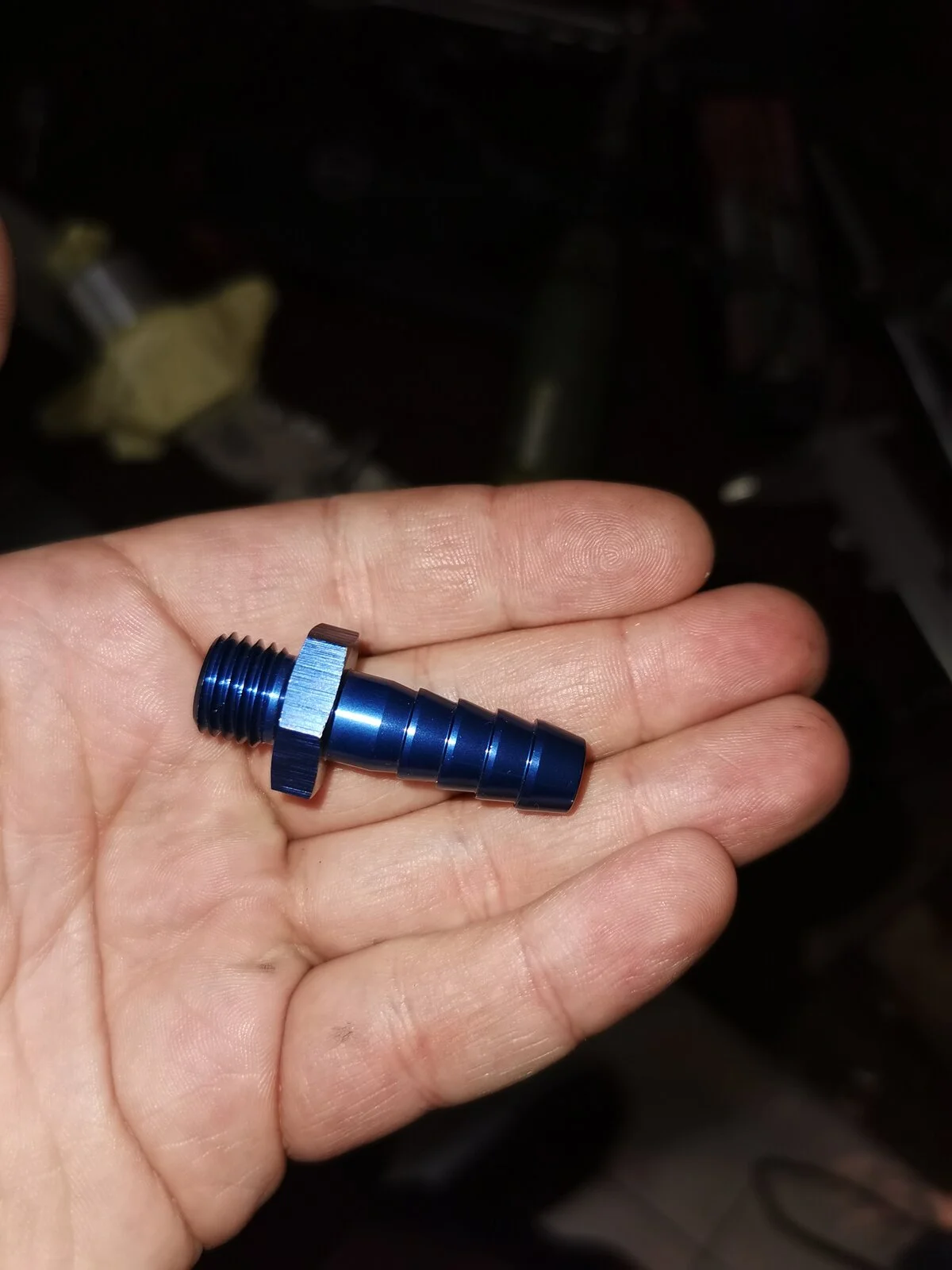

Just finish the fuel rail end for adding fuel regulator.

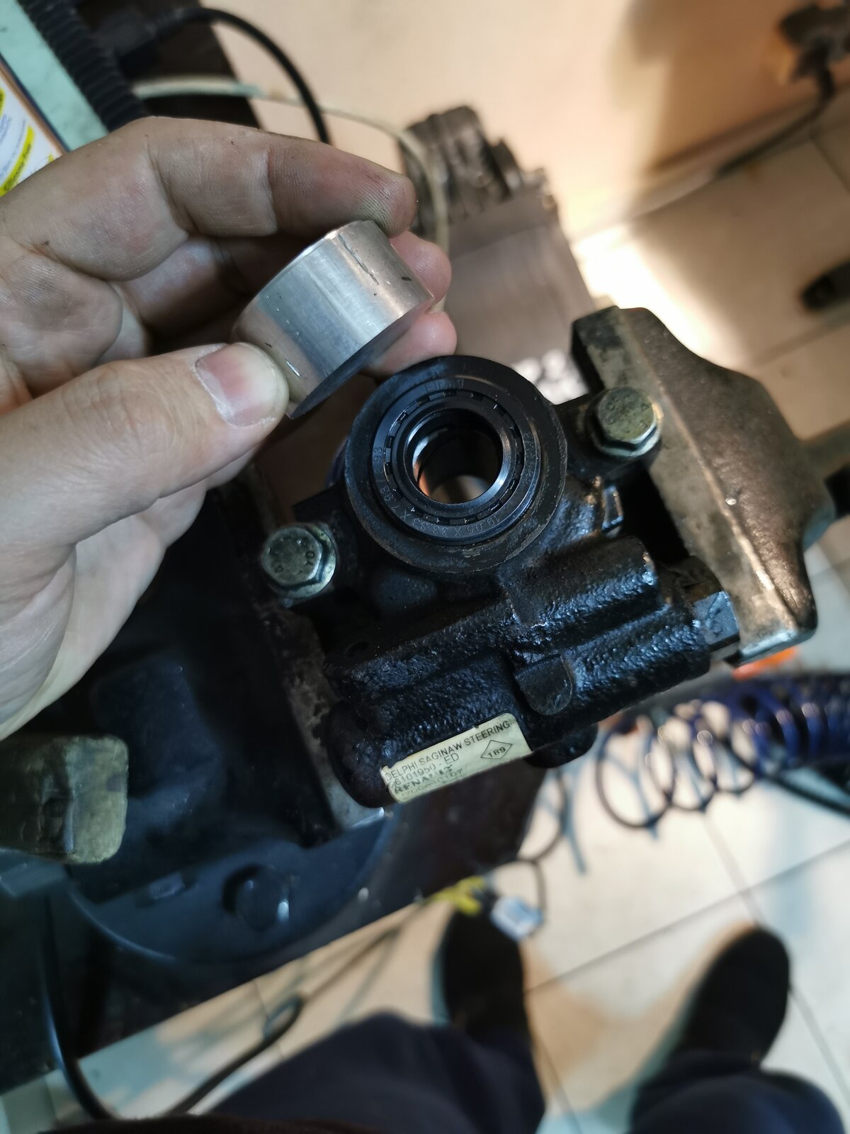

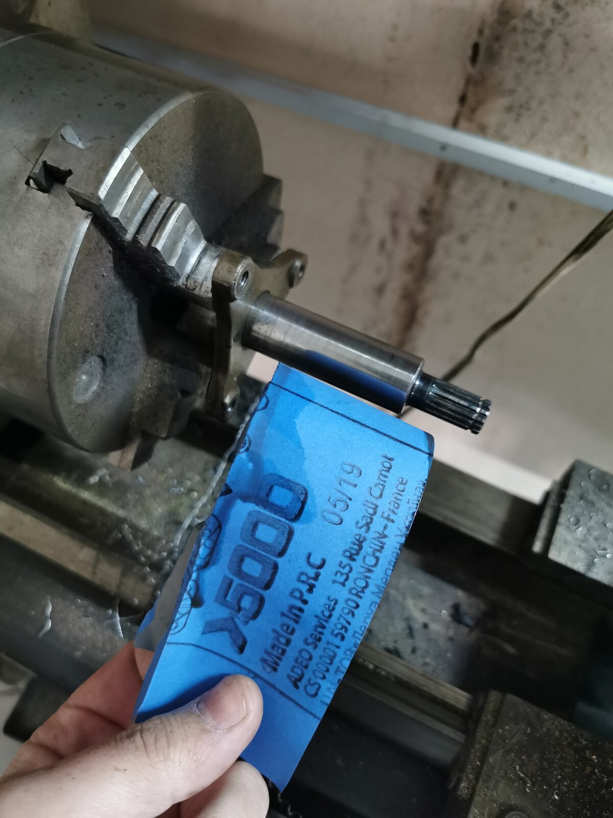

Replace the seal on a steering pump and polish a bit the shaft on the seal end.

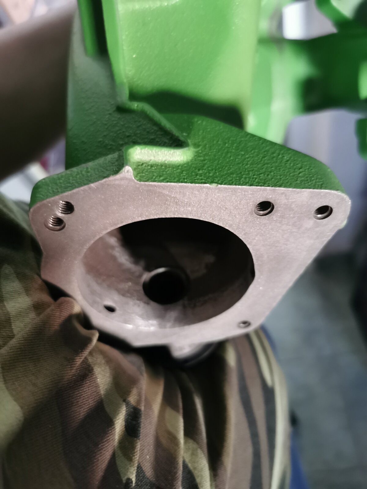

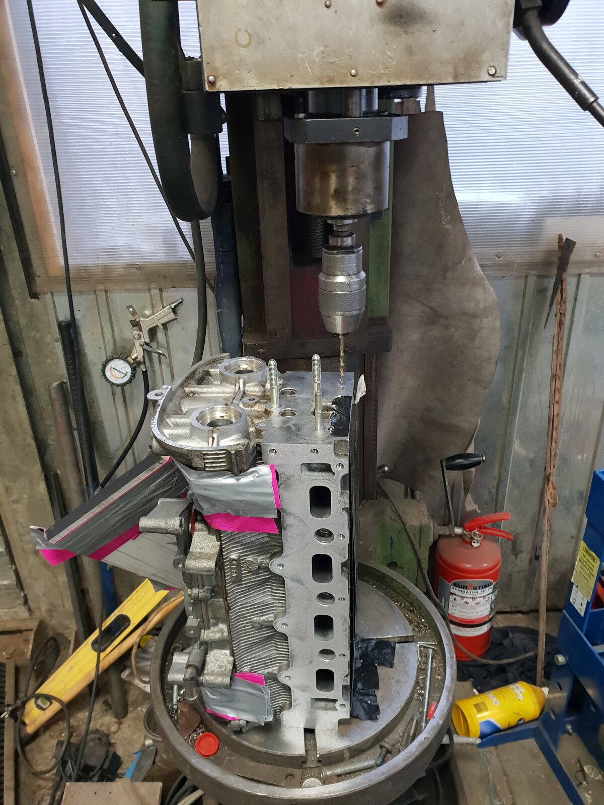

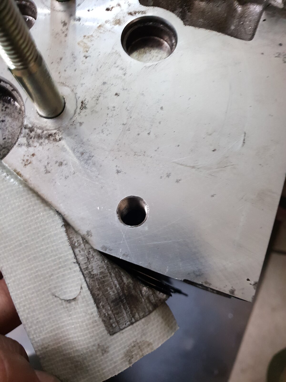

Port a bit more the 197 inlet for adding 65mm tb. Not a must , but I have a brand new 65mm tb

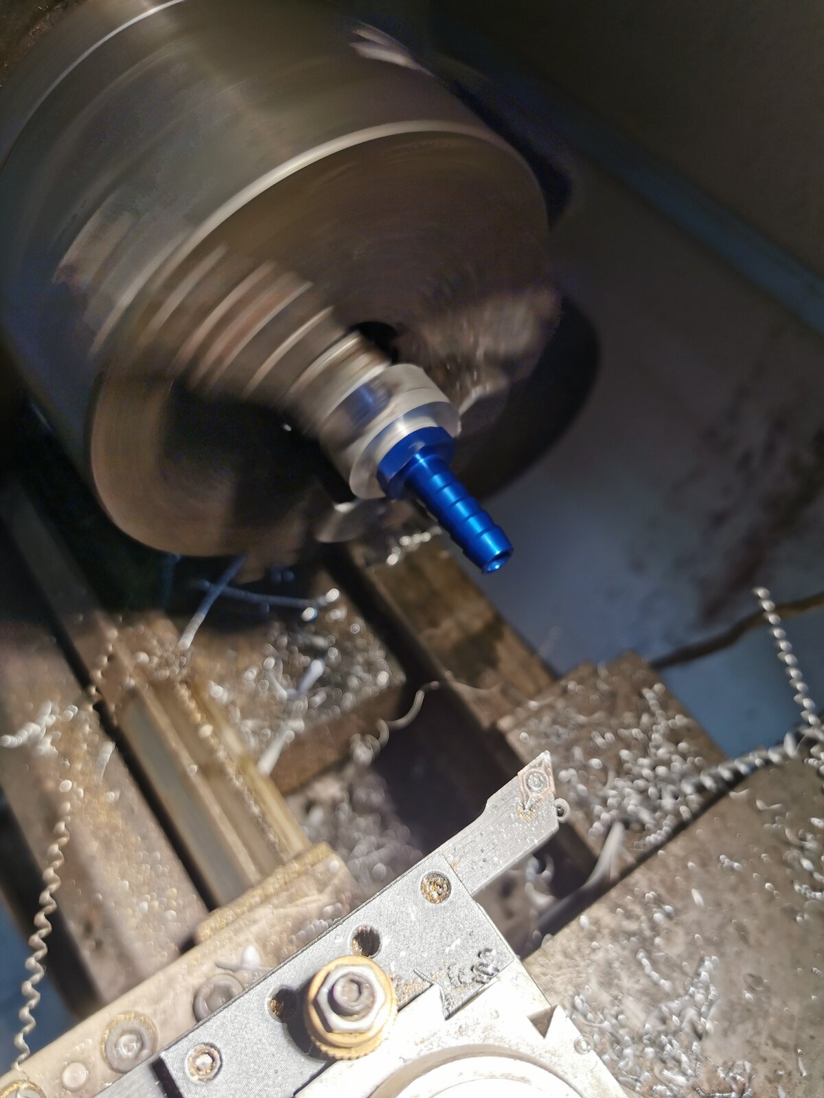

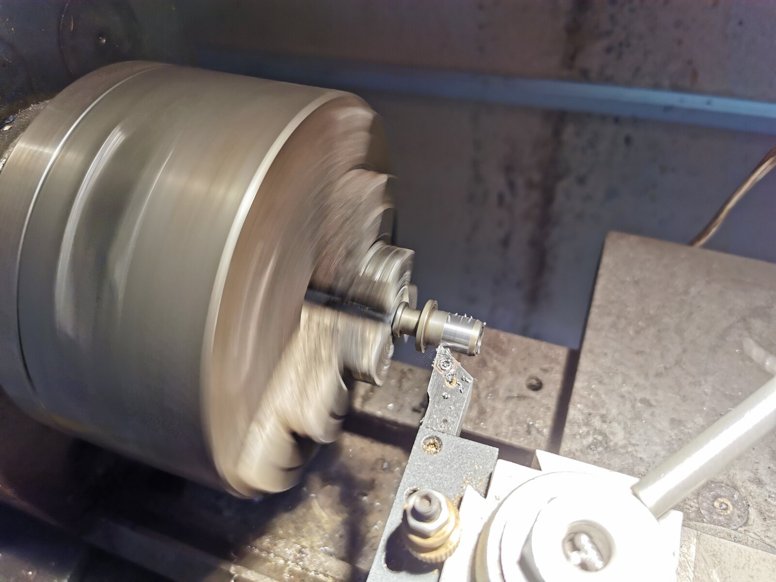

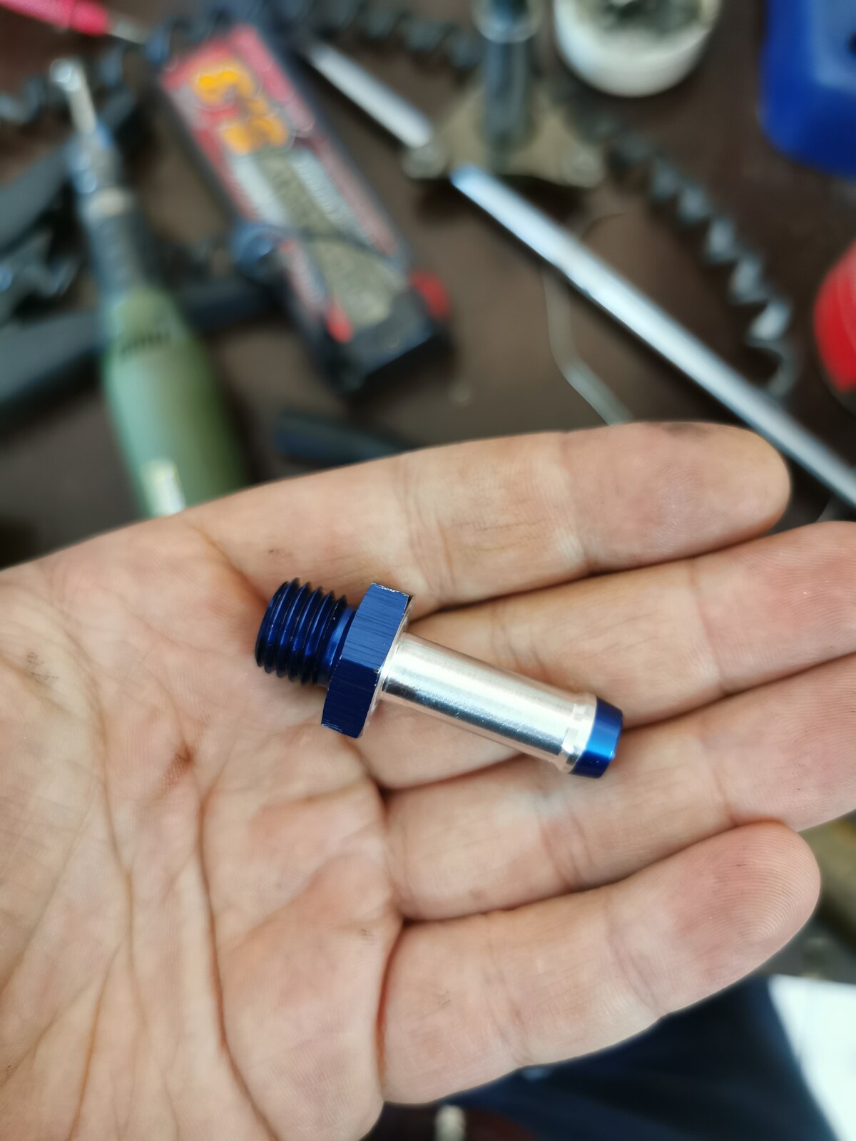

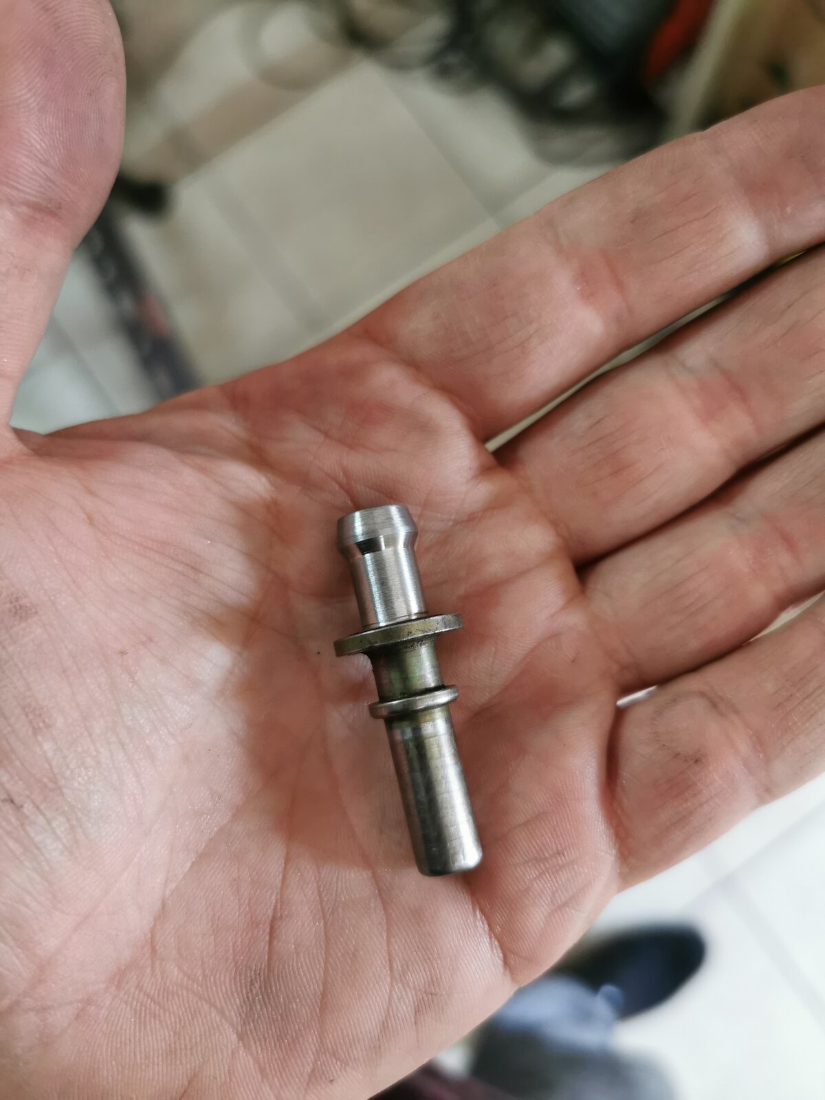

Put connector for brake booster direct into 197 inlet
Put AN4 fitting for oil feed

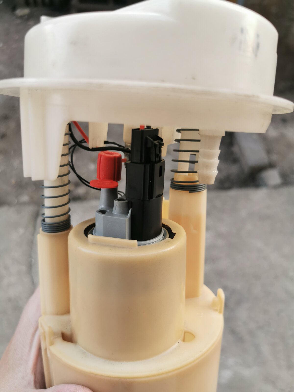

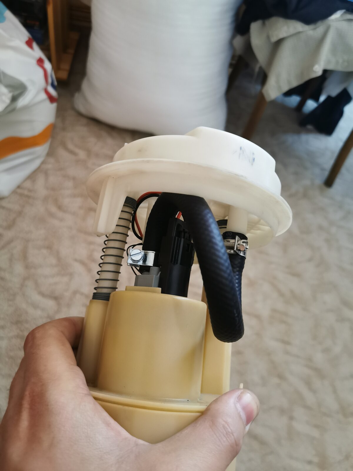

Install walbro 255 fuel pump into ph1 housing.
And get 6meters of 6mm fuel hose for return. Now the fuel system is ready for boost:)

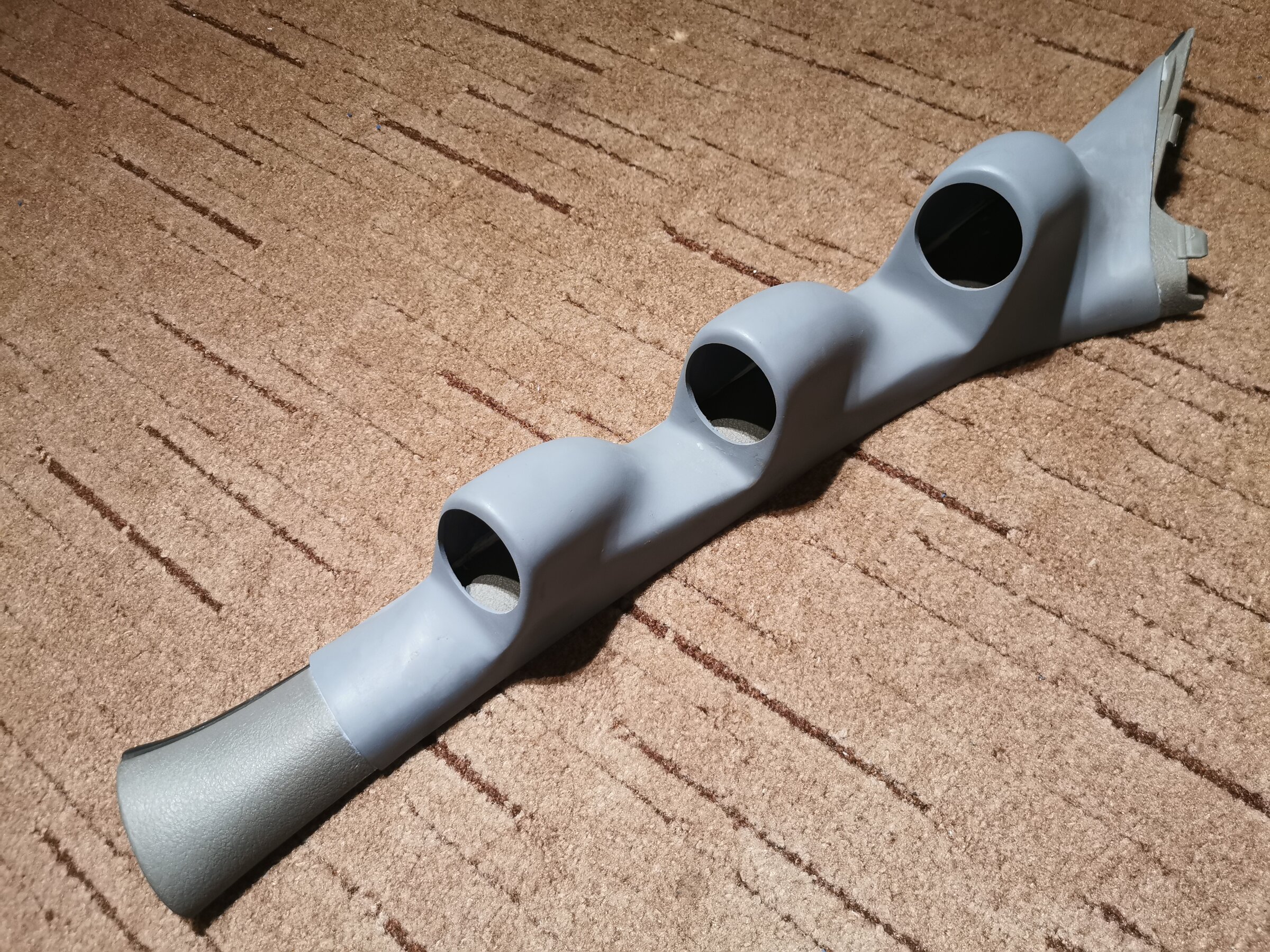

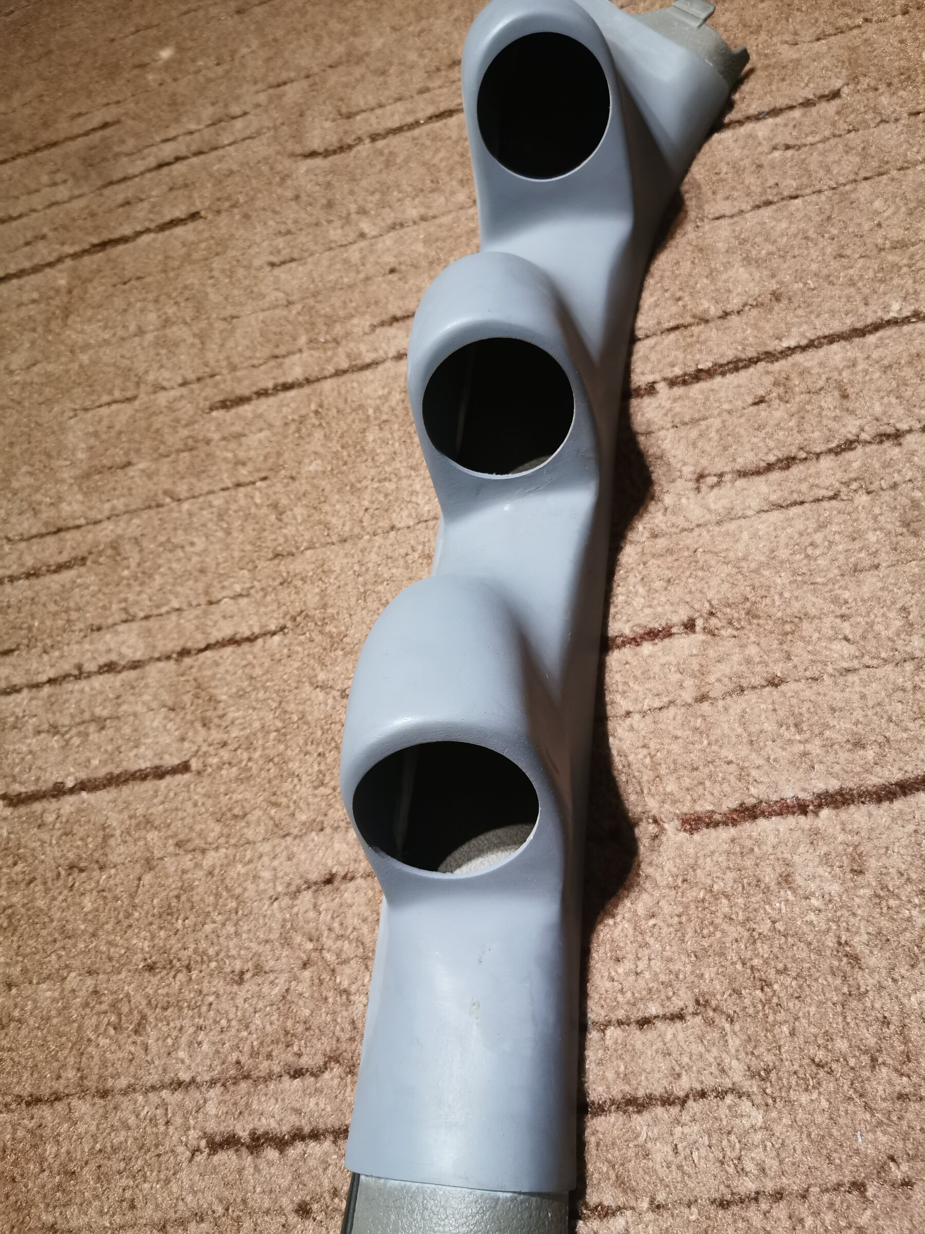

Gt2560r...and a pillar pod :)

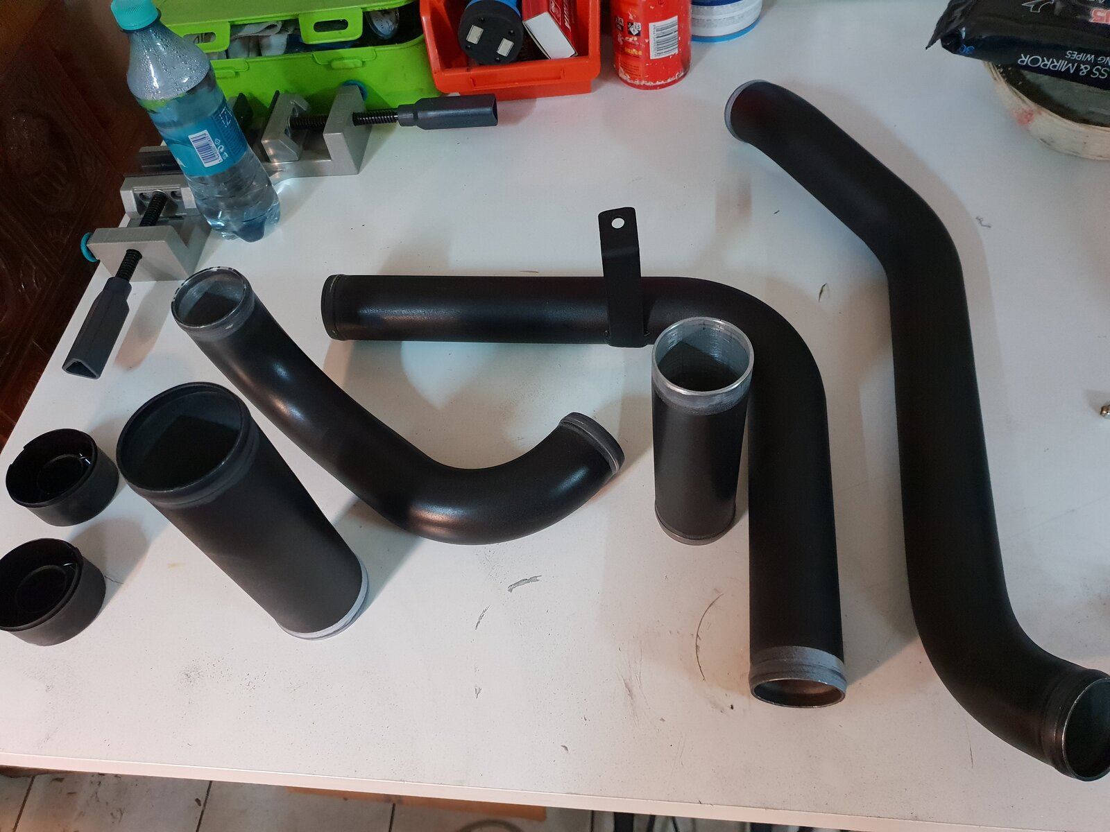

Custom intercooler pipework

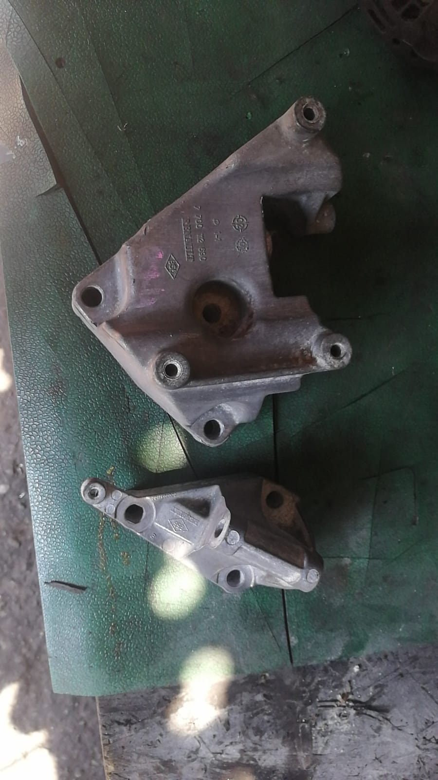

I will use a 1.2 steering column and an eBay kit controller box and also I will keep the AC. Aux brackets are from and old Kangoo that has AC but no steering pump.
I just want to remove the fu***** aux tensioner :))
Pics soon :)

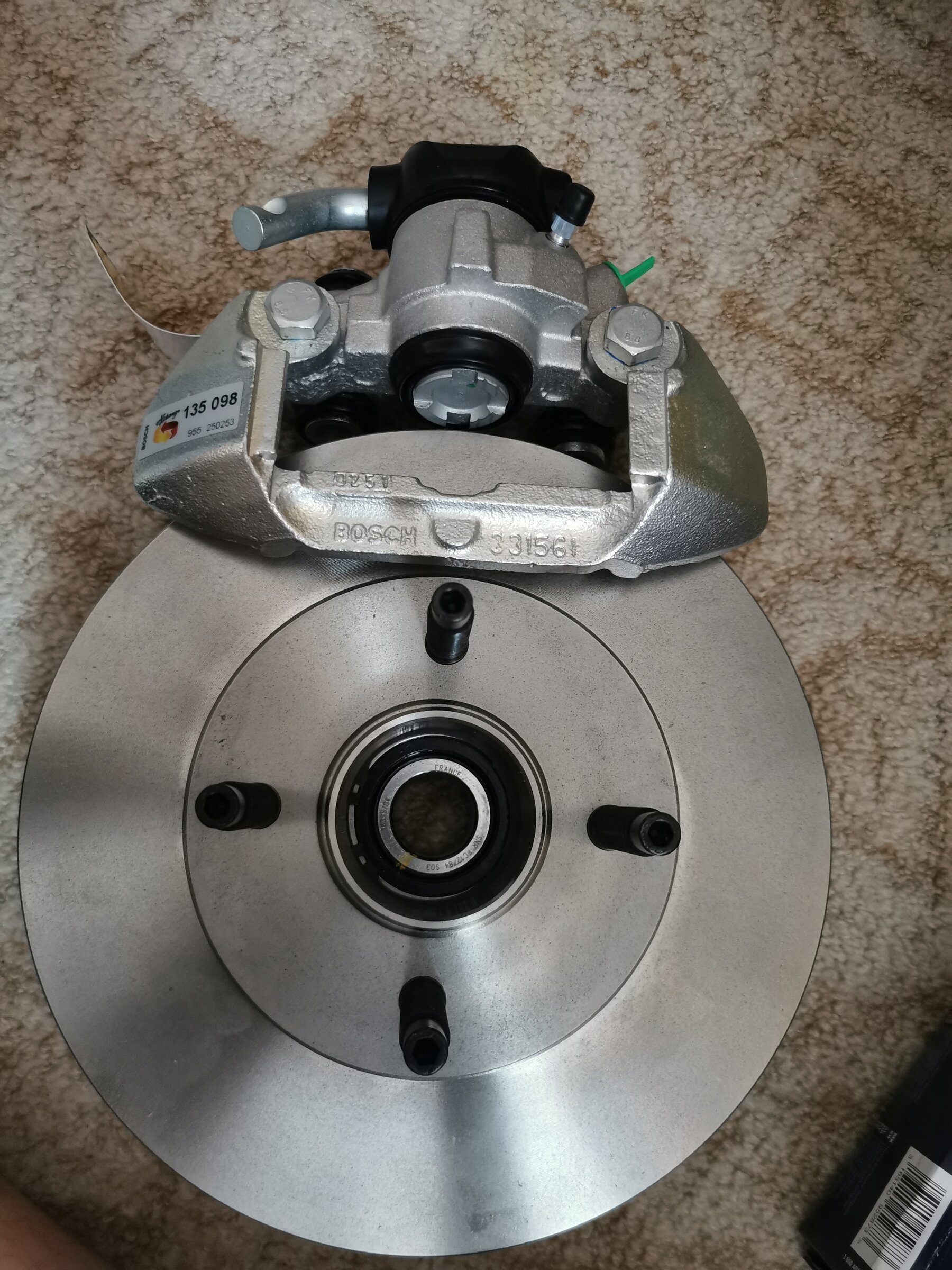

New ceramic pads on hellix clutch
New SNR rear disc
Refurbished Bosch rear calipers
New rear pads
New Poly rear beam bushes

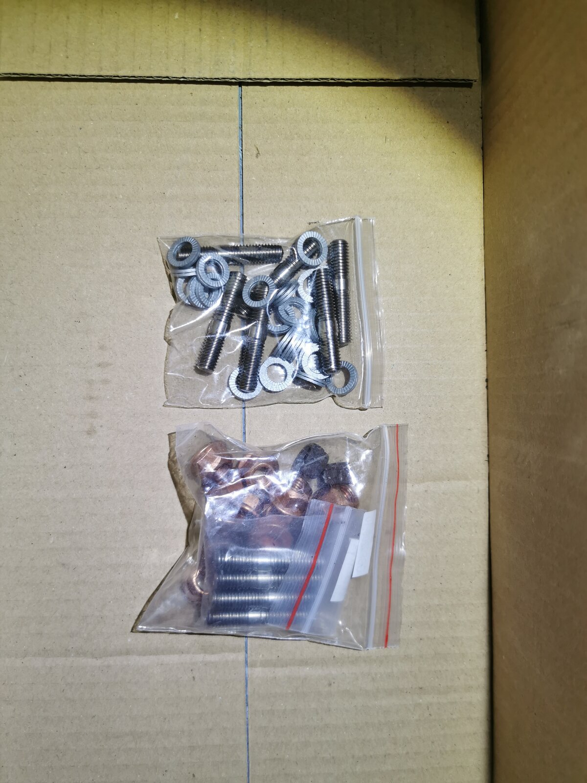

And...75mm stud kit.

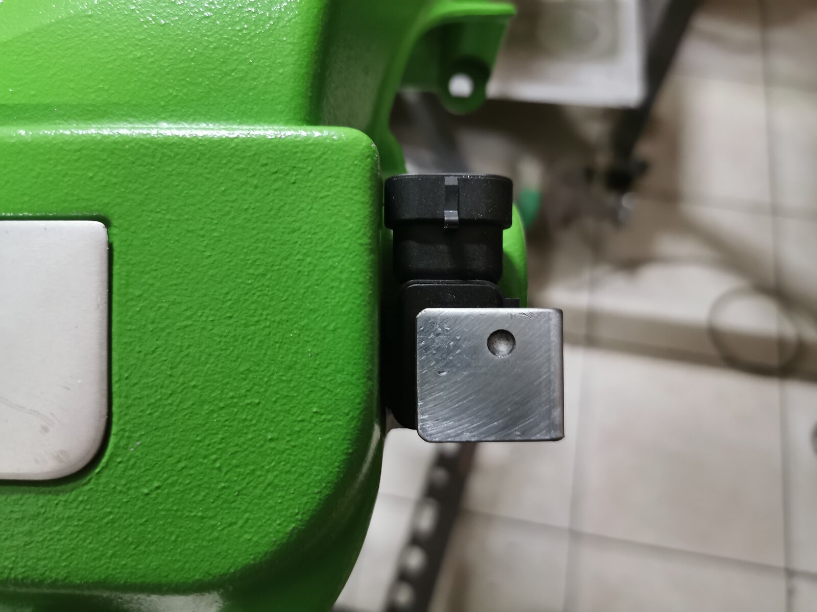

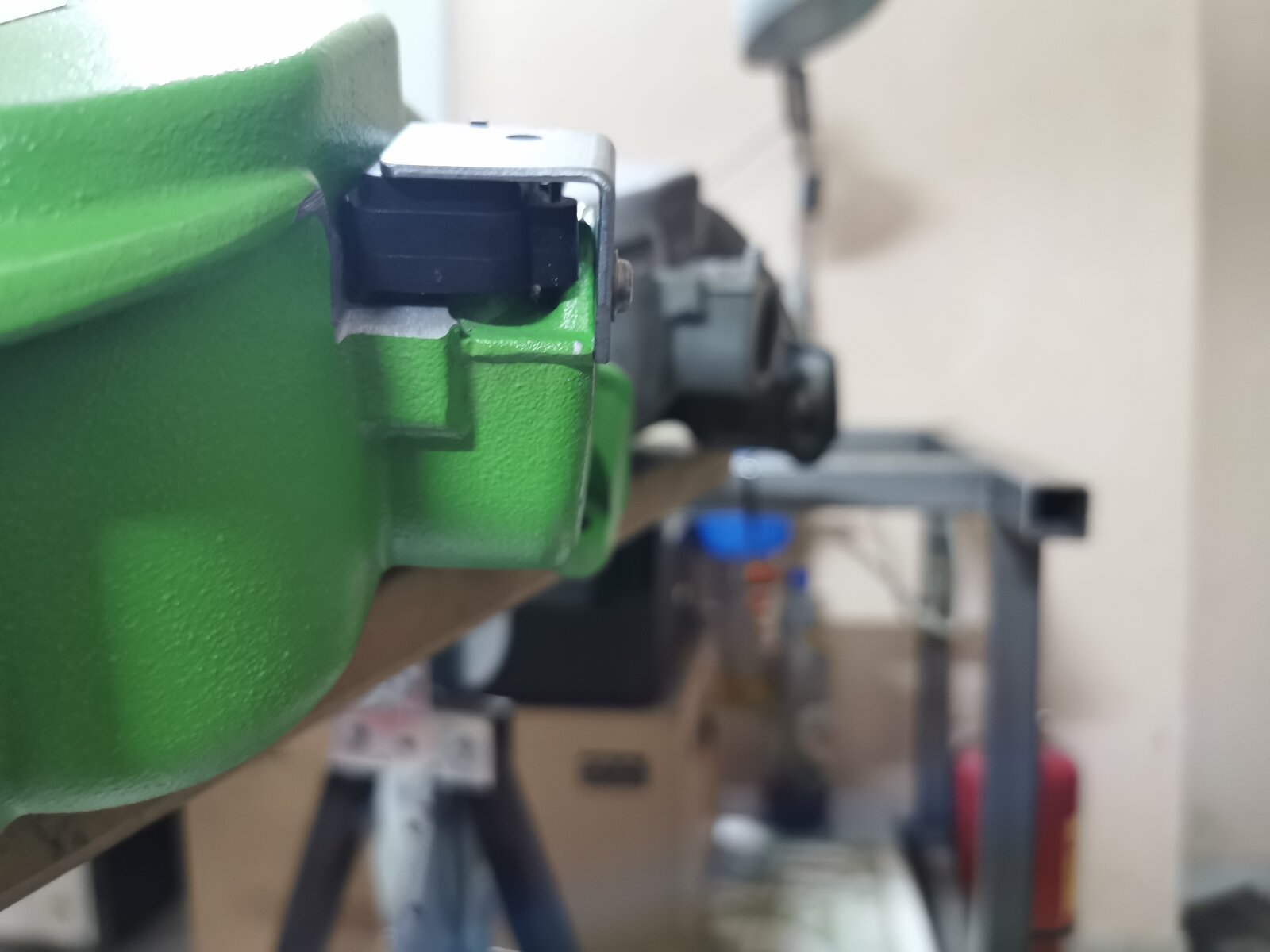

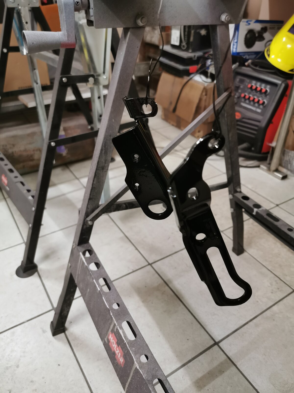

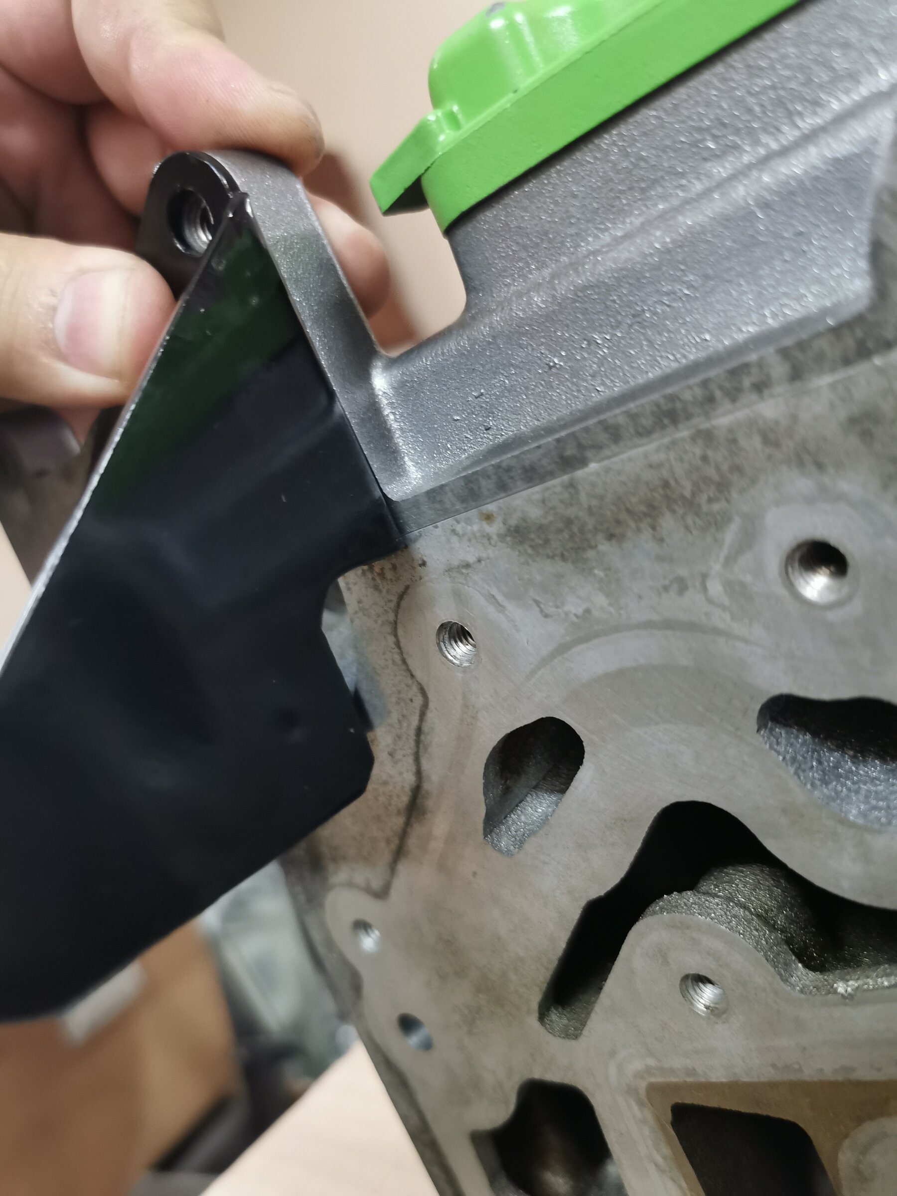

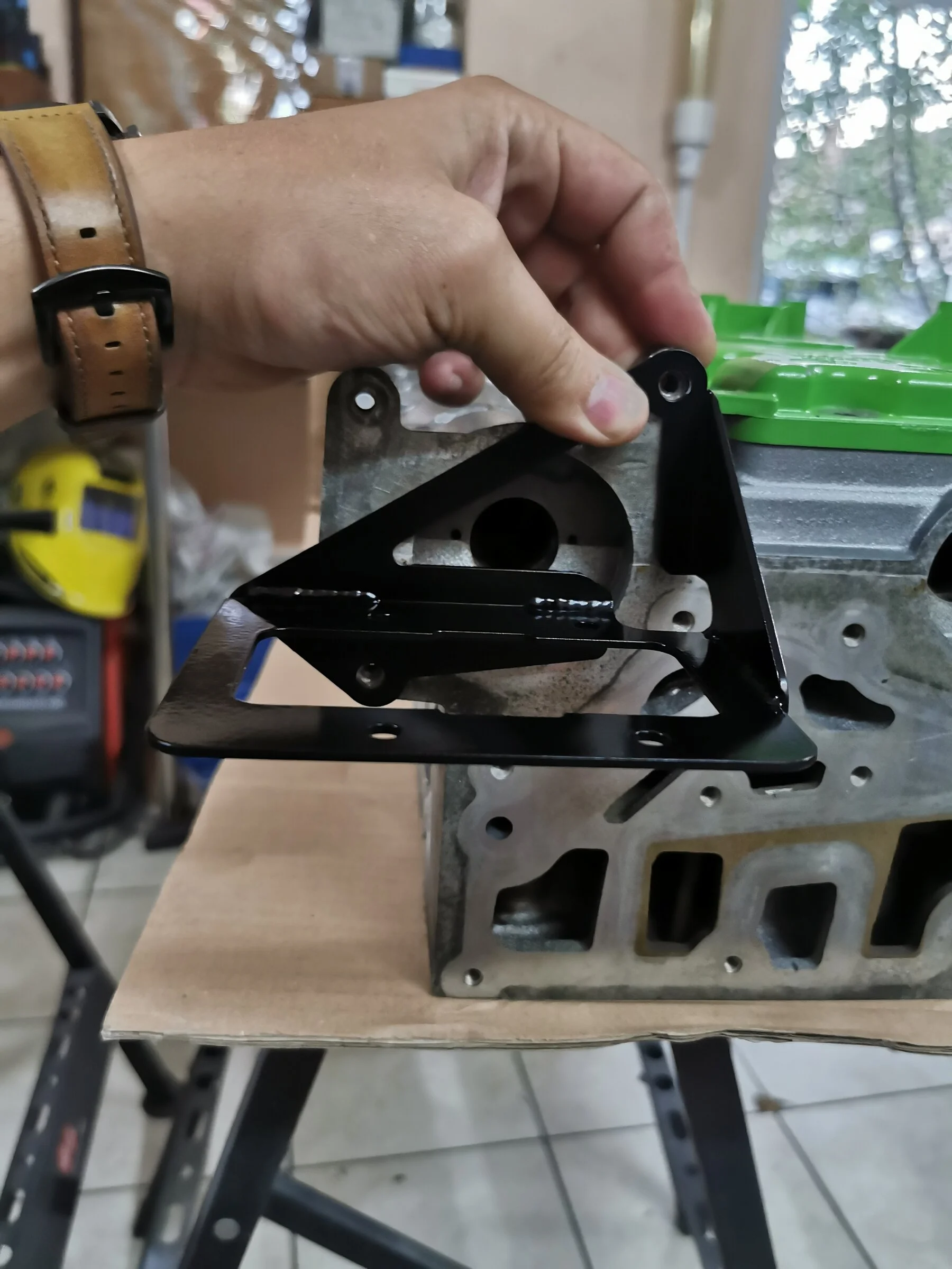

Coil pack bracket.
I wait for some parts untill I can test the setup without steering pump and with aircon

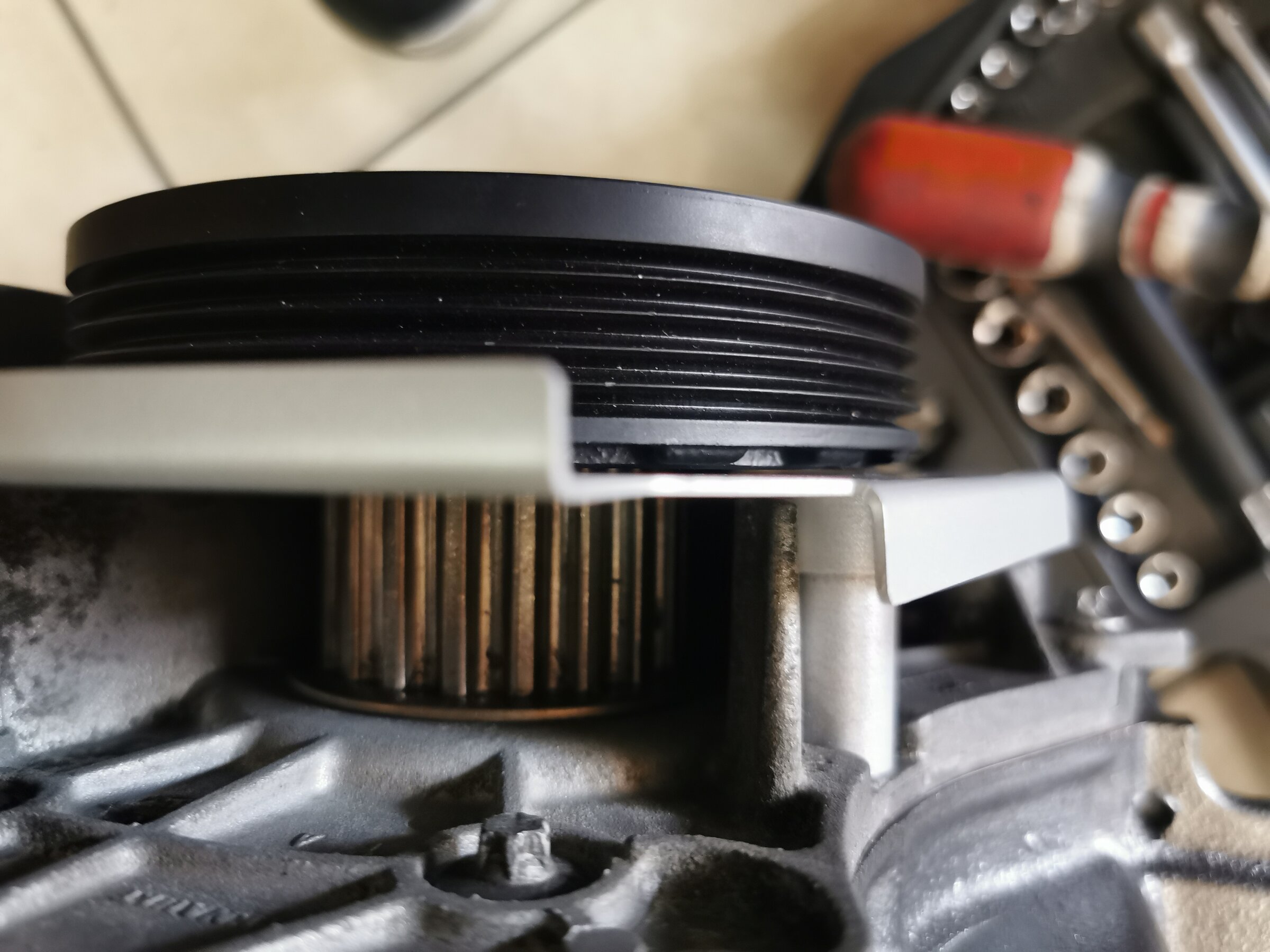

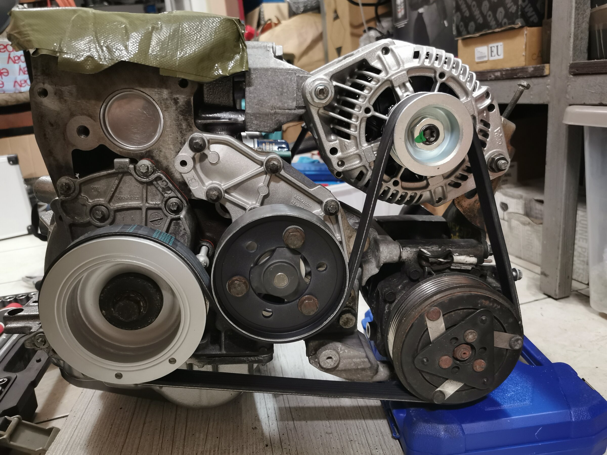

Fit the new damped pulley with 5 ribs and check the clearances for cambelt cover.
Everything is OK:)
