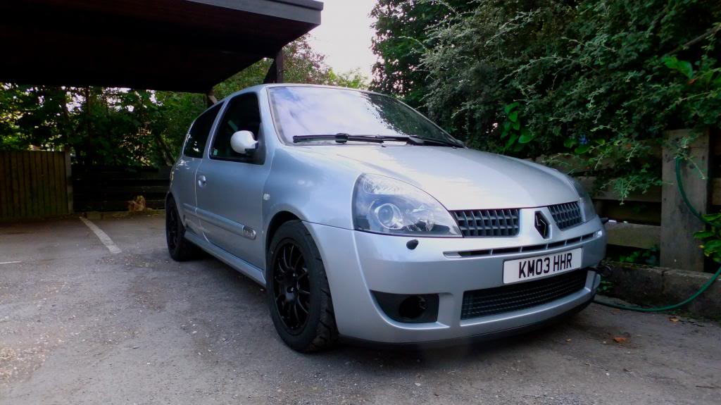

Right i thought i may as well start a progress thread as my car is taking shape pretty quickly. I bought a standard clio 172 in silver about 3 weeks ago with the intention of turning it in to my new track car. The car is a 2003 172 with 70k on the clock and 6 previous owners. Only issue with the car is it has a slight oil leek coming from somewhere, i think the gearbox side but cant quite tell until i get it on a ramp.
Current spec including parts I've just bought but not fitted yet
Spax RSX Full front and rear coilovers - new
K-Tec solid top mounts

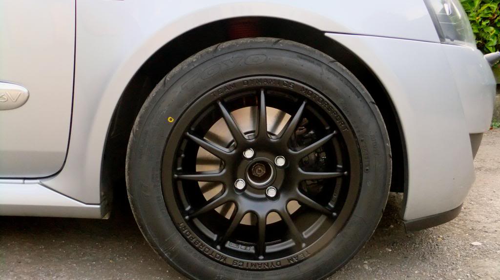

Team Dynamics pro race 1.2 15x7 et35 matt black - track wheels - new
Toyo R888 195/50/15 GG - track tyres - new
Speedline Cup wheels 16x?? Grey - road wheels
Conti sport contact 3 - road tyres
K-Tec 15mm spacers for the front - new
Eibach Front camber bolts
Brembo HC front discs with ds2500 pads - new
Genuine rear discs and brembo pads - new
K-Tec brake lines
Superblue race fluid - new
K-Tec induction kit - Black - new

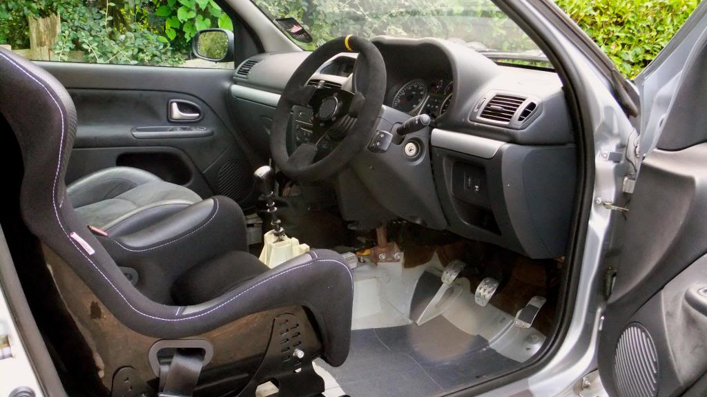

Corbeau Pro Series bucket seat - new
OMP side mounts and Sub frame - new
Schroth 4 point harness - Black - new
Stripped interior - Dash, headlining and front door cards remaining
100mm brake ducts
Omp steering wheel boss
Go Pro 3 white edition

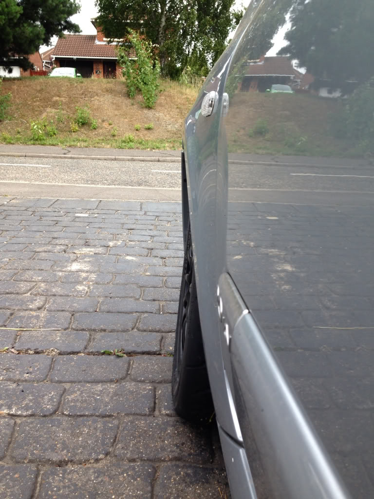

Why i need spacers

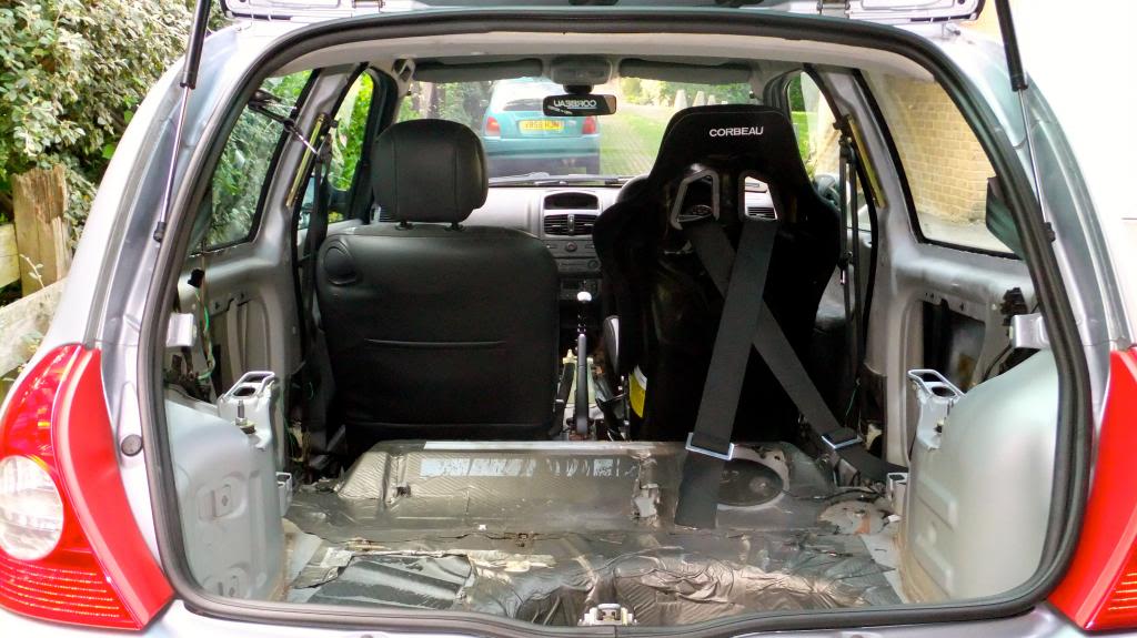

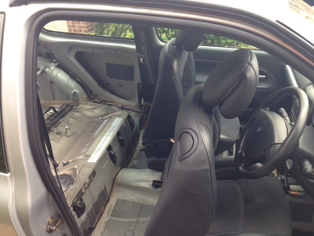

i had a stripped type r before and that was noisy

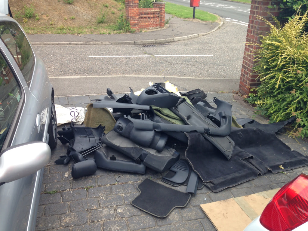

Quite amazing how big that pile of junk is to be honest isn't it.
Not that it matters but I weighed every item too.
Front carpet removed?
​Front door cards staying put?
I know I struggled to fit it all in the loft in my garage, yes front carpet all removed and gear surround, still have the front door cards, top and bottom dash and headlining.
the carpet was surprisingly heavy, I've got loads of sound deadening stuff to remove though.
I was only intending on removing the bit of carpet behind the front seats, as soon as I pulled it out and felt the weight, I had to take the front out.

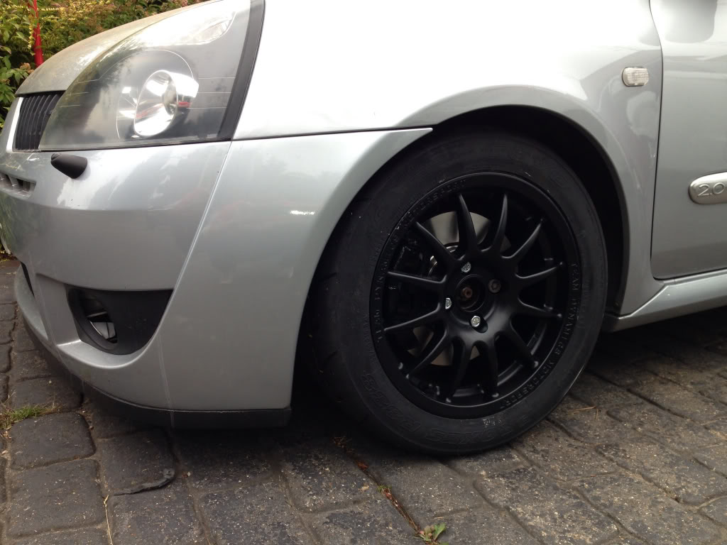

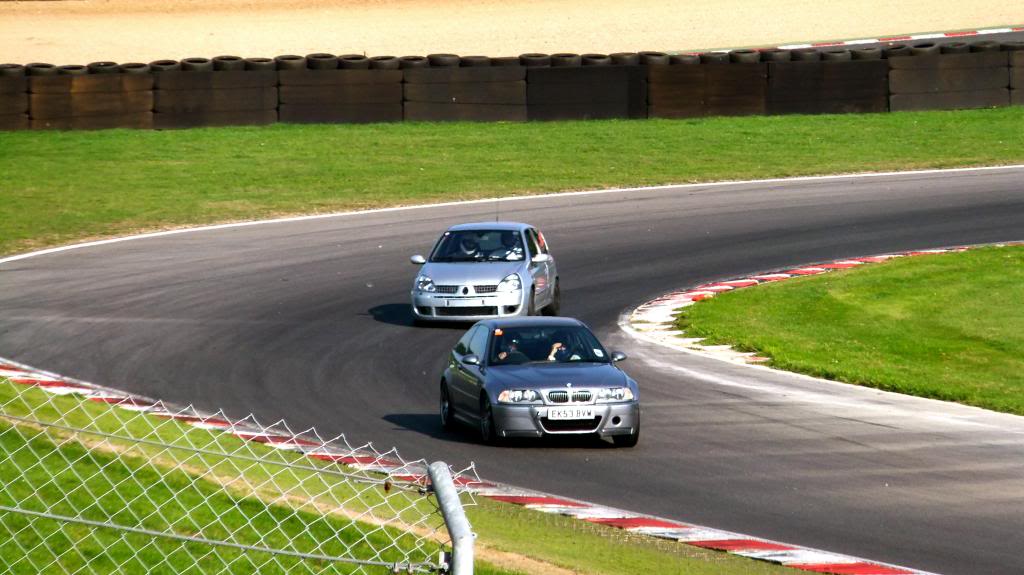

Since my last update the majority of my bits have now been fitted to the car. The coilovers are now all on the car and the geo was done by a local tuning company TDI. I had to fit some 15mm front spacers as the wheels were a bit close to the front shocks, apart from that every thing went very smoothly.
I have some updated pictures of the car from last tuesday, and a couple from my track day at Brands GP on the wednesday, i do have some in car footage from my go pro i just need to go through it and upload it.
The car performed extremely well on the track day, i did surprise me a little bit with how quick i would go through the corners. I went with a few other people and took them all out for passenger rides and they were all surprised as well. I did manage to upset a few bigger cars on track as well which is always good fun. Although by the end of the day the car was showing a few signs of wear, the service light kept coming on, the clutch pedal became stiffer and creaky and also the steering rack became quite creaky. Haven't had the chance to have a look over the car since the track day as its just been sat in my garage.

- Adjust the ride hight on the coilovers as i was getting some rubbing from some where may need rear spacers

Ive got the spax rsx track day kit, i think the rear wheels may be clipping the rear coilovers under heavy load, i need to get it in the air and have a good look really. I know its quite high, it does need to go lower but i just don't want any rubbing.

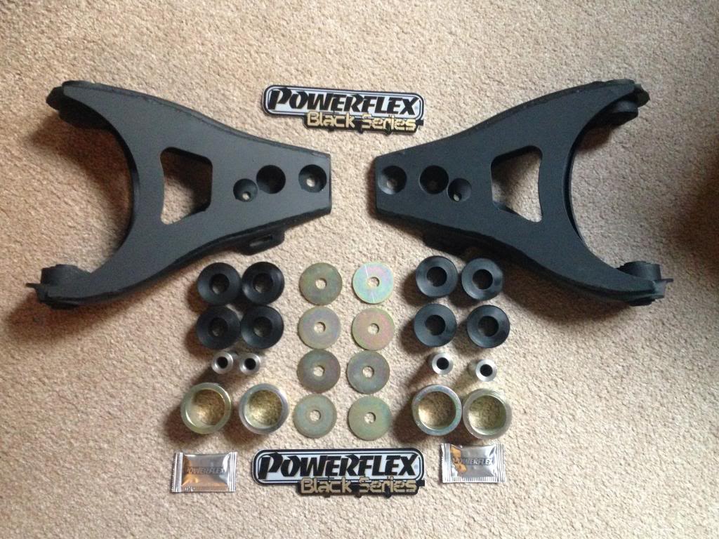

So far i have got some new cup wishbones with stress plates welded on to them and sprayed satin black Thanks SprayShack, I've also just received my Powerflex Black series wishbone kit. But I still need to pick up my new bottom ball joints and track rod ends from GSF and then the front is all ready to be refreshed. Anti roll bar bushes will be upgraded to Powerflex Black series bushes by Danny @519 when i get my cam belt service done in the new year.

Anyways heres a picture of what I've received so far
I know its in the title but what/why are the stress plates fitted? Do they make a difference or are they just a precaution upgrade?

There meant to stiffen the wishbones up as they are only pressed steel as standard and can flex under high stress. Just thought whilst doing a front end refresh whist the car is sorn over winter why not.
Most the guys with the race clios on here run them
