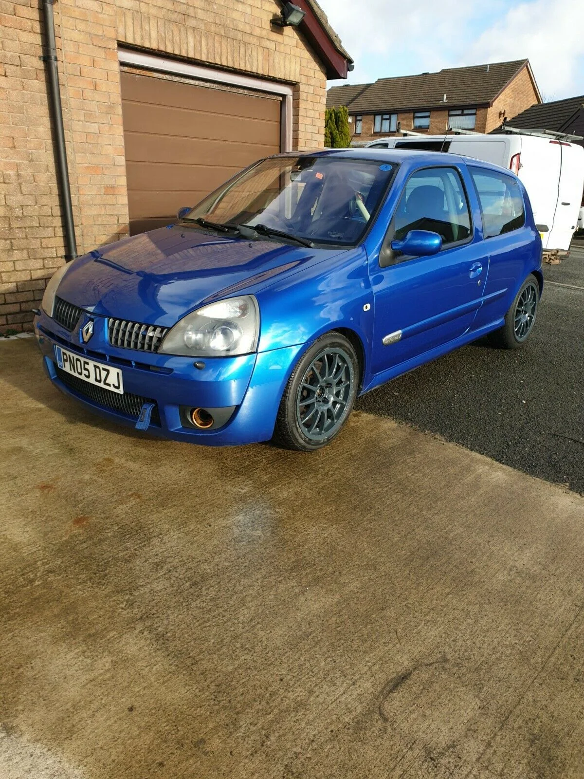

I have always wanted a Clio 182, but found myself mainly leading a life more VAG. Then a few years ago I bought an RS250 and loved it. Since then I have gone back to VW daily driving a MK7.5 Golf R Estate, which is a fantastic daily, especially when you have a little one and all the trimmings in tow. Realising the limits of the Golf regarding it's daily duties and with lockdown boredom continuing, I hankered after a cheap, fun track car. I started looking at MX5s but rust is all too common and in the back of my mind I knew I wanted another French hot hatch.
I began to search the FB pages and god forbid the FB market place. The prices of Clio 182's are far and wide and also location was somewhat important as I am in Wales and lockdown restrictions differ between nations.
Eventually I found a 172 Cup not to far away, it had been breathed on slightly and was fully black power-flexed bushed throughout and it shook like a s**tting dog. Now I am not old and I want a track car but honestly, these bushes ruined it. It also had some rust coming through both rear arches. Weighing this against the price, I walked away (to my missus bemusement!).
Then while browsing ebay, I saw an add for a Clio 182. Frank and honest description and a few messages back and forth I agreed a price and made my way to West Wales.

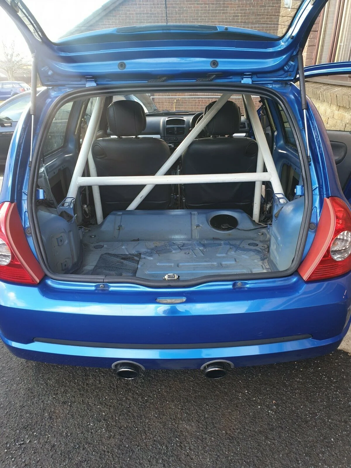

The car, sat with 150k miles and 12 months MOT. A bolt in roll cage, some TD alloys with new linglong ditchfinders, yellow powerflex bushes, KTEC exhaust and some other mods here and there. As it was stripped out I could see down in to the sills through the rear door cards, no rust! Oh and did I mention; no history apart from a "Covid trackday guidance" in the glovebox?
I took it for a test drive where the owner encouraged me to (safely) give it some. Smitten I agreed a price paid the man and made my way the 100 miles home. Faultlessly I drove home, pulled up outside my house, turned the Clio off and called the wife out to show her my new money pit.

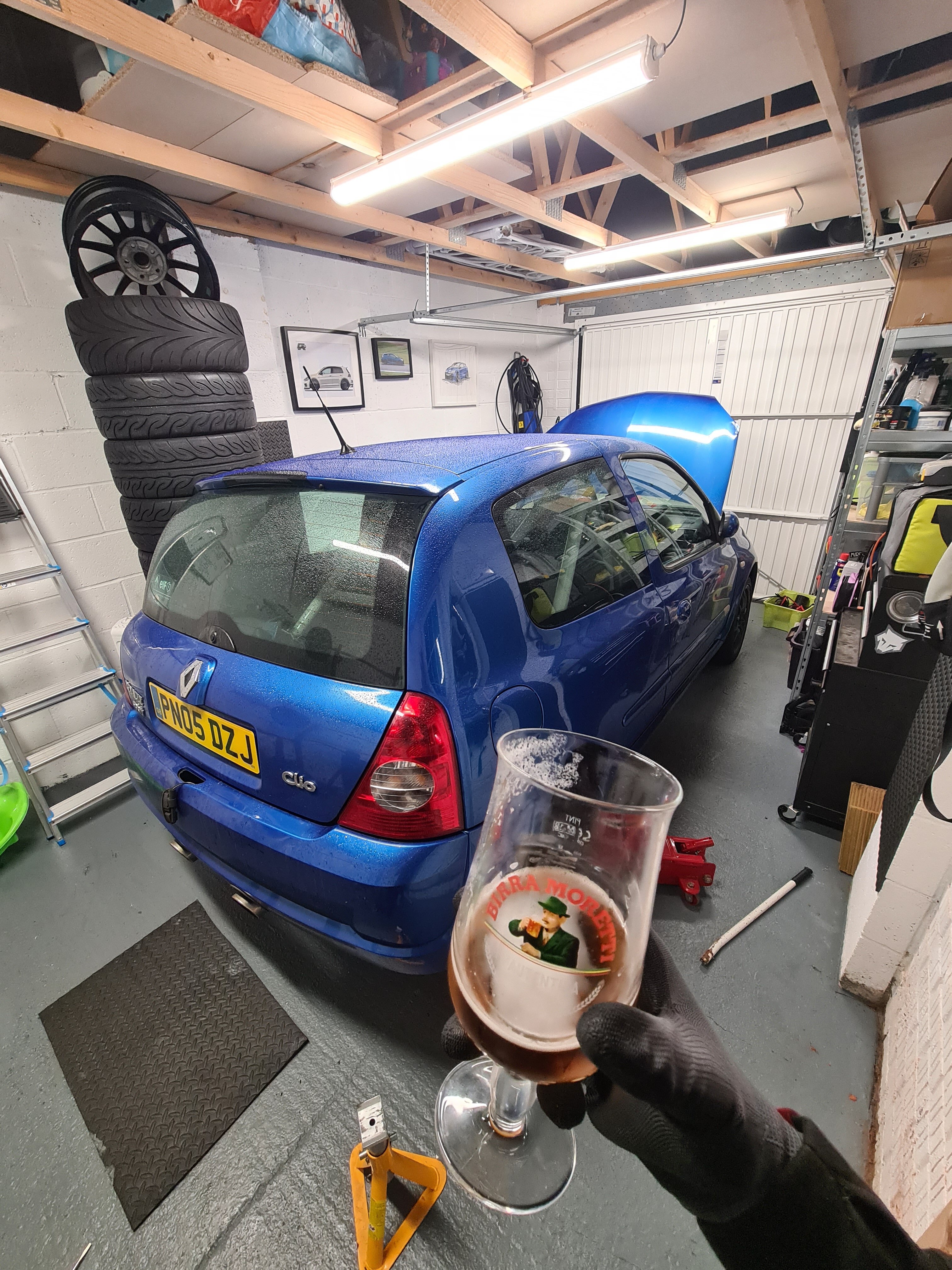

bowen86
Armed with Cliosport.net on my phone and a pint of Udine's finest, I set about finding out what had caused the missfire to appear after the journey home.
Cliosport.net, Dr.Google and a friends code reader pointed me in the direction of either an Injector or a Lambda sensor. As I had neither of these to hand I started to look in, under and around the car to make a list of what needs to be fixed and in what order.
The only piece of history I have (or had..more later)

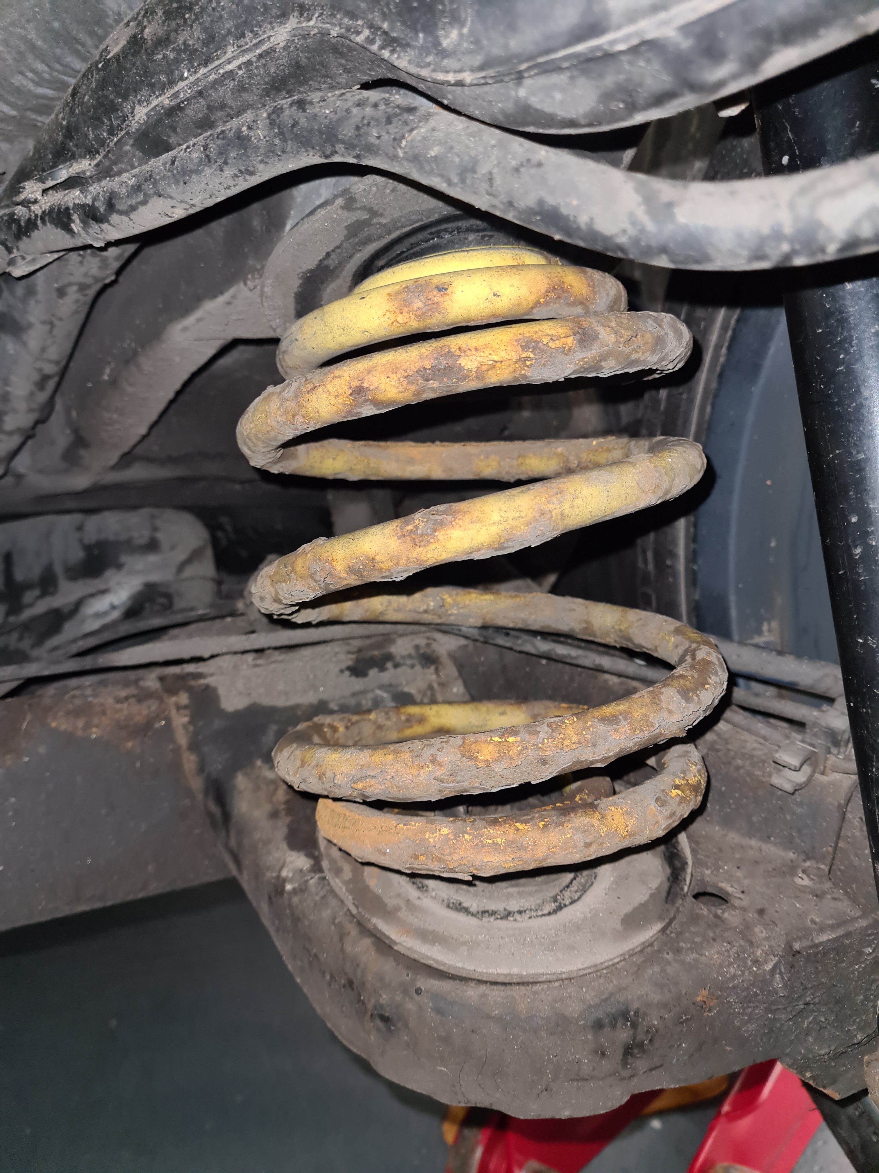

Apex springs, that may or may not have been on the sea bed.

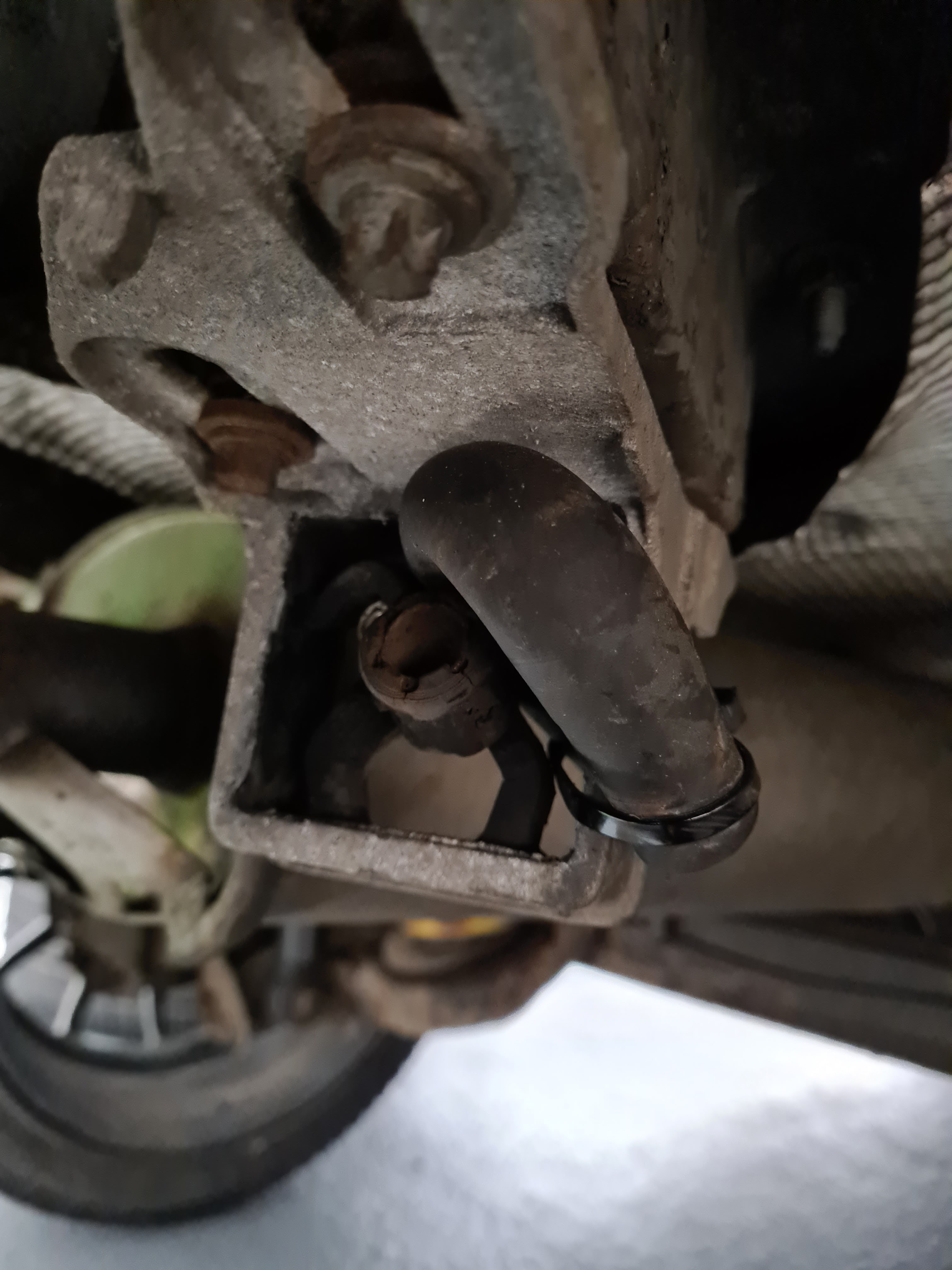

I see this exhaust hanger as a right of passage of Clio ownership

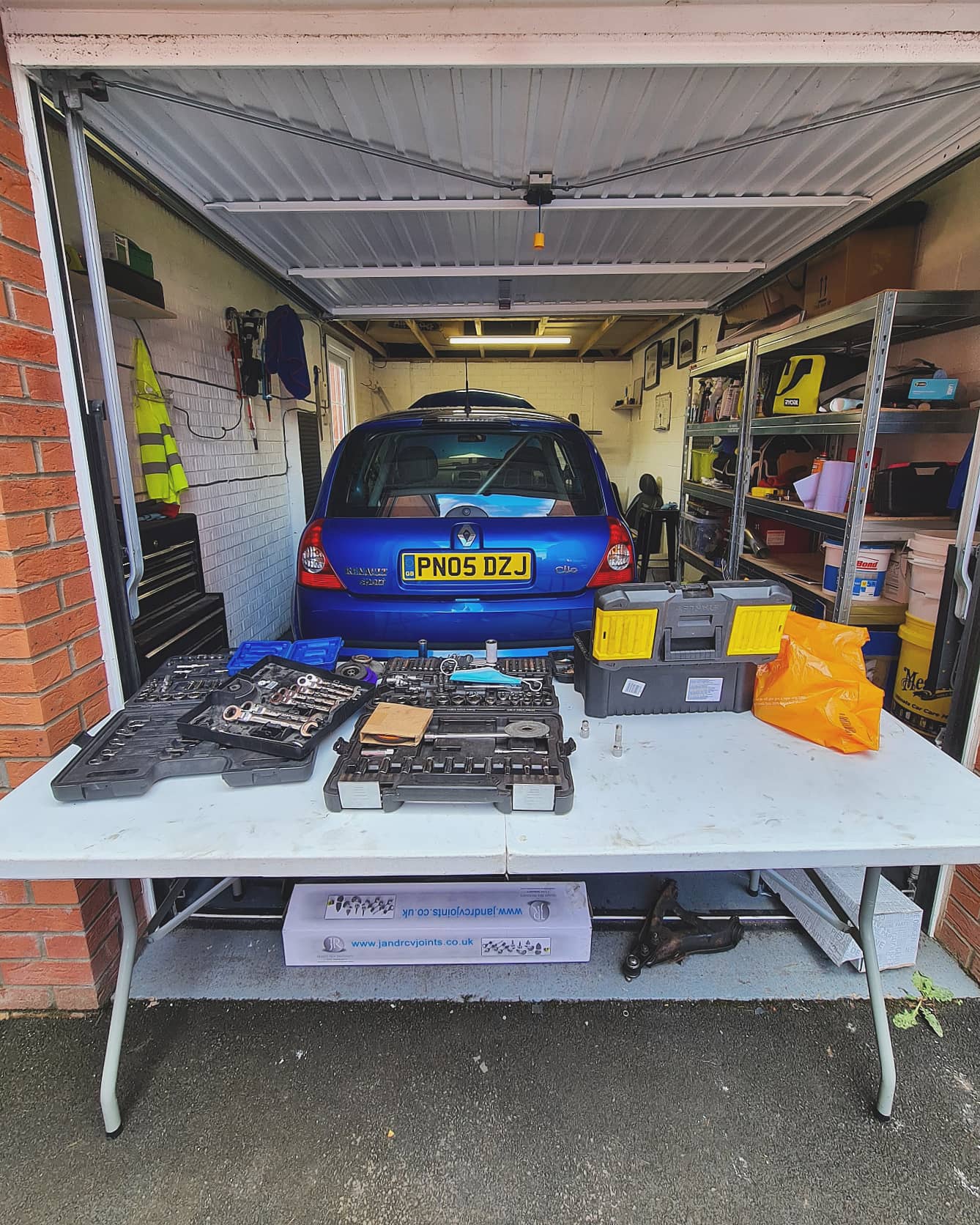

bowen86
I put a call out on Instagram (@bowen_7r if you're interested) and a few friends cam to my aide offering up some parts that they no longer needed.
I sourced:
A coilpack
2x Injectors
Washer blanks
and some other bits
I also ordered:
Engine Oil & Oil filter
Gearbox Oil
NGK Sparkplugs
Lambda Sensor
Exhaust hangers
Light bulbs

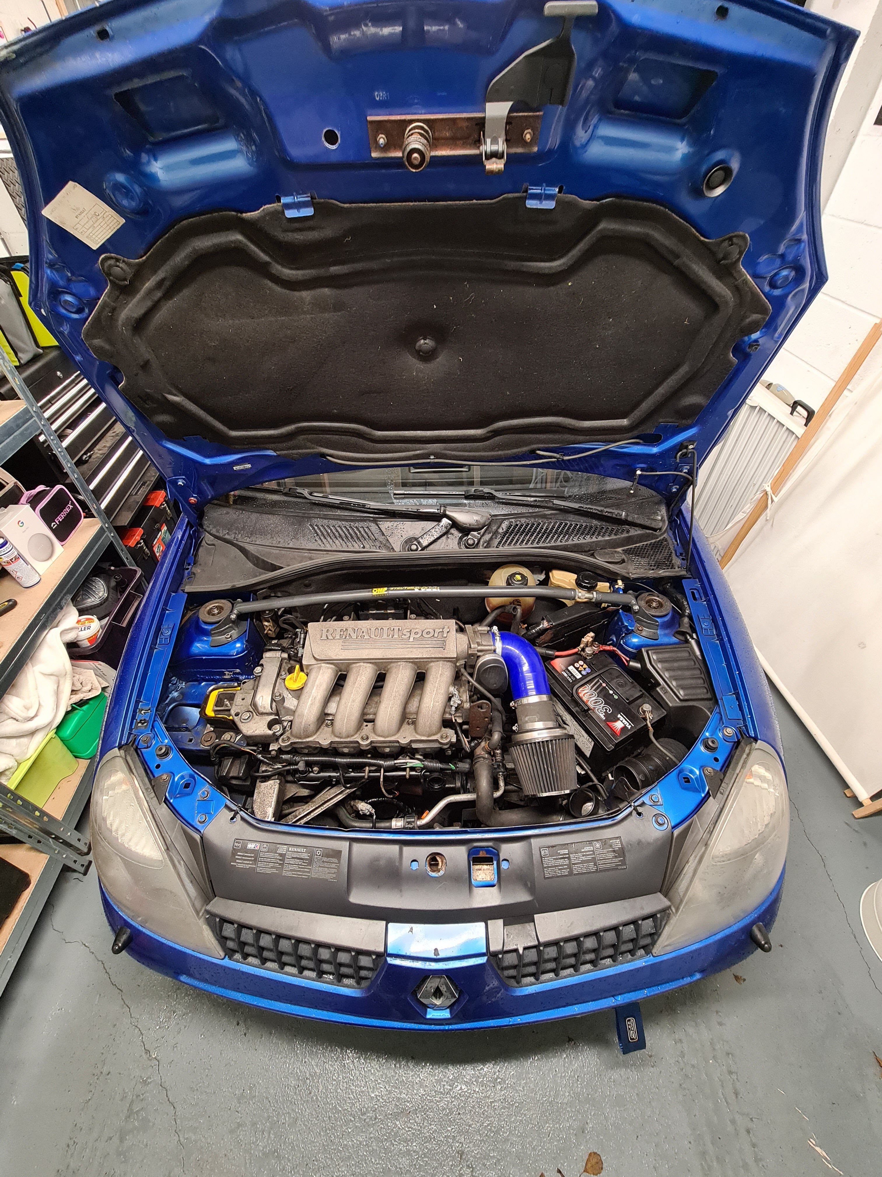

With all of the above fitted.... I nervously turned the key, and...... this missifire was gone. Hoorah.
I took it out the garage, grabbed the wife and we went for a blast. I don't think the Missus was half as impressed as I was.
So pics after my work, not that you can see any of it.

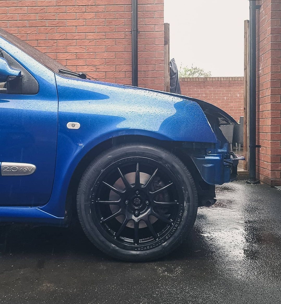

I also removed the sound actuator thingy and the carbon canister.

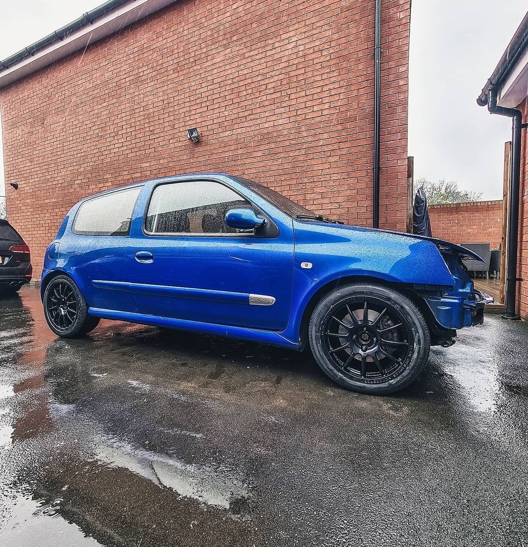

With it now running pretty well I set about sorting some of the aesthetics:

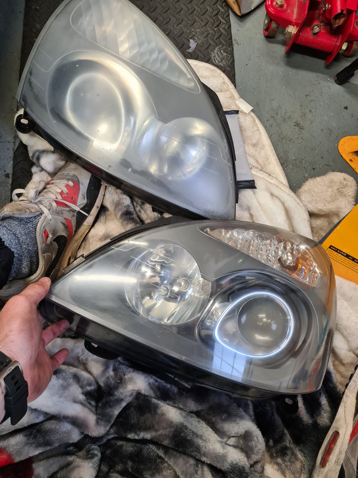

Headlights refurbed
Trimmed a rear boot mat and painted the roll cage silver instead of white.
I also fitted a Fabia splitter, headlight washer blanks, degunked the interior plastics and removed the toe strap for a cup racer tow eye. Recently I removed the side skirts to check the sills which are not in great shape, so I'll be straightening and prepping them for a repaint before refitting the skirts. Also no signs of rust.

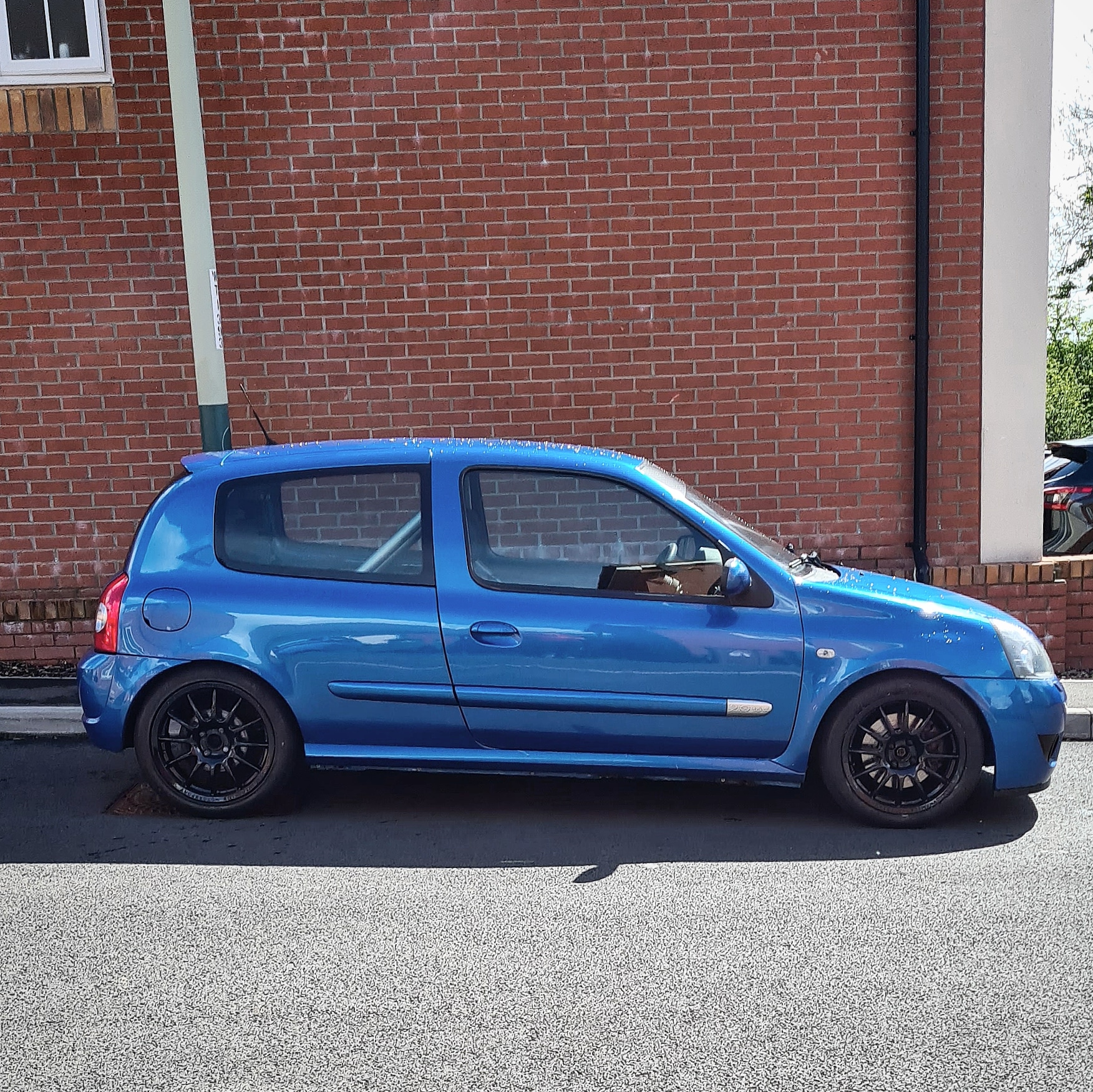

Refurbed the wheels myself, don't like black wheels but I think it suits it.

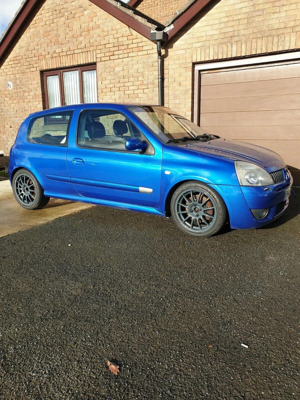

Busy day yesterday. A mate came around to help, bribed with bacon rolls and tea.
Managed to fit:
Front 172 cup struts
Cooksport springs
Lower arms
Powerflex Top mounts
And the N/S Driveshaft, after the inner boot split on the back of the block, so I grinded that back too.
Nothing really fought us thankfully. I'm amazed the (apex) springs were in one piece as they were really crusty.
I noticed the O/S outer CV boot was split so I'll replace that or possibly. The whole shaft for the cost, it makes sense to just replace the shaft.
Bucket seat is almost in.

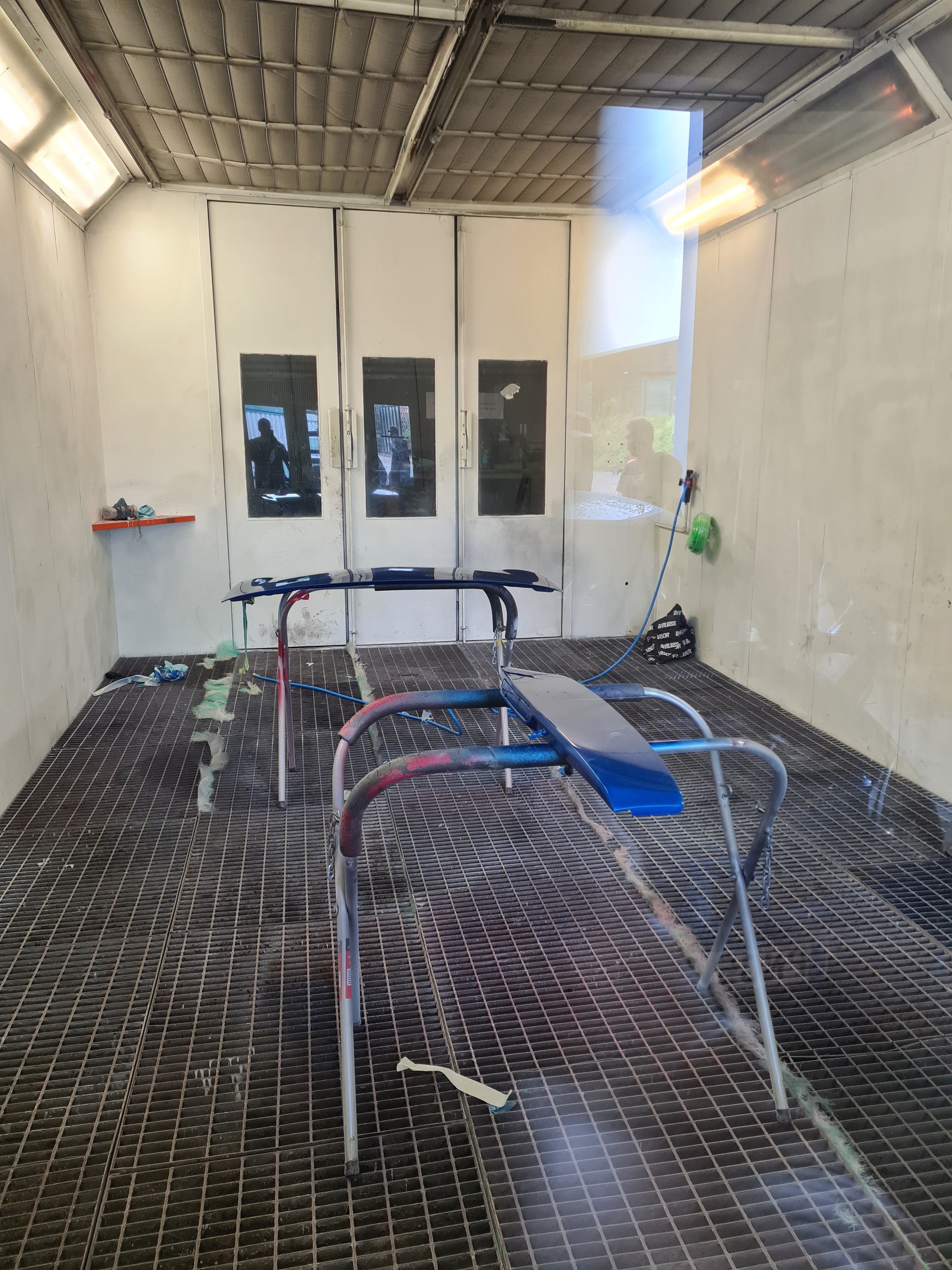

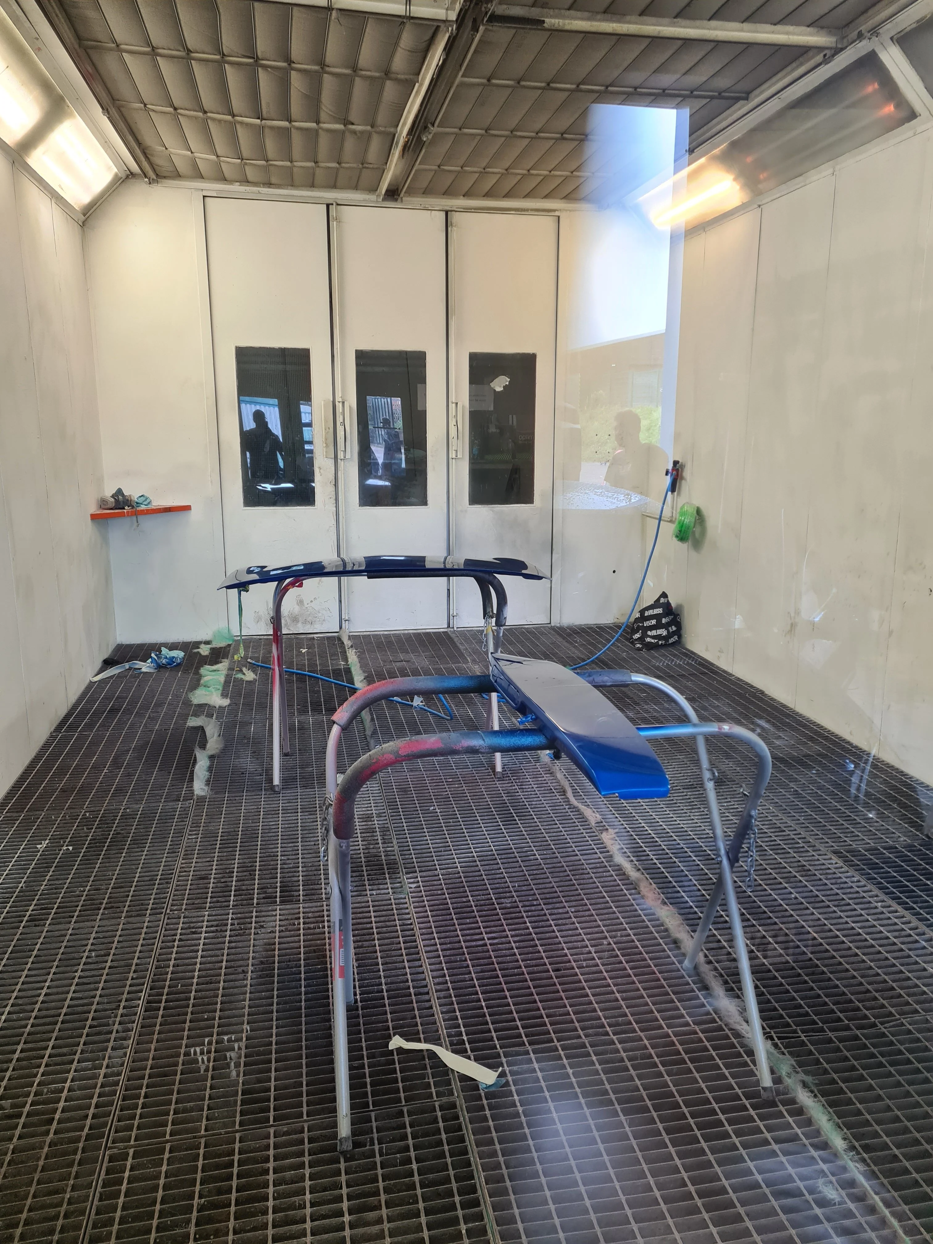

A day before the track day at Llandow I managed to have a freshly painted bonnet and cup spoiler fitted....ready for me to ding on the track day.

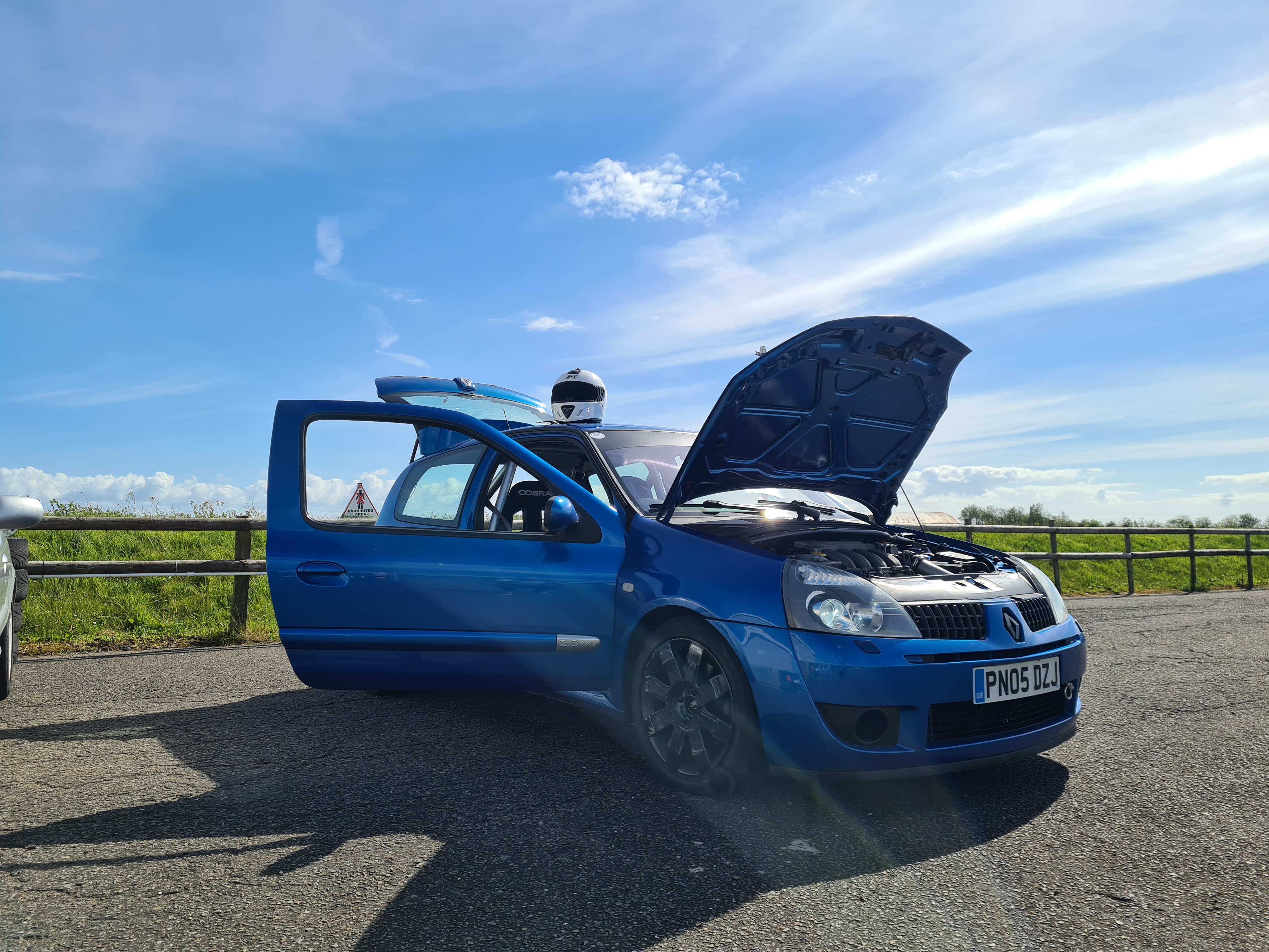

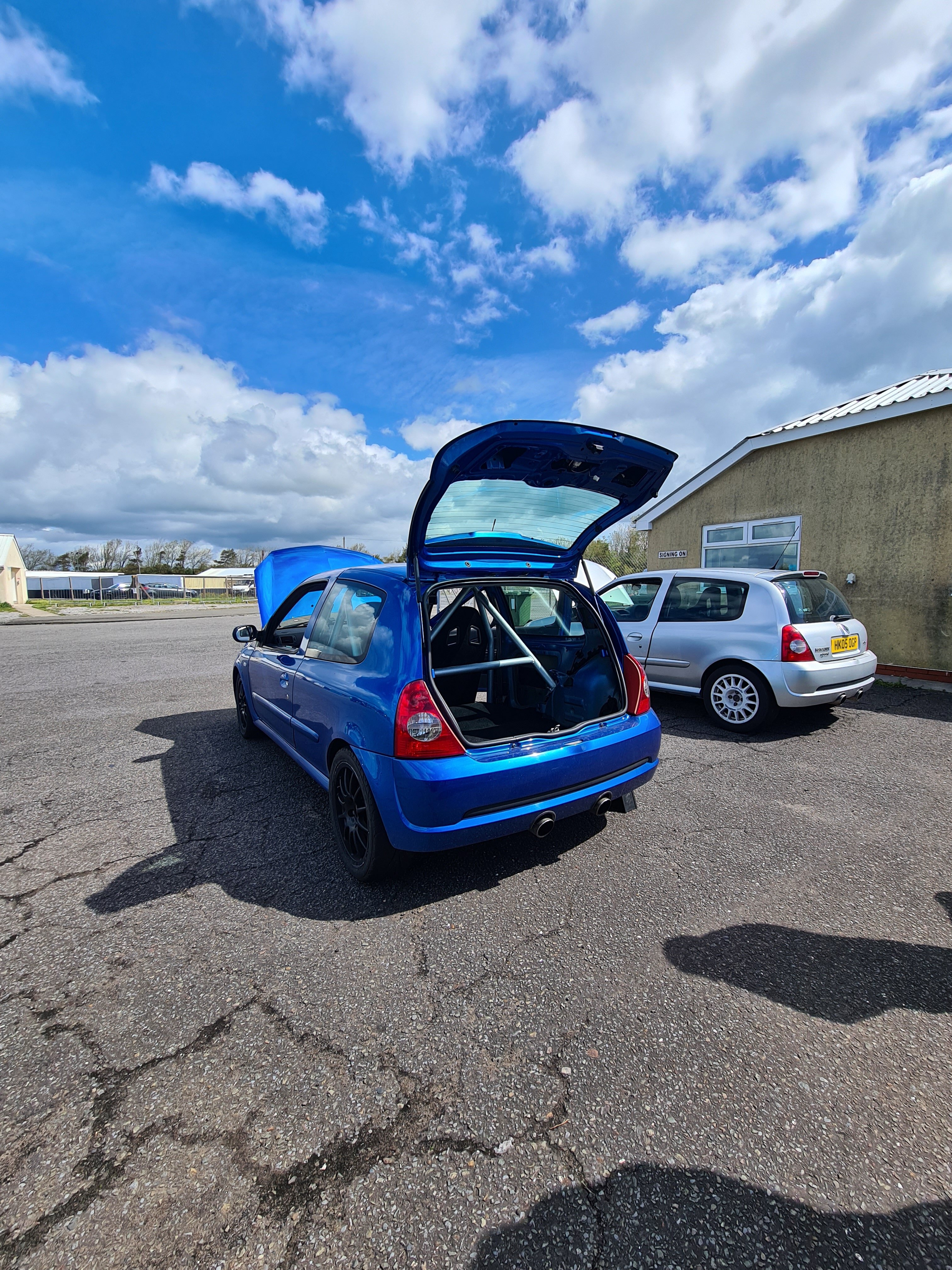

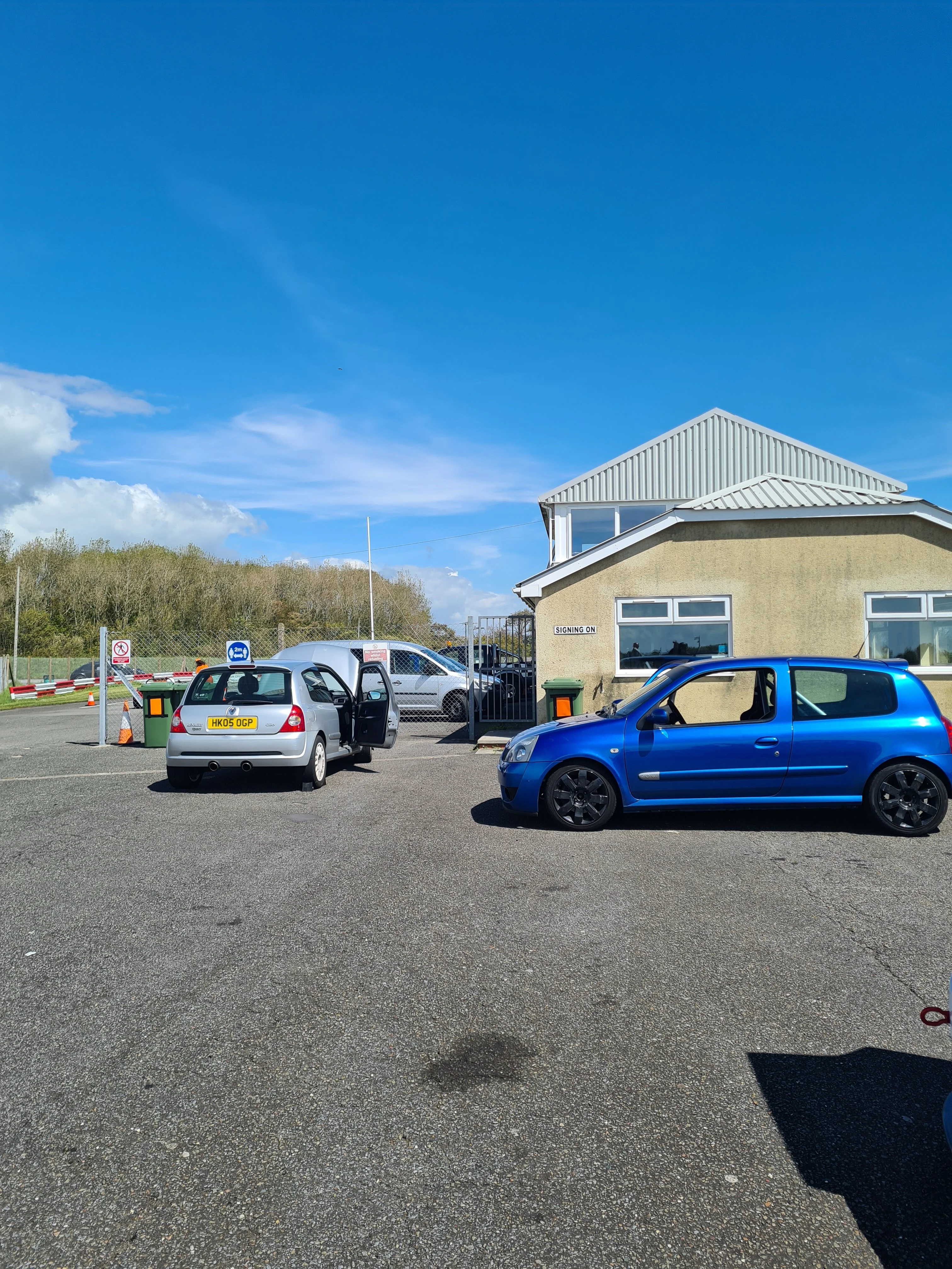

22.5.21 Llandow
Llandow is almost on my door step, but I've never been. Choosing Castle Combe as my nearest which is just shy of an hour away.
We arrive, the rain has held. Tyre pressures and wheel bolts checked, all good.
Then comes the noise test and now the covid temperature test... I passed one and failed the other. I asked the Marshall to comeback in 5 mins when my temperature will have dropped, it did. Thankfully.
About 20 cars there, all manner of things from Ariel Atoms and Westfields to Audi S5's and Minis.
This was my first track day in 2 years and my first in Clio and an N/A car. The day starts and the Clio and I take our time to adjust to the course and blow off the cobwebs. After a few laps I am fully in to the swing of it as is the Clio. I had my reservations about the Clio as since I've had it, it's been a bit like Triggers broom. The front end refresh being the most note worthy. I needn't have worried. The Clio took all the abuse I and the track threw at it. What a great car. Throughly enjoyed it.
Llandow is notorious for being an unforgiving track, tough in brakes and tyres especially. I chewed through the front left in the first half of the day. Luckily a mate who I was with on the day (owns a clio which you'll see in the pictures) lives close by and at lunch he popped home and got me his spare wheels with road tyres. Eternally grateful and he became my hero allowing me to enjoy the rest of the day.
My only gripe with the Clio is the steering. When I bought it I was told it had a PAS leak, which I though I had fixed but I'm not sure.
I'm considering EPAS. Can anyone give me their opinion on it if they have it etc?
If you made it this far thank you and I'll let the pics do the taking.... I should say there is no track photographer at Llandow which is dissapointing although I'm told to expect some from a friend who was spectating.

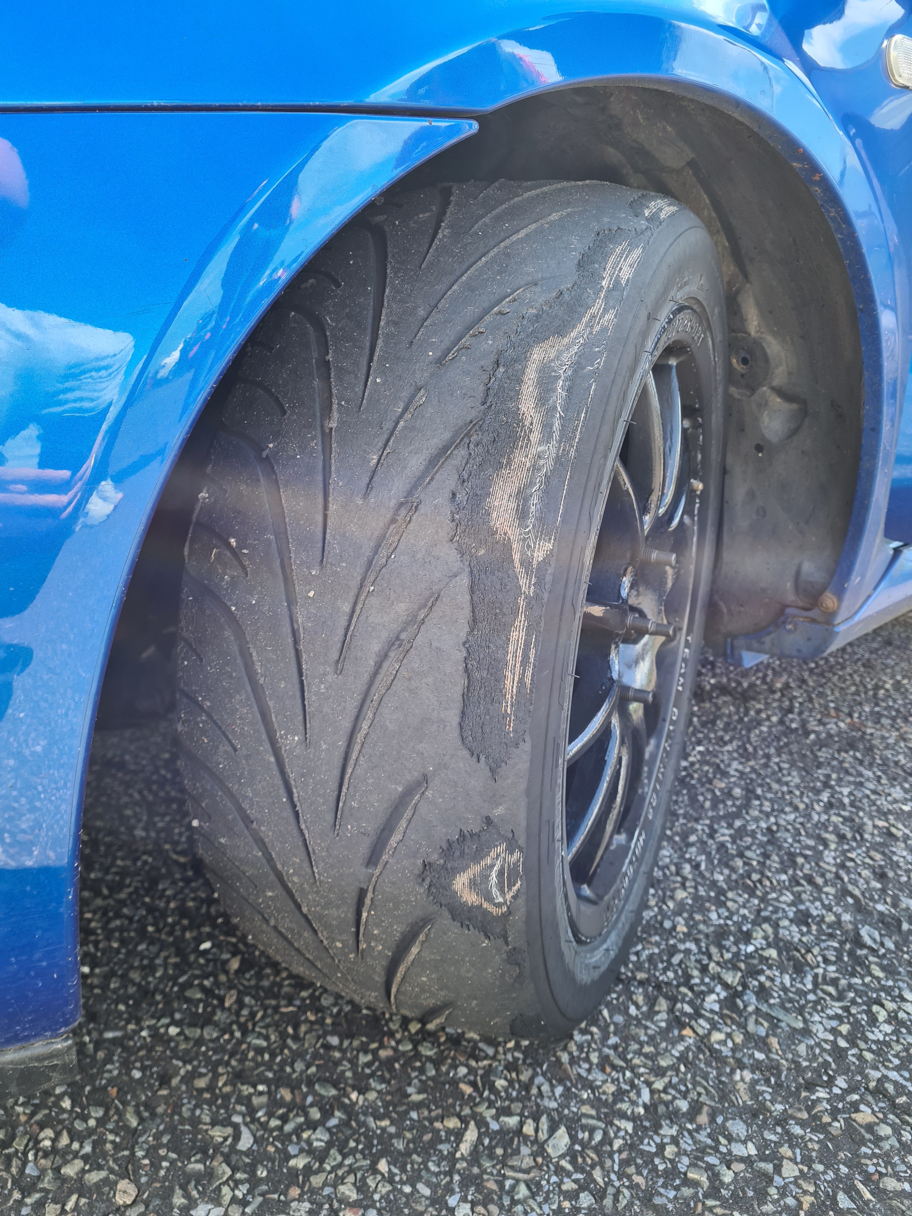

Your tyre pressures cant have been right to rip through the tyre like that? Either that or loooads of camber!
bowen86
I was checking my pressures before and after every outing on track, ensuring they were optimal. Camber and tracking could well have been out as I've done loads of work on the front end, so I'll give you that.
Have you done Llandow before? It is notoriously hard on tyres especially the front passenger side.
Klumpy Dumpy
Not all gingers stink of piss. But I do.
Nothing to do with camber or pressures mate. RSR's are f**king s**t, a made had one of his go like that after 500 road miles on an EP3, the tyre just decided to shed it's skin like a snake 😂
If it's a track car remove the PAS completely, done it on mine and it feels really good when you get over 10mph
bowen86
Absolutely. These tyres were the only option I had at such short notice. I had them on my Megane RS250 track car and they were shite. They have lamination failure. I didn't expect much at all and I was right.
Klumpy Dumpy
Aye they're dogger haha
If youre gonna be doing a few trackdays a year grab yourself a set of 15" wheels mate. 195/50R15 slicks and semi slicks are half the price of 16" ones
Louis
I Love Ed Sheeran
Surely they dont wear like this?! Looks insane!
