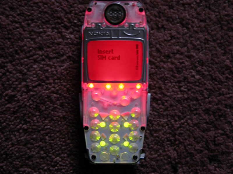

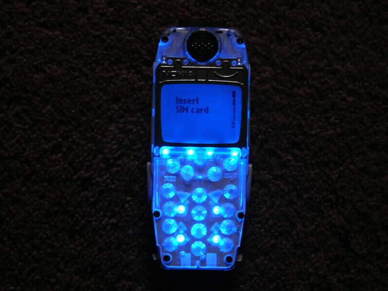

i have done lots of led changing in the past, just on mobile phones

can't see it being harder than certain phone led changes, but it sounds like theres a lot more work involved!
I used to chip literally hundreds of ps2's and xboxes - and from my experience, removing items from a board is probably more risky than soldering new things to it - its a lot easier to take too long and burn components, and there also the risk of removing a solder pad from the board - which is fixable, but only if you really know what you're doing

26 thats cool, its easy work if you ask me. ive done so so many mobile phones.
