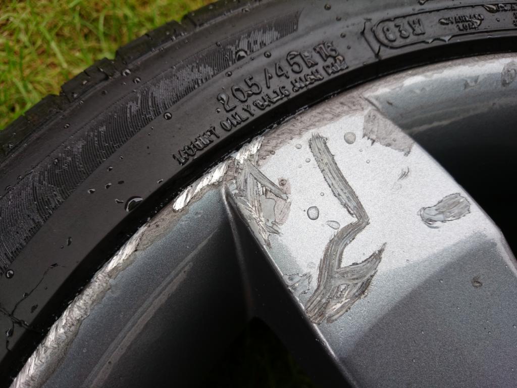

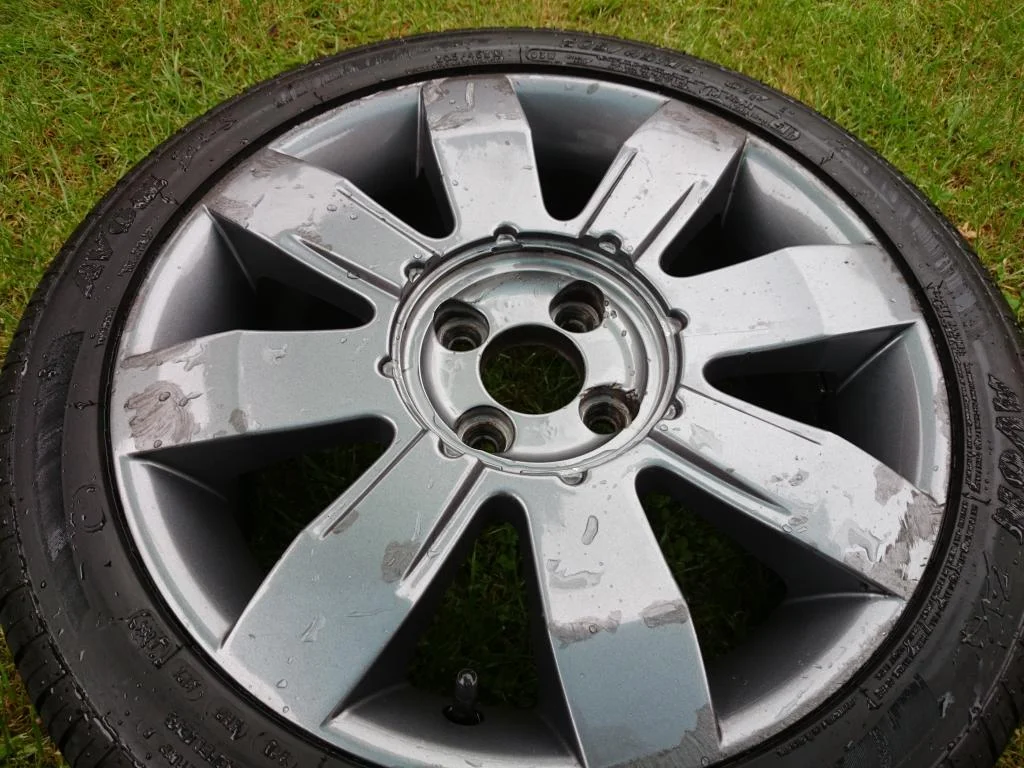

My alloy wheels were looking very tired and battered (previous owner never bothered with refurb).
I have driven around with them for 10 months and didn't want to pay £££ for a decent refurb so thought I would give it a go myself.
I decided to spray them a darker shade than the standard colour as my car is Inferno Orange and darker wheels look nice against that colour. I went with the Ford Graphite Grey after much research lol.

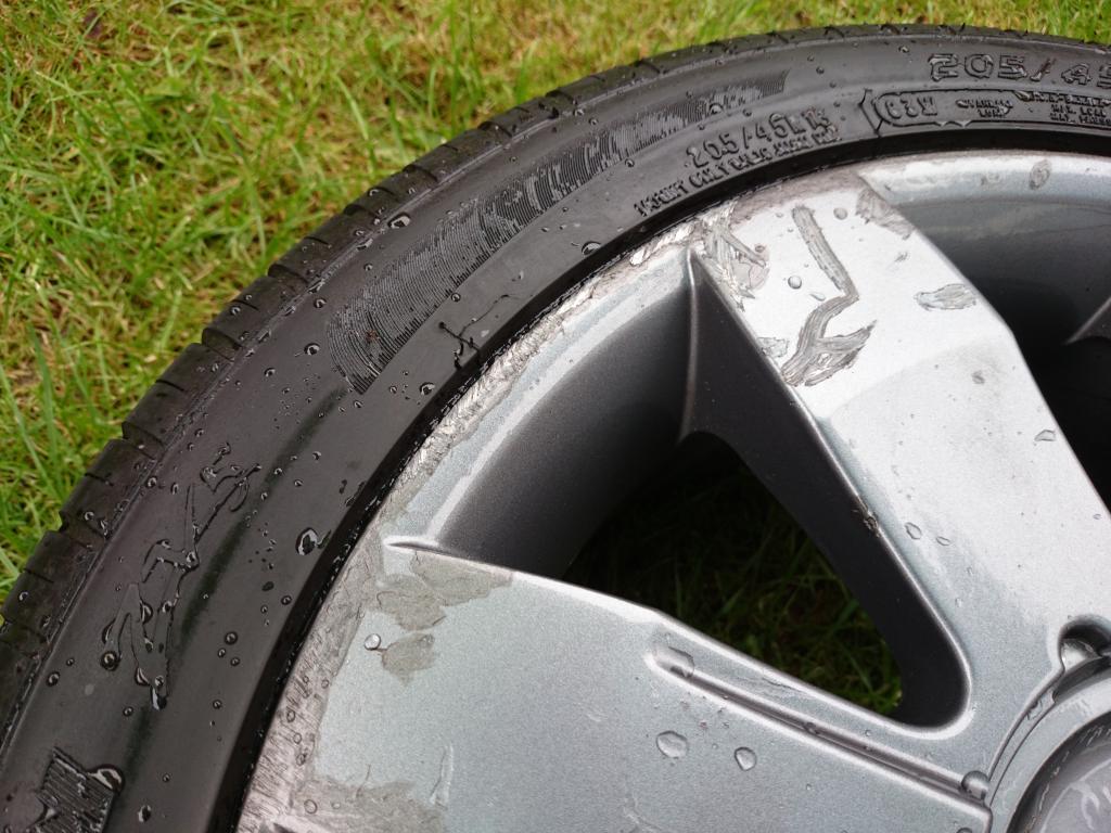

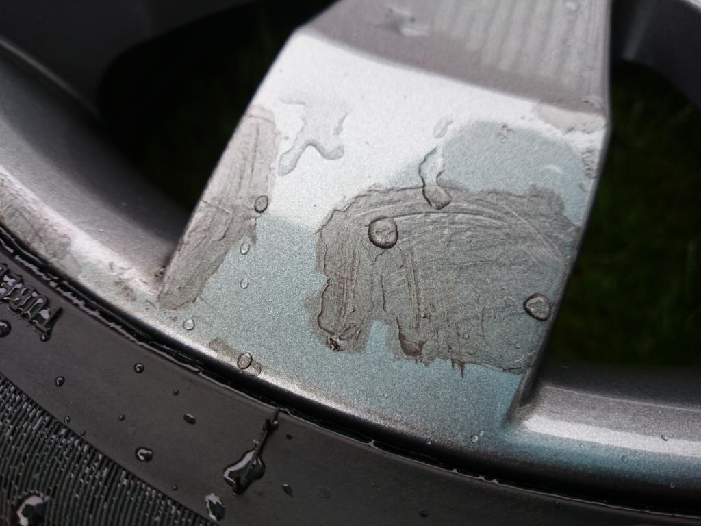

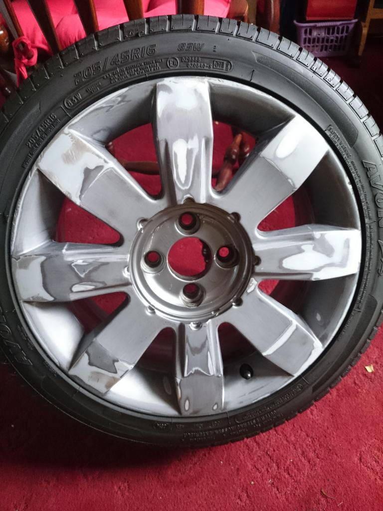

Before (as you can see I tried touch up as a temporary measure):

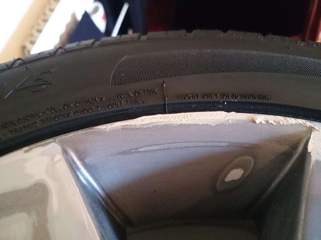

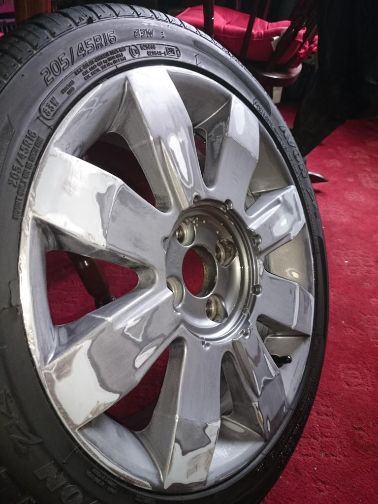

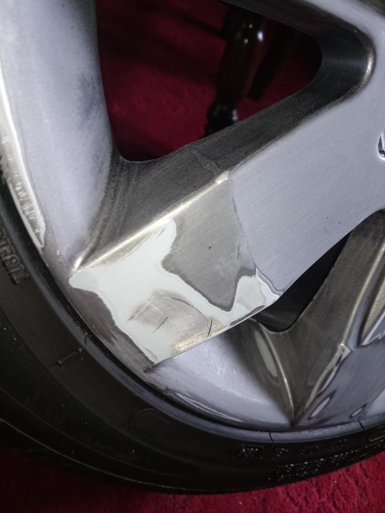

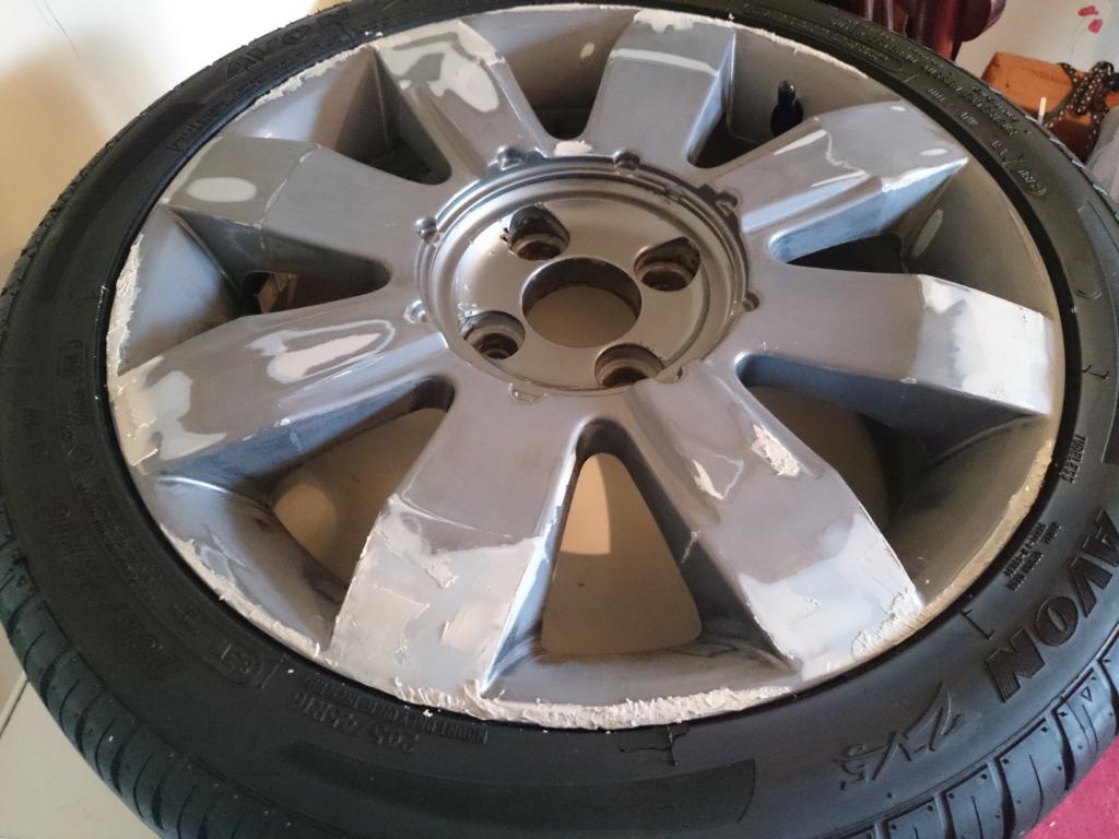

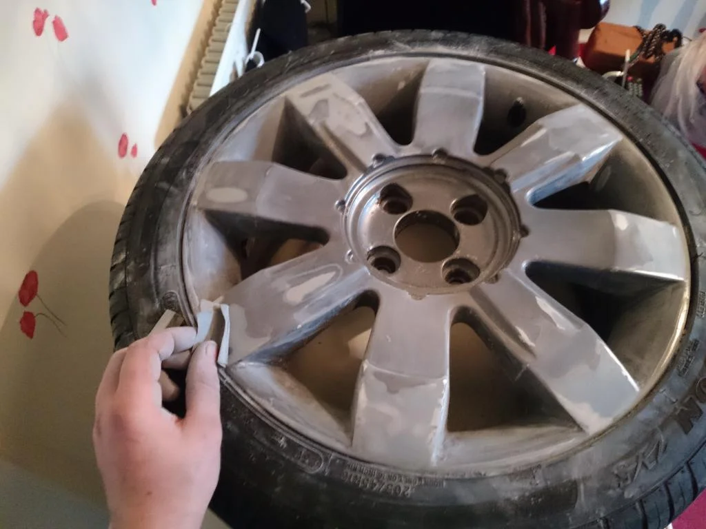

The preparation took ages :dead:, after sanding down the burrs in the metal using 400 grit I then switched to 800 then 1200 and 2000 grit wet and dry.

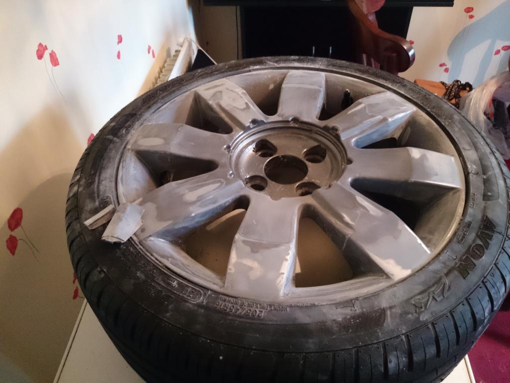

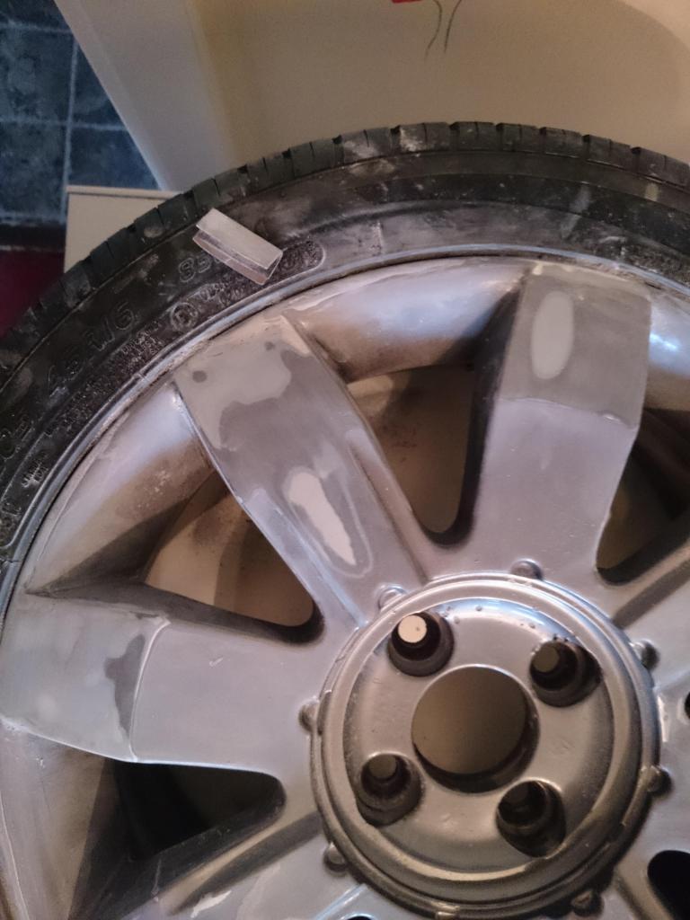

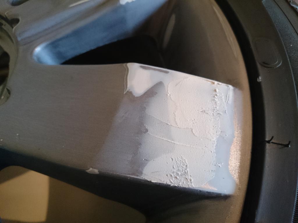

Filling the dents and scatches, I decided to use davids isopon car body filler as it keys well and is easy to sand back, again saded using 400,800,1200,2000 grit

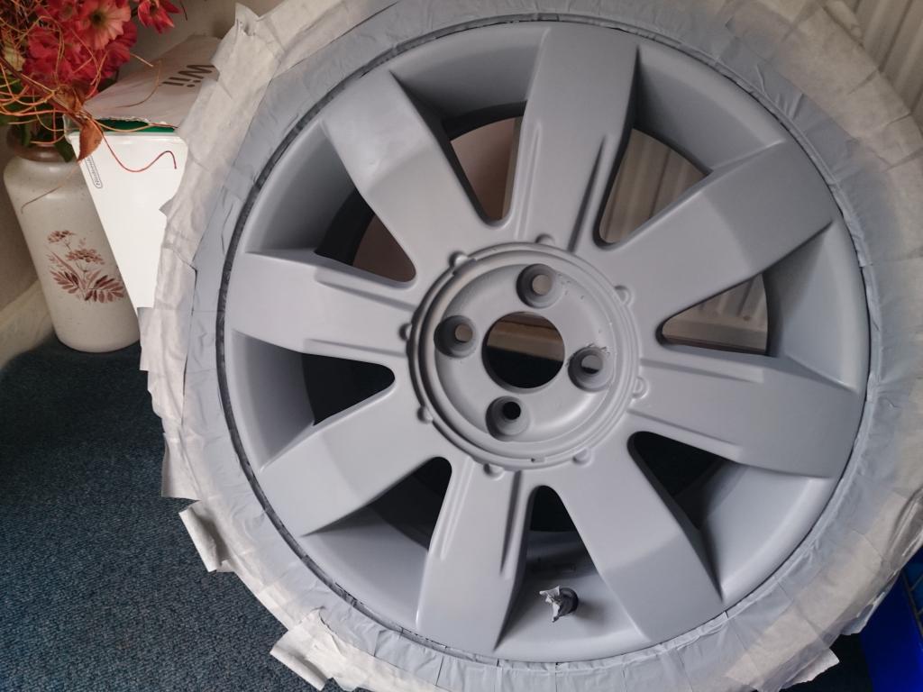

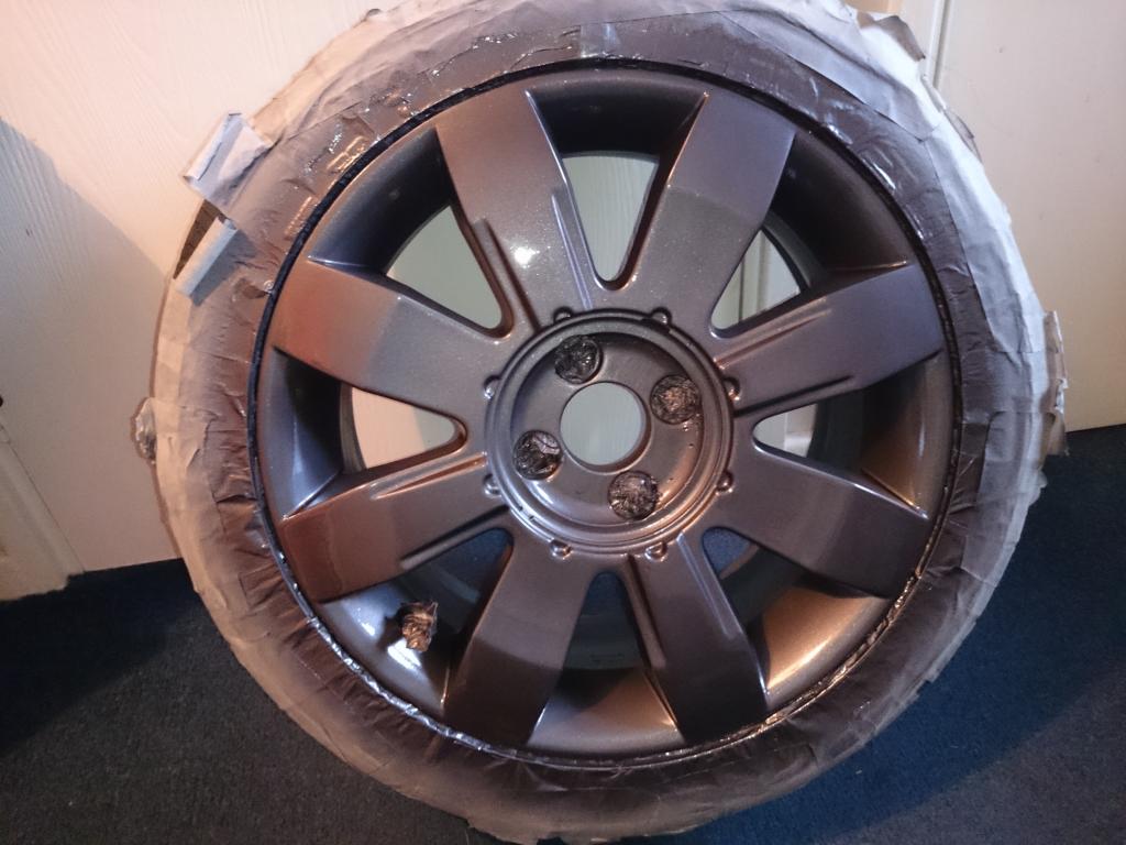

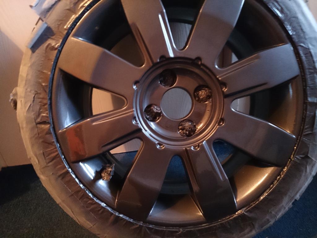

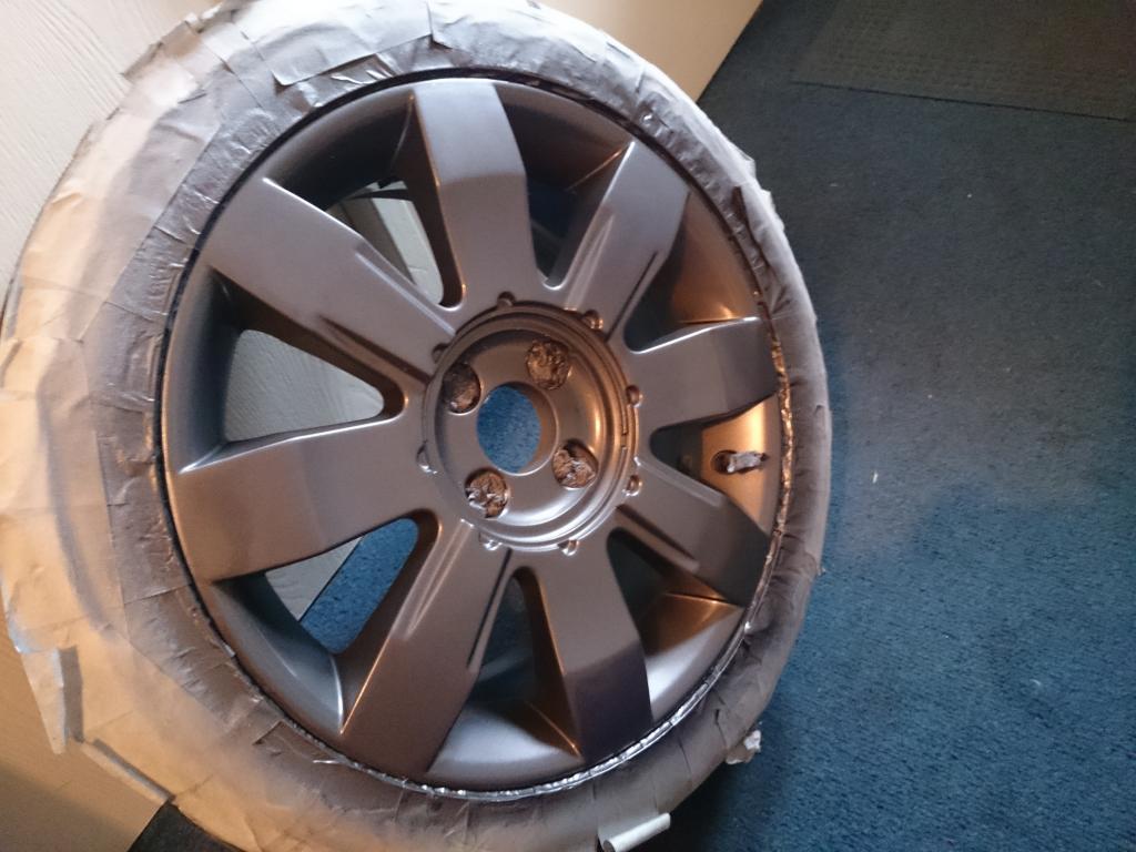

Primer and paint and laquer stage, I applied 3 coats of primer an sanded back its coat to ensure a smooth surface (took long then I anticipated lol), then 3 coats of paint and laquer

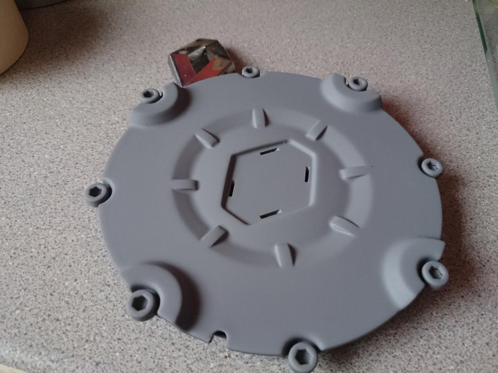

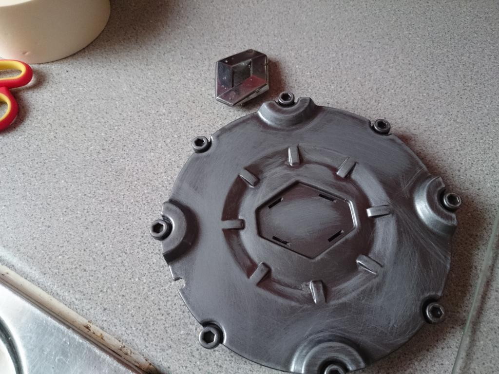

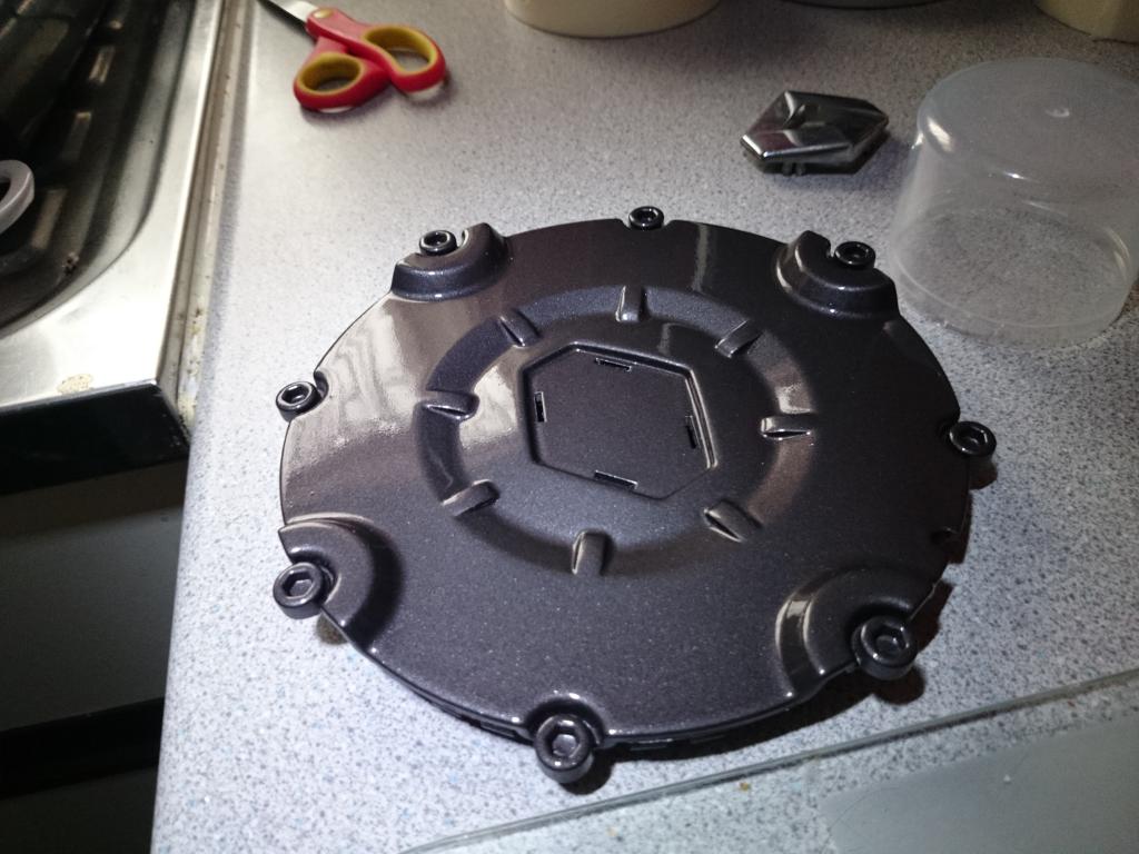

Not forgetting the wheel center caps:

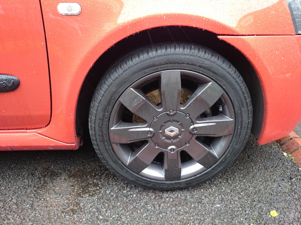

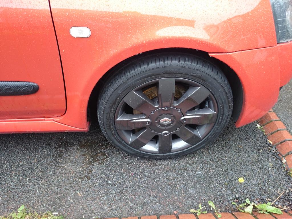

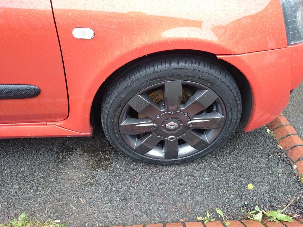

That's it, did all four obviously. Took a few days to do all four wheels around my working hours aswell. To my surprise they are near perfect, anybody that didn't see my paint them doesnt believe I did them lol.

Cheers guys, it cost me a total of £65 in materials, that's the primer, paint, lacquer and a complete wet and dry sandpaper set and masking tape.
Already had some filler in the cupboard ;). It was fun to do, the problem is im a bit picky which meant it took longer than I thought it would lol.
Definatly worth a go for anyone thinking about doing it. I was apprehensive at first but they looked terrible before so I had nothing to lose :).

I've done several sets. Never been kurbed as bad as that so never used filler. The sanding is such an epic epic bore though.

Another ball ache is if you over spray and end up with a run line, which you then have to wait to dry before sanding, before you can add more coats
This happened with the lacquer, had to wait days for it to harden properly.
