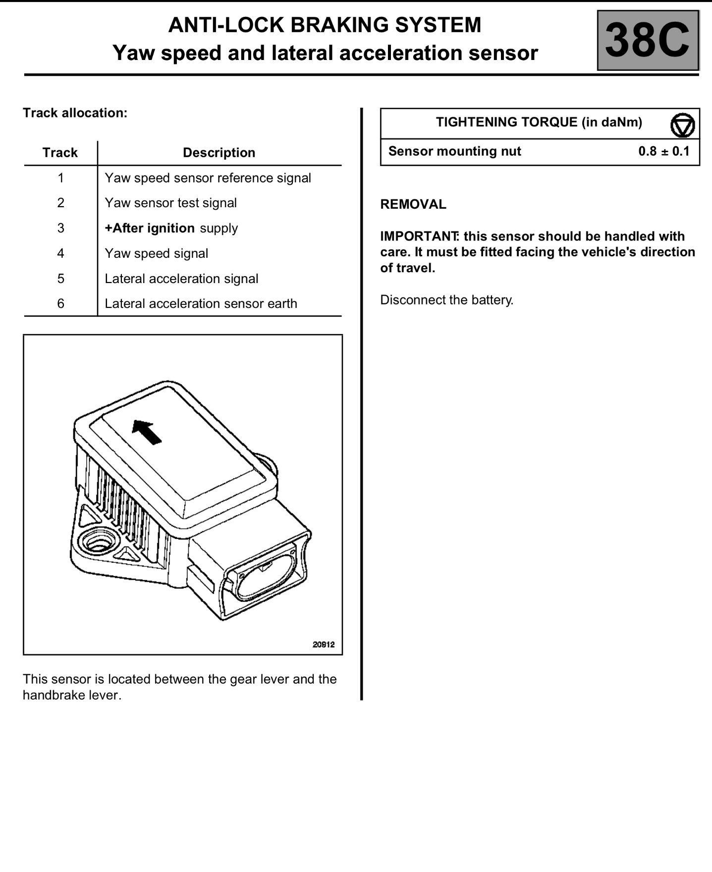

Also, check the connector to the direction sensor, it's under the handbrake trim. It has an arrow pointing forwards.

The Yaw sensor under the handbrake cover is a good shout as I had this this problem. Clean the connector and make sure it's plugged in properly.
  Clio.

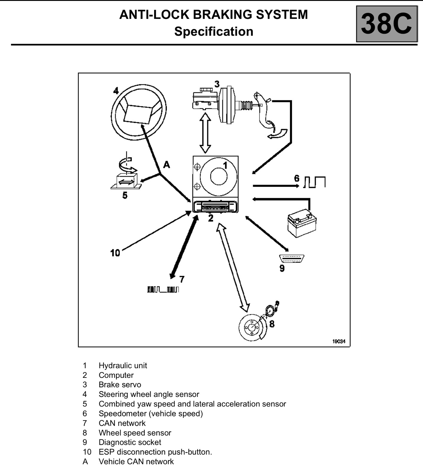

Here's the components that make up the system.
