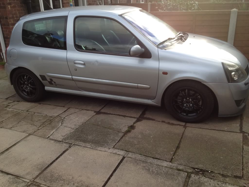

Definitely needs springs at the least. I have Sportlines at the minute whilst im saving up to afford coilovers.
Doesn't look too bad but not ideal in my opinion.

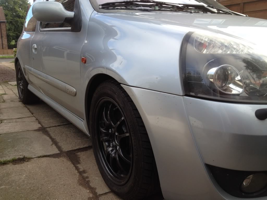

Thanks guys, the difference is clear in the picture. The jury is out. It looks like a cheap set would do as a short term fix.

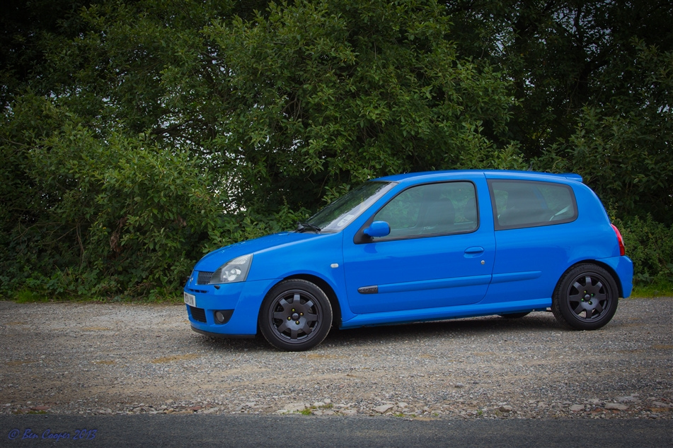

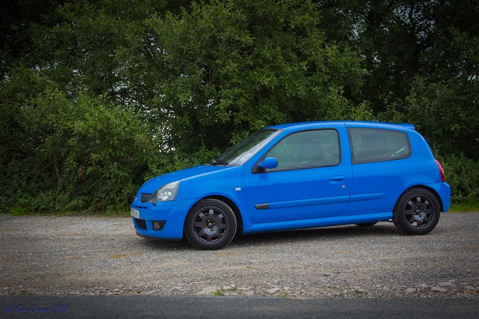

heres cooksports with 15's at et37 195/50 R15 Michelin PE2's with 15mm front and 10mm rear spacers, they catch a bit from time to time. without the spacers they'd be fine, the standard wheels on this setup on 205 tyres and et43 don't rub at all ever

Hi mate, whats the distance between the centre of the wheel and the lip of the car on this. looks ideal and I am struggling at the moment getting a good coilover height
