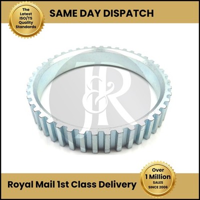

Oh front ABS rings are the other thing I'm after? Any ideas?
I've managed to find a Valeo Clutch on ECP - hopefully it's correct (will be keeping receipt!)
These are good quality abs rings.

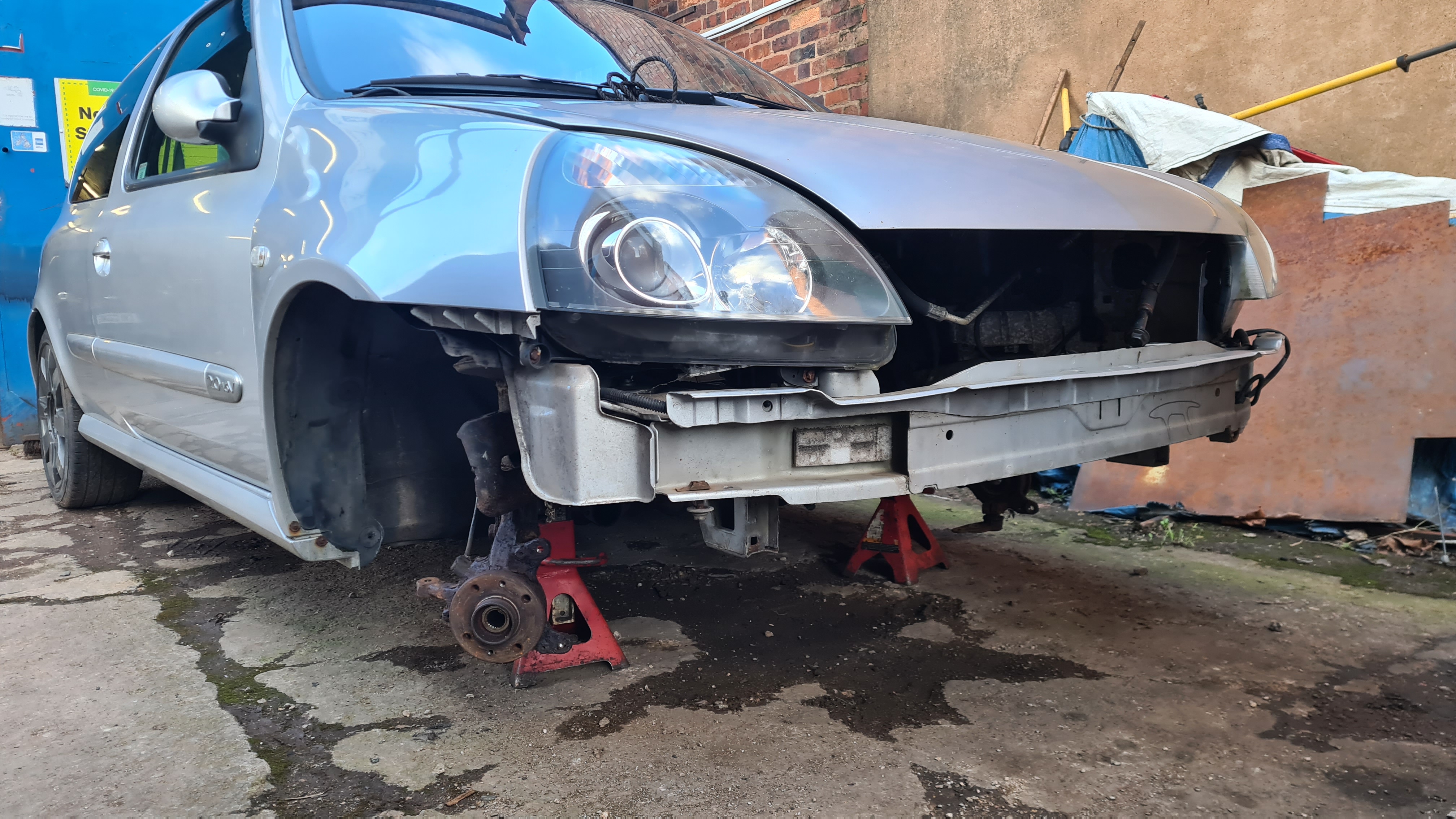

All pretty much done now - will get some pics up.

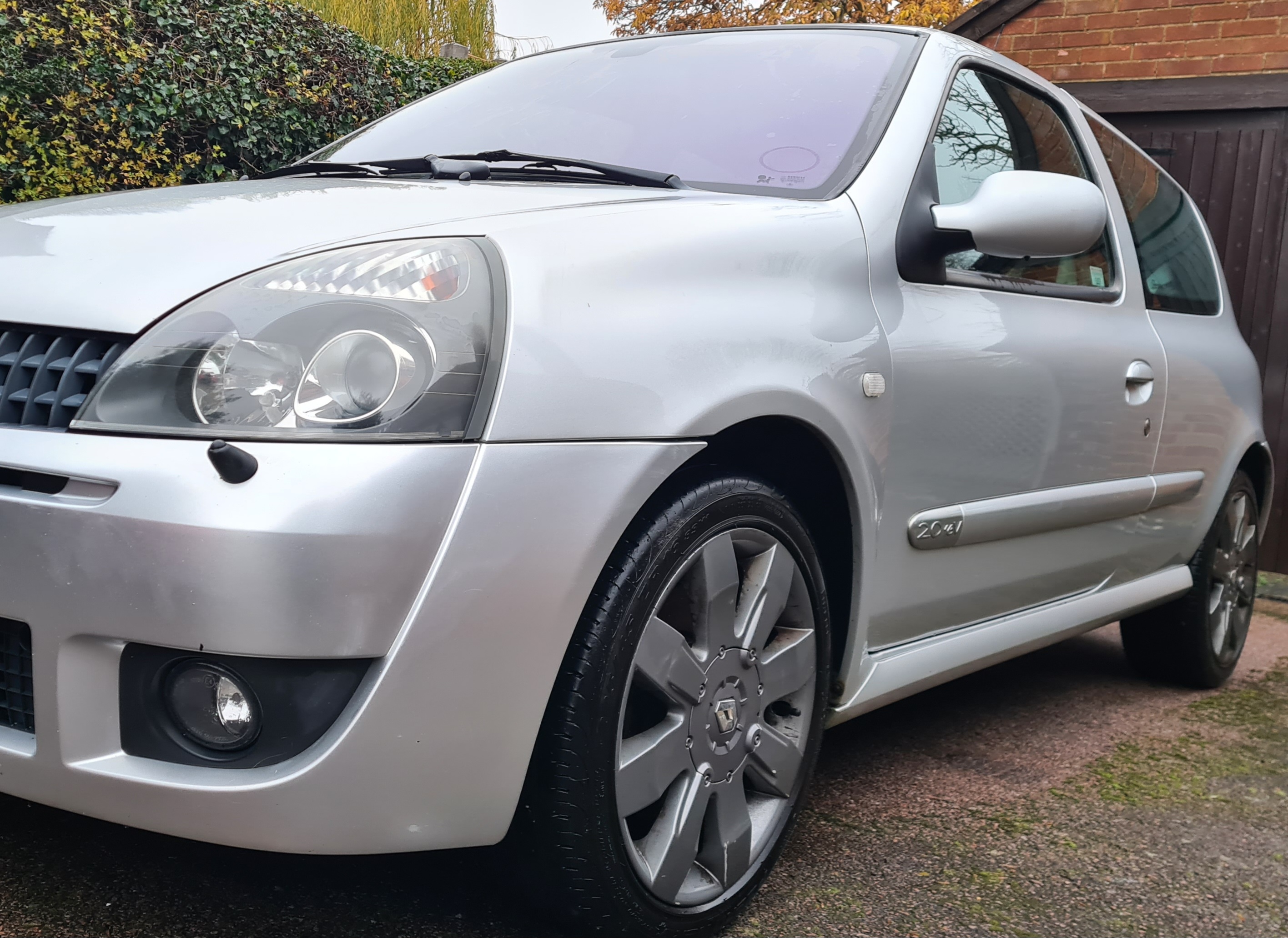

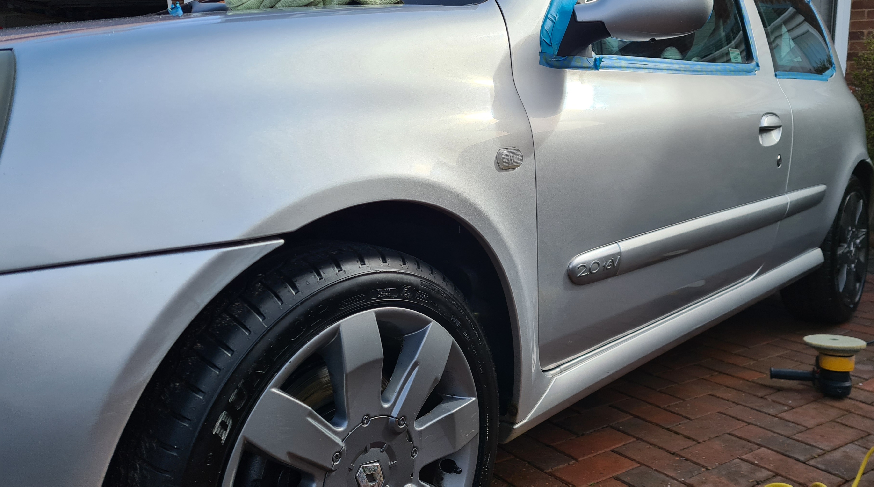

All polished up this weekend and back on the road! I've spent more than the original purchase price 10 years ago restoring it. Guess I'll have to keep it now. :oops:. Took it for a spin but as it's a had engine rebuild being gentle... for now! Love it.
