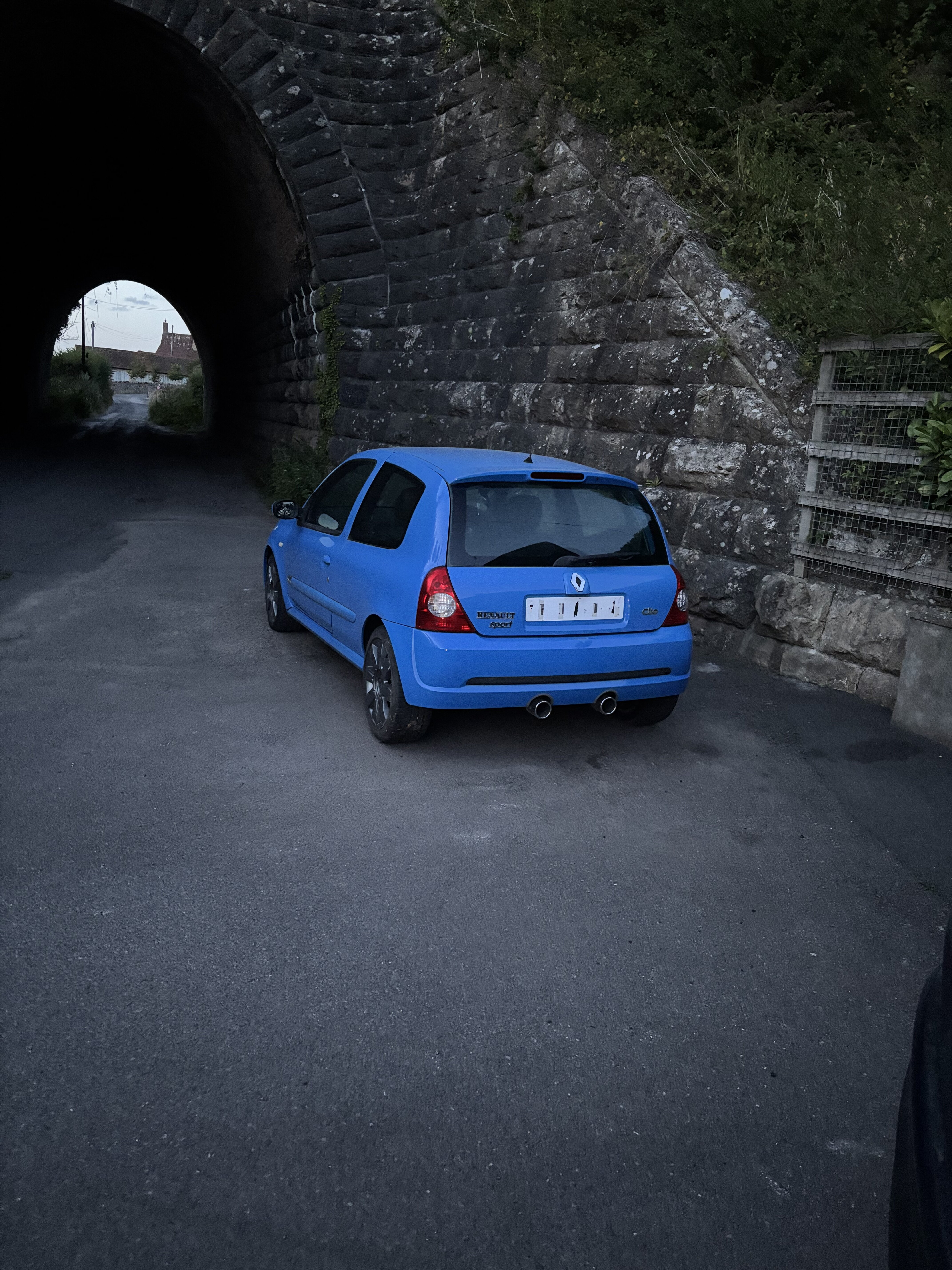

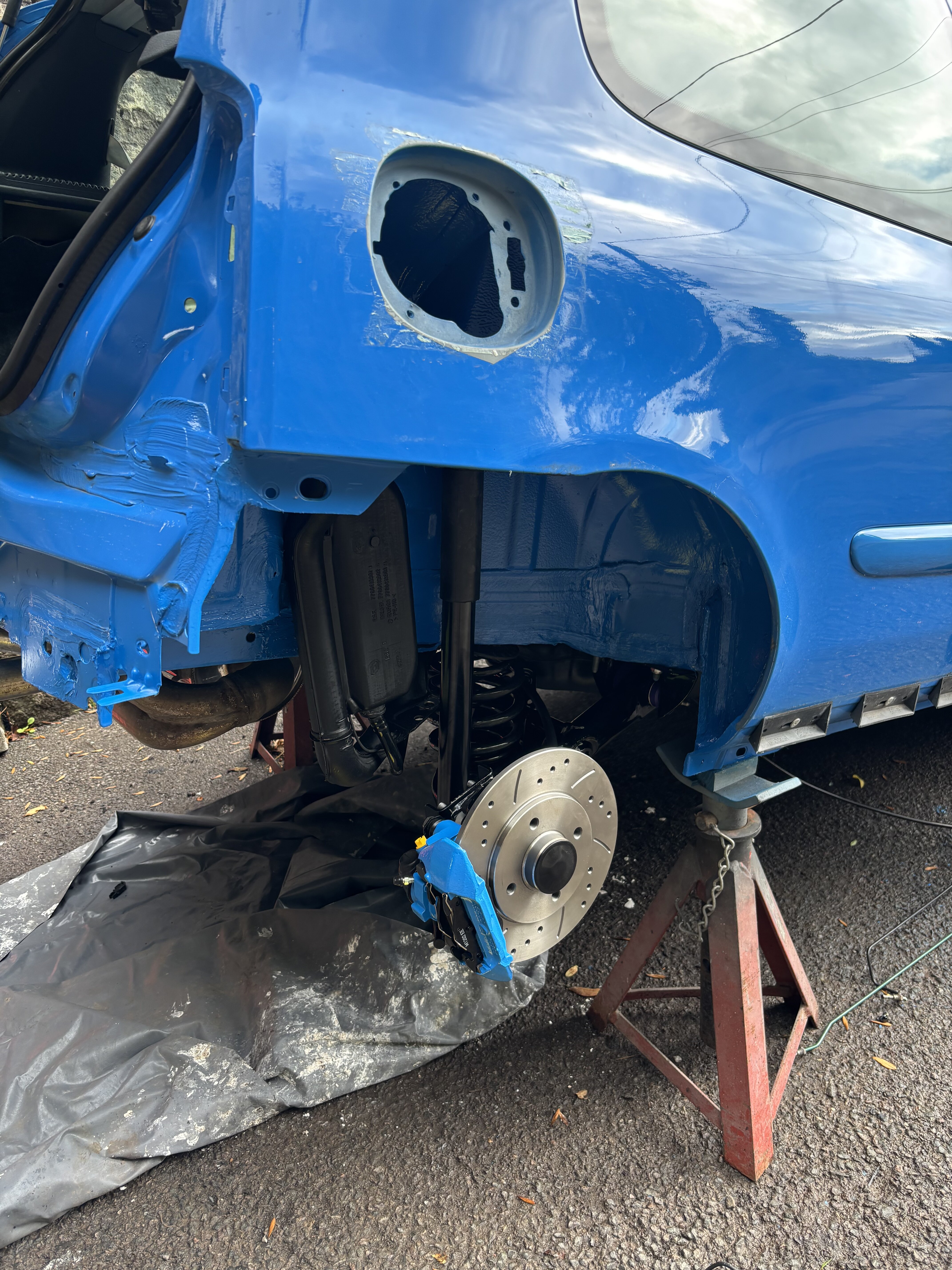

Hello, here’s my clio 182 I brought it of my best mate who’s owned it for 10 years and last 5 years been sat on his drive.

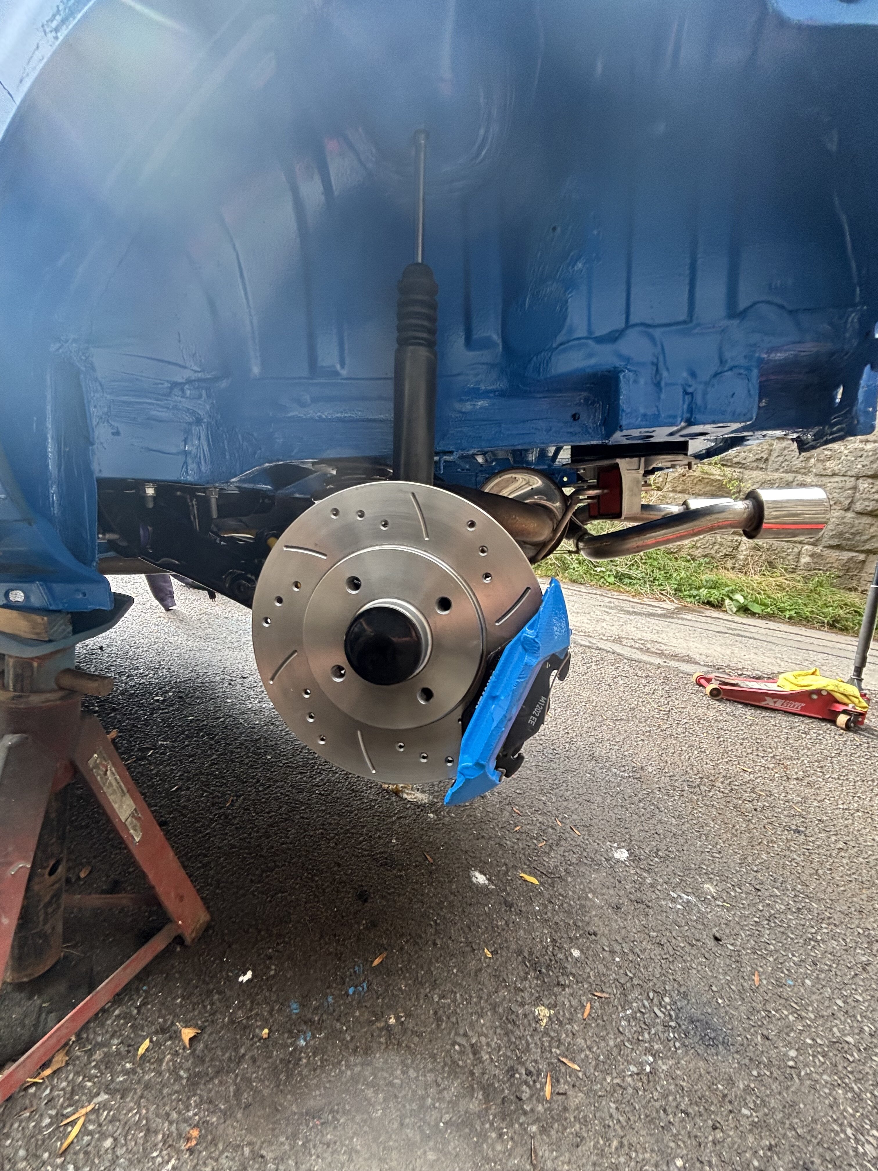

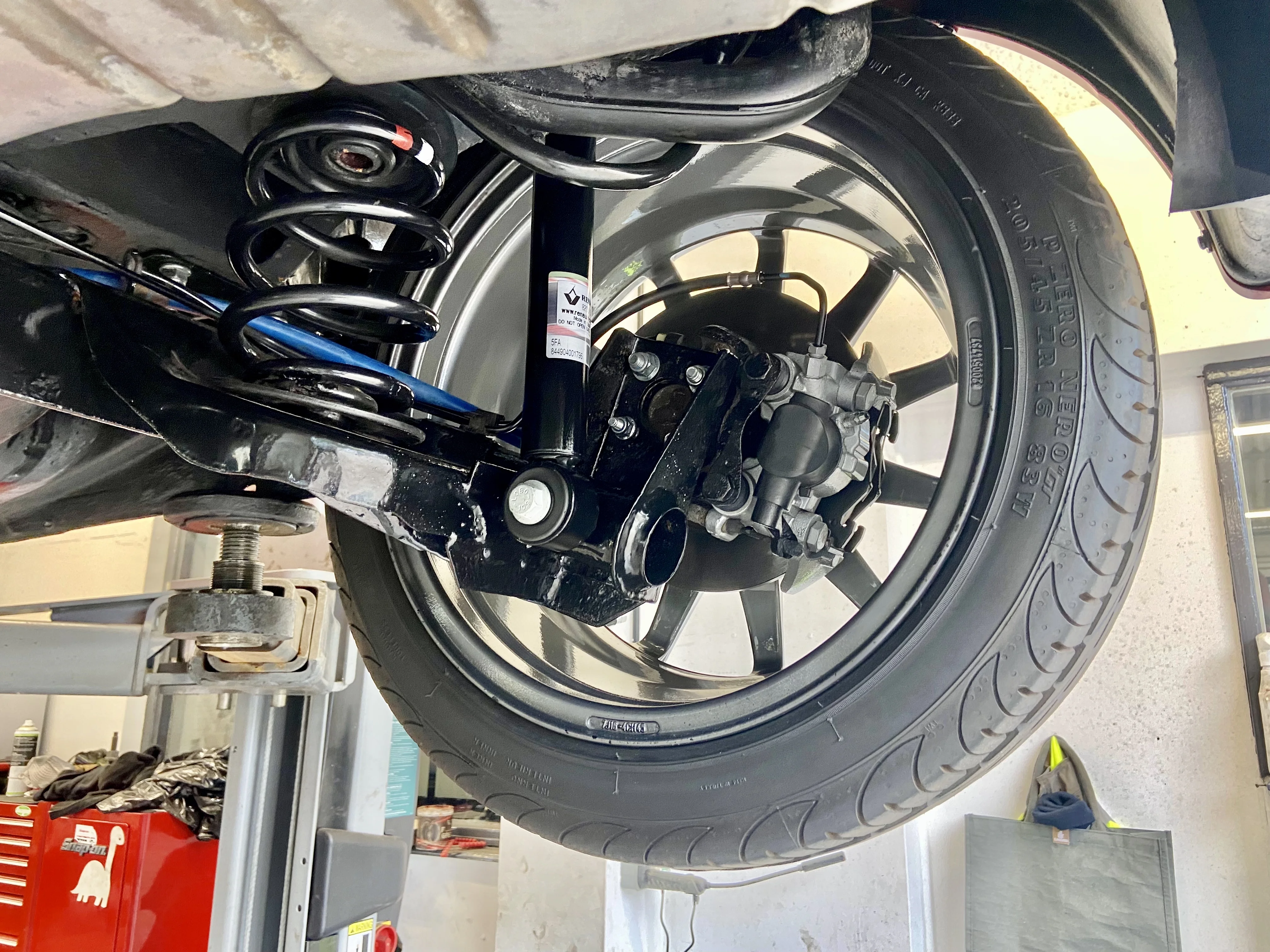

Currently restoring the rear end
Hopefully putting back together on the weekend more to follow
I’ll too look forward to your future posts - it does look great when they are done and well worth the effort 😍😍😍

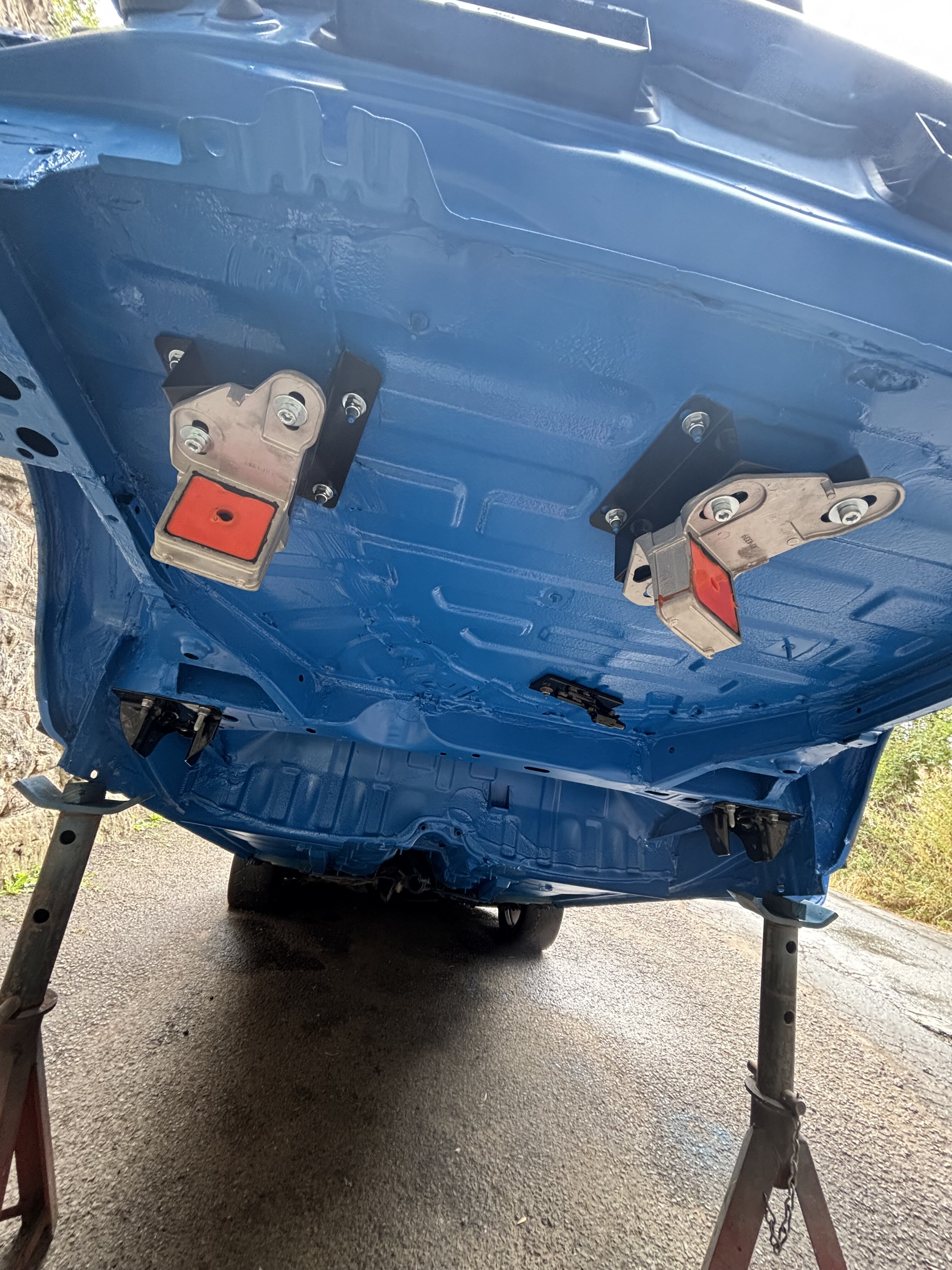

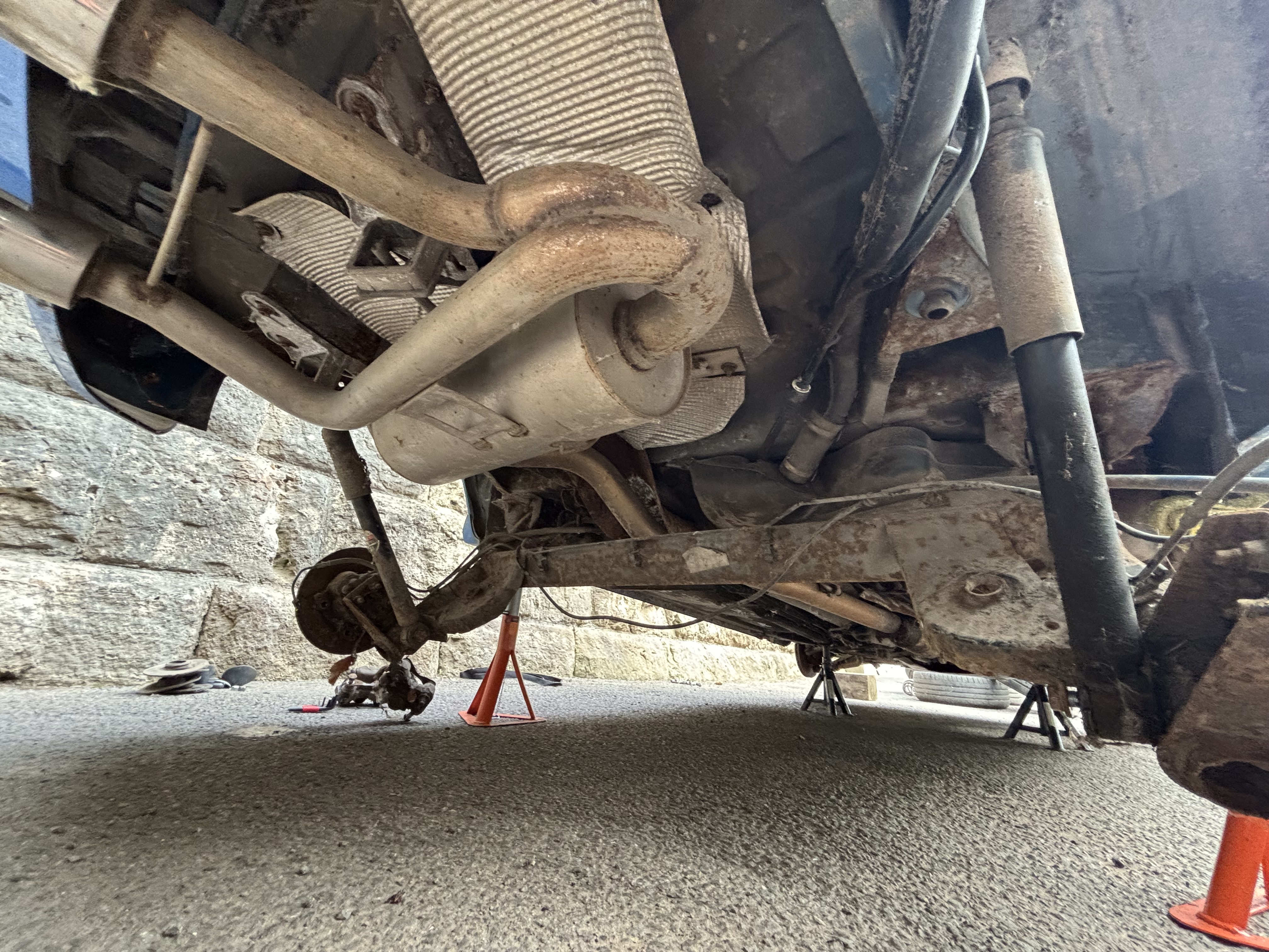

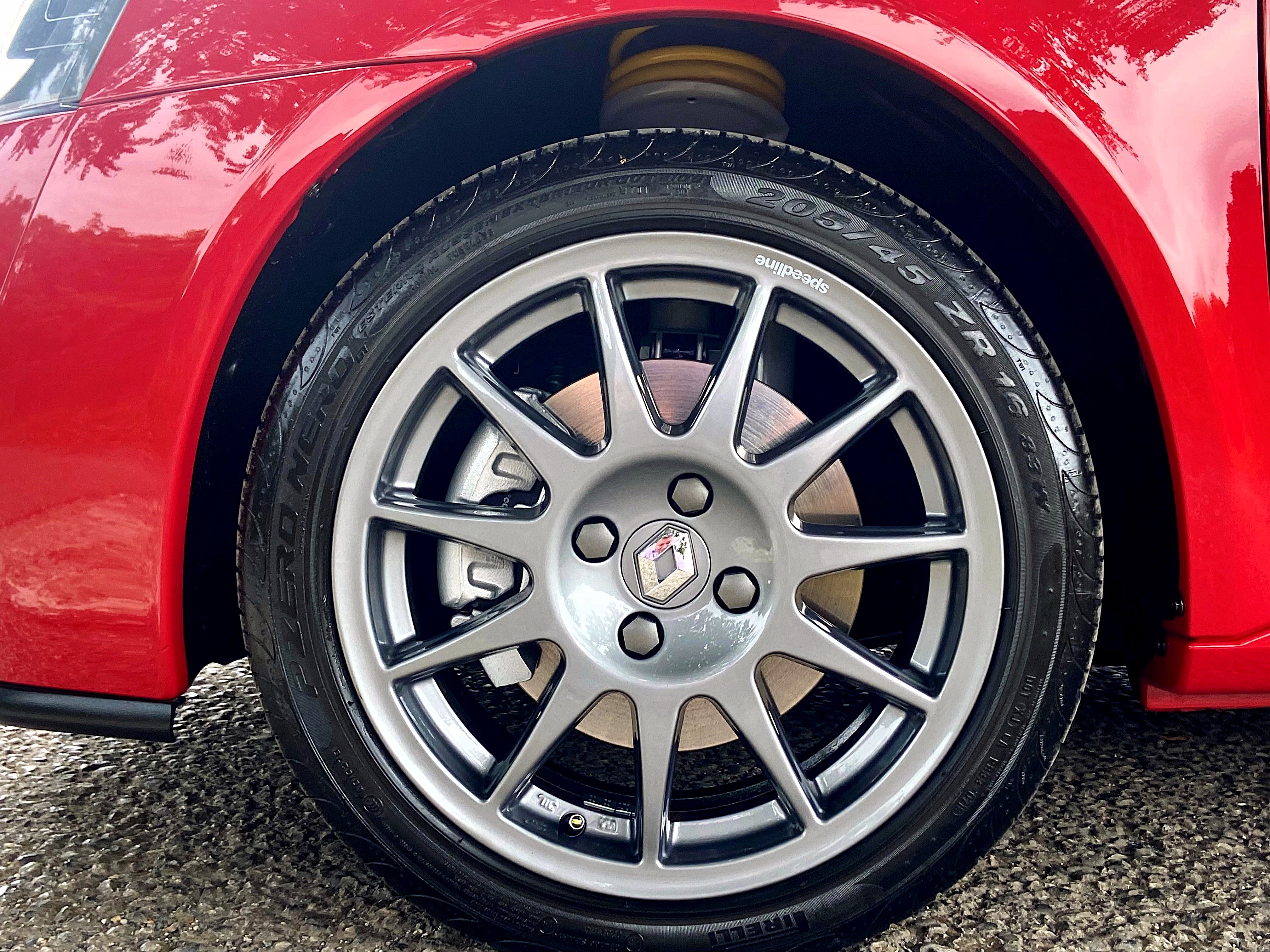

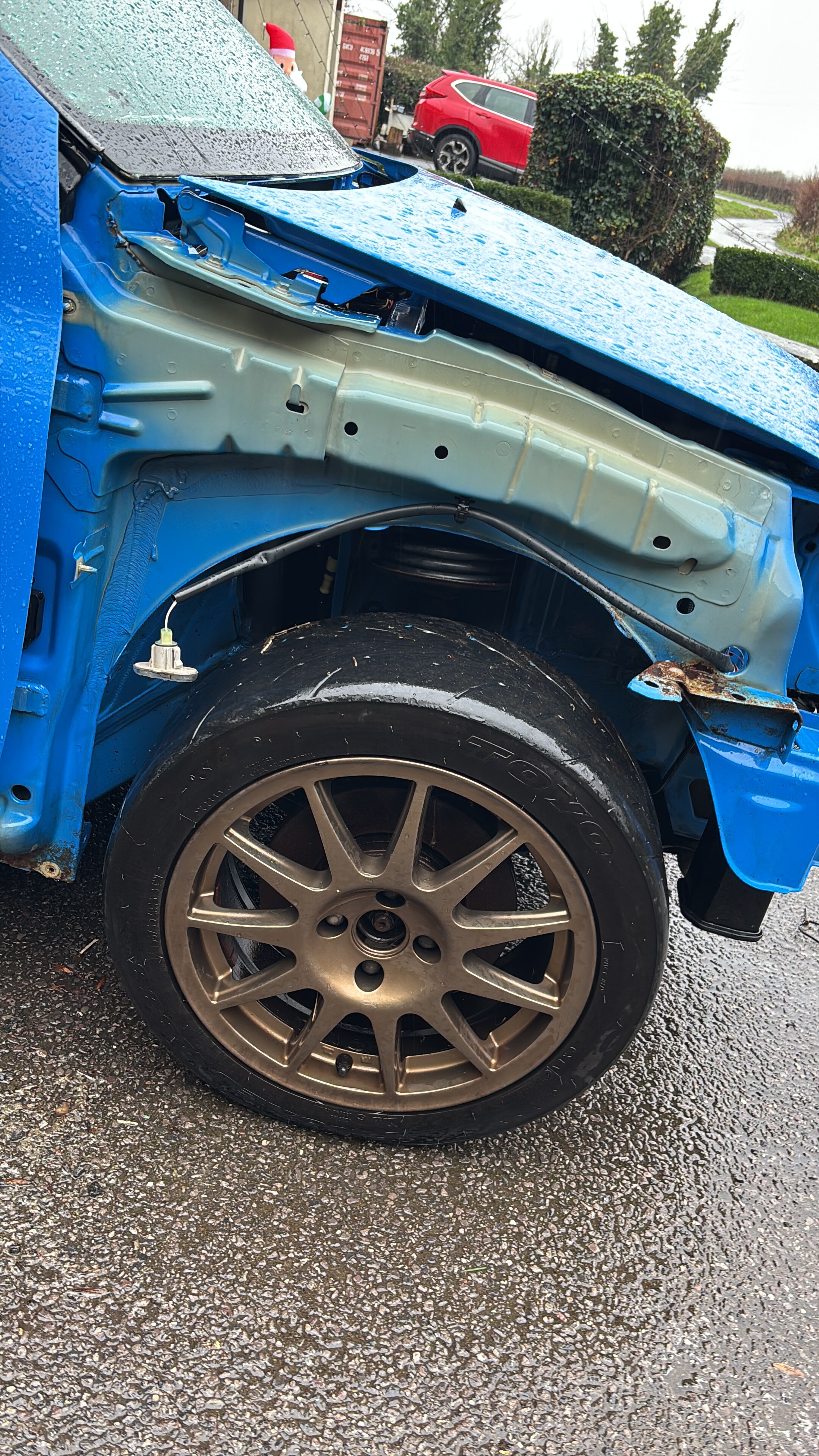

I saw the second pic and thought “he’s not saving this, that’s finished!”
Wow!!! Hat’s off to you mate, that’s amazing.

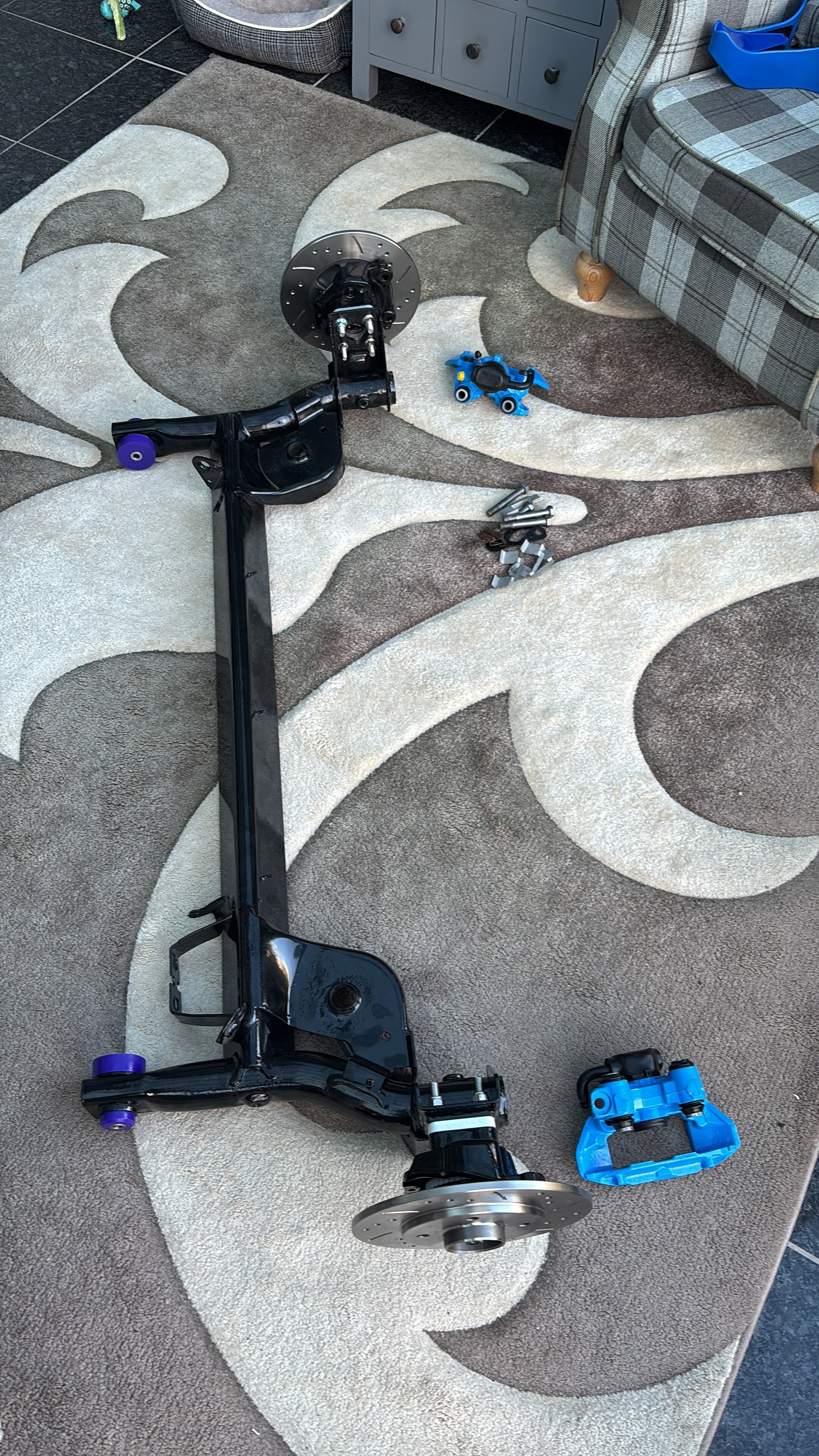

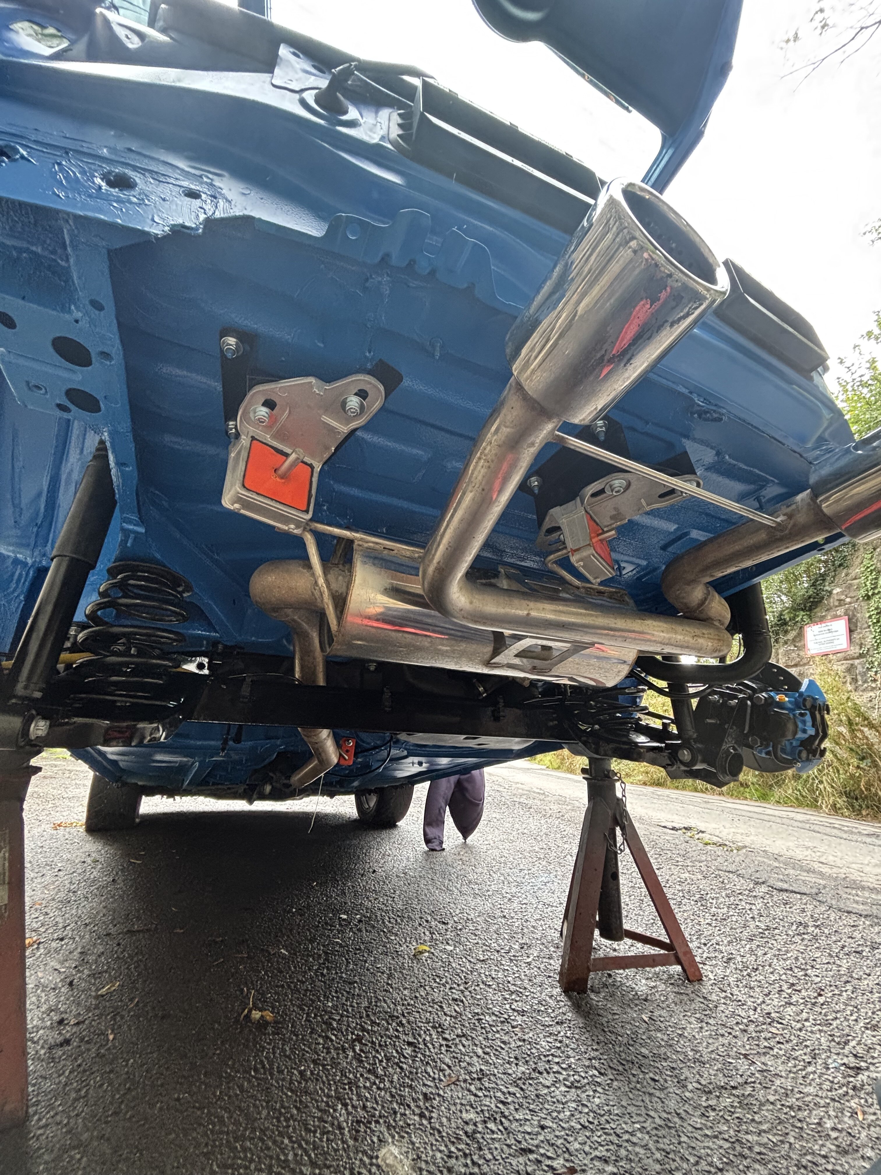

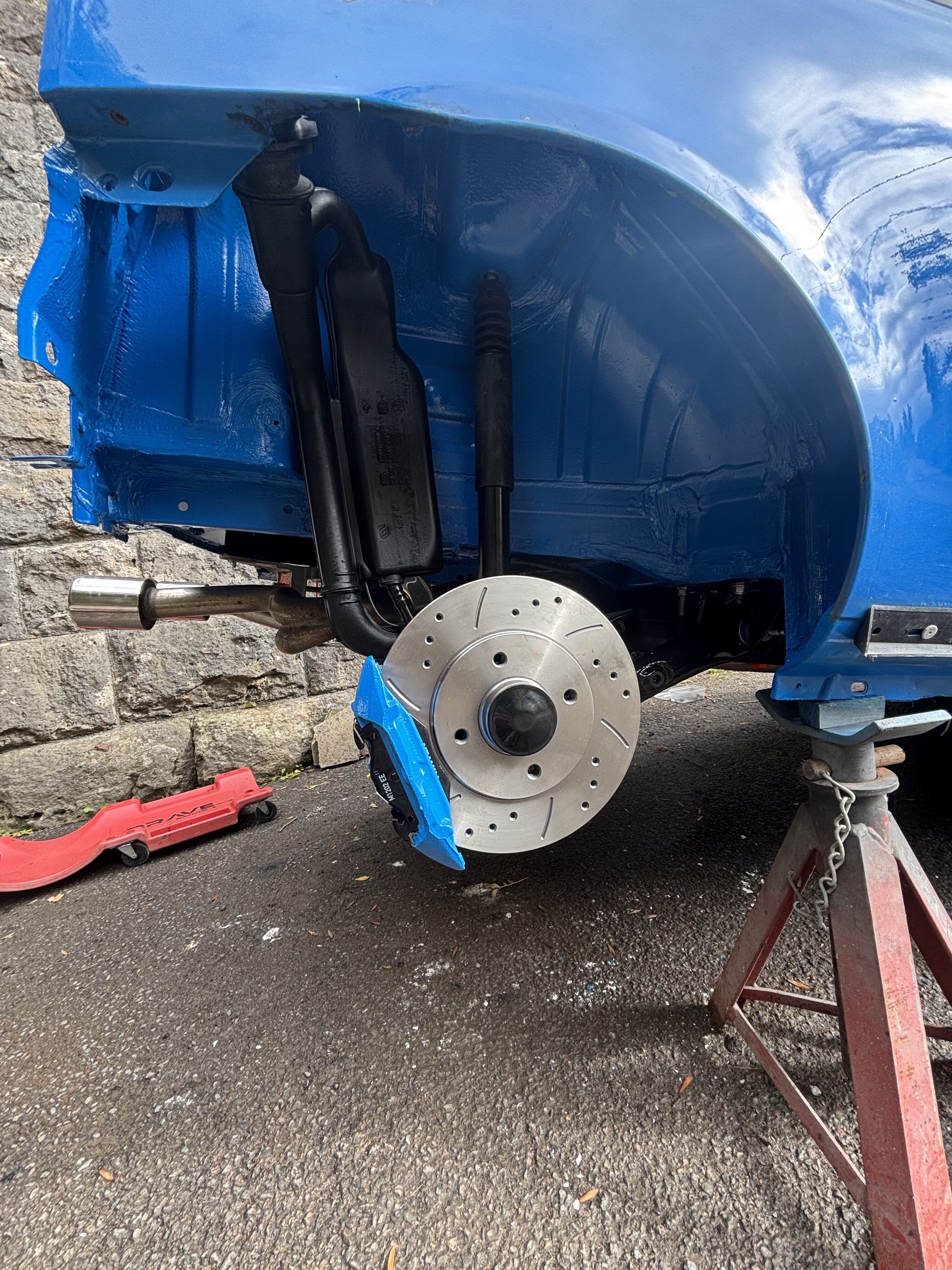

The rear beam does look lovely freshly powdercoated (y)

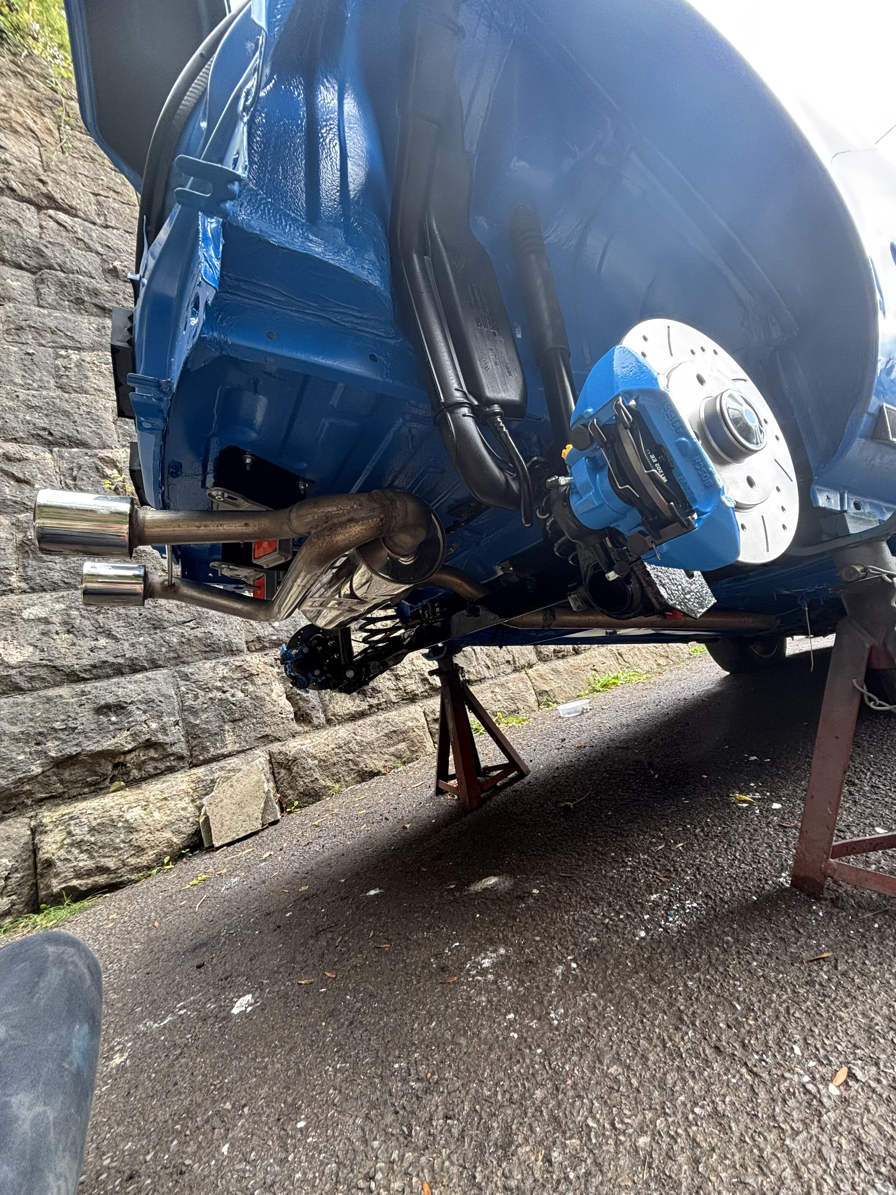

What make are those rear discs?
Rear discs are mintex

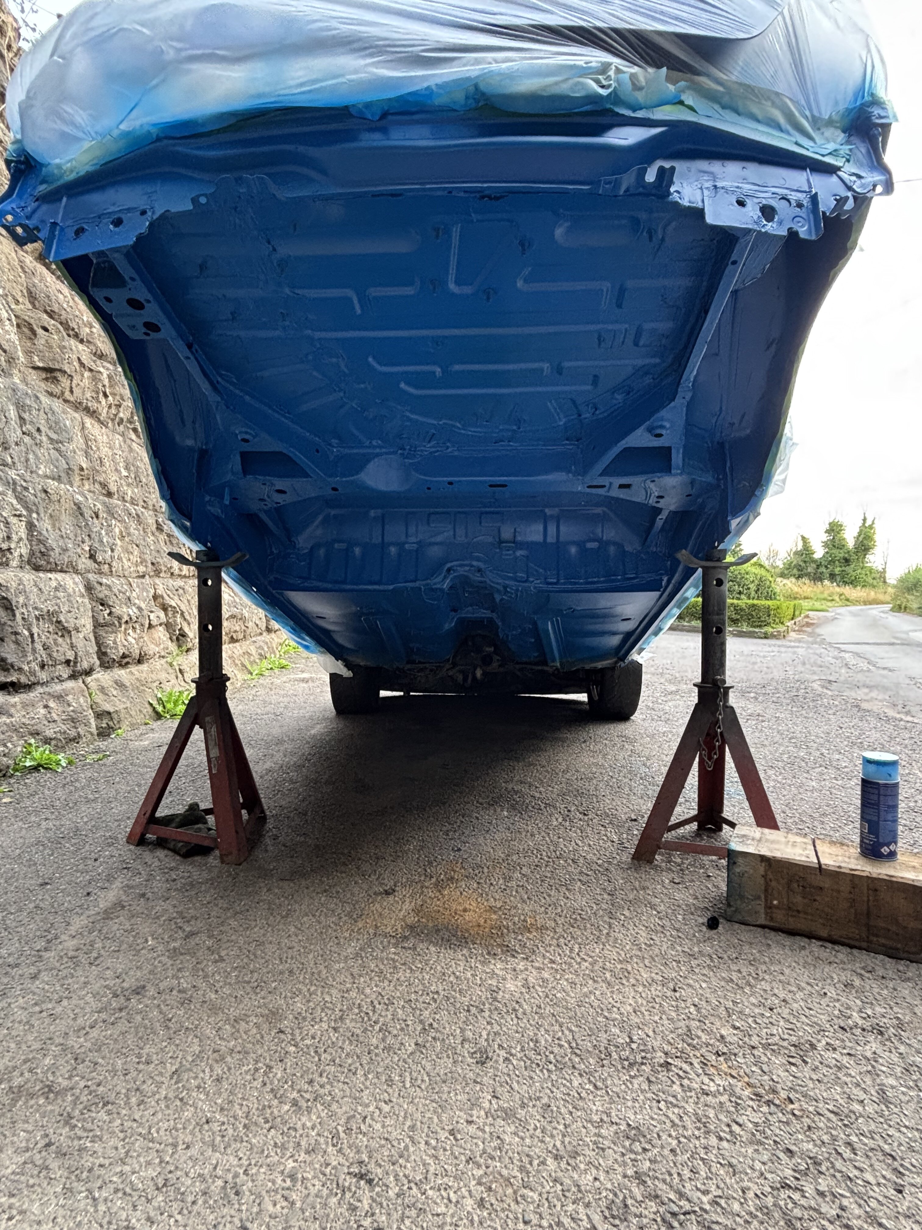

Lovely work, did you bare metal the underside?
Yea the mains bits went back to bare metal rust converter and then buzzweld products
Yea at first I thought that but I was surprised that the chassis was pretty good condition.
Wow. Great work.

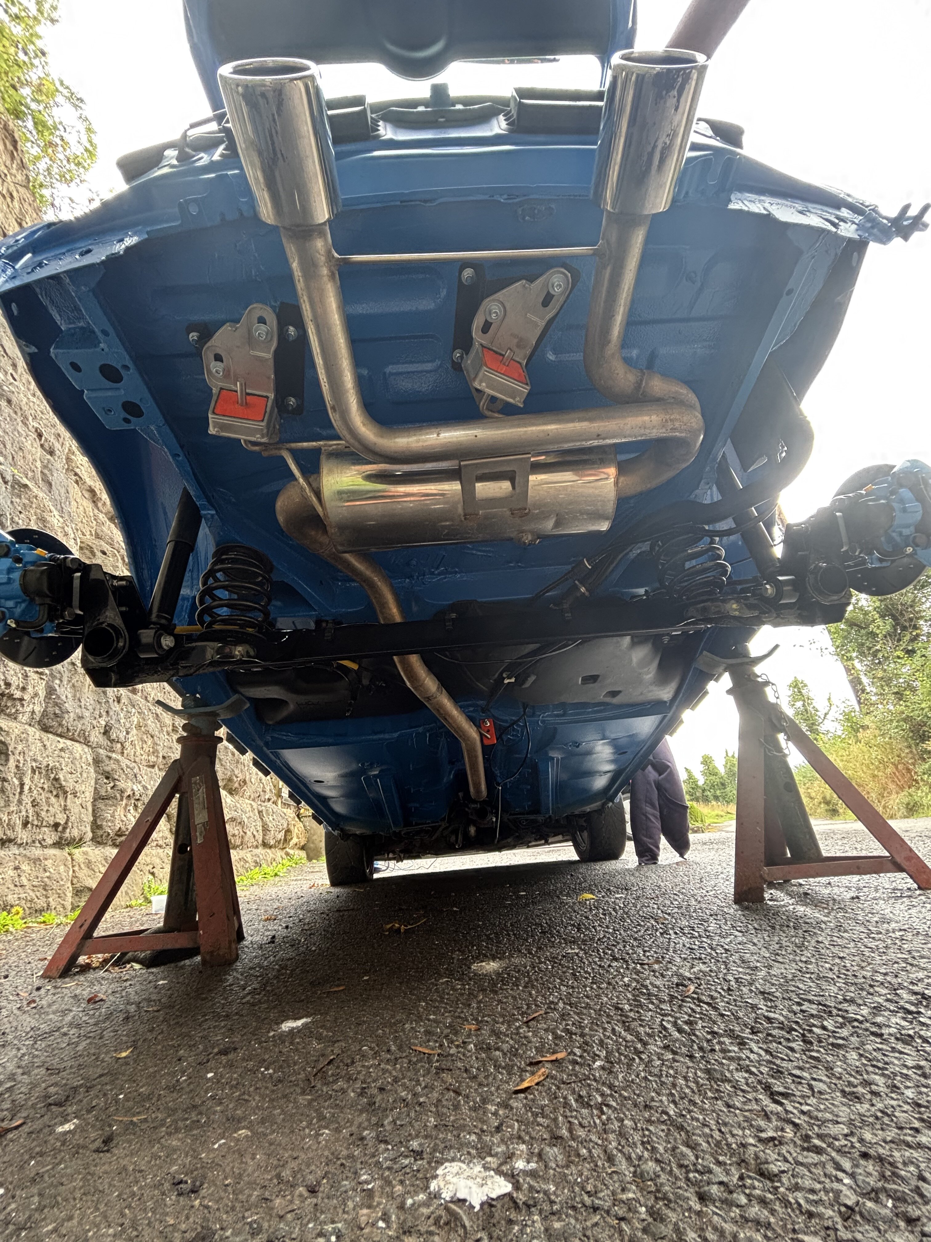

What nuts/bolts did you used to reattached the rear beam brackets to the car? The ones that go through the body.
Looks great and having done it I can confirm it’s a hateful yet rewarding job! It looks sketchy as f**k on those axle stands mind!
I managed to get most of it back together still waiting on some parts to arrive.
Looks dodgy on those stands but was solid

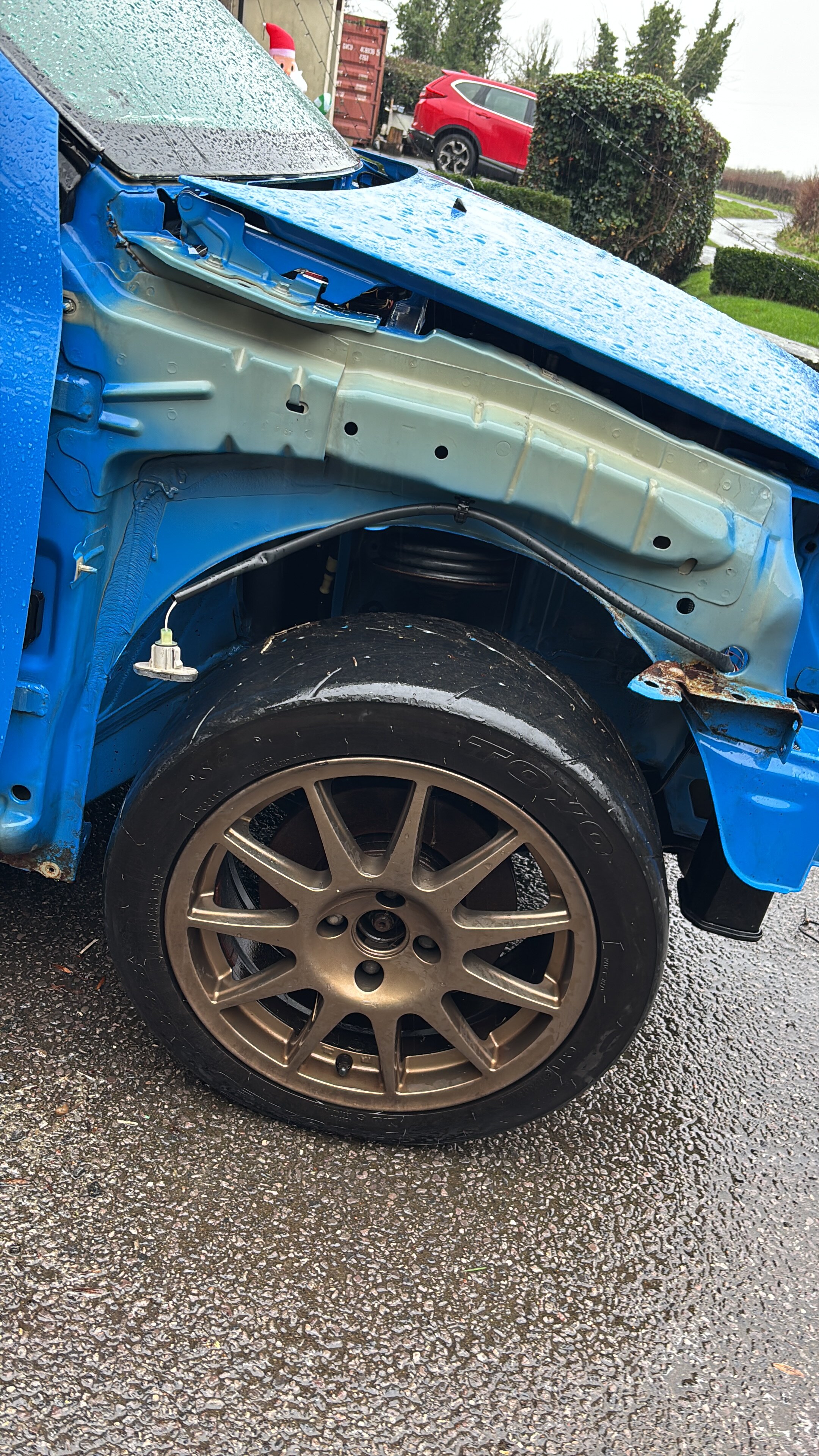

Around the fuel cap will be getting cut out and replaced.

I went a different way with my underneath as we used Gravitex to coat it and then wax oiled in every hole on the hottest day of 2022.
Yea was surprised how hard some parts are to get, feel easier getting parts for my 1995 del Sol.
that doesn’t sound fun, lucky when I was working on it wasn’t that hot, I’m going to put some Bilt hamber dynax UC on top for some extra protection.

This what I spent on most the parts/work

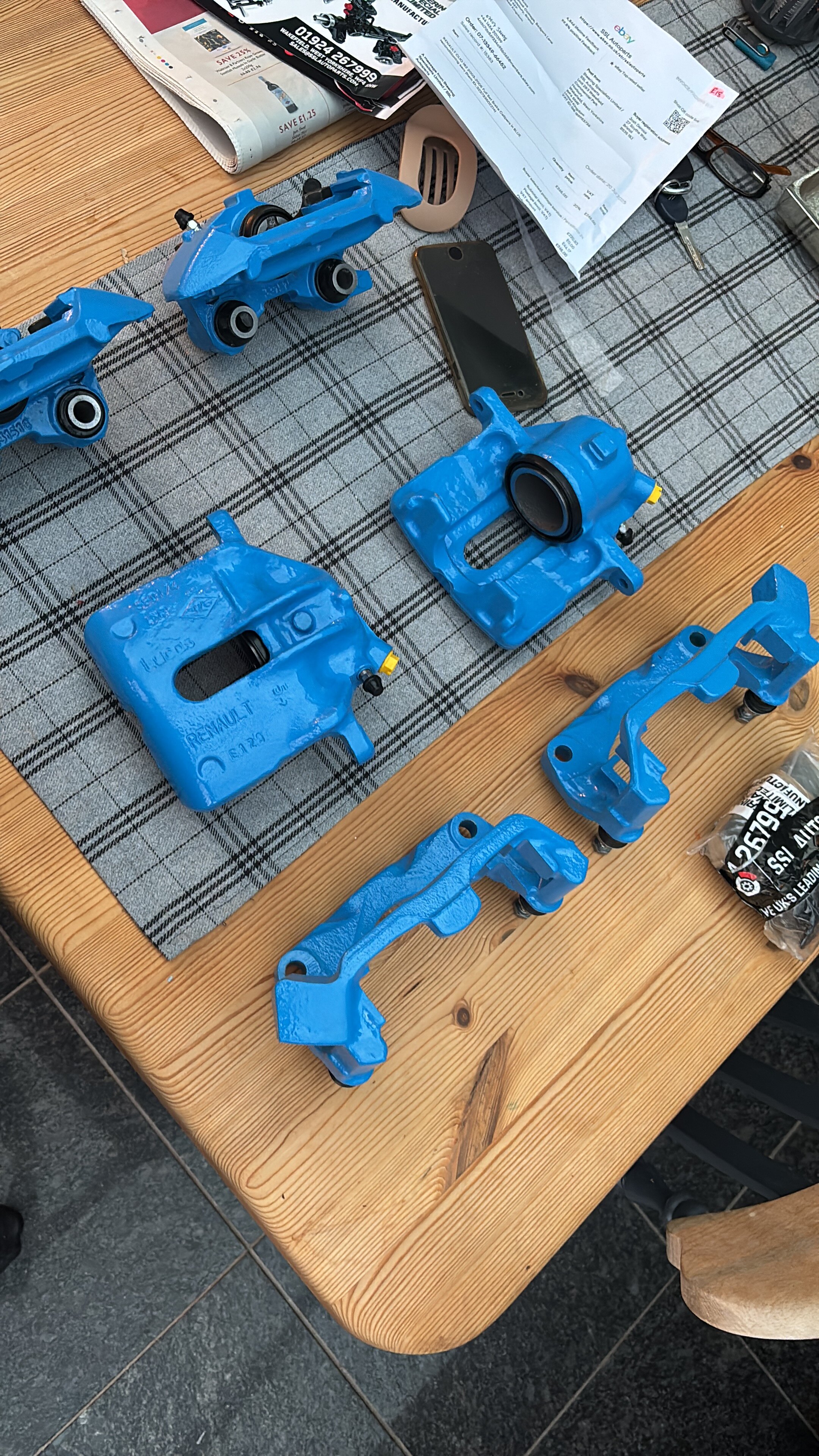

Calliper refurb front and rear £265
Primer £99.21
Rust converter £12
Sealant £28.26
Under-seal £361
Powder coating £200
Bolts £150 rear axel, rear damper, fuel tank and axel to chassis
Stub axel bolts £38.67
Axel bushes power flex £115
After Market Handbrake cable left right £45
Abs sensor £39
Discs pads £130
Exhaust hangers £79.95
Exhaust hanger mounts £65
BRT rear braided hose £75
Rear exhaust bush £14

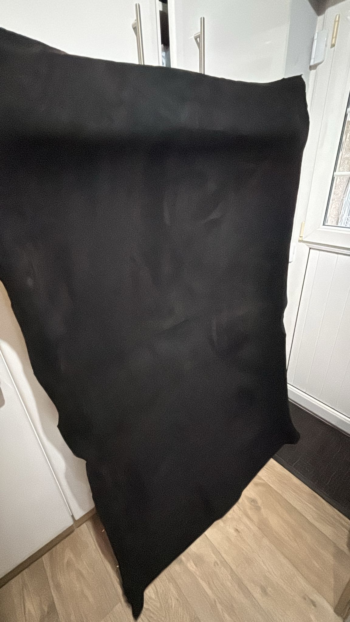

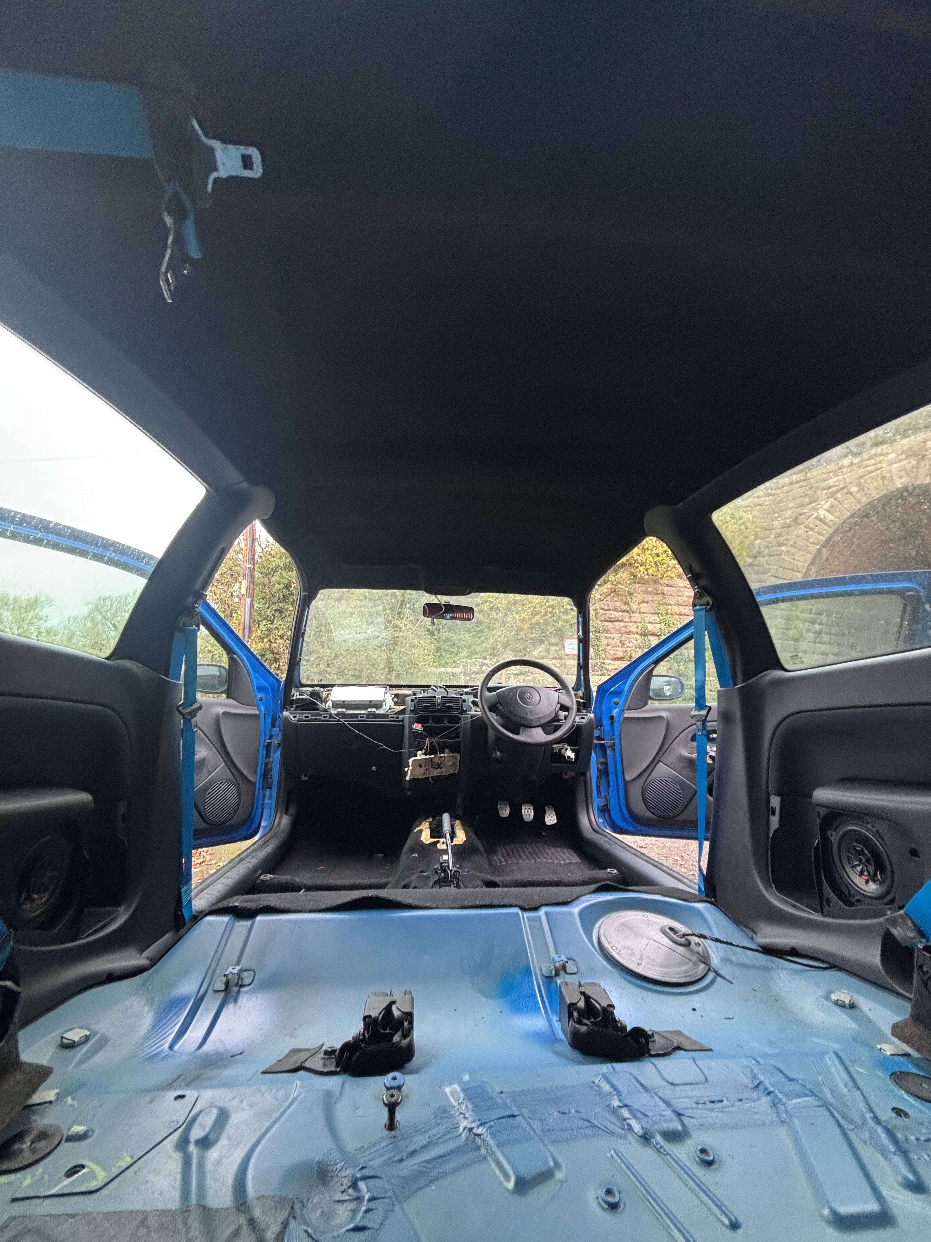

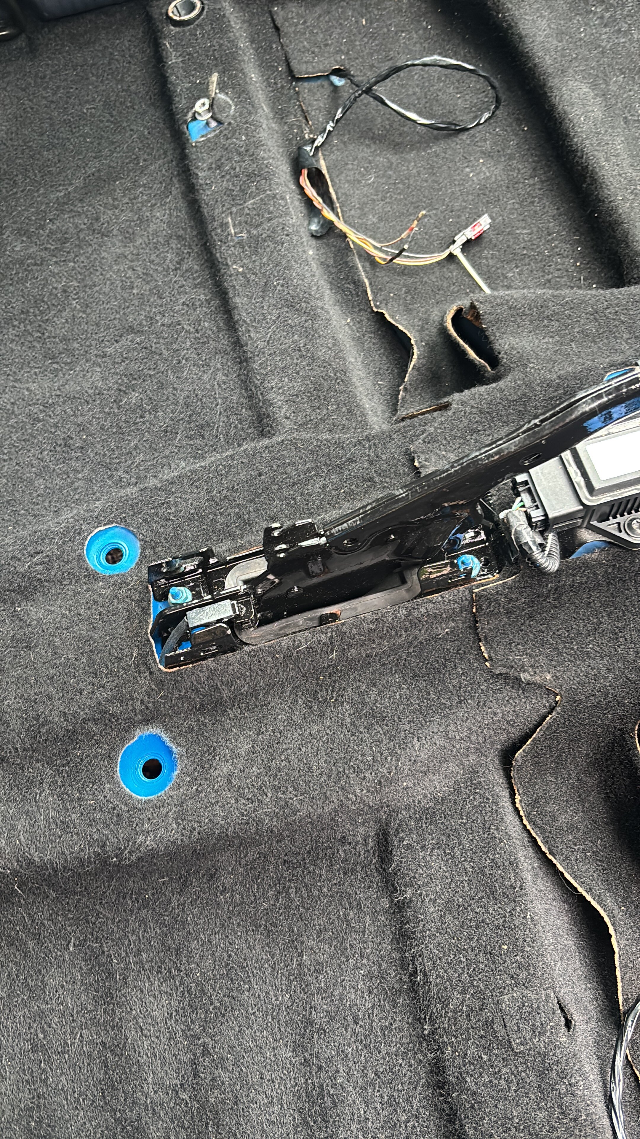

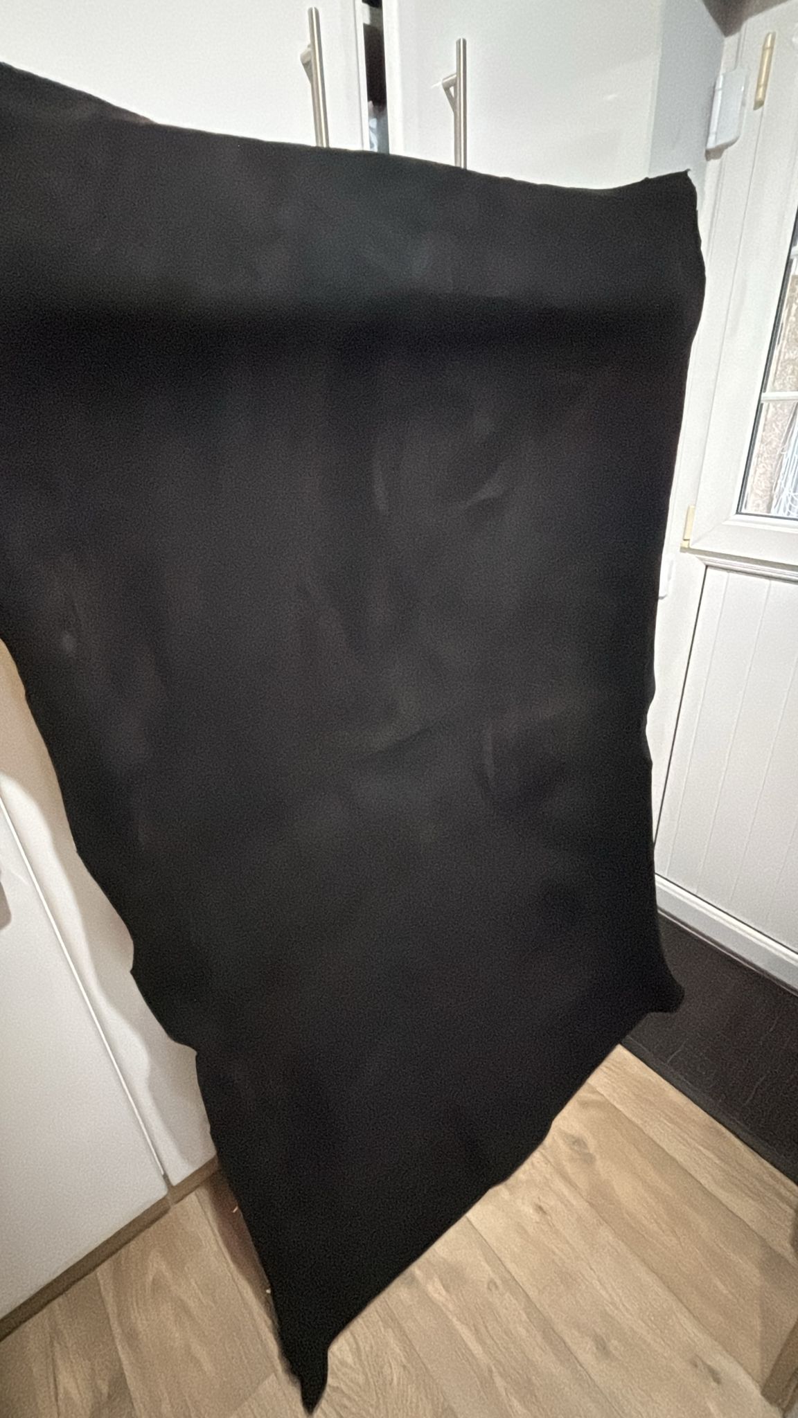

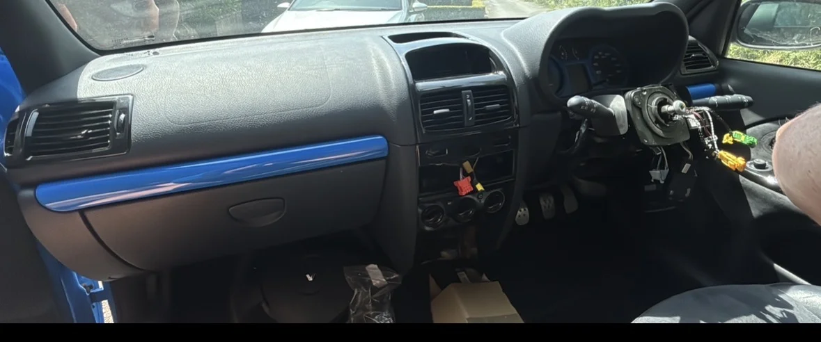

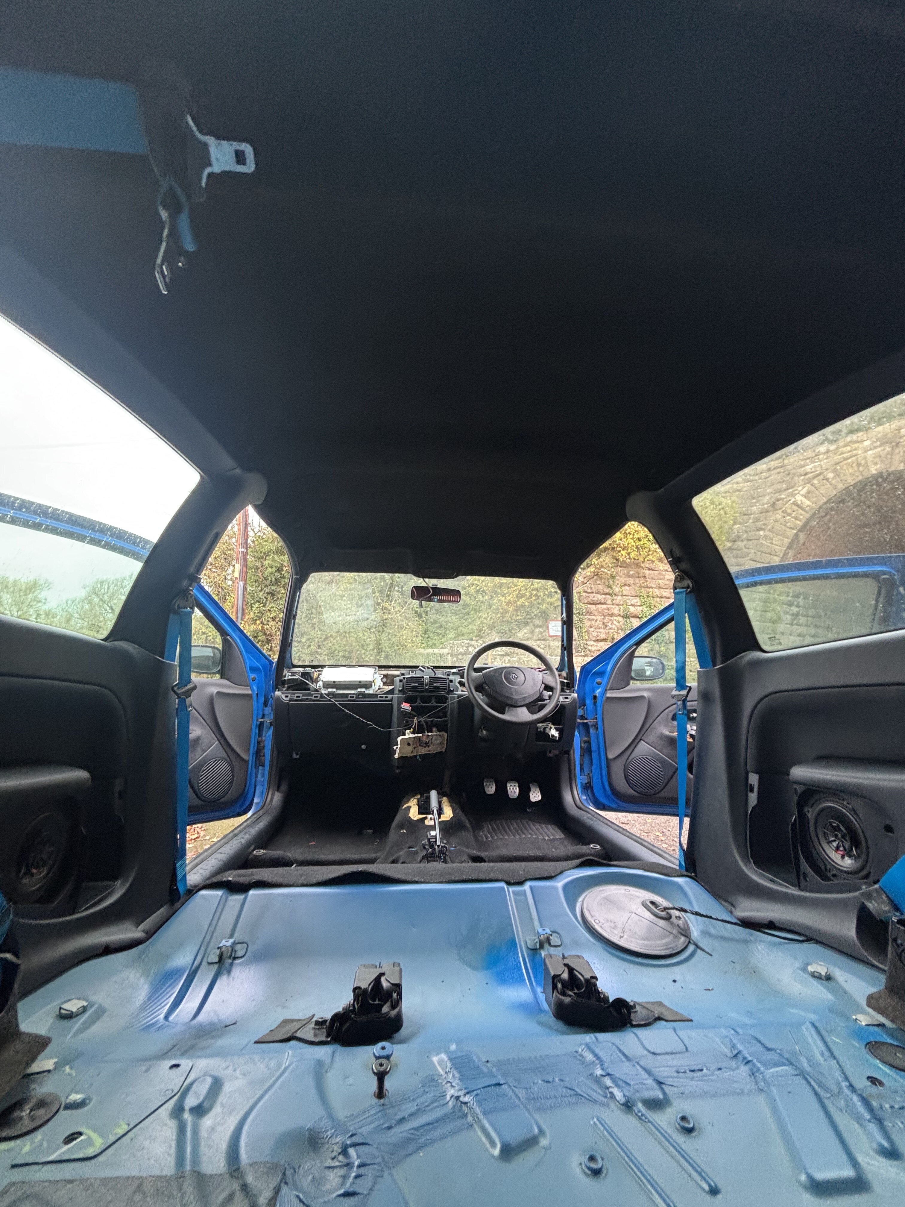

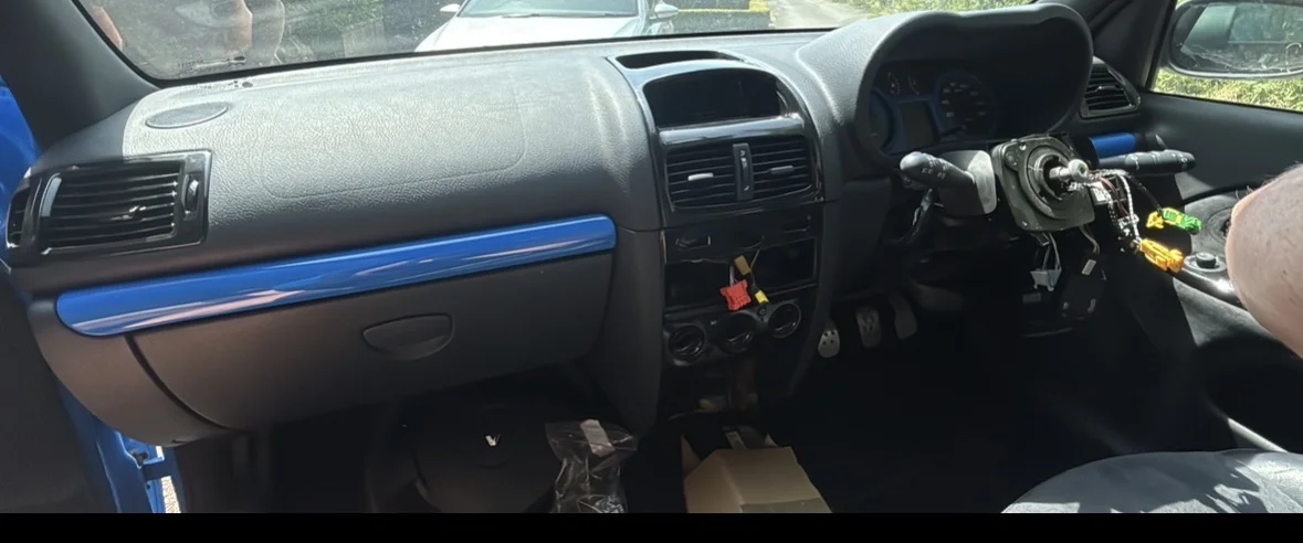

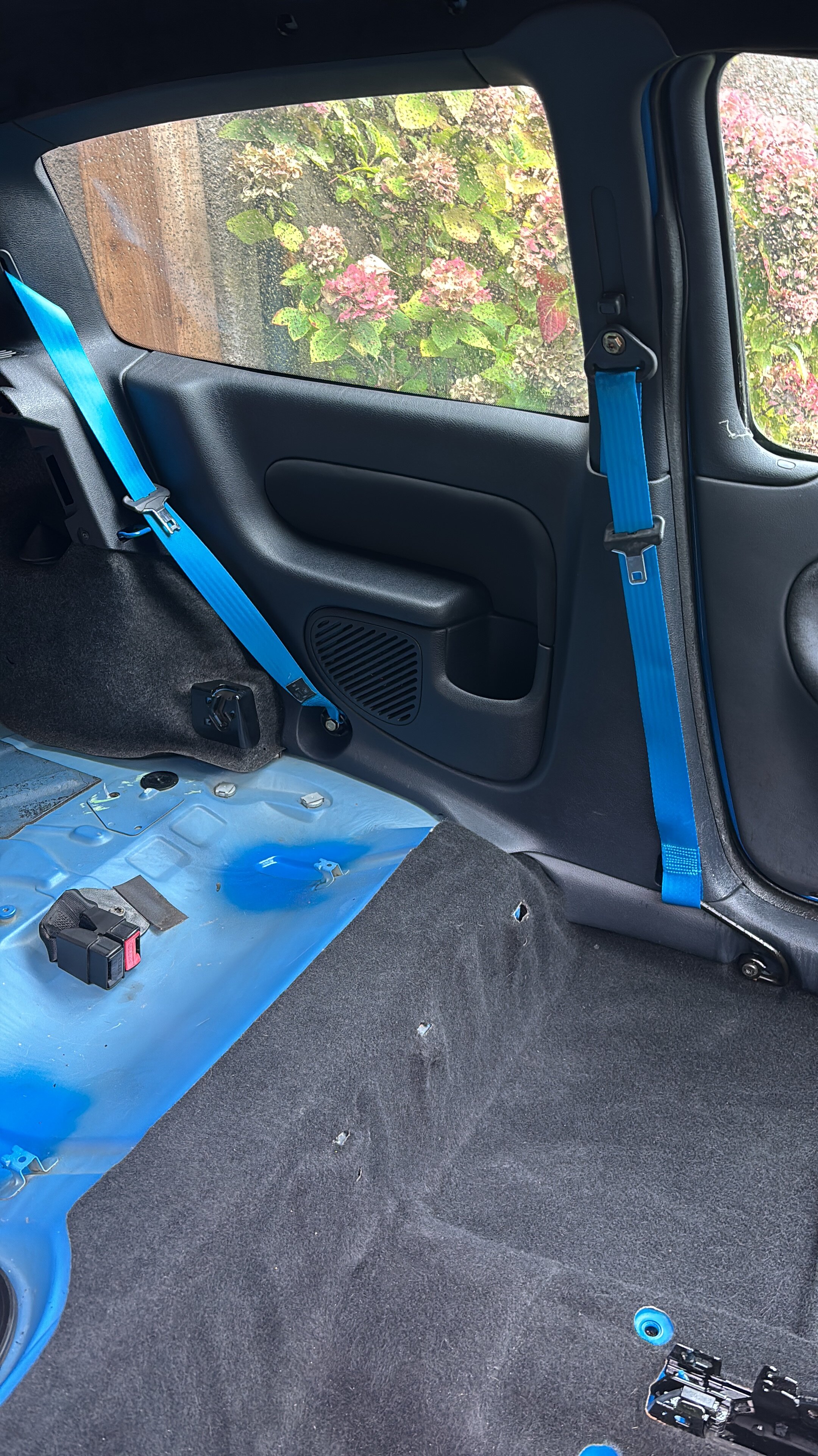

haven’t done much lately put new head liner in and new seat belts, got steering wheel on the way. Just waiting for the interior parts to come back from paint.

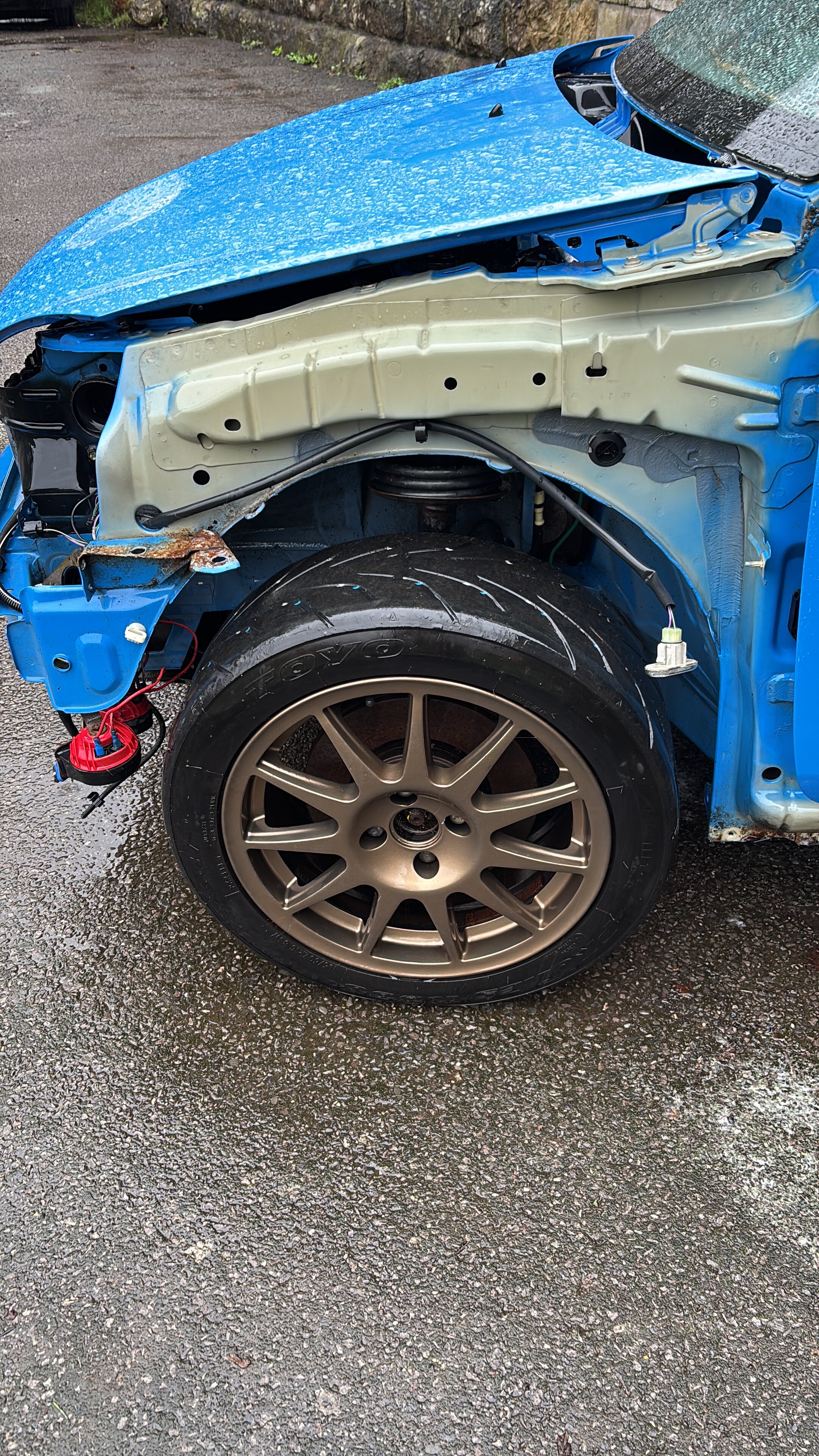

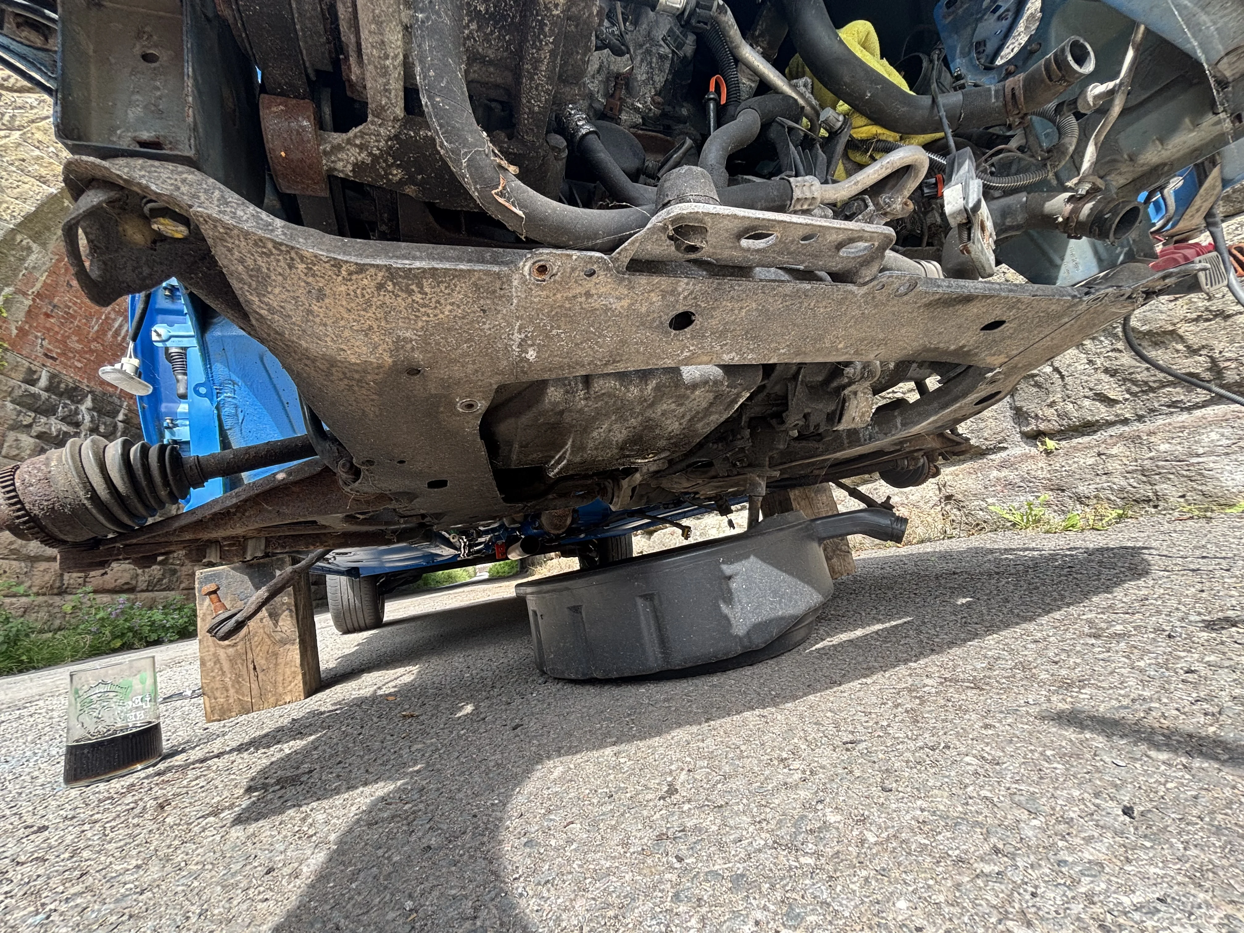

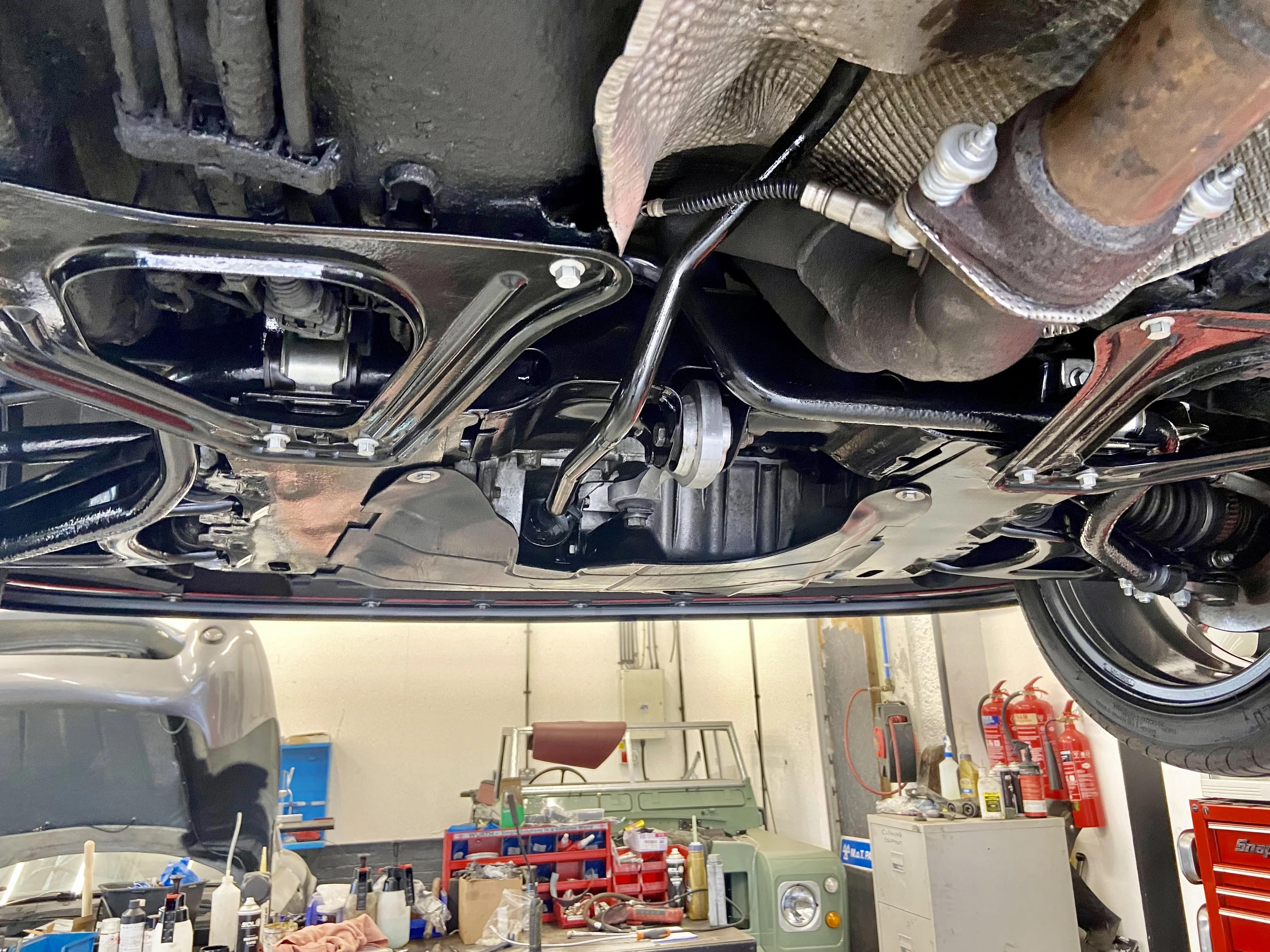

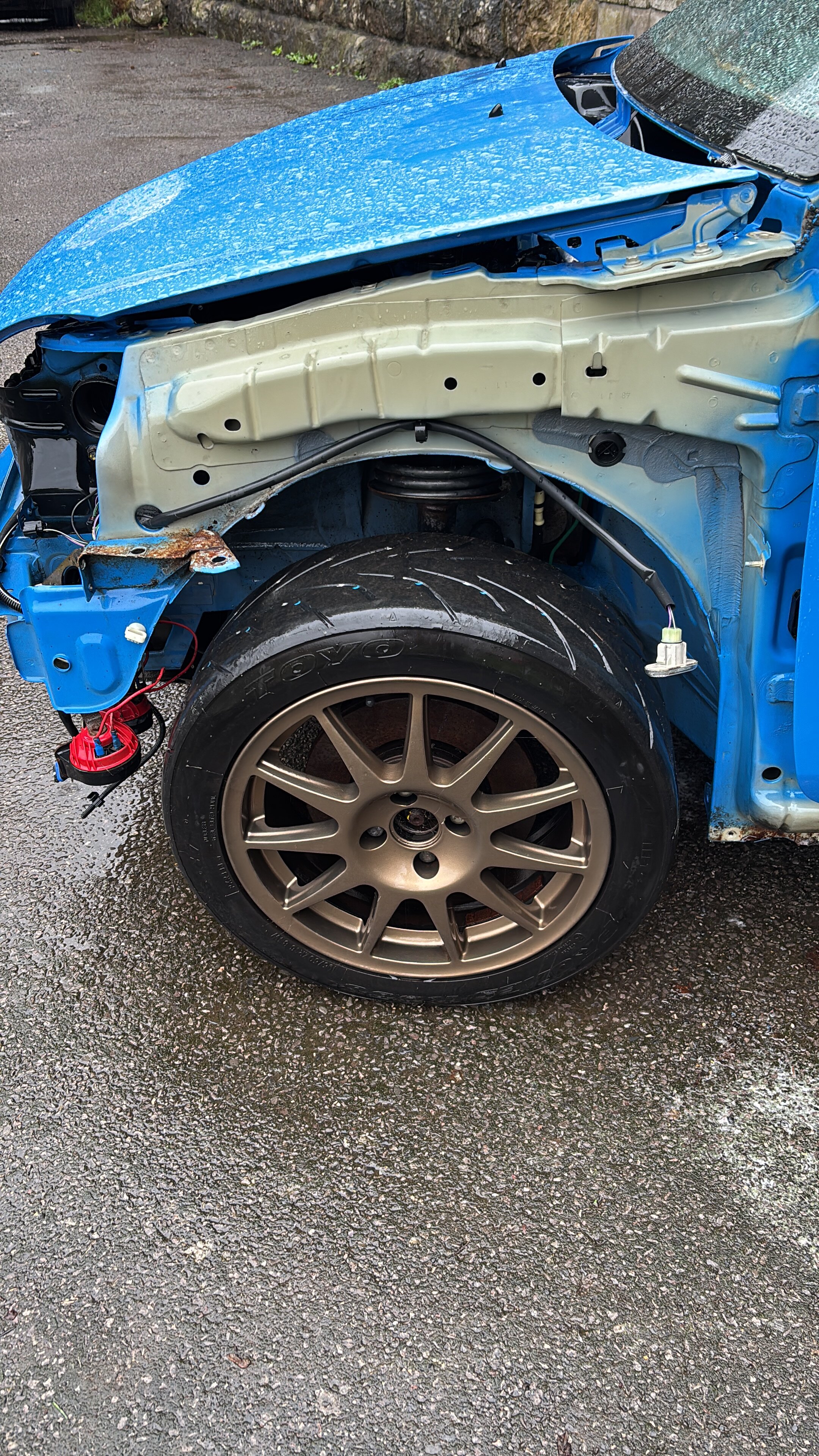

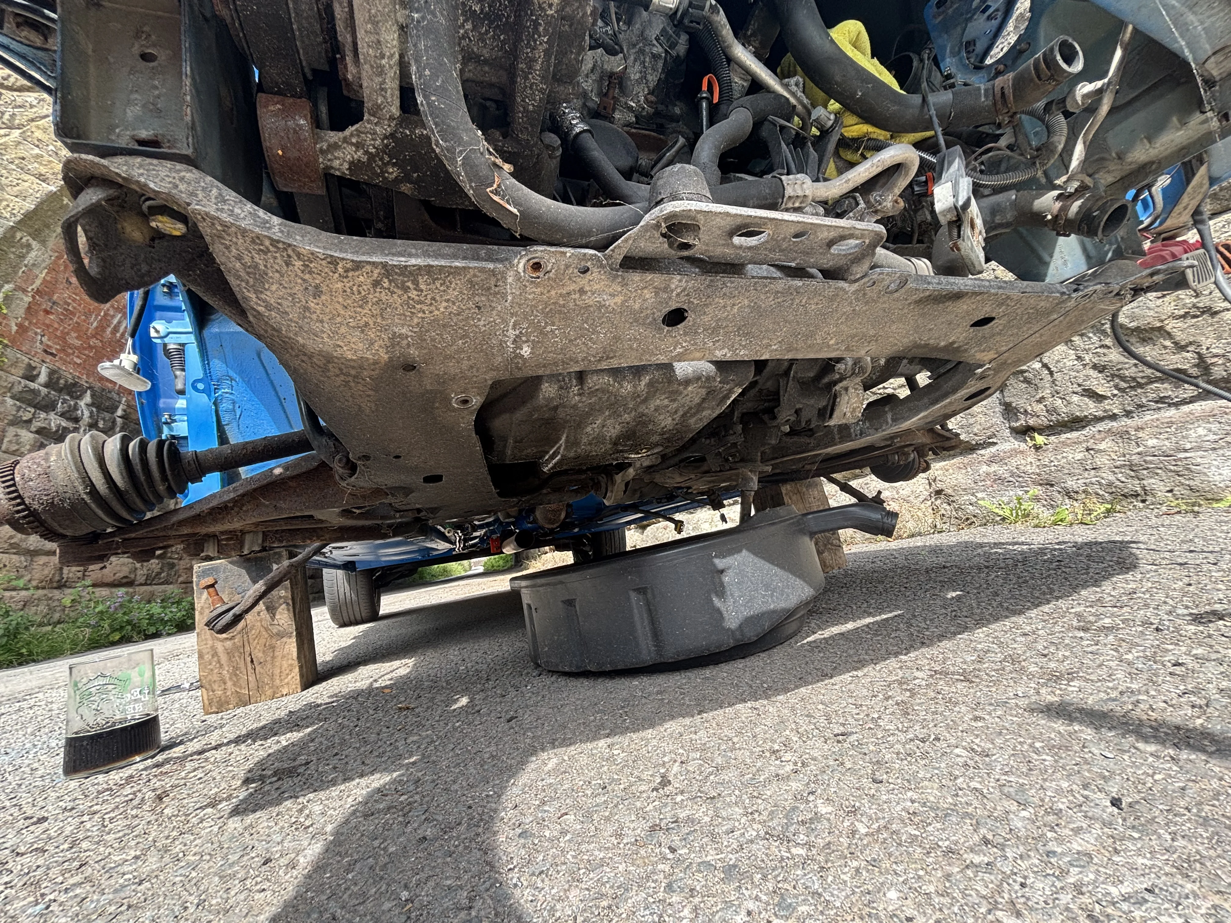

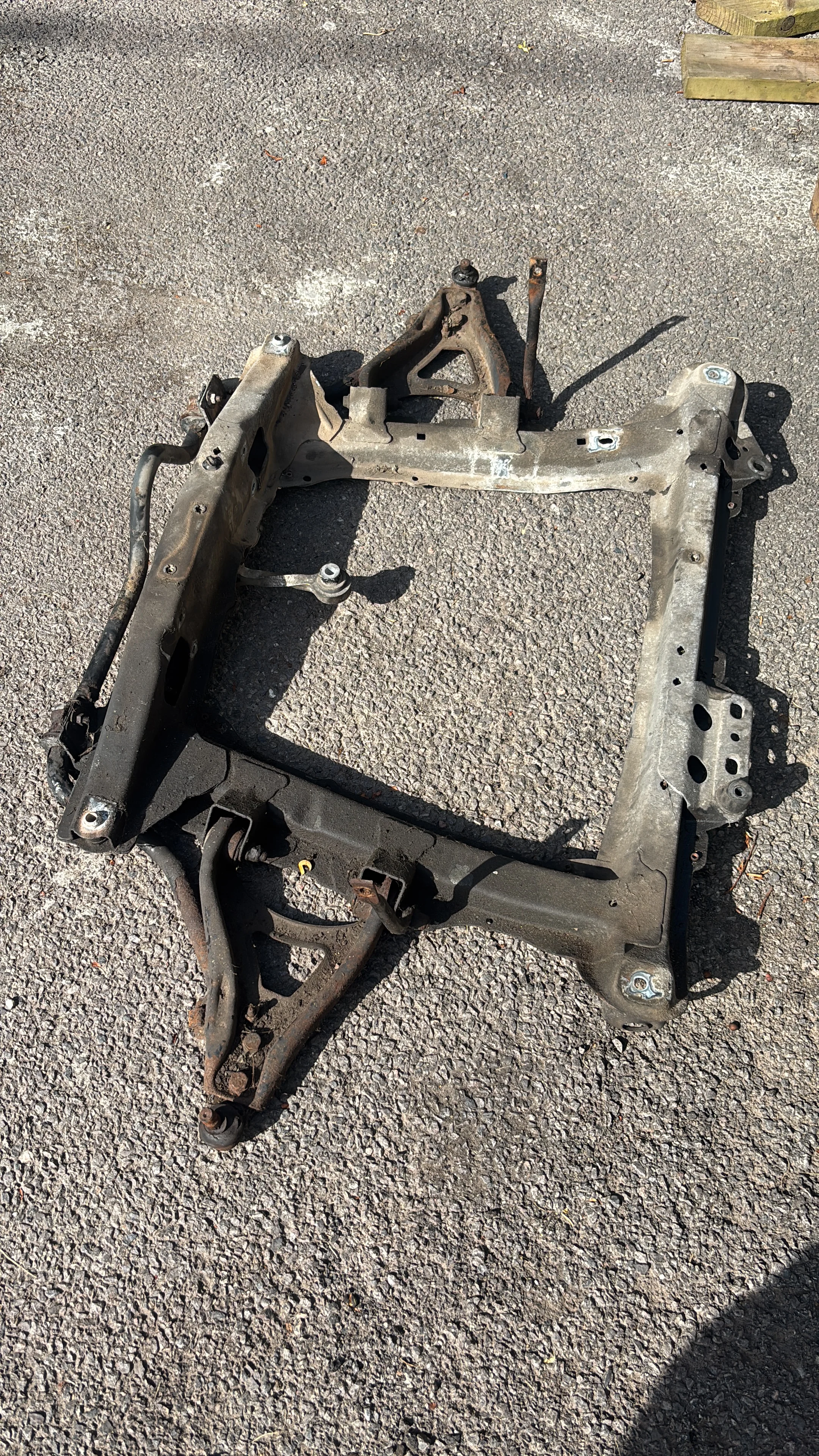

Going to start on front end next, taking the engine out might send off to engine dynamics to be rebuilt will change engine mounts, updated rad etc but anyone recommend me doing anything else that’s a must?

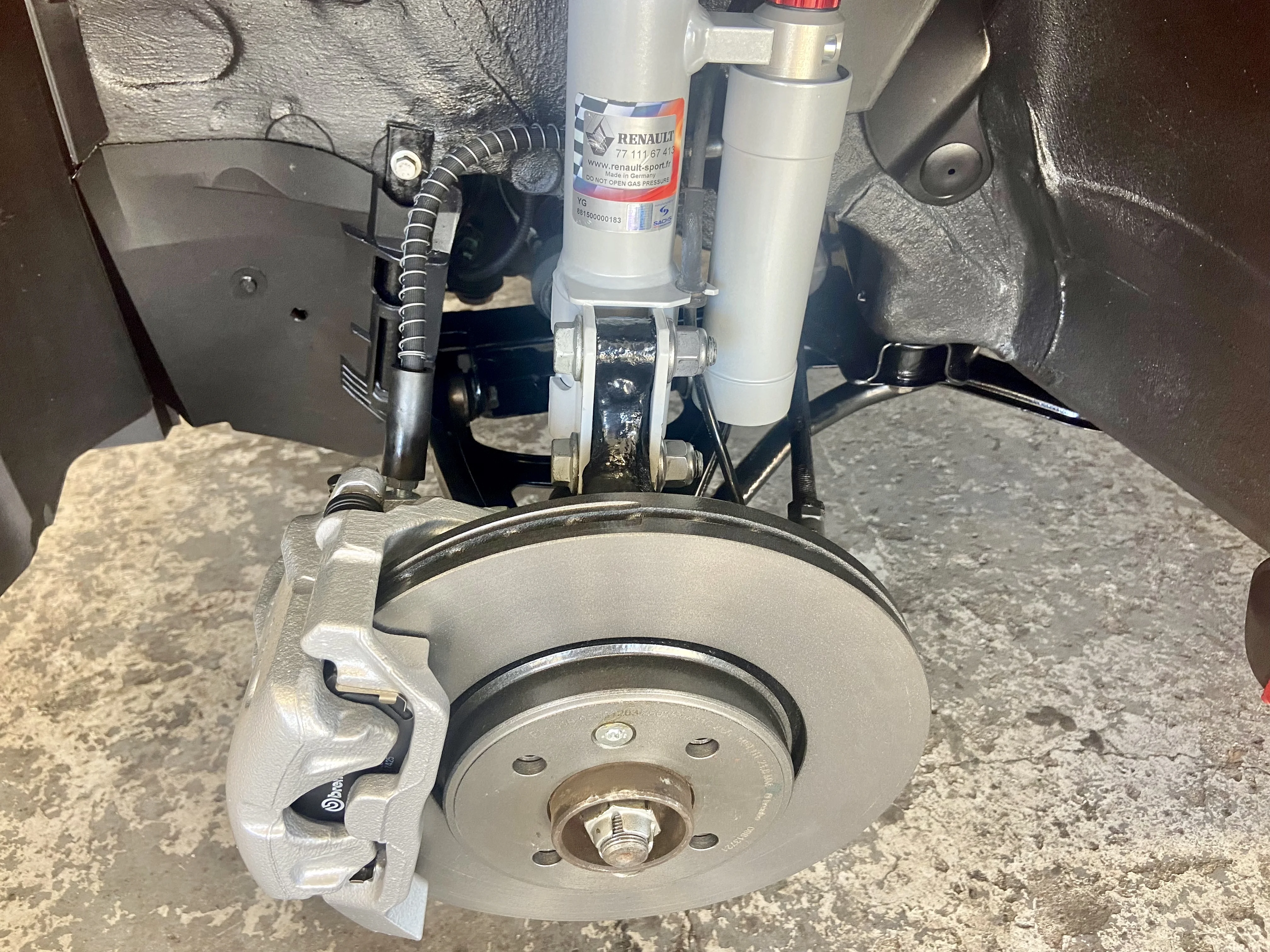

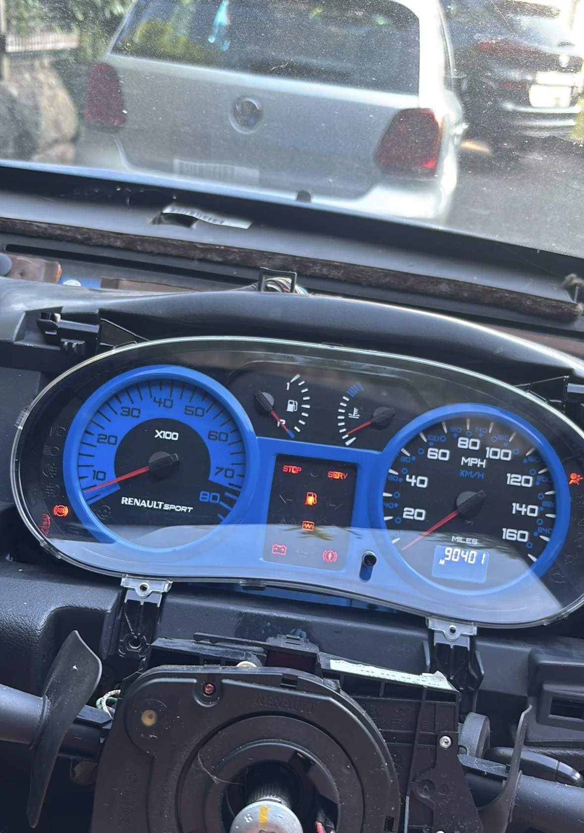

update
Interior nearly pretty much done, Been waiting for my steering wheel/boss to arrive that I brought back in November from K-tec 🙄

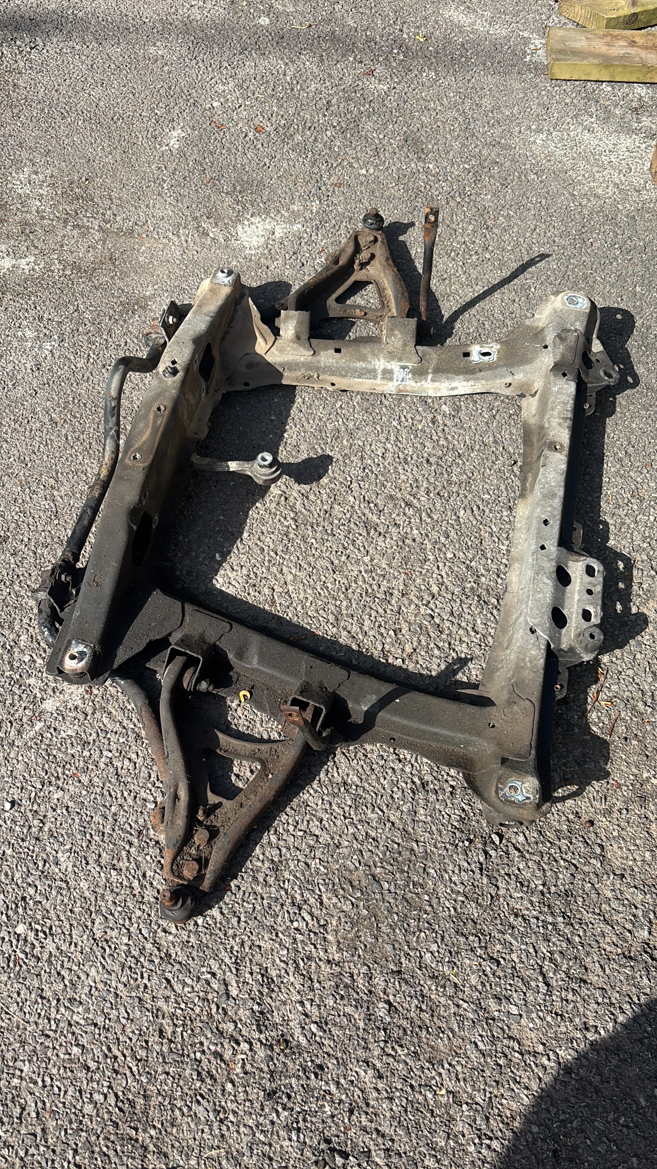

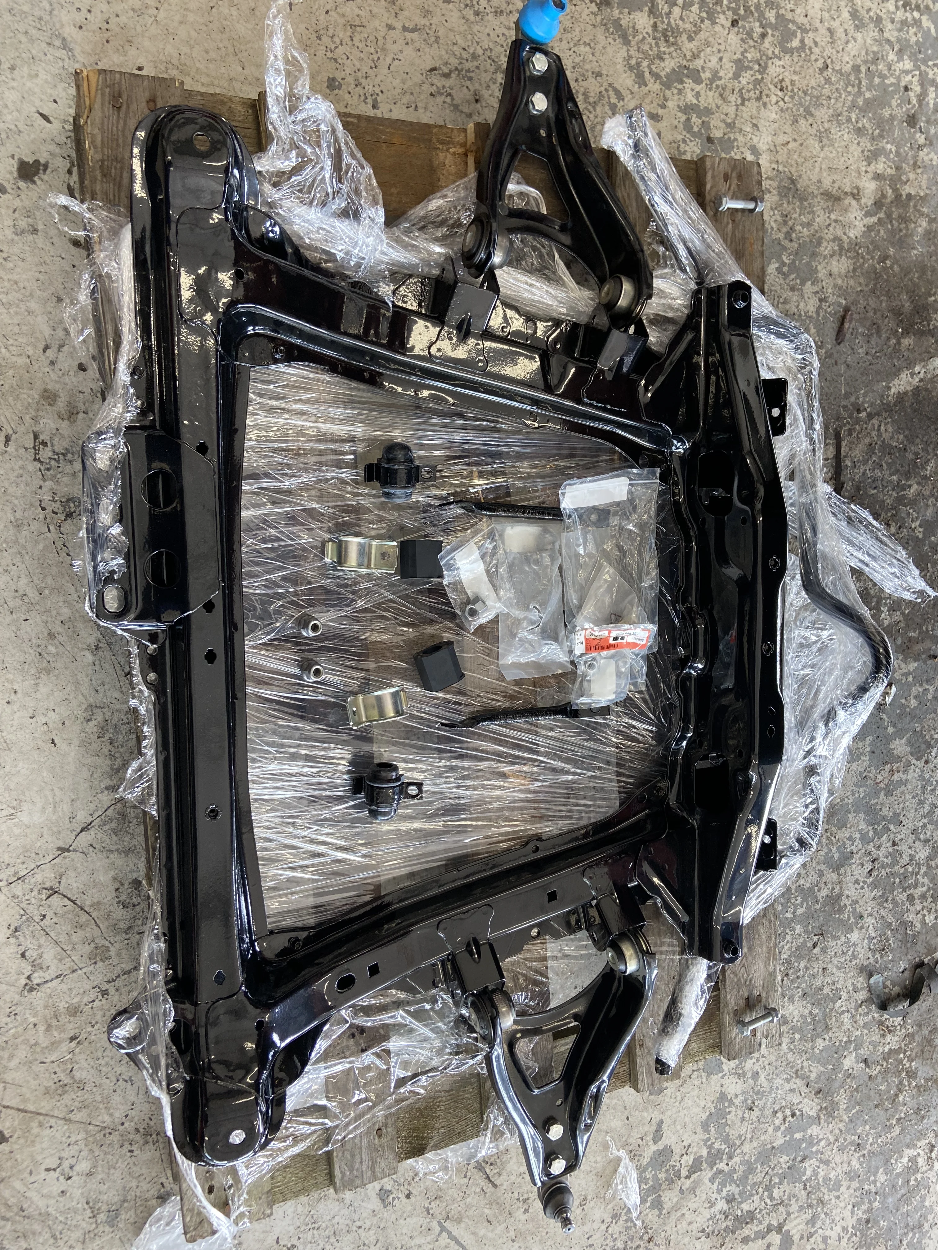

subframe been sent for powder coating, got the driveshafts and steering rack to send off for refurb.
Next up take the engine out and start refurbing the arches etc
Pretty much need/want to replace all
Bolt’s does anyone know the best place to get replacement??
Theres a thread on here somewhere that details all the bolts for most of the suspension / engine area so you can purchase from anywhere.

update
You can get all the bolts cleaned and plated if they are not to badly pitted, I was £20 for all mine to get done from a local industrial coatings firm. The front subframes are galvanised from factory so that would come up good with a good power wash/strong cleaner.
Powder coating anything on the underside is fine if you dont plan to run the car through the winter months, if you do then avoid at all costs as it just falls apart after a few years due to stonechips, thats my experience anyway, I'll never powdercoat anything underside of a car again.
Yea that’s currently what I’m looking at trying to find a company to do it. Any chance got the details for that company?
I won’t be using the car much, this will be another summer car keep away from the salt for sure.
It was a company in dyce Scotland (highland electroplaters) they just do industrial stuff but I popped in with them all in a carrier bag thinking it would be a no, boy said 20 quid be ready in a few days, there will be a company local to you surely, some came back plated but excessive pitting so I replaced them, this was 10yrs ago now

I had my Trophy powder coated underneath too - unfortunately for me I bought all new bolts which cost an arm and a leg.

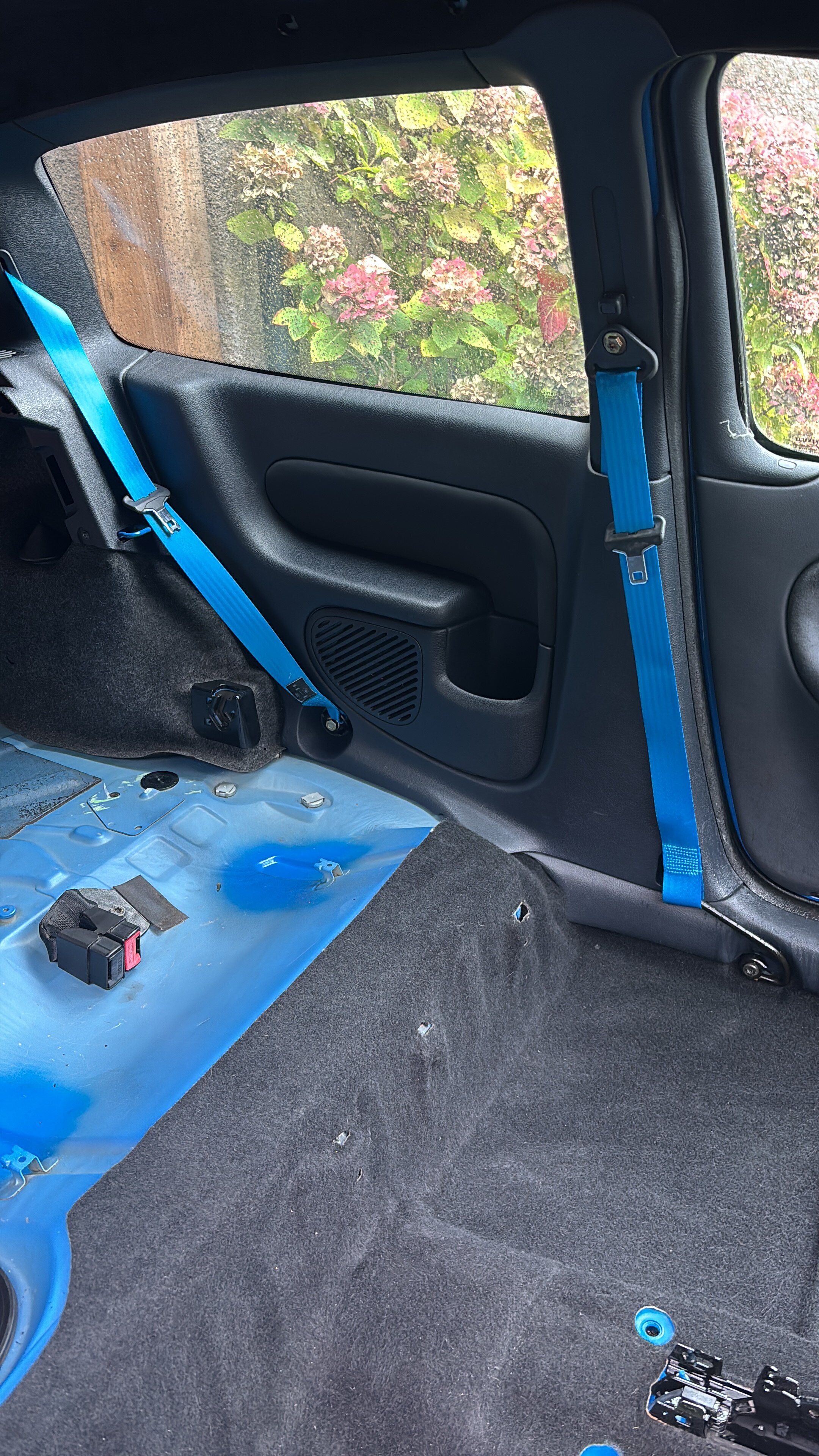

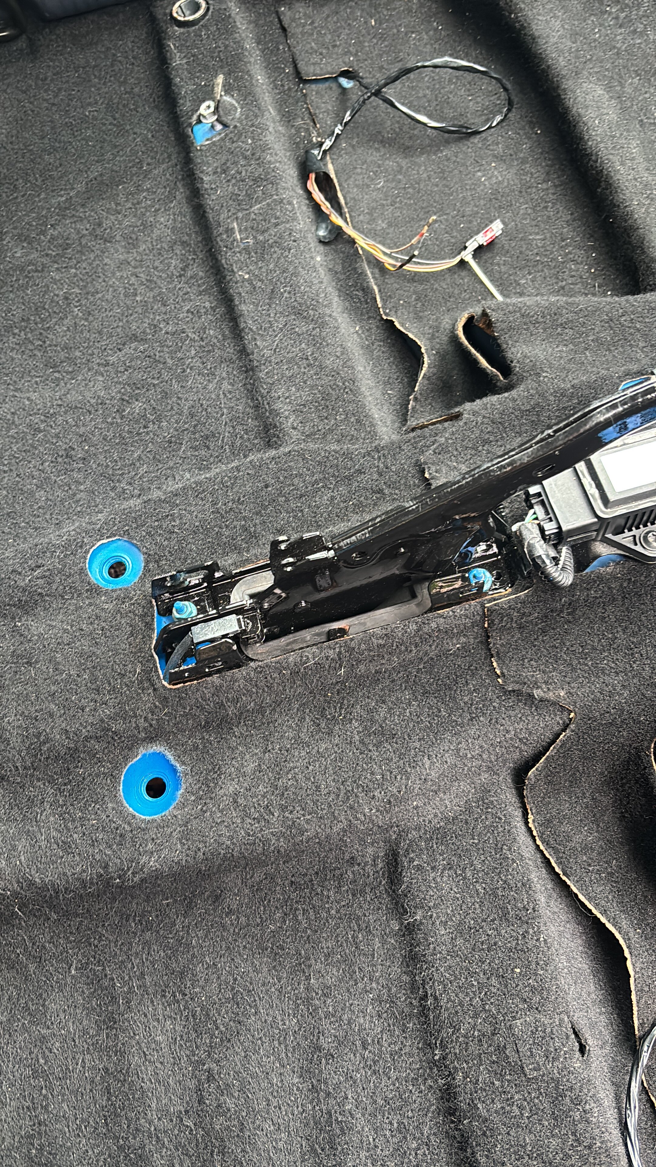

Where did you get your seatbelts done?
Really good, used them twice now quick turn around! Just take your belts out post them and they will send them back to you.
Only £27.50 per seatbelt.
@NickReilly063 After seeing that I’m going have to take the hit on them, going try get the zinc plated.
I bought a zinc plating kit and did everything myself for my engine build/front end refresh, it's about £200 outlay but having got stuff plated for other projects and losing the will to live fishing through a bucket of fasteners to work out what went where I think it's worth it so you can keep everything separated
