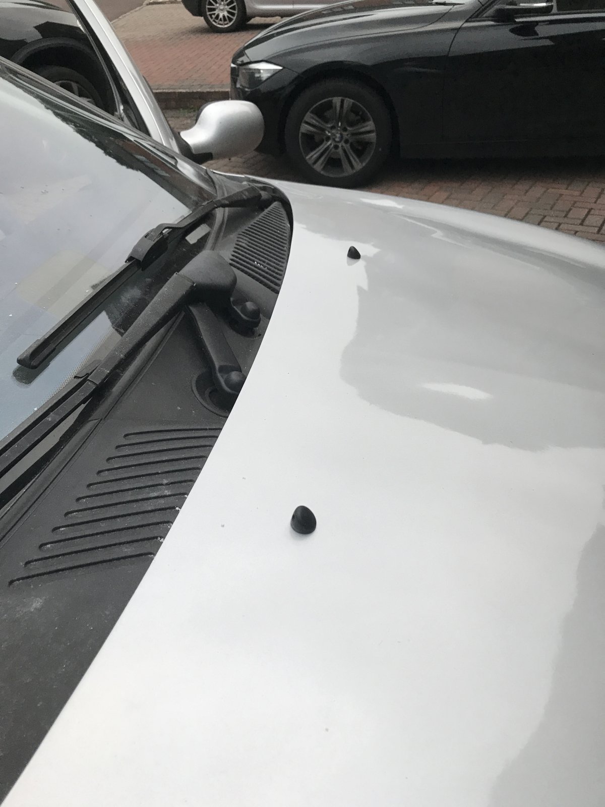

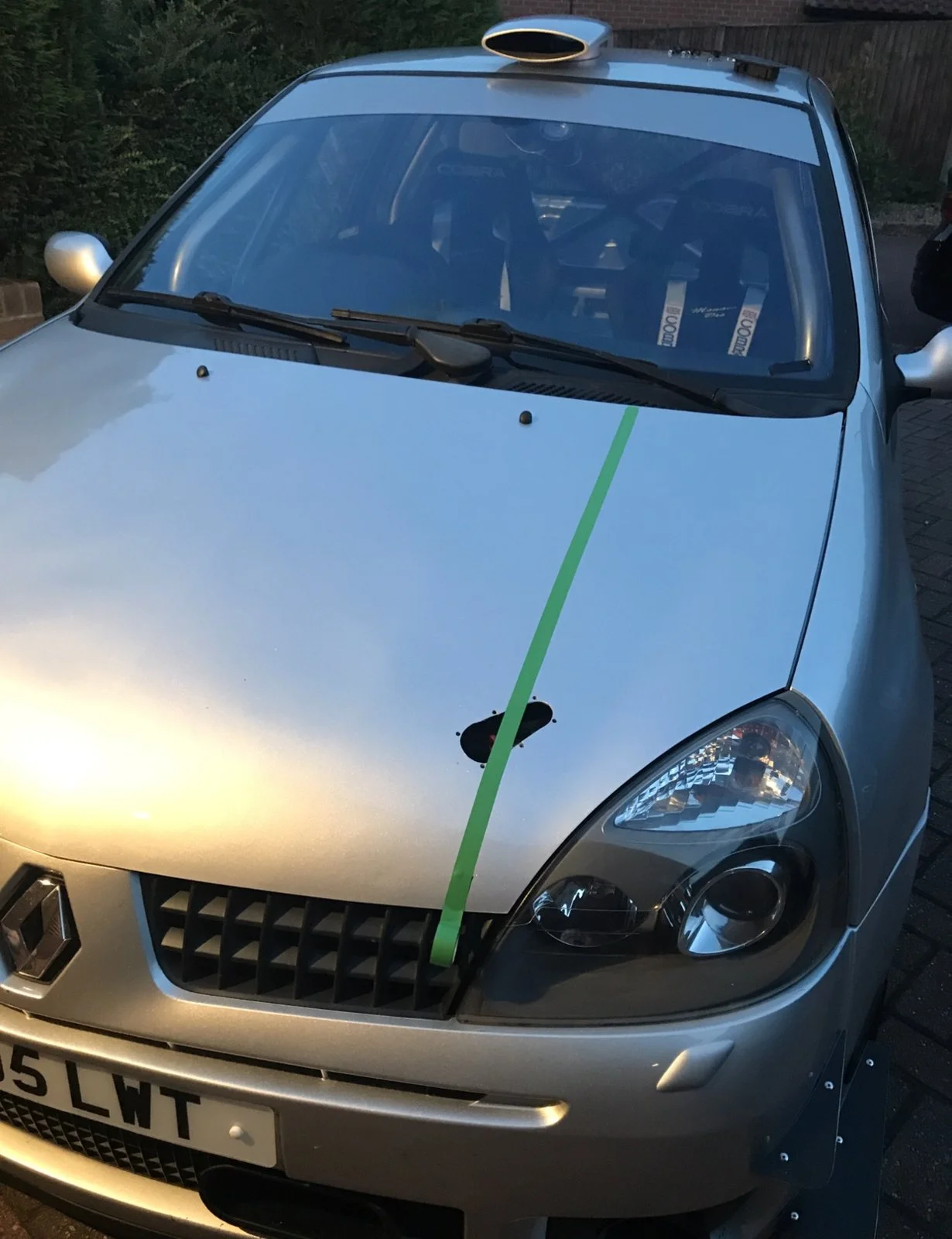

First up installing the windscreen washer jets and bonnet lifter rod.

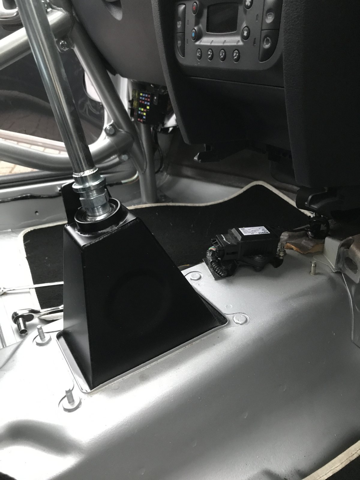

Then I tidied up inside between the seats. Almost put the centre section back in but decided not to.

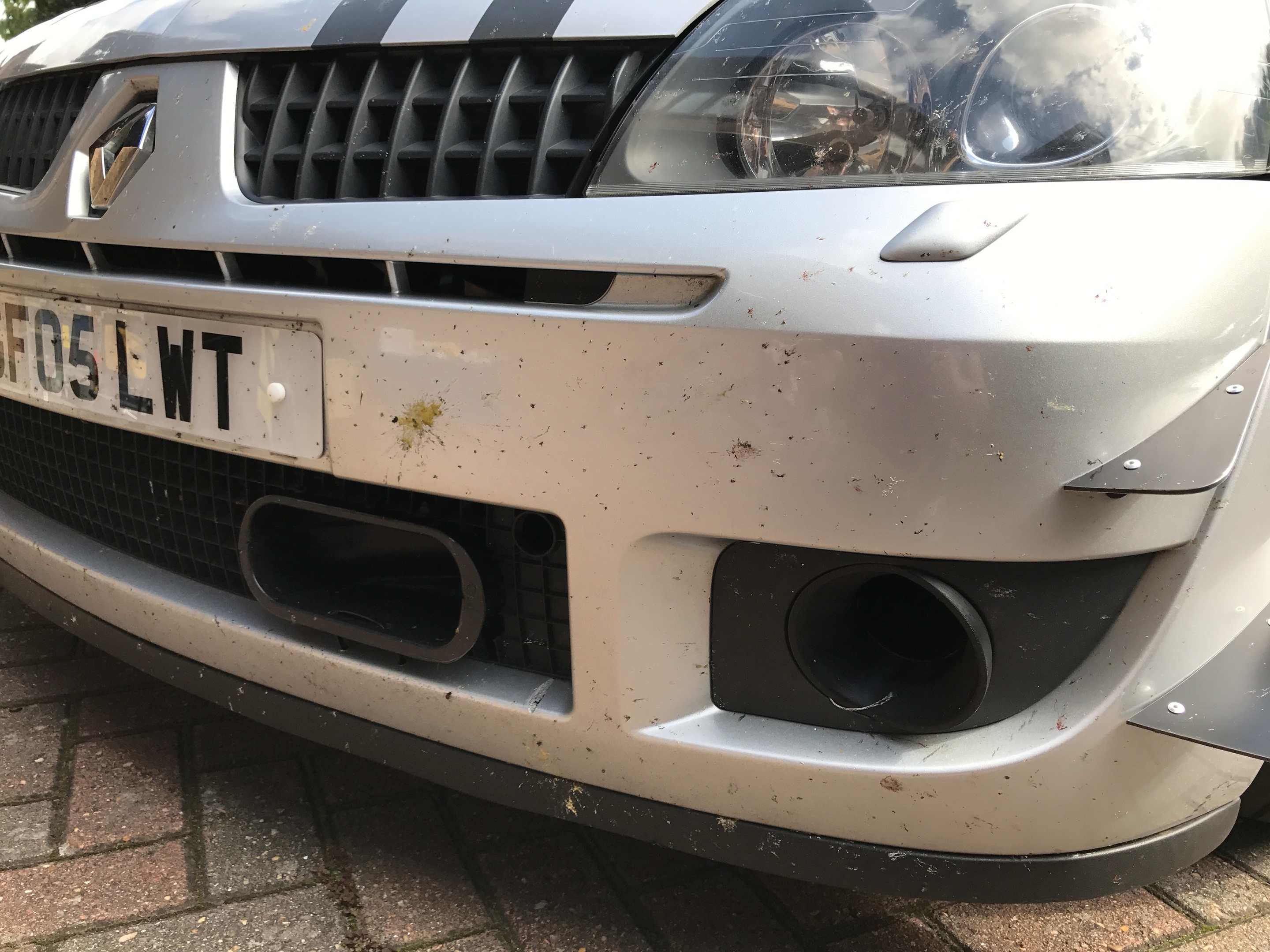

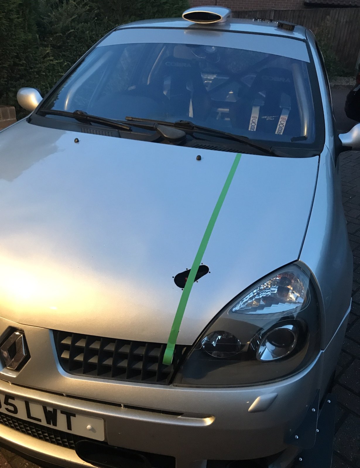

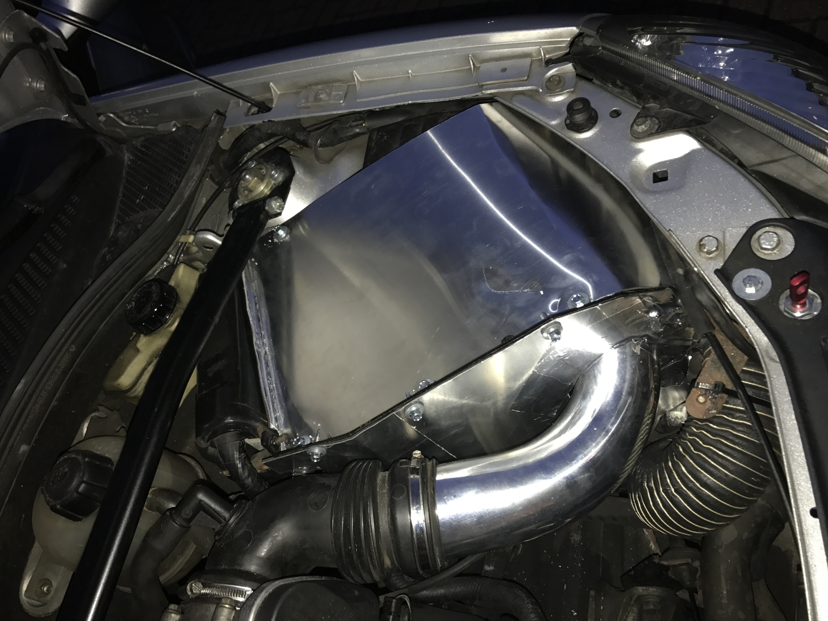

Then I put the front bumper etc back on. I also installed he cold air supply but haven't made the chamber for it yet. I have mocked it up in cardboard. Thought I'd do the final metal one once the charging issue is shorted.

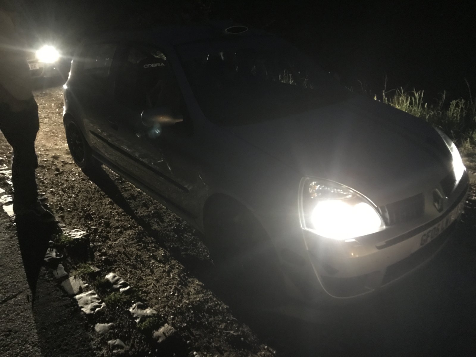

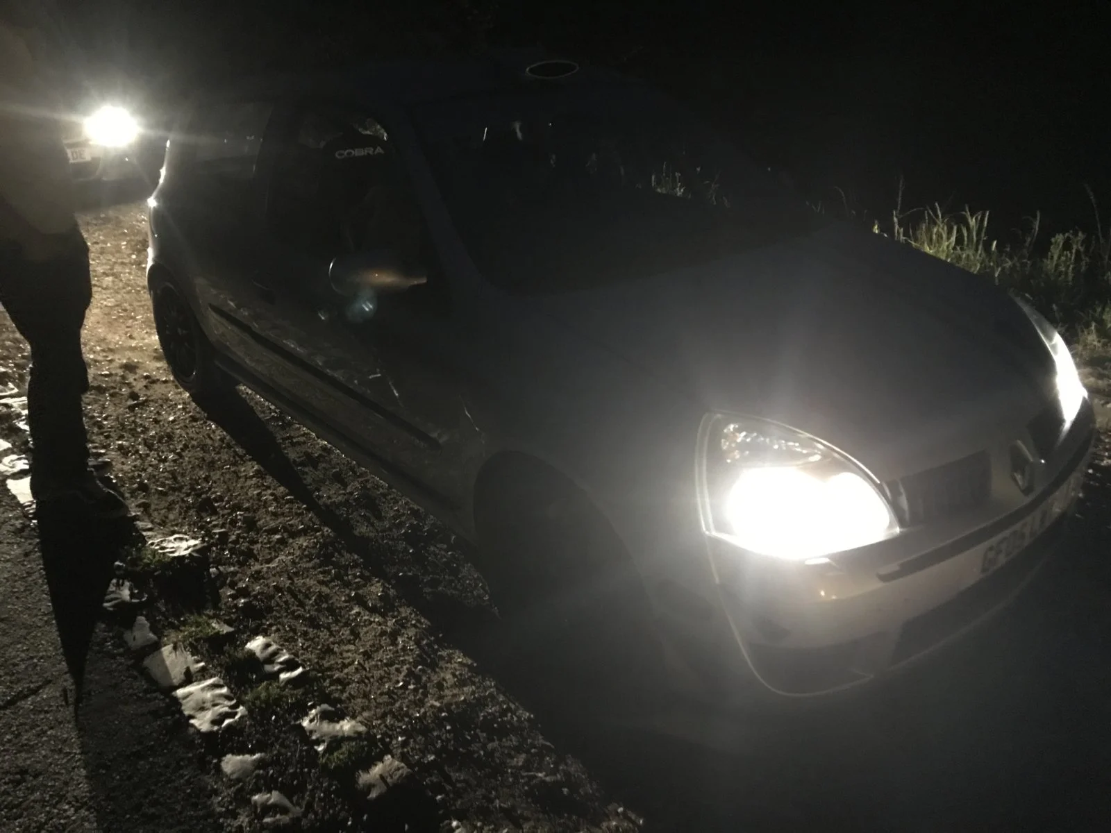

Still my happy car day didn't last long! The daily car dicided to stop in the middle of the road. Cue three breakdown truck later and the divs manage to get it on the flatbed without wreaking the transmission! On wards in upwards!

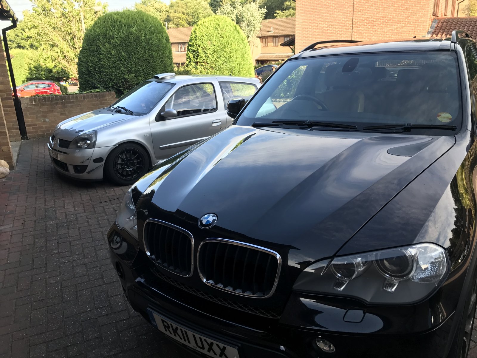

Happy days, the Clio and X5 came back today!
X5 now has a new £830 fuel pump! Luckily that was covered on the RAC warranty :grin:

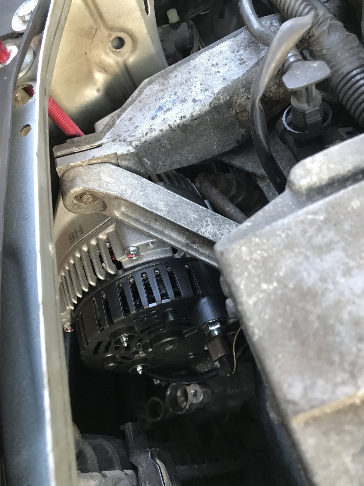

The Clio now has a new alternator (circa £200) and as of Monday coming it will have new ABS sensors (£120). I hate spending money on bits that don't make the car faster or better!

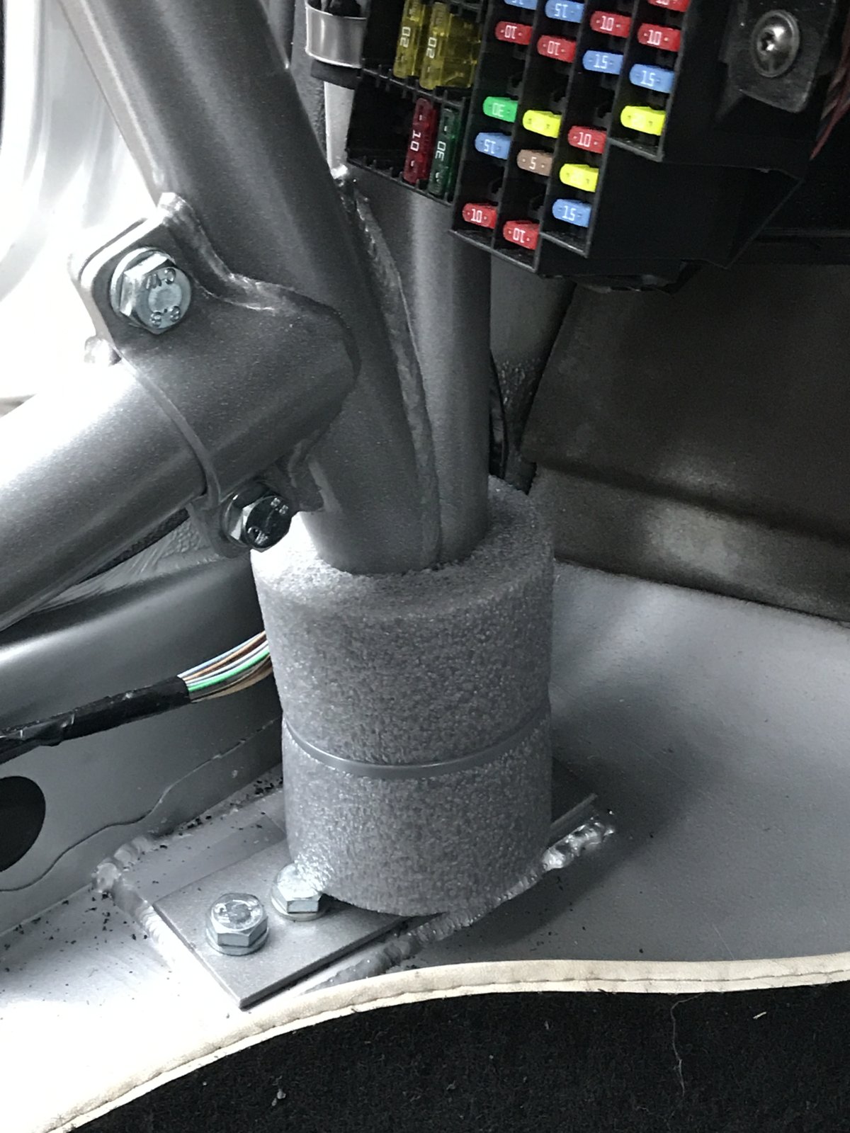

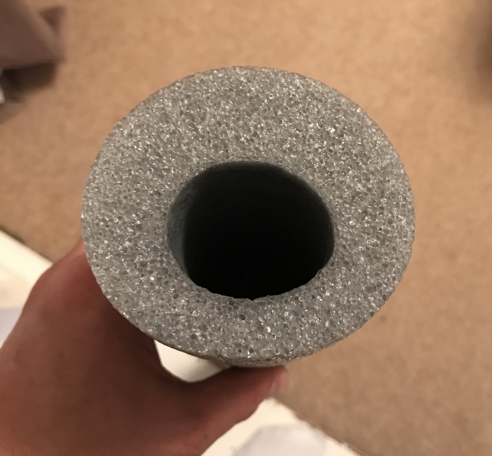

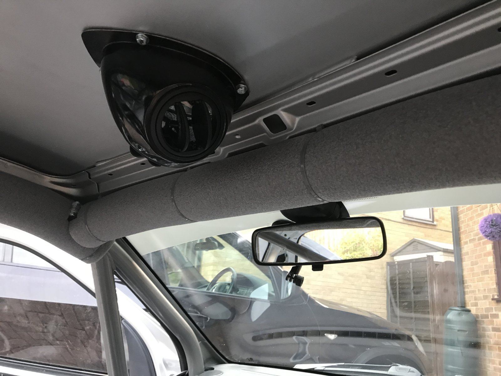

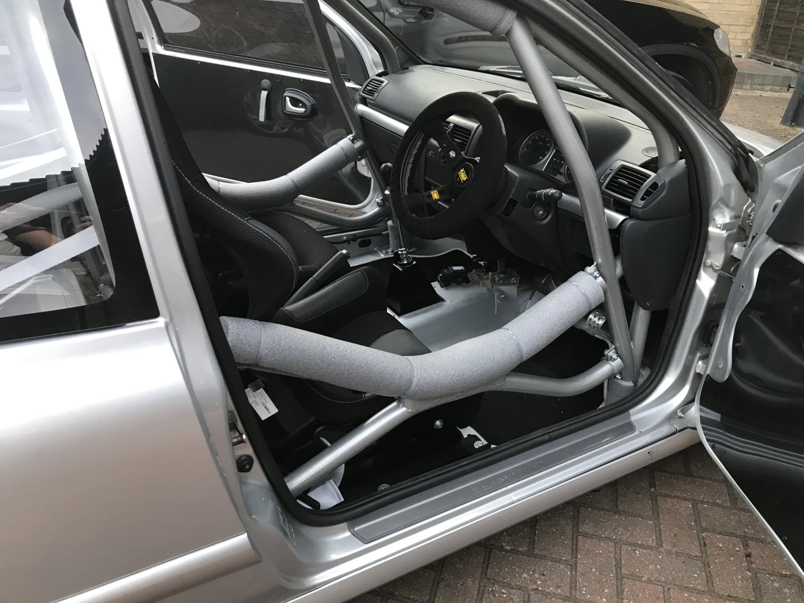

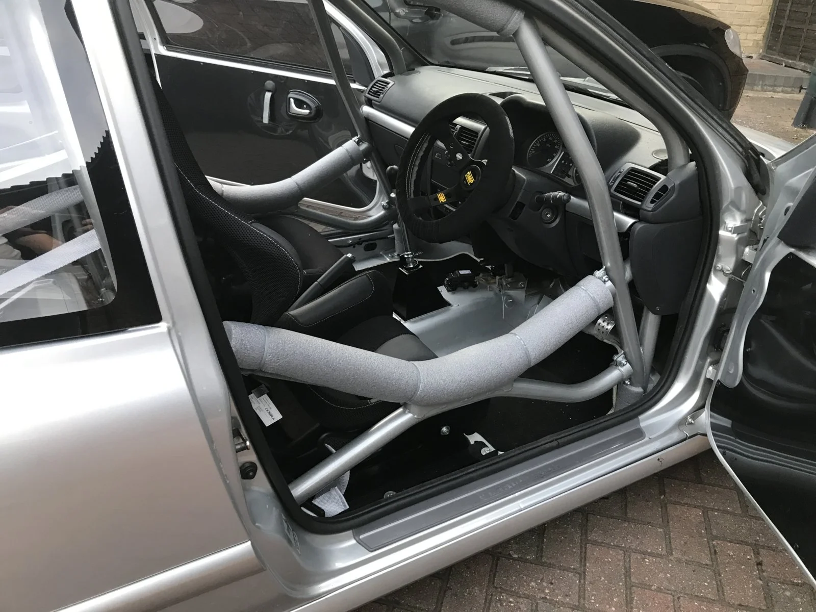

Is that pipe lagging/insulation ? I wouldn't recommend that for roll cage padding. Will do bugger all in the event of a crash/roll.
Sent from my SM-G955F using Tapatalk

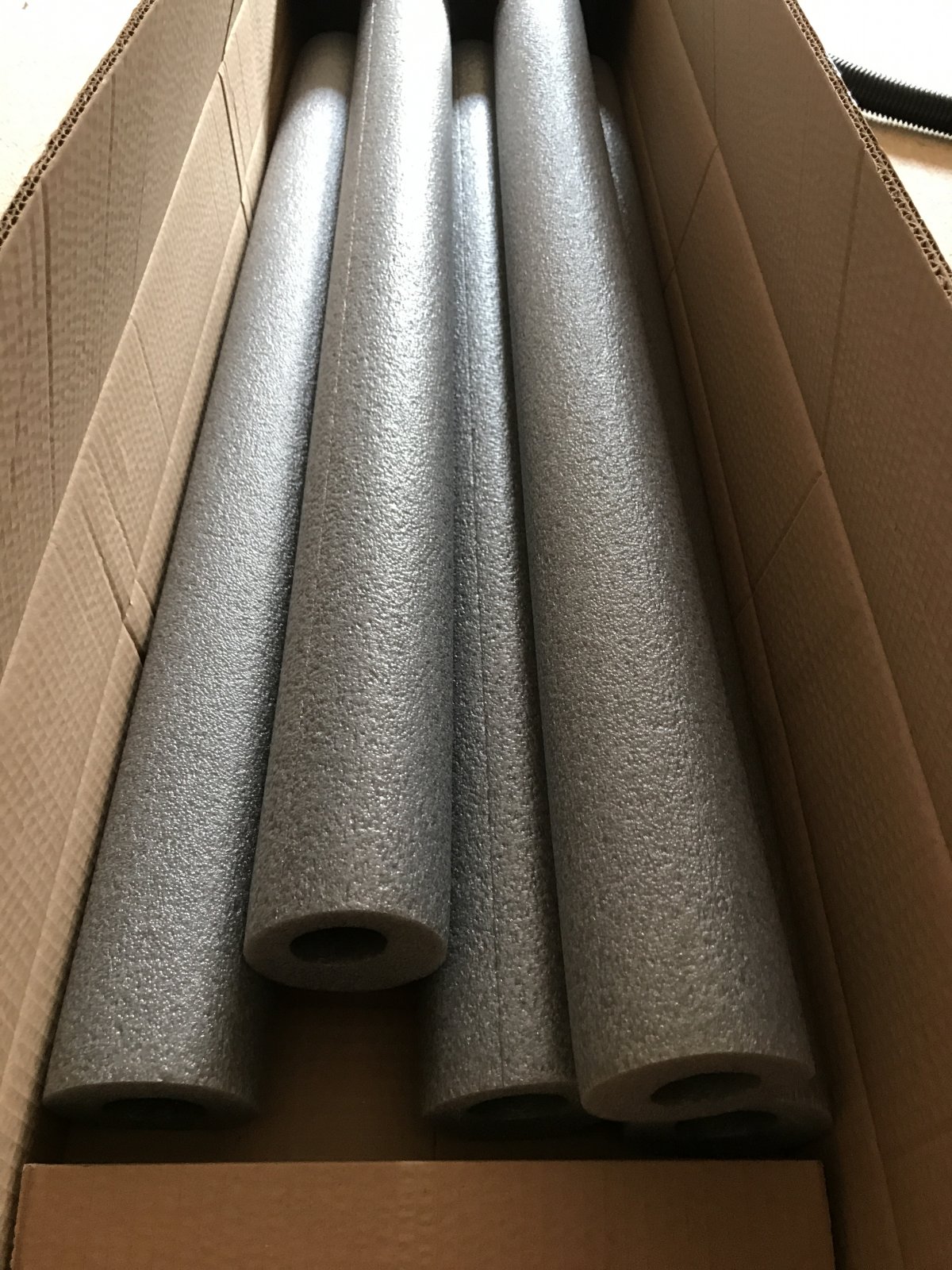

Fear not it's not! It just looks the same and cost ten times as much! It's the proper stuff from Demon Tweeks with the off centred middle. I don't want to be drinking through a straw for the rest of my life......
So the roll cage padding is now installed. Still in two minds about putting some on the upright. There is no way my head can hit it with out my head coming off my neck, also the bar comes in handy to grab hold of to get in and out of the car. OCD grey cable ties purchased.
Used the off cuts to project the ankles

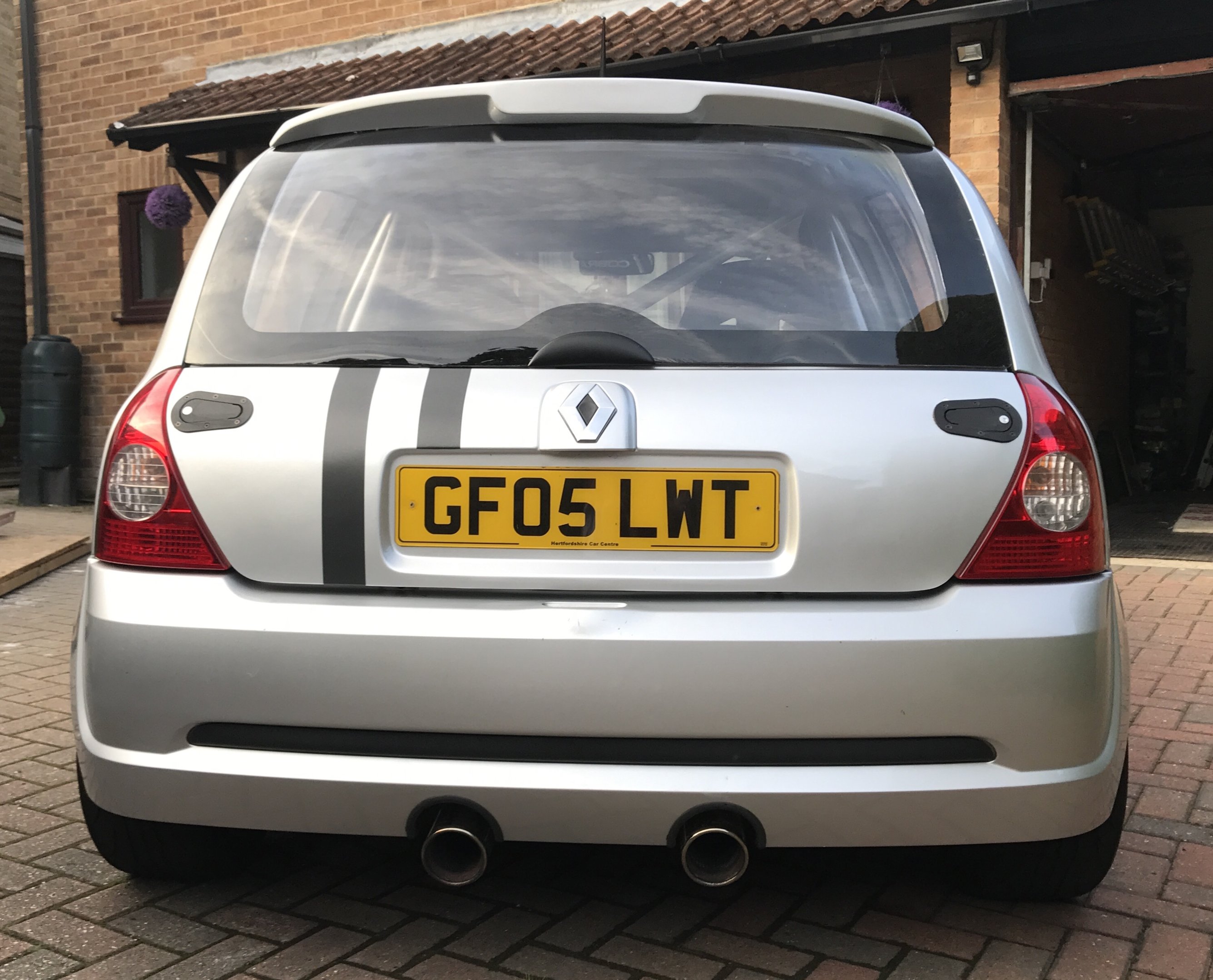

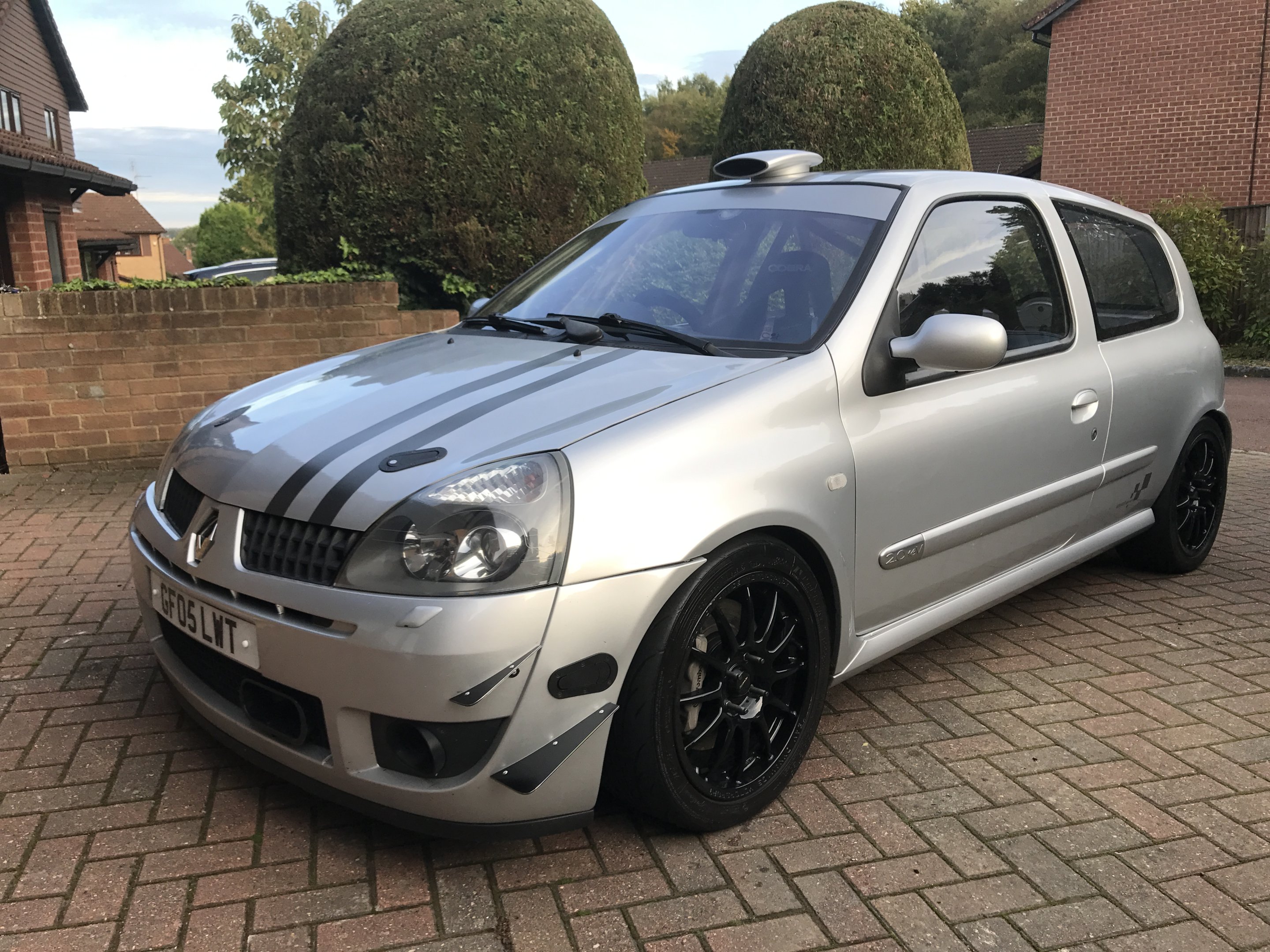

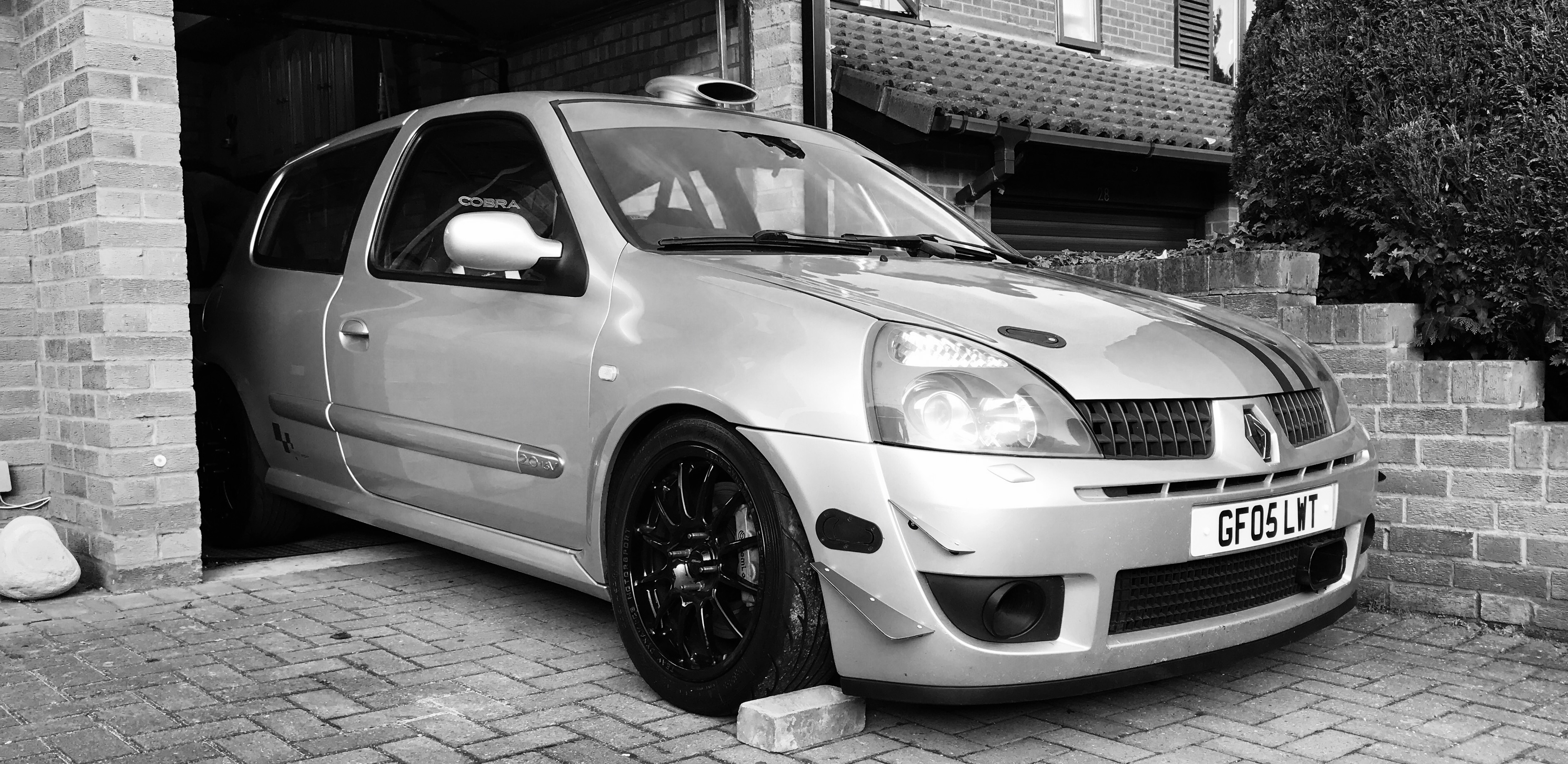

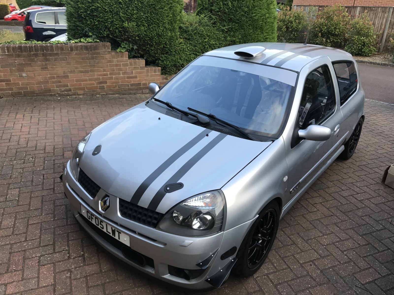

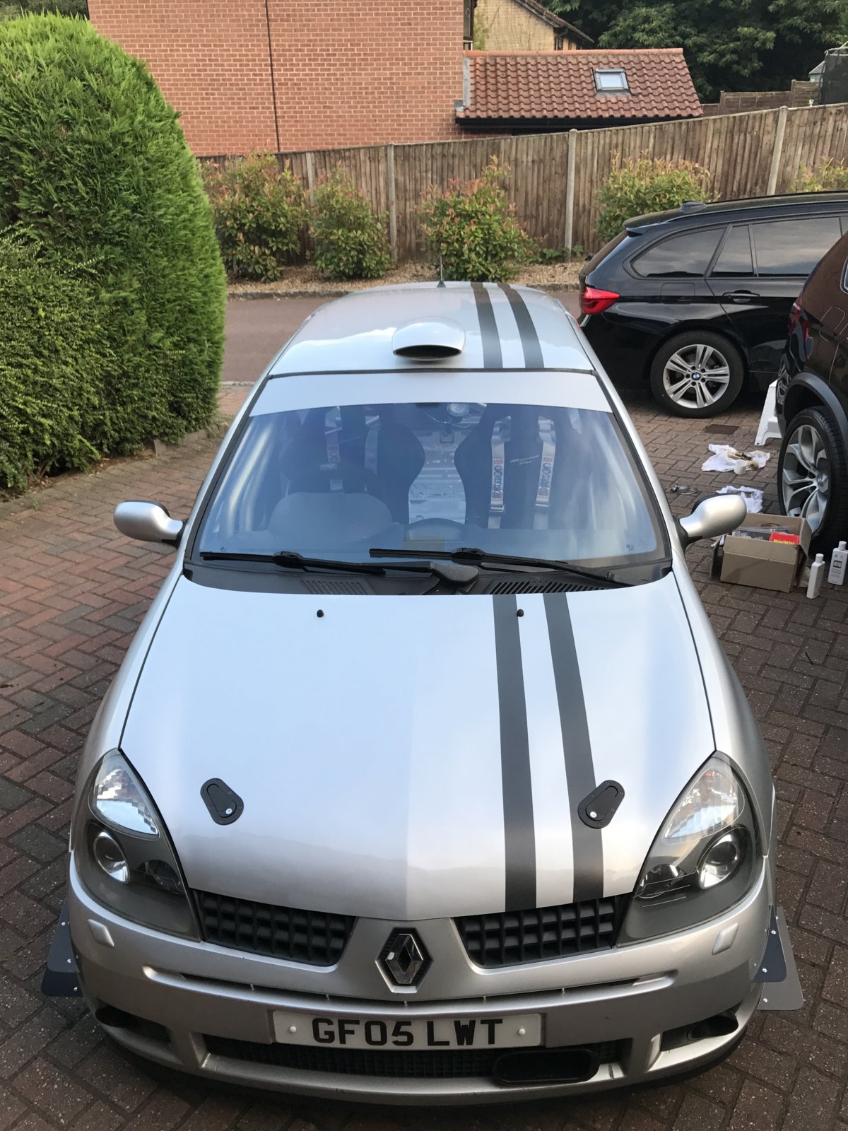

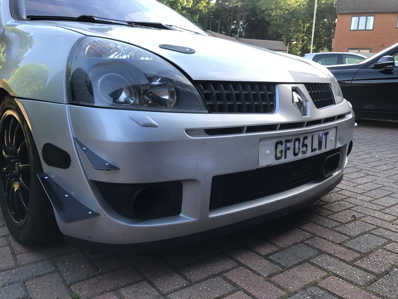

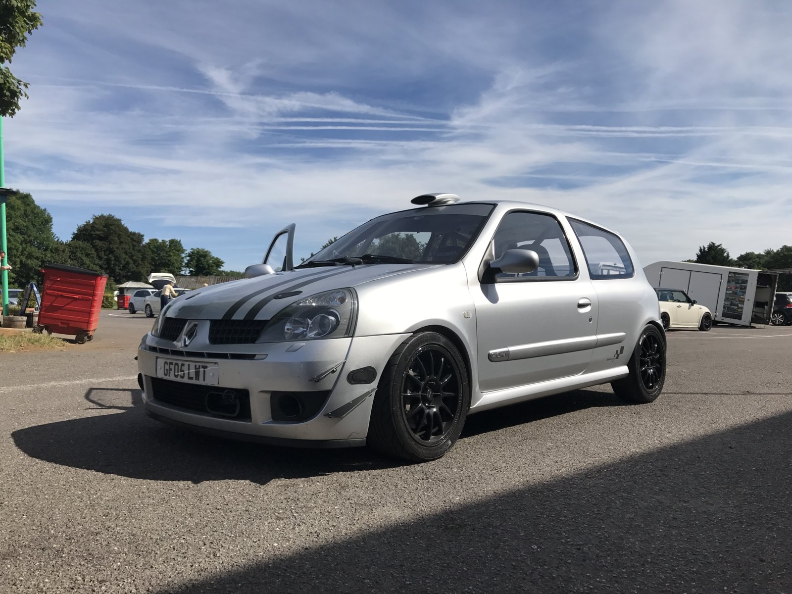

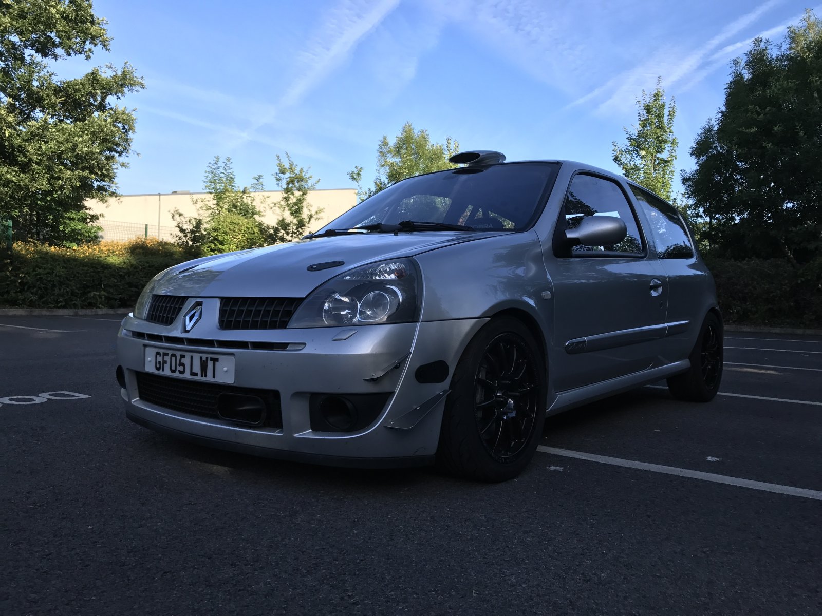

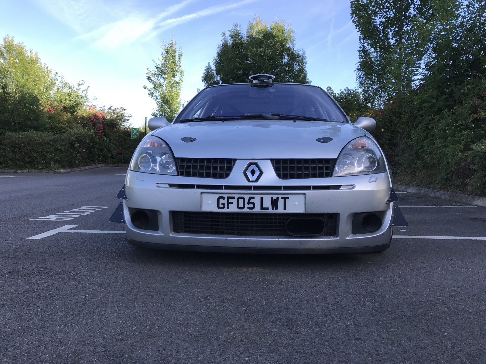

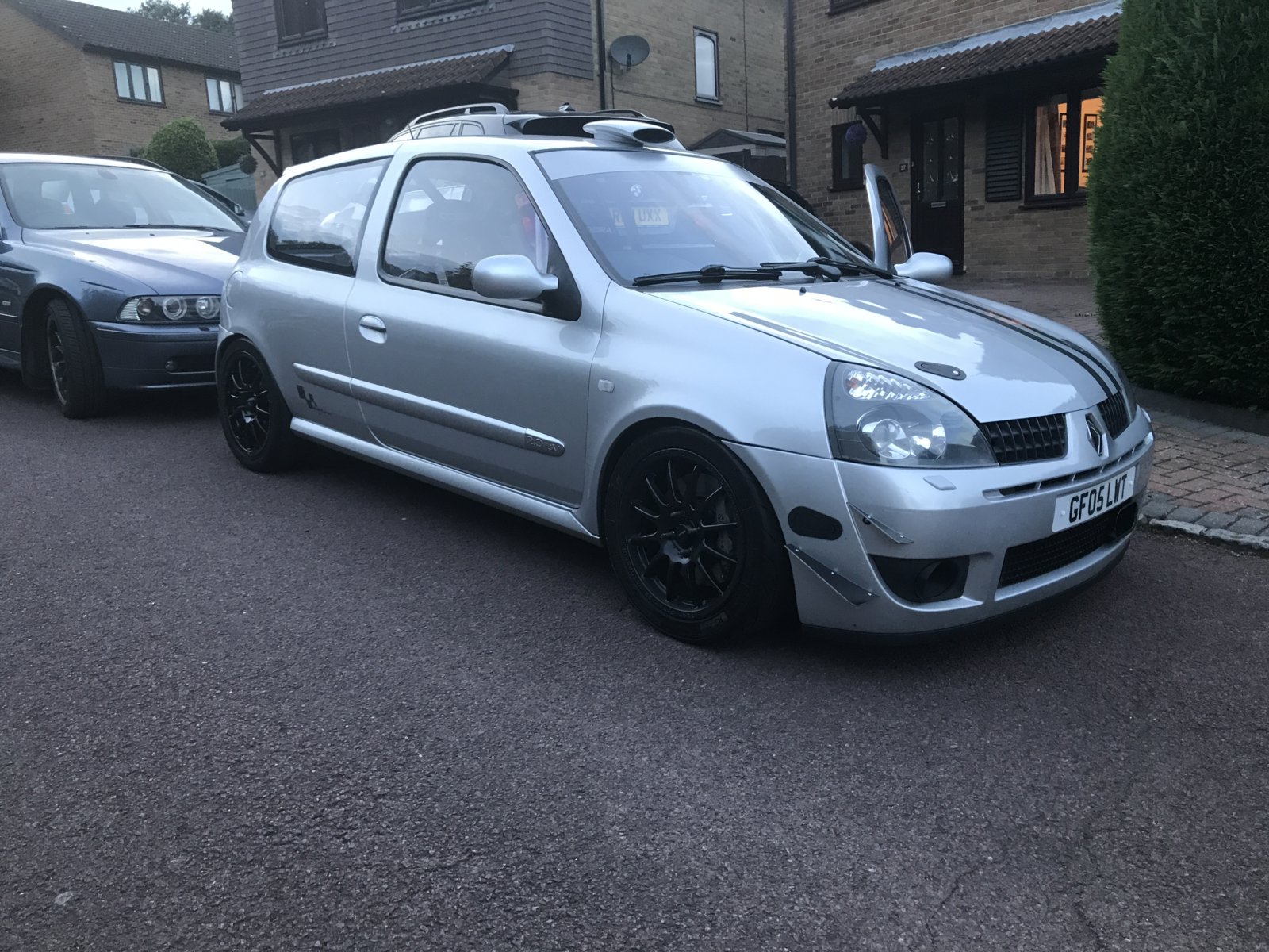

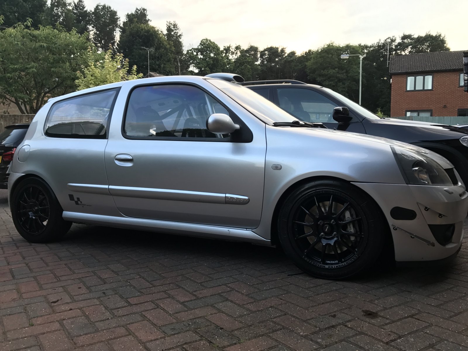

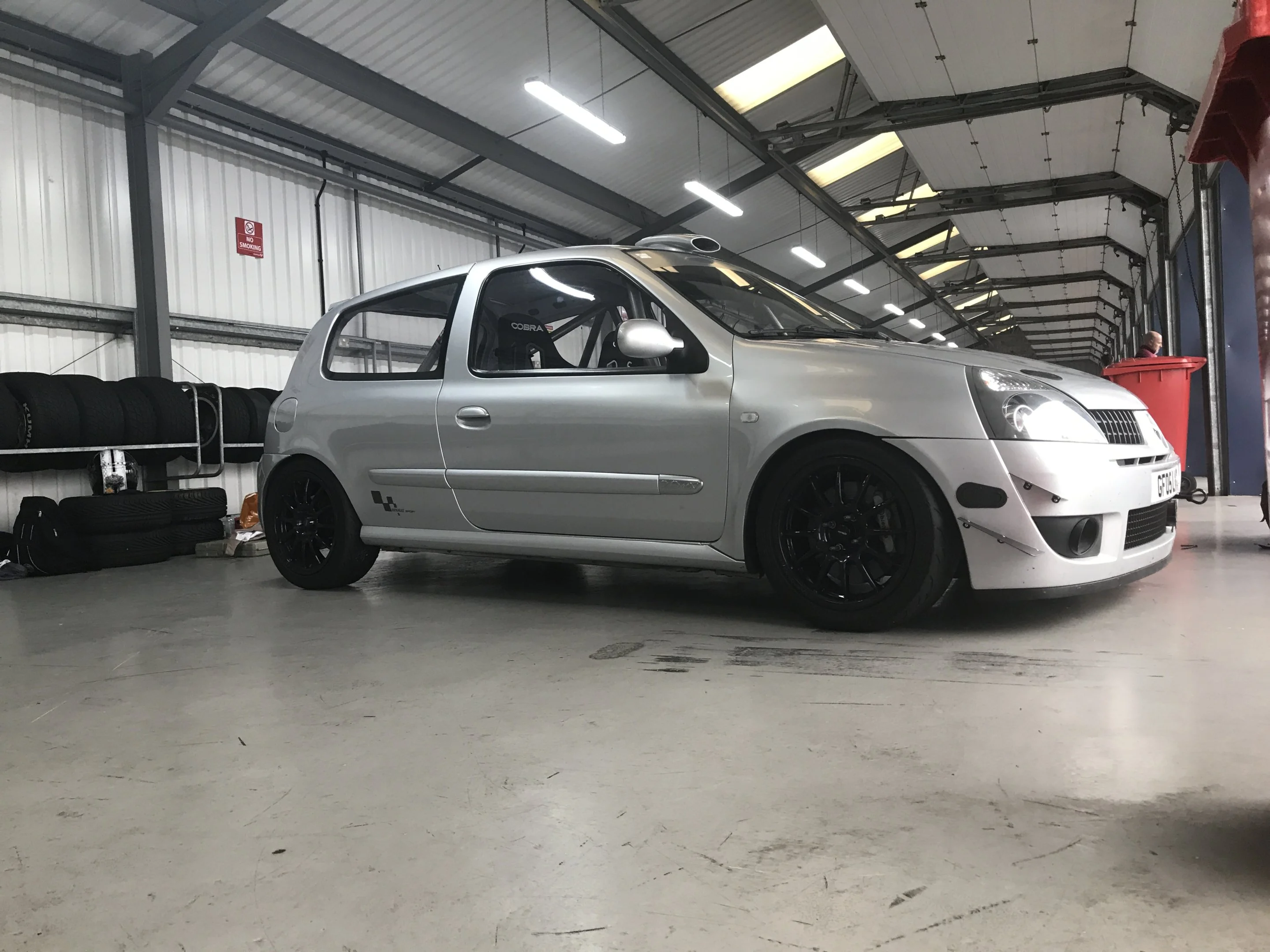

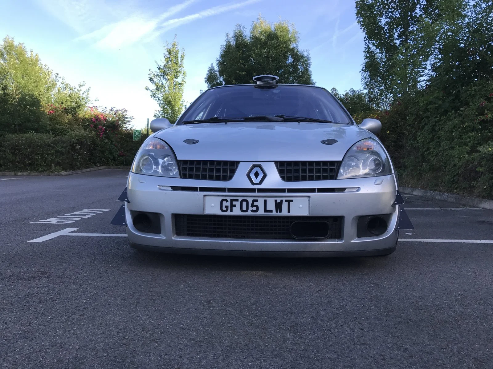

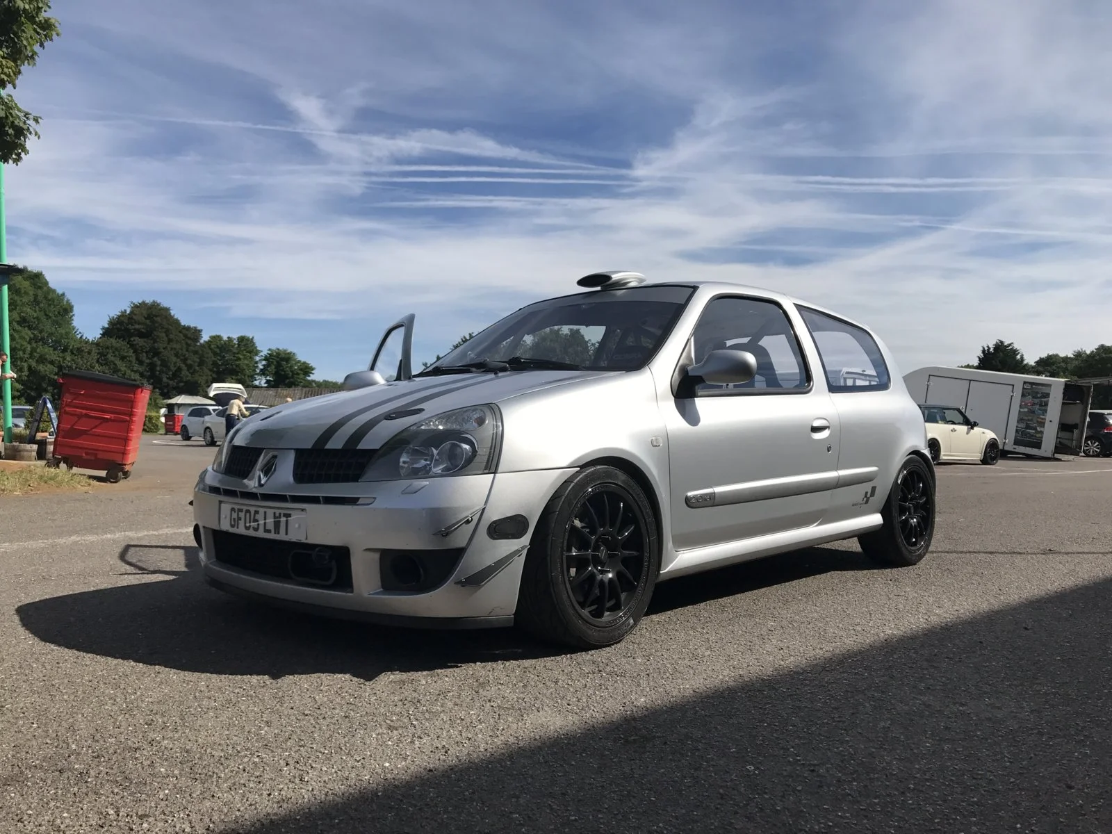

Finally time to tart the old girl up abit. Gave it a wash for the first time this year! Then added some graphics. First up was the sunscreen. I removed all the trip to do a proper job.
It's hard to see but the graphics are all charcoal colour. Didn't want to go to OTT but wanted it to stand out abit from the other silver ones.
The strips are positioned the same as the ones that had them from the factory but are 10mm thicker (giving a smaller gap between them).

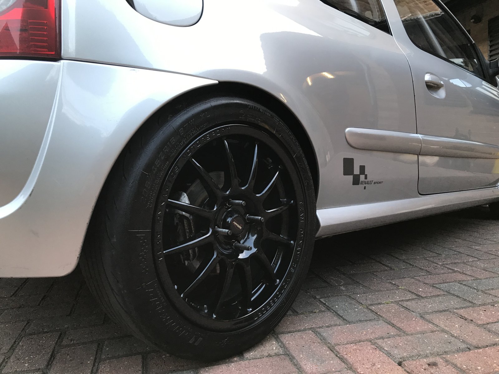

Fitted some DC1.11 pads and replaced the front ABS sensors. How much bloody money are the ABS sensors?!?!!?! Took abit of googling to realise you have to drive the car a little bit to clear the ABS fault light. Then off we went and drive 15/20miles! Stopped a few times to make sure nothing had fallen off 😂
Even put some petrol in it for the first time this year!
I cant fault the car at the moment, the front end feels positive, a few little rattles but no big banging or crashing. The induction noise from the new cone filter is spot on. The seats, gearbox and steering wheel are all so much better than the standard awkward positioned items.

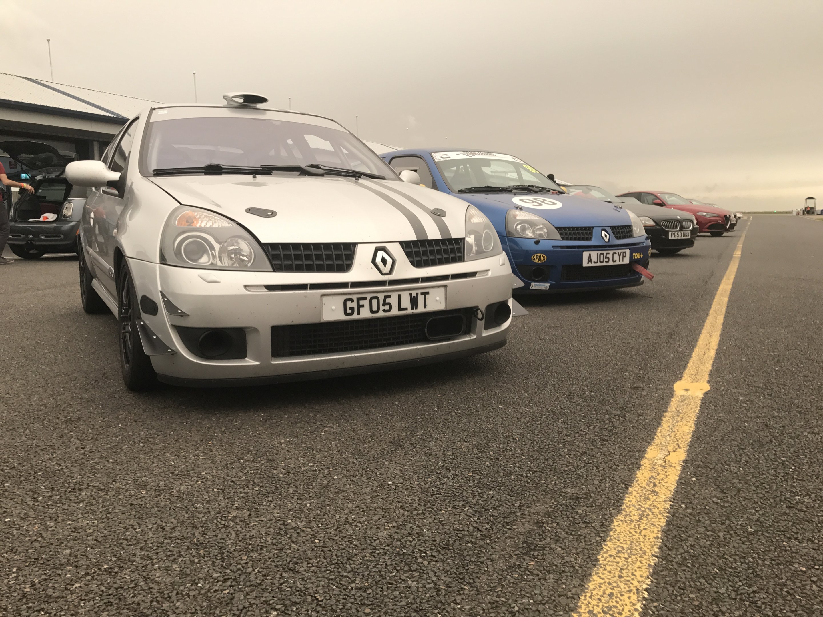

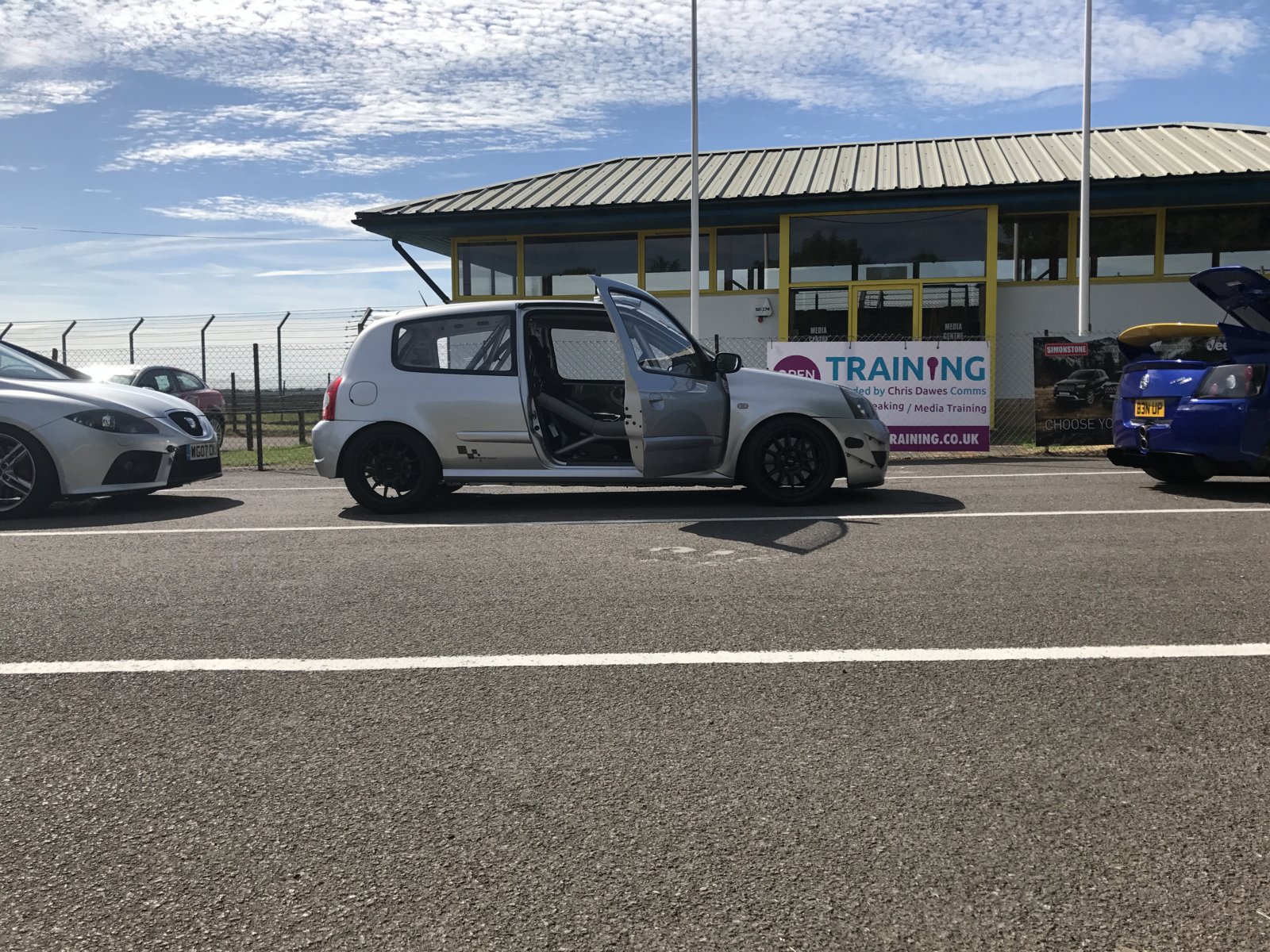

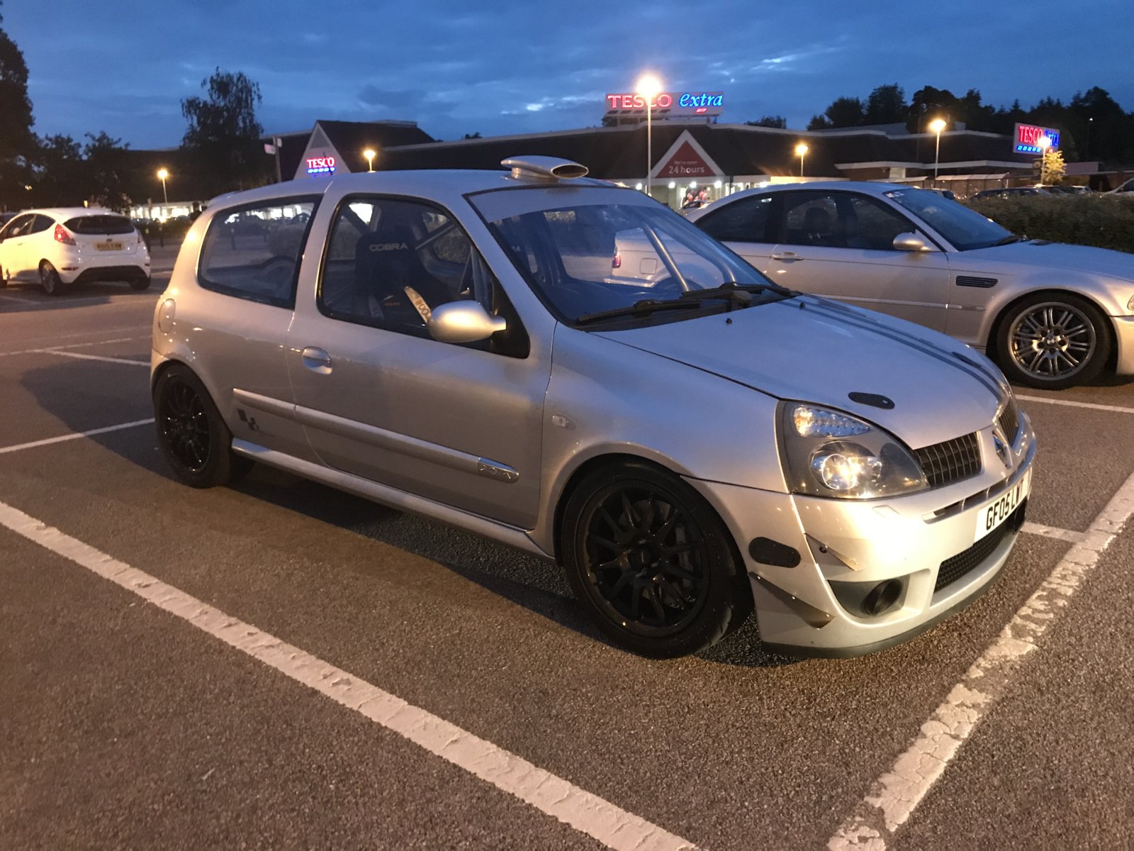

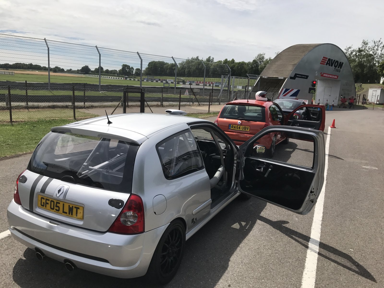

Finished the first trackday, apart from having to cut the inner arch lining out 10 miles into the journey there the car was absolutely faultless! No official photographer unfortunately but I have plenty of videos. The car deffinety has a spring in her step now it's been on a diet!
Any idea what sort of times you were doing? Pretty sure I was talking to you on tric trophy page the other day?!
Ads
Ads
Just uploading some vids but the first lap I timed later in the day was 1.24 with a passenger. Front tyres was the limiting factor today. It was Uber hot!
Been a bit warm hasn't it lol, I'd live to get a dry day at Combe ;) good times though by the sound of things

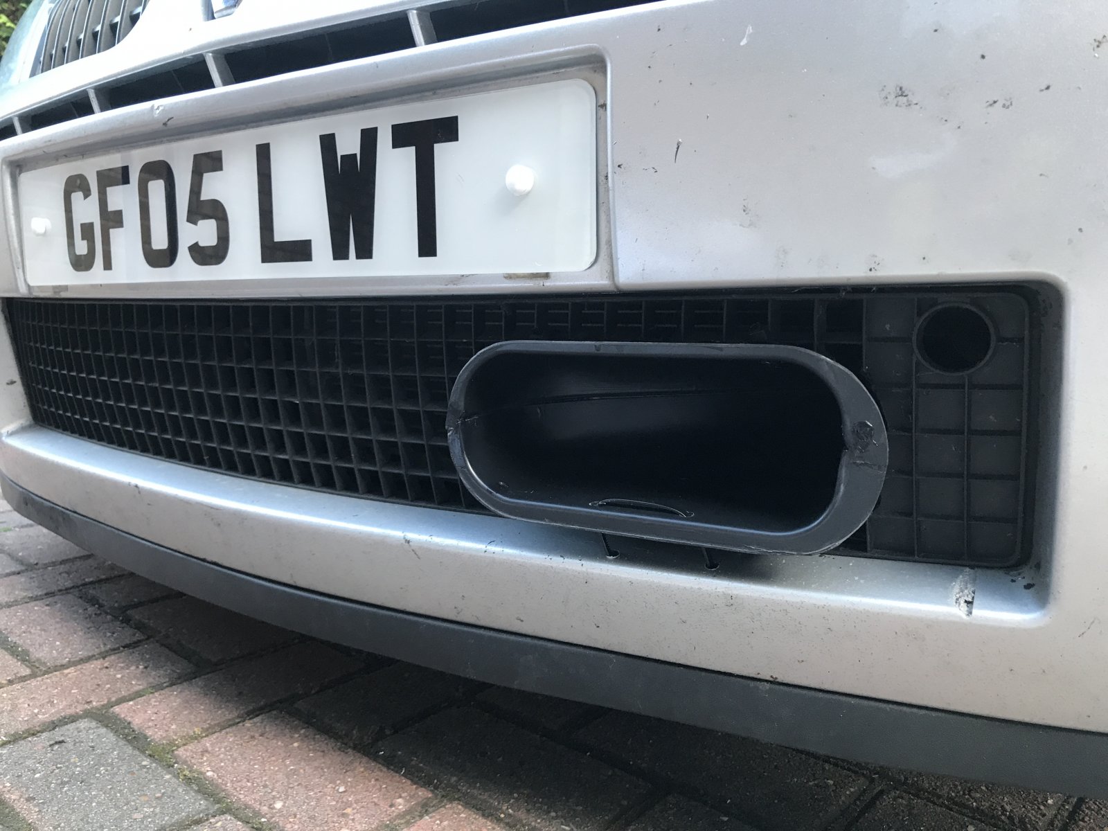

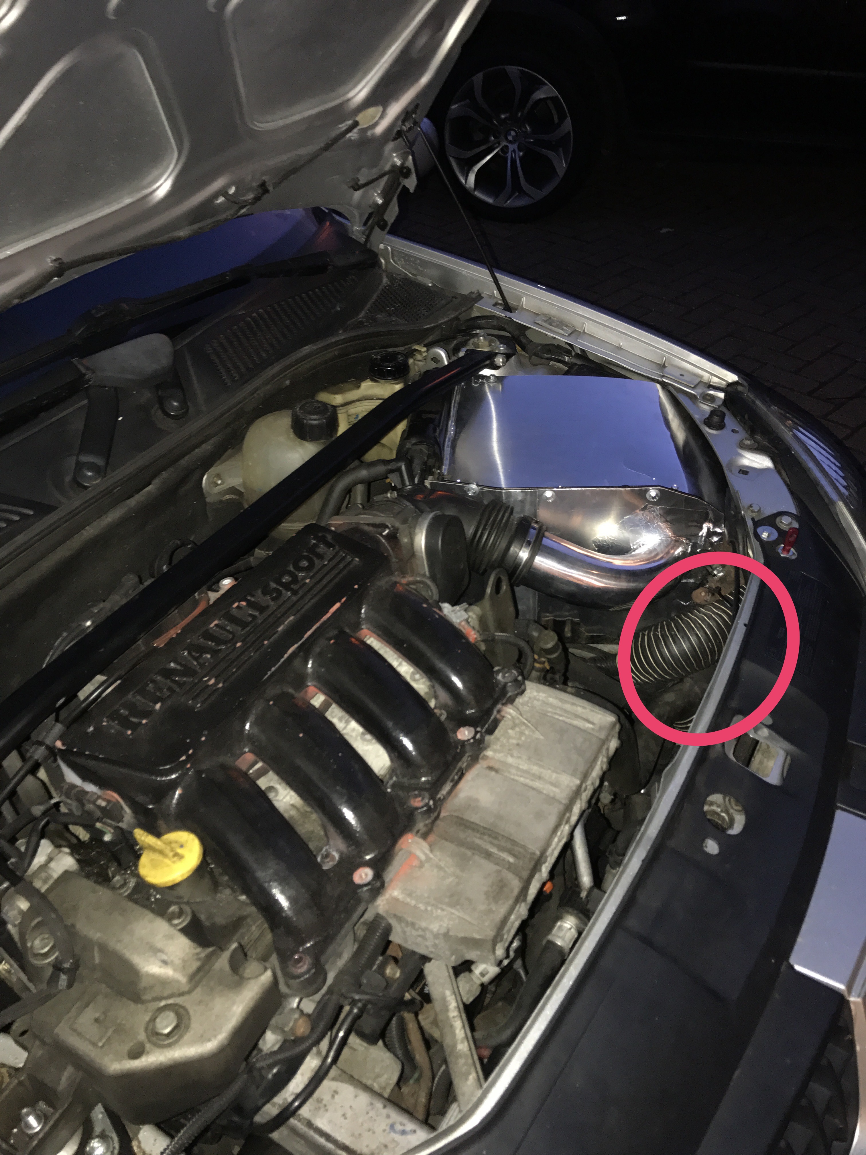

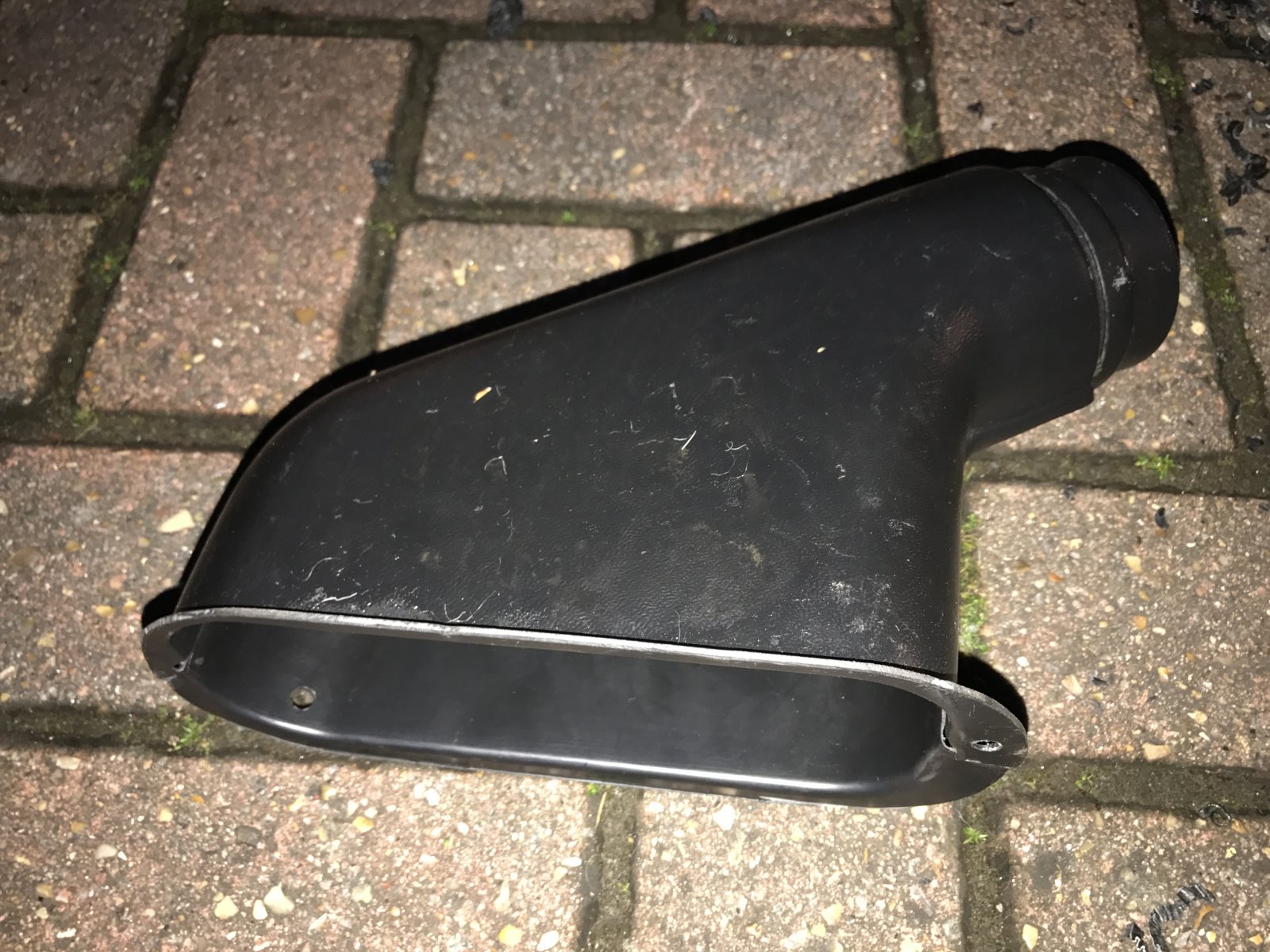

It is a brake duct for a dax cobra which was brought for this......
But it/they never got fitted. I just checked the Dax website and can't find them. The pipe outlet is 70mm (same as the air inlet to the engine). To be honest it does sit proud in front of the bumper grill and could do with being a bit shallower but it was free and seams to work!

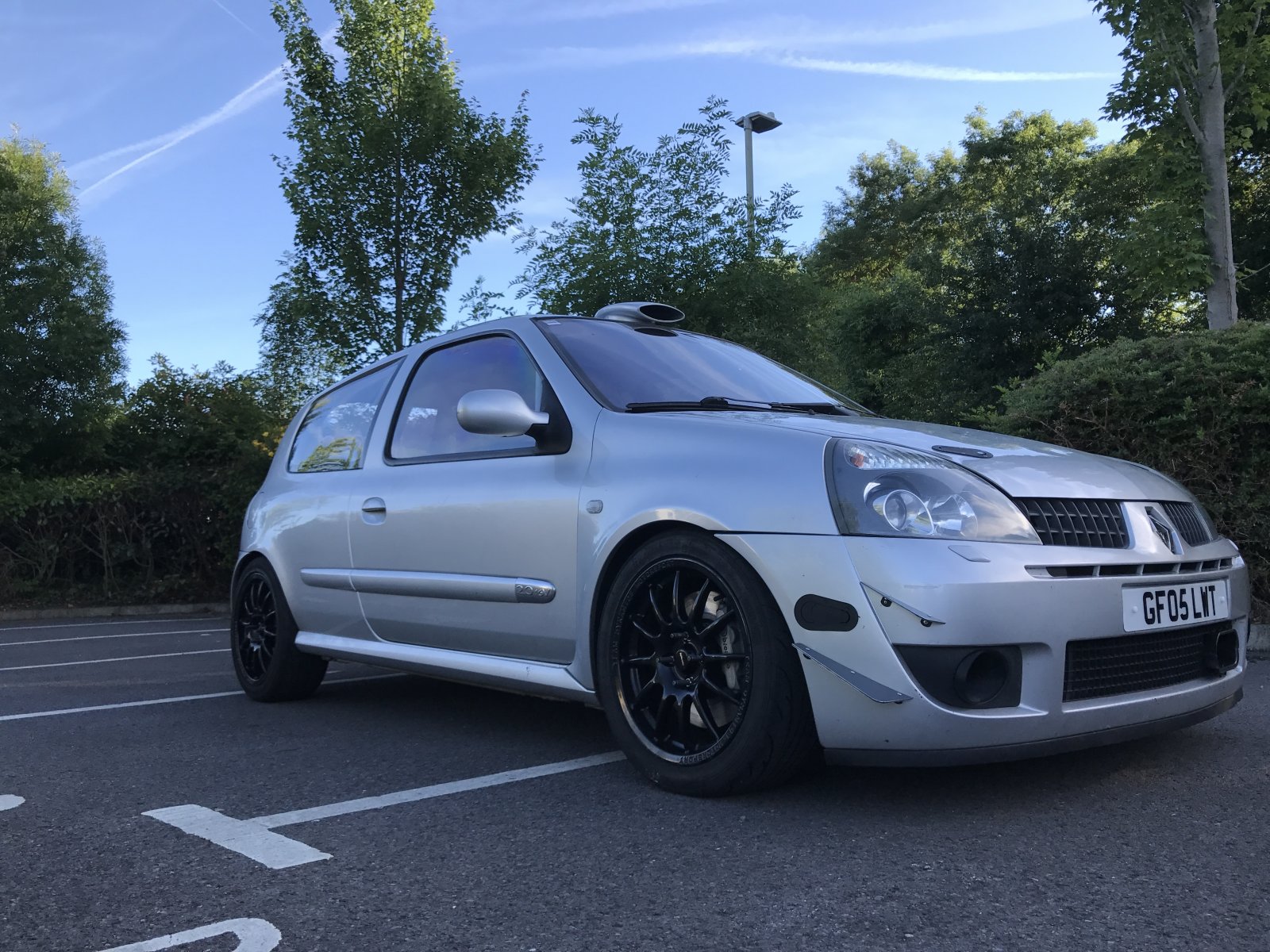

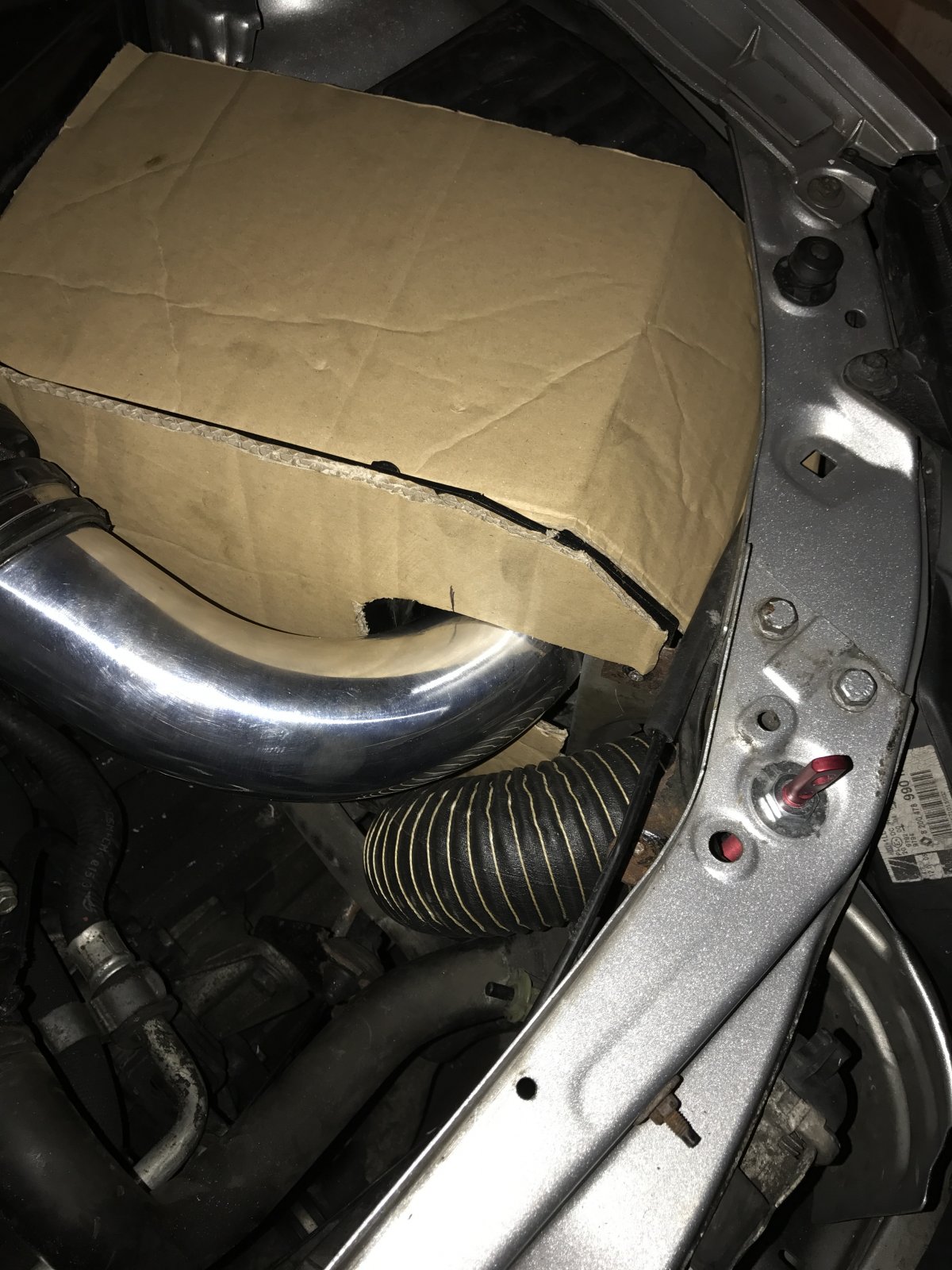

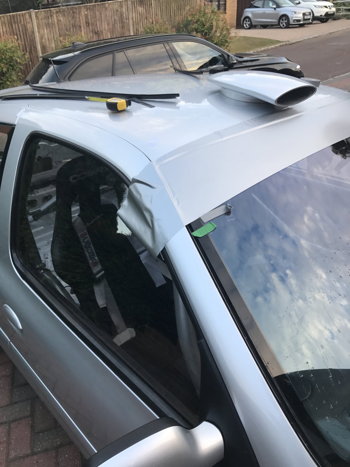

I did knock up this before he track day to help get the cold air into the engine-
I had no running issues on what was a very hot day. You can see where the 70mm pipe feeds in (red circle). It's not pretty but function over form.....

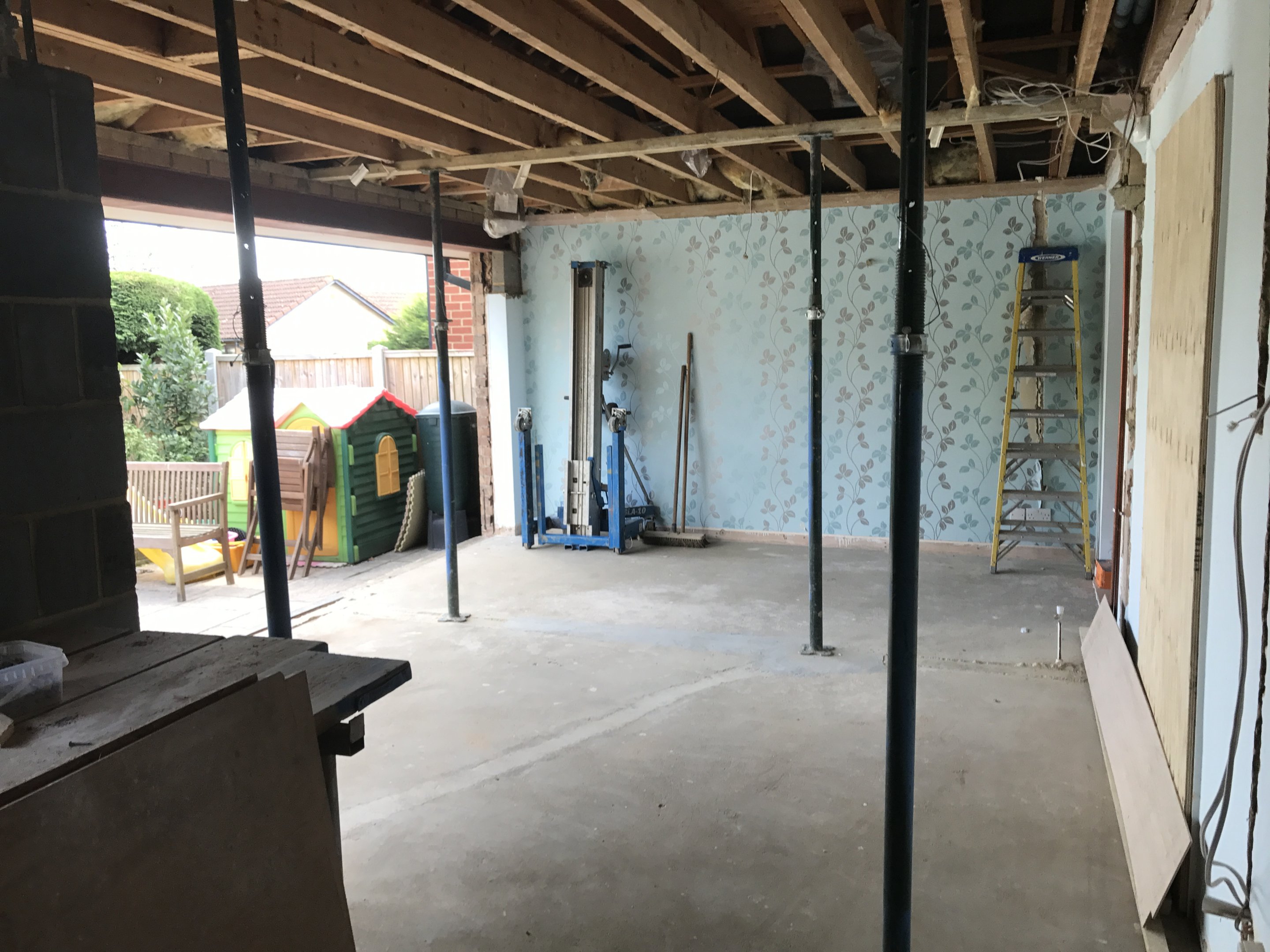

Our extension starts Monday so I have a bit of an eye on money at the moment. There's talk of a trackday within the month and a late ring trip October time. I think I'm getting old as I have no interest in driving the clio over again. I need to get around to doing my trailer test so I can drag it over in relative luxury next year I think.

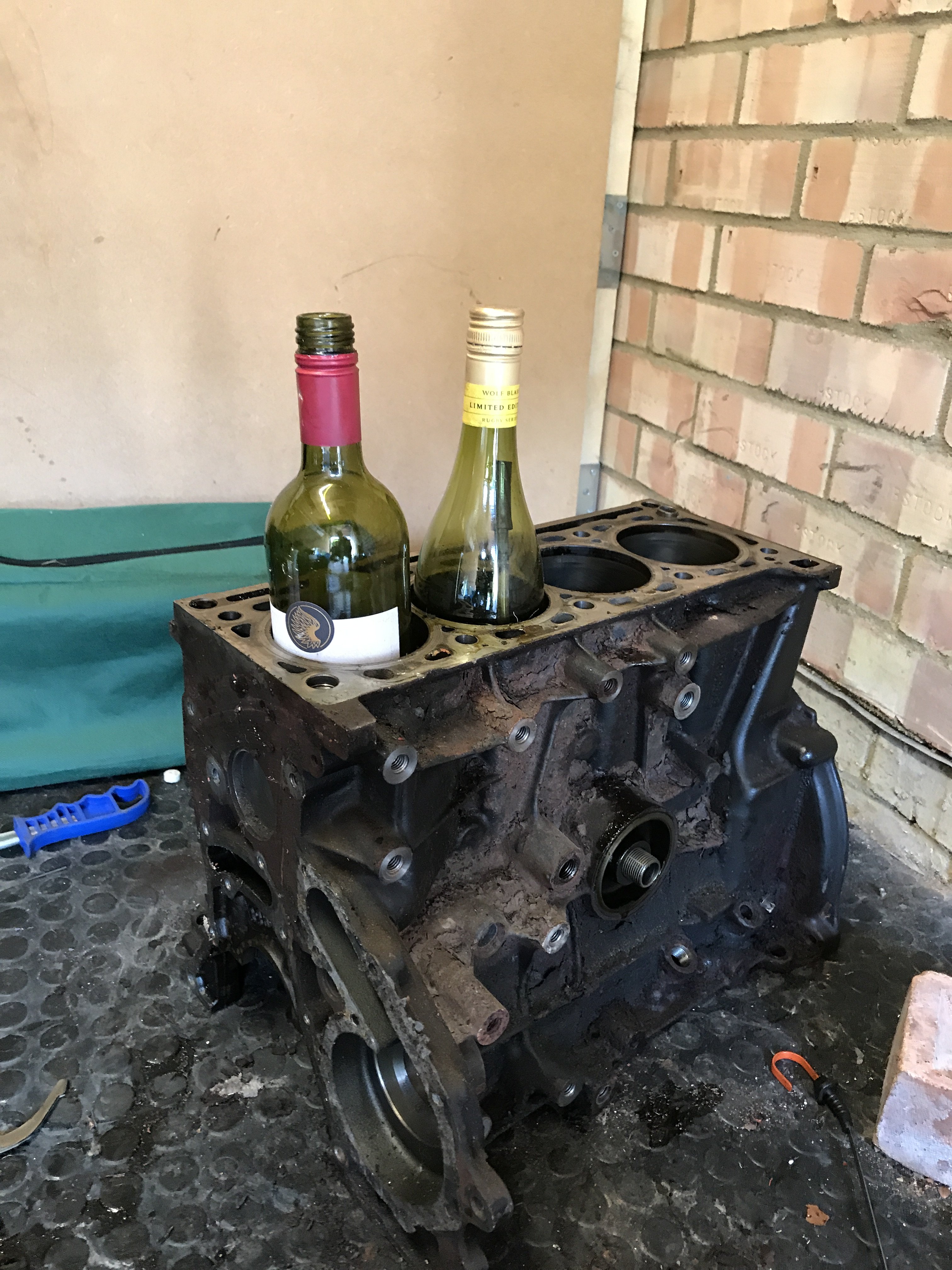

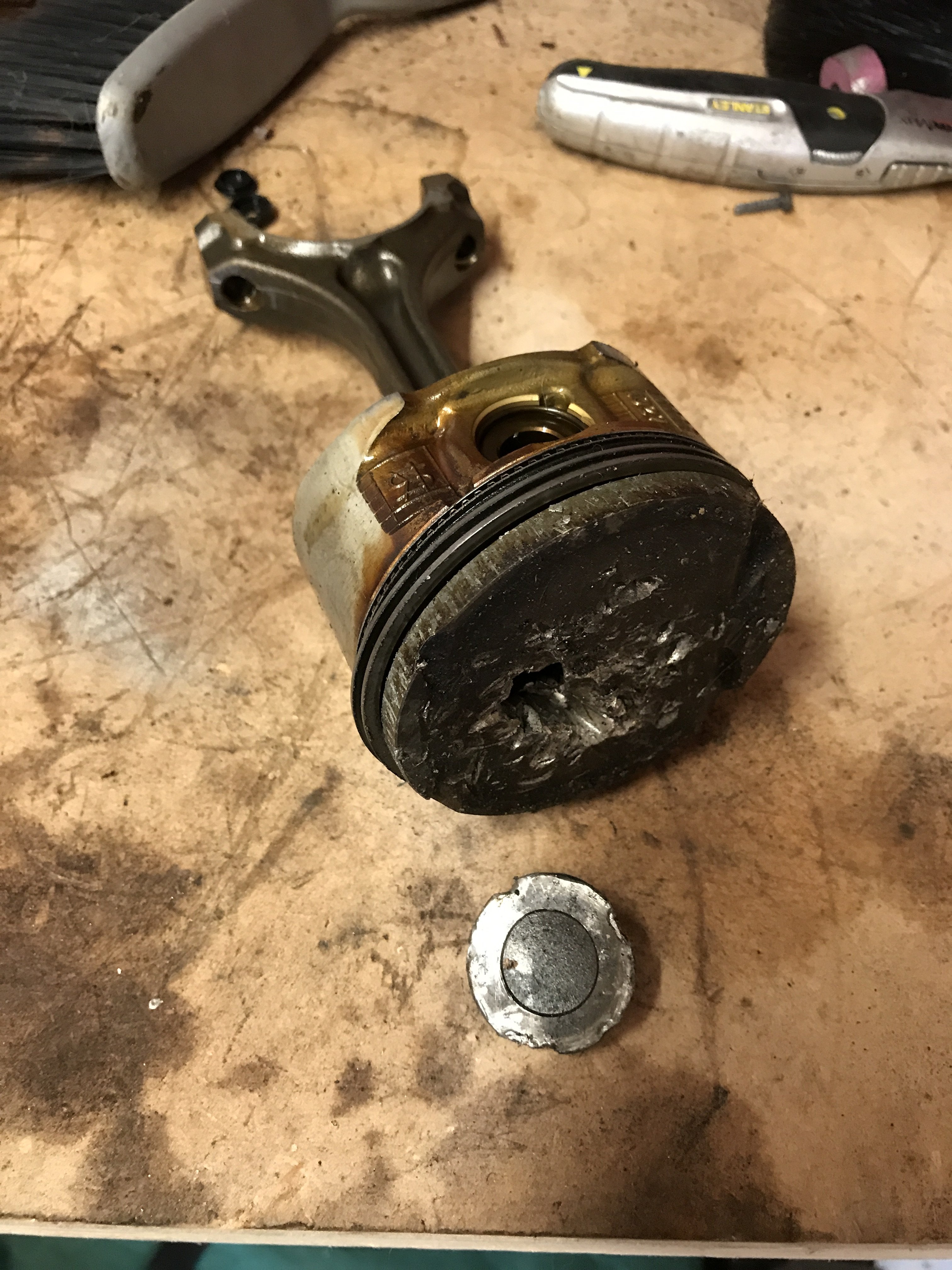

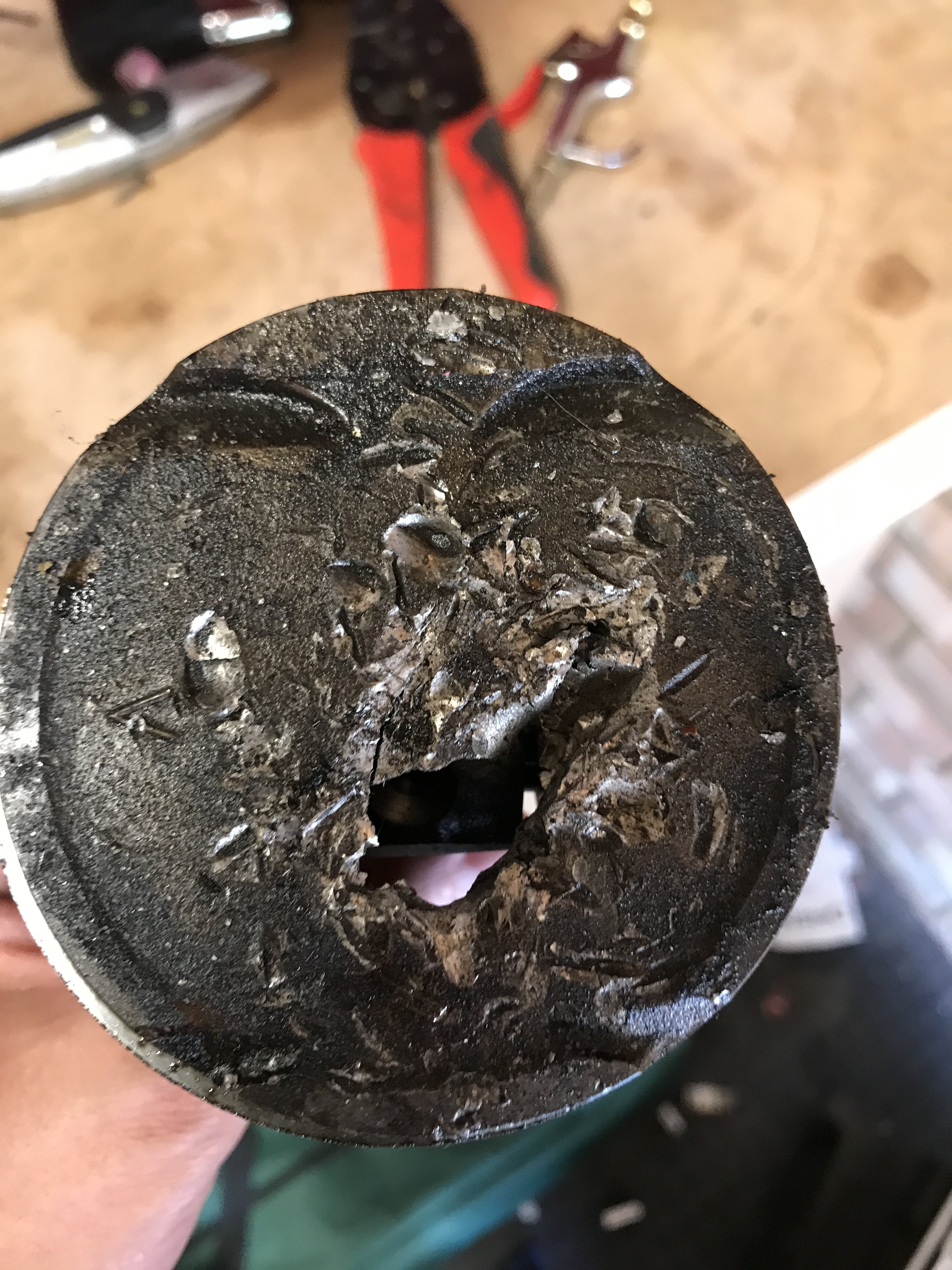

Also I've finally had time today to strip the old engine down. Absolutely convinced the cambelt change cause this to happen.....
Still I'm looking forward to completing this little side project and having it in the new extension..........

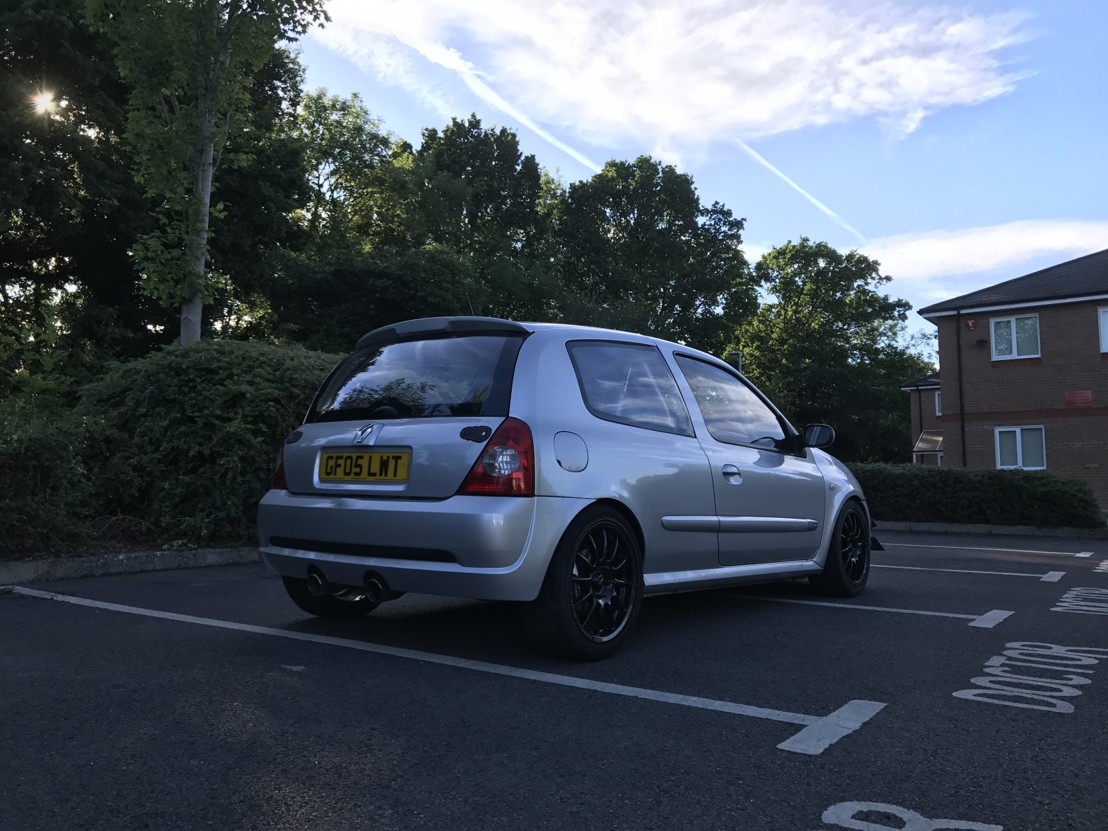

Dreaded MOT time! Spent some time sorting out a few light that didn't work. Rear number plate was interesting as it wasn't the lamp, it was the connection in the bumper that had got wet and had corroded.
Standard front number plate on and a few other bits and it........... passed!

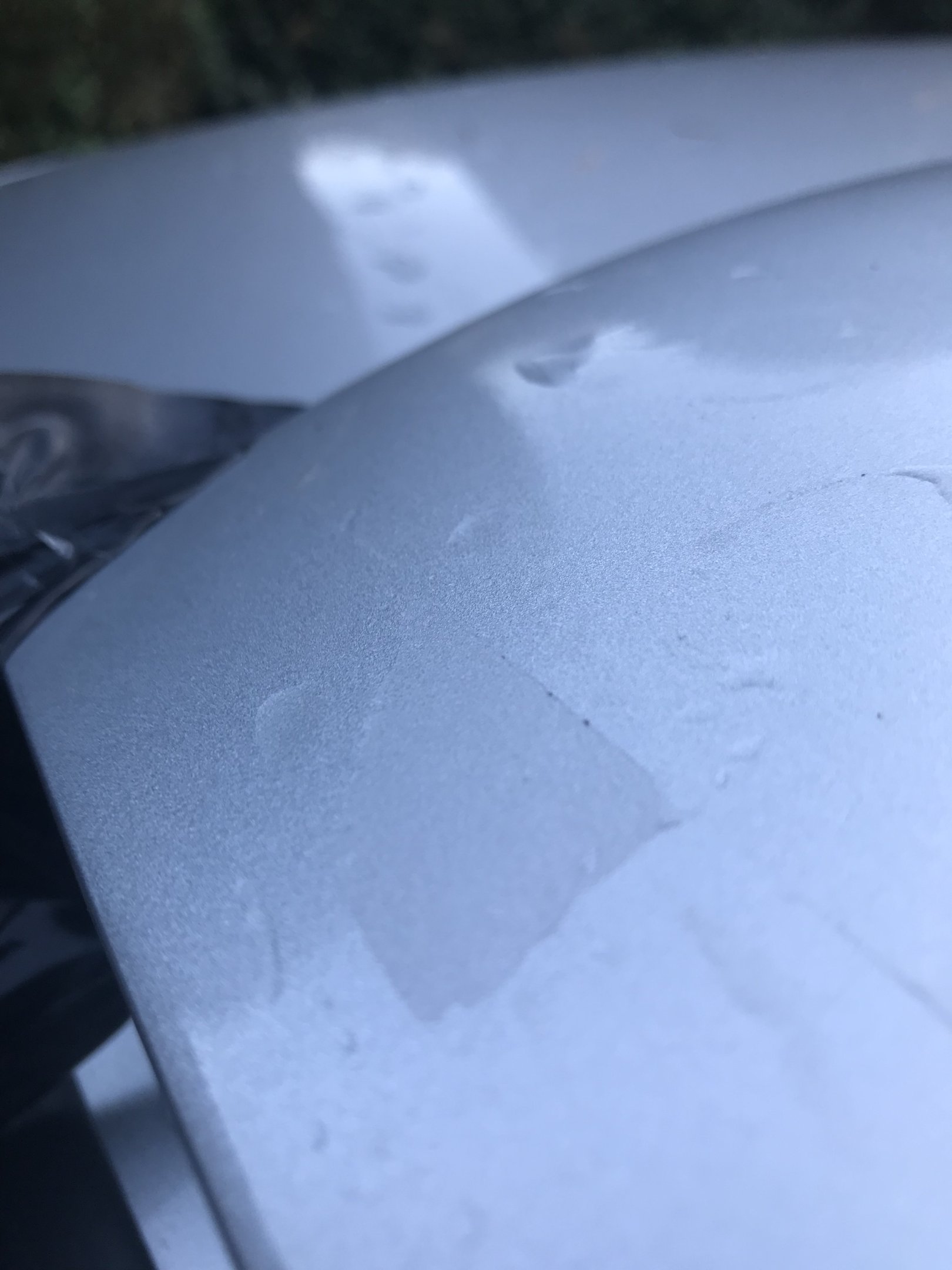

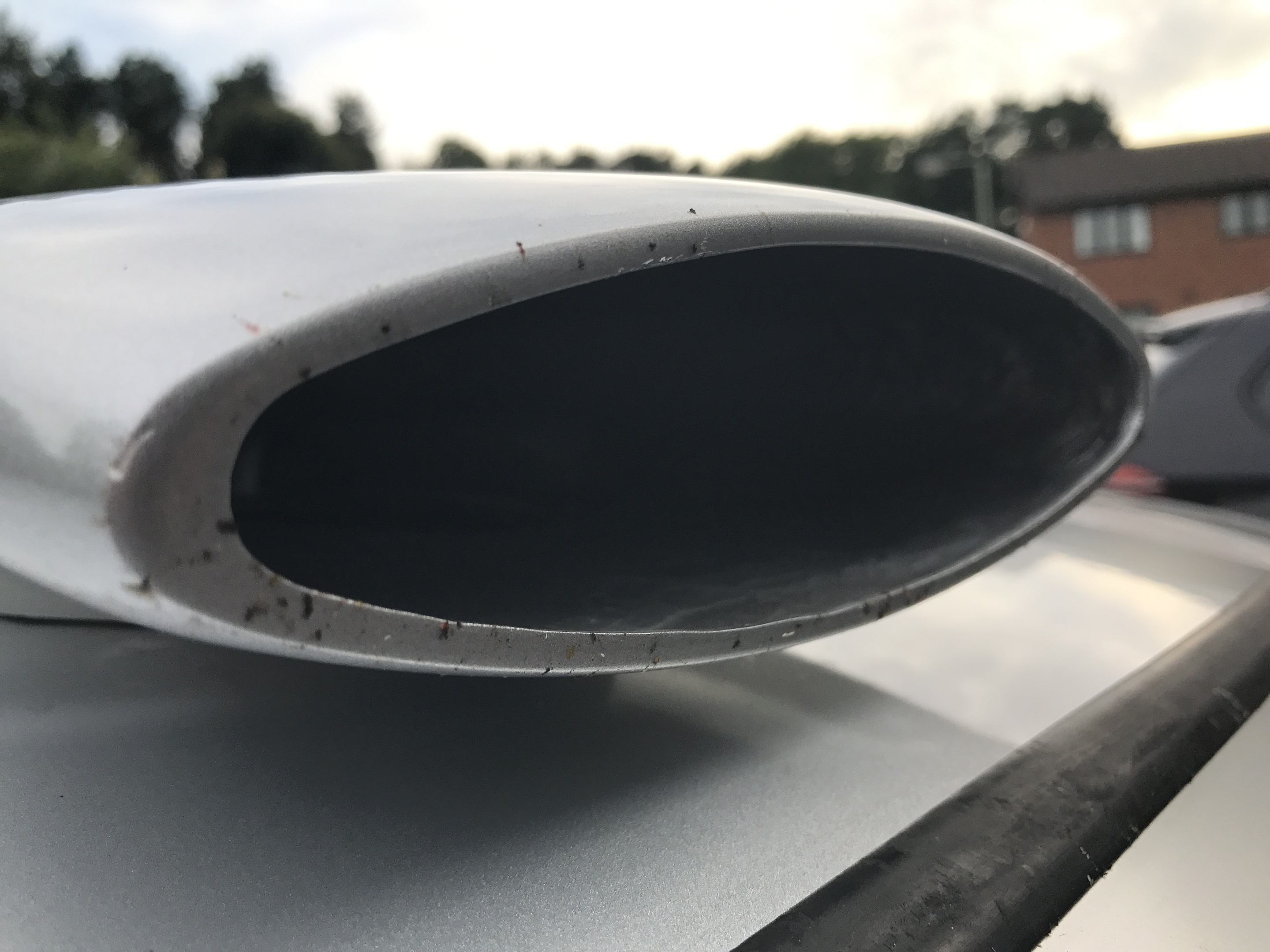

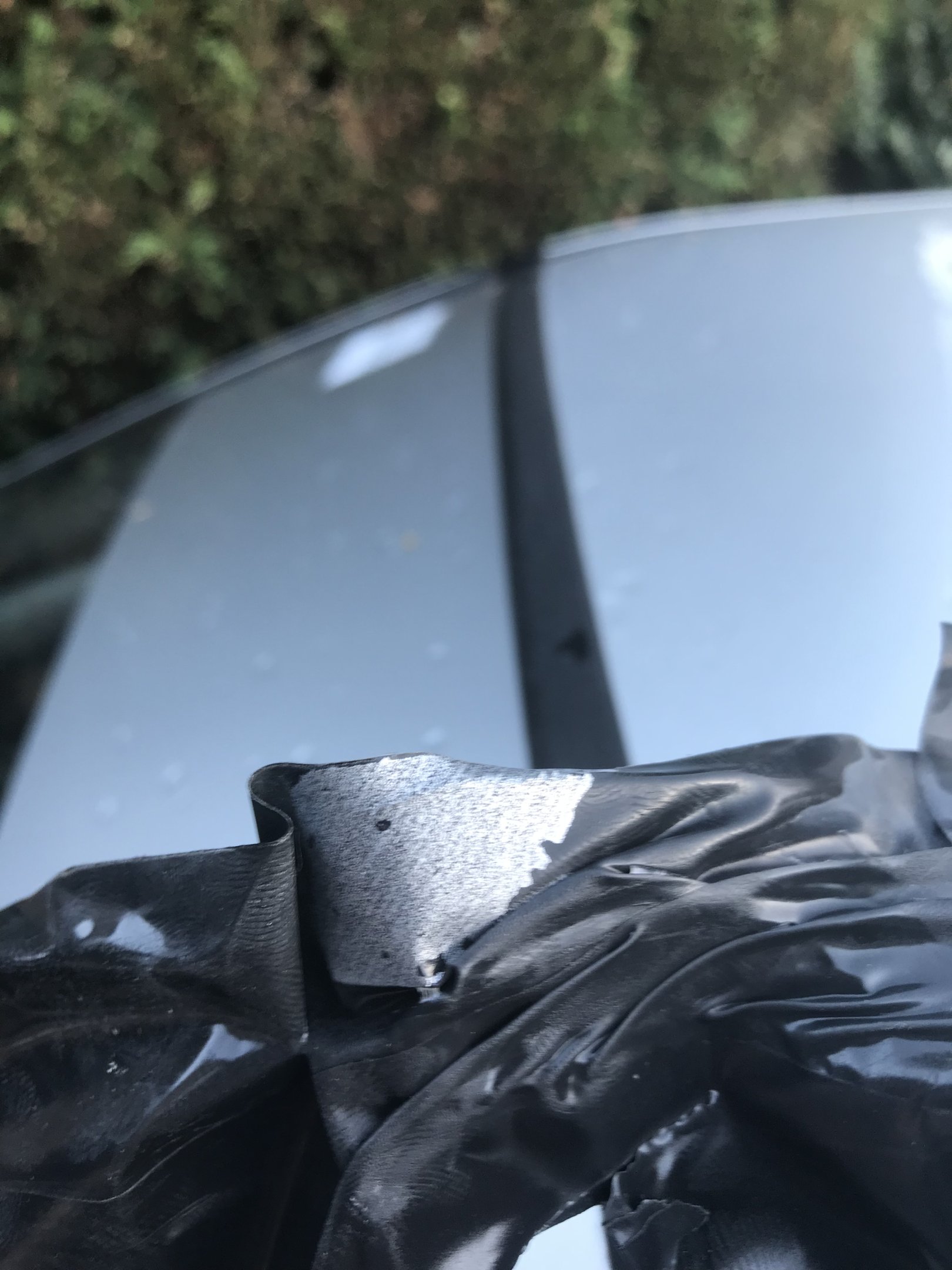

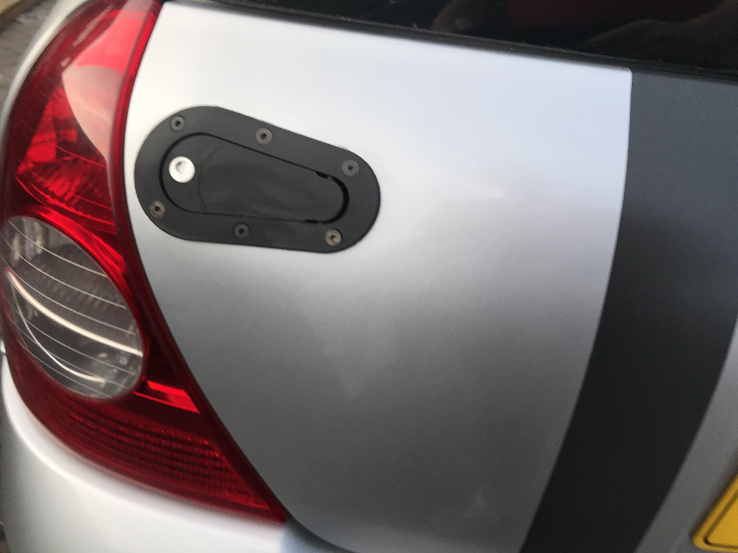

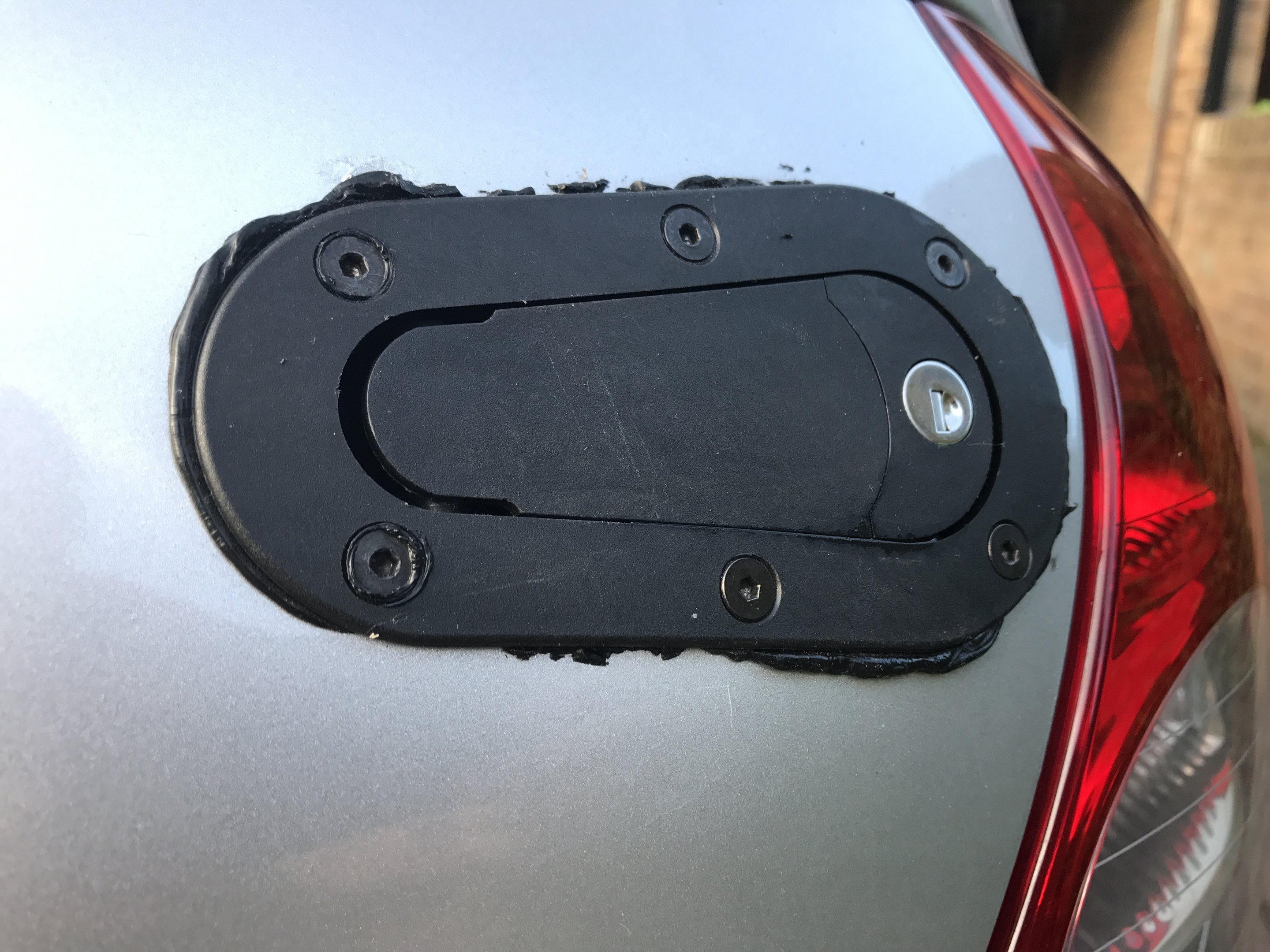

Time to clean it up and sort one thing that I regretted ever since the winter rebuild and the reason I never shown a photo of the rear of the car
Due to the aero catch being on a bend I put some black sealant around each latch. Bad idea as this splurged out and made it look rubbish! I tried to pick it off but is pulled abit of the paint off!! So I left it as it was so I could calm down and sort the mess out with a little patience. So today was the day and result, it's all off.....
So it's all shiney now

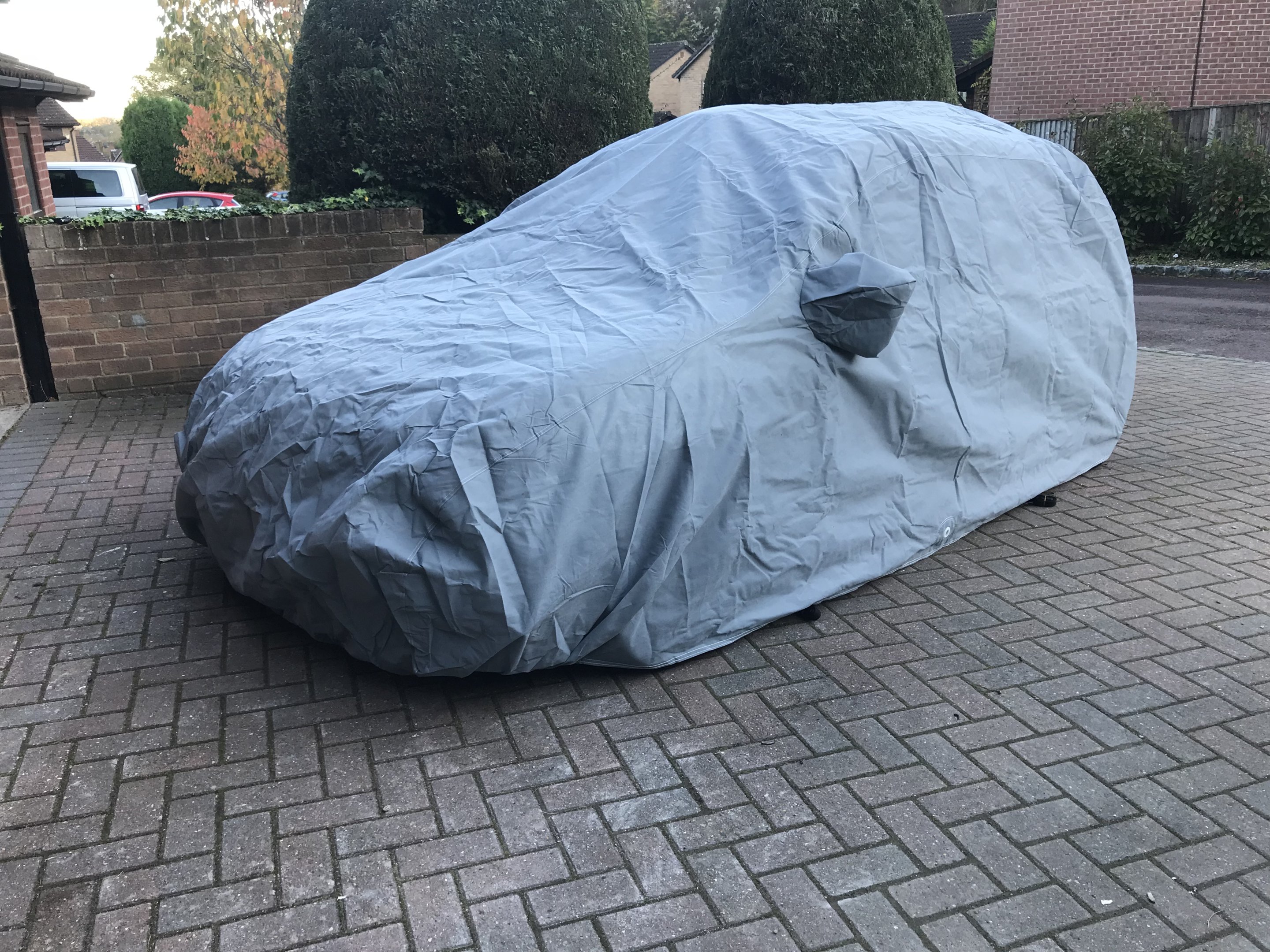

And under a cover ready for the 16th Oct. Just need to convince myself to spend some money on the an ARB before we go.....

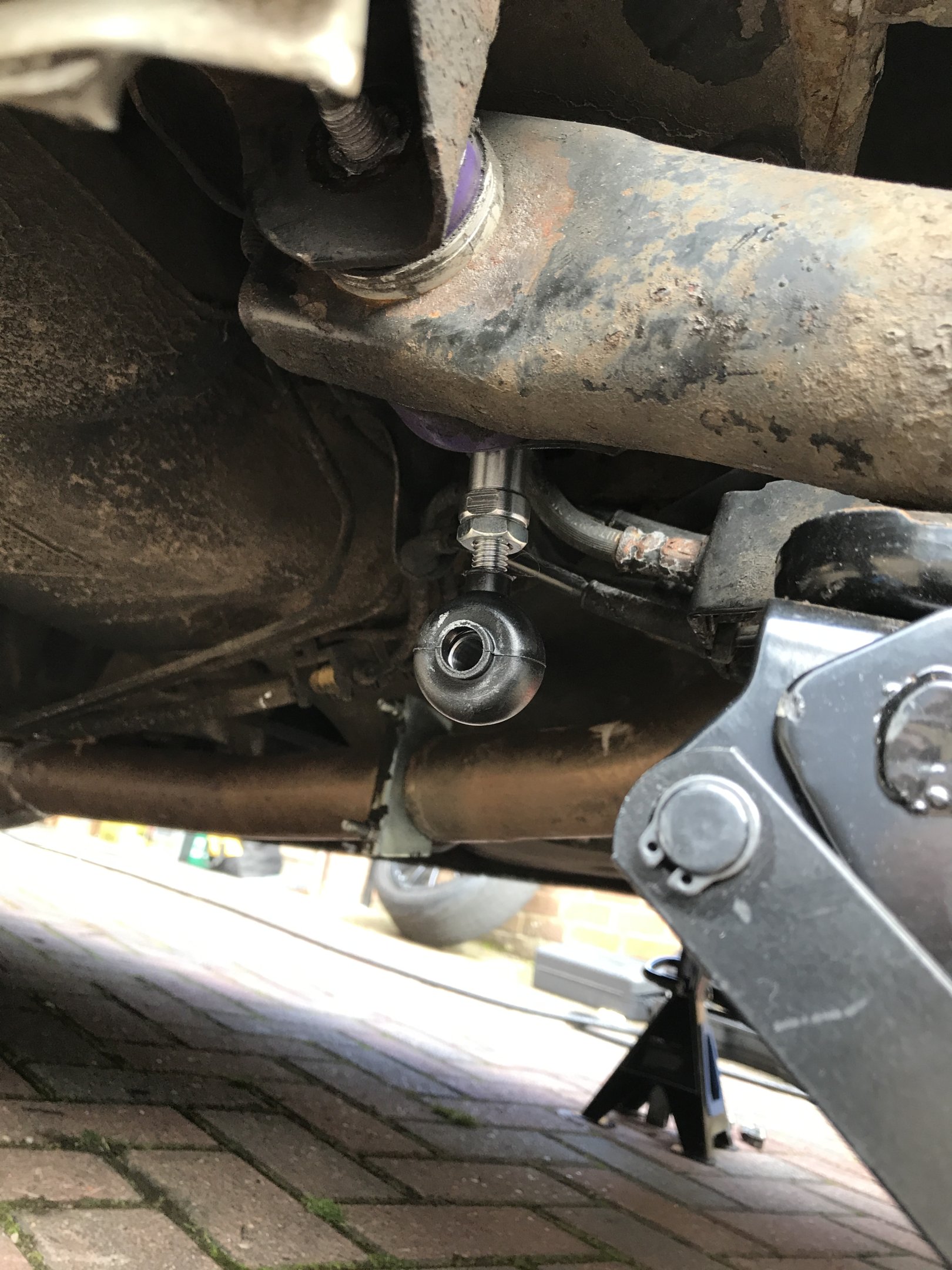

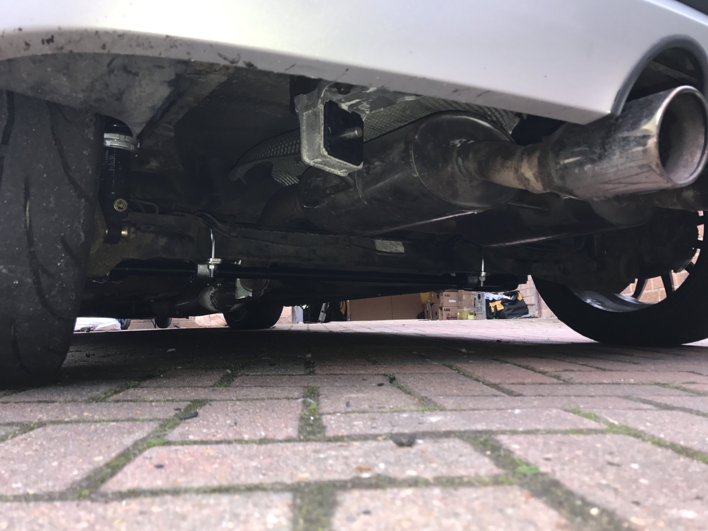

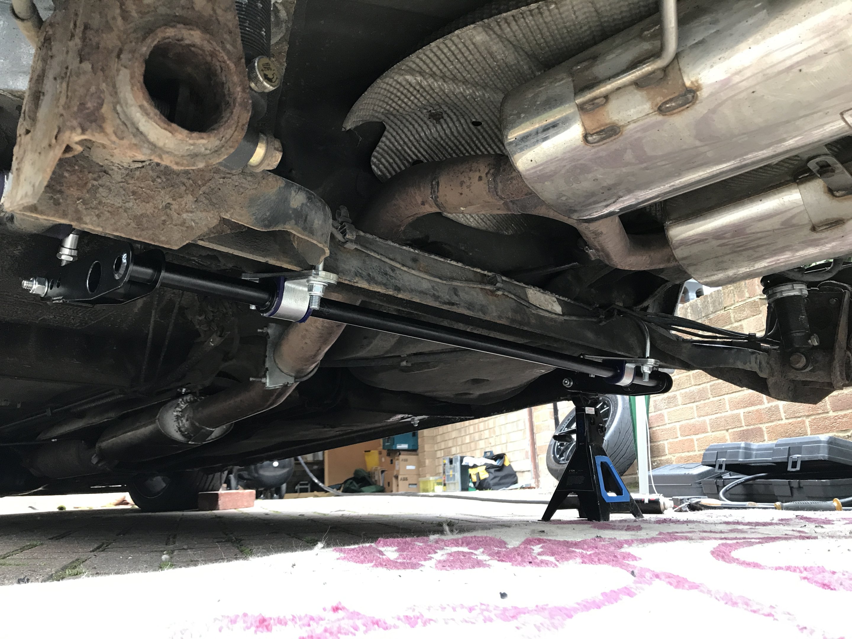

Result, I convinced myself (and the wife!) I needed the ARB so an order was placed with PMS and the following day a 22mm antiroll bar arrived.
It wasn't suppost to rain today but shortly after the car was in the air it started to so up went the gazebo!
I opted for the rubber protectors for the drop links.
Turns out it was relitivly easy to fit so after a few hours I was finished.
I've gone for the lowest setting and will crank it up if I need to.
Can't believe I've spent all this money over the past year making the car lighter and now I'm bolting big bits of metal to it!

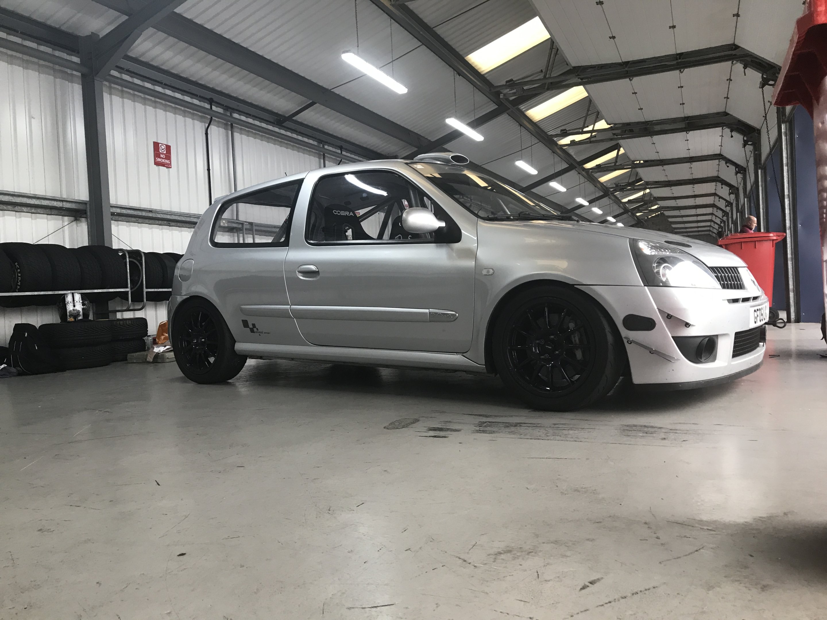

The night before the trackday.........:grimacing:

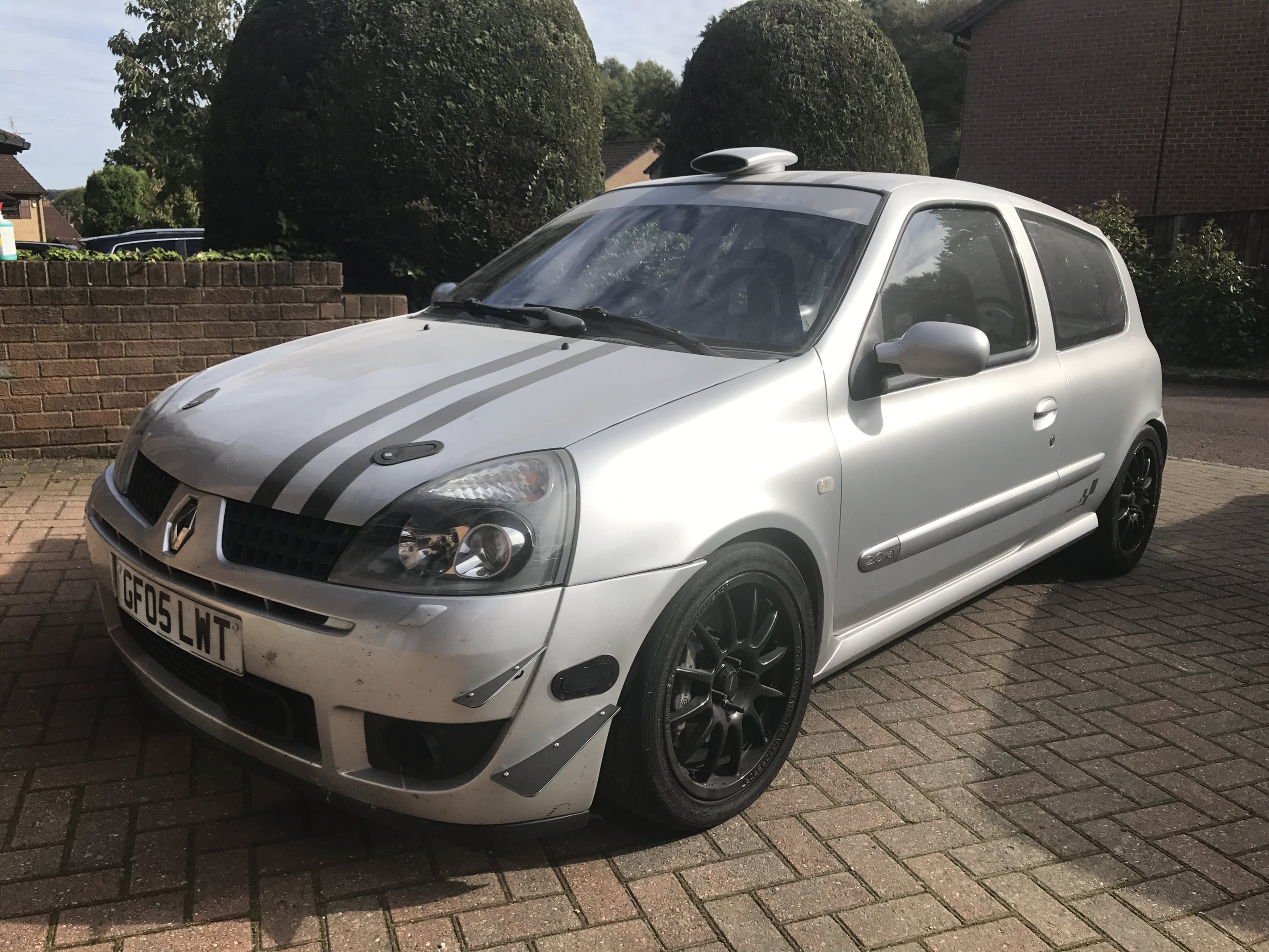

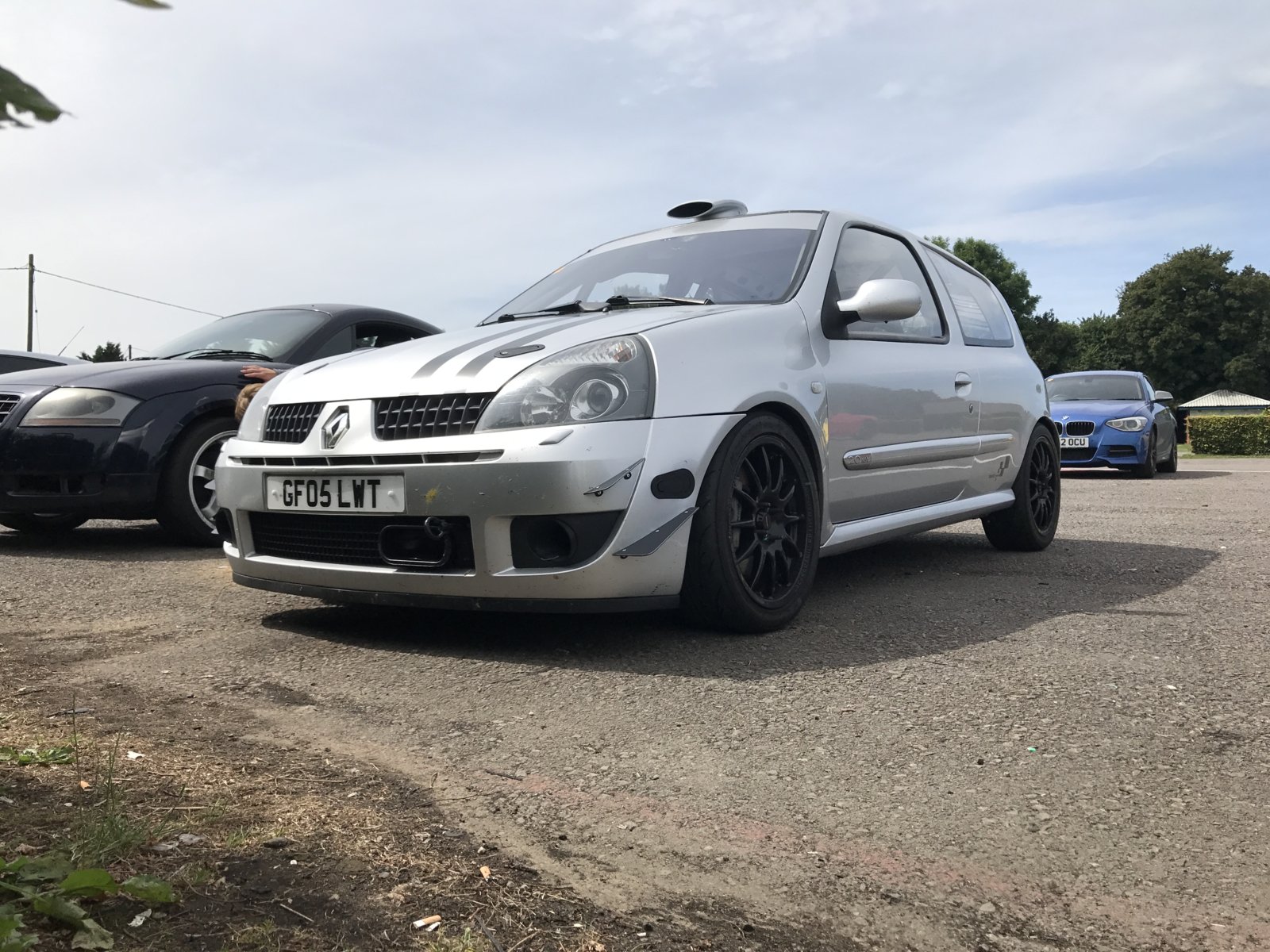

Got the Clio out to find out it's covered in dust again, so I dusted it! Checked all the levels and is all seams in order. Put some air in the tyres as they were down at 18psi from the last trackday. Then I managed to carry out a couple of jobs that should gain me at least 5 seconds a lap.....

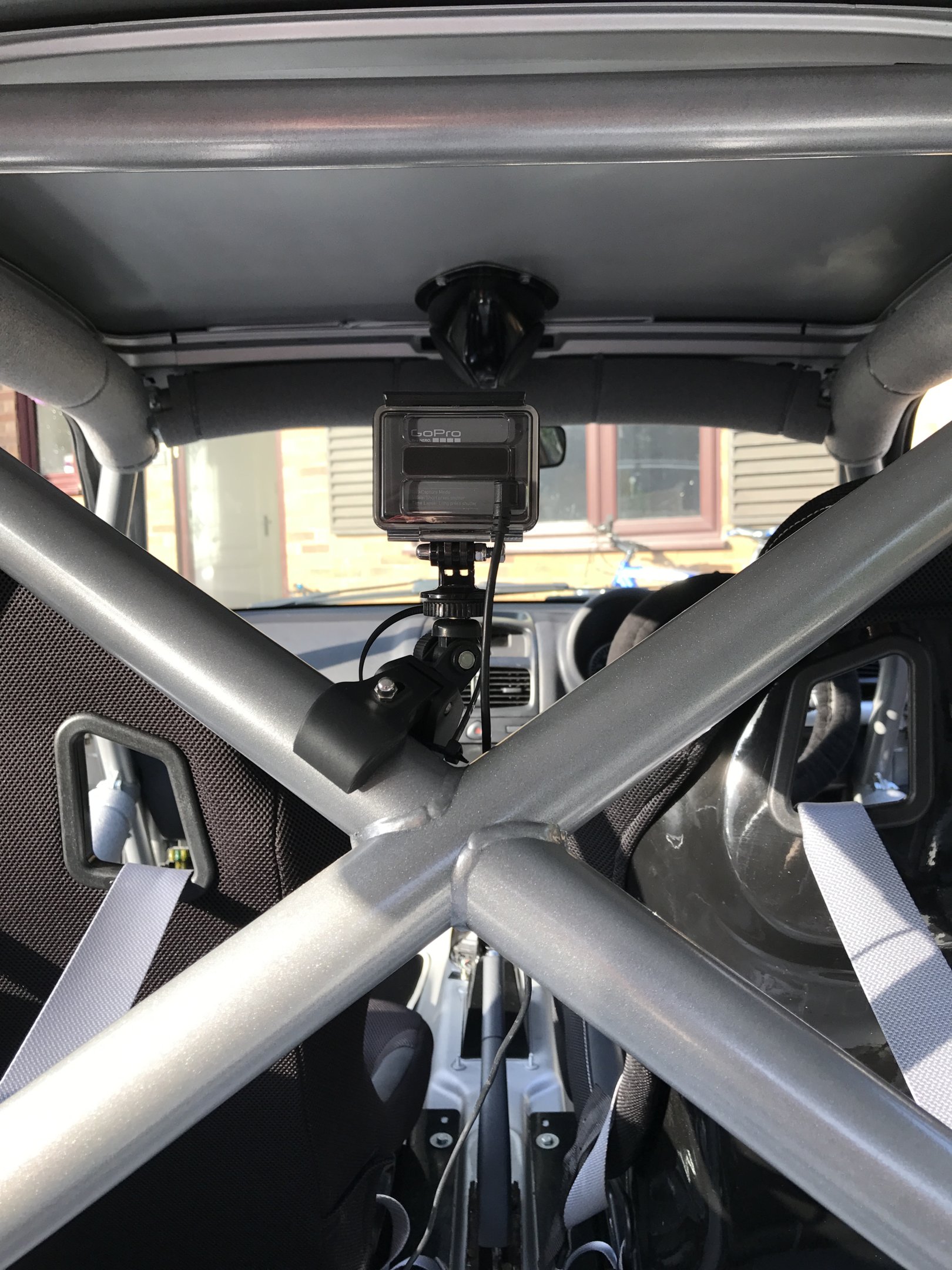

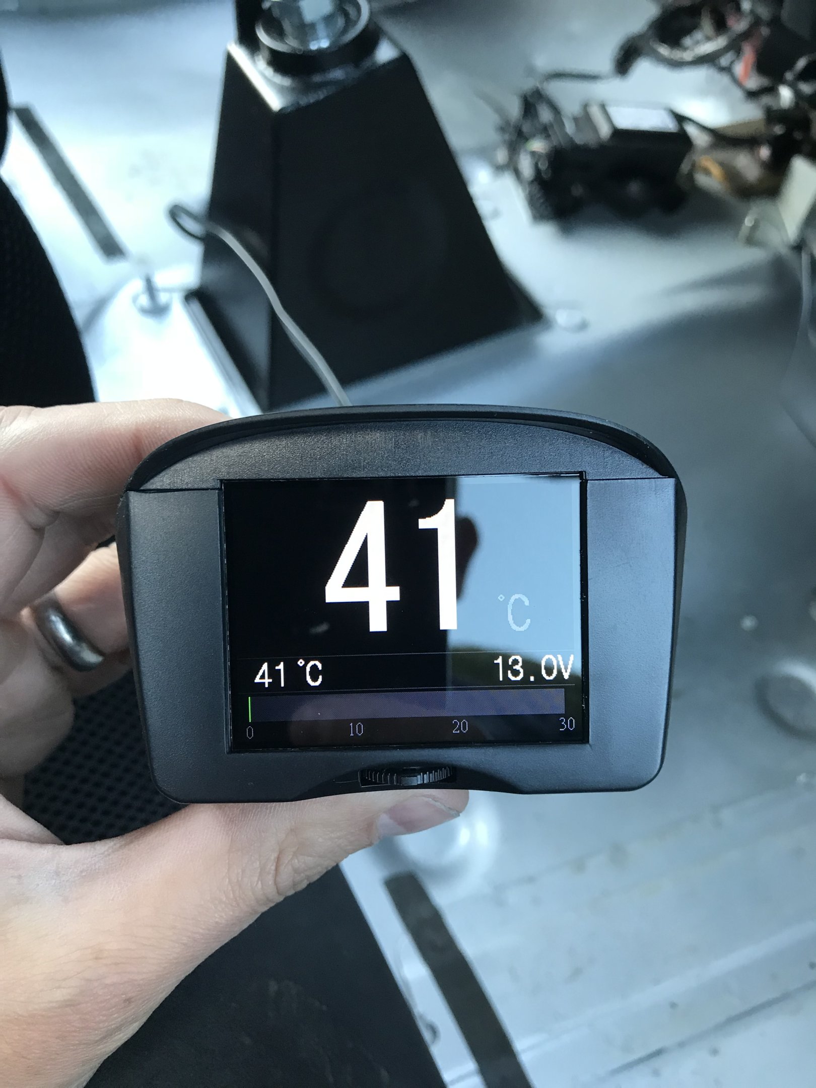

First was fit a perminant to feed to the GoPro. At Castle Combe it was flat by mid afternoon. So I missed all the faster laps at the end of the day. I dug out the old cigarette lighter and run a cable around the passenger seat to the middle of the roll cage. I can also reach this so can use it for satnav and charging the phone etc

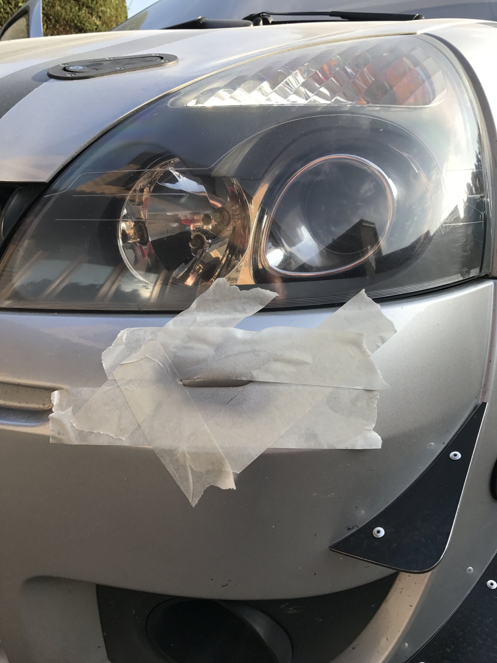

Then the big one! I touched up the headlight washer blanks as I went a bit crazy with the jet wash last time I cleaned it. Felt like a 'chips away' paint man 😂
One more change I made was to soften the coilovers by 5 clicks. I always moan how hard the ride is on the road but have never adjusted the coilovers. We will see how we got on on the way up tomorrow.

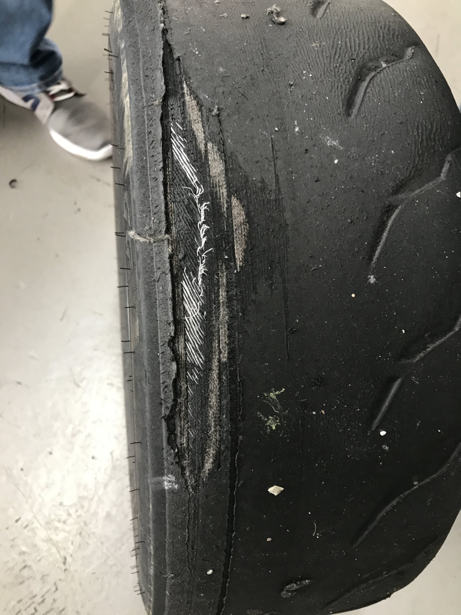

This was a tyre that came of the blue car (NS2Rs are fine on my car!)

The new rear ARB has changed the cars dynamics completely, it's so much more playful as you can make it oversteer and understeer at will! This is apparent at the corners after 15.05 on the first video:tearsofjoy:

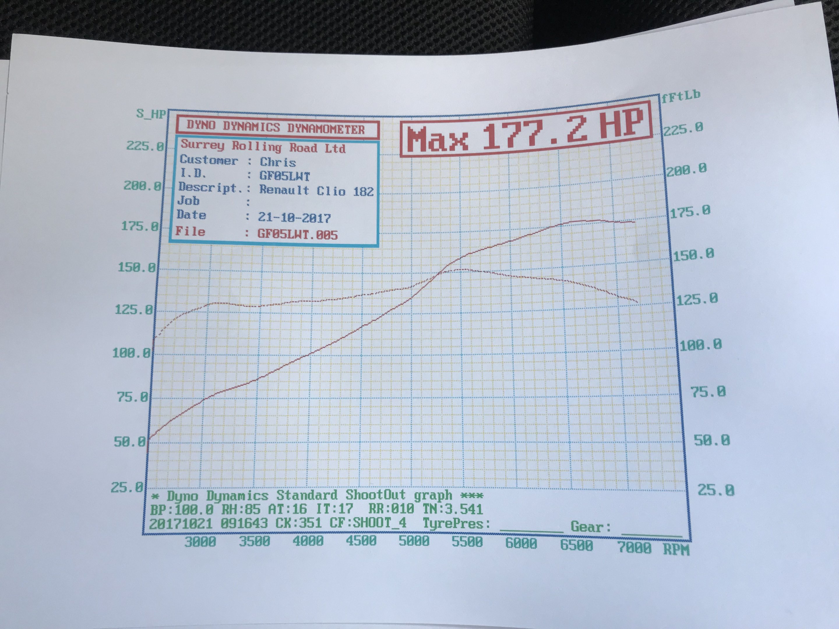

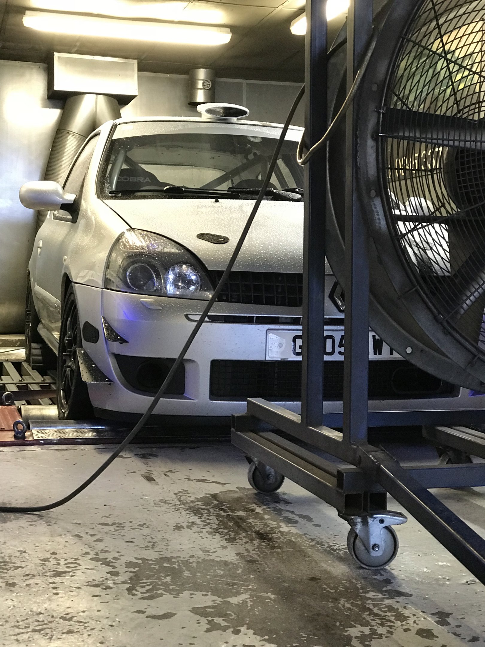

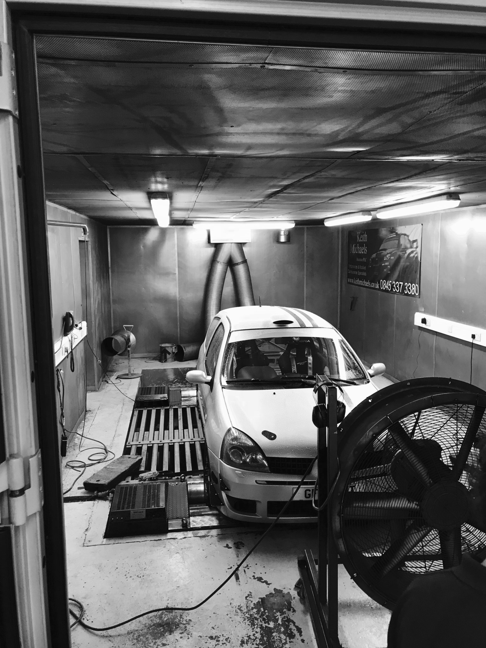

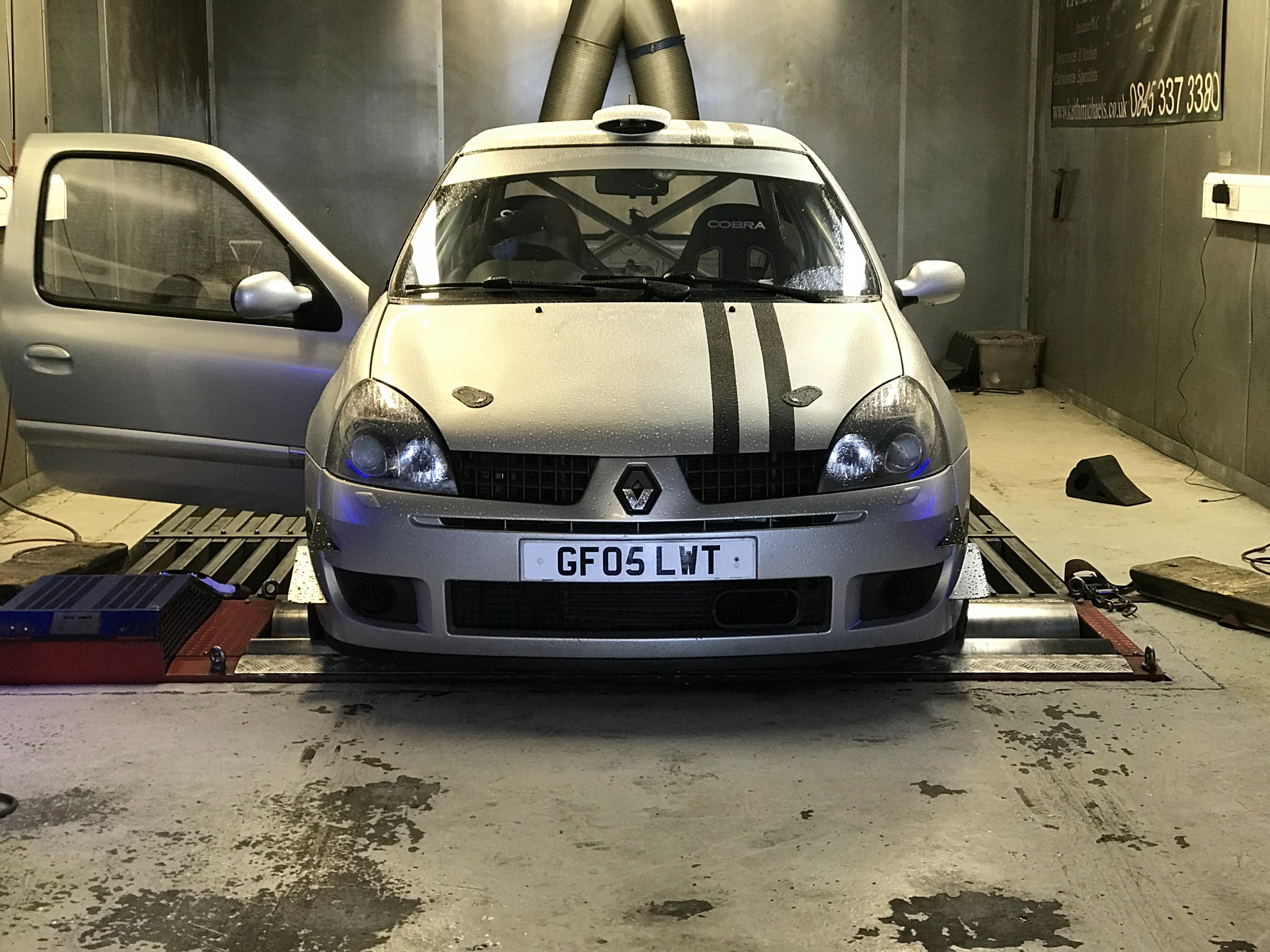

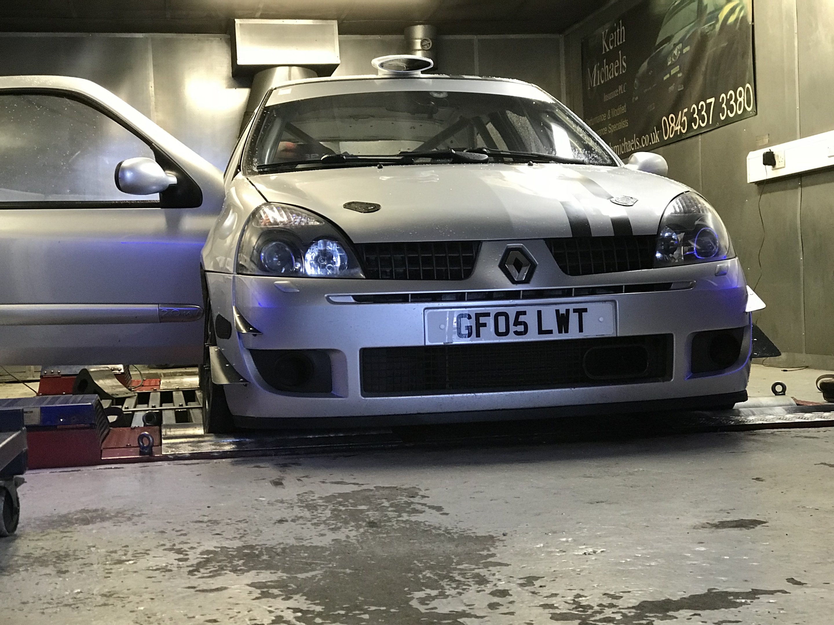

To bring to an end a busy week for the Clio we went to the group rolling road today. First of all it chucked it down on the way there resulting in the roof vent becoming a roof shower! Still we made good time and got there first.
Getting there first didn’t help as it turns out! After a golf and another Clio went before me it was my turn. I would have been genuinely happy with 165ish as remember this is an engine off of Gumtree, an exhaust off of a rolled clio and an induction set up bodge together by me!
First run was 174 bhp! Happy days but the rolling road man was shacking his head. I couldn’t hear what he was saying so just looked on. Turns out my car ended up doing 6 power runs!
The reason - when I got there early the car had cooled down. When the clio detects the oil is cold it pulls back the redline by a few hundred rpm.
So when the car had warmed up it knocked out the following.........
Happy days!
I watched a fair few more with some interested results and have now decided the next big upgrade is...........
A LSD and not power upgrades for the engine. I like this engine, it works! I’m just going to service it and looks after it .

Cheers, it was a nice day out. I have never done one before so didn’t know what to expect!

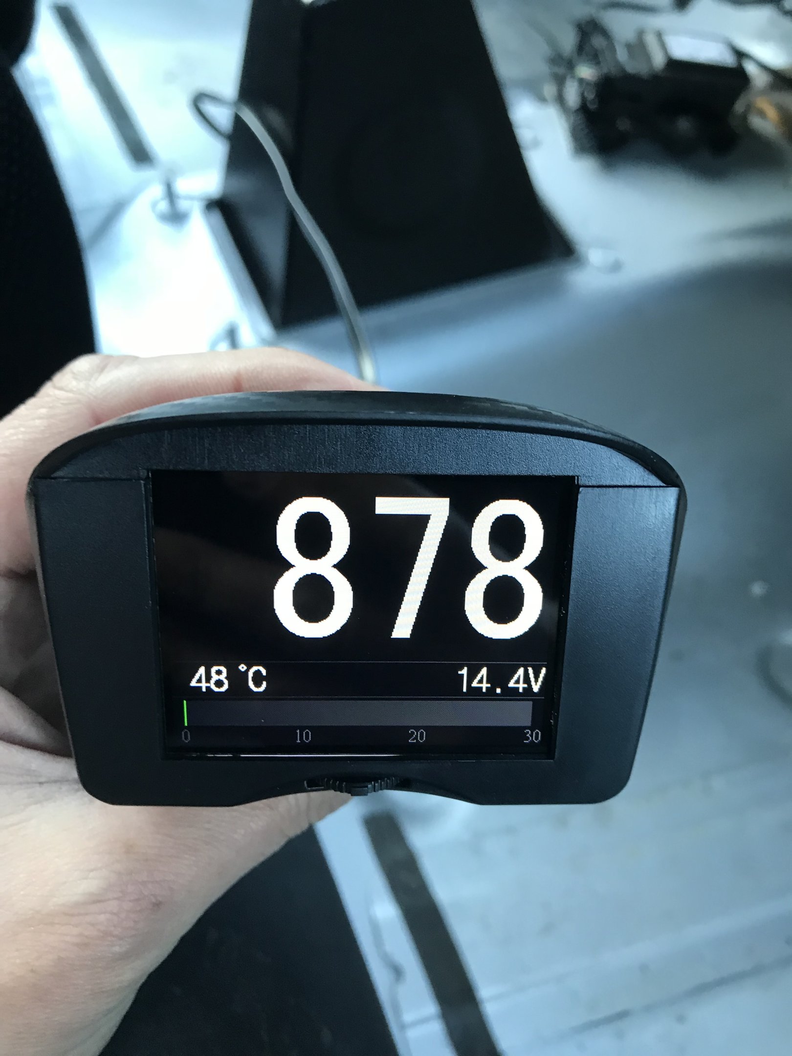

Randomly I got talking to a guy at work during the week and mentioned about how the Clio reduced it’s rev limit as the oil was cold on the rolling road. He said he had just brought on of these for his car....
Randomly I brought it on the spot on Amazon. It turned up today and for £30 it works fine. It is basic but it gives you a clear water temp display, rpm reading etc. It does have a limit alarm but the max input is 6000rpm. Also it beeps instead of showing a visual display. This might be just a set up perameter so I will have a play when I get more time. I’m going to mount it above the dash. It plugs into the ODP port and can also be used for diagnostic and some fault resetting allegedly?!

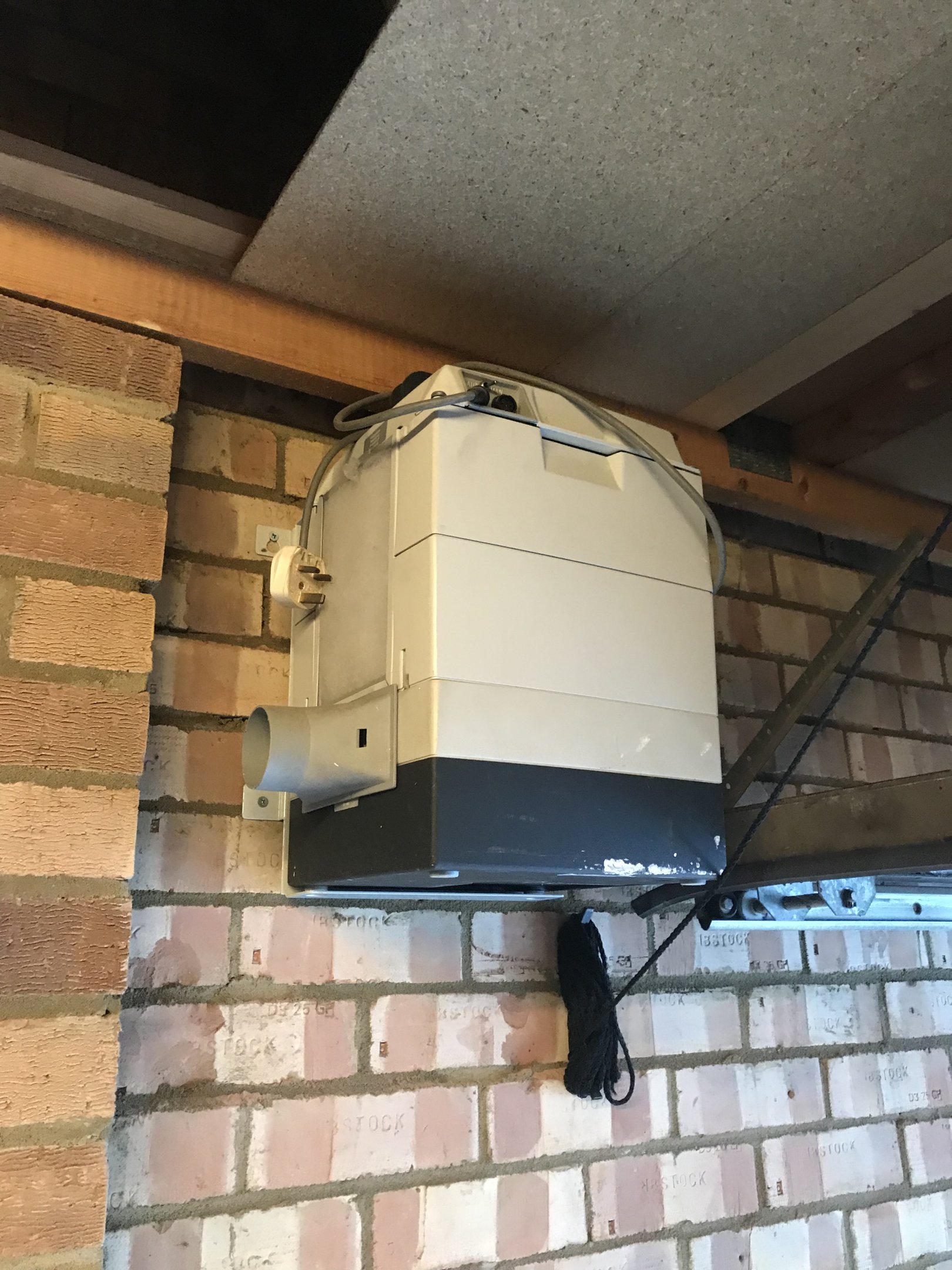

I’m fed up with the car getting knocked about in the garage and getting dirty/dusty so I now have this.....
Also as the weathers starting to turn I might finally get around to getting my dehumidifier working. I’ve spent the last 13 years in the industry dehumidifying ships, tanks, helicopters and planes. I even use to look after Rowan Atkinsons one for his F1. Time to spend some time in one of my machines!
The Clio got demoted to living outside for three weeks whilst the building work was finished off. This coincided with some appalling weather. It’s only a car but these days it’s not the most weatherproof car! I did my best by taping up the roof vent etc. This was all fine until I went to remove the tape and some of the paint came off :rage:
