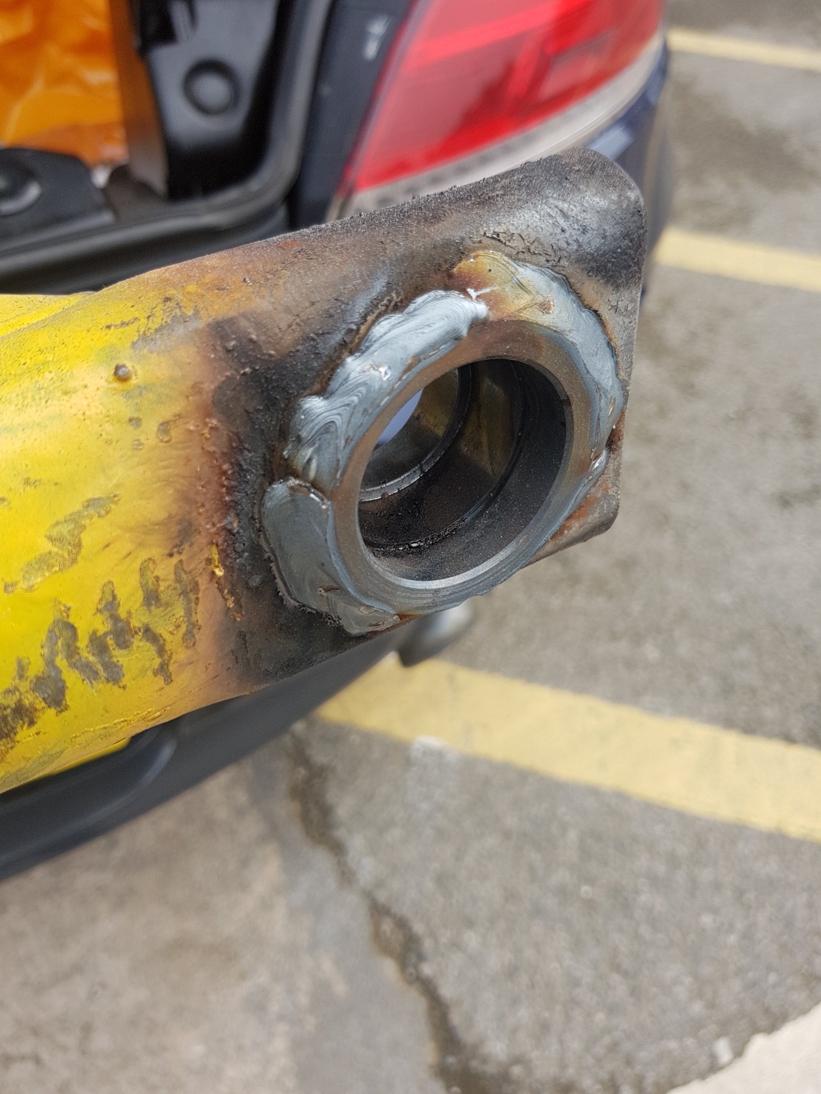

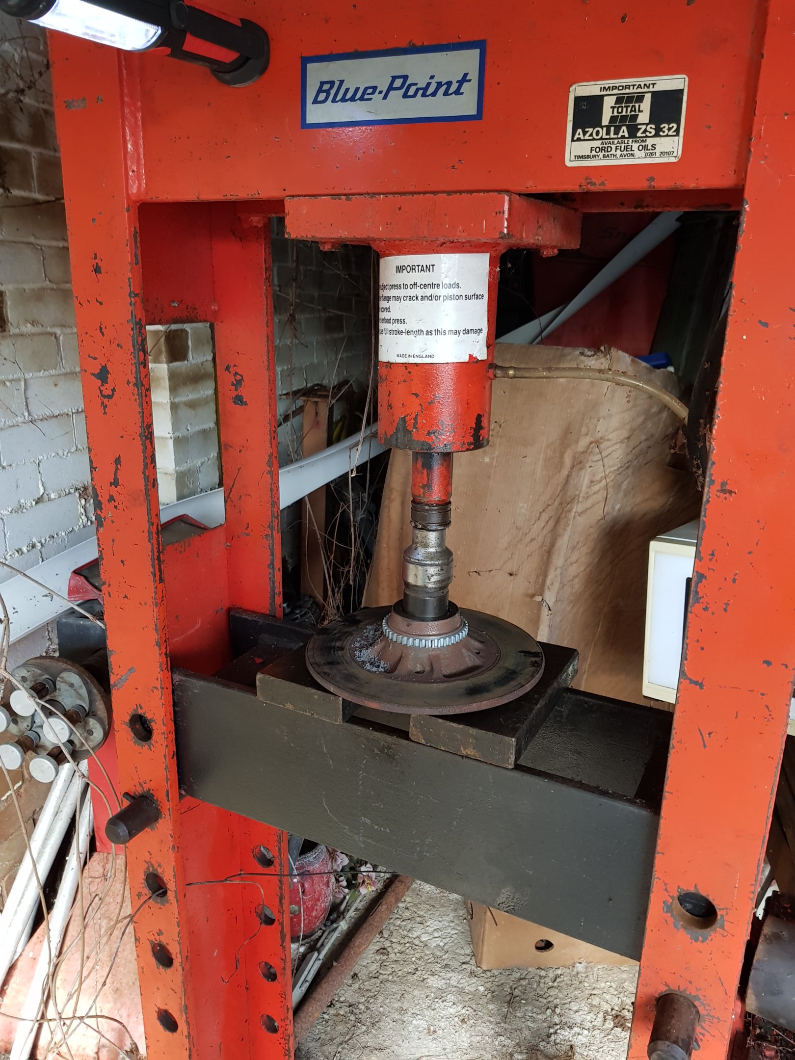

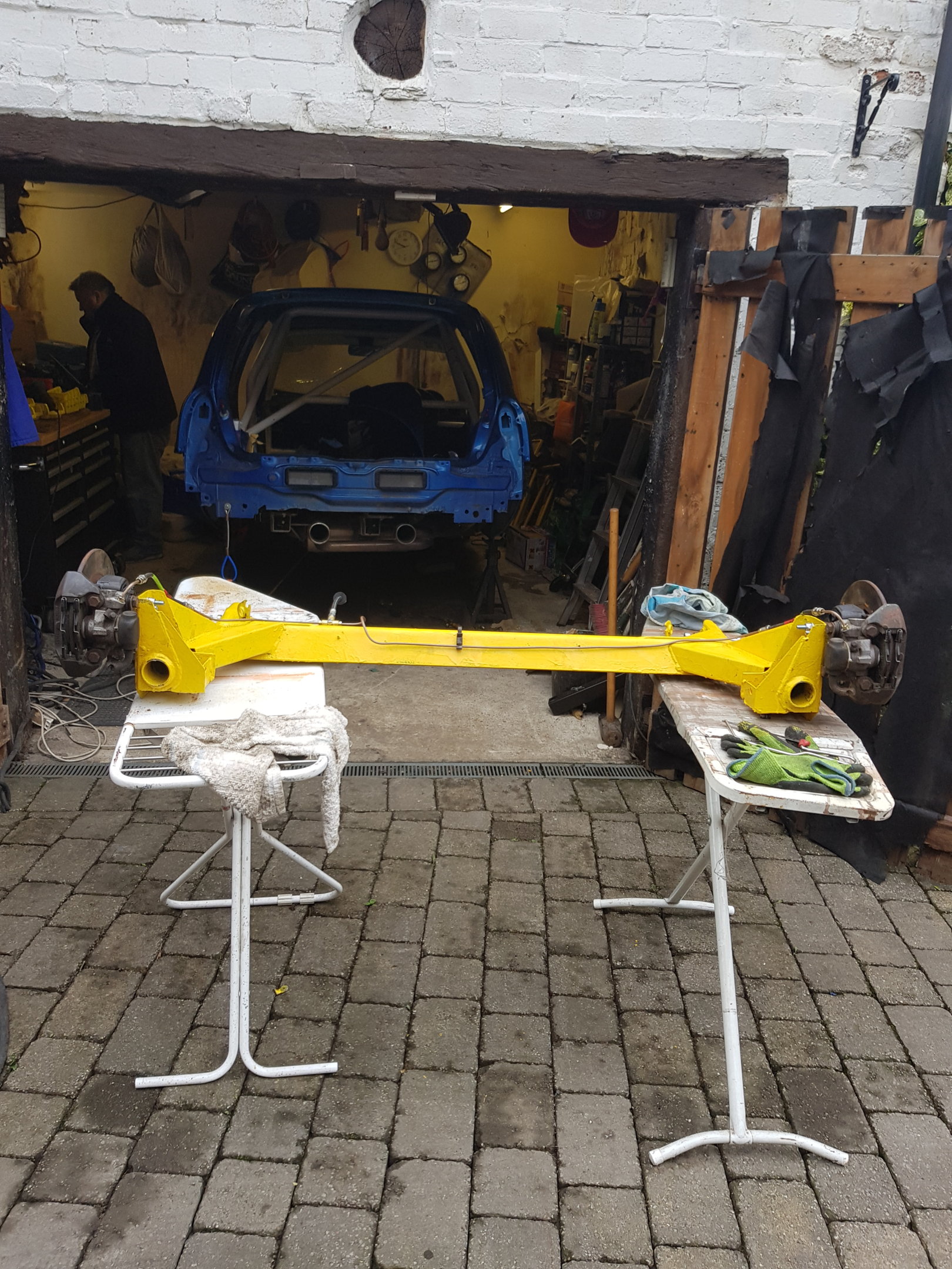

I thought I'd bought new poly bushes for the rear but turns out I hadn't. Looking up costs the bearing conversion worked out cheaper so I pressed out the bushes & housing. Pushed in the bearing housing and had it welded up at the fabricators. Now to drop the bearings in, paint up and fit at the weekend.
