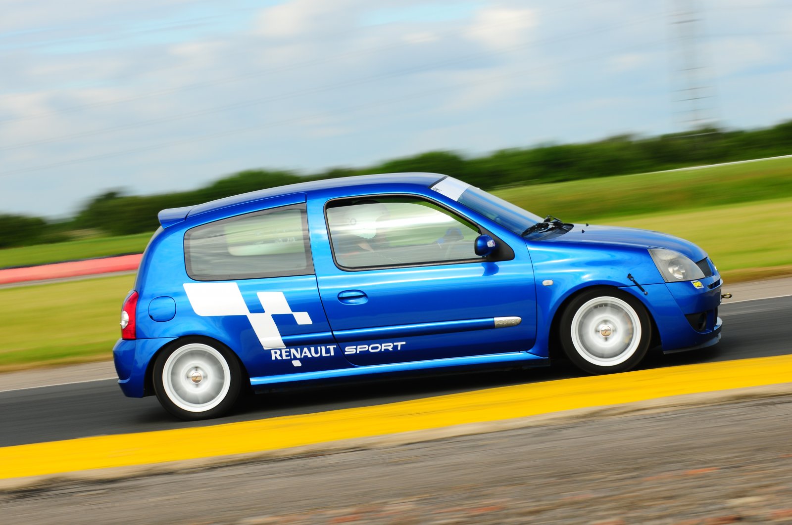

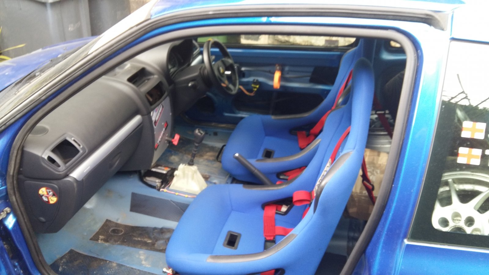

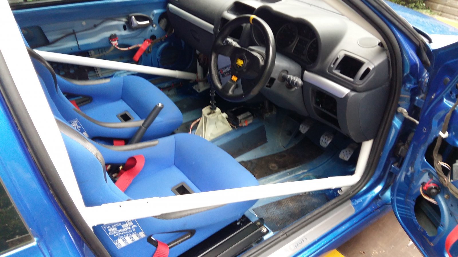

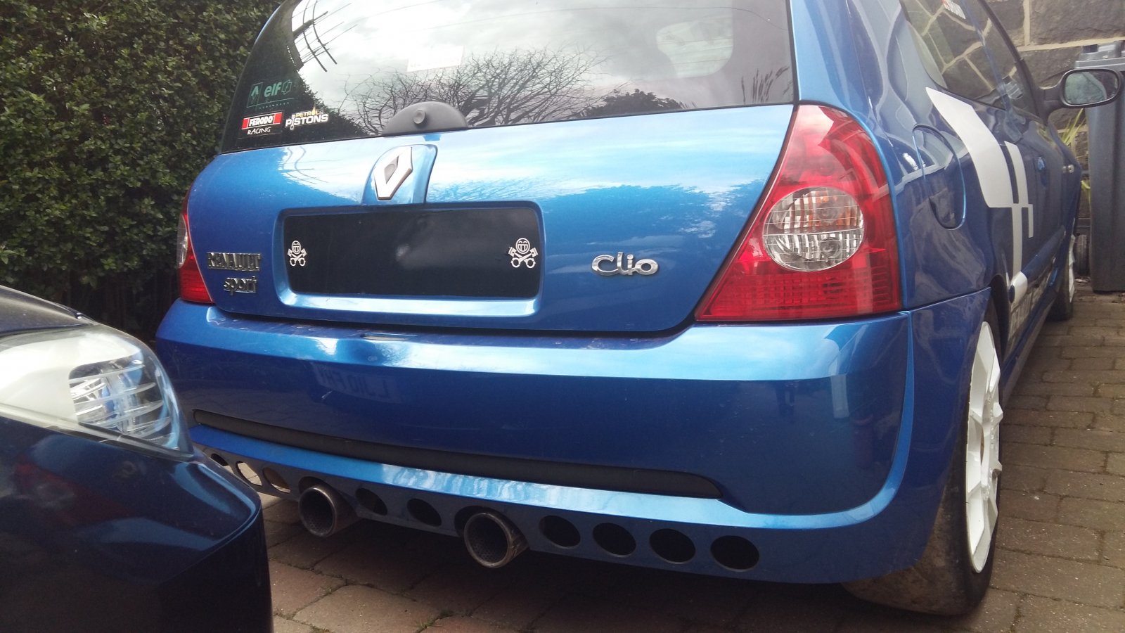

Here's my 182 track car purchased earlier this year, it's not road legal and all of the work done to date was done by the previous owners and so far its a good job.

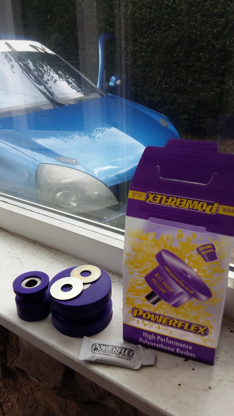

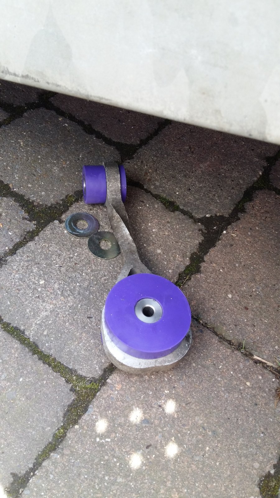

Had my first track day at blyton park in June and it's a lot of fun, the setup is good although the back end drifts a little but that just makes it more fun. One thing that didnt work so well was it jumps out of third on braking, asking around on the day and everyone said it's the engine mounts and this was backed up on the forums. Looking in to it, the engine mounts on top don't seem to have much influence on the forward backwards movement of the engine, which seems like the cause. So rather than fork out the £200 K-tec replacements, I am going to try just the "Powerflex Dog Bone Twisted Eng Mount Bush Kit " £47 off ebay. I'll let you know how I get on.

New bushes for the dog bone

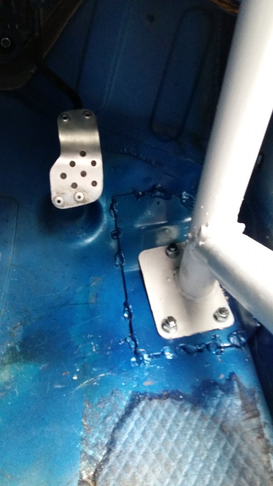

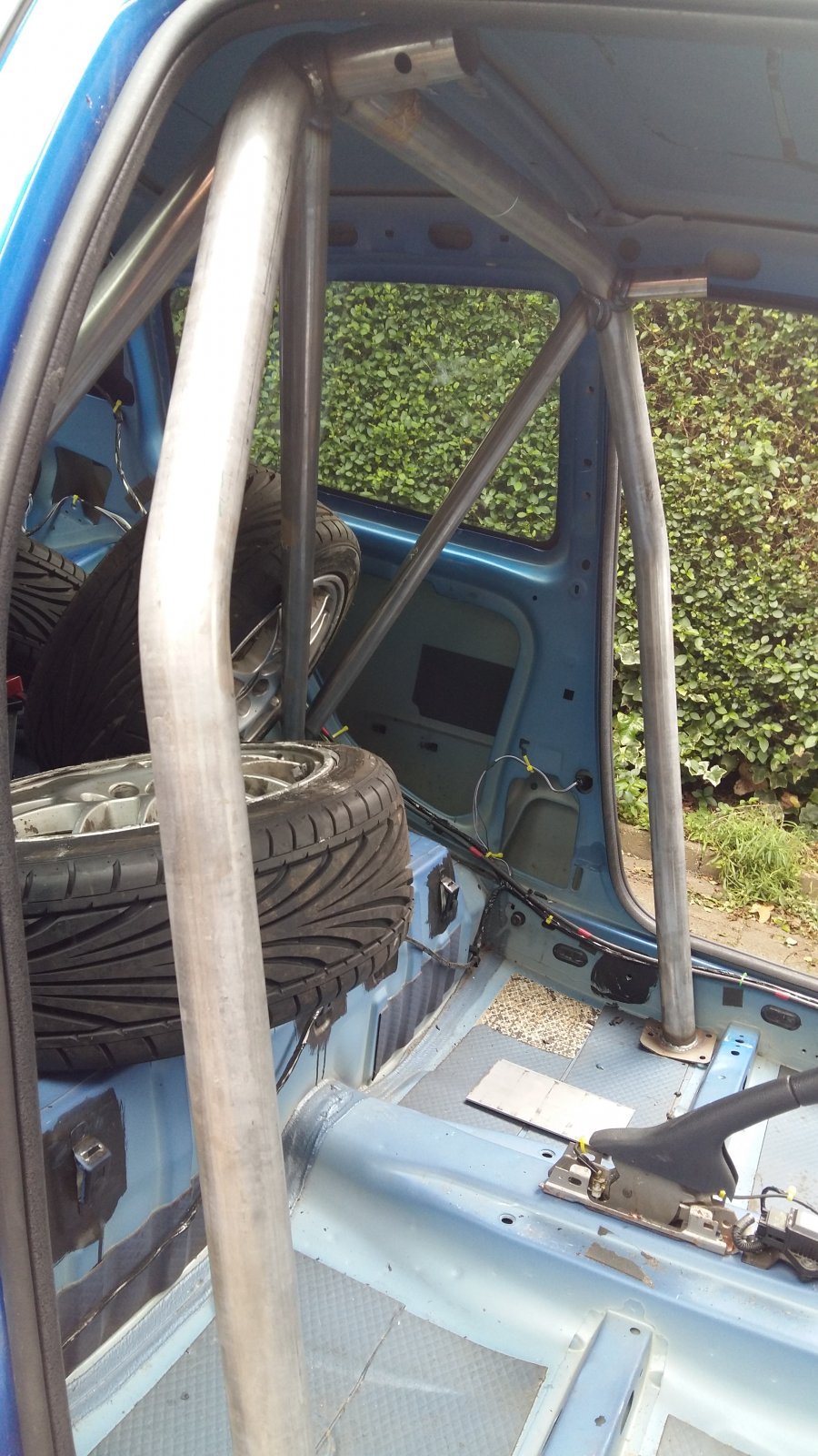

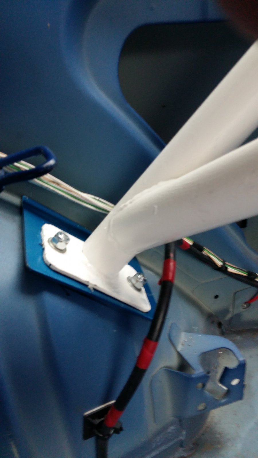

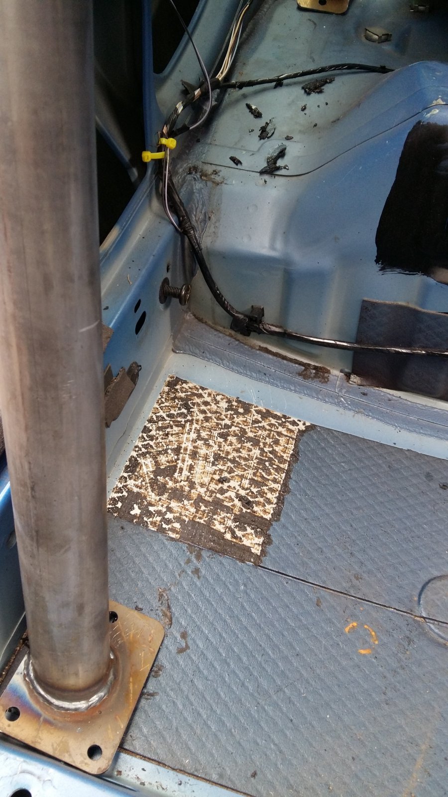

Fitting a full roll cage, you'll see i've knocked away the sound deadening strips in the corners ready for some strengthening plates, need to clean up that area more ready for welding

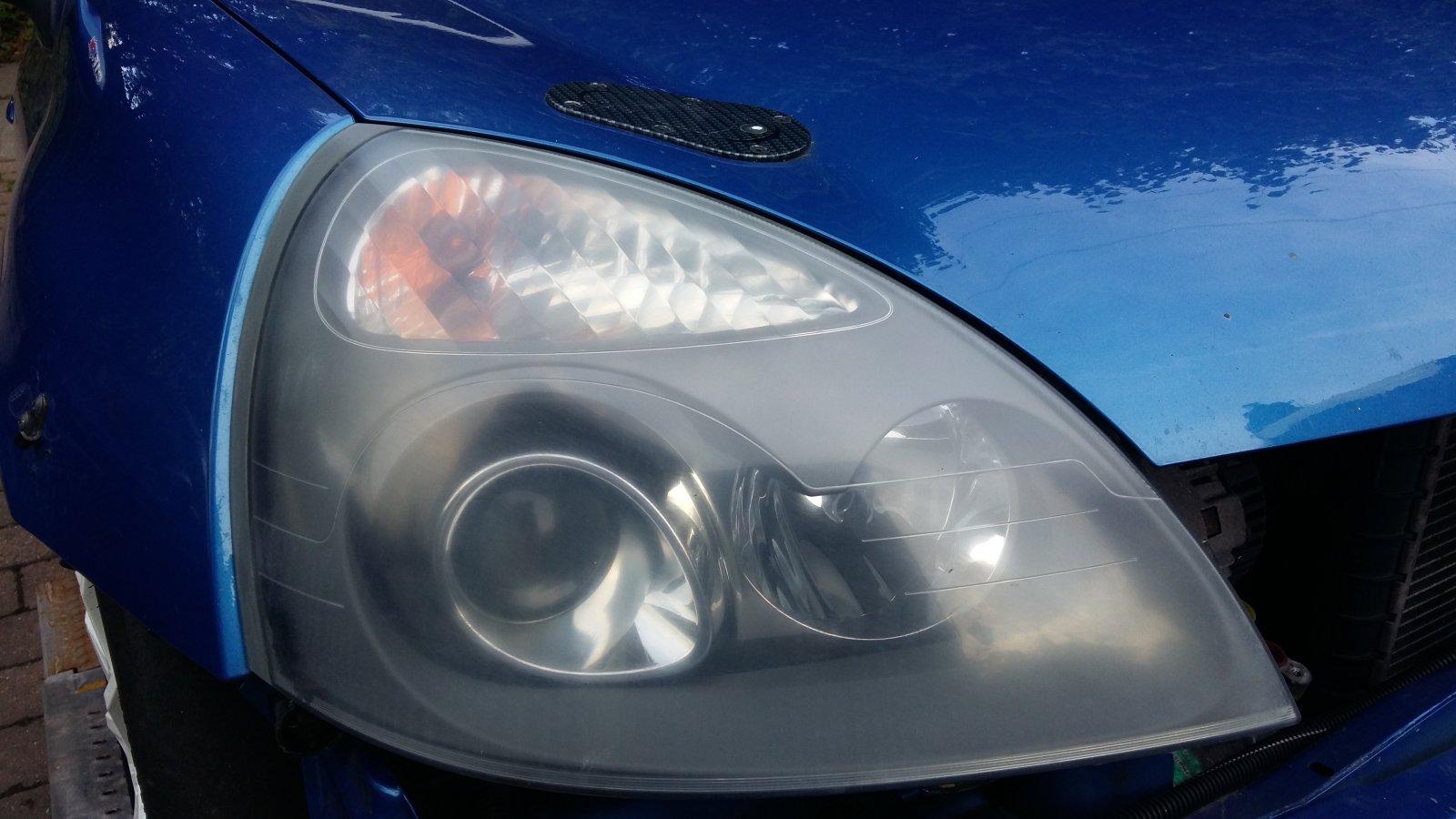

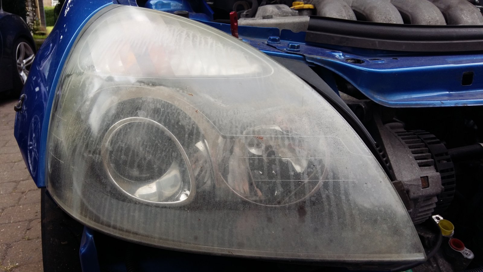

and finally one-eyed-willy has developed a bit of conjunctivitis so I'll be looking at cleaning it out

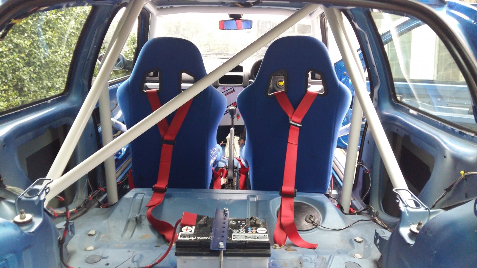

If you're looking to keep it within spec for the 182 series I believe you can only use top mounts and coilover setup from k tec racing. I could be wrong but that's the way I read it anyhow.

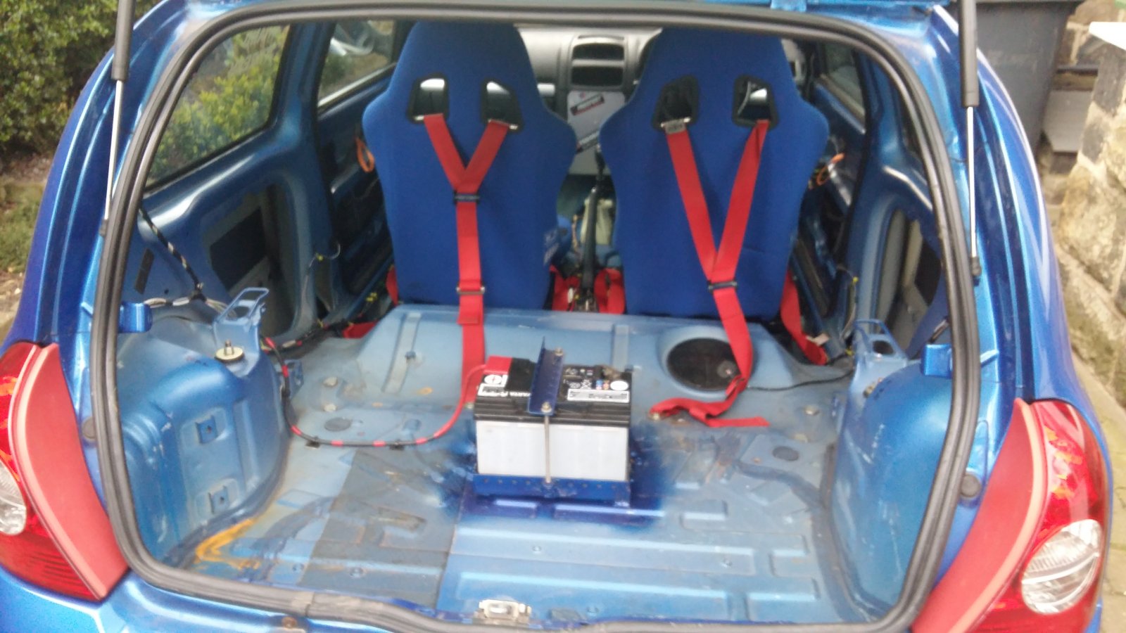

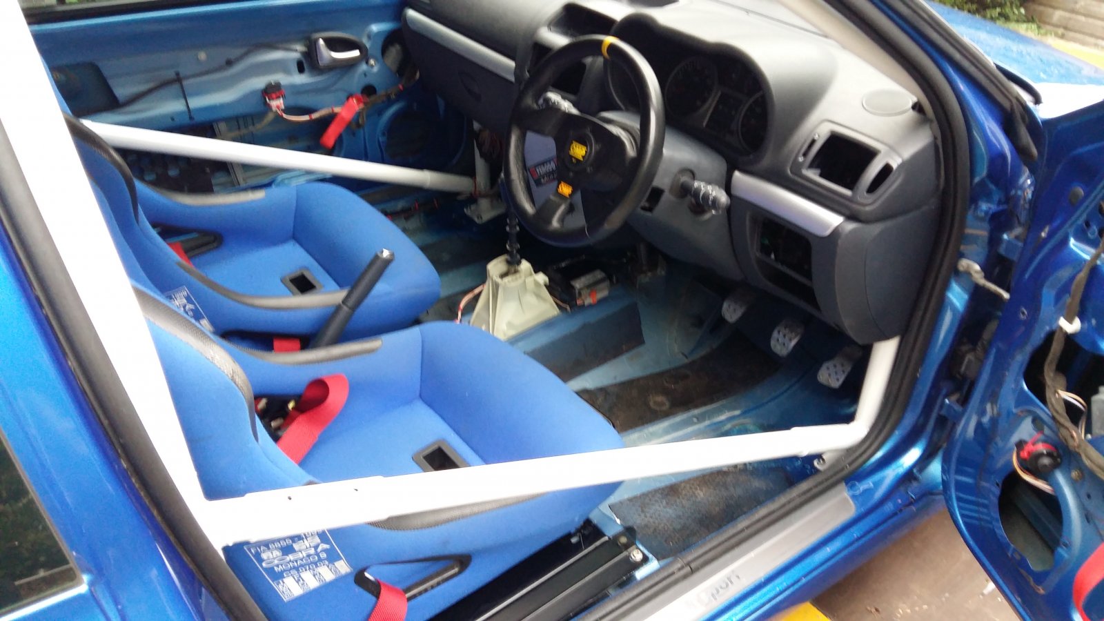

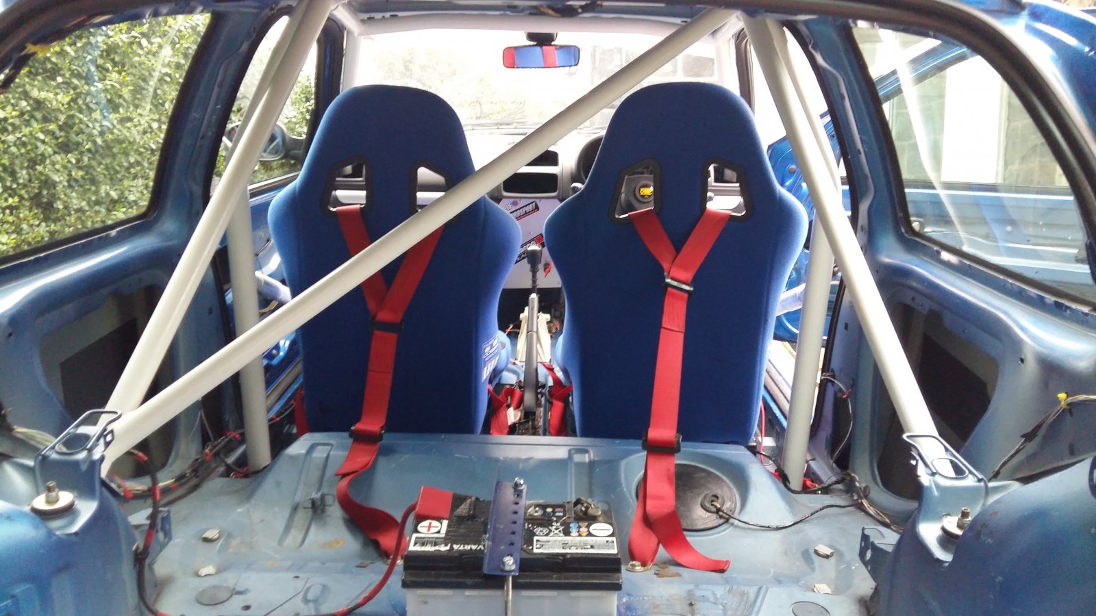

Otherwise it looks a nice solid base to progress from, I assume you'll run the harnesses off the cage once it's fitted? Only ask as I've seen too many people end up with serious back/spine problems from accidents where a harness was attached to the floor
  Clio 182
@Ads29 Thanks for the comment, you know I did plan to return the harnesses to the floor as the original picture above shows but as we're installing the roll cage this weekend then I'd appreciate your input as we could plan it differently.
So seeing the cage in the picture above, where would you mount the harness? Can you go in to a little detail as to why it makes a difference putting it there as opposed to the floor? (its not that I dont believe you as I've seen similar comments elseware, I just like to understand the science before making a change).

@imprezaworks Here's the regulation that I believe tells me the dog bone replacement is fine....
1. Modifications Permitted:
1.1 The replacement of valves, valve guides and valve seats with parts of standard pattern and material is permitted.
1.2 The replacement of engine mountings, upper engine, upper gearbox and lower stabiliser link with only the parts listed and supplied by K-Tec Racing as per 6.5.4.
Looking at the k-tec website the lower stabiliser kit looks identical to the one I bought (colour) so doubt it'd be a problem.
I see your predicament now @David Garthwaite, in an ideal world harnesses are mounted to the roll cage, this is so that there's no nasty angles on the harness itself, the sharper the angle the harness sits at the more potential there is for injury in an accident with damage/distortion to the floor (or wherever the harness is mounted too). By mounting to a cage it drastically reduces said angles, and with the integral strength of the cage itself any damage/distortion is reduced, thus reducing the chance of injury.
There doesn't look to be a horizontal harness bar on your cage though? Unless I'm missing something. In which case the shallower the angle you can get on your harnesses the safer they will be (ideally something under or around 10 degrees when mounted on cage but should be ok if no steeper than 45 degrees), have a look in the track/race section of the forum and at the top theres a thread on harness fitting by a company called schroth, which is very useful.
Unfortunately I've seen first hand the damage a harness can do when fitted at a very sharp angle (a neighbour rolled at around 40 and broke his back in several places, although he has made a full recovery since) I'm not trying to preach by any means, just don't like to see people get hurt if it can be avoided
  Clio 182
@Ads29 yeah you're not mistaken, was hoping you'd have a solution but it seems the roll cage I've got doesn't easily support the 10 degrees ideal. Obviously a bar could just be welded across but I want this to be legal for the 182 series and this is a FIA approved K-tec roll cage so I'm not sure what flexibility I have, but from your feedback I will explore options to at least get the drivers harnesses in a better place, I get the chassis distortion explanation and can use that to help come up with a better idea.
Appreciate your input man.

Time for an update of where we are with the track car, first the good news, track day booked at Donnington 29th August, massively looking forward to tanking around a full GP circuit but all the more important to have the roll cage in place given the higher speeds of here over Blyton Park. Good news in this department, we're a couple of days away from the final fit of the roll cage, thanks in no small part to the time and expertise of my father (ex mechanic) and a little help from me (office worker, so just a pair of hands).

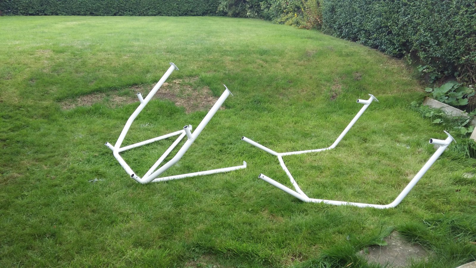

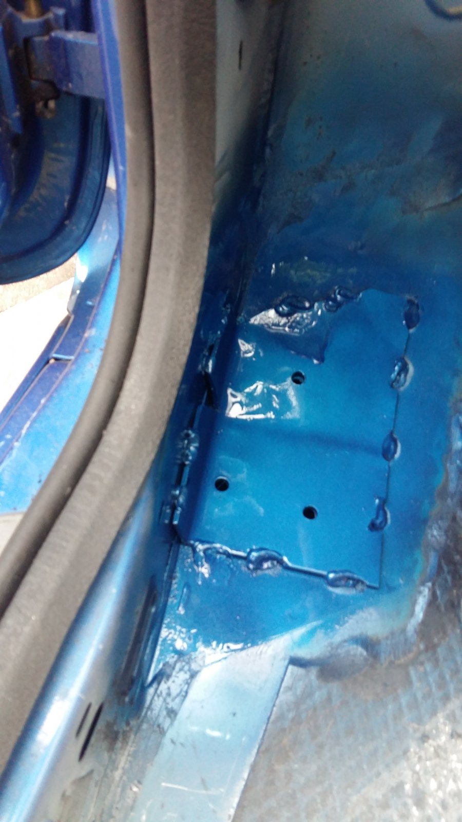

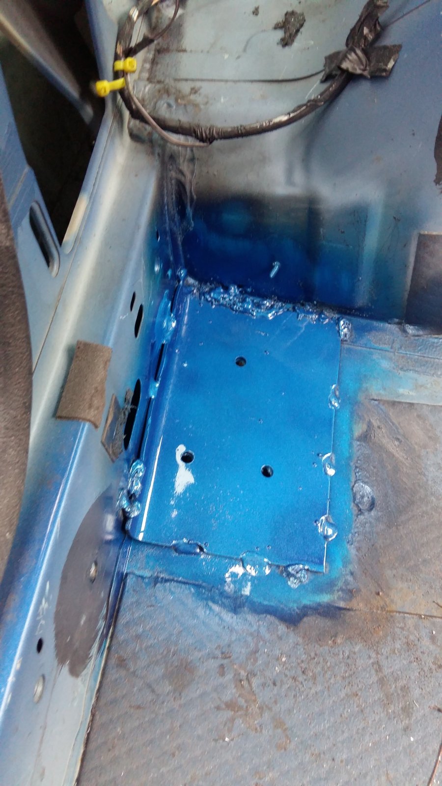

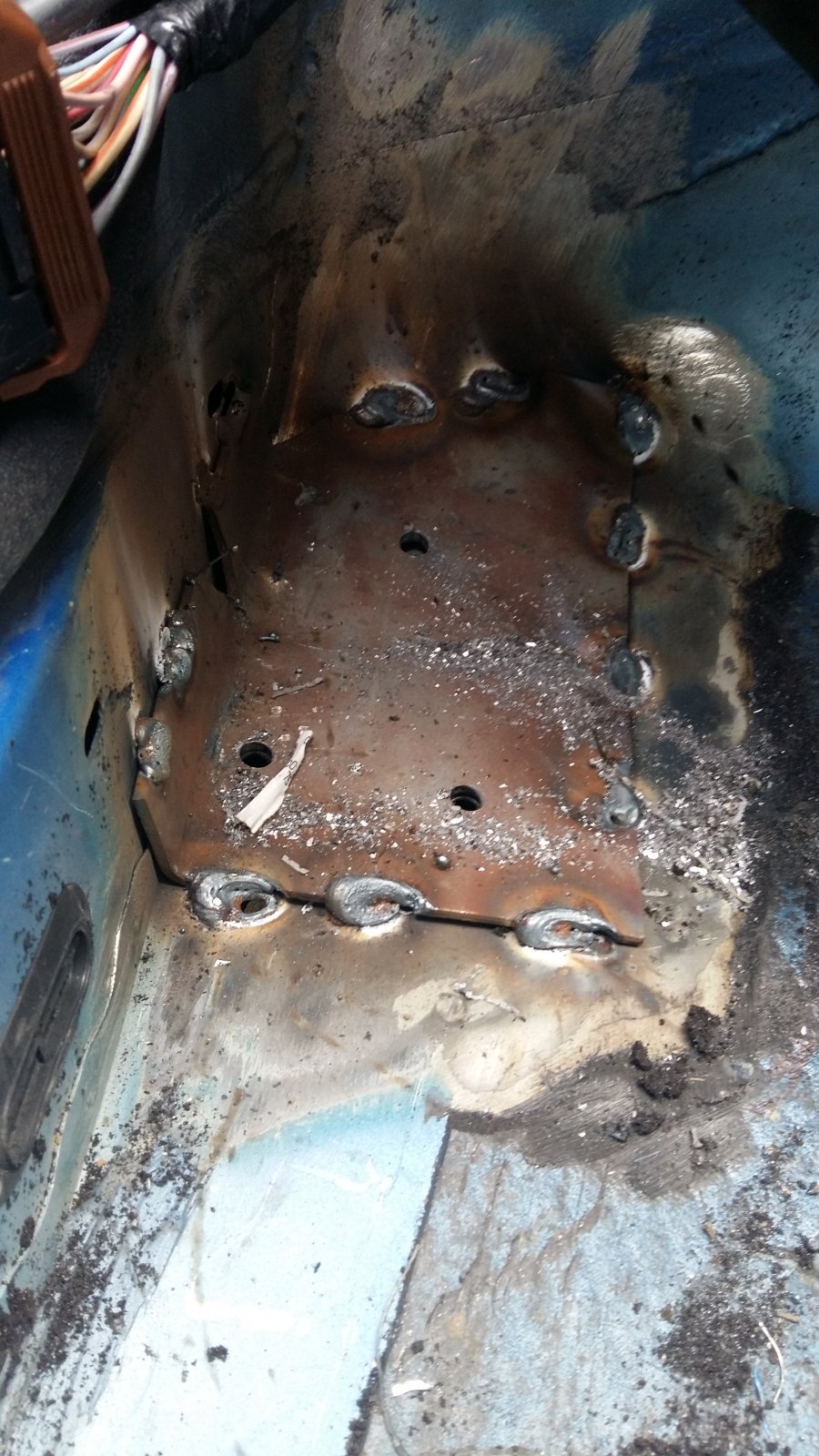

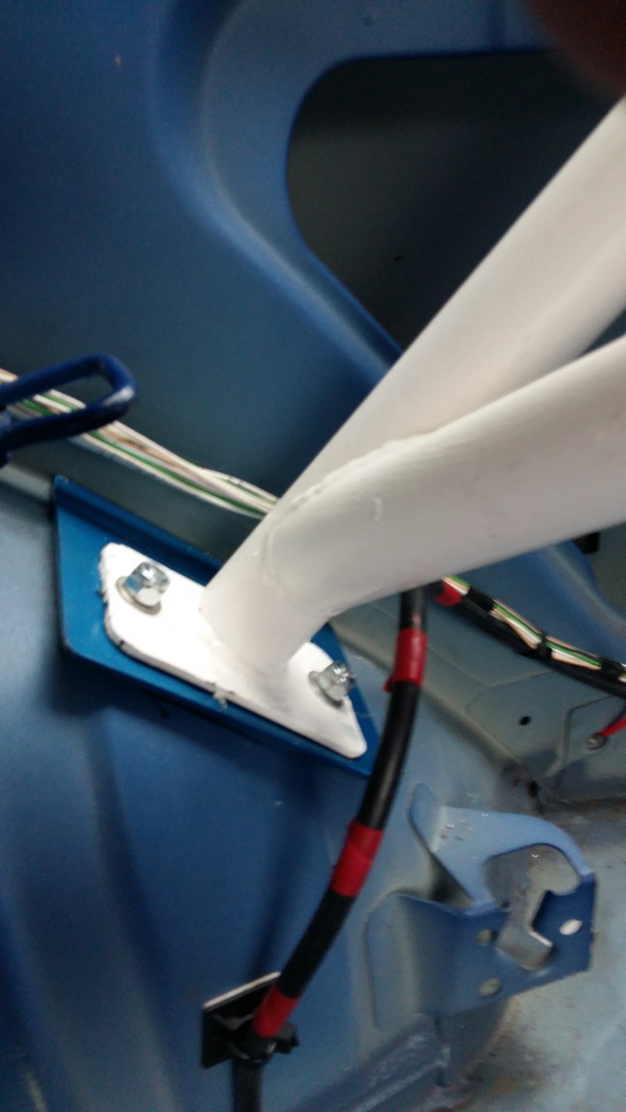

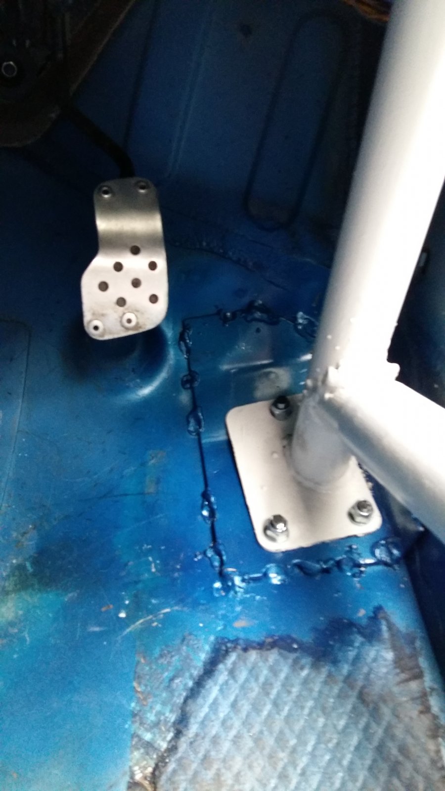

Spreader plates fitted and drilled, this proved quite a difficult weld given the thickness of the plate and the thinness of the car body, so we blew a couple of holes in the chassis.
but overall the result is very satisfying
please dont have a go at the quality of the weld, we know it could be miles better but K-tec said it just needed spot welding in place so I think we've achieved that.
Roll cage all painted and ready for installation.
The dash has been cut to accept the frame but I'll have a picture of that once it's all installed.

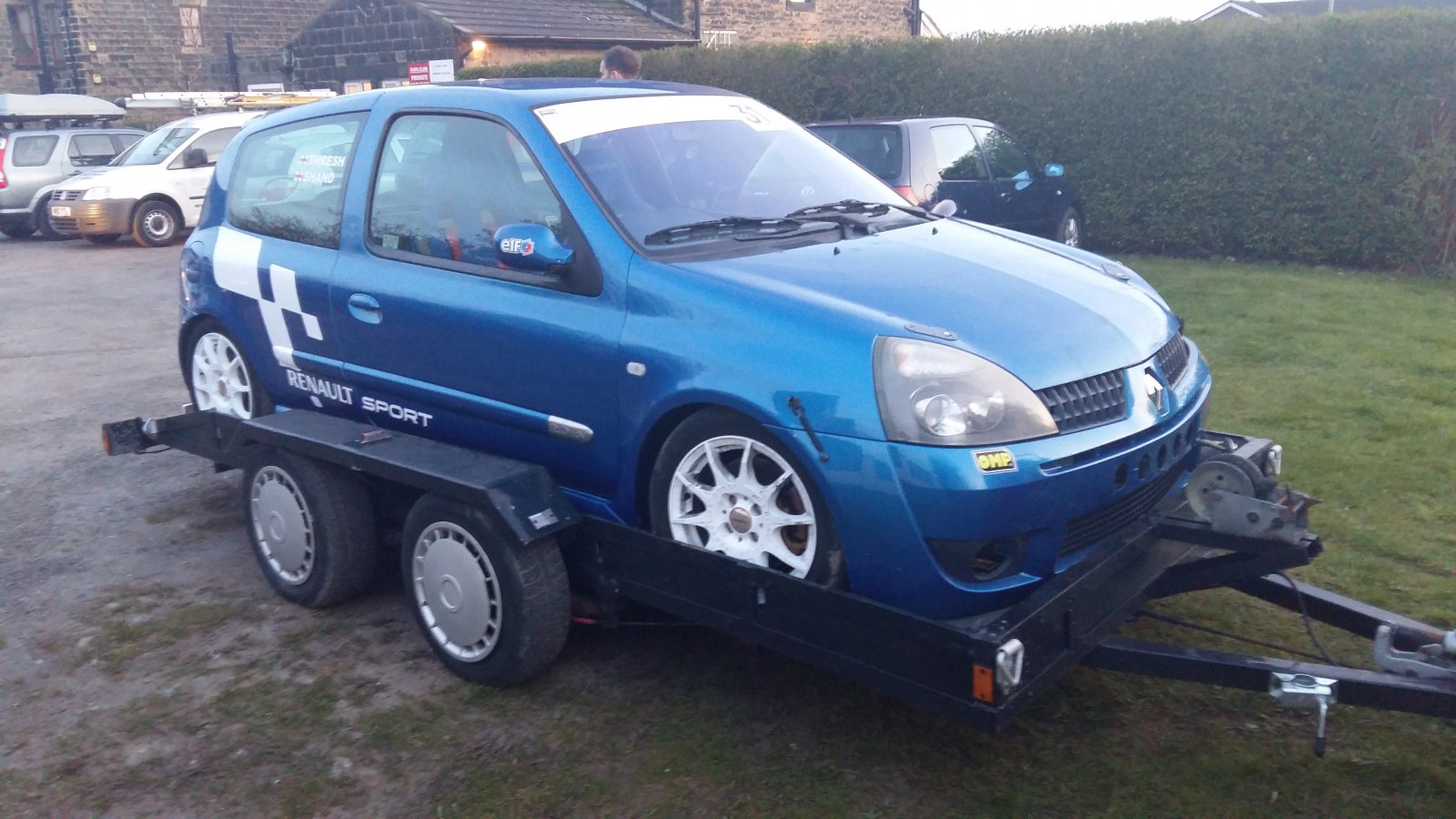

And finally for tonight, another bit of good news, a new addition to my family of vehicles.....behold!!!
The time taken to pick up a trailer the day before and return it the next evening after a full day really makes it a lot of effort, I got this beauty for £450 and think I'll break even after 7 events so worth the money I recon. I think it'll be going blue and white at some point to match the car.

Dog bone bushes going in, should stop it jumping out of 3rd on braking now
Head light cleared up...not completely happy with it yet but massive improvement (see above) and it'll do for donington on Monday.

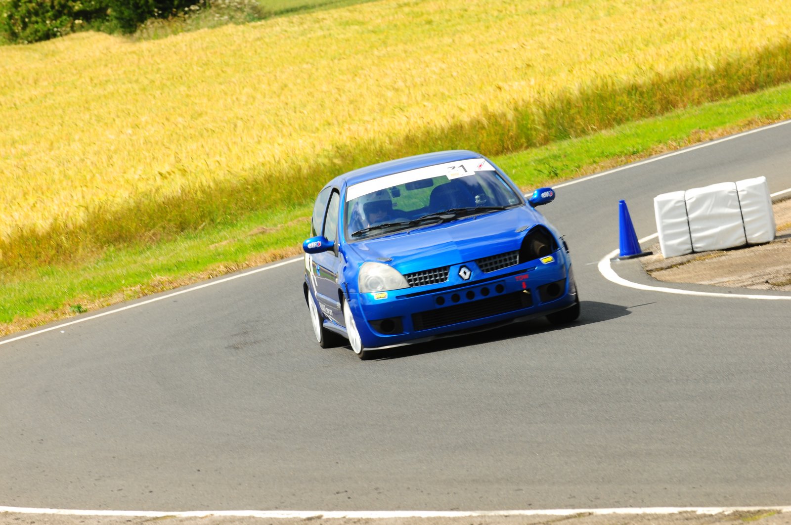

A few pics of one eyed willy down at donington earlier today, so a great day, great circuit, organisation and weather. Car performed impeccably, dog bone bushes worked a treat and stayed in gear all day, only niggle is it seems I've got a front wheel imbalance but these tyress are shot now so new ones will get balanced. Really wanted a pic with the leg cocked but didnt get one, clearer instructions to the camera man next time.
