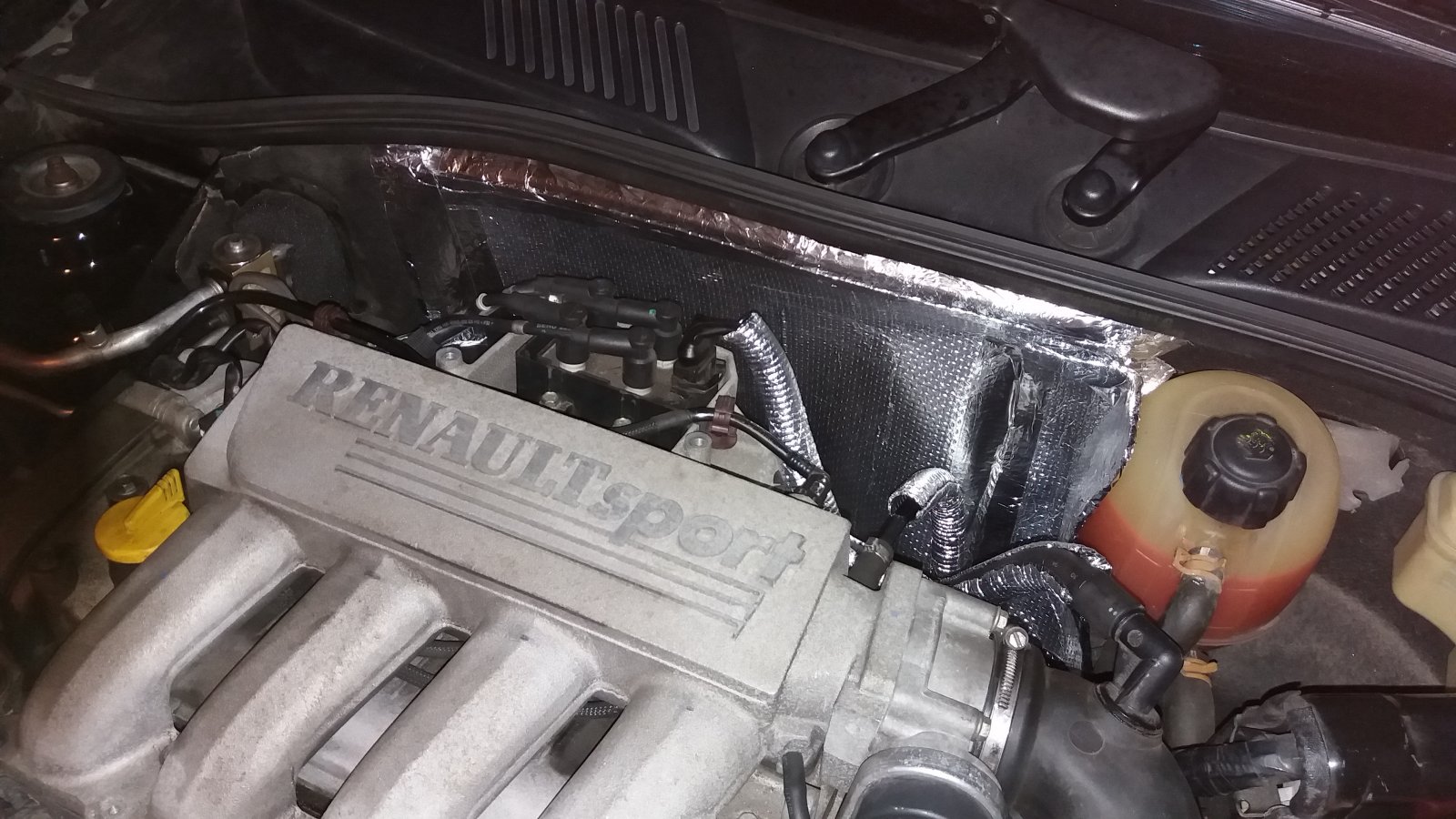

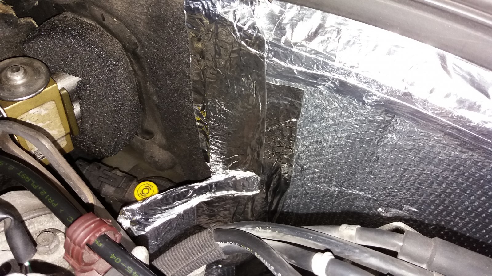

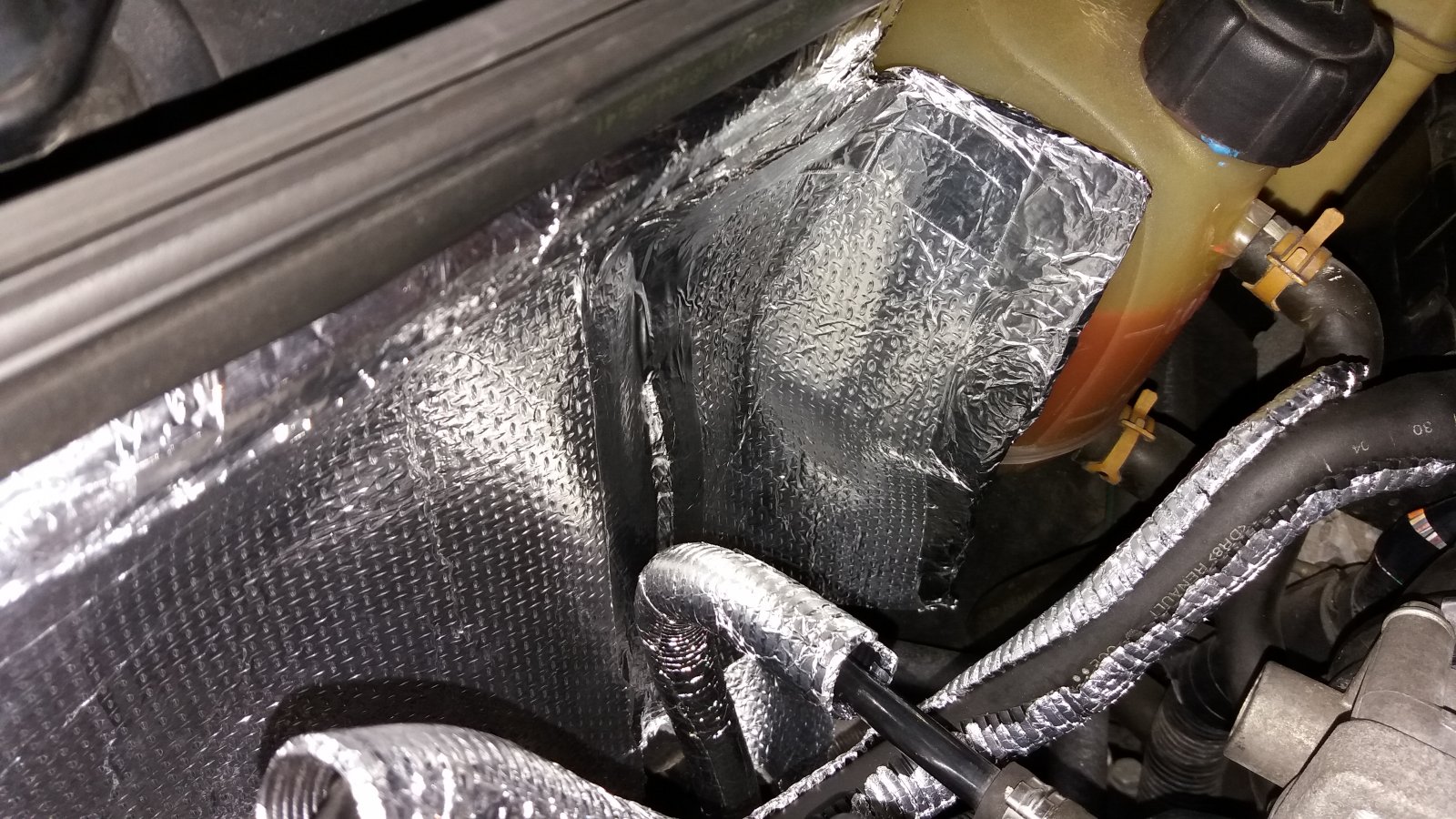

Was checking the heat shielding and sound deadening last night and not happy with the amount of heat passing up from the manifold. Wrapped some ducting in heat reflective tape and stuck it round all cabling directly exposed to the heat. Ordered some extra heat shielding mats to stick around the back and sides of manifold to give the coolant and brake fluid resorvoirs some protection. Was also looking at Zircoflex FORM to create a heat shield directly on the manifold, but concerned that may retain more unwanted heat around the starter motor. When i get the new sports cat fitted i may drop the manifold and wrap it as that would be the most ideal solution imo.

Got some heat shielding on friday and cut and fit it all in place today. Ran the car at 2k rpm for a few mins with the bonnet up and again with the bonnet down and checked heat behind the brake fluid and coolant reservoirs and they are much cooler than previous.

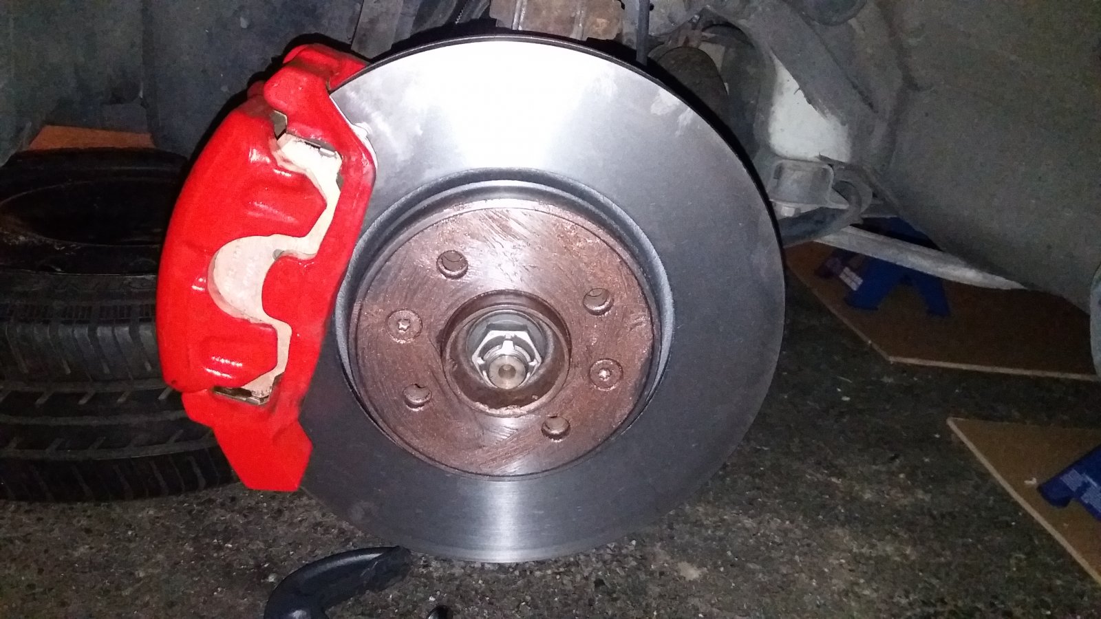

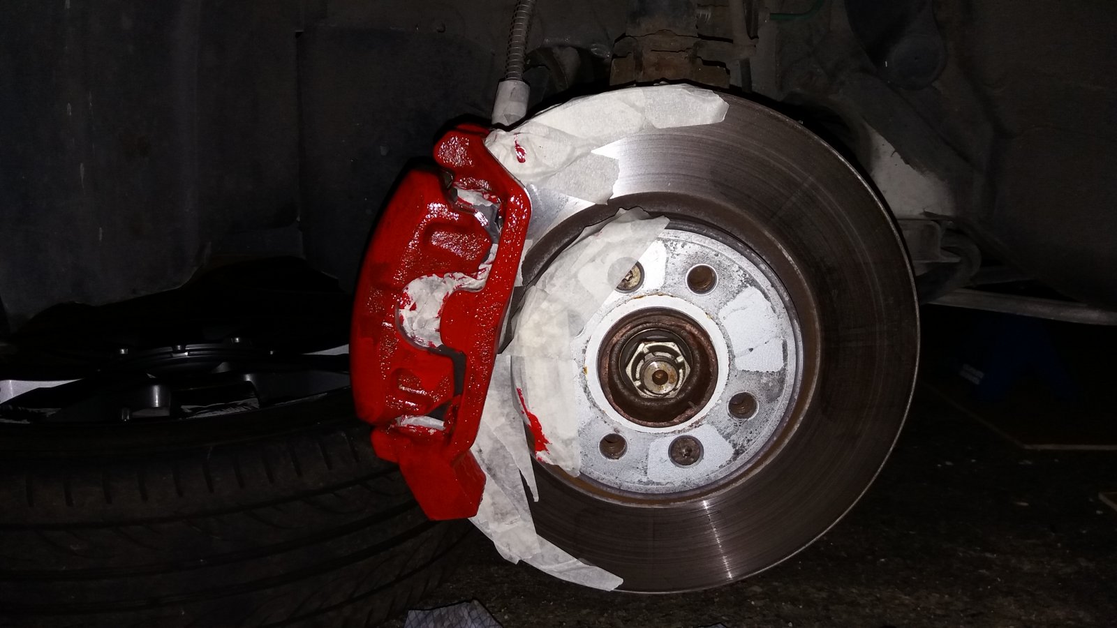

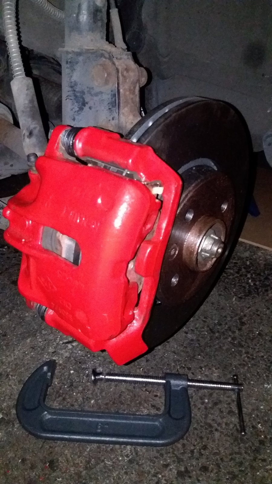

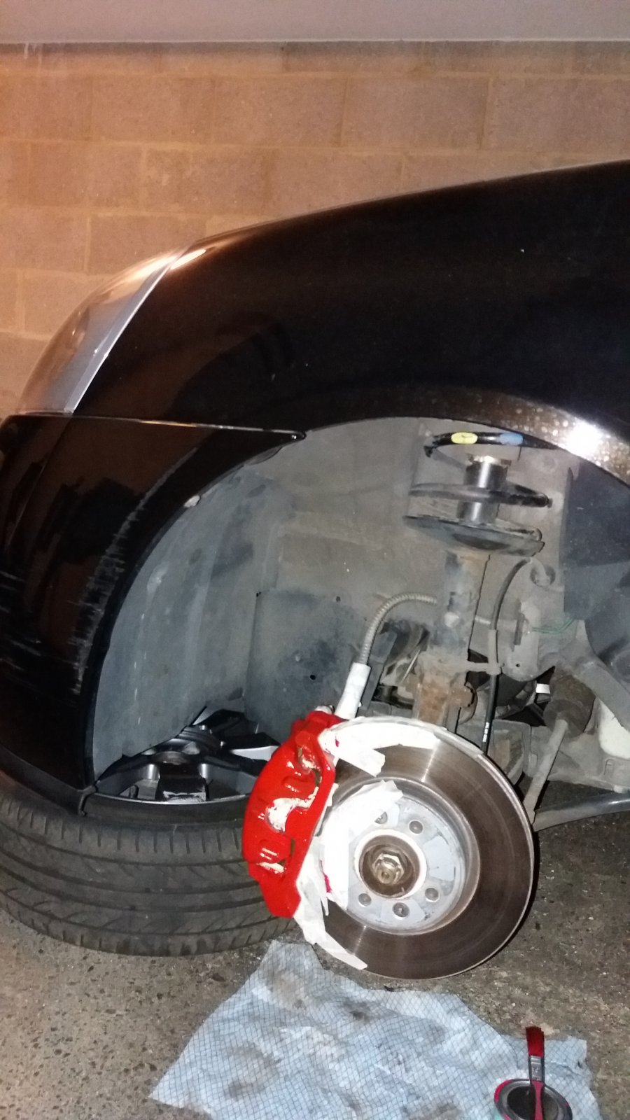

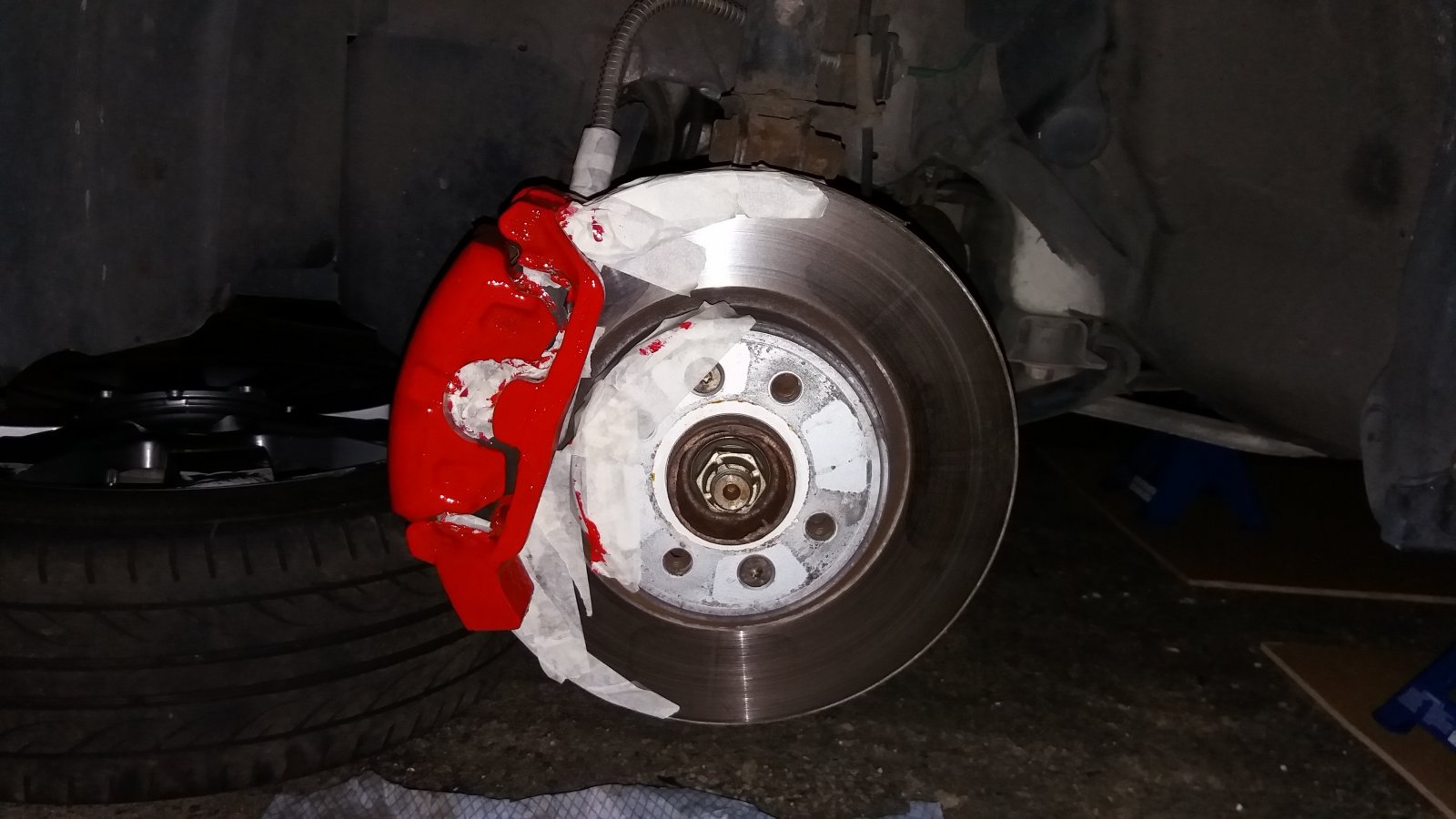

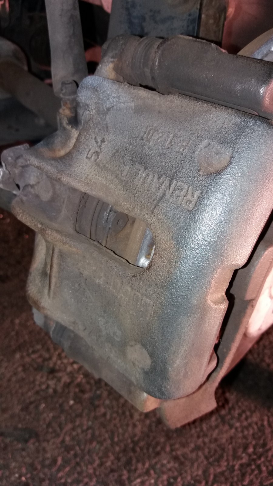

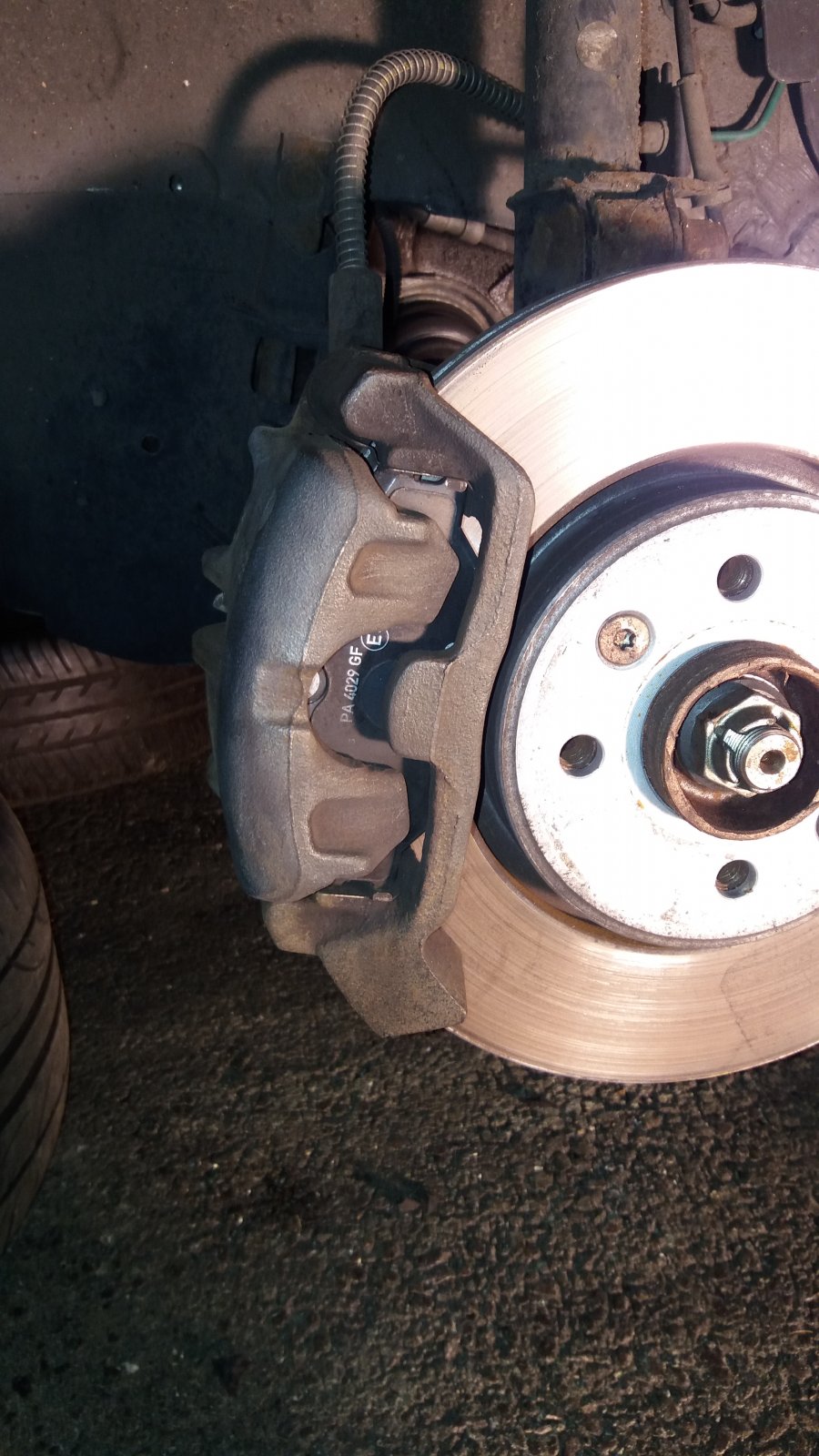

Front calipers painted and looks decent.

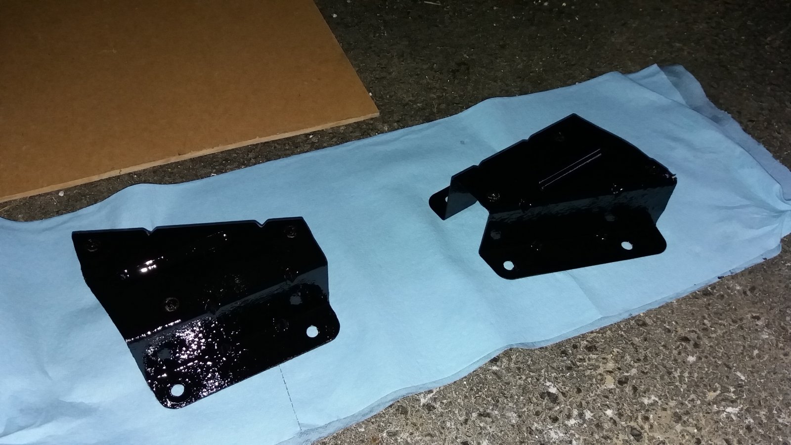

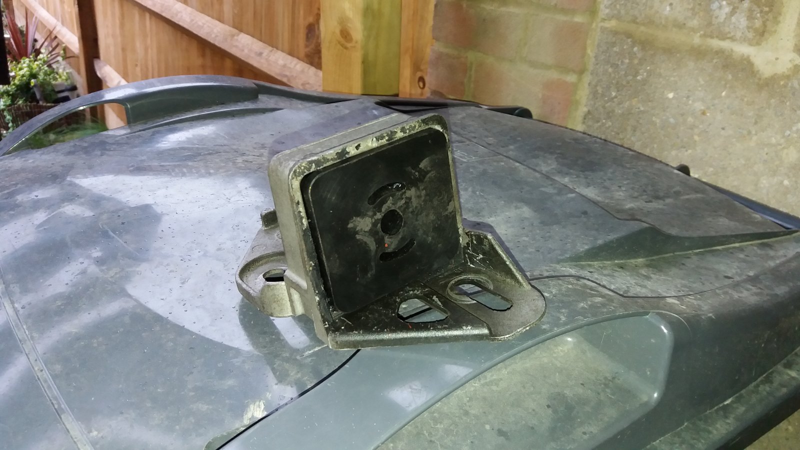

Got some exhaust mount plates yesterday gave them a scrub and a few coats of hammerite.
Can now get my 2nd powerflexed mount bracket fitted and exhaust is done.
Got refurbed exhaust mount brackets and powerflexed rear exhaust mounts on.

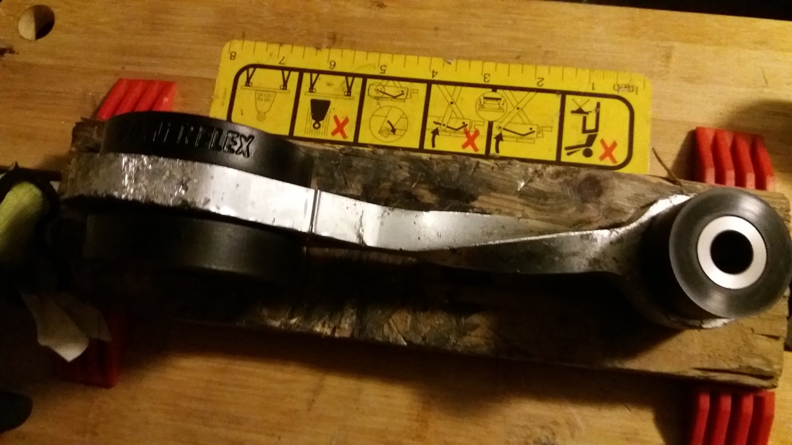

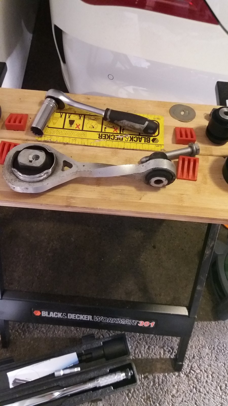

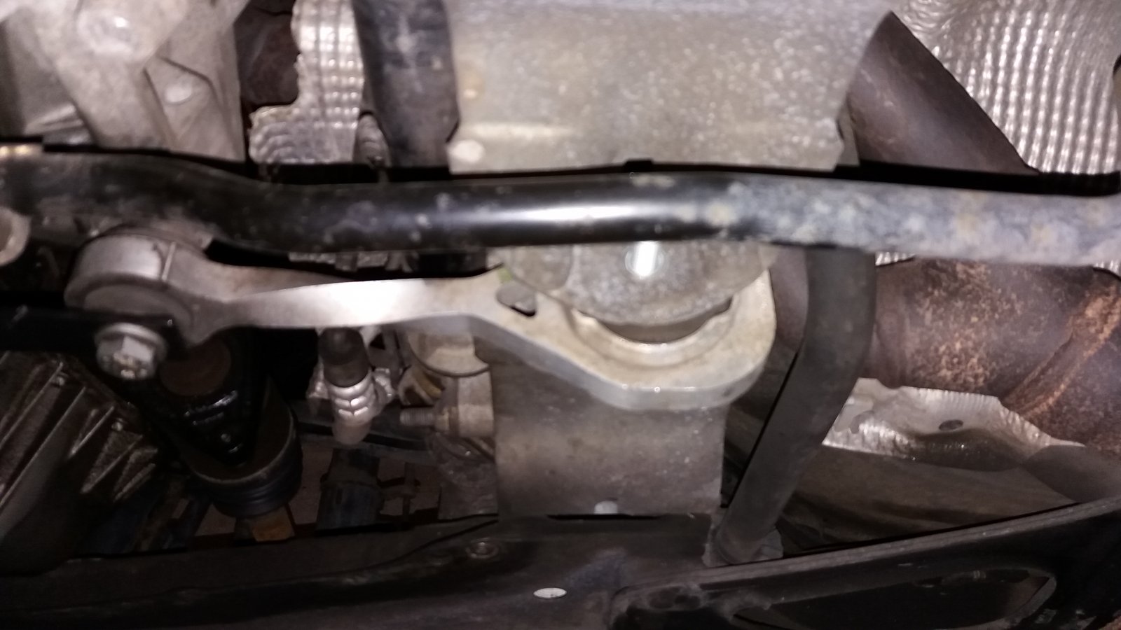

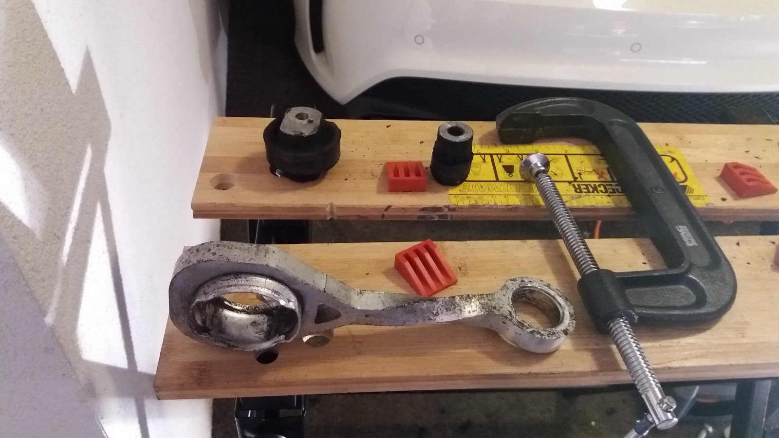

Started on the dogbone mount, with the car on stands access is a b*****d as the bolt on the big end is blocked by the gear linkage. Pulling the old rubber out is surprisingly easy, lots of silicone lubricant, clamps and a stanley knife and they slide out. The big end has a thin sheet of metal, to prevent the rubber moving, so that has to come out too.
Original mount in place
Mount removed
Old rubbers removed
Just discovered the gearbox end bolt doesnt fit the powerflex bush, bolt is 18mm, bush hole is around 16mm.
Edit... being stupid and put the centres in the wrong bush ends... time for bed zzzz
Got my big end sorted, on my dogbone mount that is. Lots of heat, hammering and cutting and wedged the bugger out.
And powerflexed.
Refitting is a bit of a turd, especially with the car on stands. But i found it easier to get the gearbox end on and then rubber mallet on the big end. Just need to lower the big end slightly as the holes arent fully aligned.

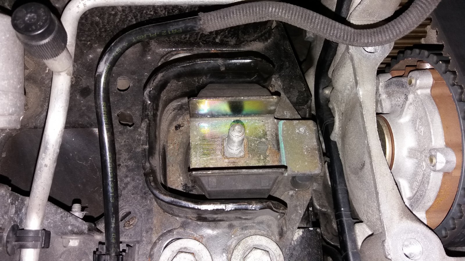

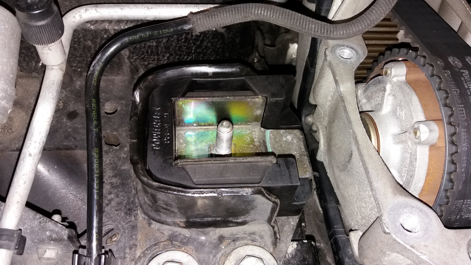

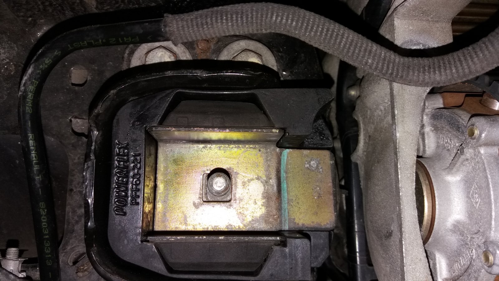

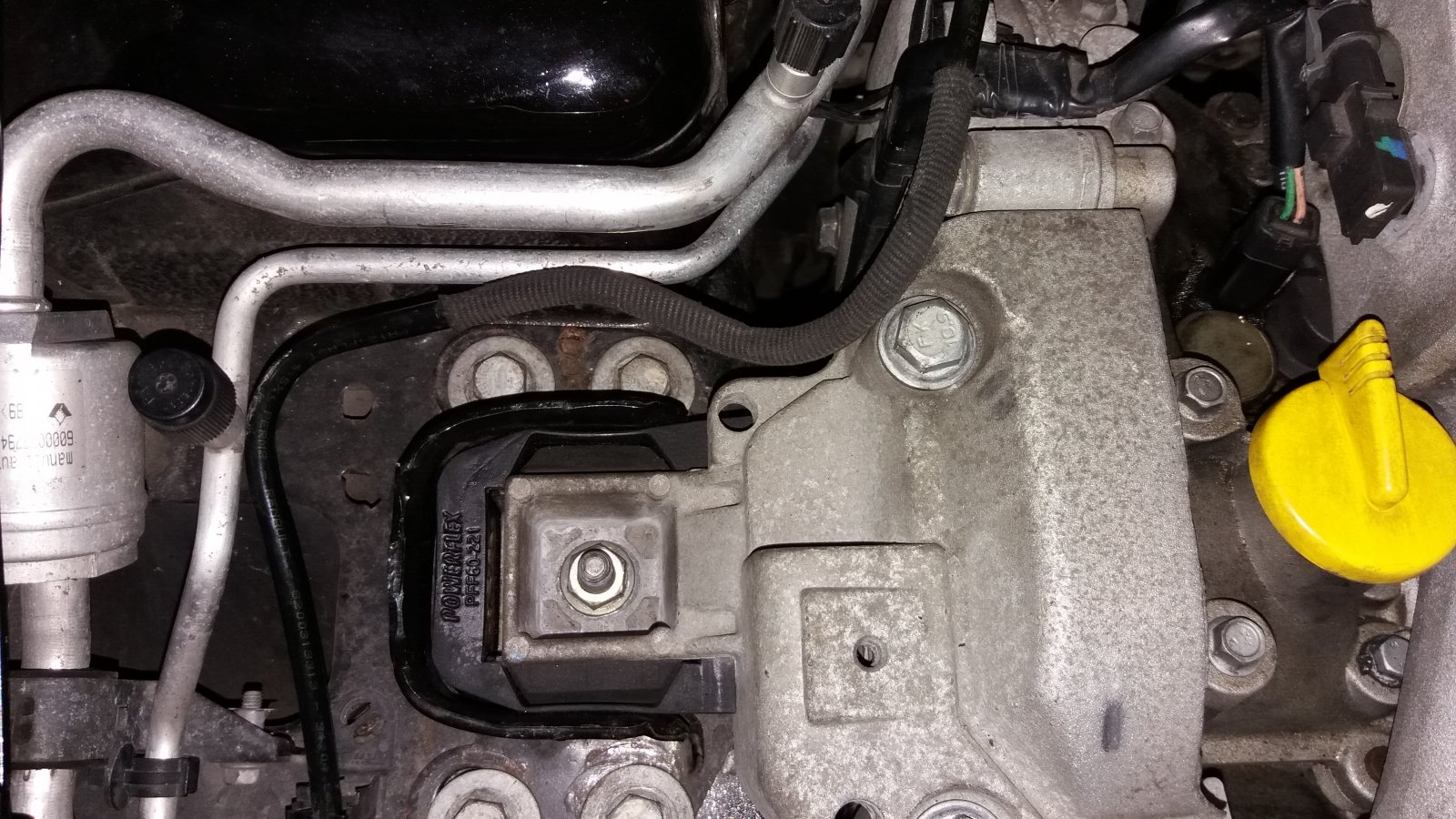

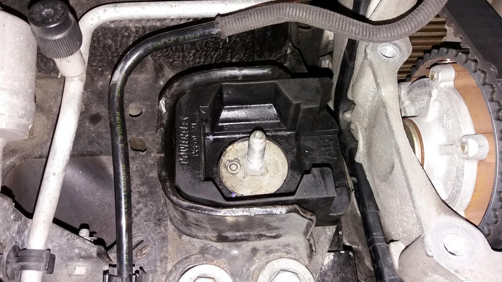

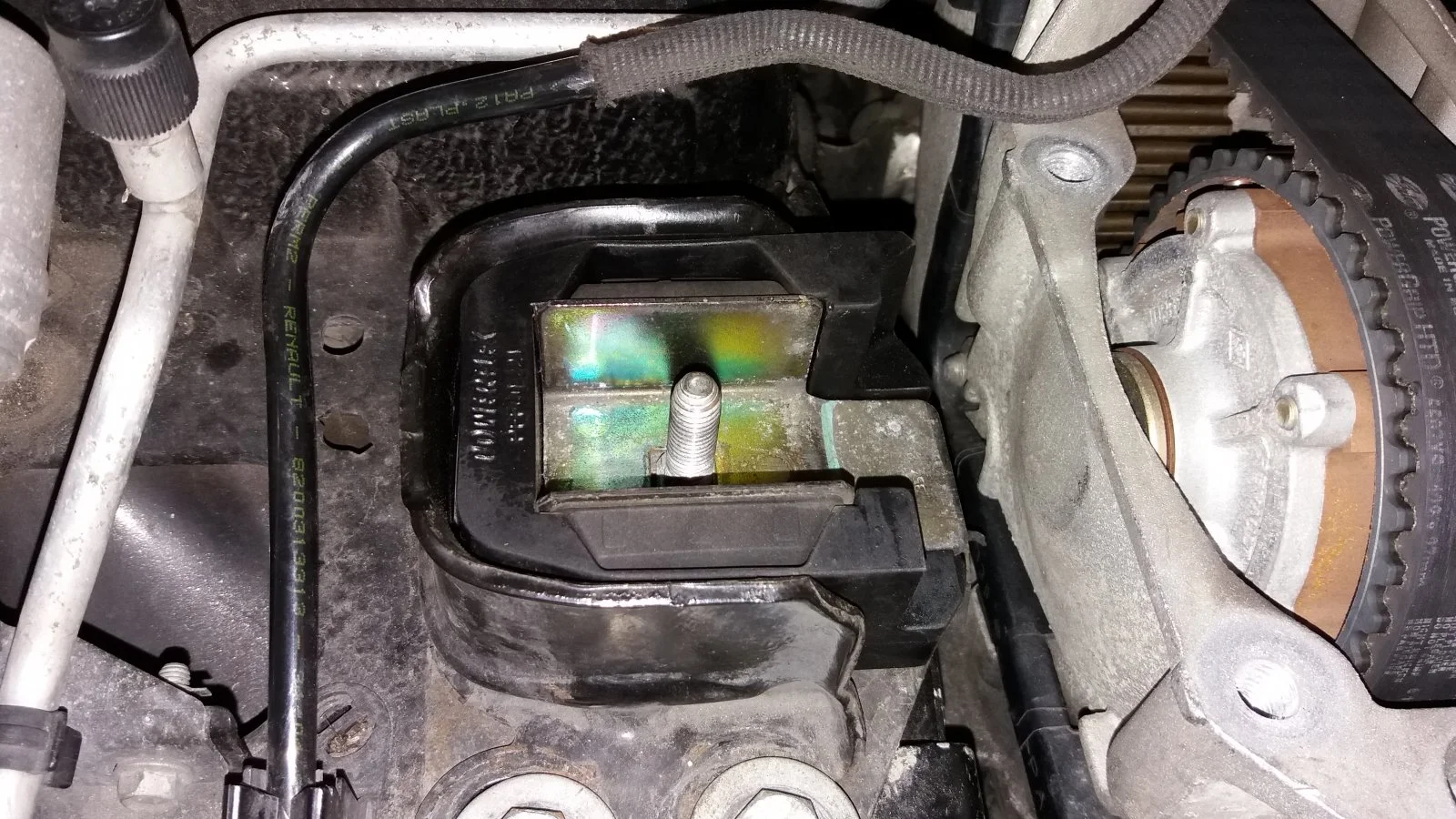

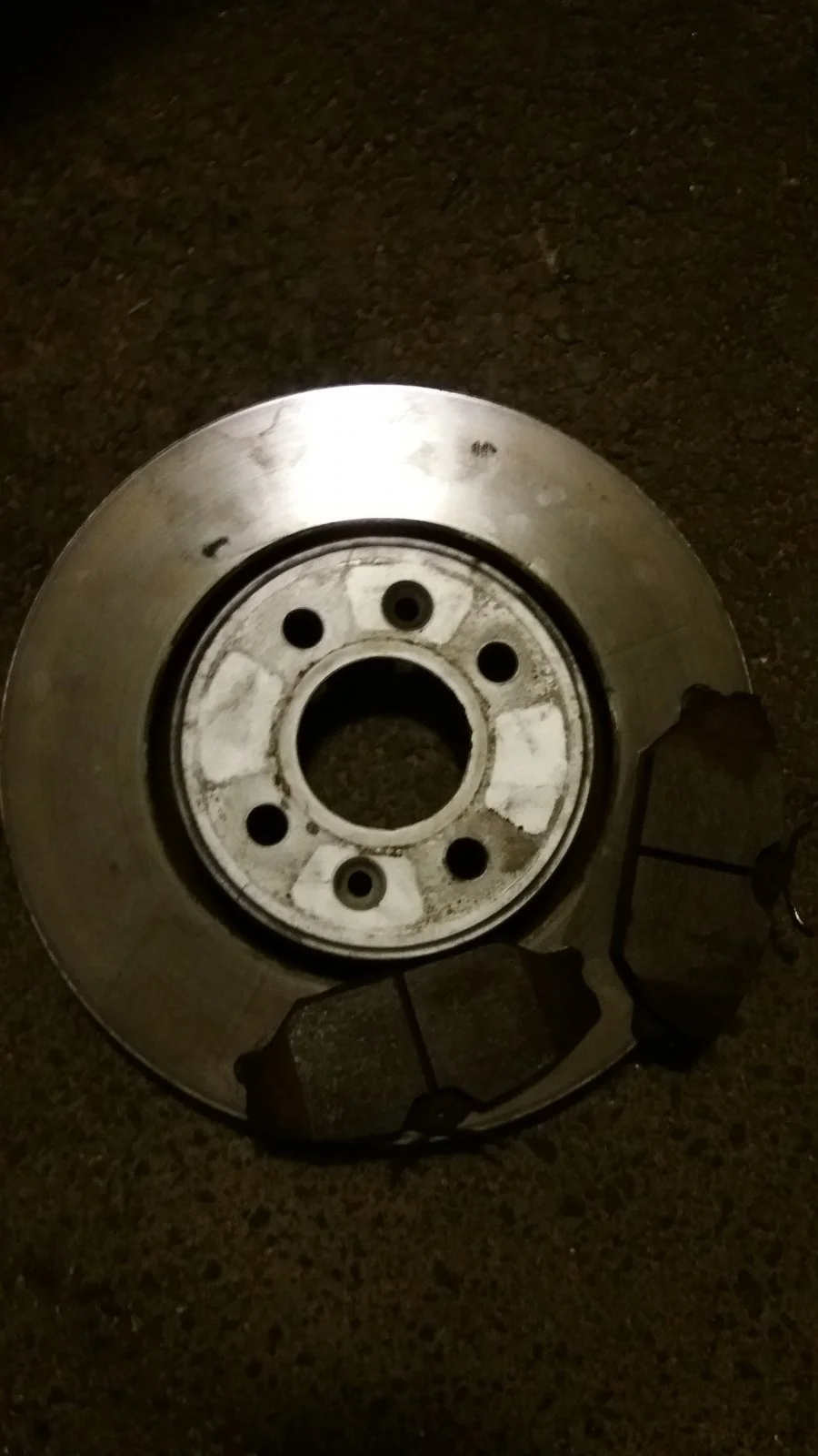

Since i last drove it ive put powerflex black on the upper engine mount, dogbone mount & rear exhaust mounts and fitted cl rc5+ & brembo hc on the fronts.
The brakes are really really good, quite a bit of squeel from the pads tho, but bearable. The powerflex bushes made a massive difference, gear changes feel much more direct, and the engine insert has reduced alot of the vibrations.

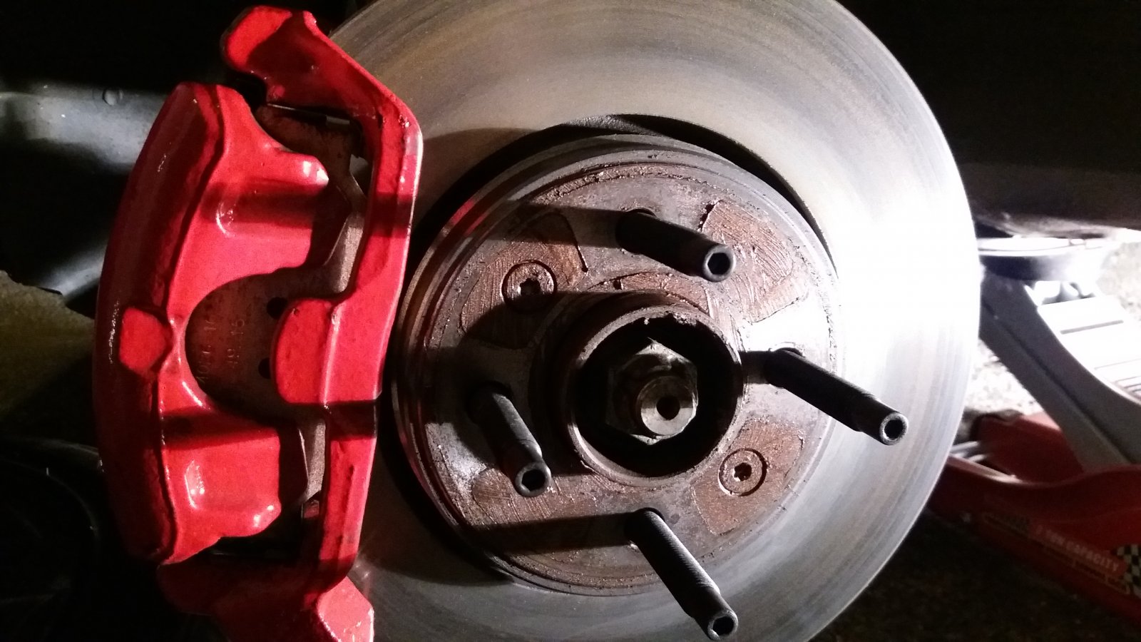

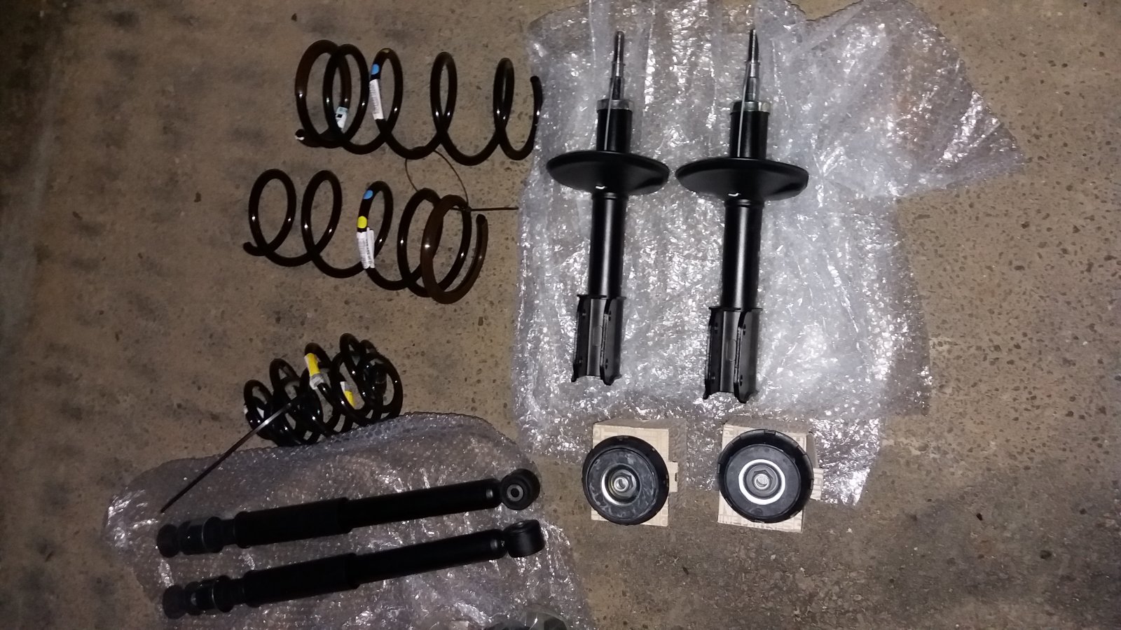

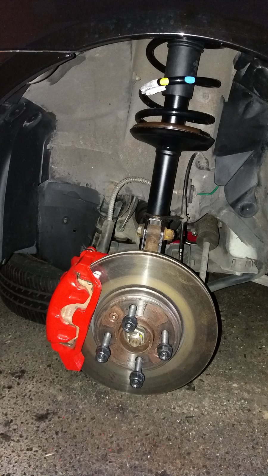

Not done much in the past 2 weeks but got a few new jobs line up... looking to do full suspension refresh, will be getting new cup springs and shocks and will do track rods at the same time. Also planning to do stud conversion and 0.5 degree shims on the rear.
Fluid change so flushing gearbox, coolant and brake fluid... engine oil already done. Going to swap the hankooks to the rear and bring the ps3s up front then get tracking done. Brands by end of oct for a day sesh.

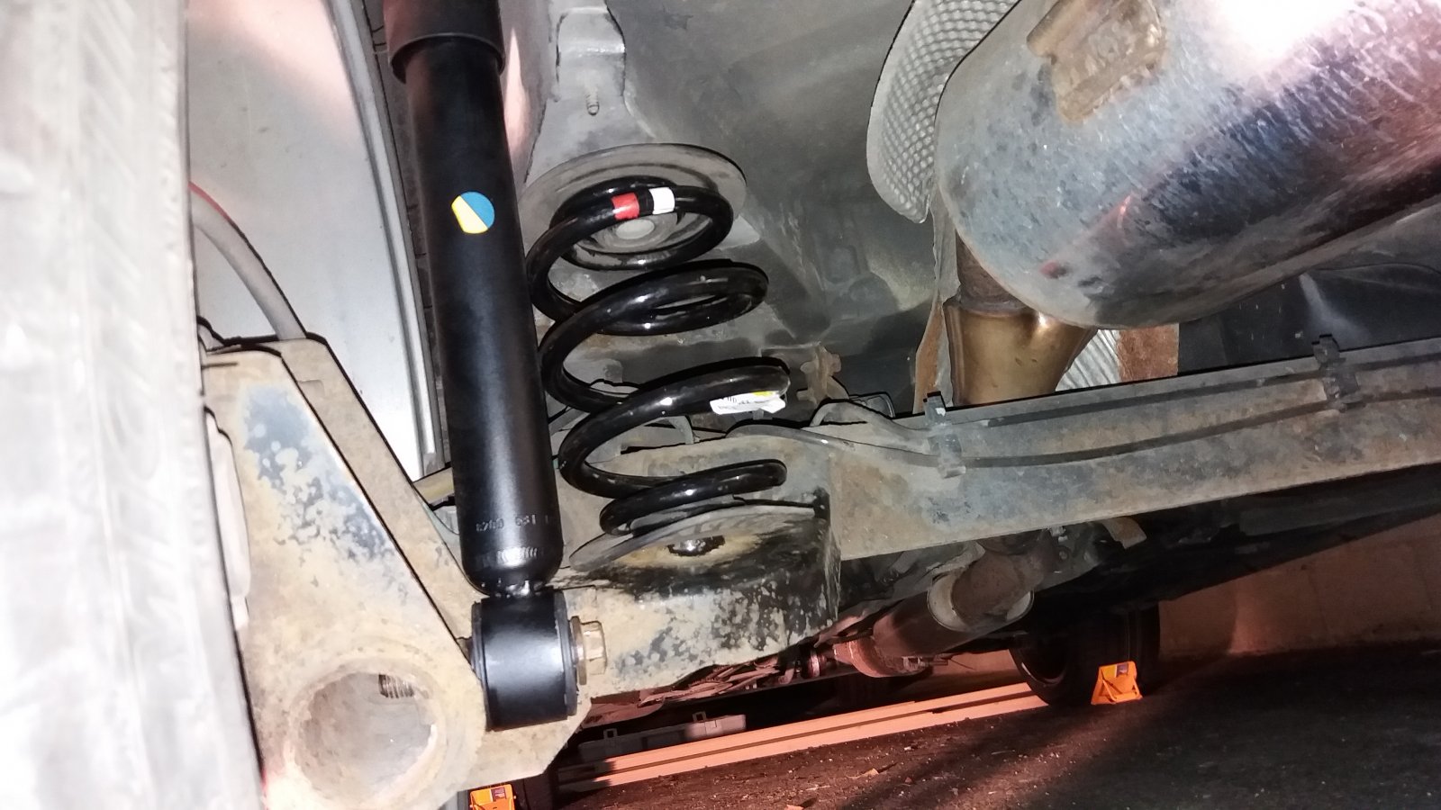

Bit crampt in the garage so cant get any decent pics of the car. Doing the rear shocks and springs tomorrow and will take it out afterward and get some pics.

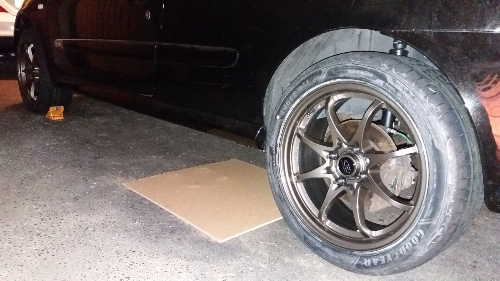

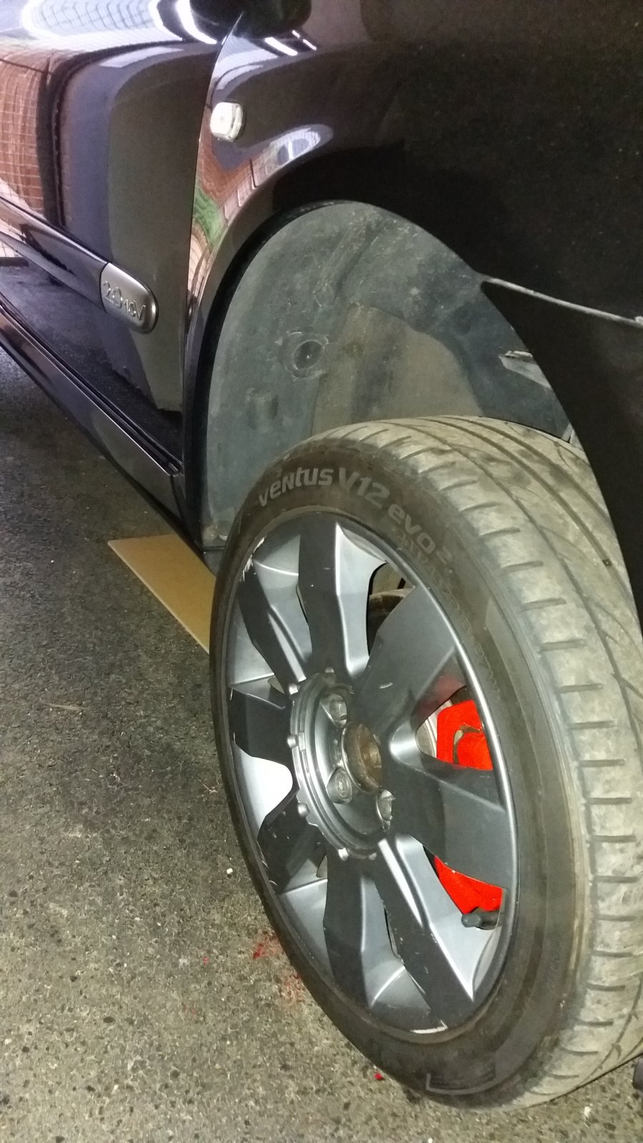

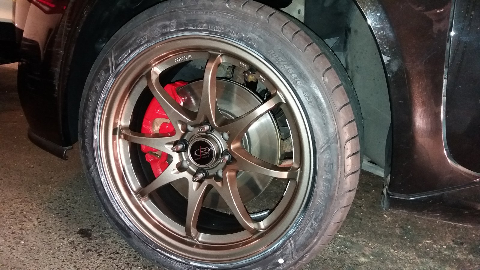

I looked at turinis and couldnt find any decent seconds, and to buy brand new in gold or anthracite was closer to a grand. Saw the rotas and the colour and price sold me on them. I would have kept the std wheels on but tbh they look pants and are heavy as fook.
Got the car out this evening and what a transformation! All the nervous twitching on the steering is gone. The ride feels much firmer. Just need to put some miles down on her now, its only done about 100 miles since i bought it in july. Aint got much else planned with it, other than do gearbox oil and brake fluid. Still got a whiteline rear arb but want to take it on track first so i can get a feel of before and after.

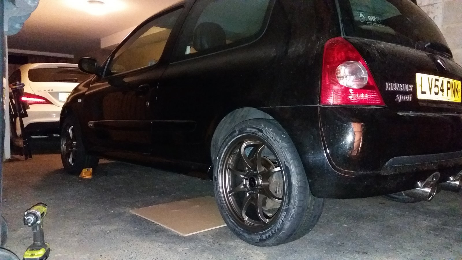

Only got the one pic, might need lowering a tad, looks like its on stilts.

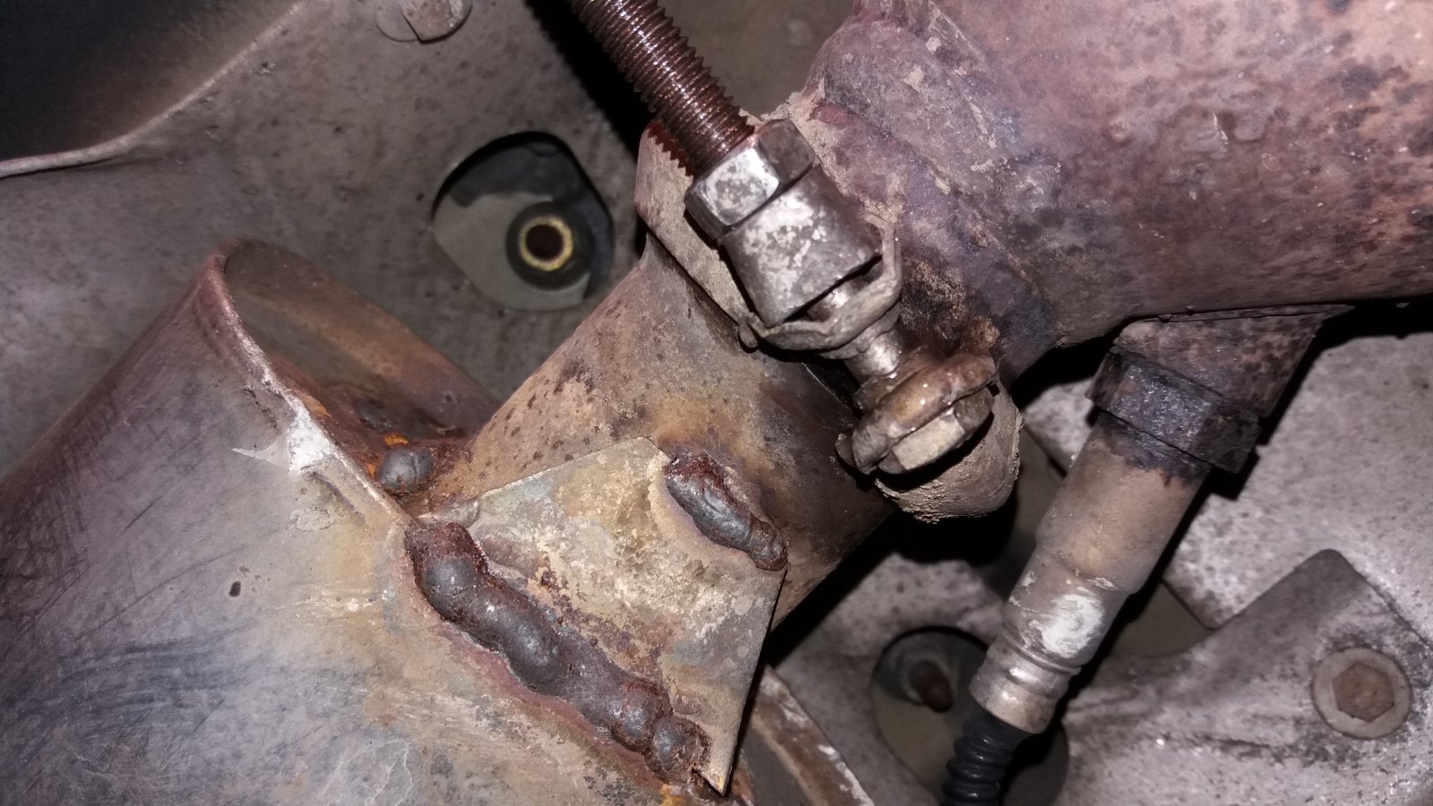

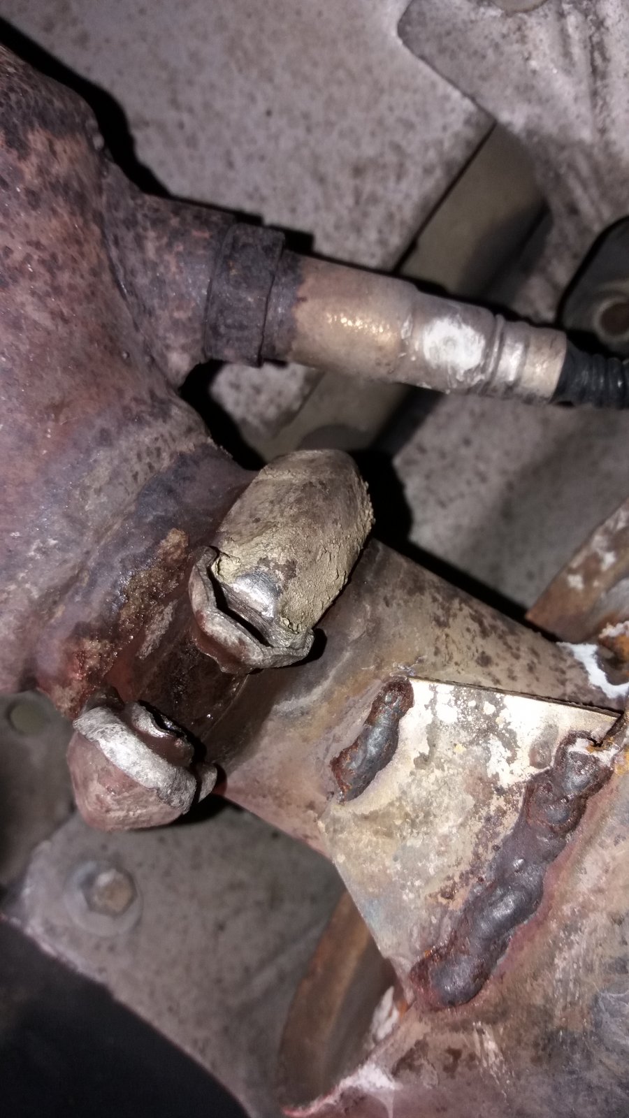

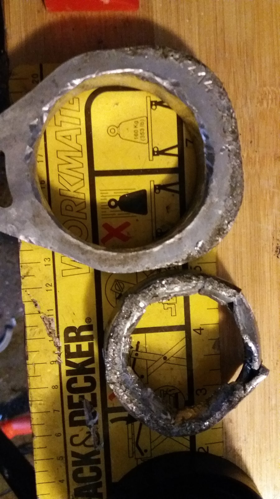

So 3 months later than planned i finally got round to sorting the exhaust. I knew it was blowing somewhere as it gives a nice tinny rasp when you put your foot down. Also, the exhaust has always sat low even after replacing rear. exhaust hangers

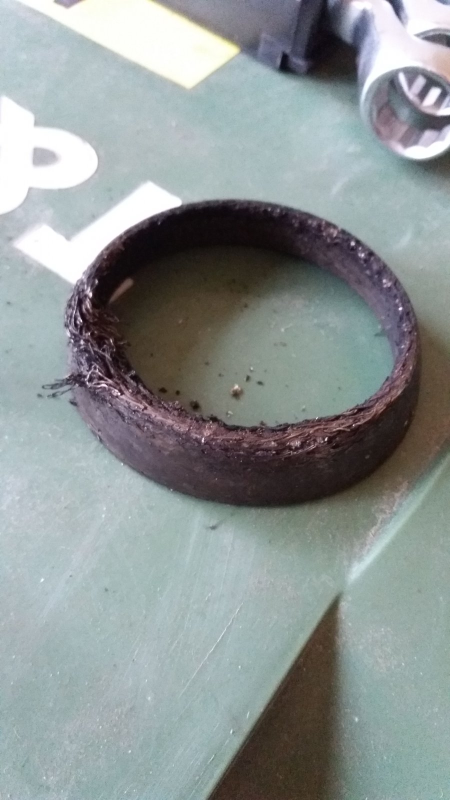

Found 2 leaks initially, cat to manifold and a joint on the pipe before the back box.
Got the car on stands and a jack under the cat and replaced the gasket and hardware.
The centre exhaust mount had perished so replaced that aswell.

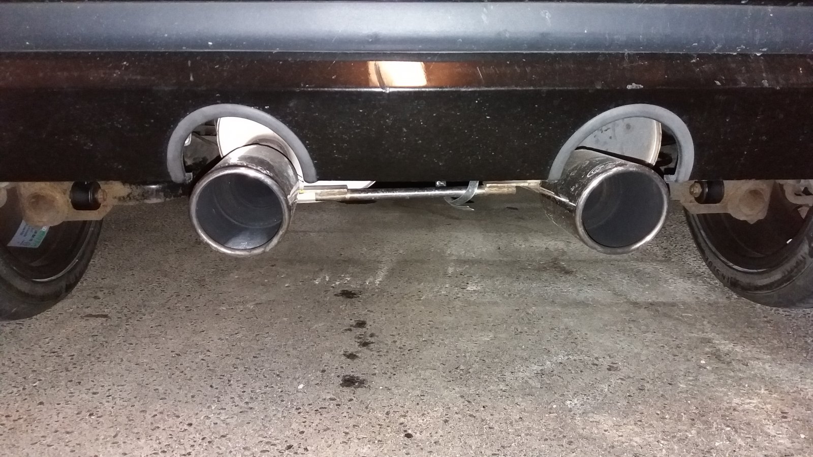

Whilst i replaced those bits i slackened the rear hangers so that i could attempt to get the exhaust sitting up in the bumper. Got it all centred, couldnt do much in the way of getting the tail pipes up into the bumper.

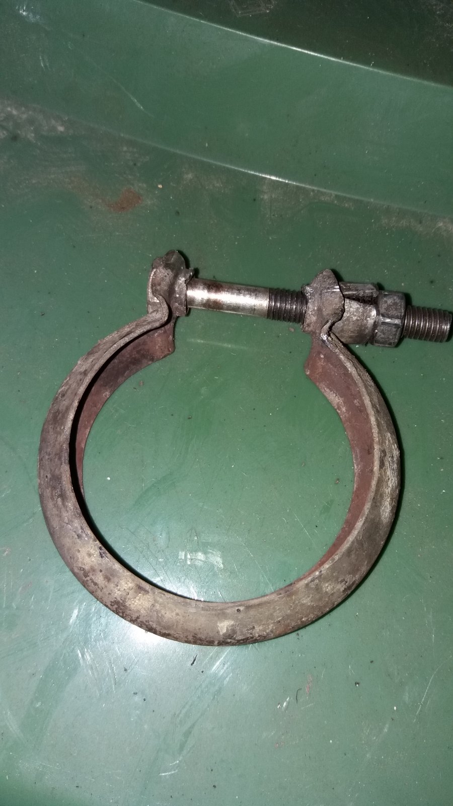

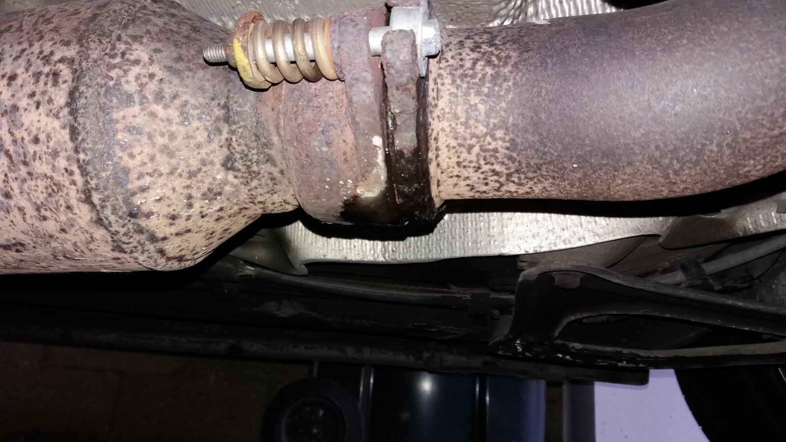

Tightened it all up and now there is a leak post-cat. Looking at the join there is nothing providing a seal, just a clamp.
Plan now is to disconnect the exhaust from the cat, give that a coat of assembly paste and the same again on the join before the back box.
