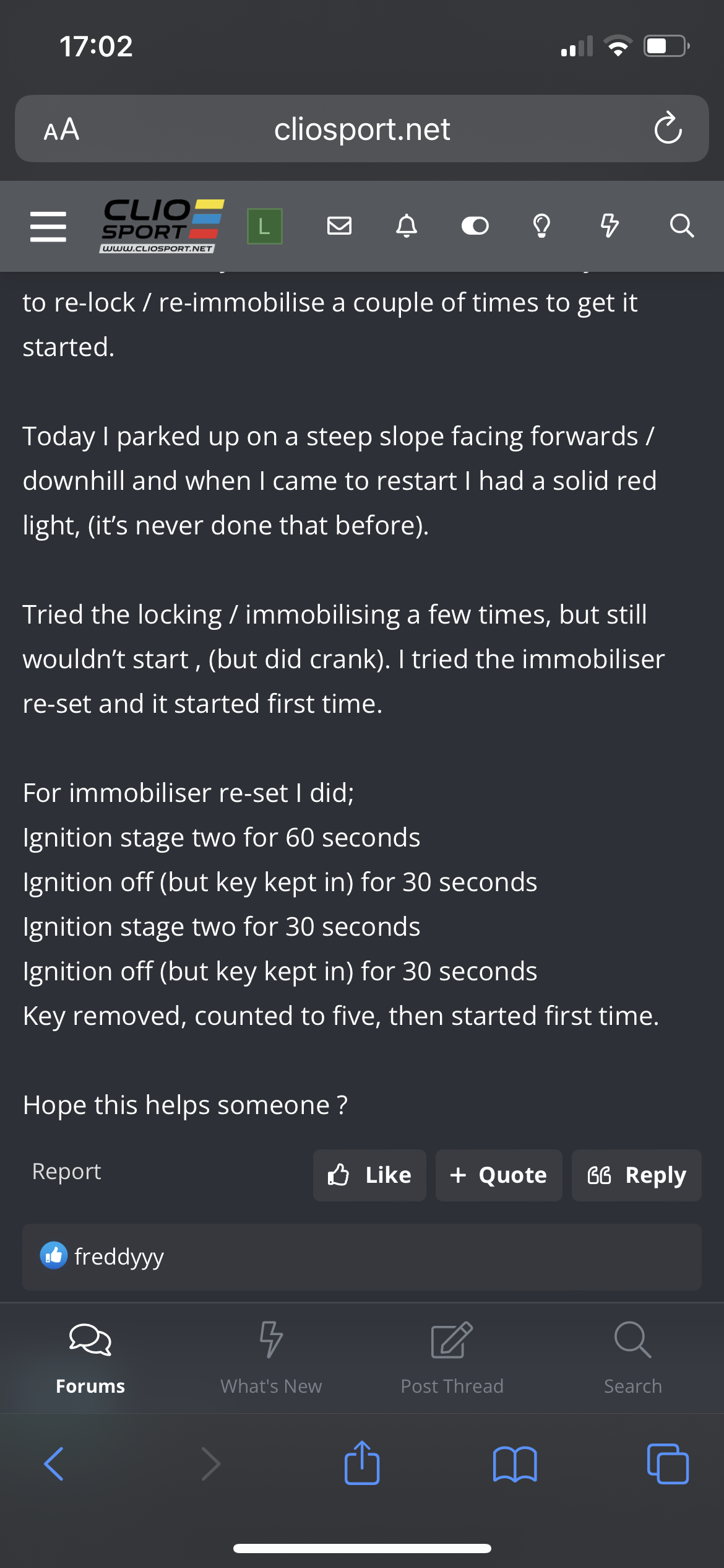

That video appears to be a bit jumpy for me, so can't tell, but is the immobiliser light going out?
Sorted now. Ignition wasn’t recognising key. Did the following and it worked….
chazza114
It could also be a sign that your key is on the way out. For the first 6 months of my ownership, to start the car I had to hold down the lock button when turning the key in the ignition. Eventually it stopped recognising the key, and I had to take the car to Renault for a new key to be coded to the car (cost around £200).
Just worth bearing this in mind of it plays up again.
