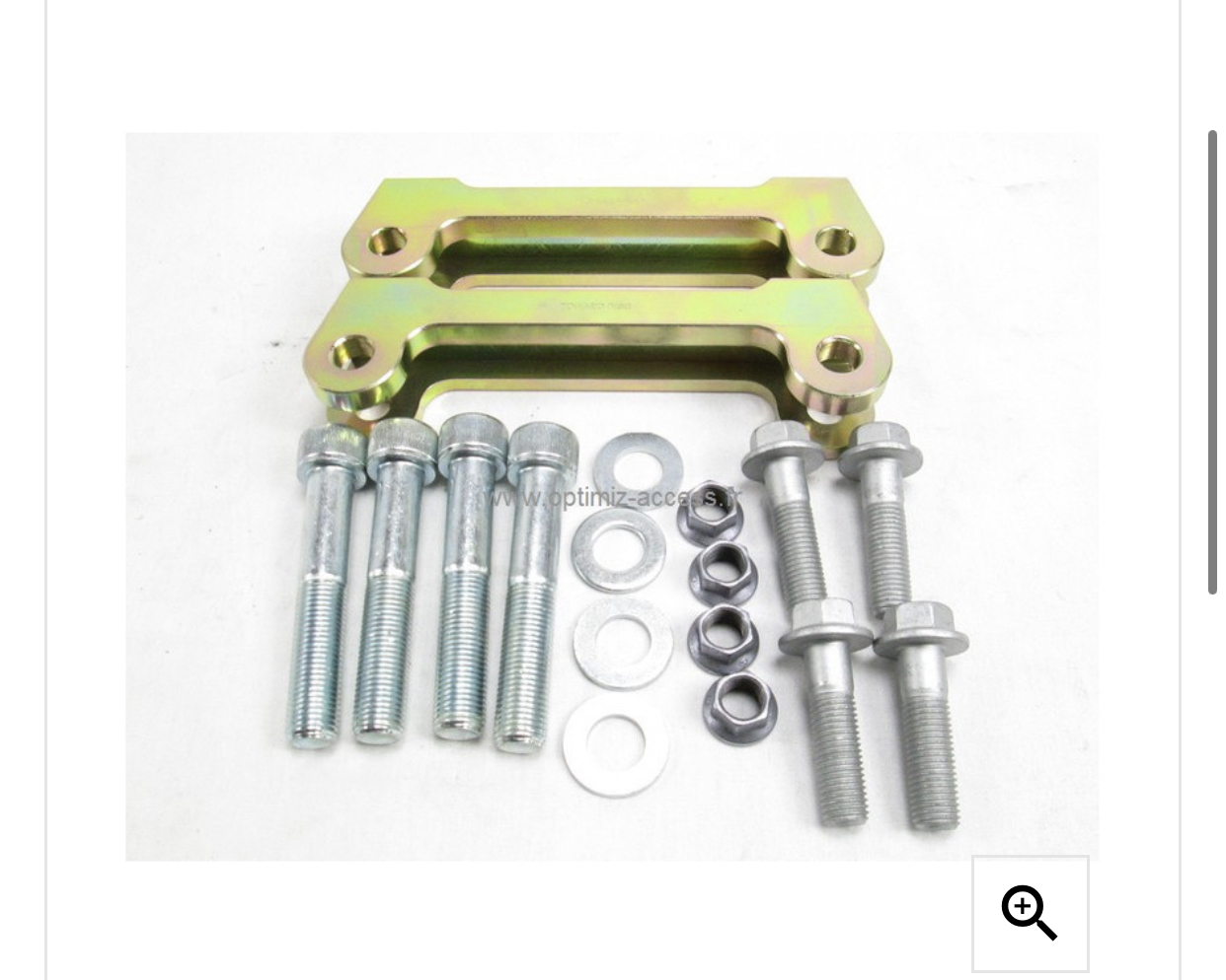

-These things (idk what they’re called in English)
And do I need the brake lines from the 197 too ? What else ?

For 280mm brake discs
- Brembo calipers (depends what brackets you run as these usually need to be machined 5mm)
- 280mm brackets
- Custom brake lines (BRT Motorsport sell these)
For 300mm brake discs
- Brembo calipers
- 300mm brackets
- 300mm Scenic discs
Then you'll need pads, pins and anti rattle shims too

-These things (idk what they’re called in English)View attachment 1592689
Thanks in advance
Don't buy those brackets, they are for a Mk4 Clio.
If you're running 15 inch wheels you'll need to stick with 280mm discs and the brembo calipers will need to be modified. If your on 16 inch wheels the calipers will fit straight onto the adaptor brackets and off you go.
