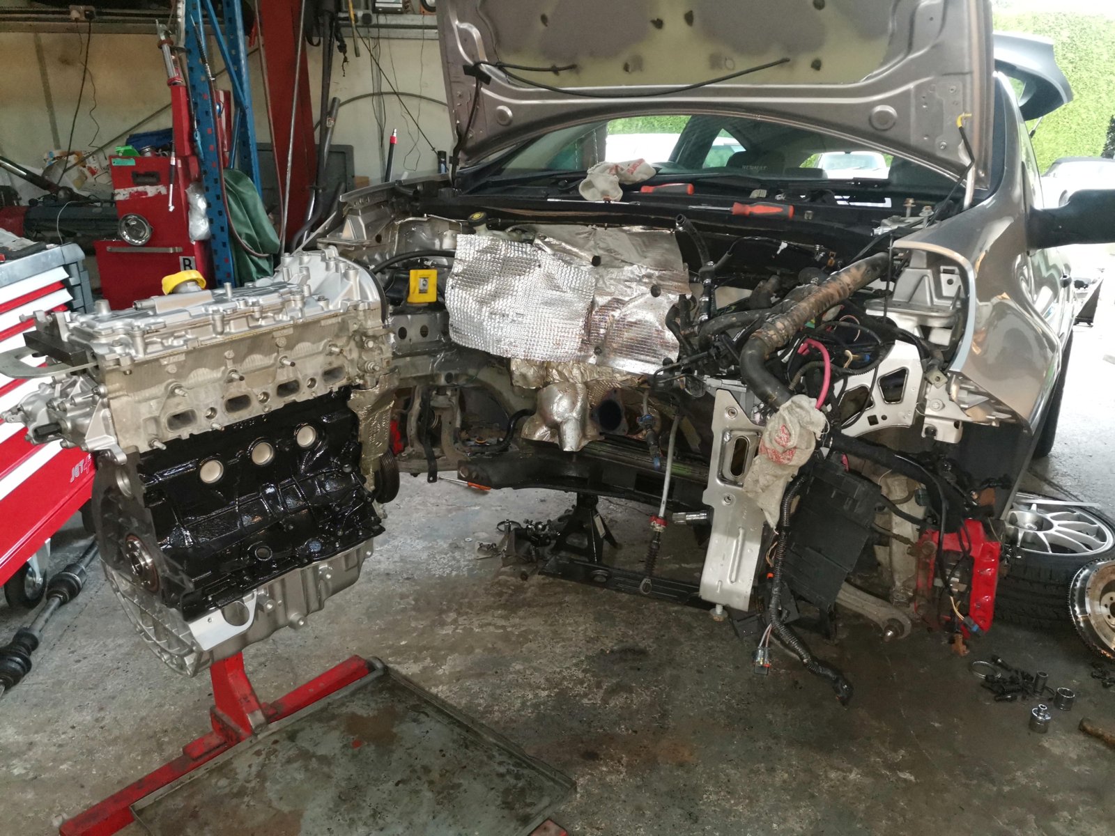

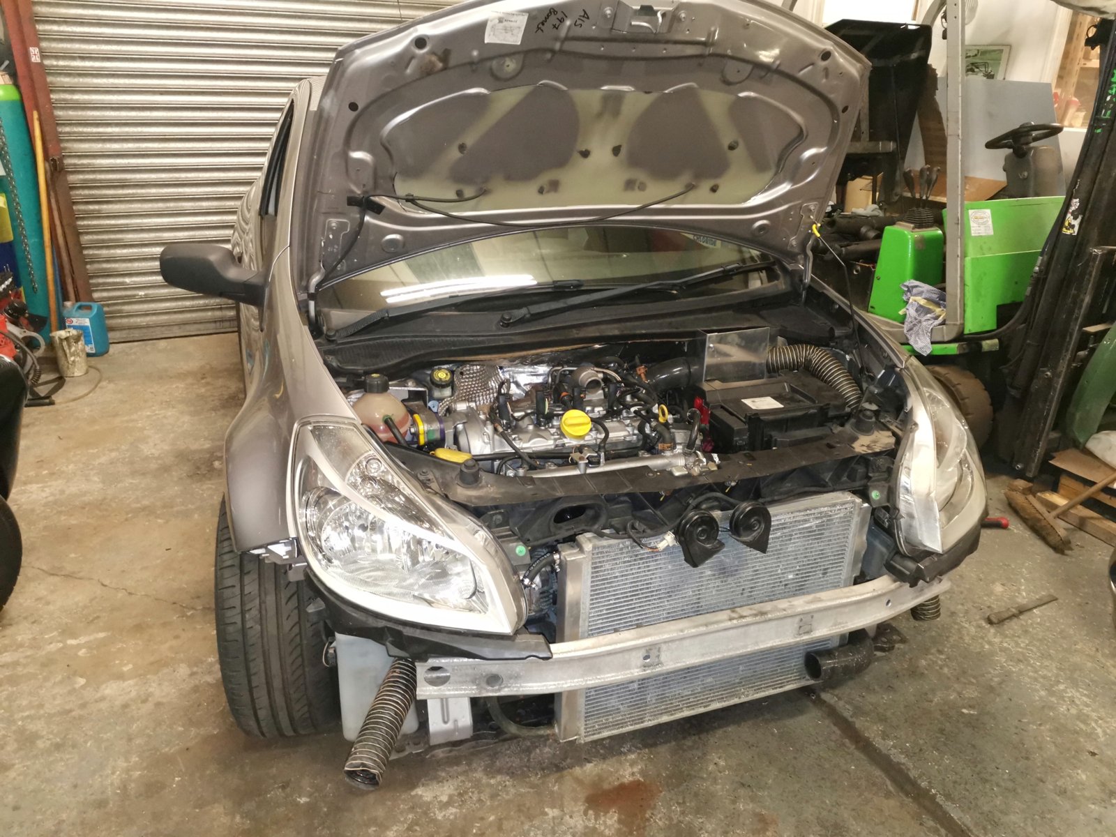

View attachment 1430180View attachment 1430181

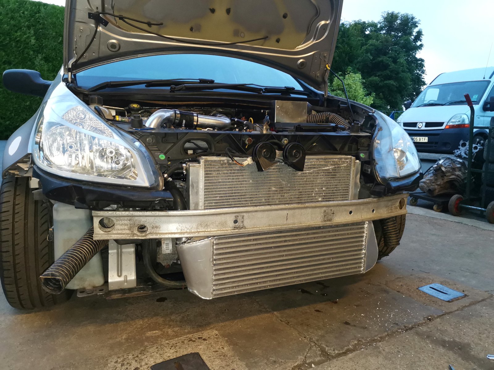

Built myself an intercooler View attachment 1430183
