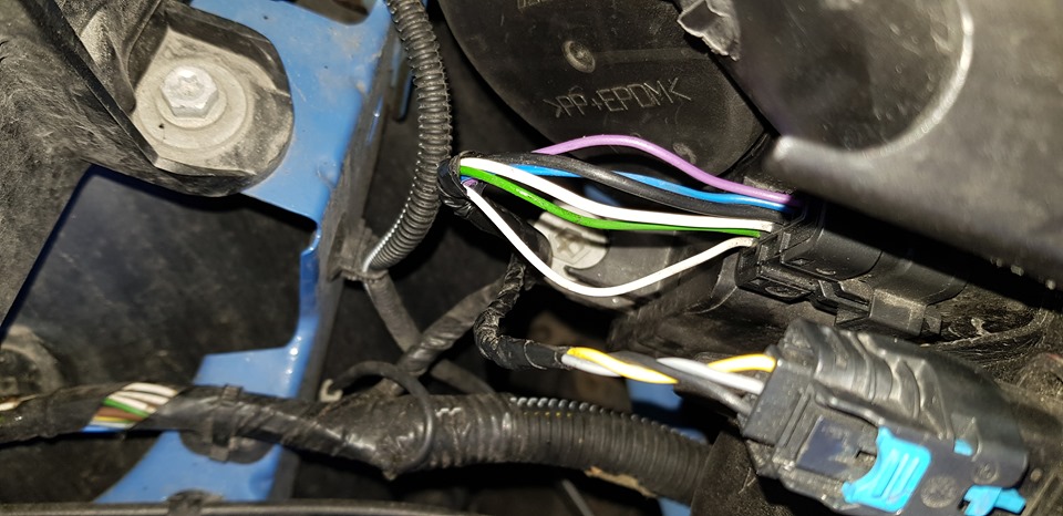

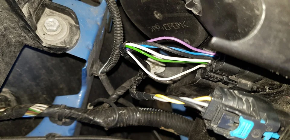

Hey guys. Wondering if anyone has mounted a LED strip as aux light on their Clio 2015 ?
I am trying to figure out where I can steal the high beam signal to my relay for LED bar but I cant seem to figure out where the 12V comes from?!
Am I extra slow or is there a canbus of some sort ?
Any help or wiring diagram is appriciated!

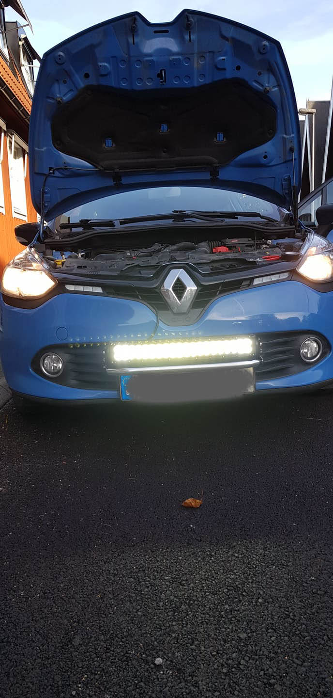

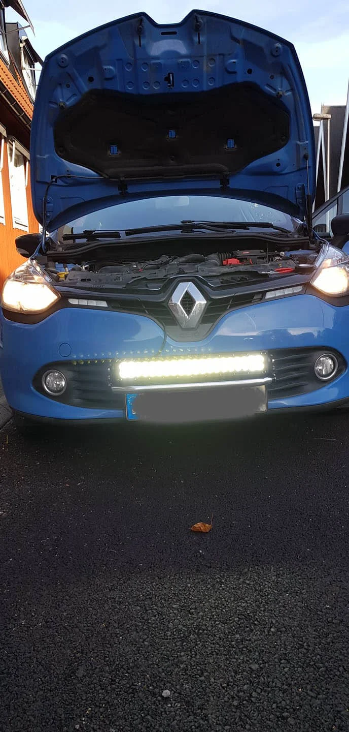

I am gonna just comment myself. Its the #6 pin and its a white cable. Just went out and meassured again. I think I must have had bad ground on my multimeter first time. :) Works like a charm now!
