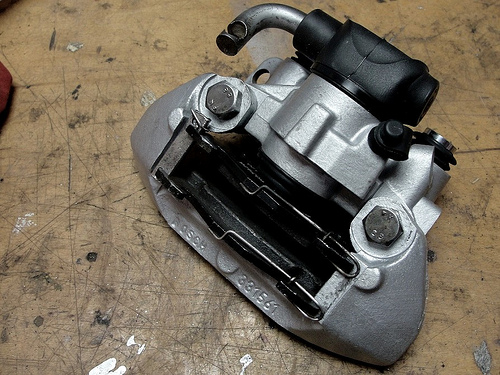

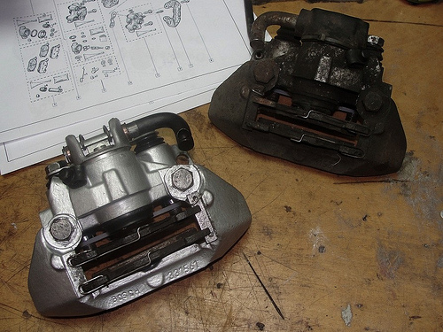

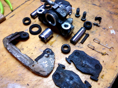

...and the "bigger" project. Last year I bought a pair of a 172 calipers with discs, brake shoes, brake tubes, little things and a dCi100 rear axle from a renaultclub.hu mate. Than for a few month (more than half year :)) I saved up for new discs, brake shoes, wheel bearing, brake fluids so on, and restored the calipers. Take apart, clean, paint, piston boot, gland, rubber dust boot changed, and than refit. Few week ago a finished, I bought everything what I need to the change, so I started it at a friday afternoon. This night I f***ed a lot with the screws of the rear axle. On saturday I solve it, and at the night I almost finished, when I realized that the right calipers female thread is totally f***ed. I can't tighten it, the screw turn around and around. Yeah. On Sunday and Monday I tried to fix up the right caliper with some friends, but in the and, I changed back the dsics to drums on the dCi100 rear axle. (On the other hand, my ABS sign sender didn't fit to the new axle, so I had'nt got ABS.. so.. )
Now I get hold of a "new" right caliper, I restored yet, and from my Hungarian Renault club mates I got some help and solution for the ABS, so I hope in the near future I can tri to change it again... with success. :)
