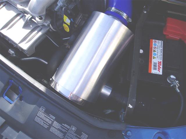

This is what i currently have in my 182 , bit of a prototype , running both the original CAF's . It has a Green cone cotton airfilter inside i also have a K+N cone cotton air filter identical in size , when i get time i'll fit 2 70mm CAF's and ditch the OEM ones . Both filters have a larger surface area than the original panel filter .
  CLIO Iceberg 172
that looks spot on how did you create the cylinder? how did you wield it etc details if you don't mind you could pm me if you don't want to advertise.
i would love to see some drawings of your idea if you didn't mind

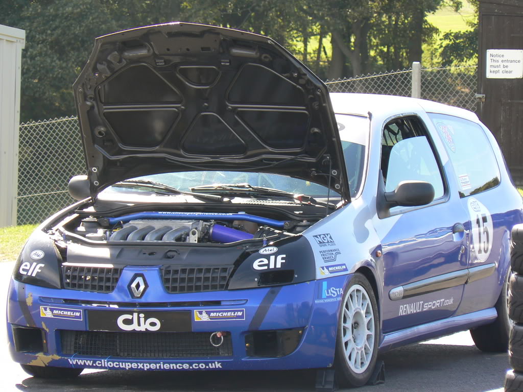

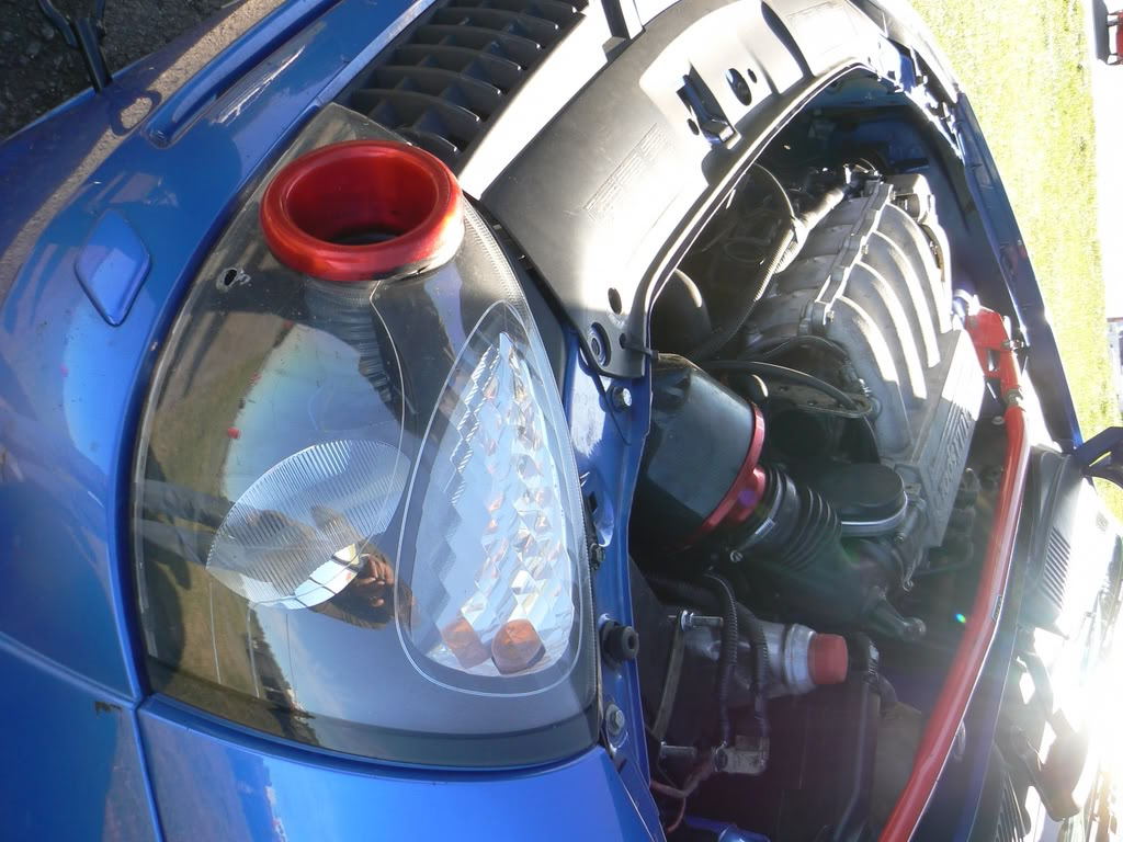

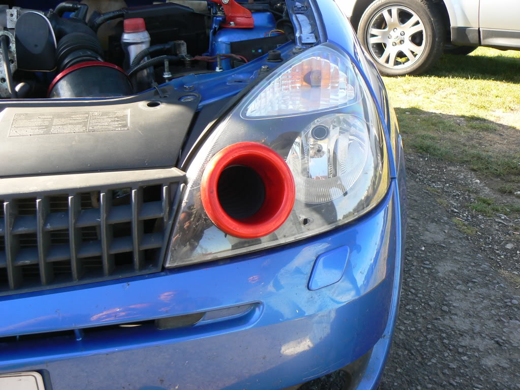

As I recall the biggest restriction on the RS clio air in take is the 90 degree bend and not the airbox/filter.
A cup racer setup has a relocated battery and straight as possible intake pipe from the passenger front head light.
You can just about see here:
Or there is also the Ghetto method:
  172 cup
the throttle body size is 70mm dude. Dont like the look of the caf trumpet out of headlight method IMO. Yes the 90 degree bend is restrictive, but still more can be done with the battery in original location. As quoted on ITG website there filter gives a peak gain of 7bhp and before you say it yes it is proven. My guesses are about 50% of that gain is from there silicone elbow alone, then filter surface area plays a roll and obviously for that you need a different airbox. Then theres things to think about like air turbulance and air feed. Looking at the inlet system design on the 172/182 turbulance will be created in the plenum so thats not such a big issue to worry about in terms of design of the airbox. So bigger air box that houses the ITG filter that looks 'similar' to maxogen/v6 would be a winner if you ask me
