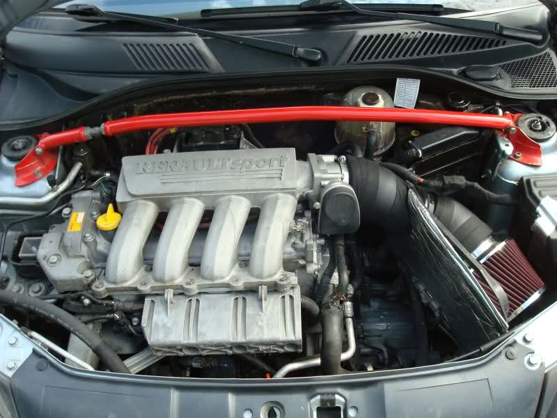

This is how its sorted on my car.
Did some testing on RStuner CAI vs stock and IMO there is no difference between these two EXCEPT temp of air in the manifold. So some sort of heat shield - resistance material ( no metal ) is a must have when thinking about this.
On a hot summer day it makes a significant difference and a nice sound too :cool:

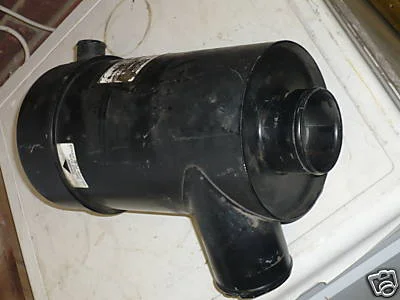

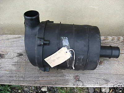

i was just having a look at some of the box's floating around in the whole v6 style of things and i came across a few designs that look very simuler,
has anyone thought about the following:
the landrover discovery 300d airbox
and the 1998 renault scenic airbox
The inlet pipe isnt pure foam is it? :eek:;)
Should be a difference in flow aswell due to being less restrictive with that set up ?

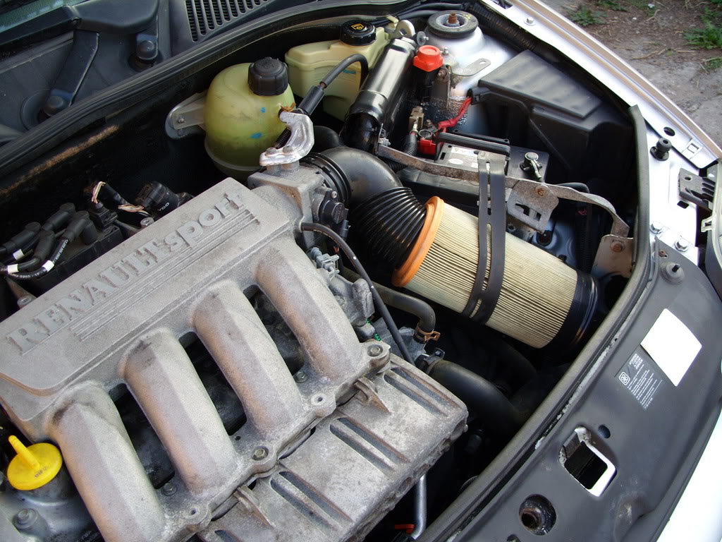

sorry removed all the "DIY Maxogen" pics from my photobucket
current set up is like this,
All i need is a trailer and some headlight blanks for a direct cold air feed, but as i still use it on the road thats not possible at the moment.
That airbox is about £60 from renault, £5 for a samco straight and £35 for the ITG filter element, no point buying a maxogen really, only for the looks, or doing a new cheaper one form scratch

No mate, inside of its a plastic tube ( more of them actually - used for drainage ) made into one and then wrapped with a thermo isolated foam.
Restriction differences are more-less the same - both are around 20 - 24 millibars ( from 2k rpm till 7500 rpm ) but the temp difference is noticeable in favor of CAI of course.
At that time i didnt have PTFE gasket as I have know and my intake manifold has been rebored and port matched.
Maybe it looks a bit pikeysh but I love the sound and difference in performance, not to mention DIY approach and low cost
i probably didnt word what i said very well, theres no doubt that the maxogen is the best air box for the clio, but i wasnt going to pay near on 400 quid for it, If i could get my hands on just the box and filter at a reasonable price i would try it back to back with the espace v6 air box, id have to move the ECU and catch tank/get a longer samco straight tho. i think removing the inlet bend made the biggest difference, but comes with the ballache of relocating, using a different battery.
  VaVa
I was going to say that getting rid of the 90 degree elbow will have made as much difference as anything.
I've no doubt that the way you've done it is perfectly fine. But it pisses me off that people make out the Maxogen is crap and pointless when a) They've never tried one and b) the only reason they say so is because they can't justify the cost.
It's the best there is. It's down to the individual whether they consider the extra little bit to be worth the cost. Law of diminishing returns etc....
