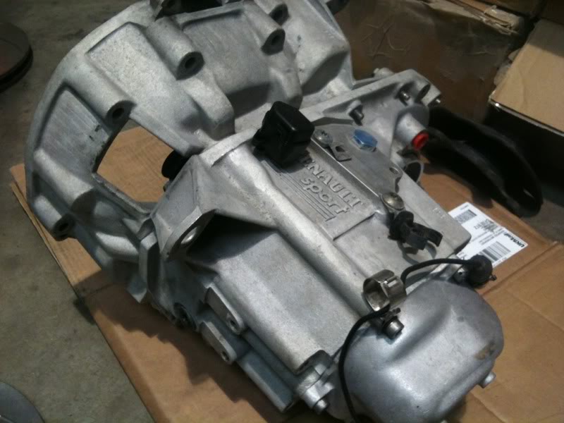

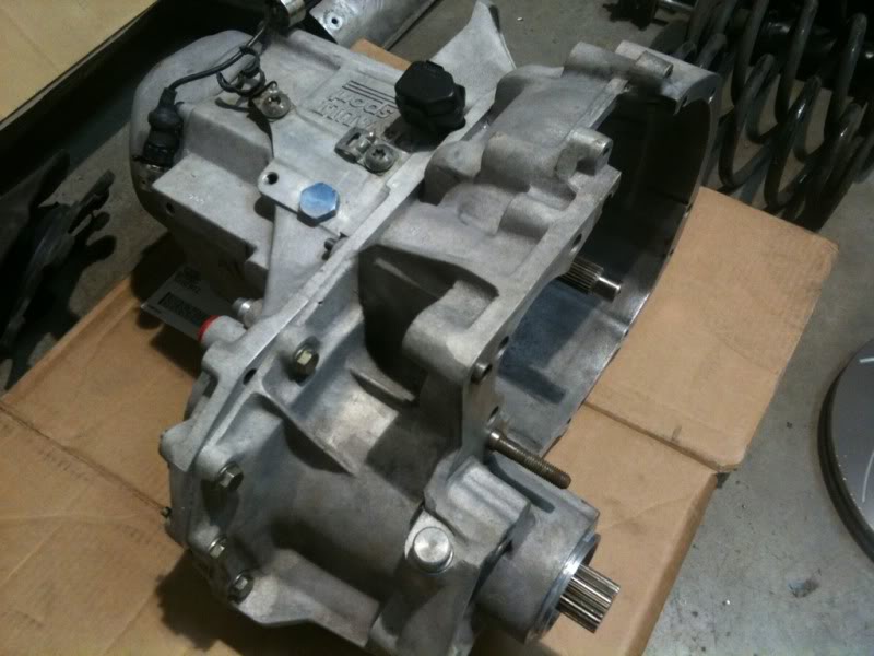

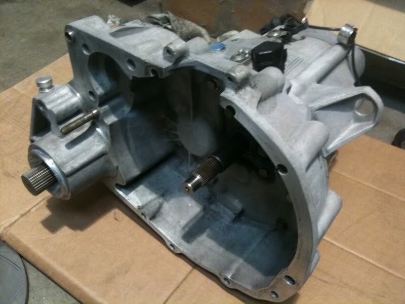

Can i have some pics of the gearbox casing please?
Mine has just come back from a rebuilt with a lower CW&P fitted
Thanks for that, very interesting. Can you show the attachment of the linkage please? Has this got a sadev LS diff fitted? Could i see a pic of the driveshaft area too please?
What clutch will you put on this?
Would also be interested to know what was the wear at the rebuild and general condition of the box and how many racing miles it had done since last rebuild, if you dont mind.

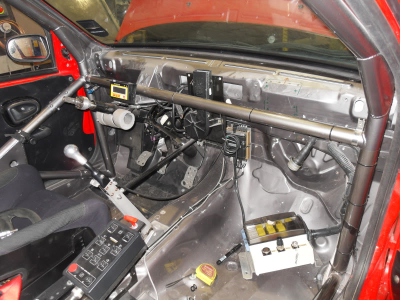

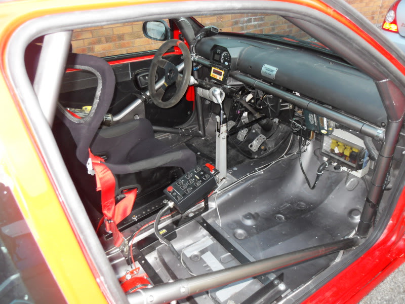

Here it show our dash that is totally different from the road car
And stripped out ready to be made right hand drive

It's not that big a job actually , I had to cut the holes in the bulkhead for the rack and pedal box , and weld on a new bracket for the steering column , you can see in the lower picture where I have marked it out ready , got a bracket from cliospares , everything is staying in place so I can swap it to LHD if needed when I come round to sell it.

Plan to lower the steering column in my car, just like it’s done on your car. Can you please measure how thick those spacers are? They can be seen in this picture just above the top of the gear lever.
Thanks in advance
Hey Ian,
They are actually longer in that pic than they are now. They are 1.5cm now. I wanted the steering wheel back up a bit as it was too low.
