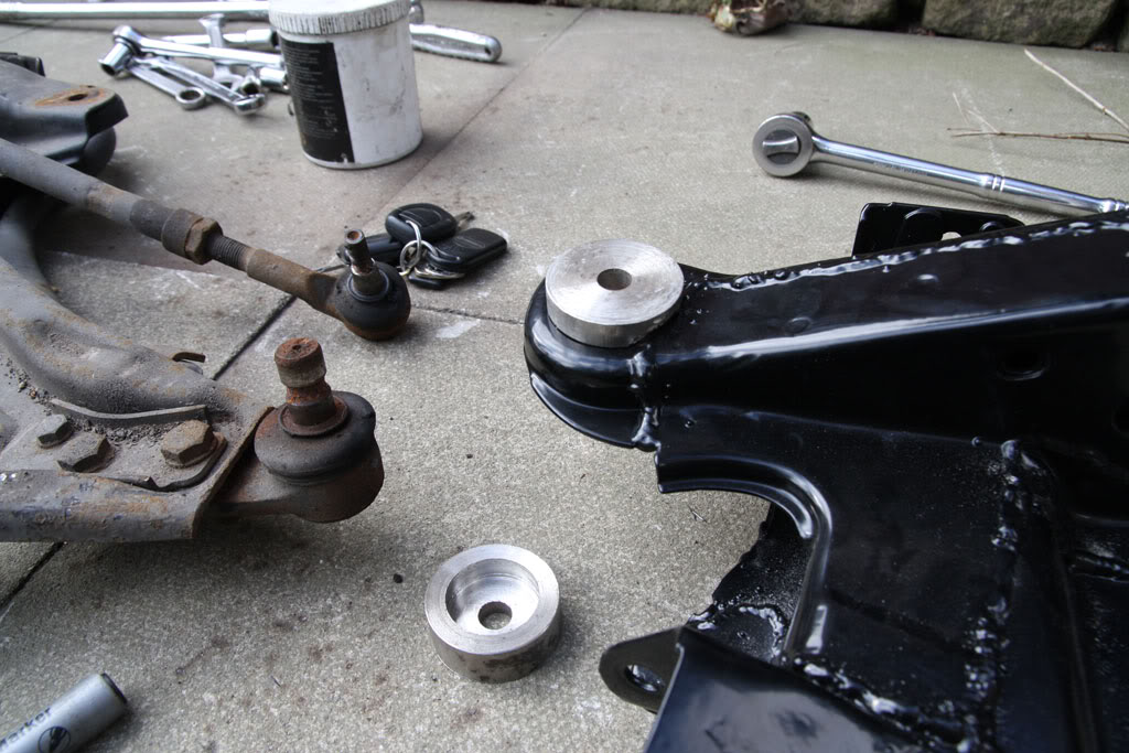

Did you manage to get a replacement mount in the end? On mine it doesnt have studs it just uses bolts. Must have been changed at some point, maybe for reason above.
  Clio Cup Racer
Replacement from Rsport was going to be £100 in total. £30 for bearing. £70 for metal part. What a joke.
So I extracted the stud and replaced it. You could use a bolt as well mikekean, would work fine, I just decided to replace the stud.

Ok cheers, was thinking about getting some of the bushes as spares for when the original's perish and £90 for all 3 isnt to bad.
Yeah mine already has bolts like I said and its fine, probably because of what happened to yours maybe.
All 3 mounts are exactly the same so if this is a common issue then it could happen to all 3 in theory
mikekean
  996 C4S, 135i, E30x2
Personally i would replace all the studs with high tensile bolts. A 12.9 or a 10.9 bolt would take some serious abuse before it snapped.
Mine has 10.9's and its been ok in my ownership, fingers crossed it will stay that way. 12.9 would be to brittle i think.

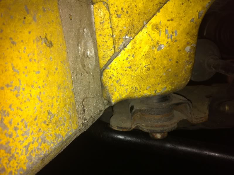

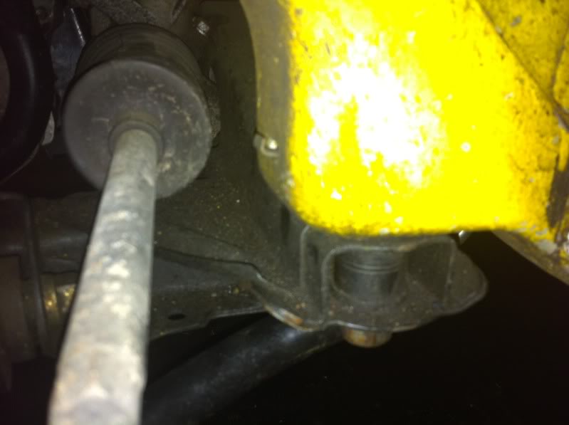

Where the subframe mounts to the chassis - at one side it has a rubber spacer - at the other it doesnt. Seems to make the sub frame wonky. Noticed it when fitting new ARB bushes - the bracket at one side fitted between the subframe and underneath of the car - the other side was hitting the underneath of the car.
Should it have a spacer at both sides? No spacer at either side? Or is it right having one at the one side, doesn't seem right to me.
Driver side (no spacer):
Passenger side (with spacer):
Arb Bushes:
mikekean
Can say i have noticed that on mine, if I get chance today I will pop up to the store and see if mine is the same.
Mk1s are the same with the rubber bush/spacer, never really looked at why it is. Mine was all falling to bits so i got rid of it and machined up a steel spacer that sits in the hole to the same height instead

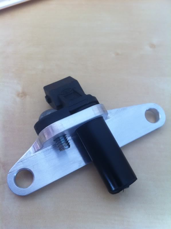

Had major problems when the car was back together again that it wouldn't start. Was trying everything but tracked down to Omex not getting sync with the flywheel. You can monitor by the software and see it changes to Stat Sync On when it has sync. Went and purchased a new 'blue' revision 4 Renault CPS sensor but this didnt help so had to approach Omex. Ecu went to Omex for testing and to be fair they were pretty helpful - they are busy people but managed to bench test the ecu and try it in a customers car. Result - they basically said there is a known problem with the Renault sensor and they recommend using a Ford Zetec sensor. They said the customer's car they tried it on worked for 4000 miles on a Renault sensor but stopped working when they went to try my ecu on it but changing it over to a Zetec sensor worked fine and ran with my ecu.
I was doubtful but purchased a Zetec sensor and Omex sent the ecu back up FOC.
Used one of my many renault CPS sensors to make a bracket for the Zetec sensor by chopping off the sensor part and attaching a L shape bracket to mount the Zetec sensor onto. Tried it in car but car wouldn't start. Tried swapping the CPS wires round and boom she started.

Got the car out on the 23rd May. Was with my temporary bracket for the crank sensor and unfortunately by the end of the day the bottom on the sensor was worn through because the gap was wrong. Very hard to make up a bracket and get the gap perfect without removing the gearbox.
So was chasing Omex but they were awaiting stock. Got dingy'd for a bit but eventually out of the blue they sent me a quotation - they had stock again and £50 later I had one the next day.
