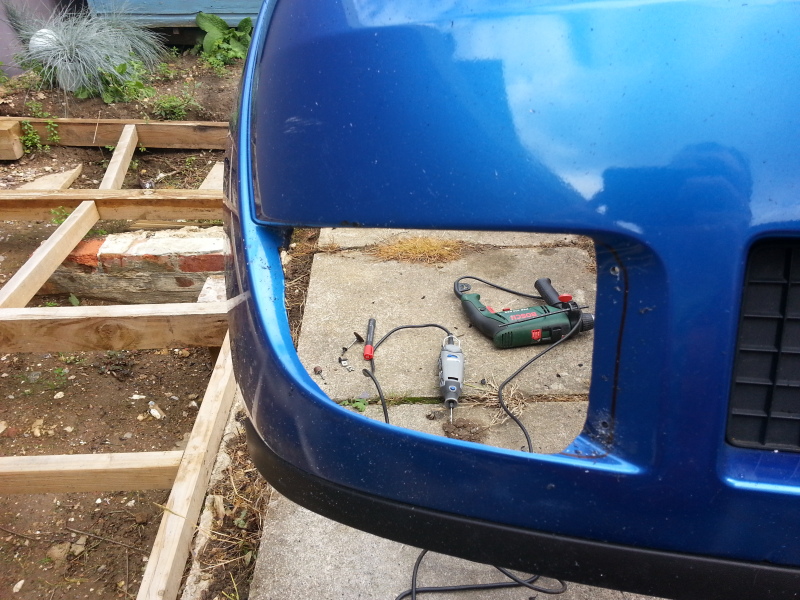

Another quality purchase from Chris @ CM Composites. This one needed more 'tweaking' to suit the car...my car especially is a little awkward up front.
Took me a day all in to get the bumper right, ducts right and the deflectors on. Like the roof scoop, the FRP is well put together and stands up to my obsession with the torque wrench.
Should be able to test them out tomorrow at Abingdon :)

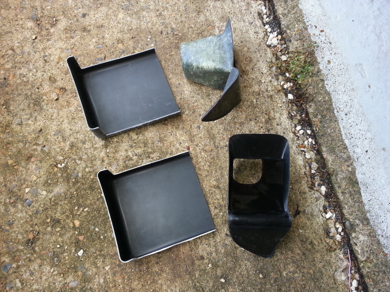

The kit

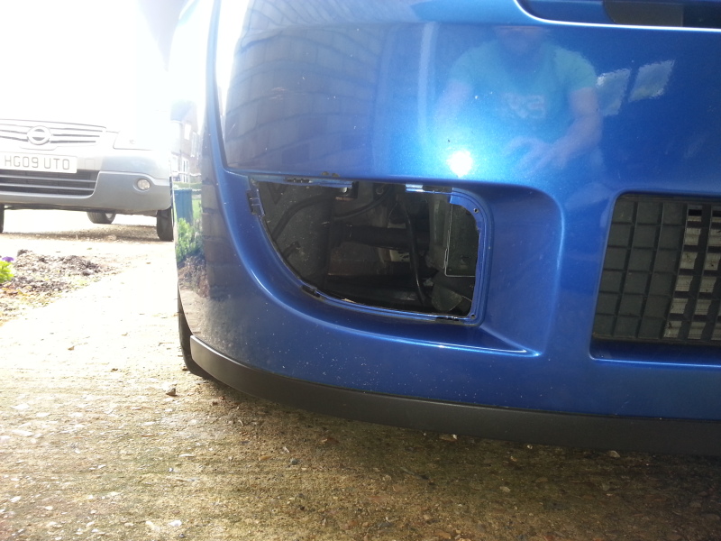

My fog light surround (already cut for previous ducts)
Cut for new ducts

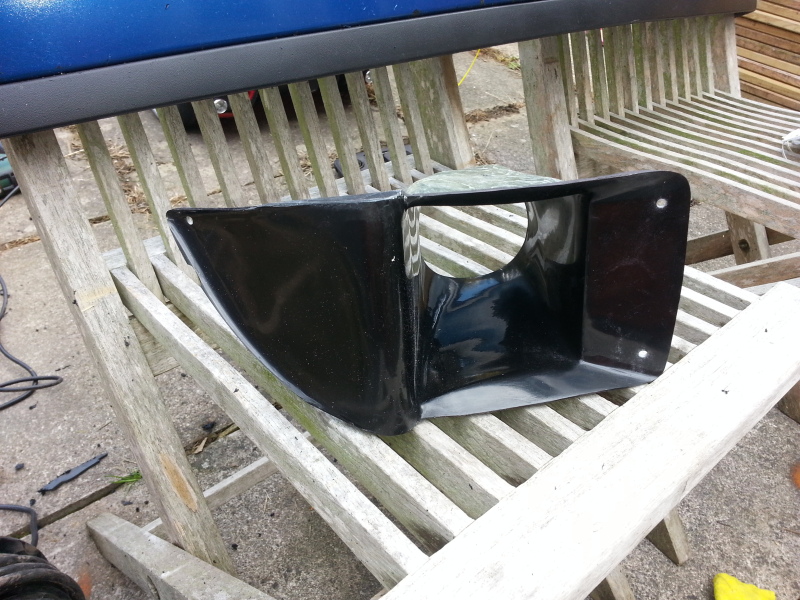

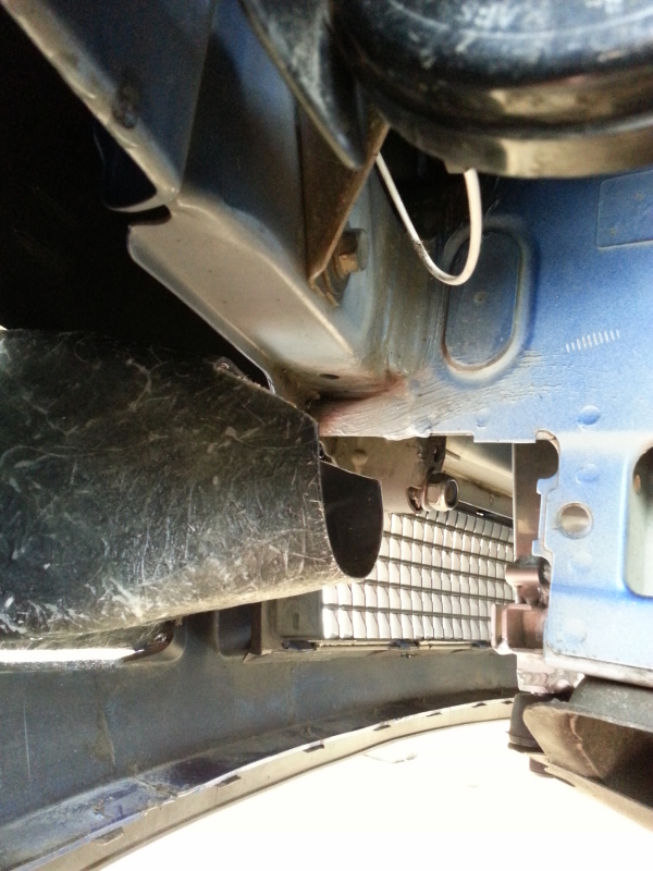

Ducts ready to fit

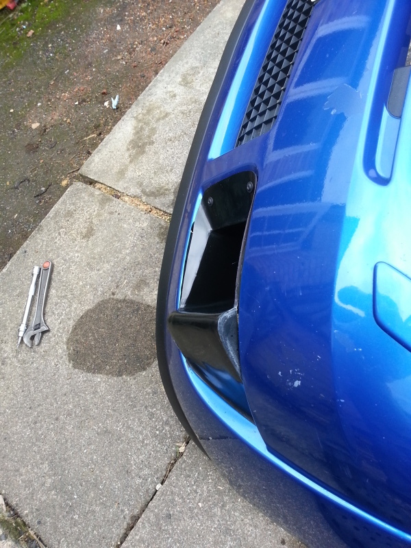

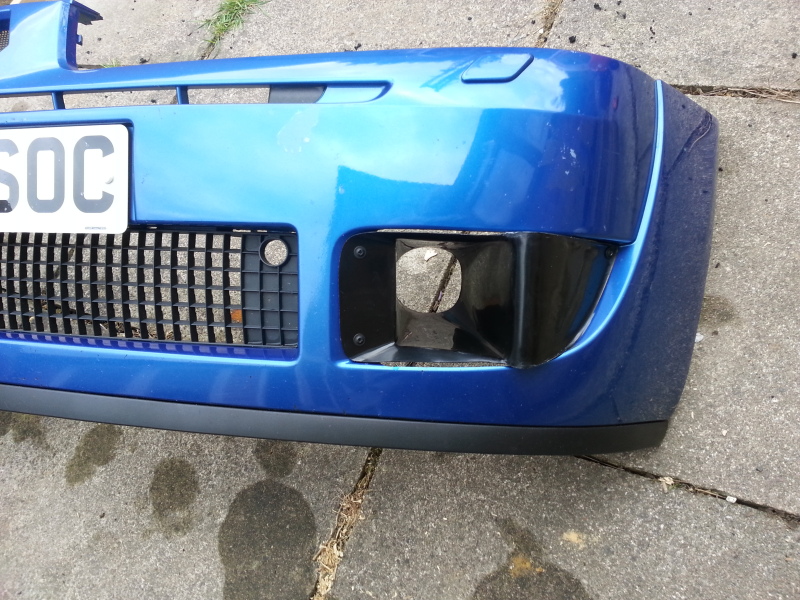

Duct fitted (two angles)

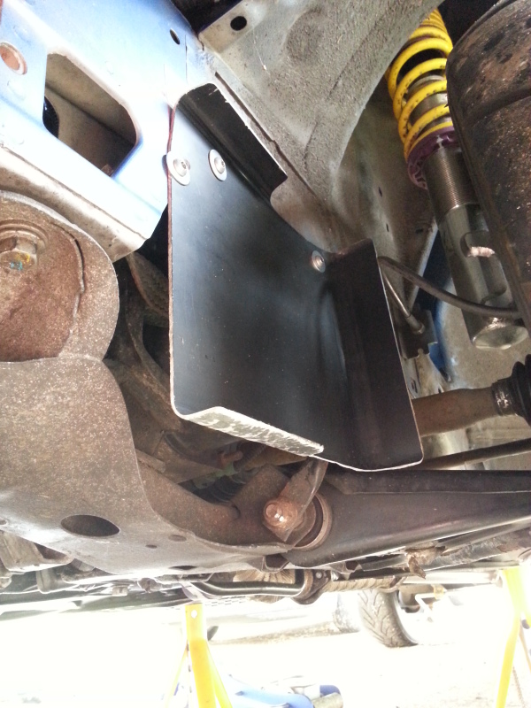

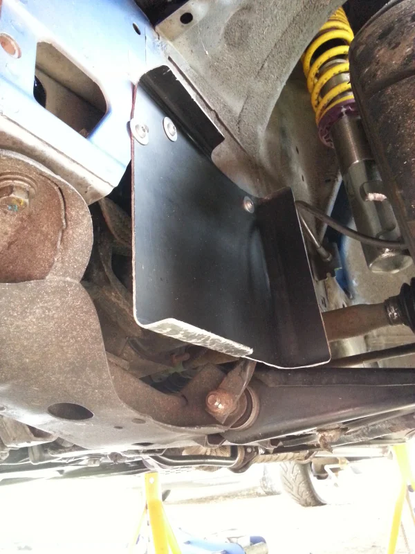

Deflector plate in place
Back of duct

I'm not sure I could live with that gap top and bottom! I might have to fiberglass mine in and paint the bumper. OCD would go nuts lol
Because racecar for me. I could have done a neater job tbh...bit of a rush for a trackday tomorrow.
My bumper is lower/angled as there are no innards anymore to save weight so the ducts would clear a normal bumper. The plates are universal so need cutting to suit. I run 2118s with no spacers and neg 3.5 deg camber. I had to cut to clear the tyres on full lock.

The cup racers used to run ducting cable tied onto the deflector plate for more direct air when the wheels are turned Tony, the originals need some finessing for clearing the chassis leg as well
Chris's fit on james bumper was nice, but you chopped out too much no? Or didn't they slide in?

Glad the brake vents worked well, the original cup racer ones had gaps at top and bottom too...
I fitted mine the other week, still need to fit the deflector plates. I saw a Clio yesterday where it had a second deflector plate fitted (a lot smaller) on the wishbone to direct air up from the ground, this is something I am going to look into fitting.
