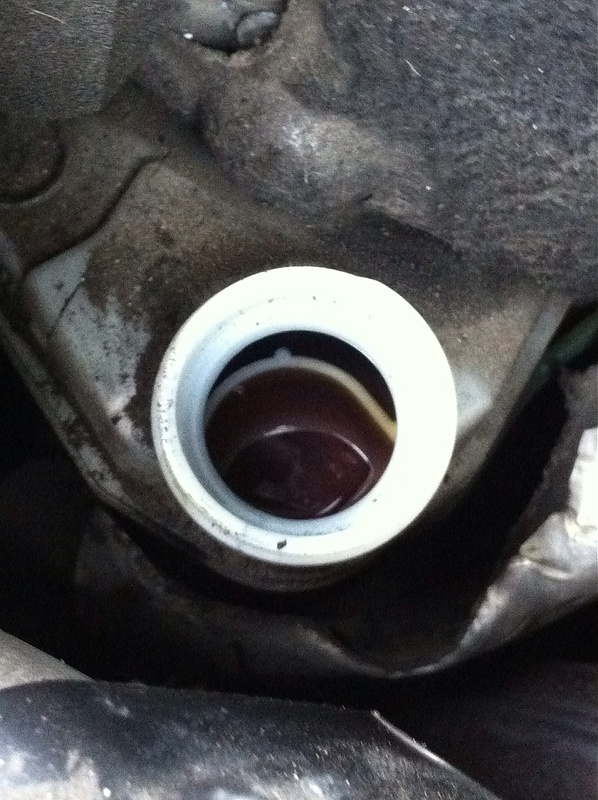

Brake fluid level is the same as in my 182 so shouldn't yield any problems. it's around the top of the white lip, pic doesn't show to much.
We drove it yesterday and it kept coming on and off as you described, didn't seem to be a pattern to it being on and off.

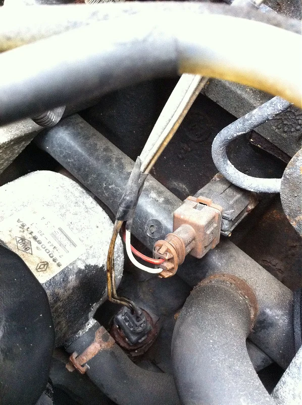

Which one of the below sensors is the oil pressure on (will chuck some wd40 on it)

Sensors

Sensor?

As there was no knocking and the car ran fine I was confident the sensor may be busted even though the fault codes showed nothing
I replaced the sensor today which is on the front of the engine, neither of the TWO near the filter. It's the sensor just behind the fan with a single wire coming out.
To replace it you will need a deep 22mm socket and about 10 minutes of your time if you have the tools. Leave the car to stand for a bit so all the oil it in the sump.
