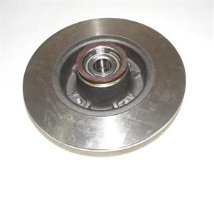

Ive just changed the rear discs and pads on my Clio Mk3, however, when I drove the car the ABS light came on. Thinking about it, I cant remember seeing the ABS magnet on the new disc. It is not a toothed ring like previous models, its a smooth flat disc. Does any one know if I can buy them separately and if I fitted them, would the light go out on its own or does it need to be reset??
Here is the ring in question, the dark area on top of the hub!!
