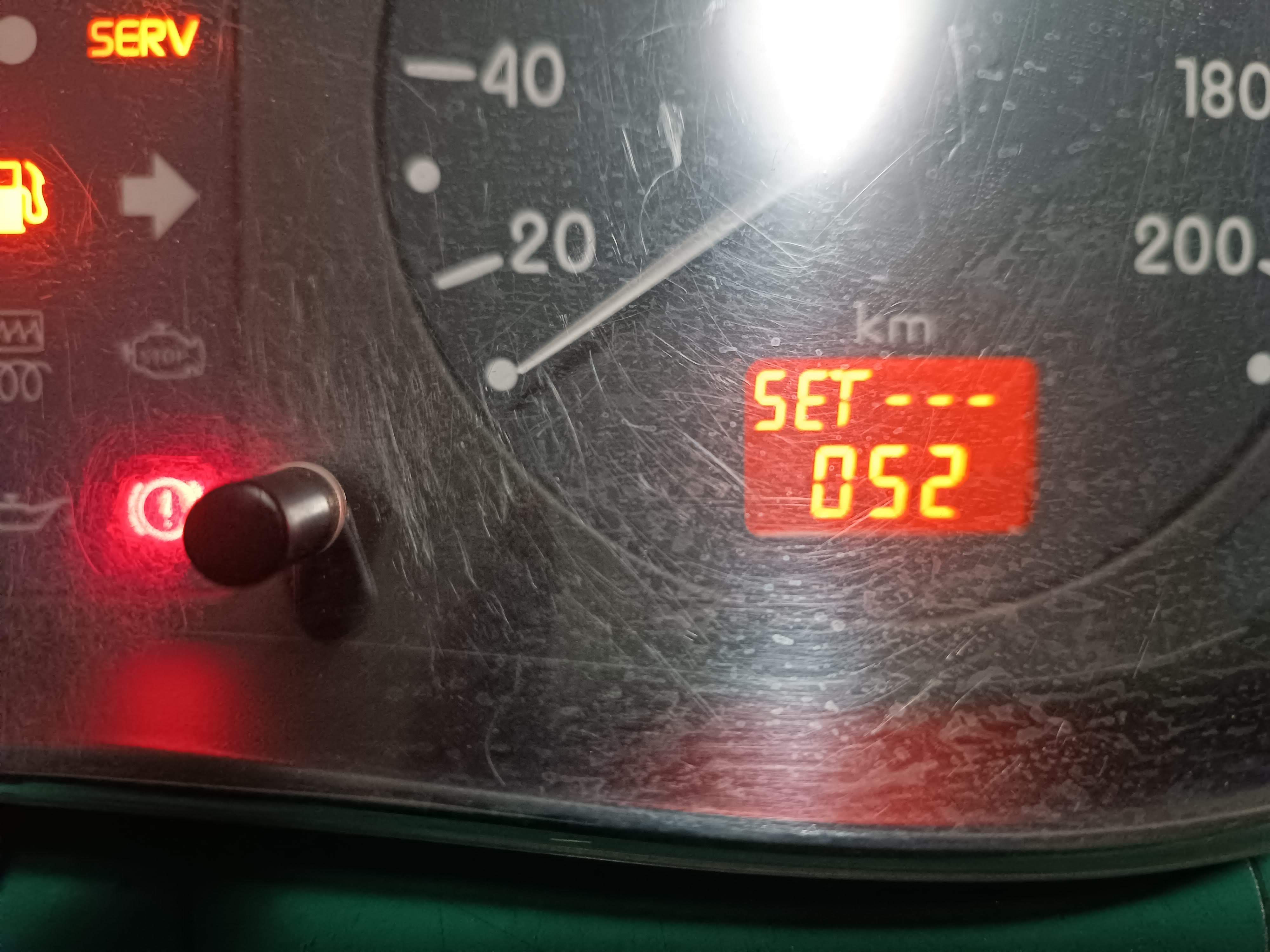

So ive started with this process.
So far im able to read CAN messages from the gauge cluster.

Has anyone seen this before or know what it could be.

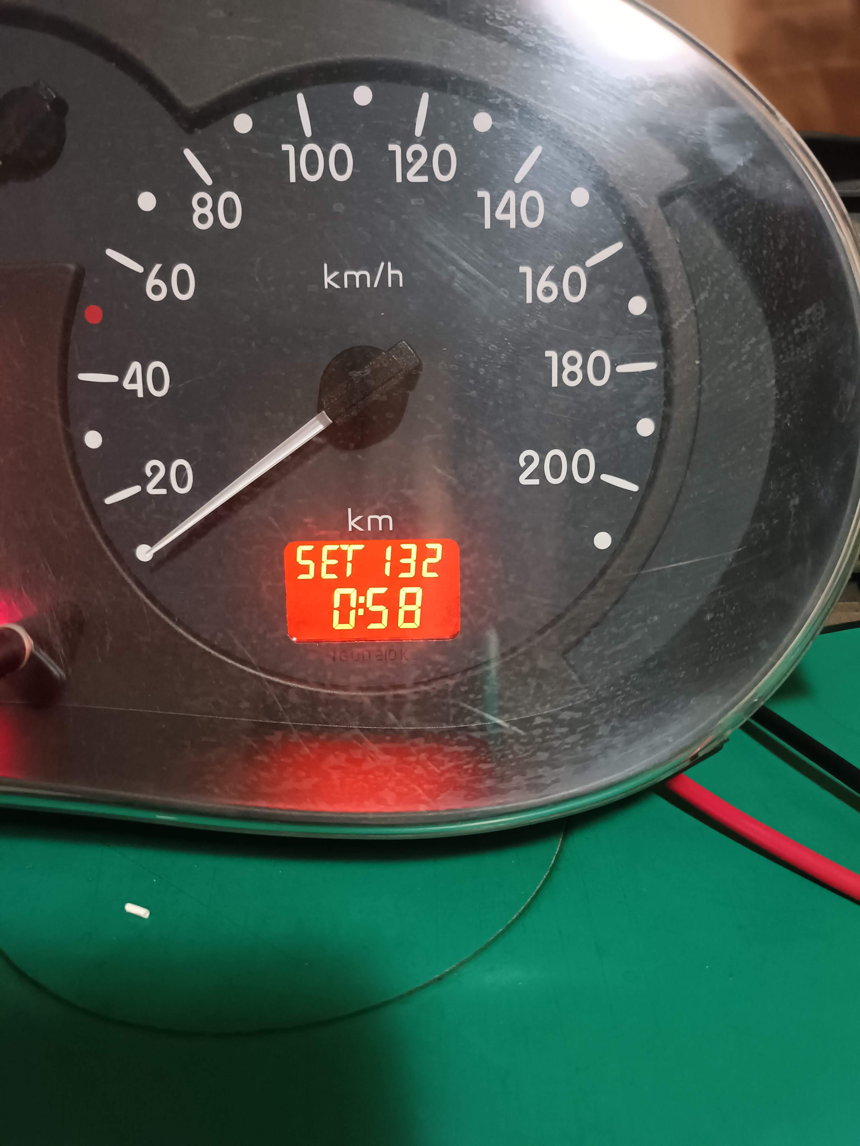

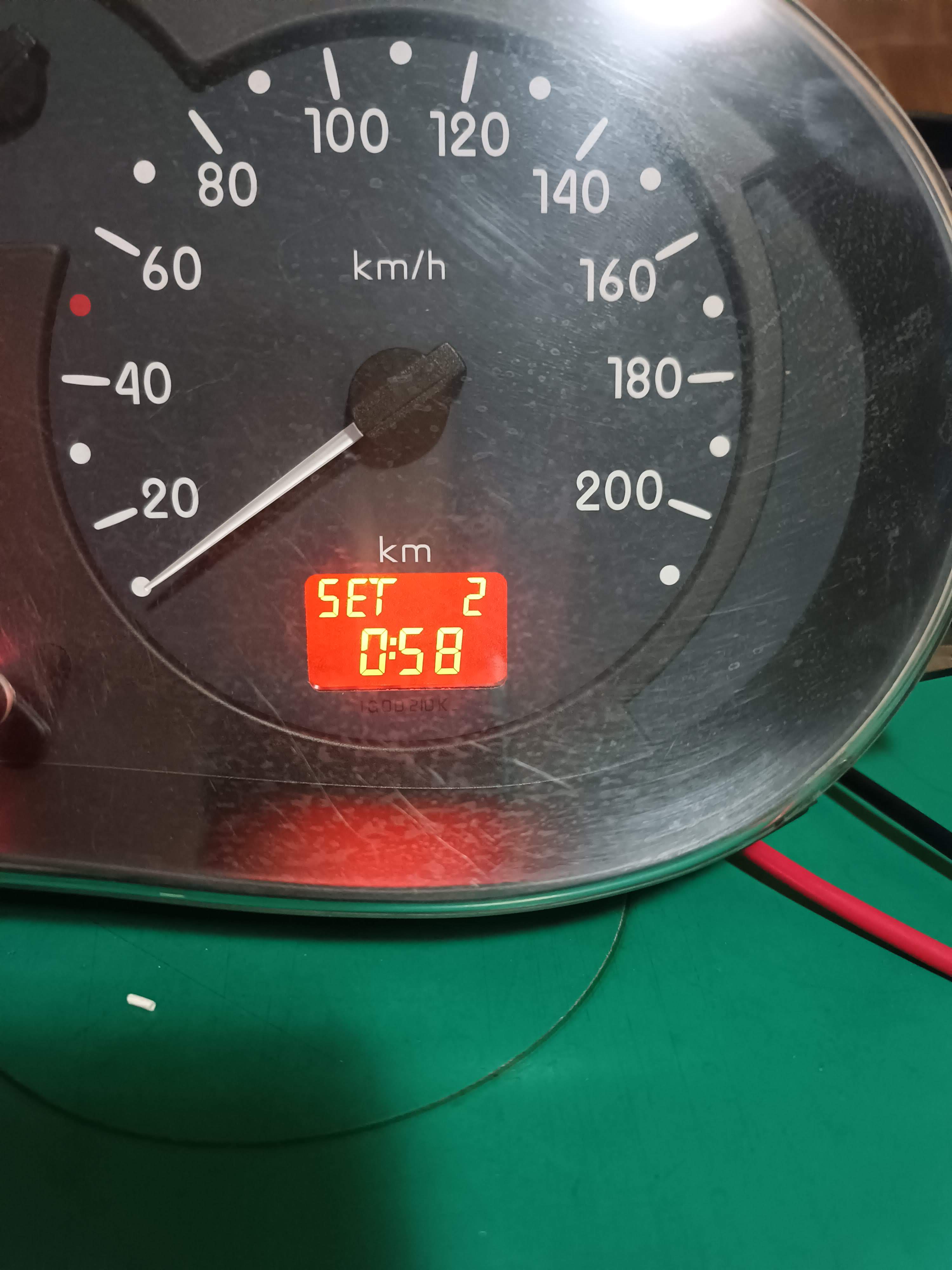

Its a message that gets sent from the ecu onto the can bus and if i change the last two bytes it shows that on the instrument cluster display. By changing the byte values i can change the number displayed with set, 132 seems to be the max.

So i have pretty much full control over the instrument cluster, so id say it was a success. Videos of it working are in the google drive folder.
