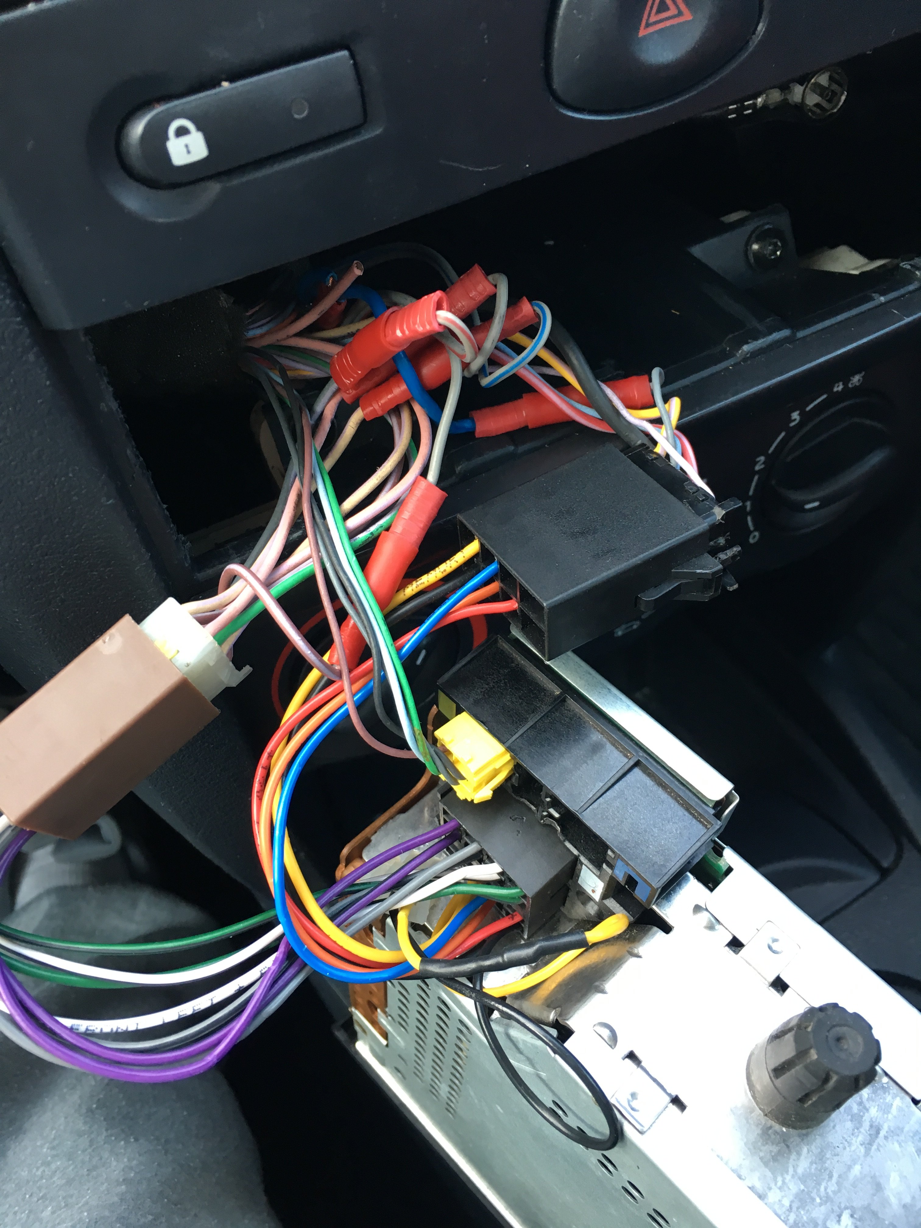

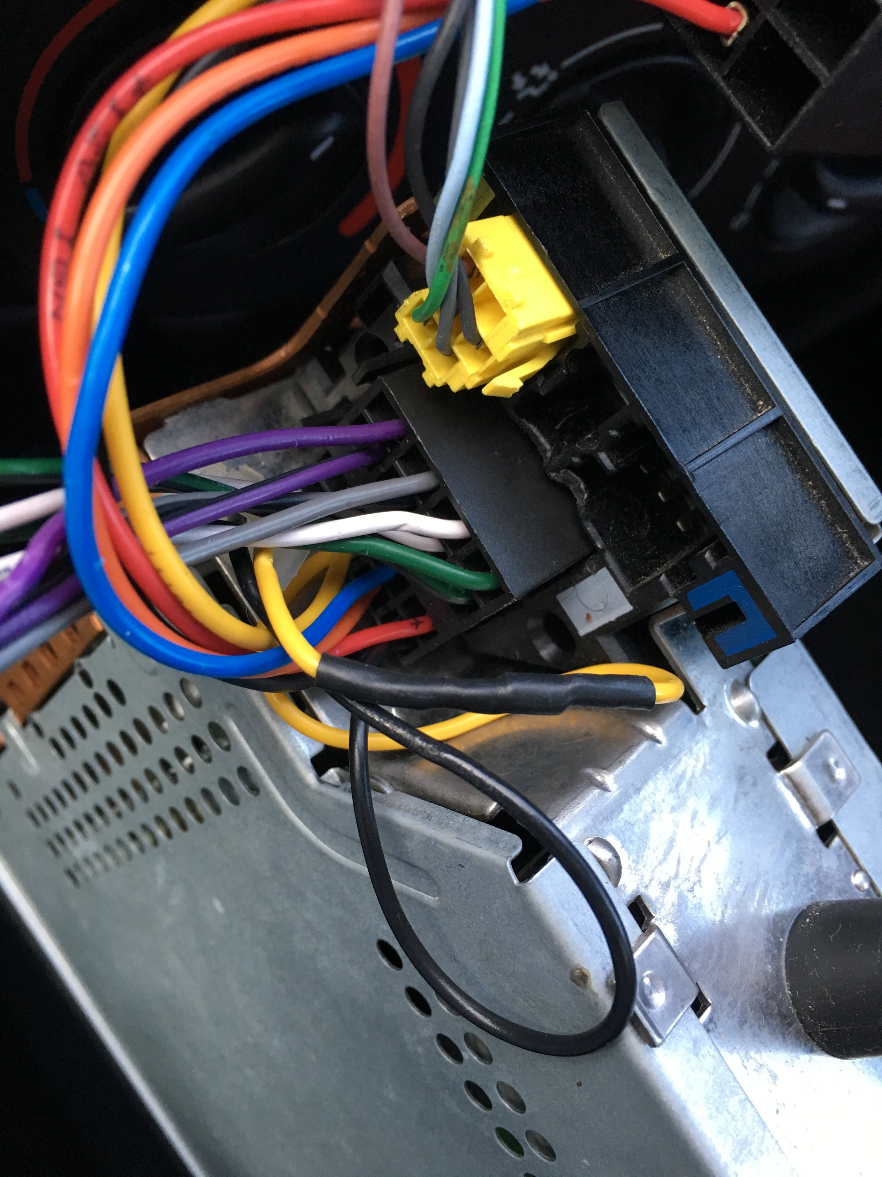

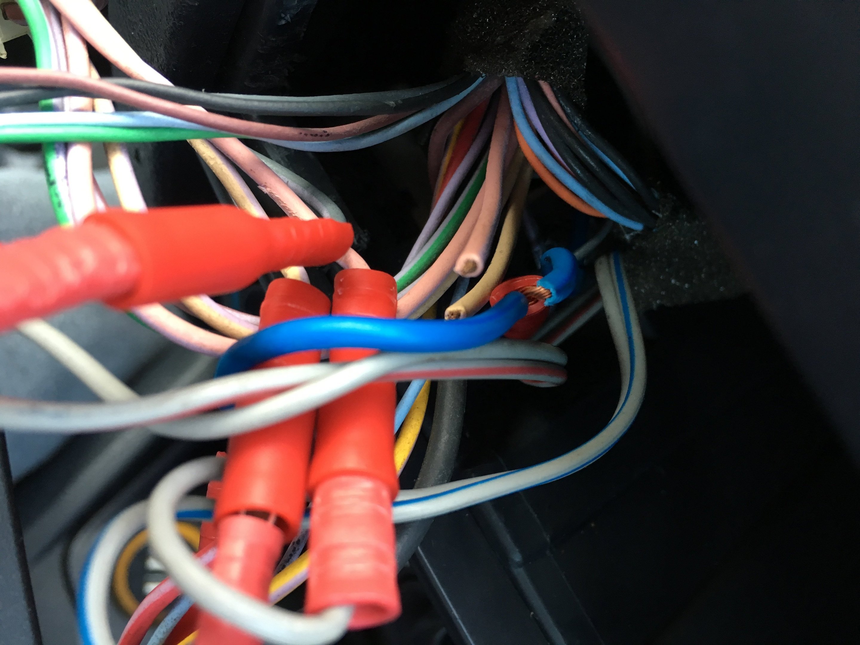

Aha yea I don't think it's a fuse, I just went to have another look and I found 2 wires that have been cut. I will upload some photos to show you.
  Clio 172 Merc ML55
I'd take that extra peice of wiring loom out and try again, the cut wires look like they're speaker ones which wouldn't affect power
Ok ill try that, i have kenwood head unit spare but there's only space for one of the plugs, is one of the plugs for the stalk? I'm not bothered if the stalk still works or not.
  Clio 172 Merc ML55
The yellow square plug works the stalk, the white plug is for the speakers and the black plug does power, memory, antenna etc
Thank you very much for the information :) I found out that I was missing the lead for my Kenwood head unit, which converts the 2 standard plugs into the plug that plugs into the Kenwwood head unit. So all shall be good when it arrives.
