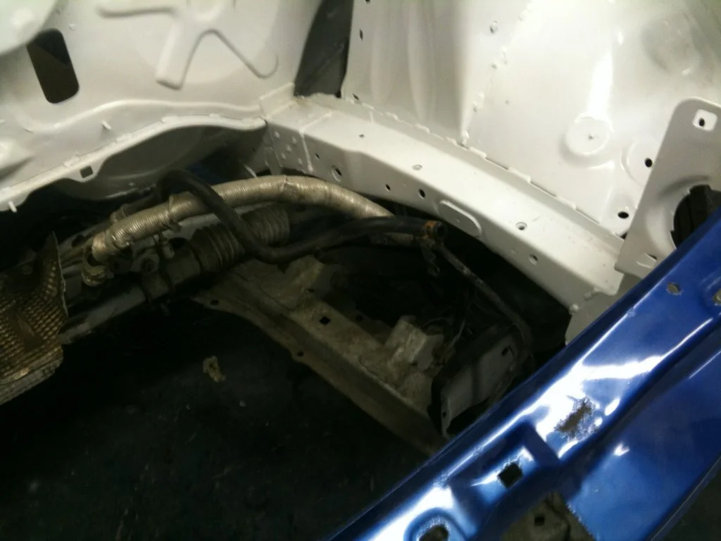

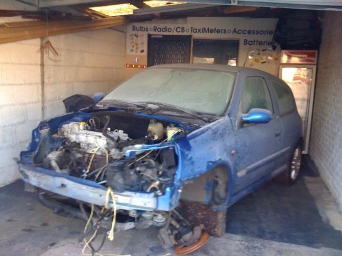

I first bought the car accident damaged of eBay for 1600quid which wasn't so bad at the time, with only a bent subframe and wishbone which wasn't to difficult to replace, but luckily enough I decided to place the car on jig when fitting the cage and found out the right suspension strut was nearly 2inches higher on one side, so not such a barging after all!!
Unfortunately this is the only picture I've got from when I first had the car,
this being my first builds this seemed such a daunting task looking at it there,

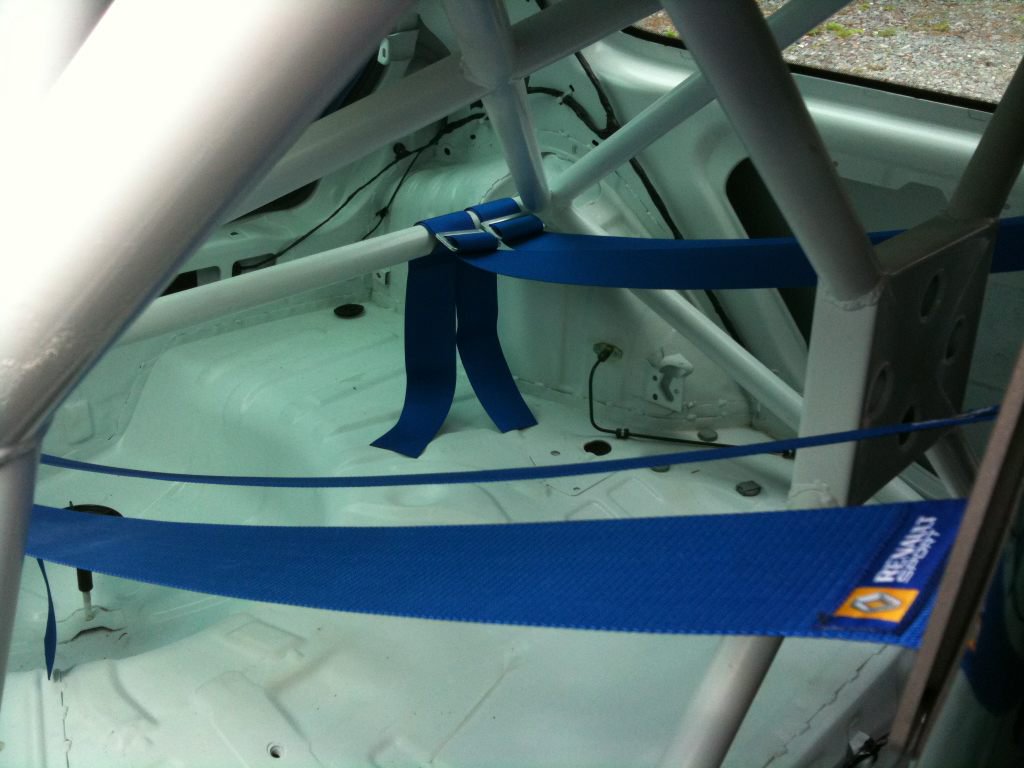

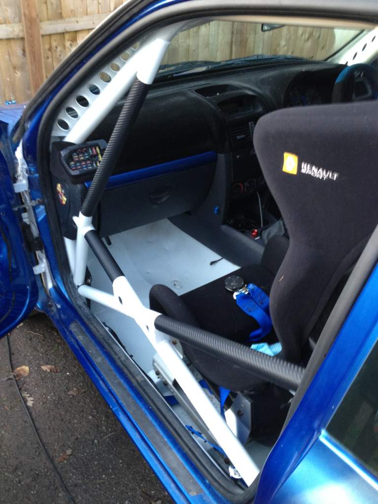

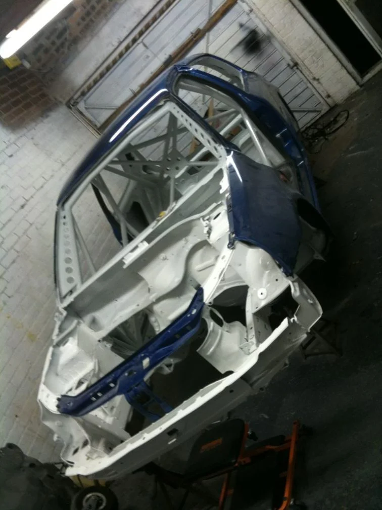

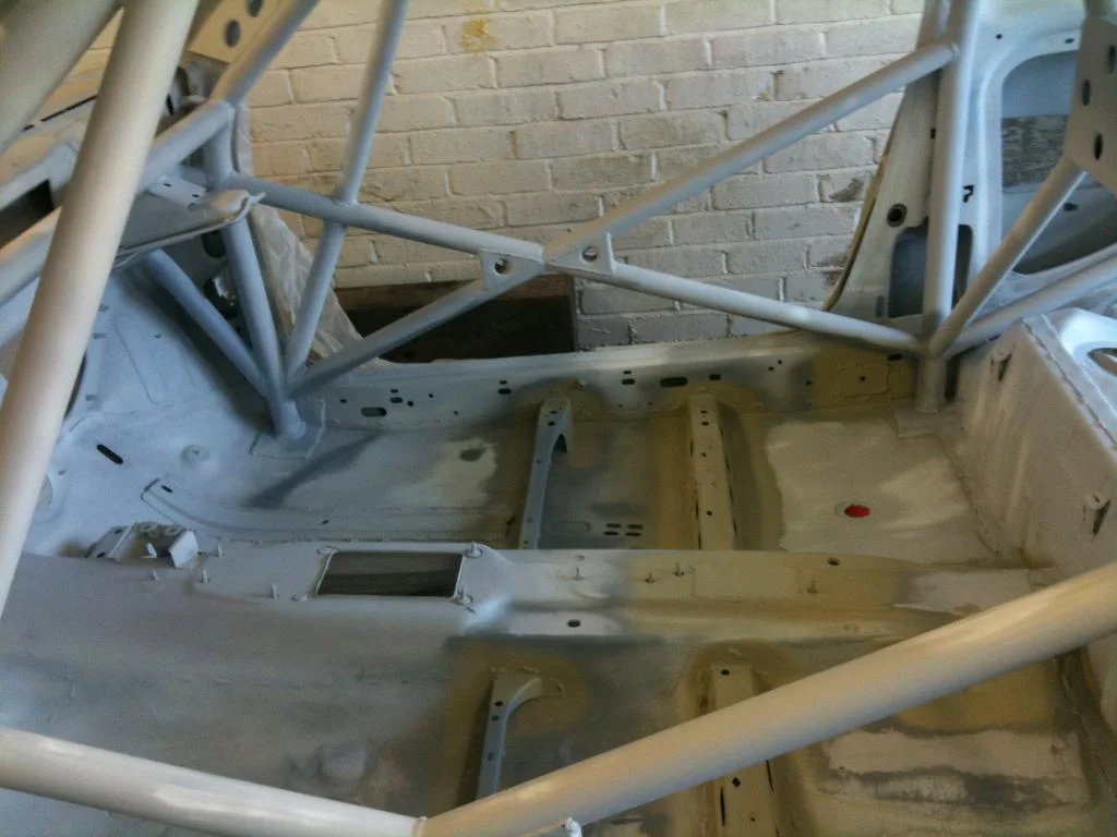

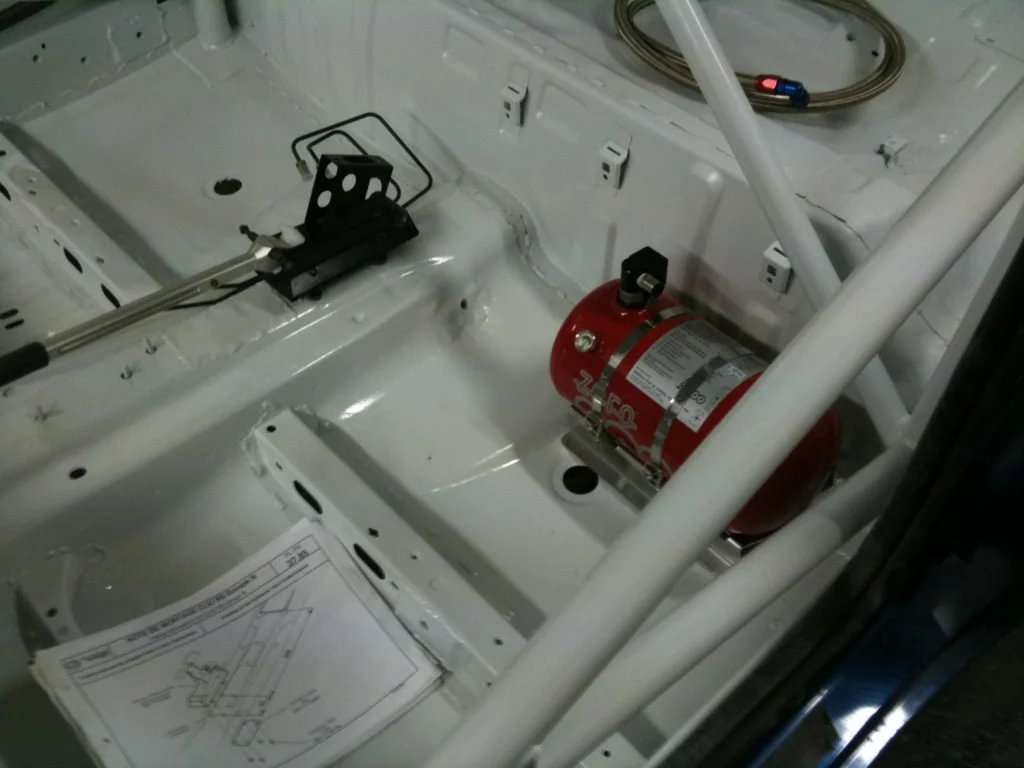

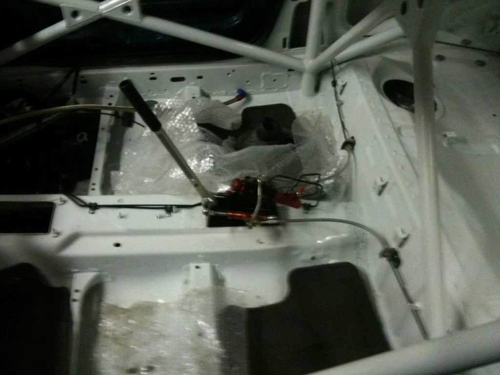

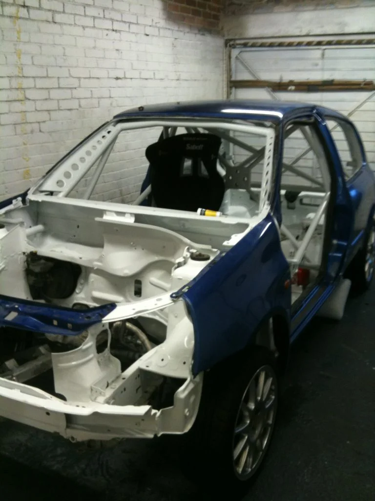

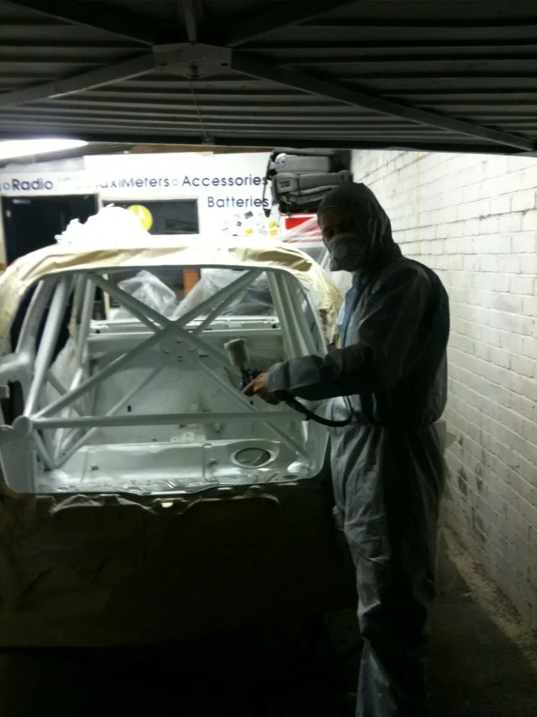

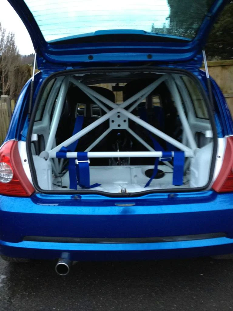

A few calls to rsport and we managed to get the last of the parts they had for these cars, but no cages and body strengthening kits left so we went with the full weld in custom cages which is lovely cage, also seam welded the whole shell and replicated the strengthening plates as much possible,
All sprayed up :)
A few parts from rsport had arrived so we started to put the car back together

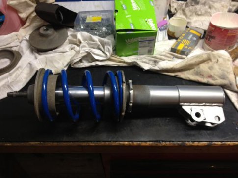

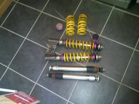

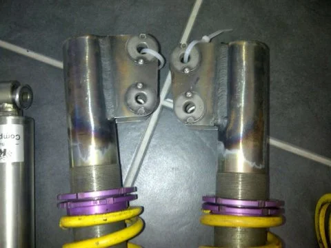

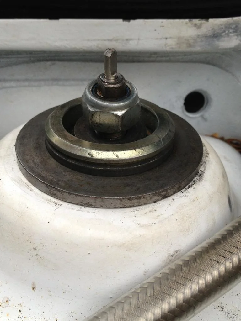

suspension, kw competion 2way adjustable :)
Modified to fit on standard hubs(which I will come to regret further on)
This also came with the cup racer top mounts and strut brace

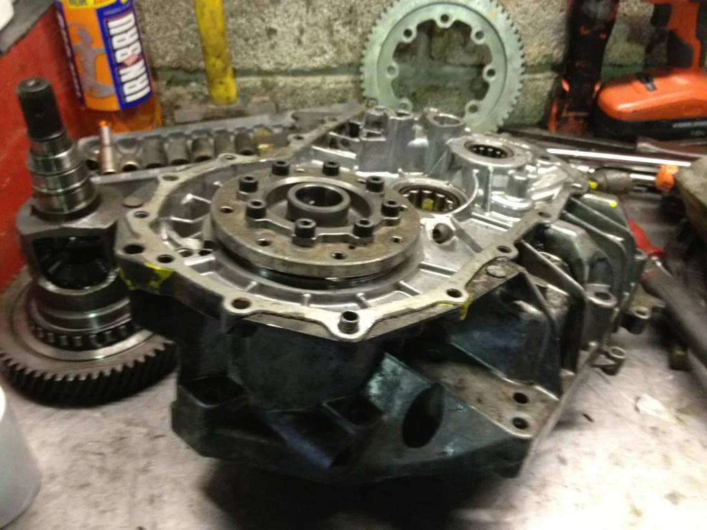

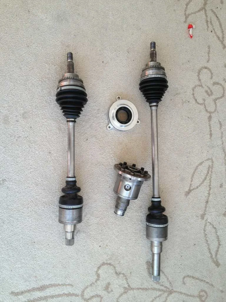

next step was to sort the gearbox, first we wanted to fit the sadev dogbox but at 5grand even for a second hand one! That was out of the question, luckily enough I managed to get the shafts and diff from this box at a really good price :)
also fitted with a 5.2 final drive that took the top end down to around 120 on 16's

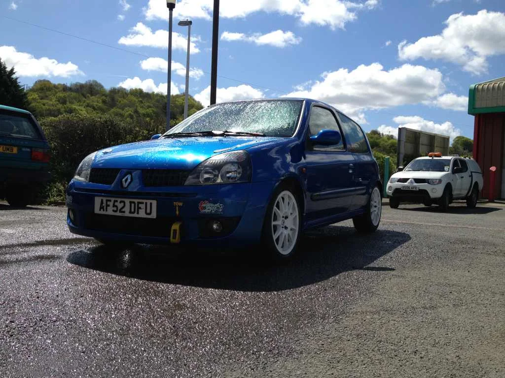

we then had the car pretty much how we wanted it

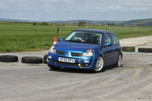

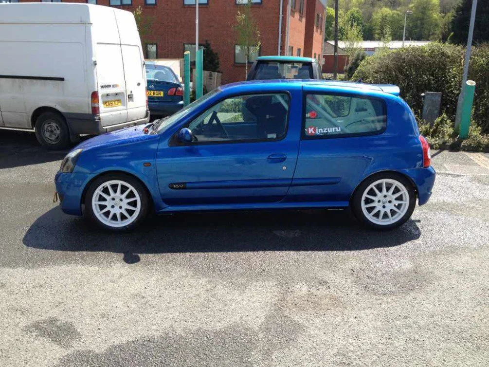

we have now done 2 rally sprints down pembrey local to us,
Finishing 10th the first time out and 1st overall the second time :)

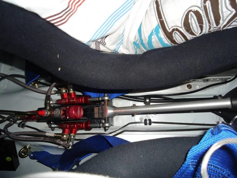

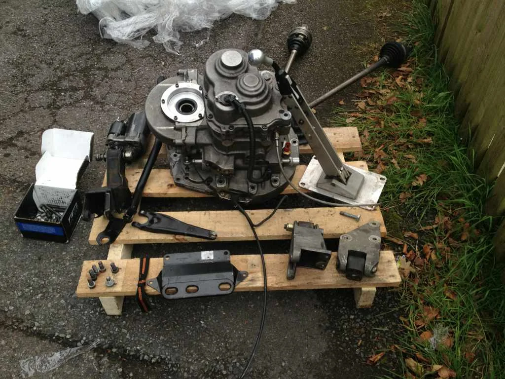

Firstly I've bought a sadev st75 sequential with shafts and lever for a cup racer which arrived last Thursday :)
Ye car is pretty much stripped back now, so ill updated the thread as much as possible,
Sorry for the lack of pictures both hopefully now I can keep on top of it and get some decent pics up when the box is in

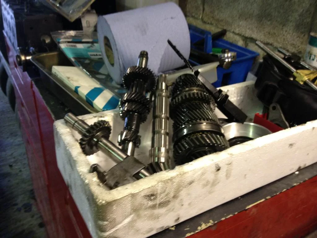

  Cup In bits

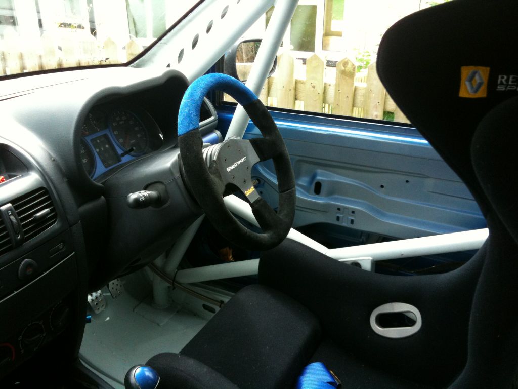

Nice project Andrew. Be nice to see how you get on retro fitting the st75.
Do you need the subframe to fit it and can you fit the cup racer mounts to a road 172 cup?

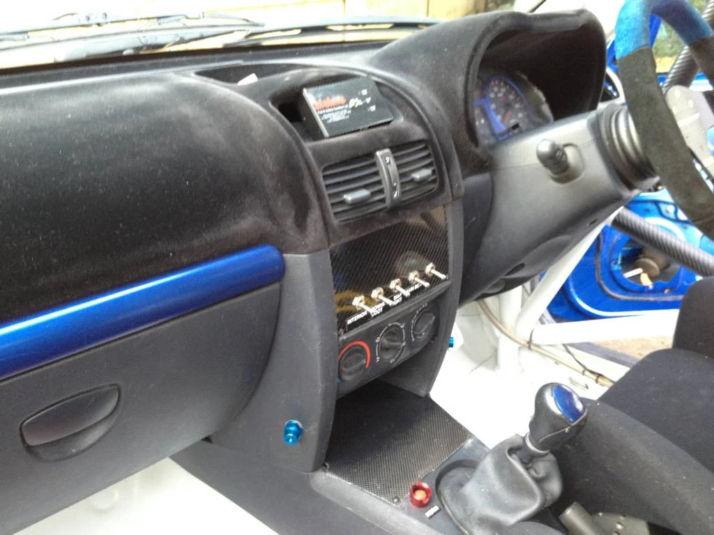

Also how did you profile the dash for the cage so good? trial and error lol

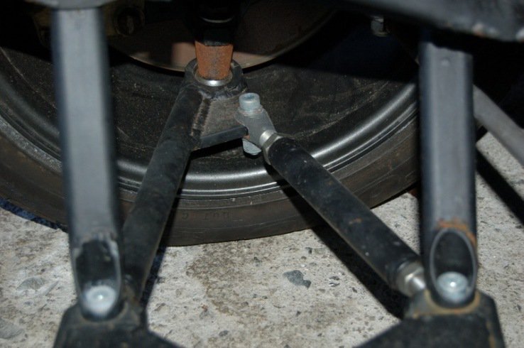

I'm sending the subframe to pure Motorsport and having fully adjustable wishbones made as the shafts are 20mm wider each side, should look something like this but they are still in the development stage and I'm going to be the guinea pig
that why I'm a little gutted I had the suspension altered as I'm now going to be using the racer hubs :/

Wishbones are p**n, I need to get my shafts lengthened as well.
Is that a clio or just a pic for reference, looks to have a custom subframe aswell.
the pic is pure motorsports own clio they are building for hill climbs, so mine should look just like them but tarted up a bit more.
Ye the subframe is standard just been modified to take the wishbones, I should be able to get a lot more castor with these, and a better range of adjustment

What suspension did the Group N cars run?
  Clio172cup rally car
Looks lovely and appears to be a real quality build! What ECU are you running?
I was running the standard ecu with just a generic group n map( higher rev limiter) but that will be going with the new box going in, was looking at using the ec1 with a full cup racer loom but I still need to talk to matt at Tdf and see what he thinks,
the suspension for group n was bilsteins the same as these,
These are just height adjustable and have 50mm diameter inserts very strong.
but I struggled to get rsport to get them for me so went for the kw after we decided to ditch the group n route.

Is the kw the inox or competition spec ? Ian's runs Reiger and I think there was another a while back running 3 way Ast but changed to I think Reiger.

I did see about the reiger but the price has now gone up quite a bit from what I can remember, maybe next year ill look at updating the suspension but the kw should be good enough for now,
The kw is the competition spec but were originally for a cup racer so altered the mounting points for standard hubs, but now I'm regretting it a little as I need to use the cup racer hubs now for the bottom arms!
I'm sure someone told me that the scenic shafts fit when using cup racer suspension setup?
  Cup In bits
Yeah Martijn said he used Scenic shafts on a mates car he converted to cup racer suspension. I got a scrapyard to measure some and there only a few mm longer if anything than my cup shafts so im hoping they might work if what Martijn says is right.

what you doing with the old box and shafts? for sale?
He sold it the other month :( It was a very good price too
Ye I sold it a while back, not for as much as I would of like but I couldn't wait around, I needed to put a deposit down ob the sequential :( the guy who bought it has had a bargain the diff alone is nearly 3grand to buy as a replacement part let alone the shafts!

A little bit of an update, the subframe is now with pure Motorsport being strengthened and new wishbone mounting points be added, suspension has been stripped down and altered to take Laguna hubs,
Also they made me a sump guard out of 5mm ally which I think they will be making more of to sell!
Hopefully get it all back in 2 week and get this box fitted :)
