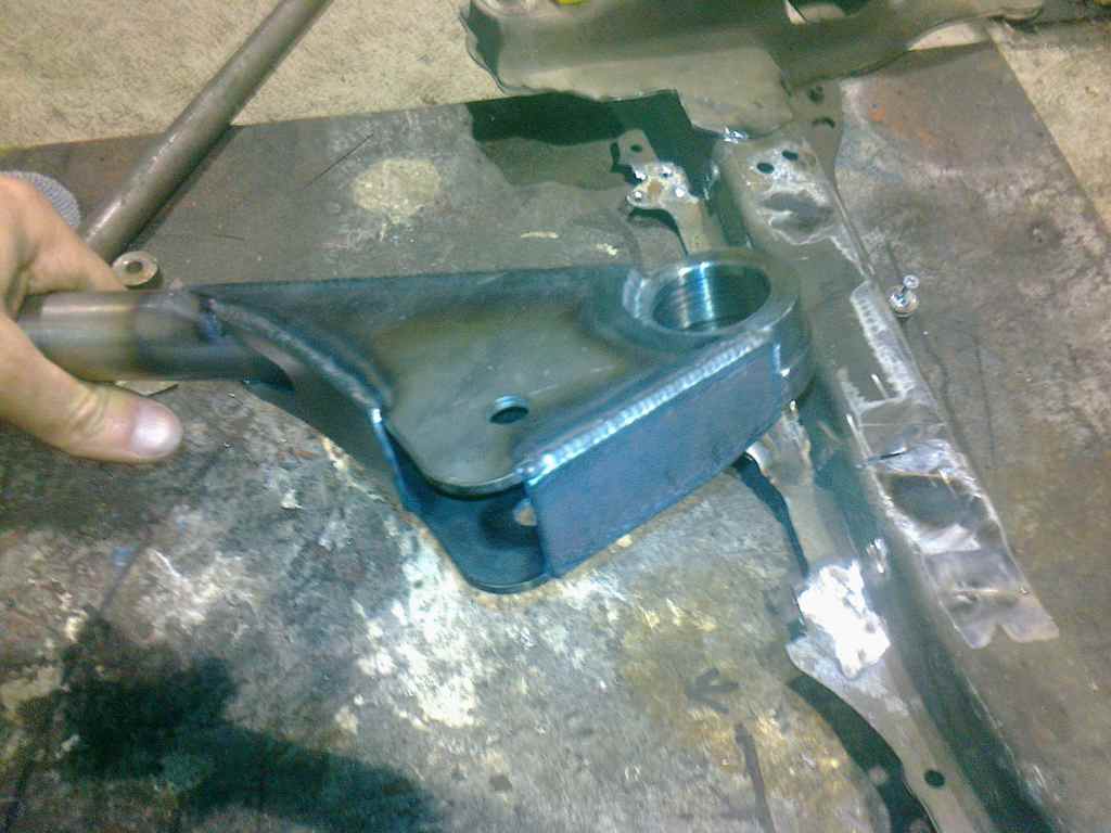

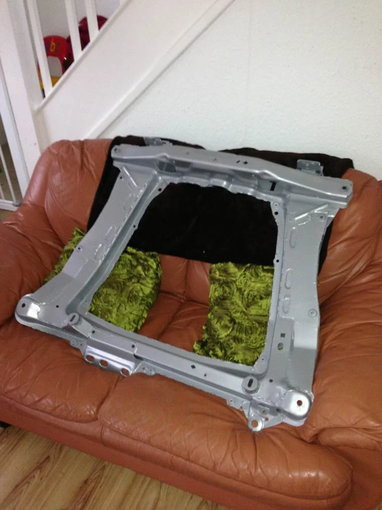

bit of an update, still haven't got the box fitted yet as I'm still waiting on the subframe, but I've just had some pics sent to me of the wishbones and there nearly finished!!!
I'm really impressed with how there coming along, much better than I expected, nick does some really good stuff down pure motorsport!!

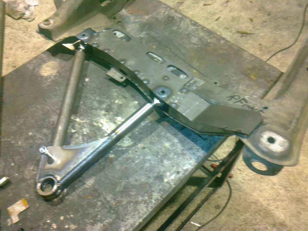

Interesting why they've got the rose joints horizontal? For some reason I thought these were intended to bolt into a standard subframe with some spacers.
  Schma Schme 1.6l
caster adjustment is the big let down on clio's.
i didn't want to spend the money on the wishbones, so modified the subframe to allow the complete wishbone to move fore/aft giving plenty of caster adjustment.
good thing about those trick wishbones is they're strong and adjustable at same time. be interesting to see them in flesh and see how much they improve overal handling.

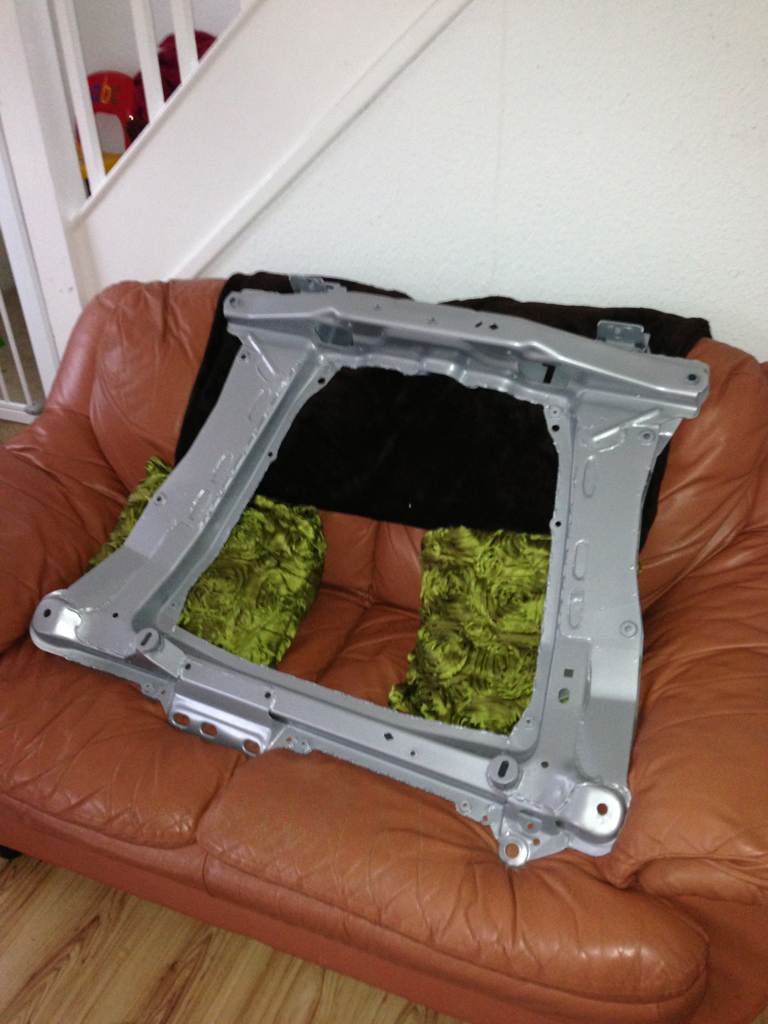

Little bit of an update, all the wishbones from pms are now complete and are on route plus suspension is also done and on the way back from Germany :)
Hopefully have it back on all fours by next week to get the geo setup by nick,
the engine and box is in on the new subframe and selecting all the gears which is good,

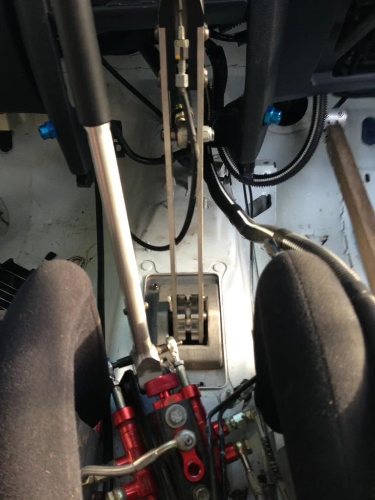

Also moved the handbrake forward, and flipped the lever round to make vertical

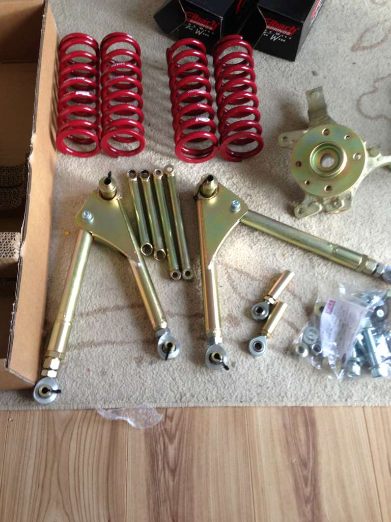

New wishbones have finally arrived!!! They look amazing! Also the rebuilt suspension is here to, so hopefully been on the road very soon!!
Nick has done a awesome job on these, really impressed with the attention to detail and craftsmanship that has gone into these, well worth the wait :)

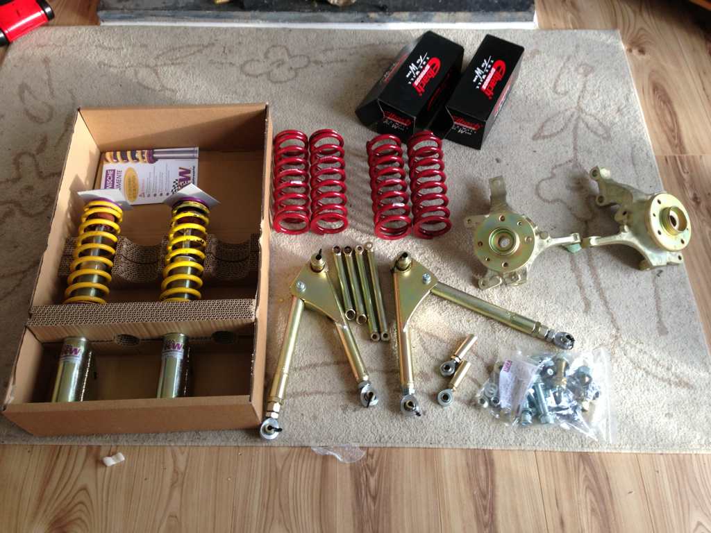

  Cup In bits
Nice bits. Is pure finalized the kit then going by all the bag's of bolts you have to fit it?
What kind of coating is that on the hubs and arms?

Which Kw's did you go for and are they custom spring rates ?
As said already the bottom arms look very trick!
Well this the first kit, going to be doing some testing hopefully next week, then see how is all goes from there I think
  Clio172cup rally car
they are the 2 way competition unit, and I've bought a few different springs rates to have a play around with the set up,
Nick did modify the strut bodies so we can now fit elliptical bolts for more camber adjustment
