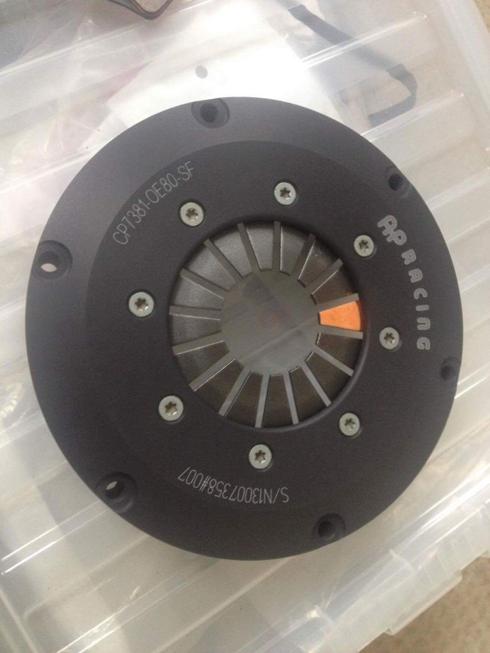

so I haven't been on here for sometime now, mainly due to work and family commitment, with the arrival of my daughter and starting my new job since finishing my degree :smile: the clio has been very much on the back burner. The car has mostly sat idle with the exception of one track day down Pembrey which resulted in the clutching giving up and a small oil leak from the crack seal. So the engine was pulled and i purchased a new lighten flywheel and AP racing clutch.

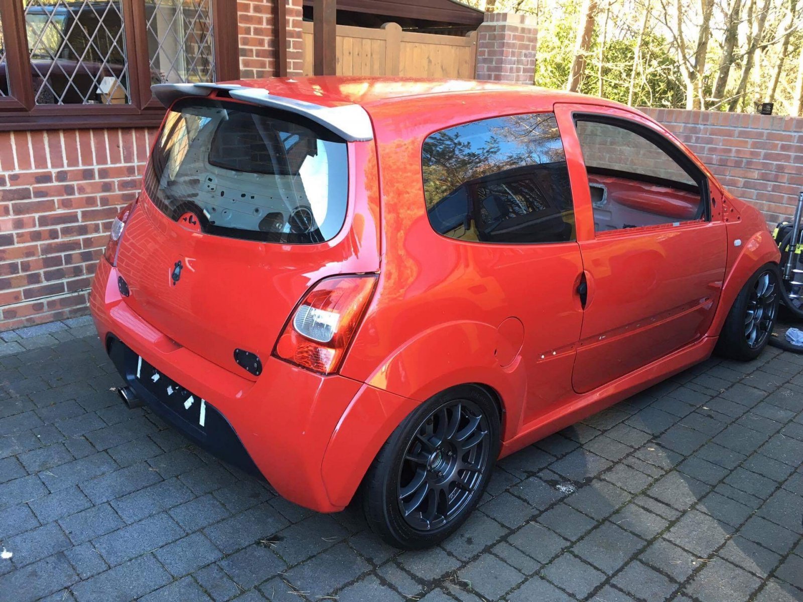

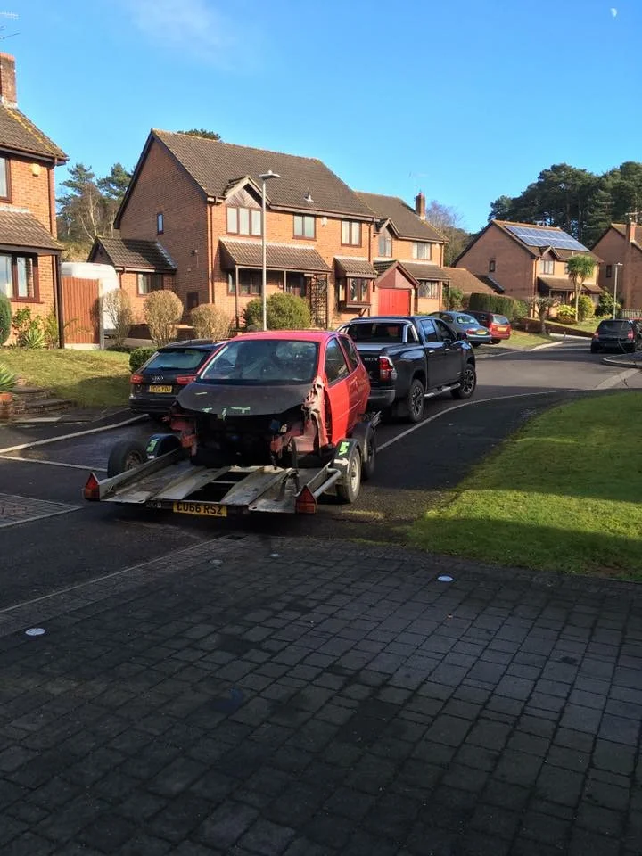

So after a little bit of research to see what parts are compatible with other Renault models.....I bought this!!
A Renault twingo 133! turns out the chassis floor is very similar if not the same in places. I've bought it as a bare shell with a lot of the hard work done, all the sound deeding has been removed already and all the unnecessary brackets taken out etc. The plan is to transfer all of the running gear and electrics from the clio over to this, Hopefully have some decent weight saving over the original Clio too, With the long term aim of make a full on s1600 style twingo the same as what currently run in rallycross.

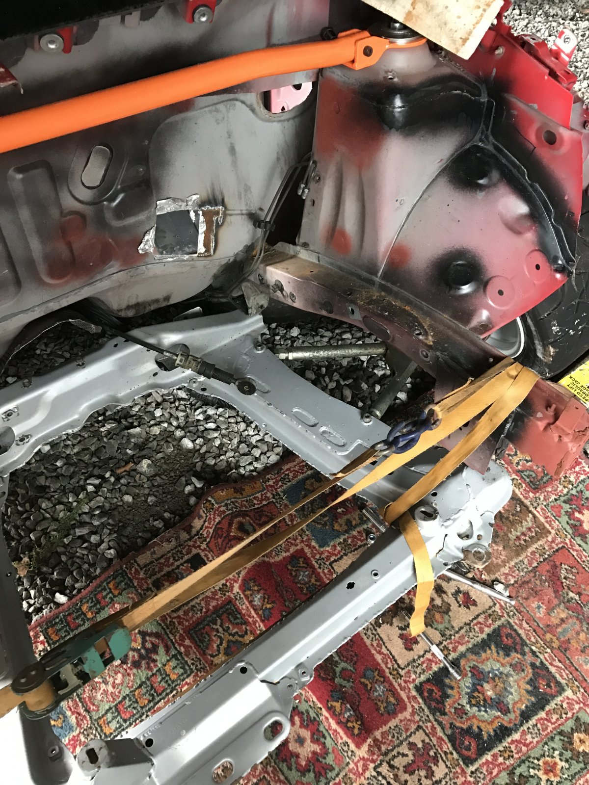

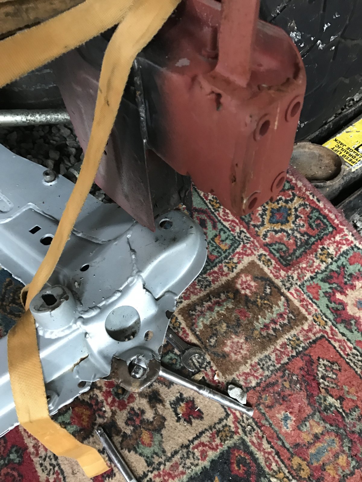

Ive already offered up the front subframe and suspension which at first glance I thought would be a straight fit, but no! it wasn't going to be that easy! haha
The front mounting points are 30mm further forward on the subframe which means im going to have to fabricate new chassis leg mounts, but it shouldn't be to difficult.

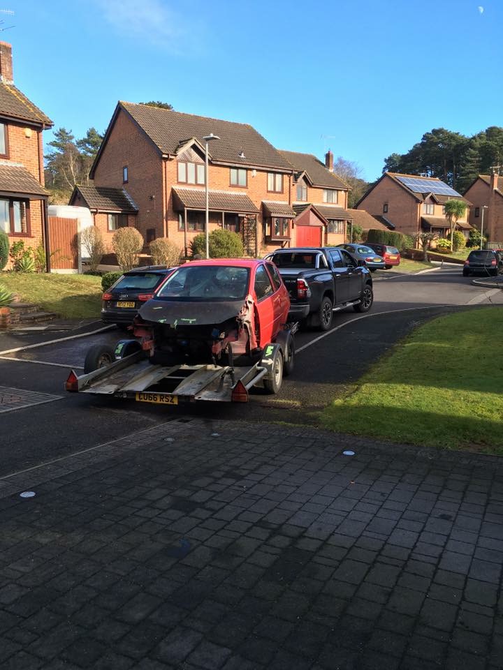

Any all this now means the Clio shell is now up for sale. I will be posting a for sale thread shortly!

Is there that much of a weight advantage in the Twingo shell? should be cool when finished though! Can you not just unpick the front subframe mounts and move then further forwards? they look pretty much identical to the clio ones so should be fairly straight forward.
Yes I think there's a 70kg kerb weight difference, nothing major but every little helps [emoji23]

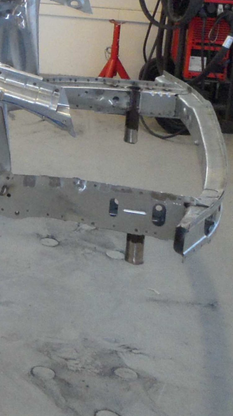

For the mounts I'm think of doing this
This is what they do to the s1600 twingo to fit a Clio subframe.
I just fancied something different and a bit newer that wasn't going to break the bank :)
I can see why they do that, they look much stronger in regards to taking jumps etc, my worry would be any frontal impact is just going to bend the leg rather than the mount just bending. But i guess just don't crash? haha

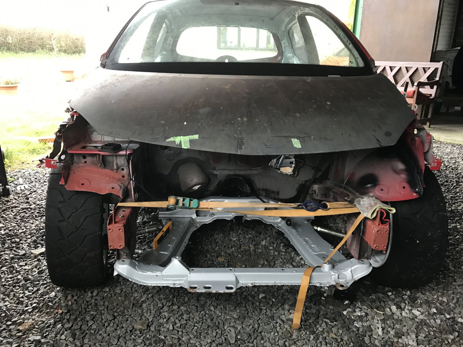

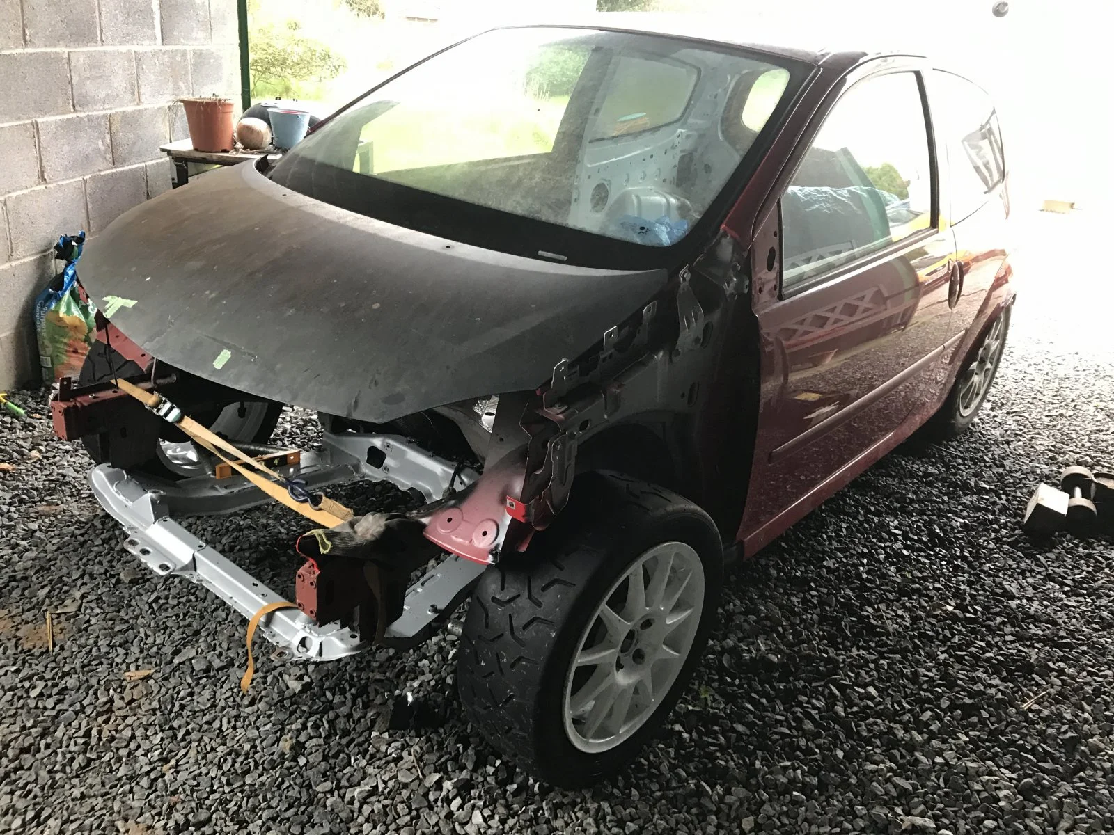

Small Update...

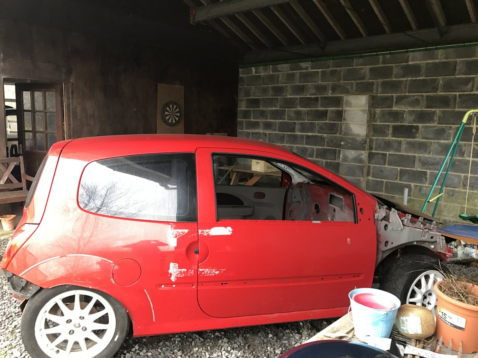

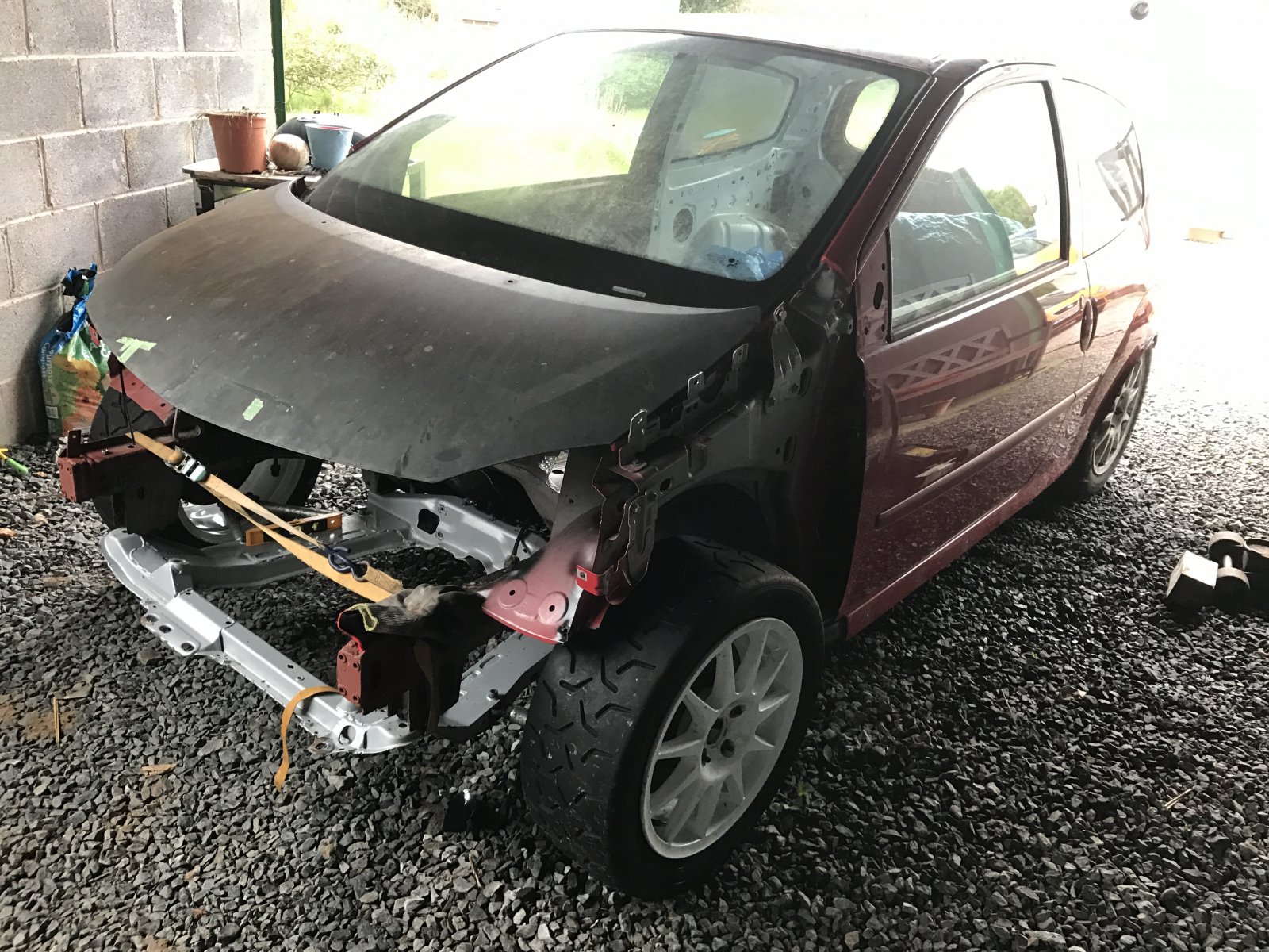

I've managed to fit all the running gear from the Clio over to Twingo and its now on all fours! all fits great apart from the sub frame front mounts. The front looks pretty mean and wide :smile:
Plan now is to sort out the roll cage and start stripping all the underseal from the wheel arches and underneath, need to make a spit so I can do it properly, I was toying with the idea of acid dipping it, but to keep the cost down I'm going to tackle it myself. Biggest hurdle now is selling the Clio shell. Once that's done I can order the cage and get it inside.

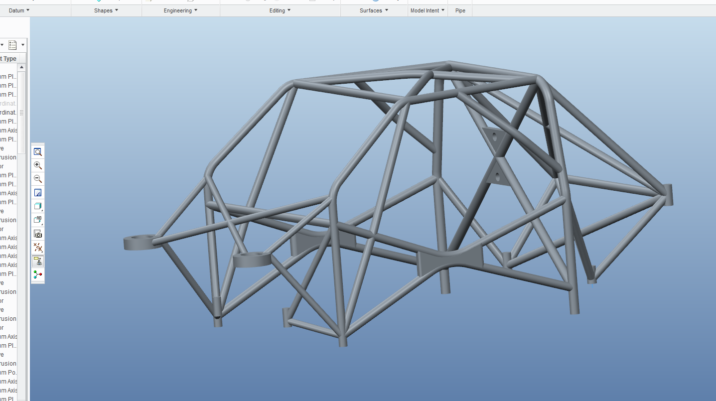

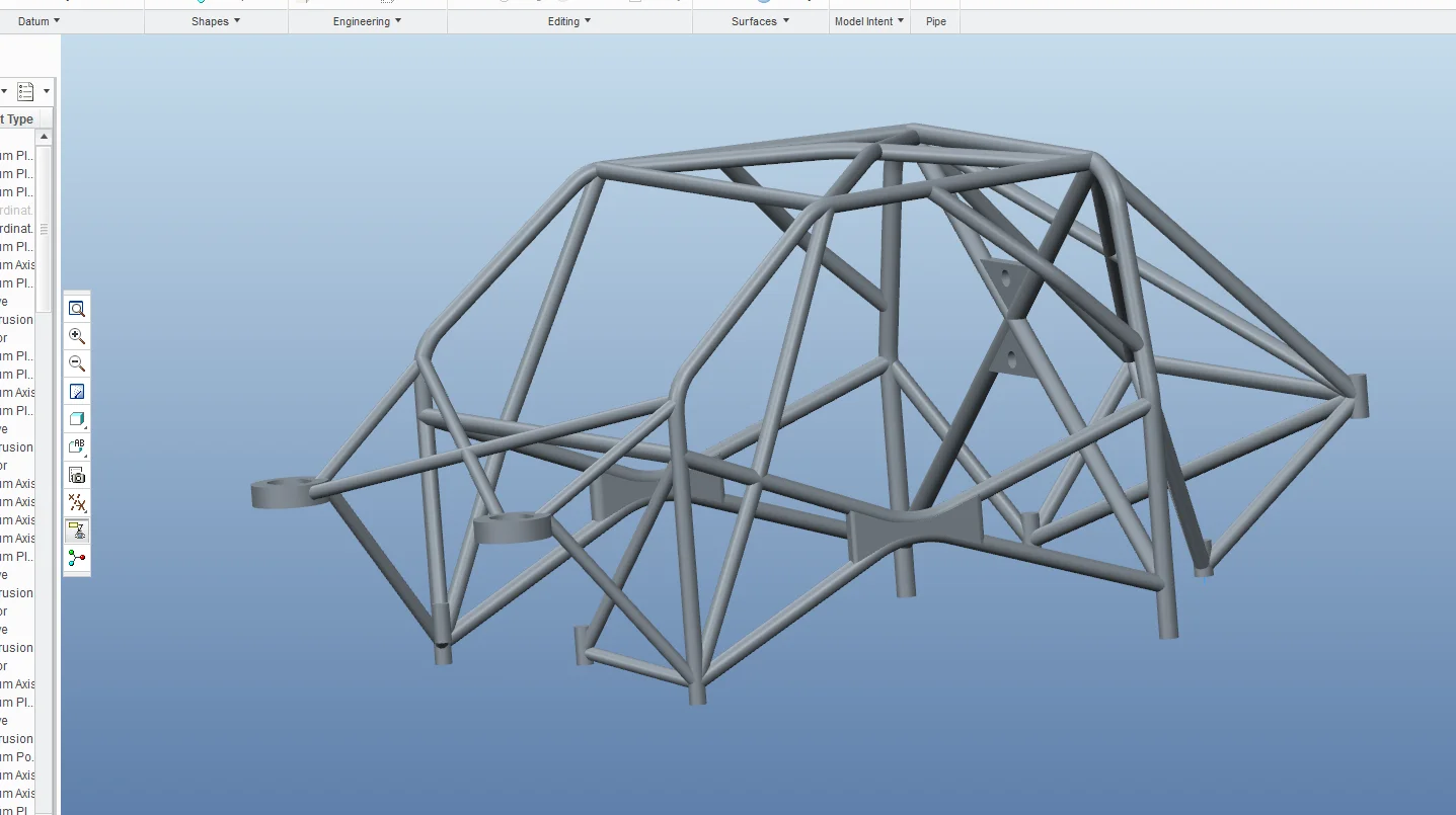

The cage is also going to be a bit special. I've managed to get hold of a 'to scale 2d drawing of the cages fitted to the rallycross twingos which have been designed to replicate the clio s1600. So I've created a 3d model of the cage. the cage includes triangulation to all suspension points including the rear beam, plus extra bars through the bulkhead between the suspension turret and the 'A' pillar bar!
