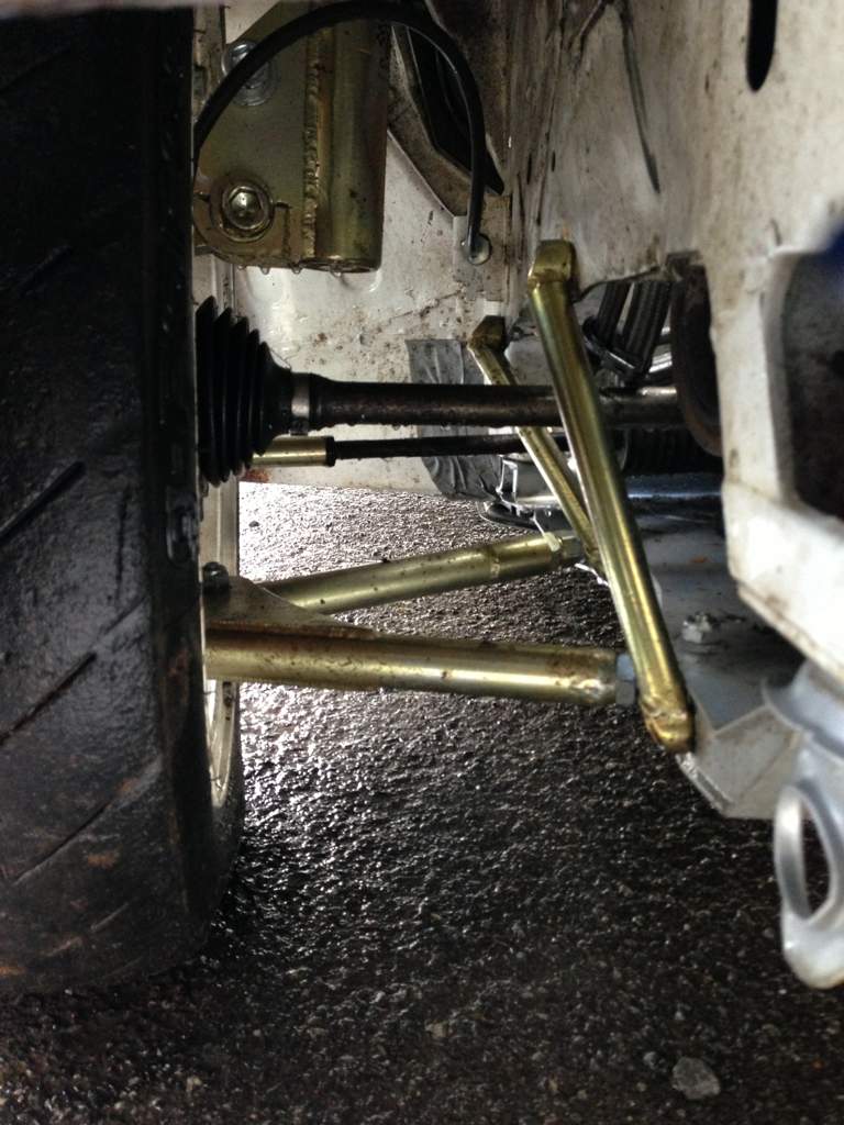

Sneaky pic of the new wishbones fitted ;), hopefully do I write up soon and some decent pictures up
  Clio172cup rally car
Ye, everything is fully adjustable now, the only thing that is holding me back now is the arches, because I'm using 16inch wheels, not getting as much castor, but still a decent amount.

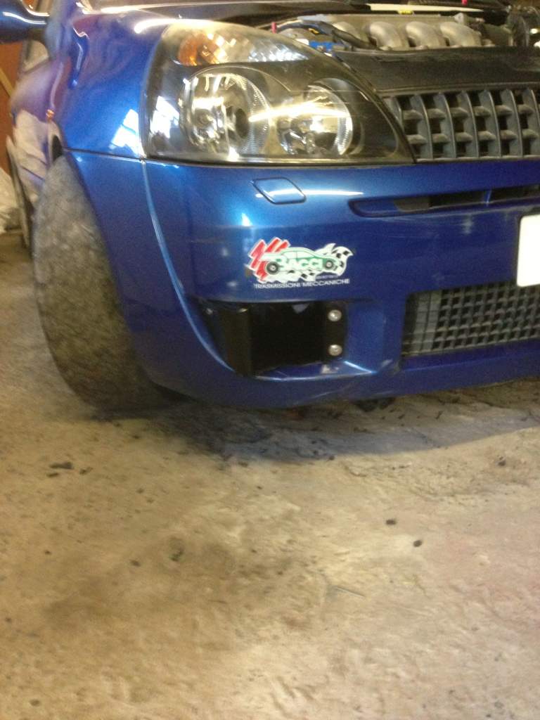

managed to fit the cup racer brake vents yesterday, took me like 4 hours of messing around to get them to fit!
These ain't original ones but copy's of the originals so you can imagine how bad the fit was, but I'm pretty pleased how they turned out :)
  Cup In bits
You may want to put that tab that you have secured with 2 bolts behind the bumper as it gives better angle for the ducting.

Tbh I thought that as the angle isn't great, I searched a little before fitting and noticed that some people put the tab further over to get a better angle but the problem I have now is that that I've cut the other side so won't be a nice fit,
I'll try that and see how it goes,

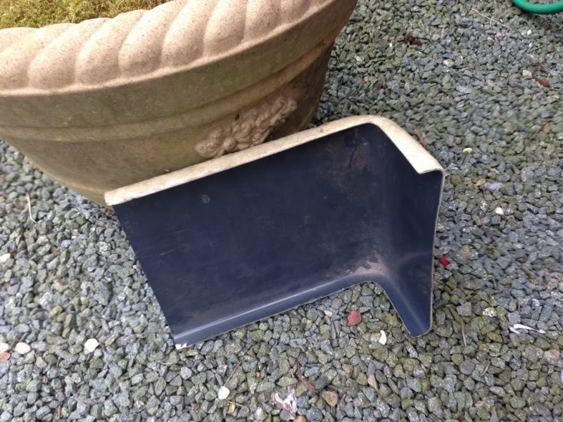

Just need to make some plates now the same as cup racers to deflect the cold to air to the brakes,
What are the cup racers ones made out of? Would ally be ok?

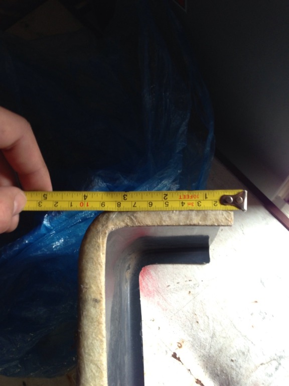

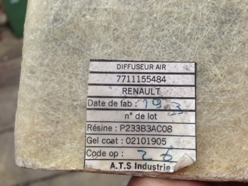

These are what genuine ones look like and are made of fibreglass, personally Ally would be better as it can be bent back after a trip threw the gravel in my case. I have a few sets to get threw first, one of which is old and they spider crack with age.

Thanks for that, I'll try and copy that as best as possible, I see what you mean but making them out of ally, I suppose they just snap otherwise being so rigid, especially me doing rally I'm sure ill be going off in all sort of condition lol.

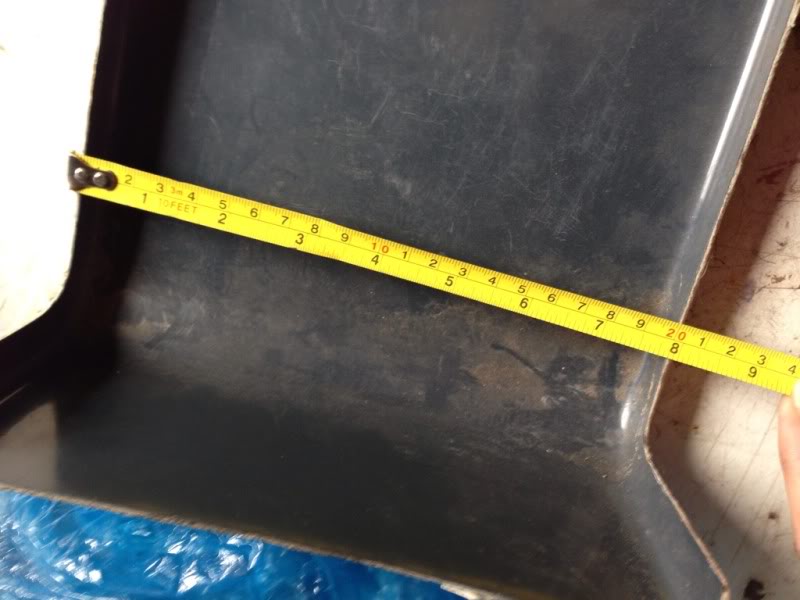

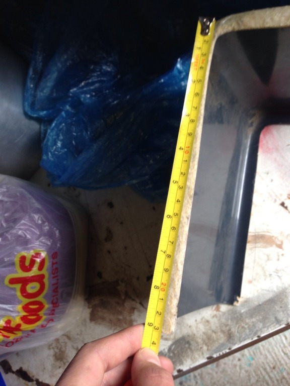

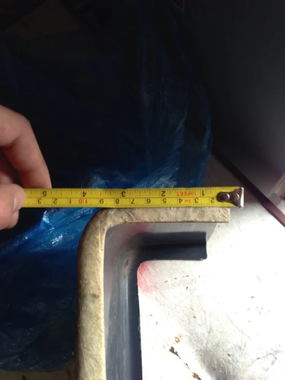

do you think you could measure that plate and send me the measurements please? Would save me loads time :)
  Cup In bits
I'll do that later on tonight mate when I'm home, they are just basically cable tied onto the small support that bridges from the subframe to chassis leg and a small bolt at the front.

Didnt get a chance to measure last night Andrew but I'll post them in here for others ref. as well
