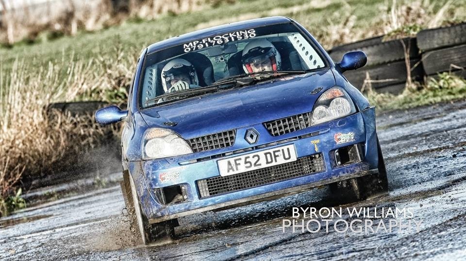

Sorry for not having any updates lately been so busy getting the car ready and family just haven't had chance.
Well I finally got the car finished and log booked just before Christmas, so decided to entry the pembrey Xmas stages.
First stages was really slippery and covered in ice, I spun twice, slid into a tyre wall and even got lost! Lol second stage was going really well, even caught the car in front within the first half of the stage, as soon as I went to pass the dash lit up like a Xmas tree and lost power completely, water temp was showing 125 degrees and had a bad mis-fire so pulled over to find the coolant hose to the bulk head had come off and dumped all the coolant. so decided to stop and wait to be recovered.
Once back at service we replaced the hose and started her up but still mis-firing, changed the coil pack and spark plugs but still no difference :( checked the dash and now saying there was a injector fault which we didn't have any spare, so called it day.
Even tho it was only a short outing I thoroughly enjoyed and can't wait for the next one :)

That's a great photo, shame you had problems and I did laugh that you got lost on stage.
Sam
North East
  Electric 🔋
Brilliant video.
I bet its soooooo much harder than it looks, and it does look difficult in the ice.
Well done though
McGherkin
McPension
Great bit of driving in some crap conditions, good first event. Shame about the DNF, s**t happens though and hopefully it'll last better next time :)

Ye I hope so too, was real shame it happened when it did was just getting into it too, only a month till the next rally down there :)

Good effort, really did look slippery, what tyres were you using? As said above a fantastic co driver really calm and gets all the calls spot on. Bad luck about the problems you had with the car.

Cheers mate, I had kumho k12's cut to intermediates, which weren't up to much on the first stage but worked much better on the second! Only problem I've got with them is the clearance, I may go over to Pirelli as they have a smaller tyre wall. Then possibly tube the front arches when I get chance :)

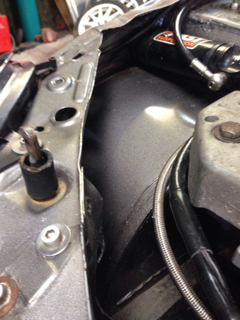

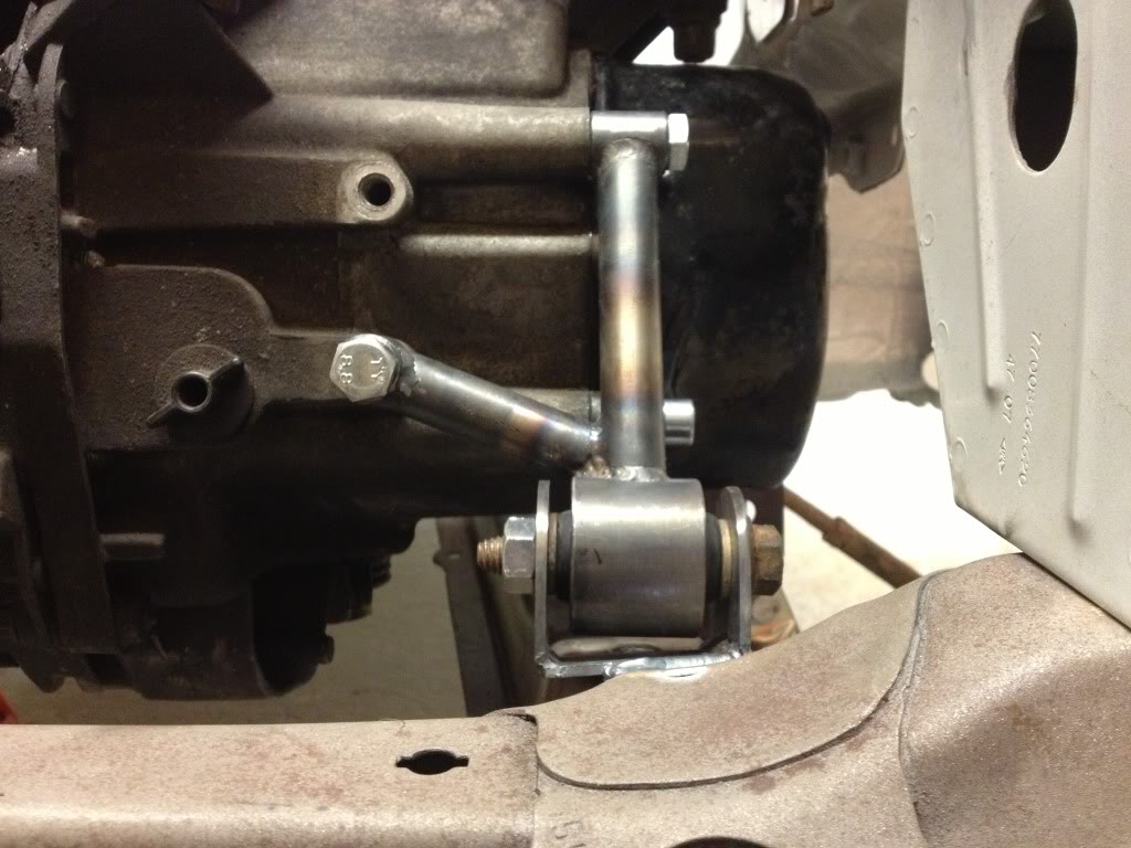

Car’s looking well mate :) Do you run cup racer engine mounts? If not have you thought of a solution for tubbing the arch where the O/S engine mount goes? I need to tub mine as struggling with tyres rubbing and about to add a lot more caster
Hi James, ye running the cup racer mounts so won't be to difficult for me to tub the arch, I could imagine it will be quite difficult when using the standard mounts, didn't Kenny do something with the mounts when he tubbed the arches on his car?
Yes I thought you were. Yes Kenny made all his own which does look ideal but I could never do that with my hamfisted skills lol
Do you think the cup racer engine mounts would fit a JC5 rather than the sadev? Sorry for all the questions ;)

No worries James, that's what this forum is for :) I pretty sure that they will fit but the rear one needs a little persuasion to get on, I know the uk cup racer sequential uses the jc5 casing so I don't see why it wouldn't fit :) I'm sure Ian or someone with a cup racer with the stsda box could put some pics of the mounts to compare it?

Tubing the inner arches isn't a 5 minute job, if you've got access to a plasma cutter though it would make it a lot easier to chop out the big bracket for the engine mount, that was a tw*t to remove with a grinder and an airsaw.
I'm not sure if the cup racer mounts would fit, they aren't that easy to get hold of and usually fetch decent money, if you then had to modify them it would make more sense to fabricate something made from scratch.
I got a set of mounts with the ST75 but I'm also going to use the engine mount I put on the chassis leg to try and take some of the strain off the subframe.
