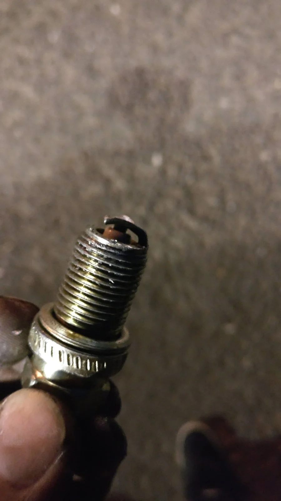

On way home today was driving down the road changed down and rather than revving I heard what sounded one blowing I assumed it was my exhaust or something. But then I noticed check engine light and that the car was Reving it self, then I heard the noise it was making. Sounds a little bit like when you get the htleads wrong way round but worse, and doesn't stall.
Ill have a proper look. But does anyone have any idea what this could be?

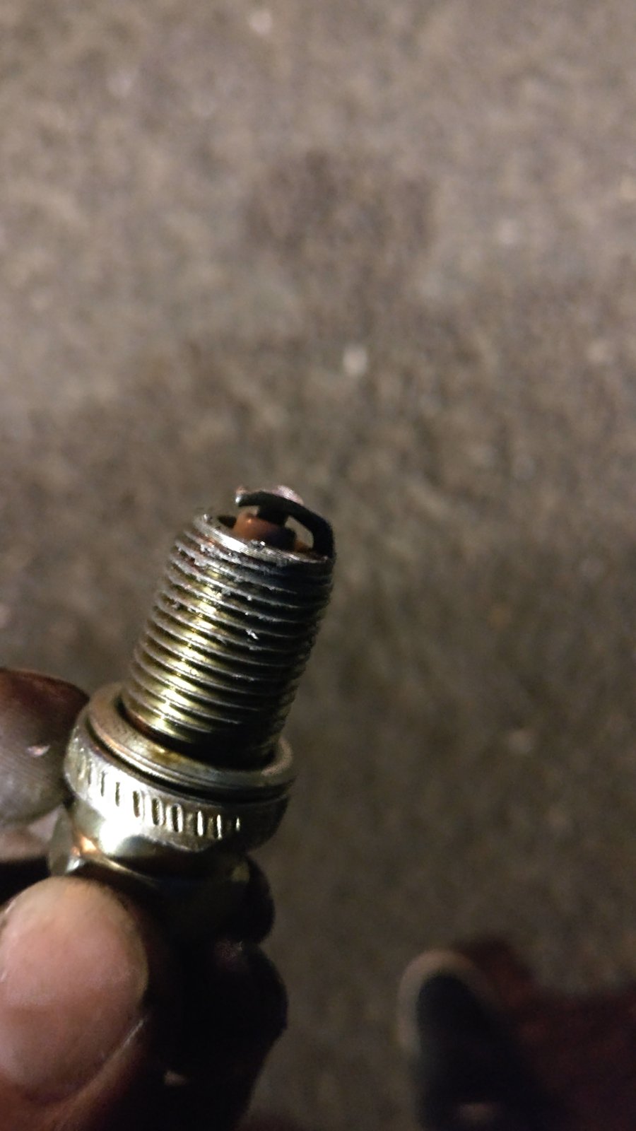

So ermmm.... This is one of the htleads
Thats probably not just bent, that looks like pretty bad news.
I took plug out replaced it and it was running fine on way home its gone again :/ might be very bad news
I’d be heading back to twotechs...!
Had it done last year had no problems with it she ran great.
Pistons made contact with the end of the spark plug, or smashed a valve top into it, it looks like
Yea you might be right. It's happened again today. Might be time to look at a new car :/.
Seen loads of engine failures recently! More than usual. Mostly due to dropping a valve. Eventually we’ll run out of used engines ? might start stockpiling now

Lol I think something hit this one good today
Just can't work out why it was working fine all day and then decided to go on way home??

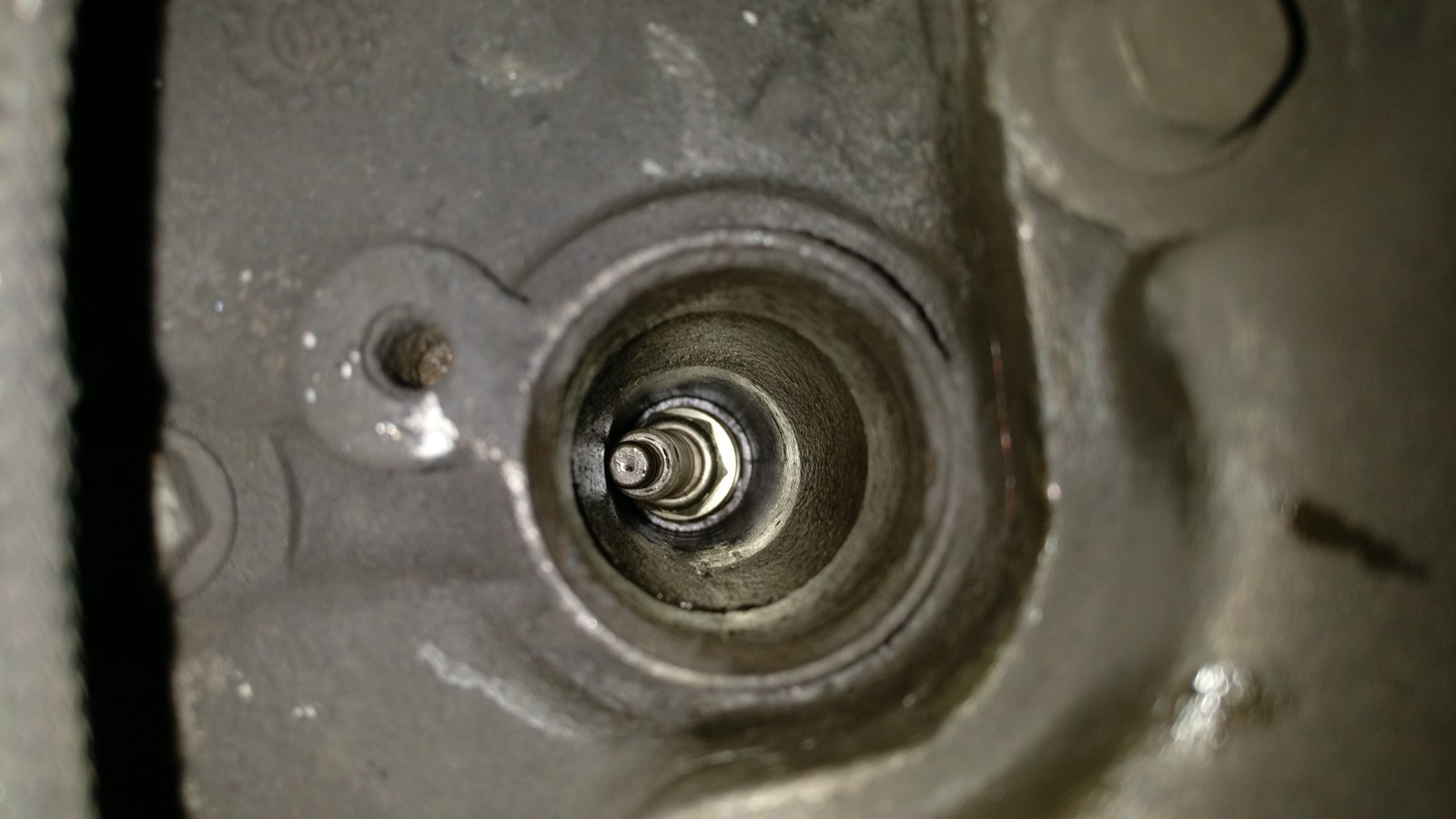

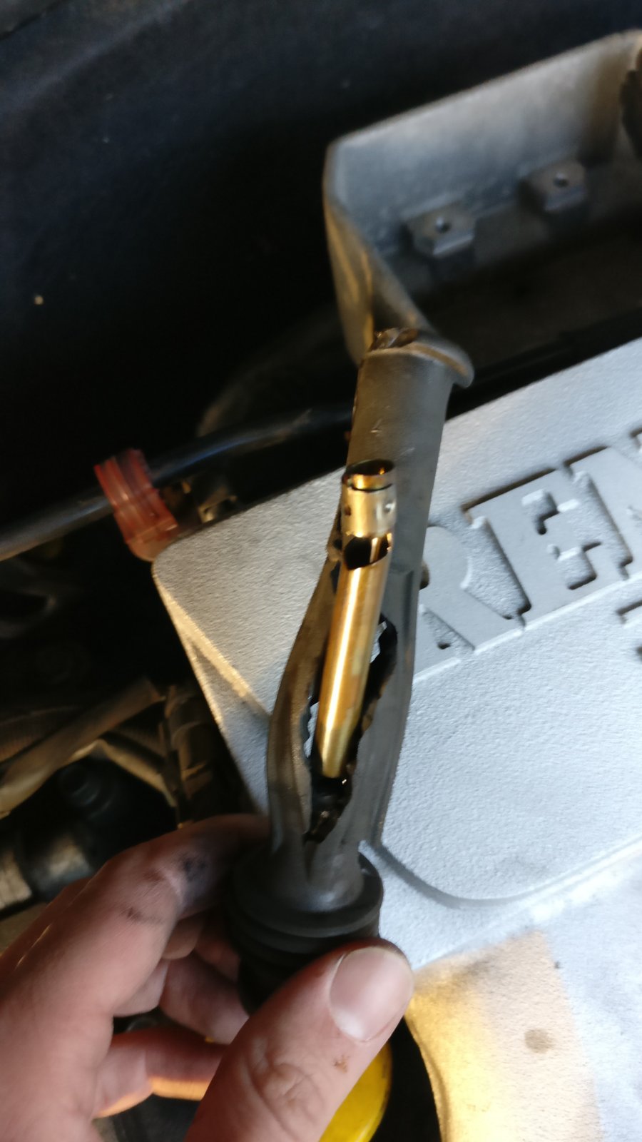

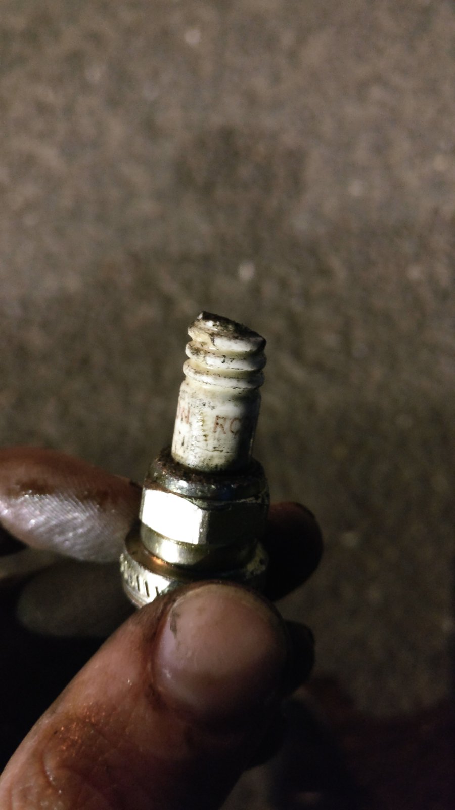

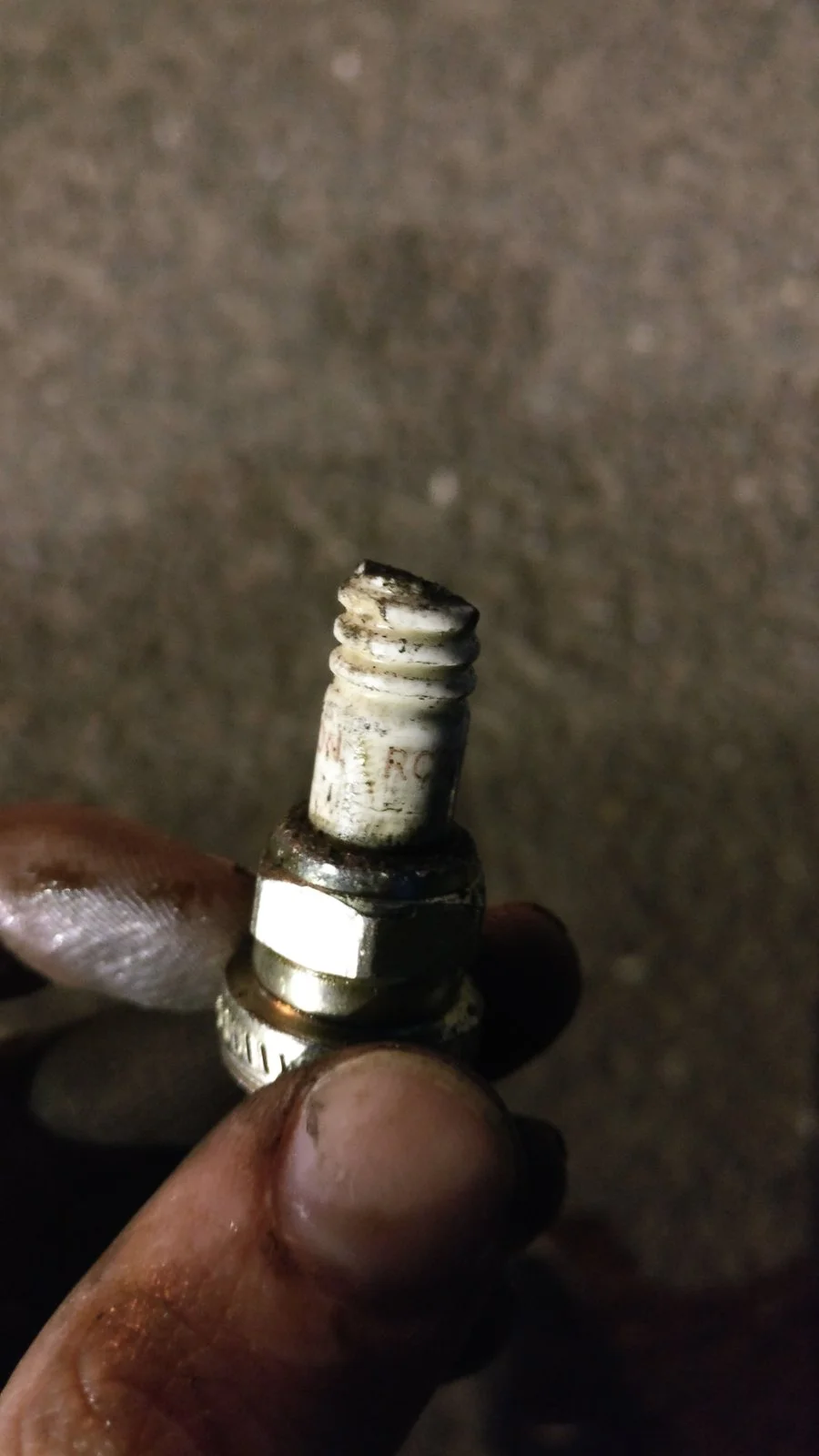

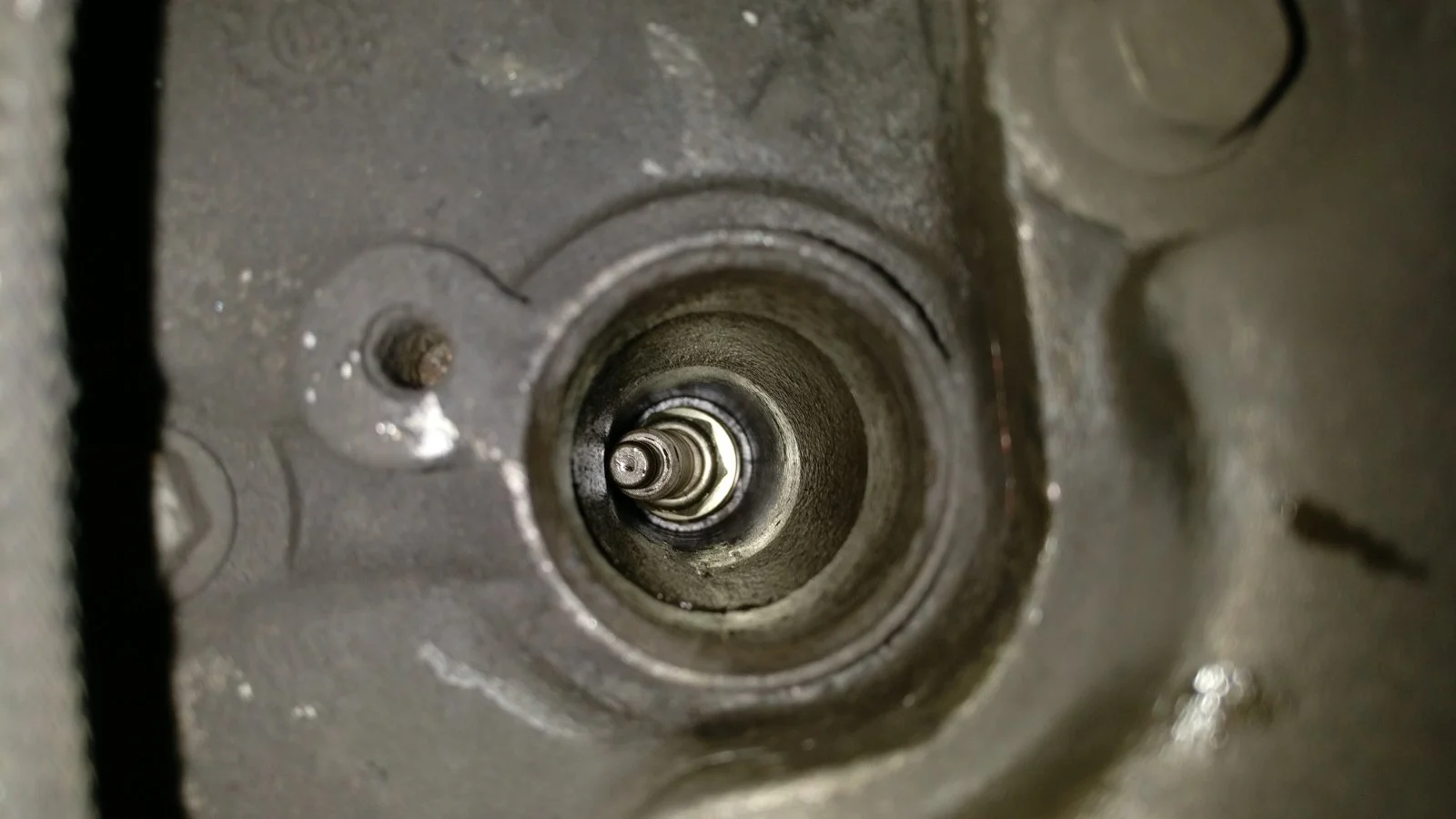

I’d say it’s spat a plug originally and potentially damaged the threads and when you’ve put a new one in its worked loose and done the same.
Ye I'd agree it wasn't a proper ngk spark tho dad a spare I had.
shat a plug out, threads will be buggered but it's a pretty easy fix. did one a few days ago.
Threads are balls. But I wound a new spark in and it held nicely. But it sounds like there's stuff in cylinder 2. Doesn't sound healthy.
I don't know if it's becuase the new spark isn't great/the ht lead I used isn't the exact same as the one that came out.
Might get a new plug. Proper one and see what happens.

you should be able to take the plug out and shine a torch down into the cylinder to see if theres any valve remains in there, or any marks on the piston where it may have made contact with the plug, if your eyes arent that good you can get smartphone borescopes on ebay for like £10 that will do the trick
Ooo might invest
Ah, small ally bits?
Err I'm not sure looked like bits of the ht lead tbh. The top of the spark plug was inbeded in the lead. Black as my hands after 20 mins under that engine.
