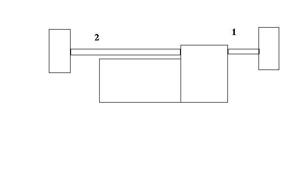

TT set up ( basic diagram )
1 - N/S
2 - O/S
As you can see due to the length of the n/s driveshaft the torque steer is scary - it is controlable though just takes a bit of getting used to

dont most fwd cars run this set up though? (different length shafts oor er!)
